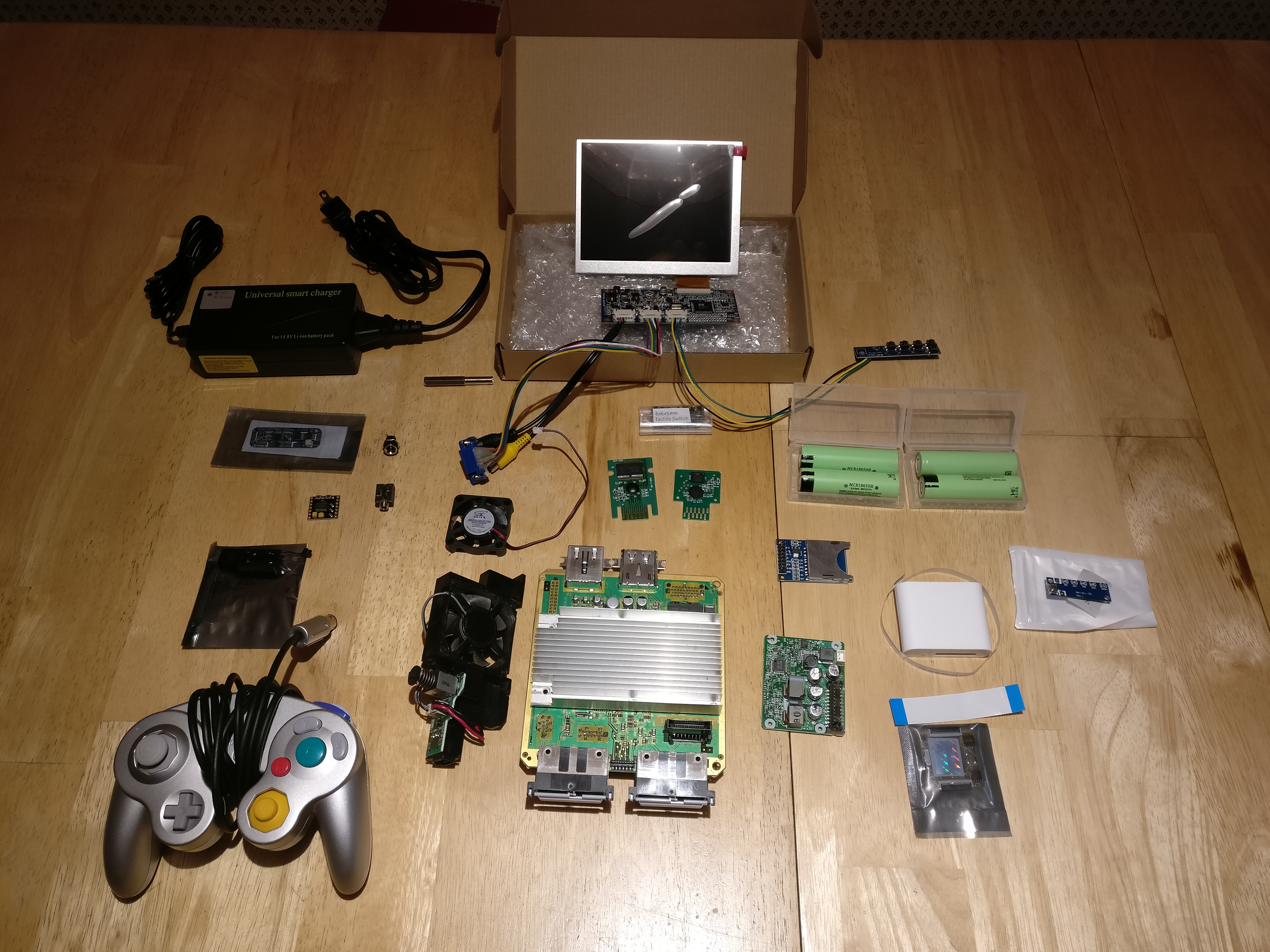

For a while I've wanted to build a Gamecube portable and I've finally done the research to build one and bought all of the parts needed to make one. This is a picture of all of the parts that I have bought:
This is a list of all of the parts I have bought for the project:
A gamecube
2x controllers
3x wasp fusions (2 i will probably will sell after)
128mb mem card and second one to use for a sd gecko
1x sd card slot
1x pam mini audio amp
2x speakers
4x panasonic NCR18650B 3400mah li ion batterys
1x li ion charging curcuit and charger plus jack
1x headphone jack
1x 4.3in screen
1x battery indicator light
a bunch of switches
1x fan to use on custom heat sink
And a bunch of different wires
The case will figured out after I finish everything else.

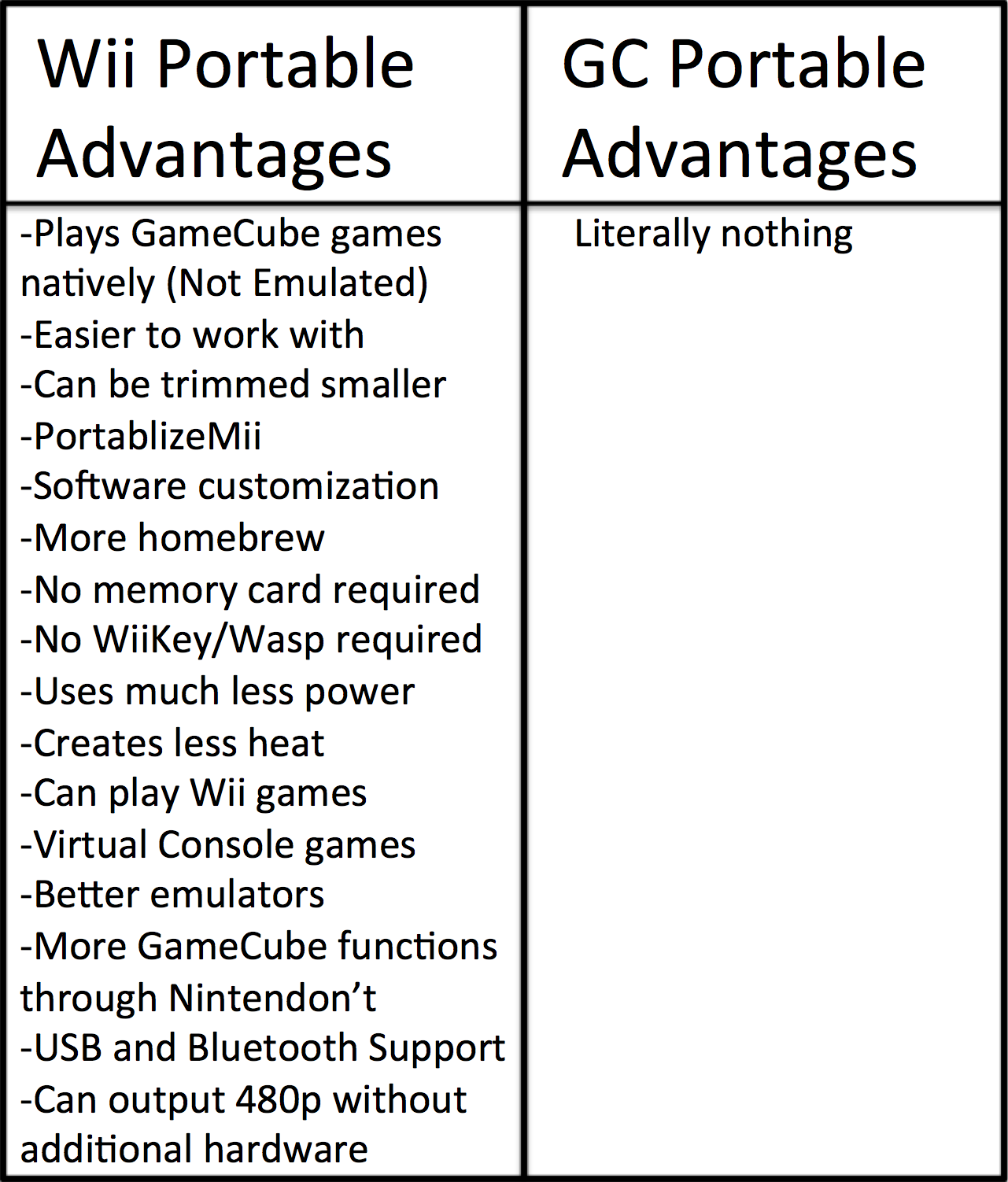

Why is that? From a few days of browsing this site and modretro, there seems to be some more documentation on GC portables, but I did see Wii's run cooler.
The Wii is much cheaper than the GameCube. It is also a lot easier to trim and get working once trimmed. It consumes less power than the GameCube which means longer battery life. Also, you do not need any kind of extra hardware to get games running on the Wii as you do with the GameCube (ex. WASP fusion)
Innovation and guide making on Modretro was essentially abandoned several years ago, right before early Wii work began. Most of the information there is outdated.
Also, have you seen the compendium, or my super guide? The Wii hardware is pretty much completely reverse engineered.
Heres a repost of my poorly made comparison chart.

I did make some nice GCps, but after portablizing the Wii I'm personally never going back. I think @Ashen would probably be in the same boat, as most of the big name GC portablizers were also very interested in the Wii many years ago.
There are always going to be people who want to make Gamecube portables(that's why we still have this forum,) but after the portablizing "revolution" this last year that number is on a steady decrease. That's because most people want better Gamecube portables, and that's exactly what the Wii is.
I don't think anyone who's posted here is trying to discourage anyone else from building something, but rather urging them to try out the Wii instead. It is really a lot easier to work with and as a community we've spent a lot more time developing things for that, and there's some cool stuff on the horizon that will only be for the Wii.
It's all about what you really want to do. There's nothing wrong with loving the Gamecube for what it is, but if your aim is just to play GC games on the go, you can't beat what we've done with the Wii.
