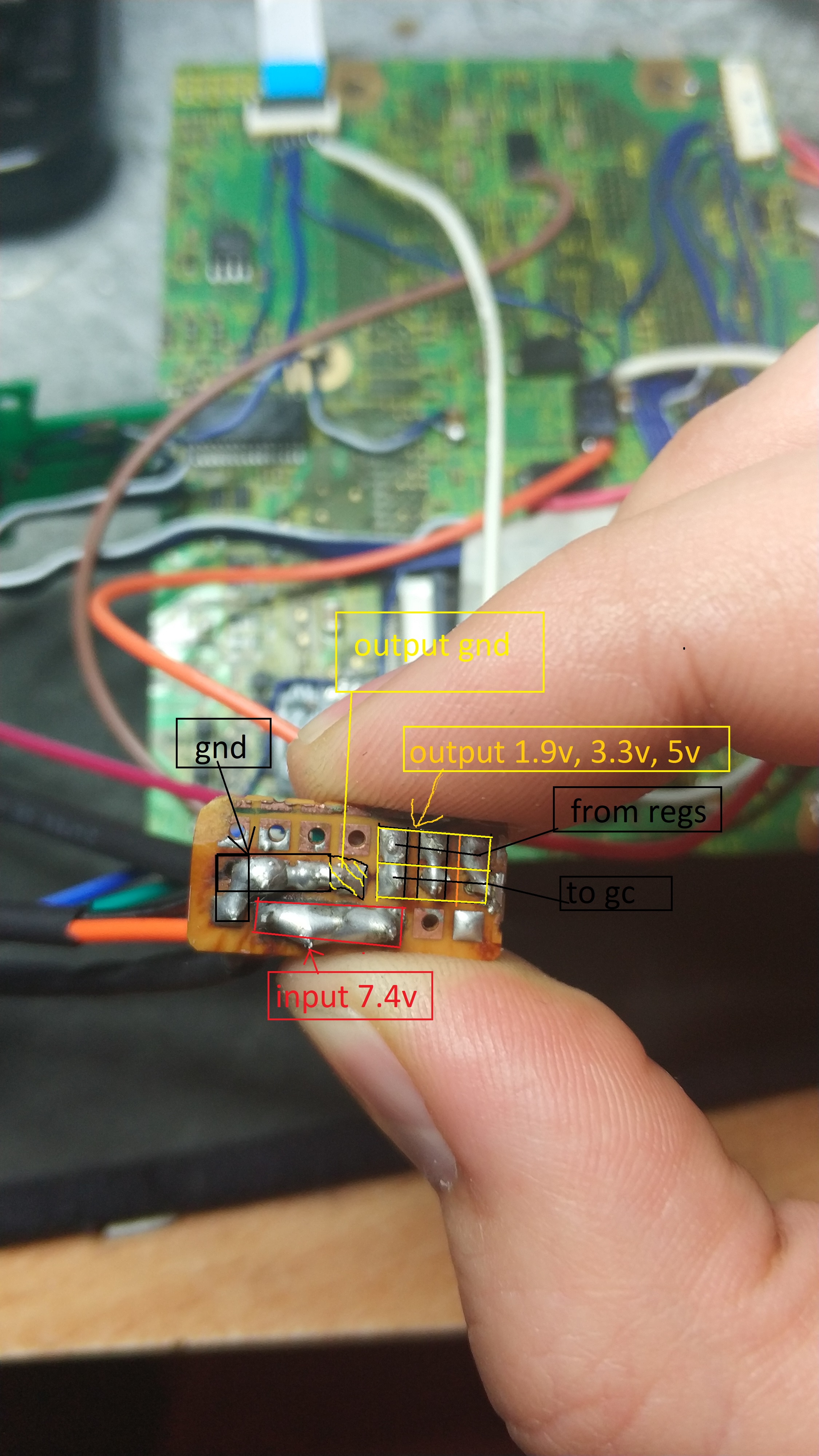

  • I don't like how cables are connected to power rails to power the GC on so i thinking to make a little pcb to handle that.

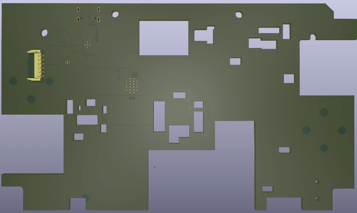

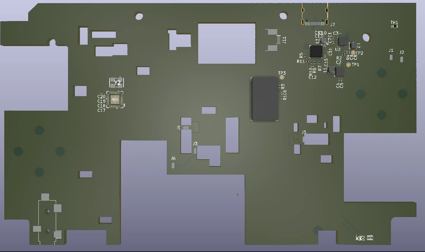

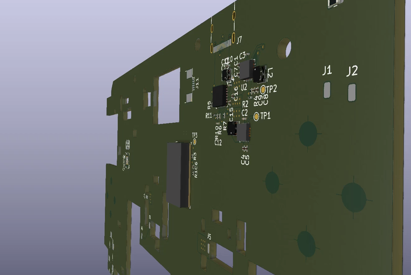

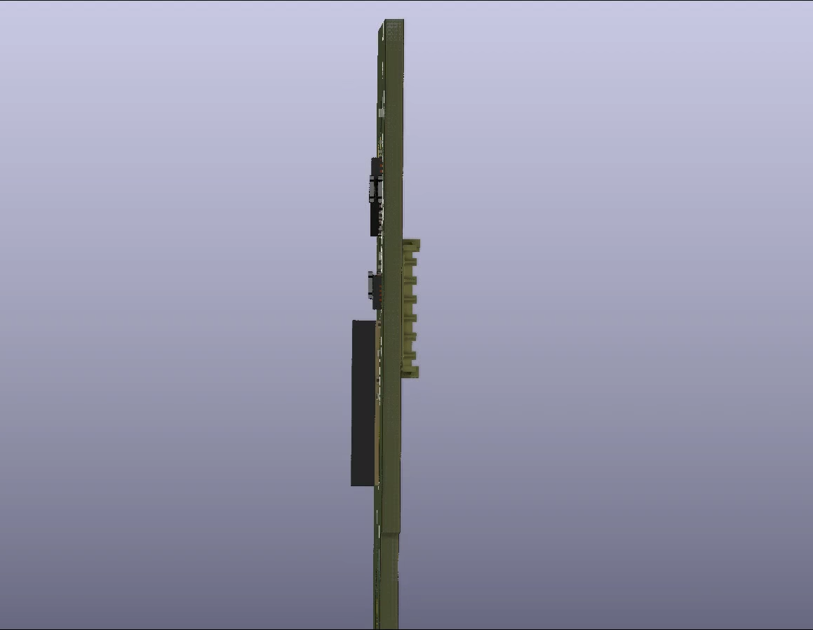

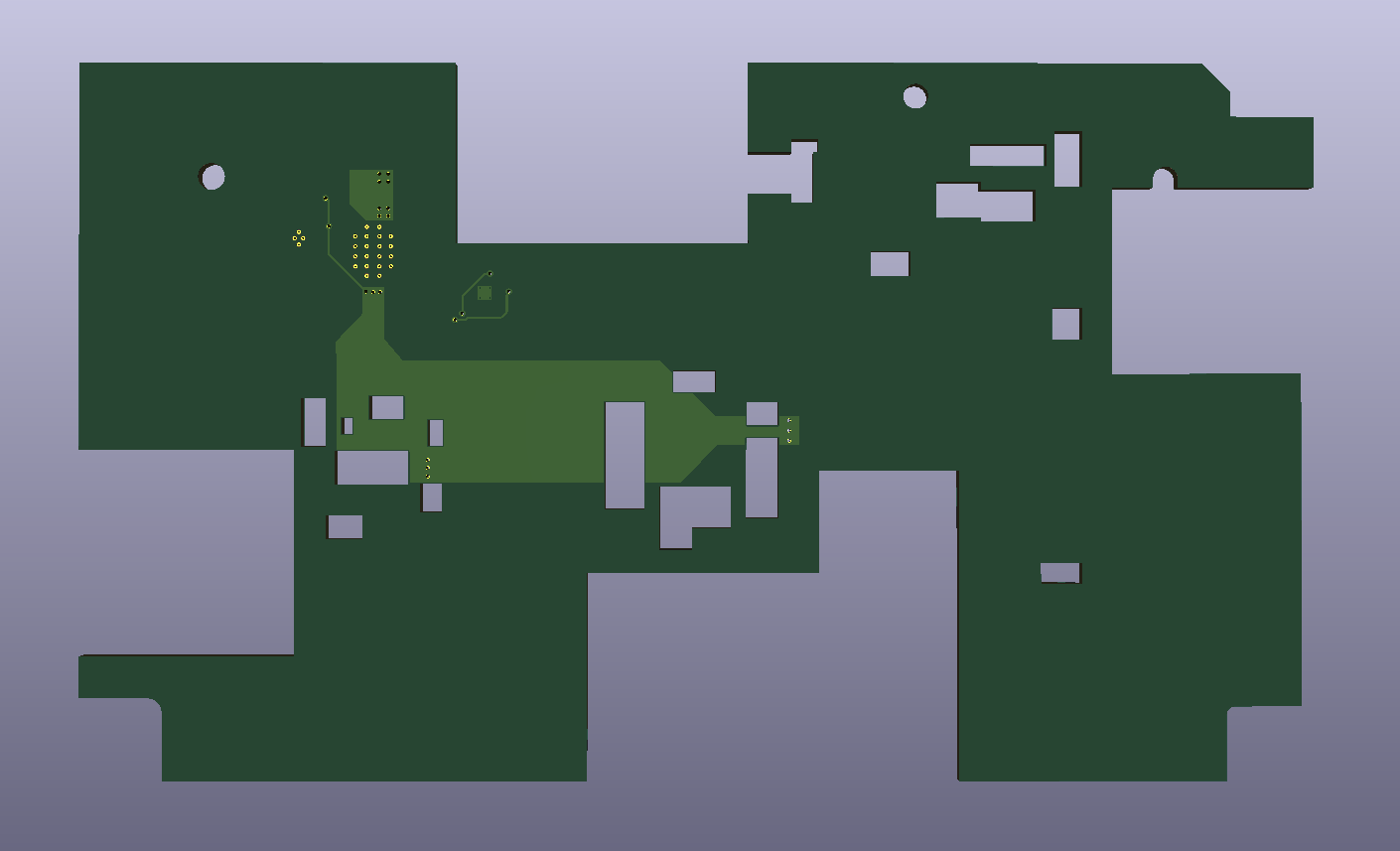

I'm messing up with kicad making my the "little" custom daugtherboard. turns out it's way bigger!.
after woke up in the middle of the night a couple days ago, I realized a couple of things..
  1. As I trying to fit the gcp on a 3ds xl shell and making the cleanest possible, i though "well, lets use the 3ds xl board to make the daugtherboard". so, the result i'ts something like this.
the cuts are designed to avoid most of big components on the gc mobo, megadrive v6 and another 3ds stick for C analog​
It's a veeeery early design cause i need to make the holes fit more precisely but it's a beginning.​
This board might be capable of handle power regulators, usb-c charging, controllers, audio and wasp fusion. (I only have, at moment, the custom regs schematic)​
  • I need to think in a solution for cooling. i pretended to use a 5v netbook fan but it died a time ago. now as nintendo switch came out, can i use the heatpipe(maybe) and fan BUT (always are a but present) i dont how to drive it (pwm maybe?) if it so, maybe use a microcontroller to handle this type pf things.
any suggestion (not change to a wii portable please), comment tip is well received
adiosin!

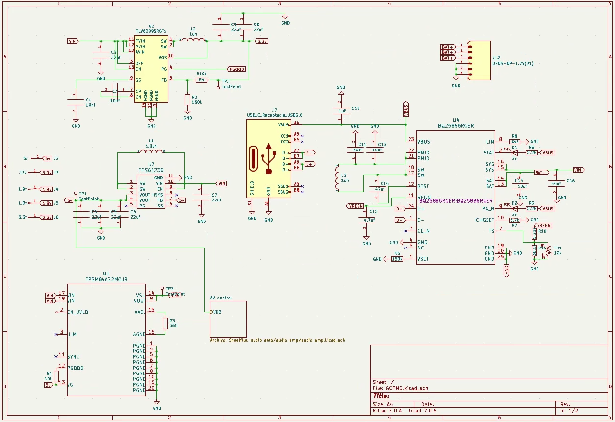

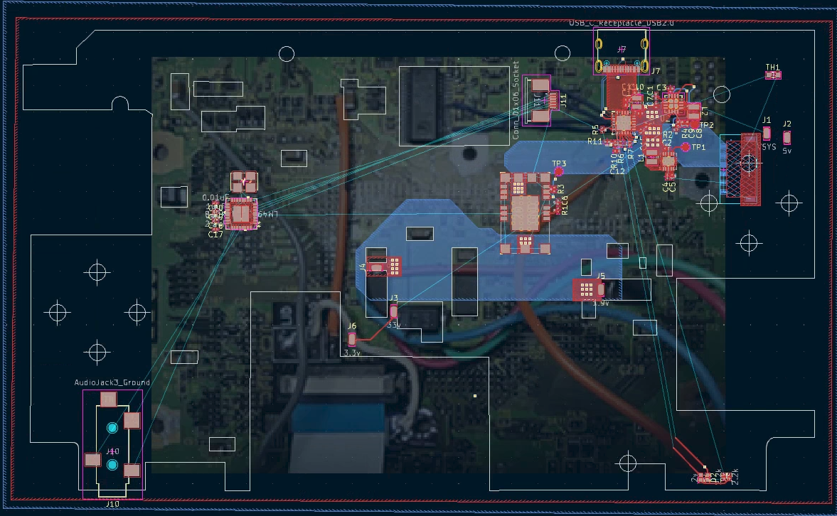

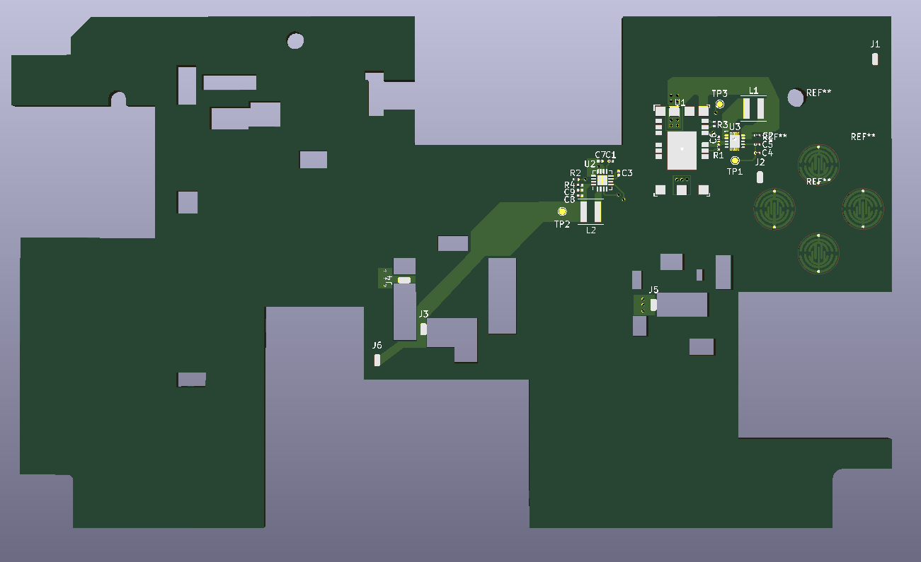

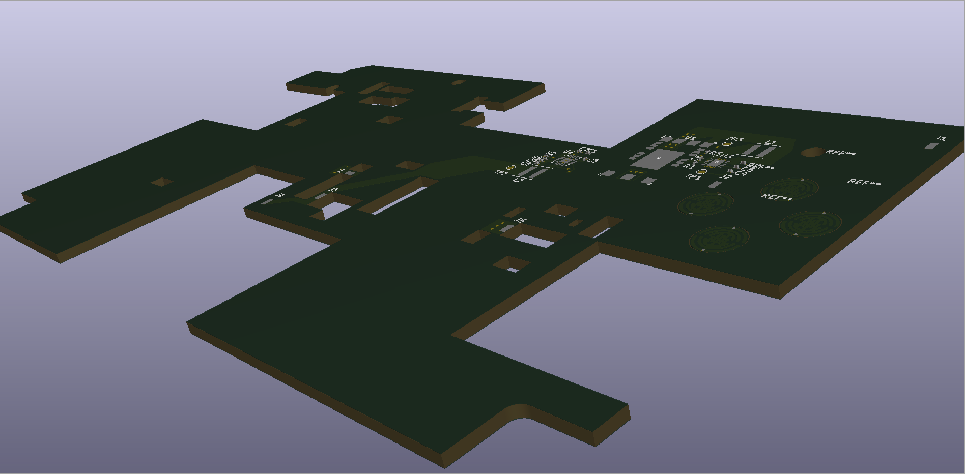

sadly, i have a a limited knowledge of electronics and pcb design but I'm still learning (baby steps). Now i want to share with u the """""progress""""" that i made so far.
and this is how the GC daughterboard will look: 1v9 ic kinda bulky but it the least of my problems hahah
I'm currently using some design from @Aurelio wiiPMS (big KUDOS for making such a awesome work) for the 5v and 3v3 lines. for the 1v9 i found the TPSM84A22MOJR IC than can handle up to 10A of current (i know that CPU max current is 11A but i want to take the risk) in a nice SMD pack.
the battery connection will be a HIROSE DF65-6P (3 lines for v+, 3 for gnd) with awg 22-24 gauge (i searched about that type of connector and cable gauge and i found that will be able to handle the current)
For battery charging I'll use the BQ25886RGER that can charge a 2s li-po battery ( my current config)
For audio will use the "classic" LM49450SQ. here i will have some trouble because i want to use the i2s audio from GC and manage the volume with i2c protocol. so, i must have some king of micro-controller to handle the settings and the audio configuration of the IC.
I really don't' have any idea of what is the best to supply the requirements of the portable. Also, as part of the list of things that i want to make, I'll need more micro-controllers ( or maybe the same) to handle fan PWM, on/off using software (like a latch switch. press to on, hold to off), handle the enable pins of regulators to handle when the input voltage are stable and ready to power on the regulators and then turn on the console (idk if its necessary to do so but i know that laptops use something similar), handle the lights for on/off, charging state, low battery and some temp warning. (what do u suggest me to do? a couple of micro-controllers? just 1? Atmega? some PIC?).
please any feedback will be sooper dooper appreciated
