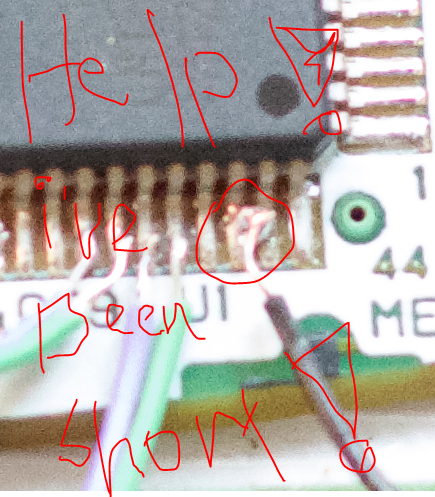

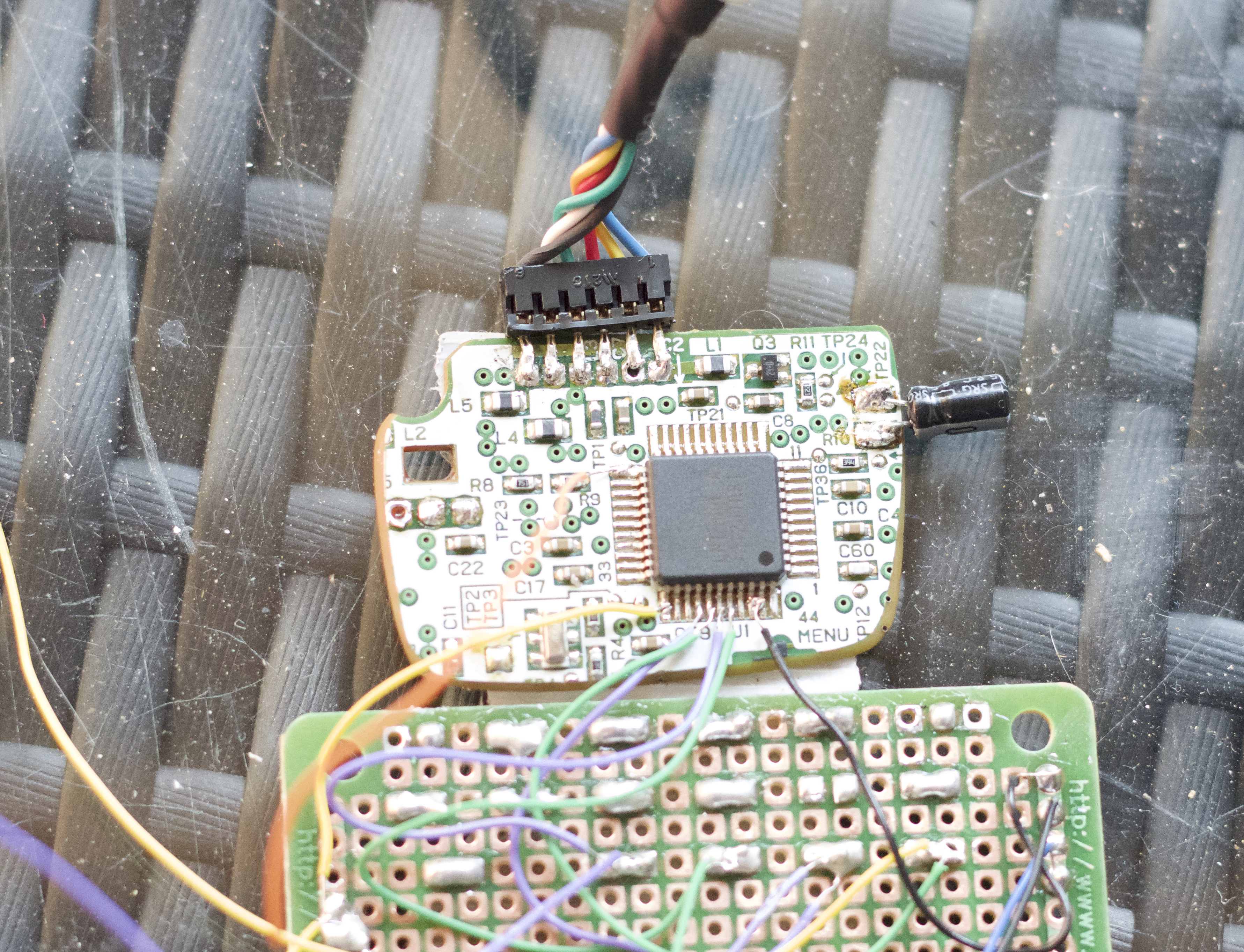

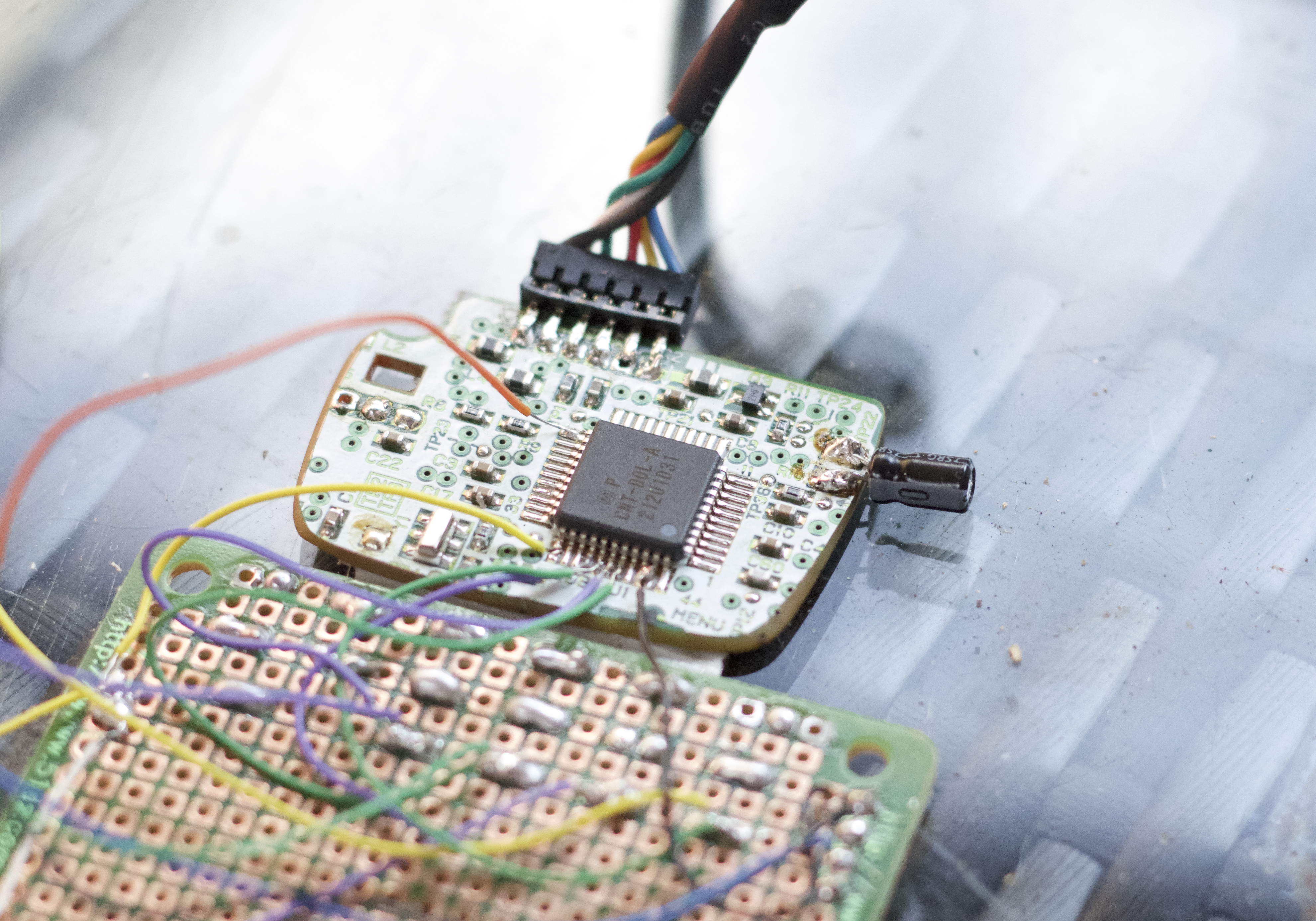

I'm having some troubles regarding my GC controller trim. I've managed to pull off a successful trim already, but one leg of the DOL-A chip broke off. So I just thought: no big deal, I'll just get another controller. I did the exact same thing with the new controller. This trim didn't go as smoothly though. I connect the controller to my Wii, boot up Portablizemii, move around the joysticks and nothing. Nothing happens on screen. What am I doing wrong?
  • I've tested continuity to make sure everything is properly connected to the joysticks
  • I've tested if voltage is going to the chip and the joysticks
  • I've sanded the whole thing down with 200 upto 2000 grit sandpaper
  • I've covered the chip with tape before trimming so no particles would get underneath the chip
I know this is the outdated way of adding Gamecube functionality to a portable, but there isn't a whole lot that can go wrong here right? Do gc controllers just die on their own like the consoles themselves?
I'm at a loss here... :rothink:

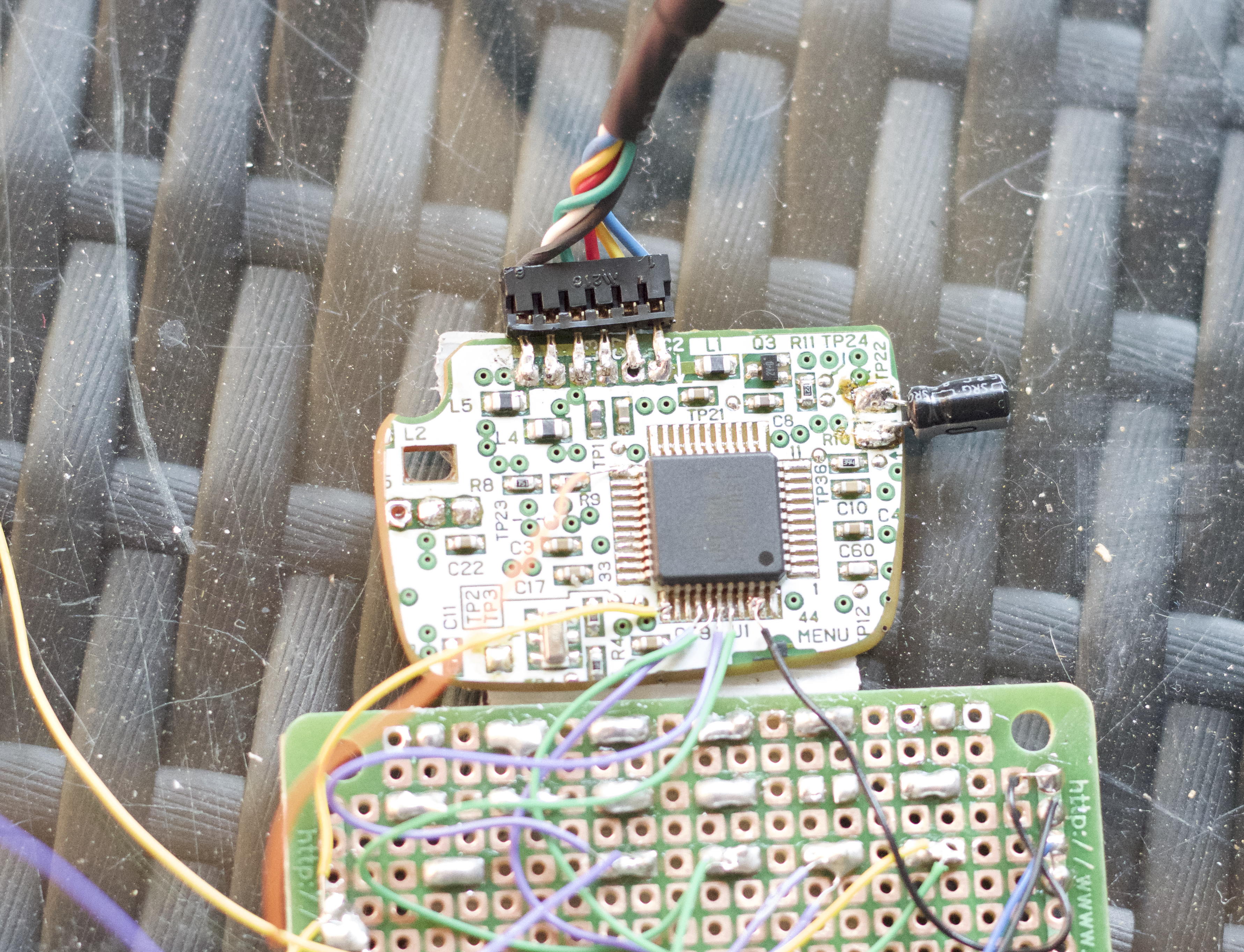

Have you checked all the ground and 3.3v pins marked here? There's a resistor down the bottom of your trim that looks a bit intruded upon. (I don't know if it's connected to anything tho)
