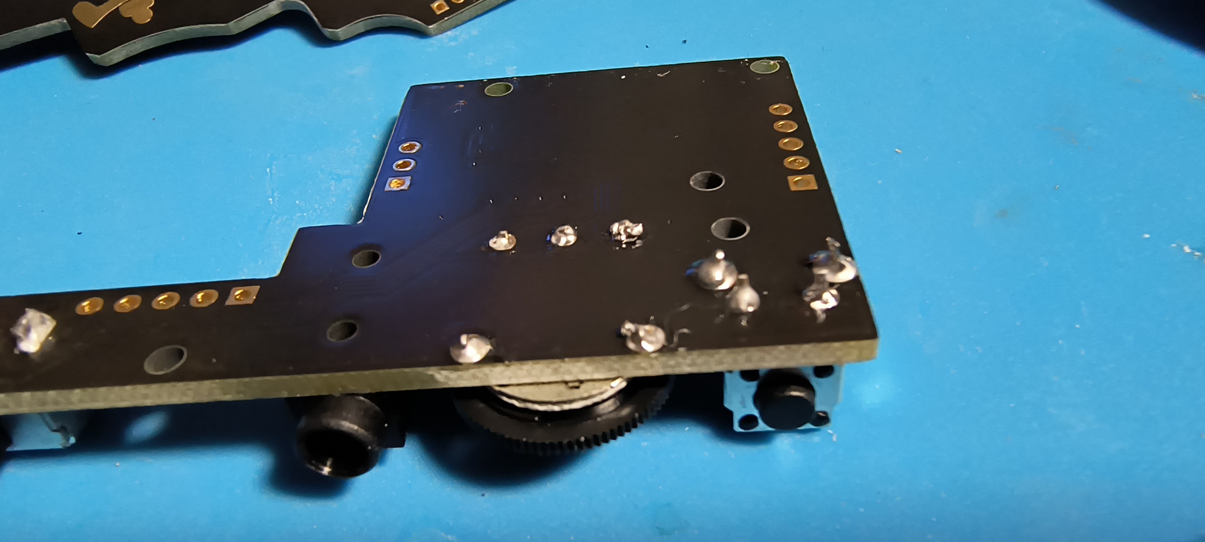

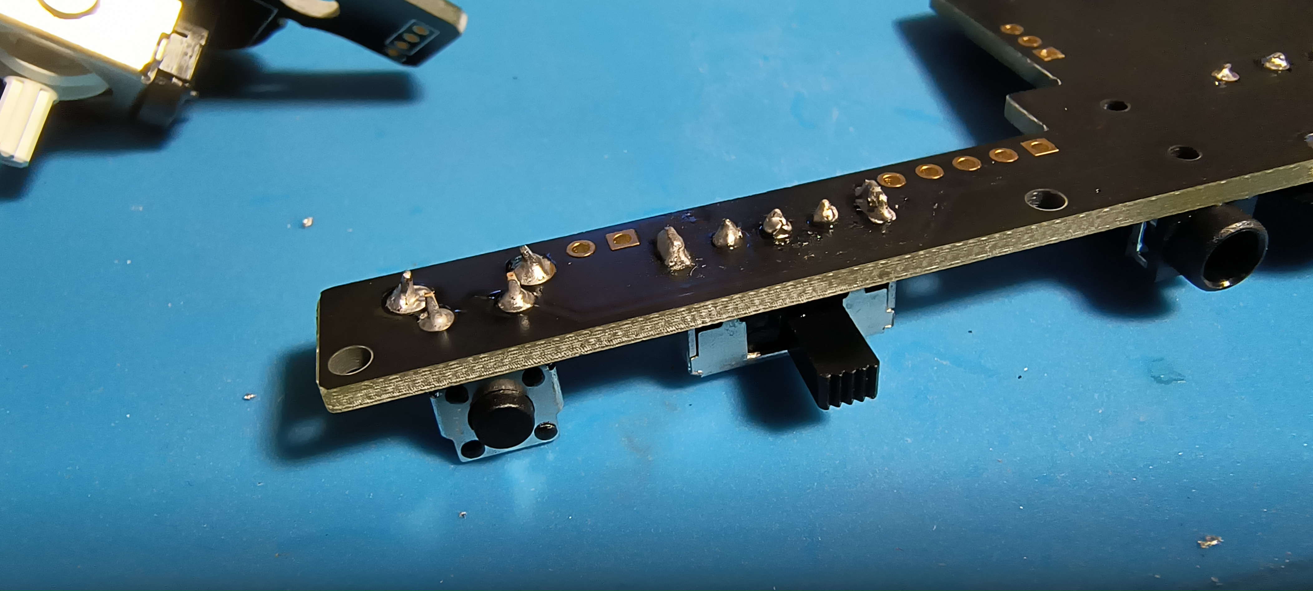

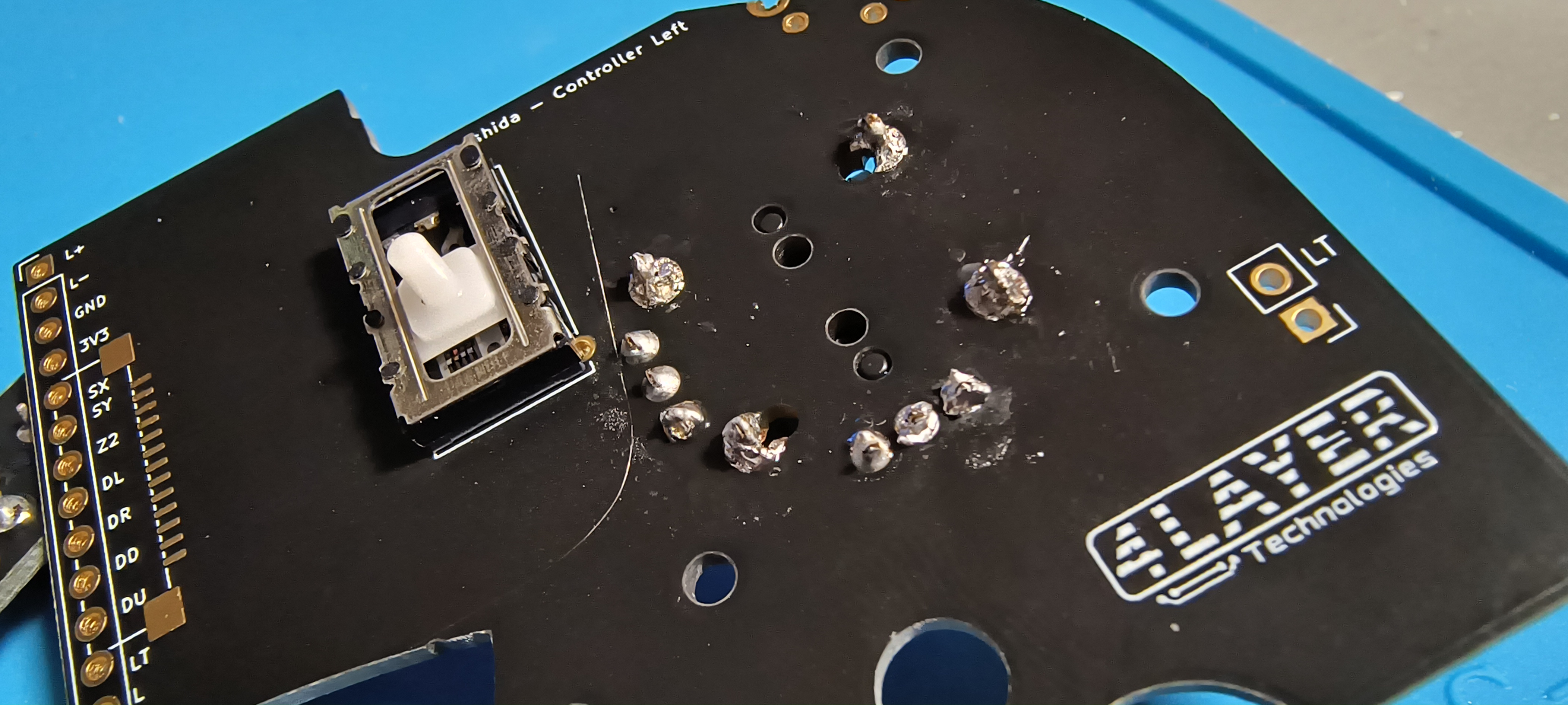

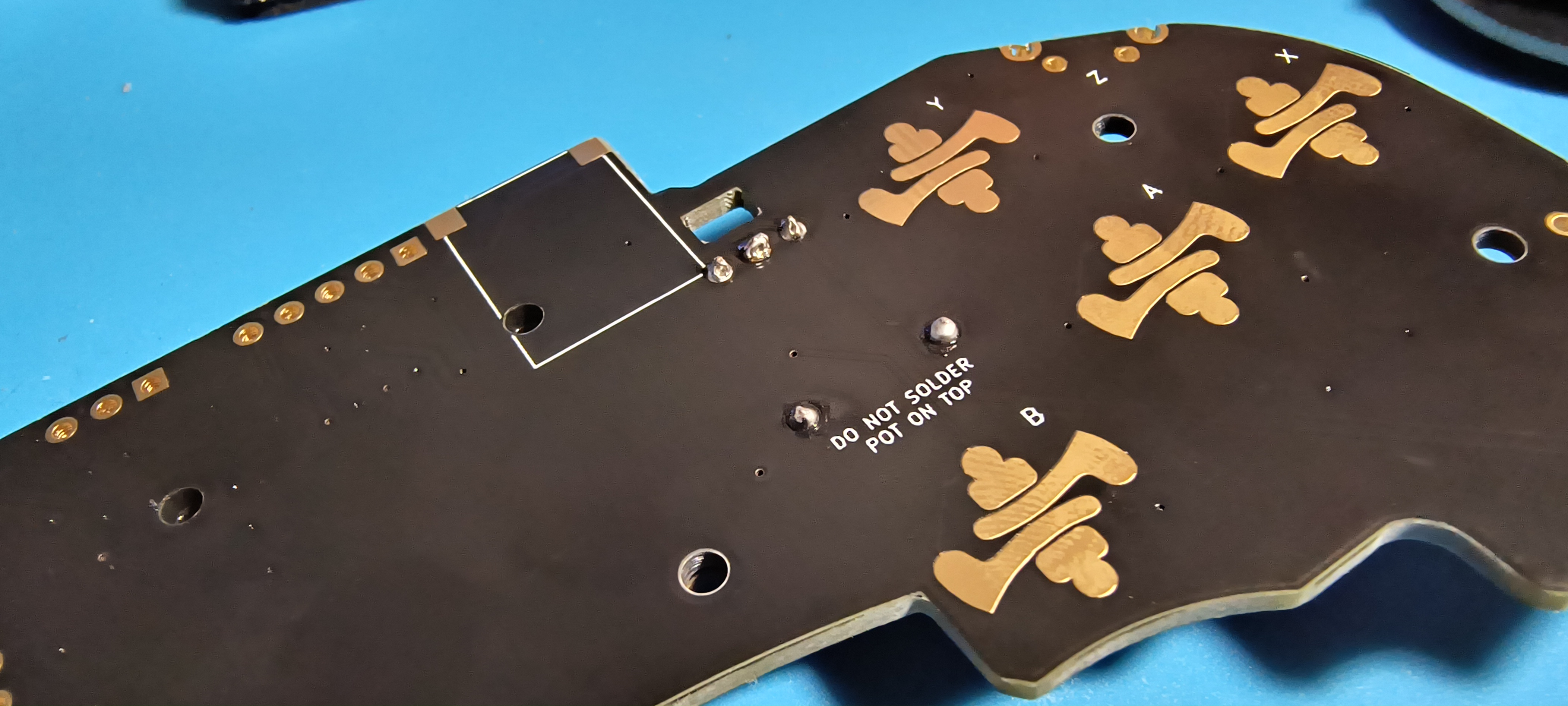

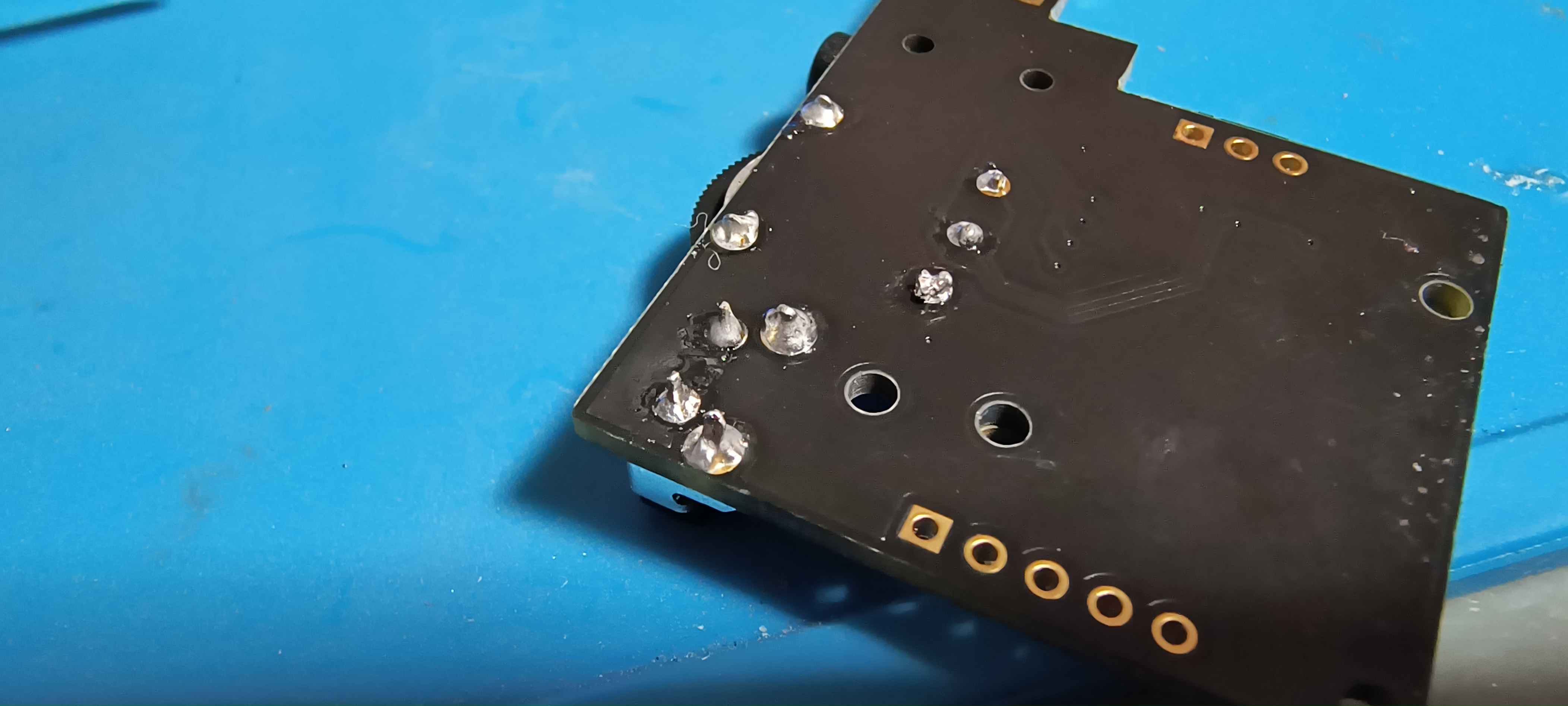

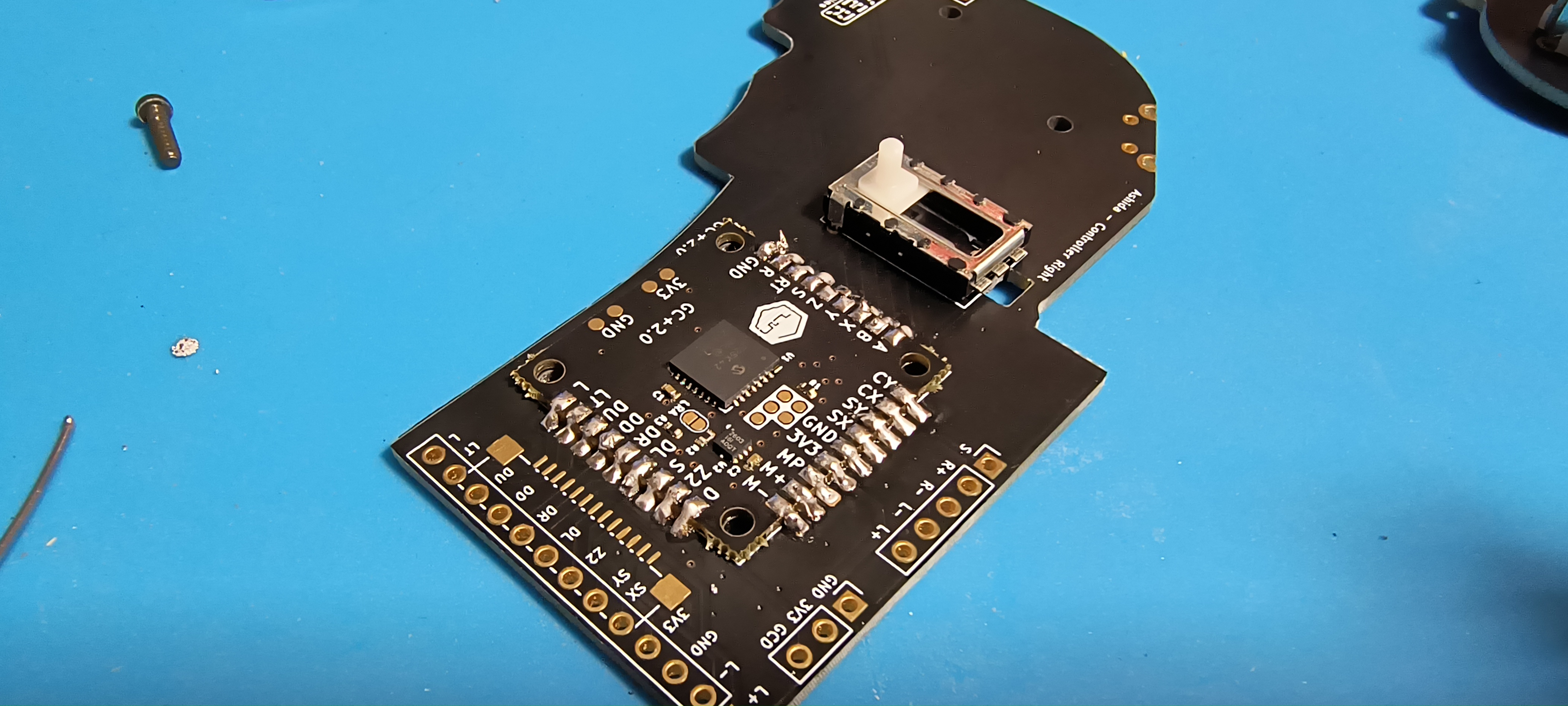

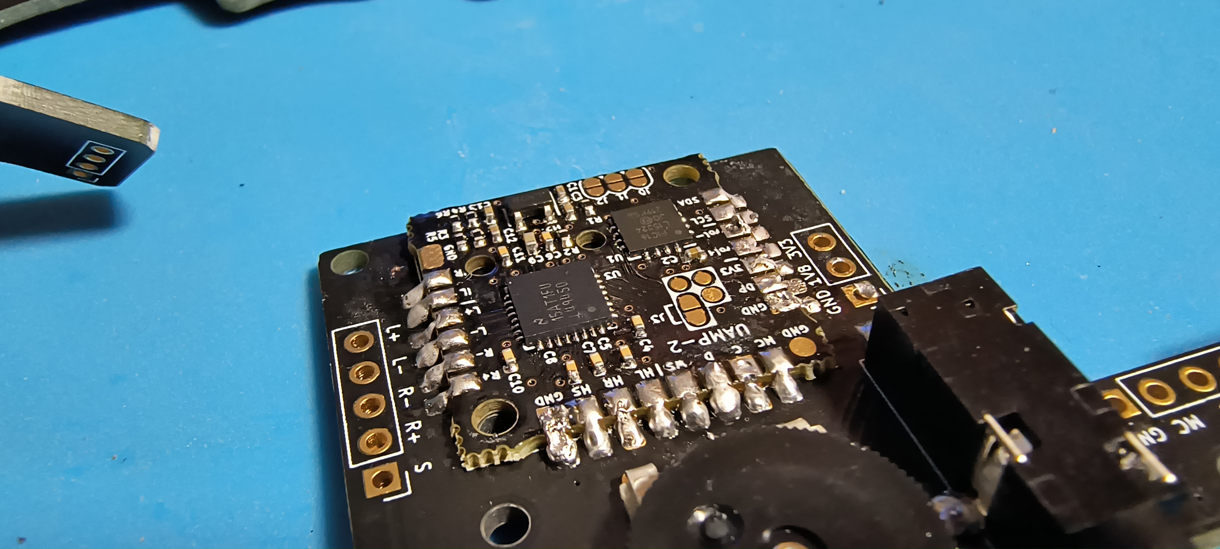

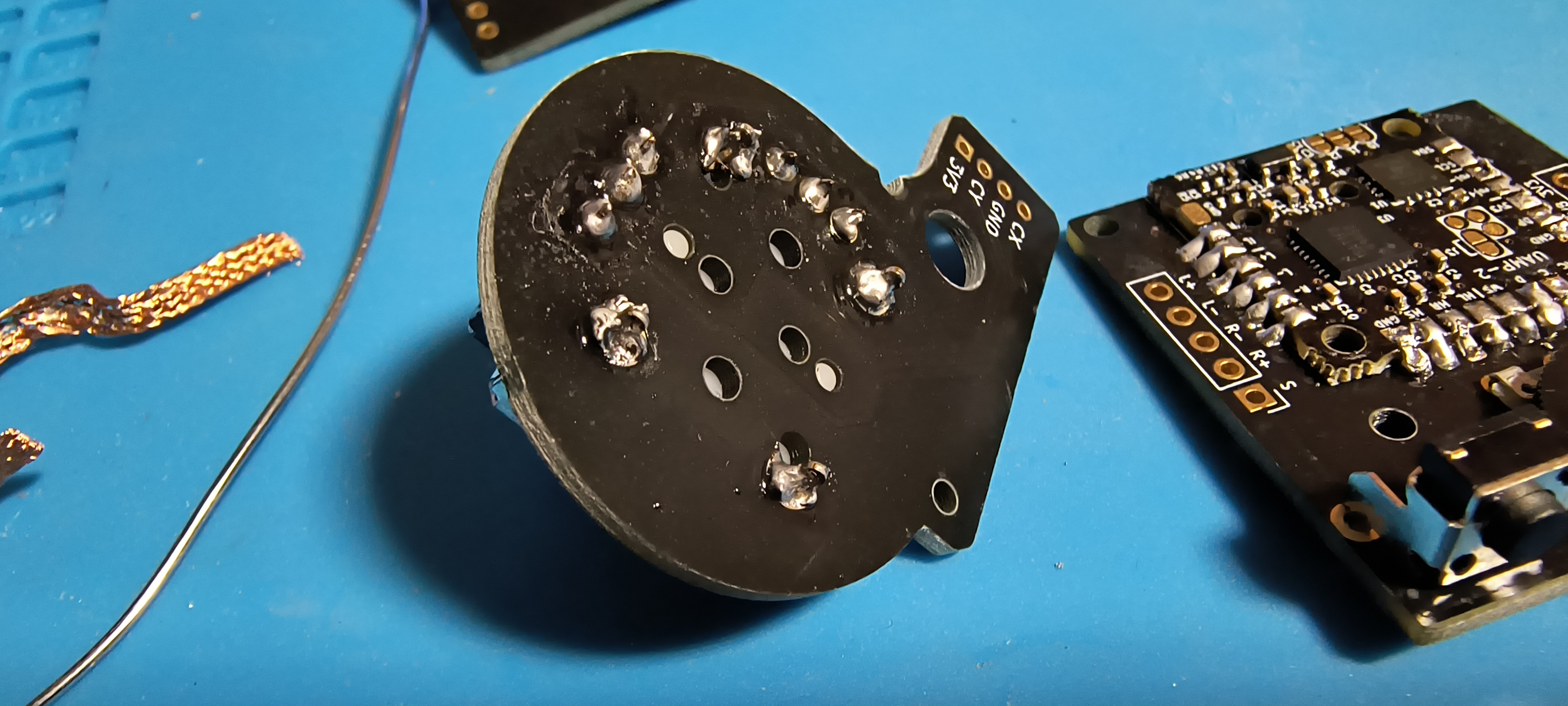

Okay! I've done a lot of progress today! I soldered on the U AMP 2 board along with the GC+2.0. Then I soldered on the stick boxes and shoulder button pots. Lastly I finished up the peripherals on the Ashida boards.
GC+2
View attachment 27231View attachment 27232
Shoulder PotView attachment 27233C-Stick BoxView attachment 27234UAMP-2View attachment 27235View attachment 27236Extra PeripheralsView attachment 27237View attachment 27238View attachment 27239Left Analog Stick BoxView attachment 27240Left Shoulder PotView attachment 27241
