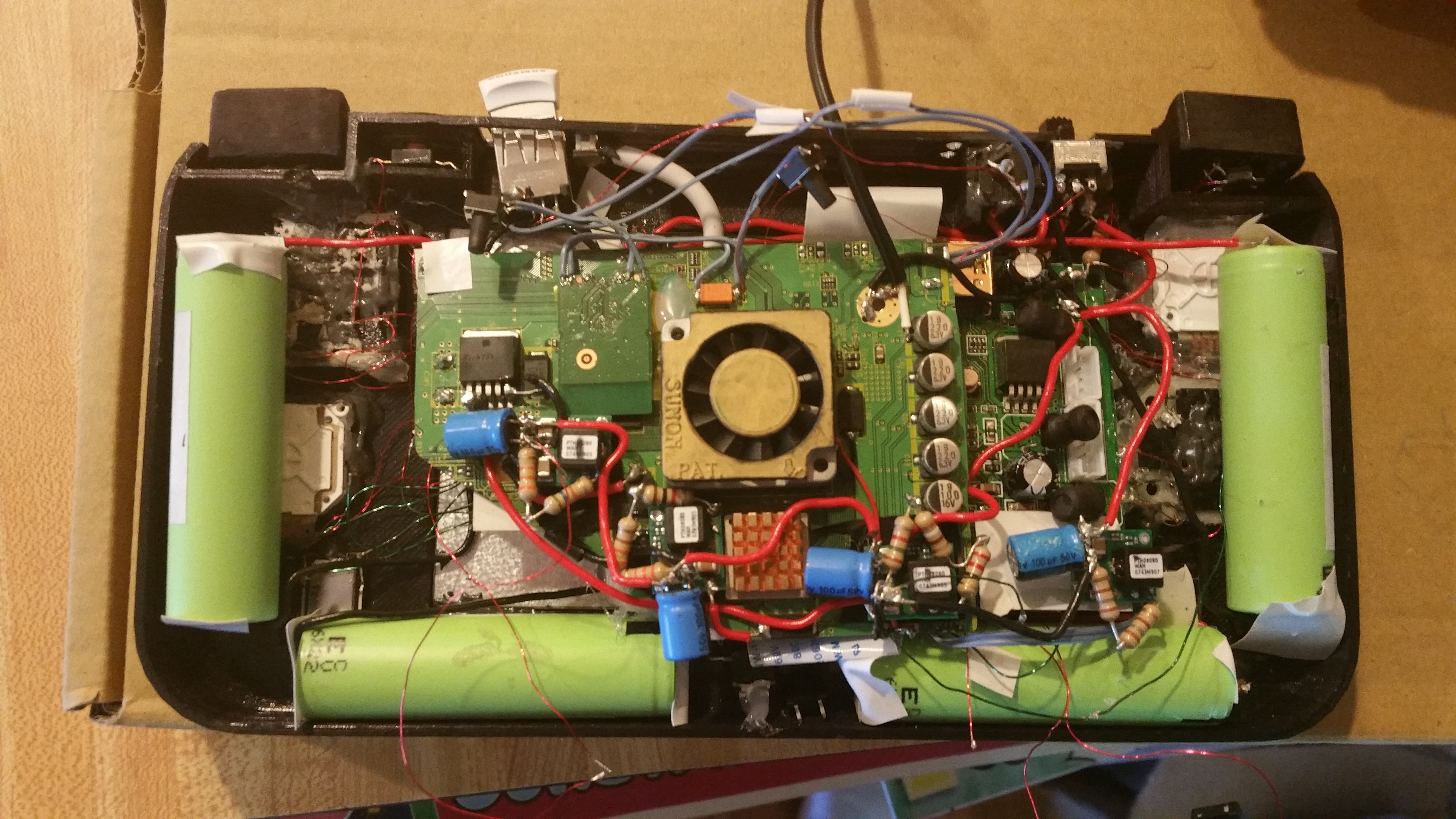

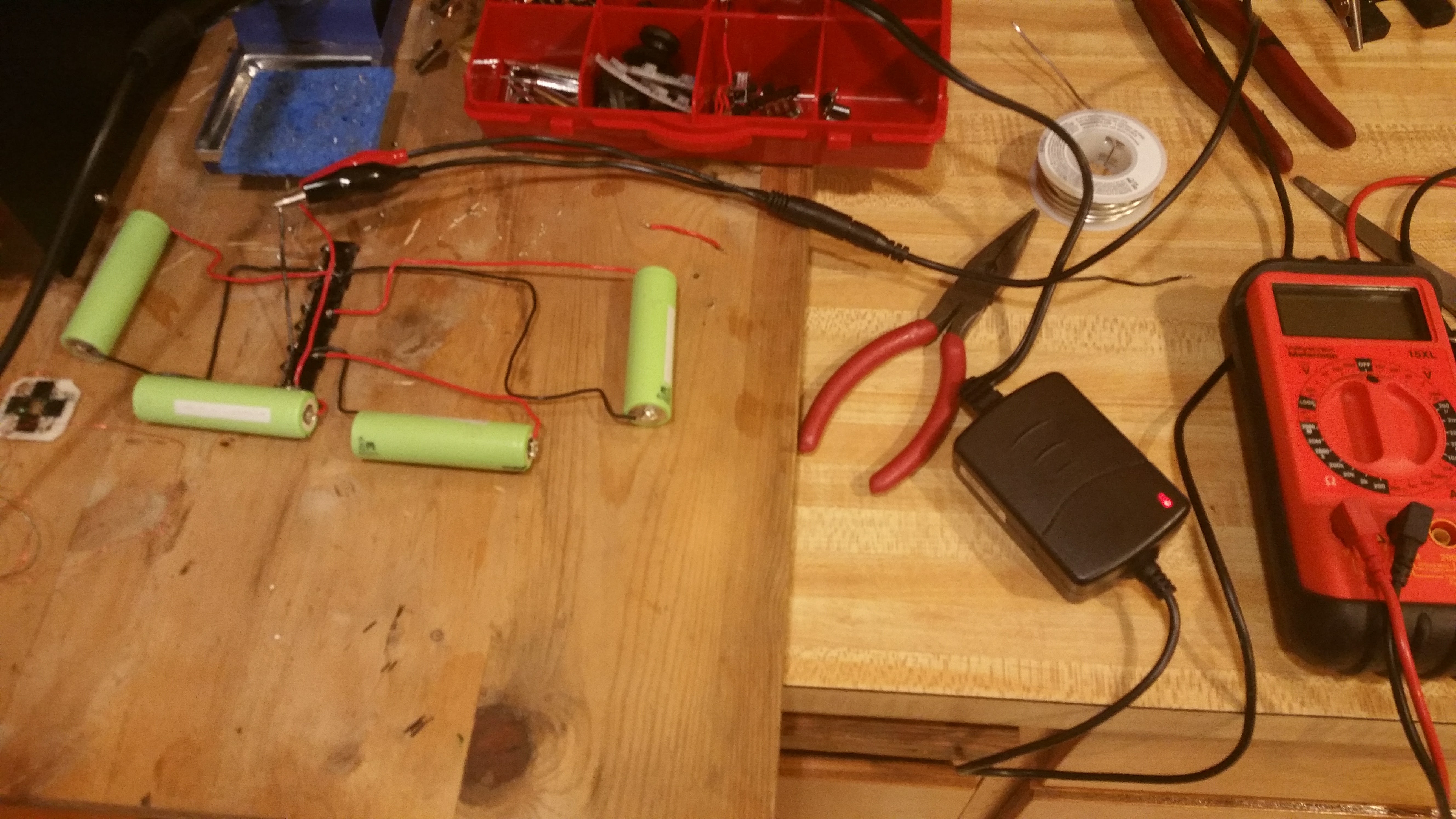

Well, you have "charge" and "play" on the SPDT marked backwards. The left pin on the DPDT should be charge, right should be play. Other than that, this should work. Just to be sure, what are the voltage and current ratings of the switches you're using? If the charge/play selector SPDT can't pass on enough current during "play" mode, that might cause the issues.@Stitches here's a diagram of my charge and play. The charger outputs 1.2 amps.
If this is wrong, then I'll delete it to prevent confusion.

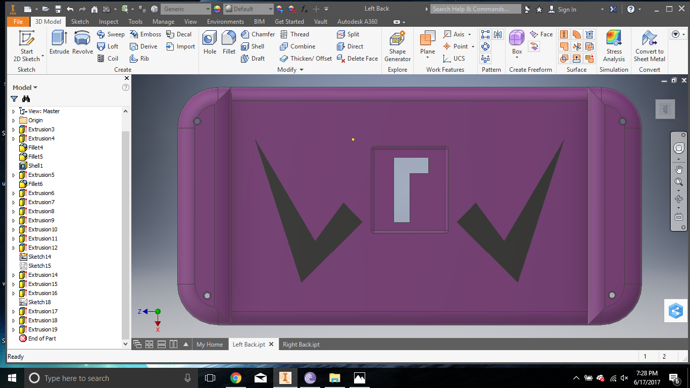

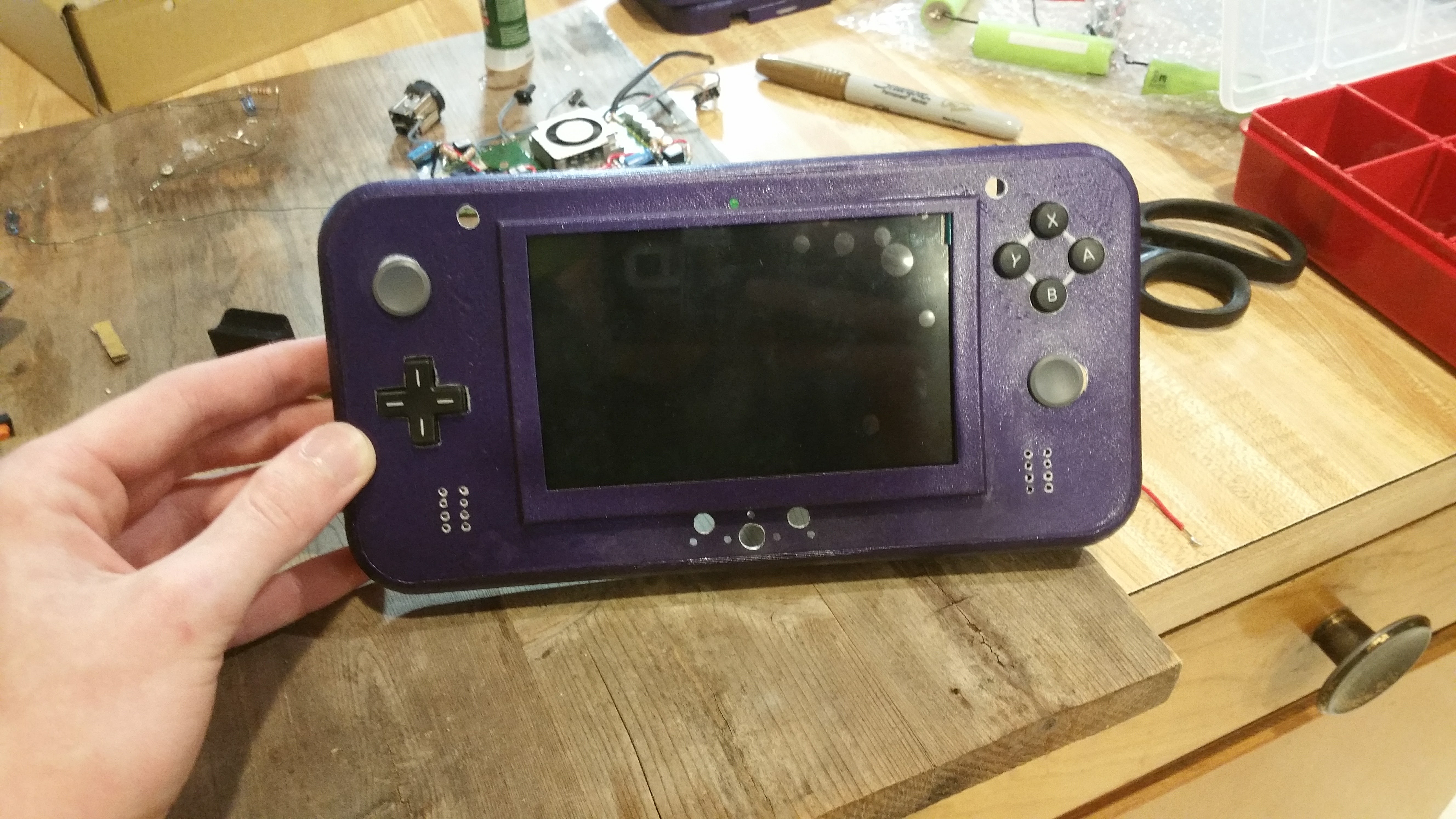

But it's waluigi?You should put warios whole face on the back if possible. I do dig the mustache though. And that case is beautiful.![]()
wario
dibs on the name WaluWiigi!!!!

Could you get a sticker of some sort and clear coat over it? For the air vent hole just paint everything seen inside the color of the nose?
Either way though this portable will look amazing and I'm excited to see how it turns out.
You should get a charger rated for the voltage of your batteries to charge your batteries. If you wanna just run your portable on wall power not doing anything with the batteries, then anything the regs can handle will be fine.
