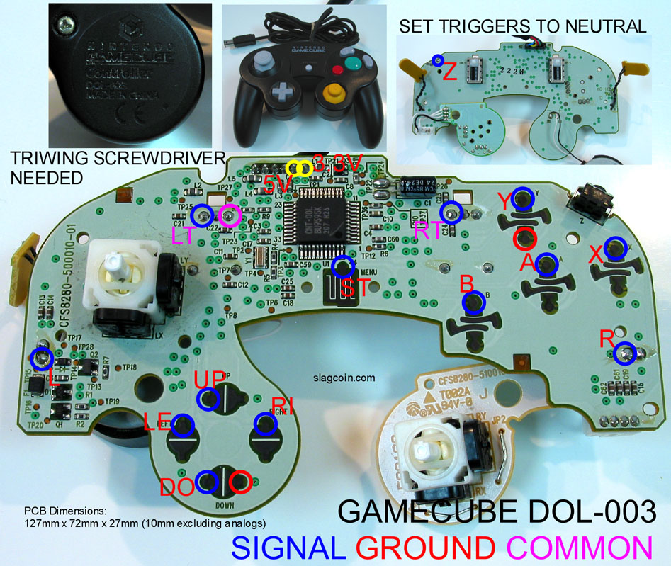

What traces would I ... if any.... need to rewire if I cut this PCB in half for a portable project?
