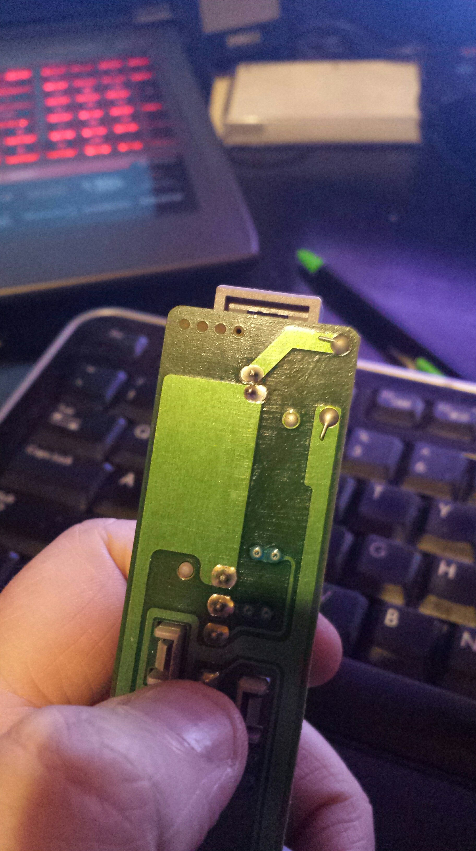

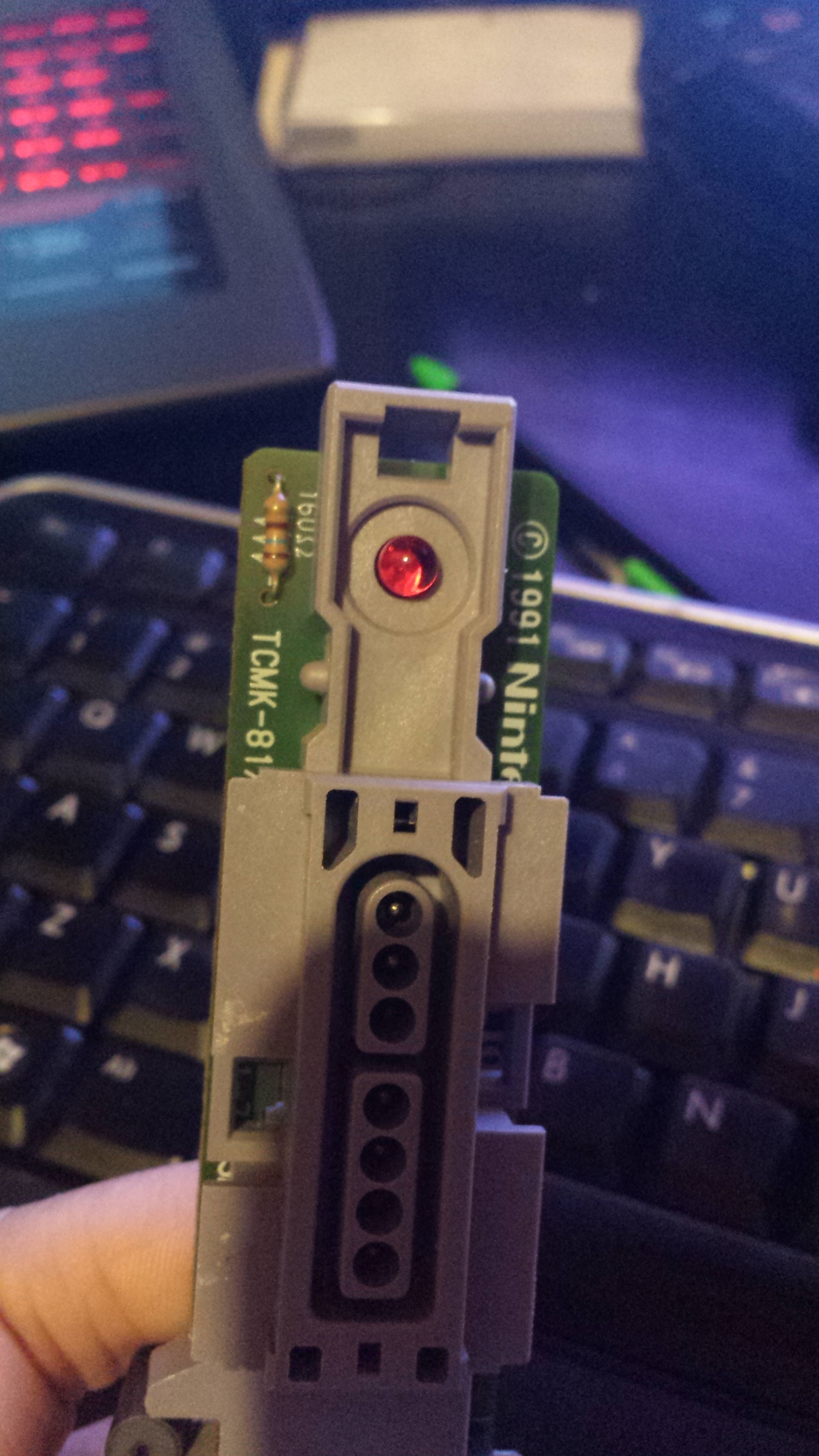

Hello everyone! Am I able to remove the section of the original SNES controller port that has the LED? I would like to make a custom case for it, but the only thing in my way is the board for the port is too long on one side with the LED and would stop me from going with the size I want. Looking at the board, it appears to me that the side with the LED is only for powering the LED itself and I may be able to trim it down. I looked all over with no answer other than how to switch the LED out, but I did see that some console boards could be trimmed to something smaller, so I'm hoping! I've included pictures. Thanks for the help.
Edit: Alternatively, would I be able to just nab one from the newer, SNES jr?

From what I understand, that board is just traces aside from an LED and a current limiting resistor for it. You should be able to cut that part off no problem, rewire it if you want an LED, or even desolder the ports from the board and just run wires by hand from the bare ports to the console.

Thank you for the help! Electronics is a new place to dive in for me, so I'm both nervous and excited about it. I'll definitely make a thread once I have a tiny bit more to show for my project.
