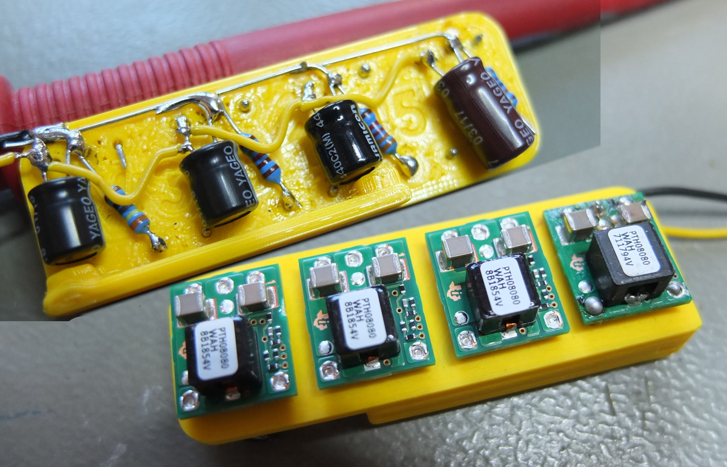

Why do people recommend using RVL-PSU instead of PTH. What are the advantages of RVL-PSU
Hmm so $67 for the PSU? Seems out of my budget unfortunately.
RVL-PSU is an all in one Wii voltage regulator board, meaning you don't have to spend time and effort wiring up and testing your PTH regs. It's also way more space efficient. For a Noldendo, PTHs are more than sufficient, but RVL-PSU is quite a bit easier to work with!

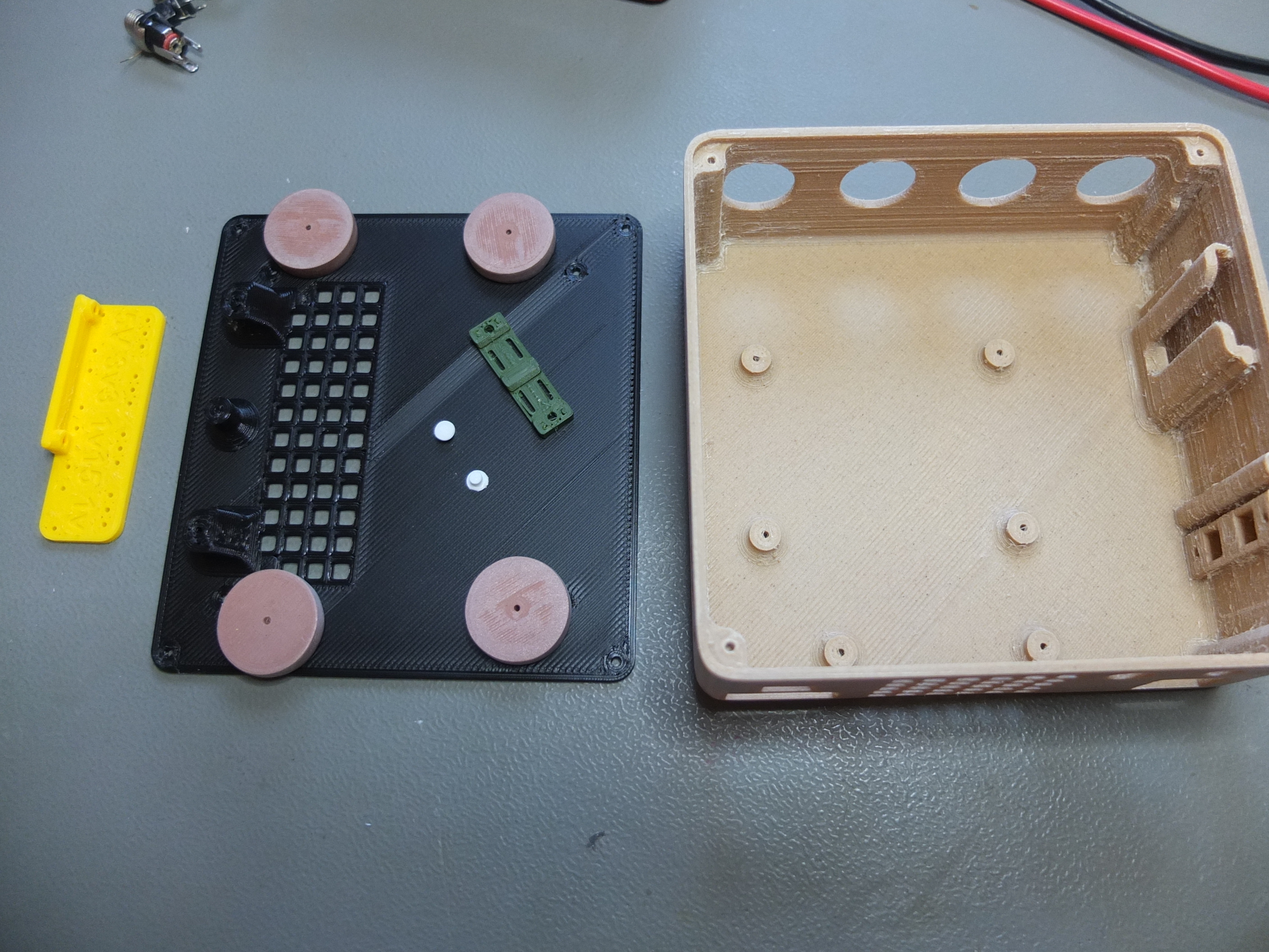

Printed Parts
Top Case
Main part / top half of the wii micro case, will hold most components.
Bottom Case
The Bottom part of the case will hold the Gamecube controller ports. Also it contains the intake air vent for cooling the wii.
Standing feet
The standing feets are **essential** for the cooling to work, since the air intake is on the bottom part. Without them your Wii will overheat!
Button Bracket

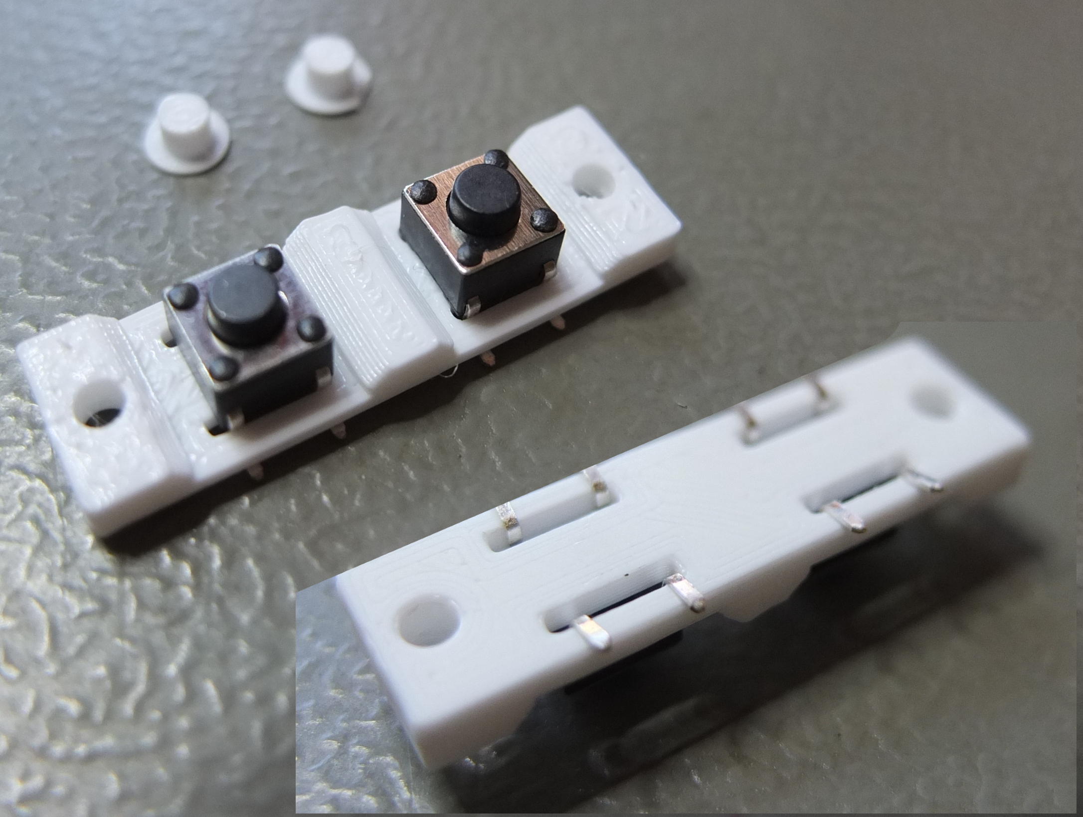

Will hold two tact buttons for reset & wiimote sync
Buttons
When you are using short tact buttons [eg. 1mm], you can simply print the supplied buttons.
PSU Holder
When using the PTH08080 regulators you can print a simple holder for them, that's easily mountable to the screwholes of the GC memorycard slot using two tiny [black] screws.

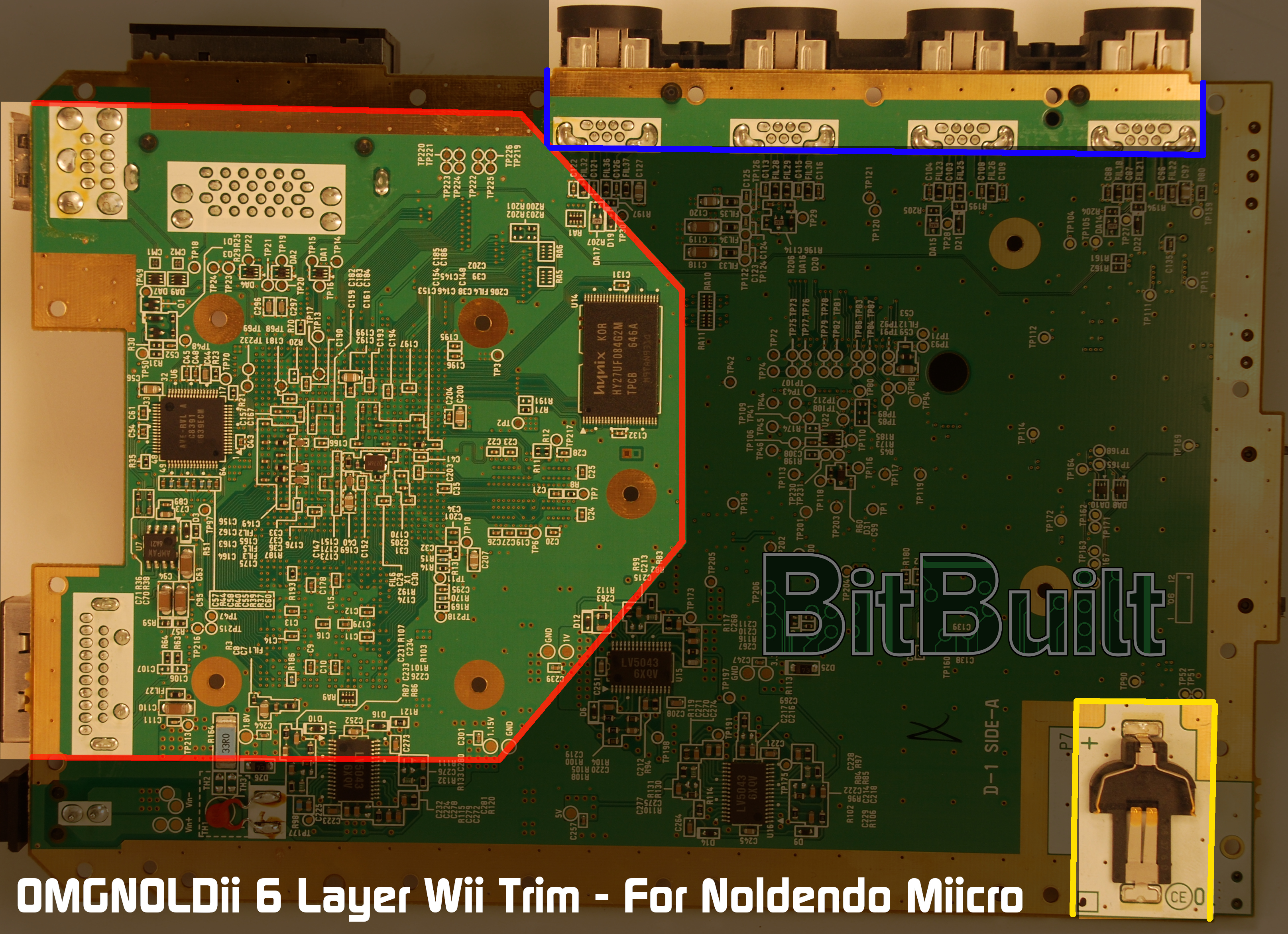

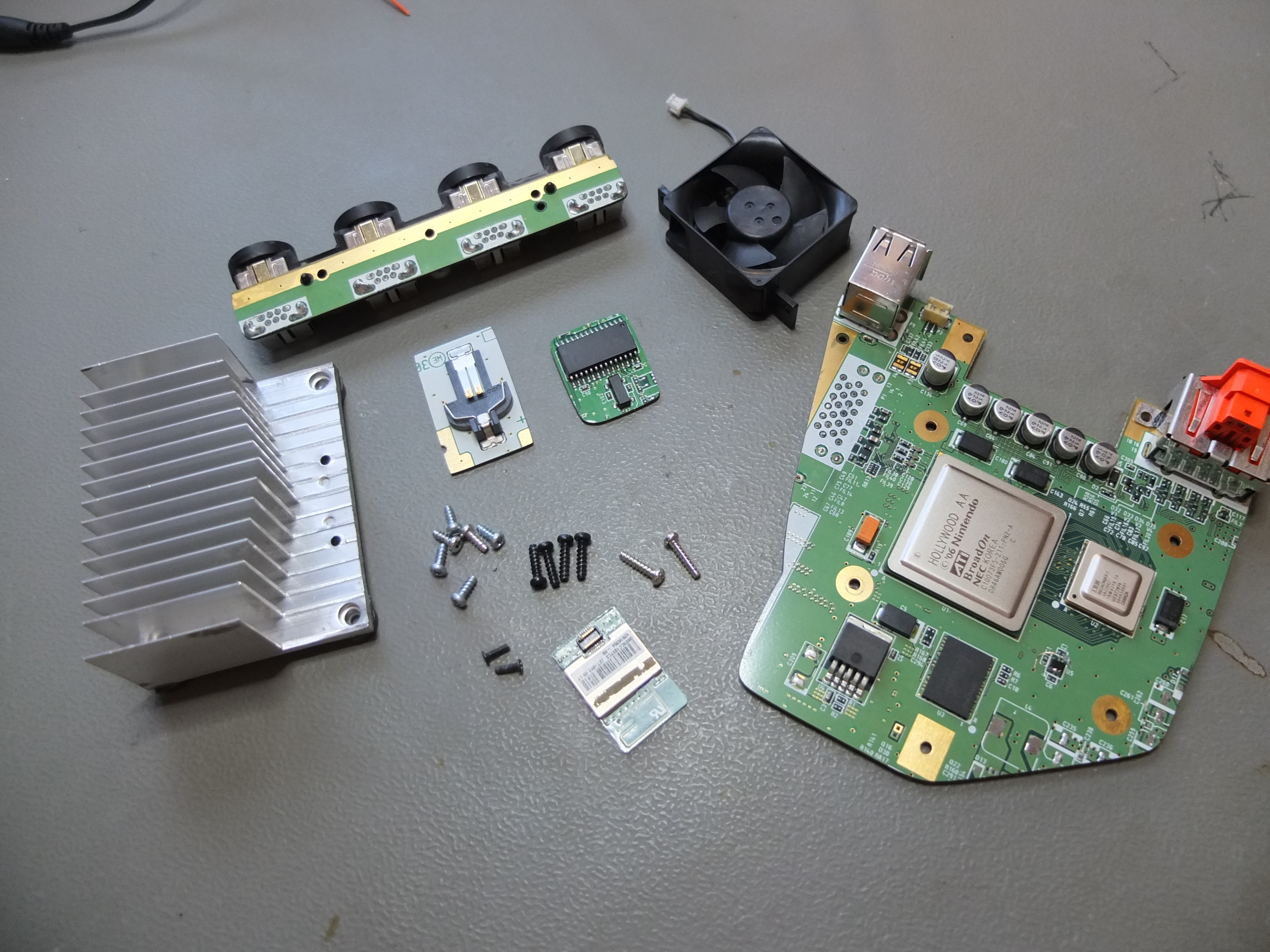

Trimming
I developed a special trim for this project, that has some benefits over the normal OM6 trim:
- AV-Port & USB Port are not trimmed off
- All four screwholes of the Wii's heatsink are kept
- RA1 [pull-up resistor array for the Gamecube controllers] is being kept
We will recycle a few parts from the Wii mainboard for this project:
- Main part [GPU/CPU & stuff]
- GC Ports
- MX-Chip [optional but recommended]

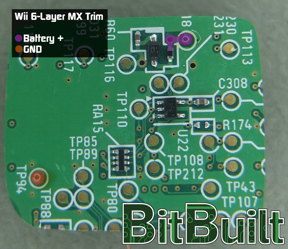

- Battery socket [optional, requires MX-Chip relocation]
The MX-Chip are can be trimmed a little bit smaller as on the 4-layer Wiis.
On the Battery socket we only need to make sure there is no short between ground and the battery positive voltage.
When trimming the parts from the mainboard, start with the Gamecube controller ports. Then the main part and in the end the MX & battery holder [if you want to rewire them]. As always trim outside of the marked area and sand/file it into shape afterwords. Make sure to not trim smaller then the official OM6 trim!
Reused parts
We will reuse a few parts from the Wii like:
- Cooling Fan
- Heatsink
Screws
You will need a few screws from your Wii's case:
- 4 short silver screws for the stand feet
- 4 short silver screws to close the case
- 2 short silver screws for the fan
- 2 long silver & 1 short silver screw for the Gamecube controller Ports
- 4 long black screws for the heatsink

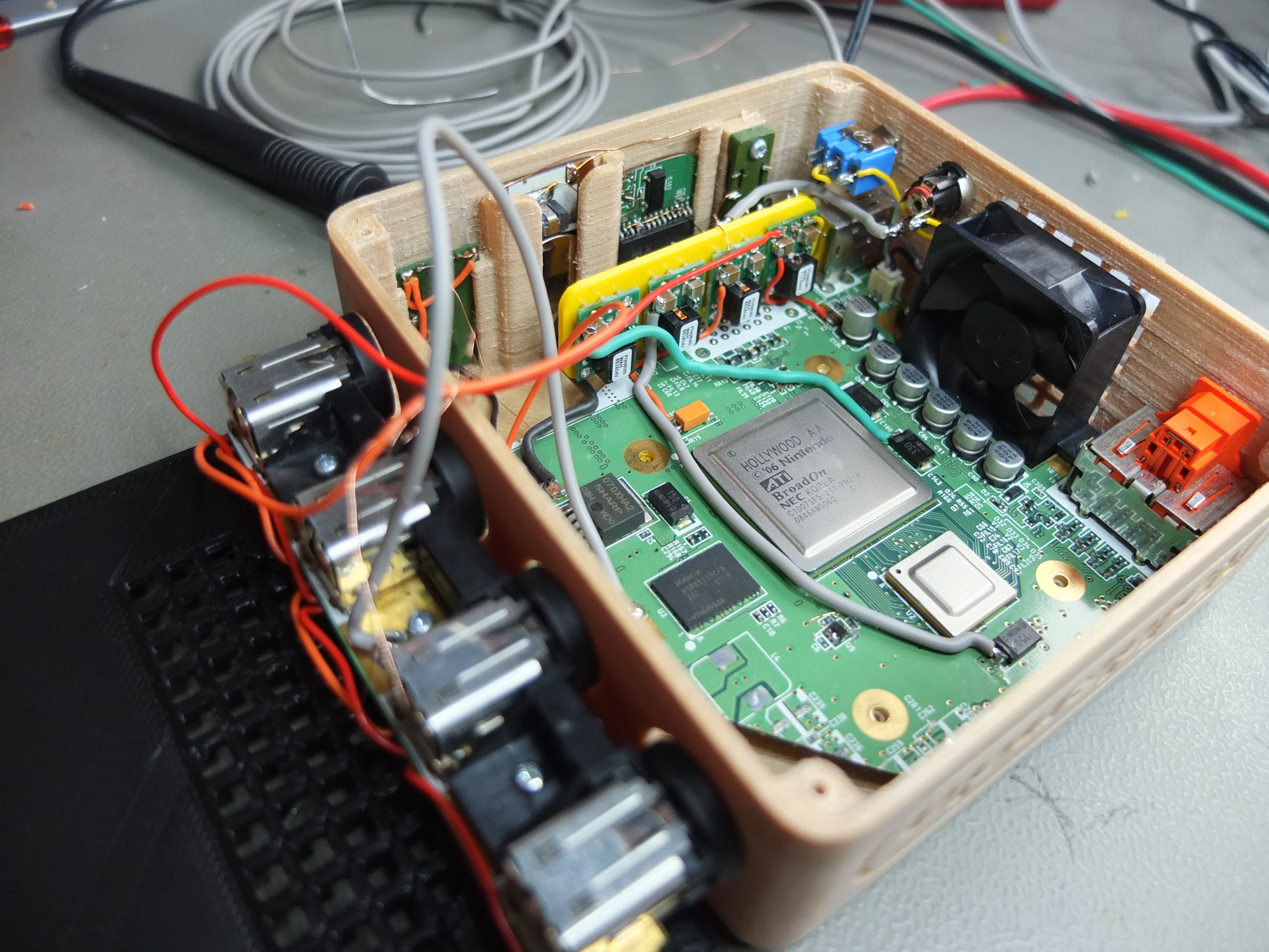

Relocations

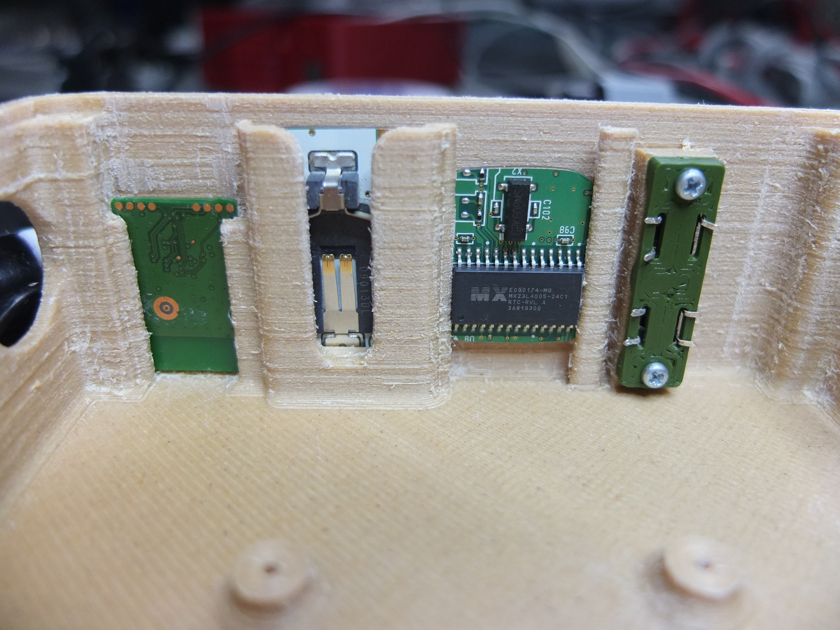

Bluetooth
Twist magnet wire very tightly using an electric drill. You will need about 10cm of twisted magnetwire. When the relocation doesn't work for you, your wire might not be twisted enough. In that case you still can shorten the wires and put the bluetooth module somewhere closer to the vias. It should fit under the trimmed mainboard, as the screw holders are of 4mm height.

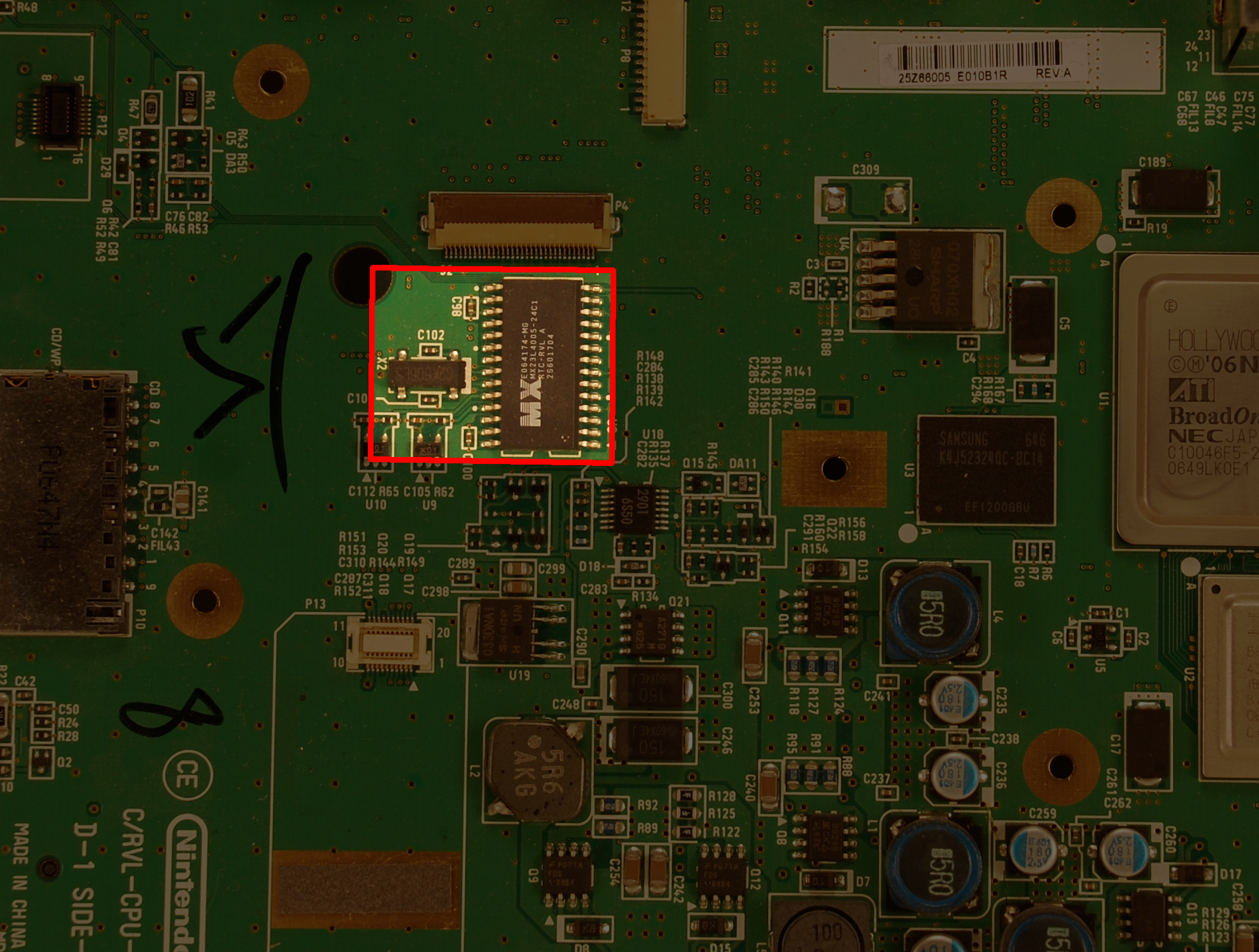

MX-Chip
I found out that without the MX-Chip, that the wavebird controller won't work statisfying, so this relocation is highly recommended. Use Magnetwire of about 6cm length for the four data lines. Stranded for voltage and ground. Same for the RTC battery.

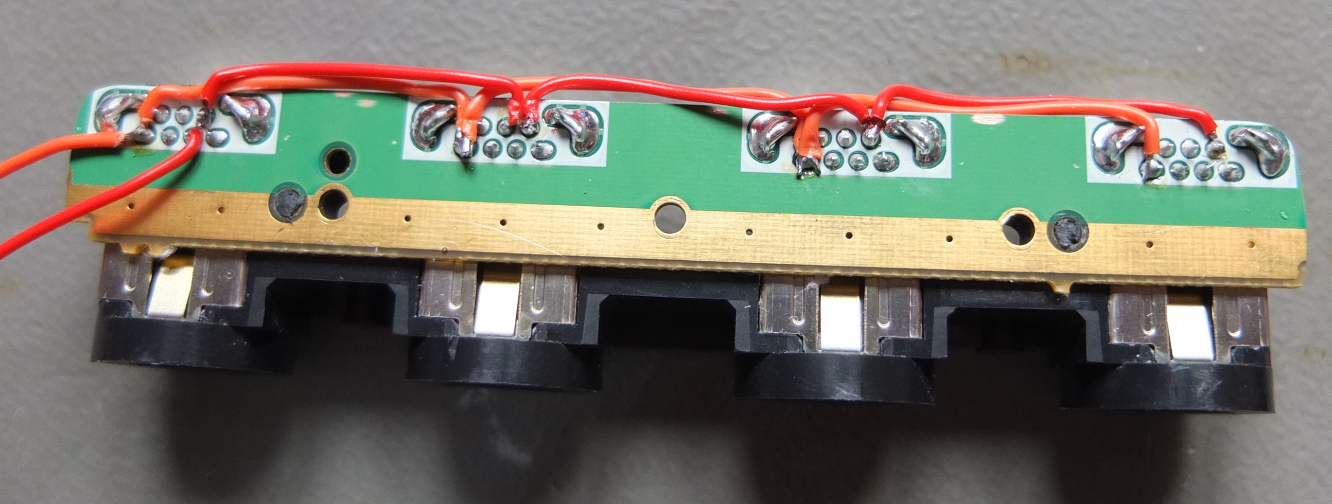

Controller Ports
First cut off the black plastic pins on the bottom of the PCB. You might even want to sand them down, to make the PCB sit flat on the holder.
For the controller ports to work we need to wire up 3.3v to all jacks. I used stranded wire and made small jumper wires of about 4cm length to daisy chain the ports. Watch out that the wire don't get in the way of the screwholes.
Ground can be connected to any pad connected to ground. I simply used a thick stranded wire and soldered it to the middle of the PCB.
Use magnet wire for the data lines. The data wires should be about 20cm long.
Use two long silver screws to secure the PCB on the bottom part. In the middle of the PCB you can use a short silver screw.
Optional: If you want rumble support you will also need to wire up 5v to every port just like you did for 3.3v.

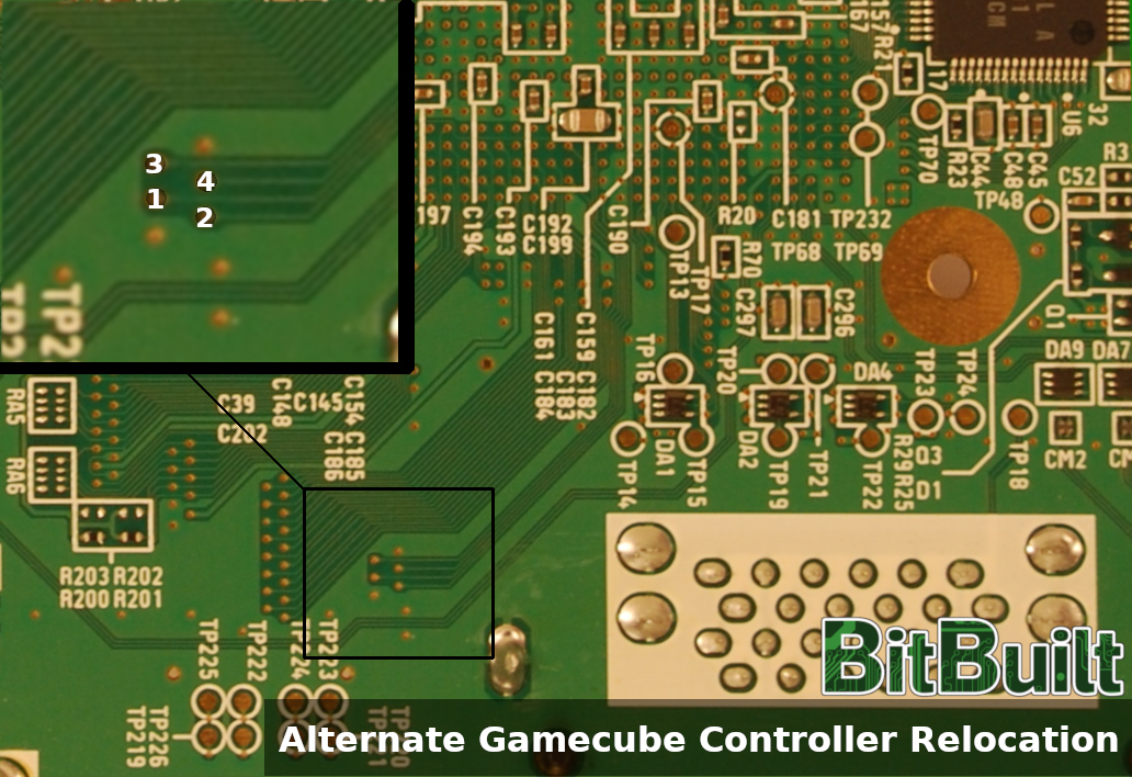

Here are some alternate relocation spots that i used, since they are further to the front & quite convenient:
Assembly
- Screw the feet to the bottom part using four small silver screws

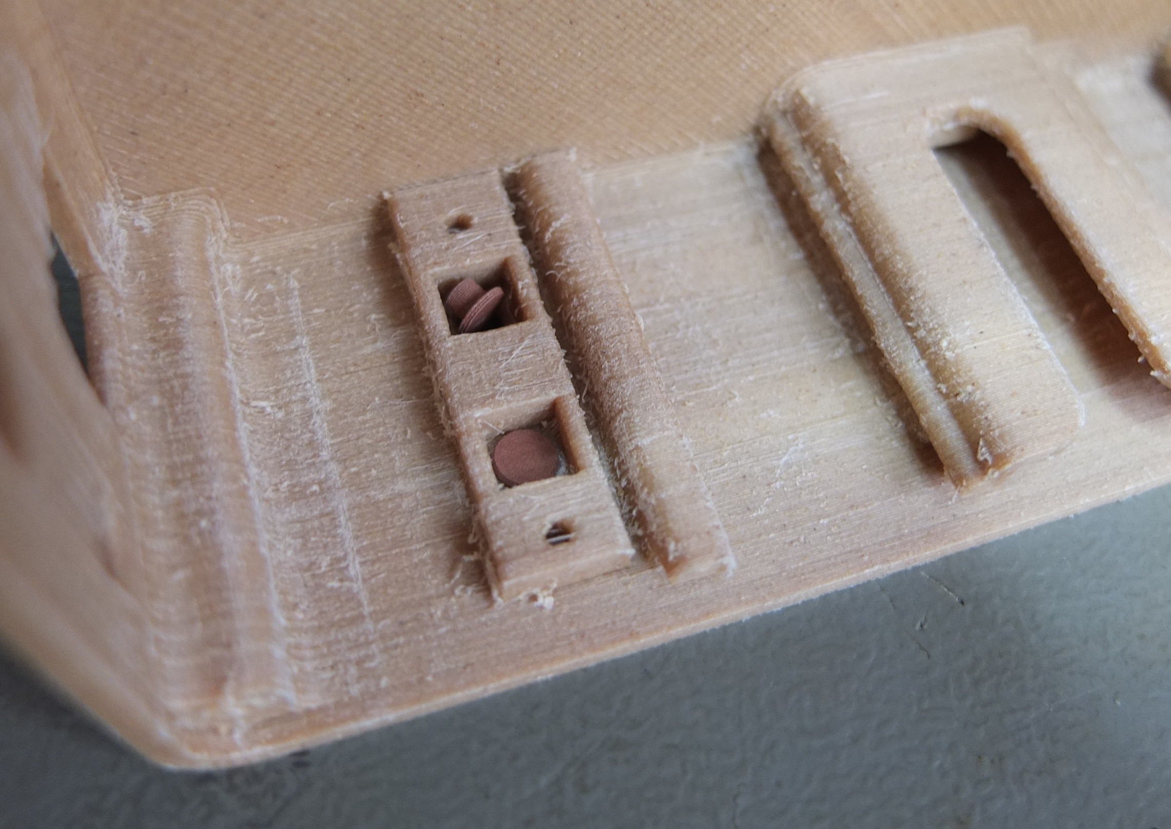

- Put the tact buttons into the bracked, secure them by bending the legs to the side and screw it in place using two short silver screws before inserting the mainboard
- Test every relocation one by one.

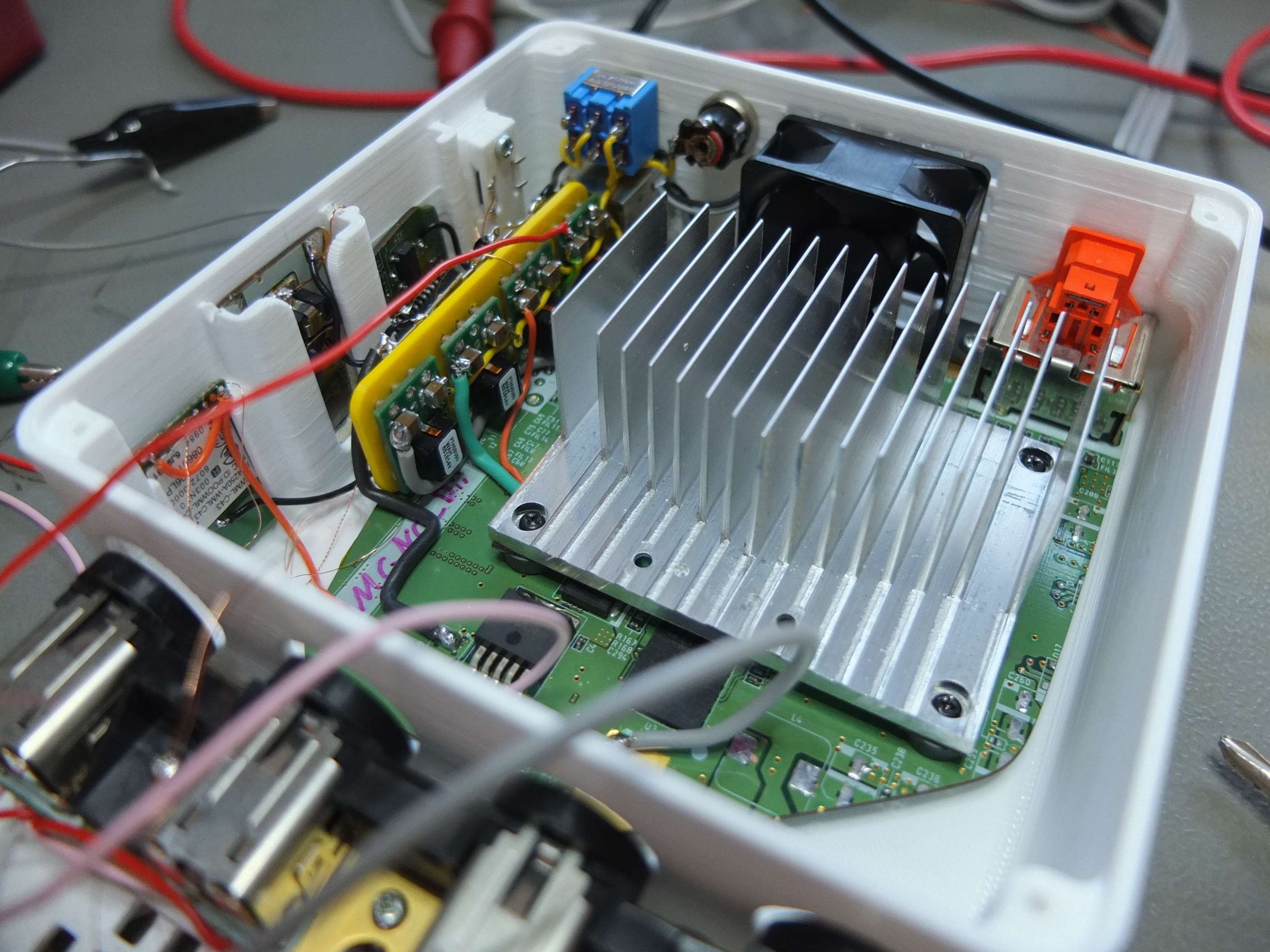

The case has a few holders for the Bluetooth board, RTC battery and MX-Chip.
In the end it should look something like this:
View attachment 13756 View attachment 13757

13.9.2020: Added alternate GCC relocation vias
