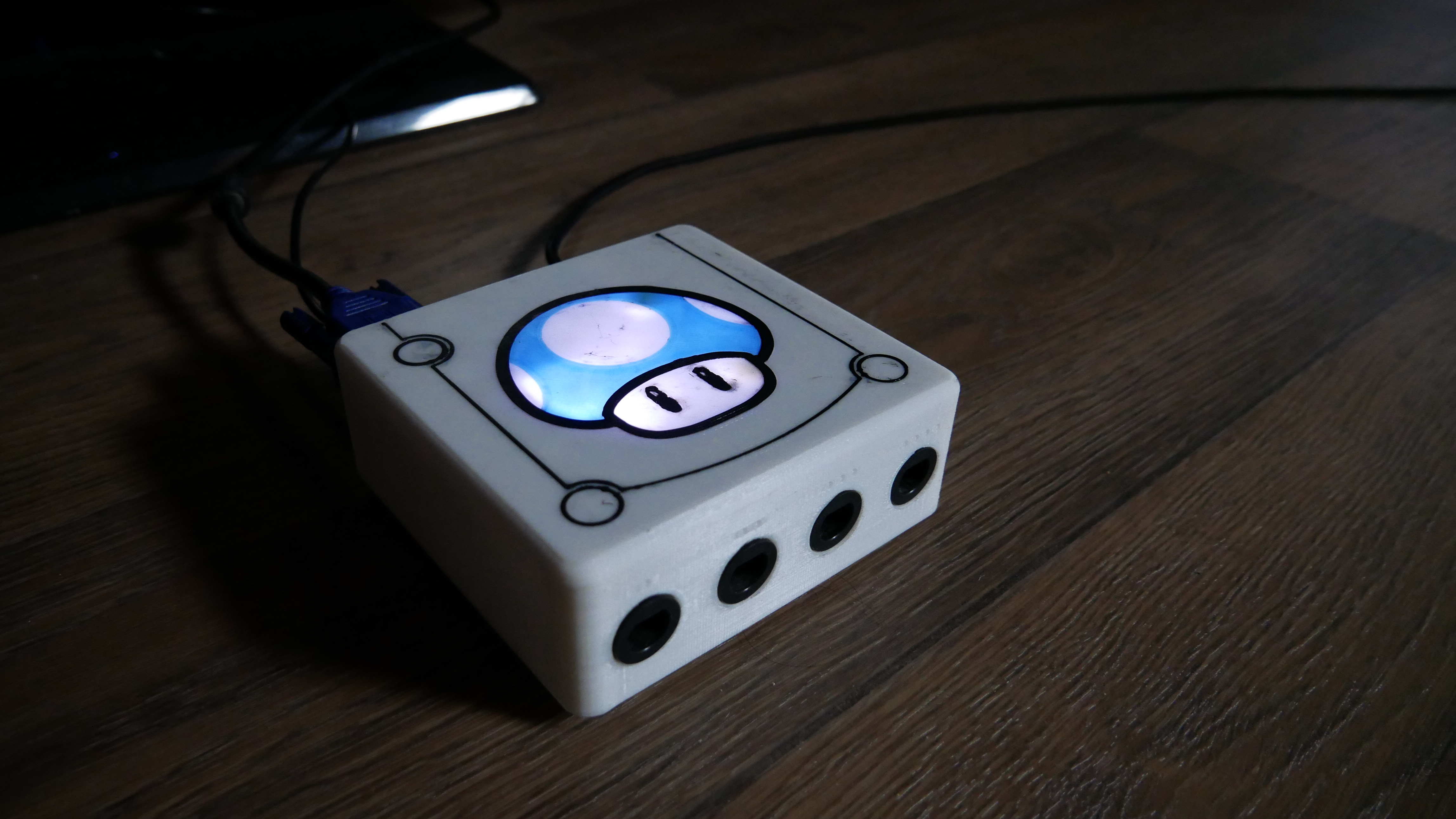

And I thought it would be a good idea to make a "pro" or "deluxe" version, which would improve/change a few things.
The goal is also not to complicate the project too much, there will only be a need for two or three more components.
The mains advantages are :
- Better video quality
- can be use with any 5V or PD charger instead of the big Wii power supply, nice if you don't have one.
- you can better see if the Wii is on with the illuminated button
- you can connect headphones to the audio jack or hi-fi speakers

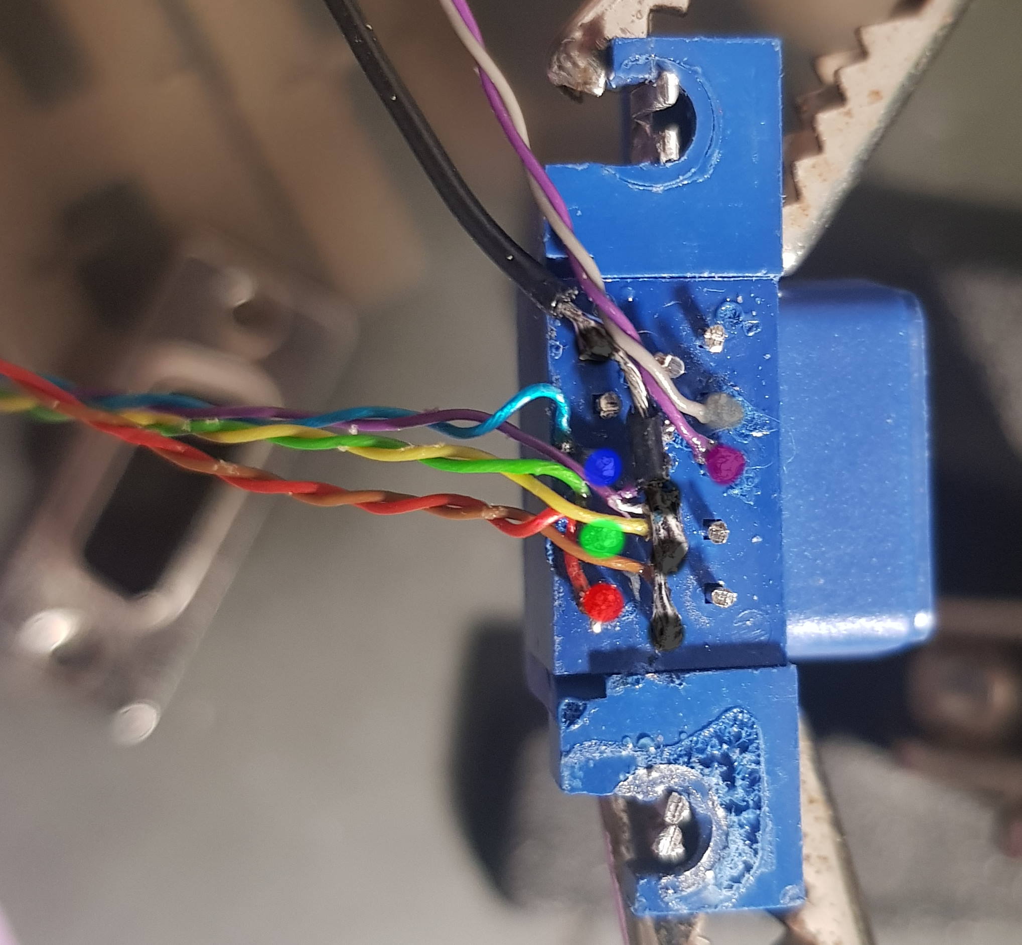

- The VGA connector improve a lot the video quality, to solder it you require to :
1 - enable the VGA in RVloader
2 - Connect some wires between the connector and the Wii Motherboard

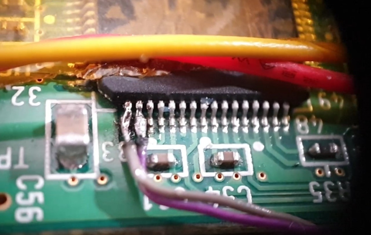

H-Sync in grey, V-Sync in Purple
You also need to connect these two wire to the AVE chip, like the picture.

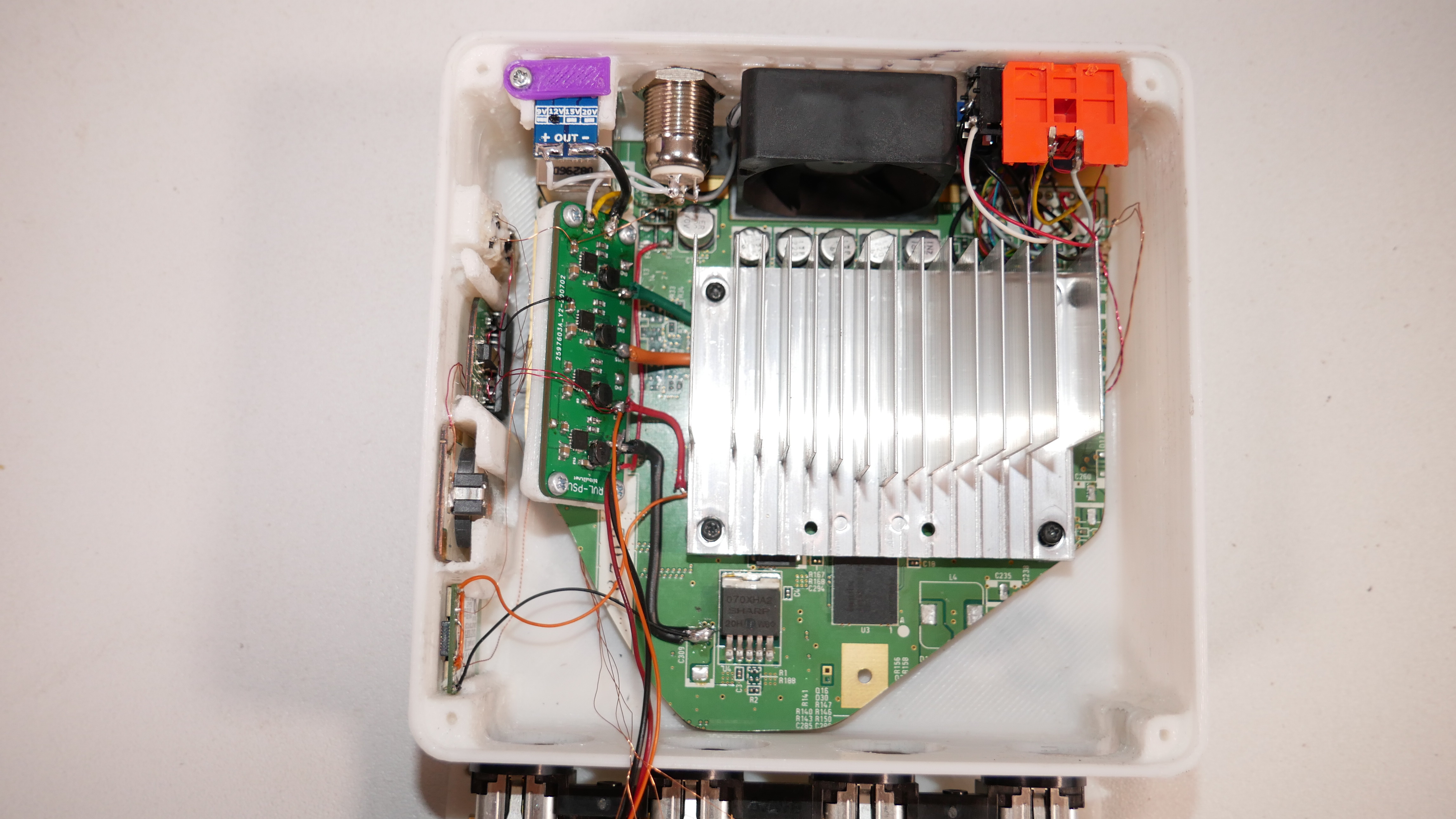

- I made a support for the RVL PSU, I put an angle like that it's much easier to solder the wires.
And some holes for better heat dissipation :
- Added USB-C PD module
- Added 3.5 mm audio Jack
- Added Power Button
- Added Sensor bar connector mount : require to be disassembled of the original video out connector and as the plug is upside down, do not forget to connect the polarity correctly.

Very nice work my dude! I like the illuminated shroom
