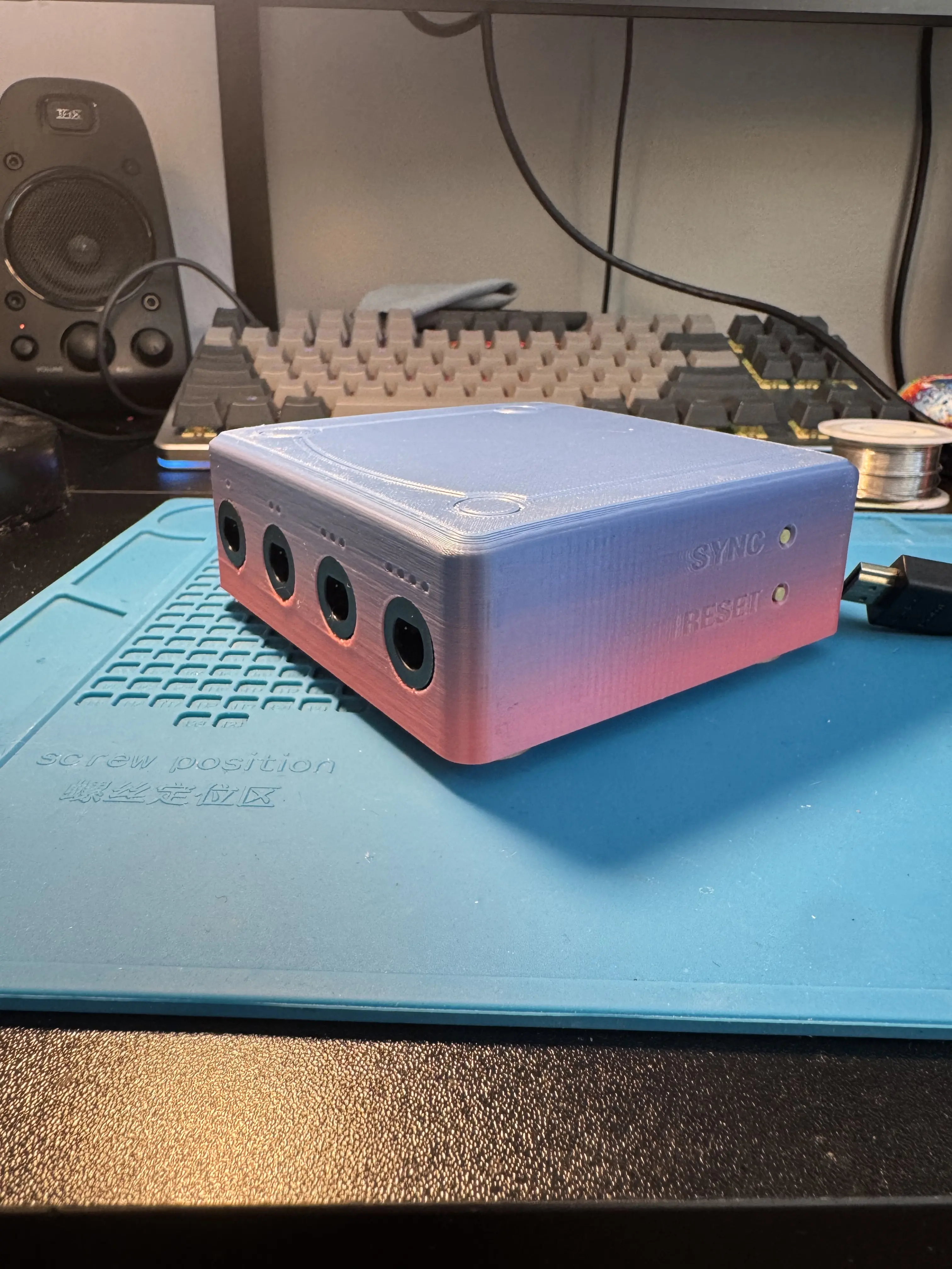

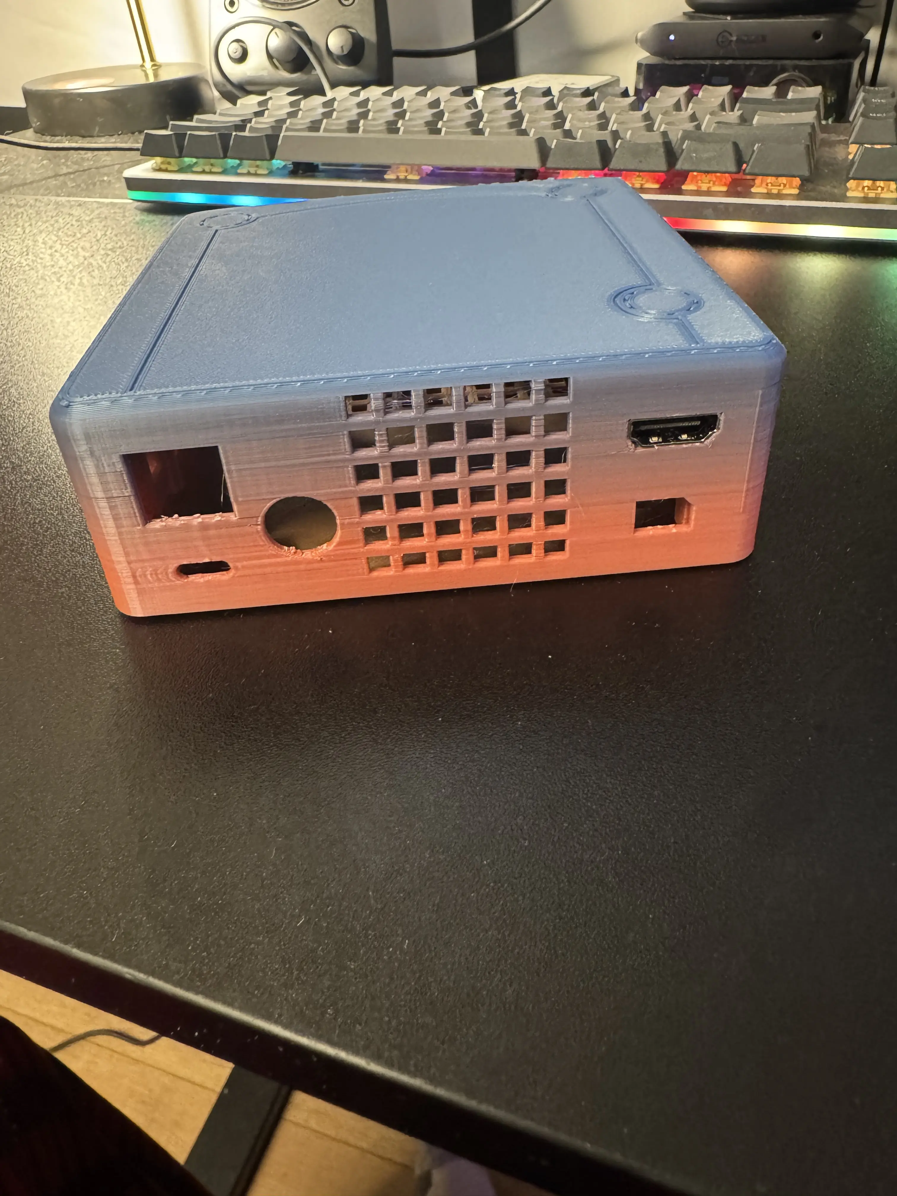

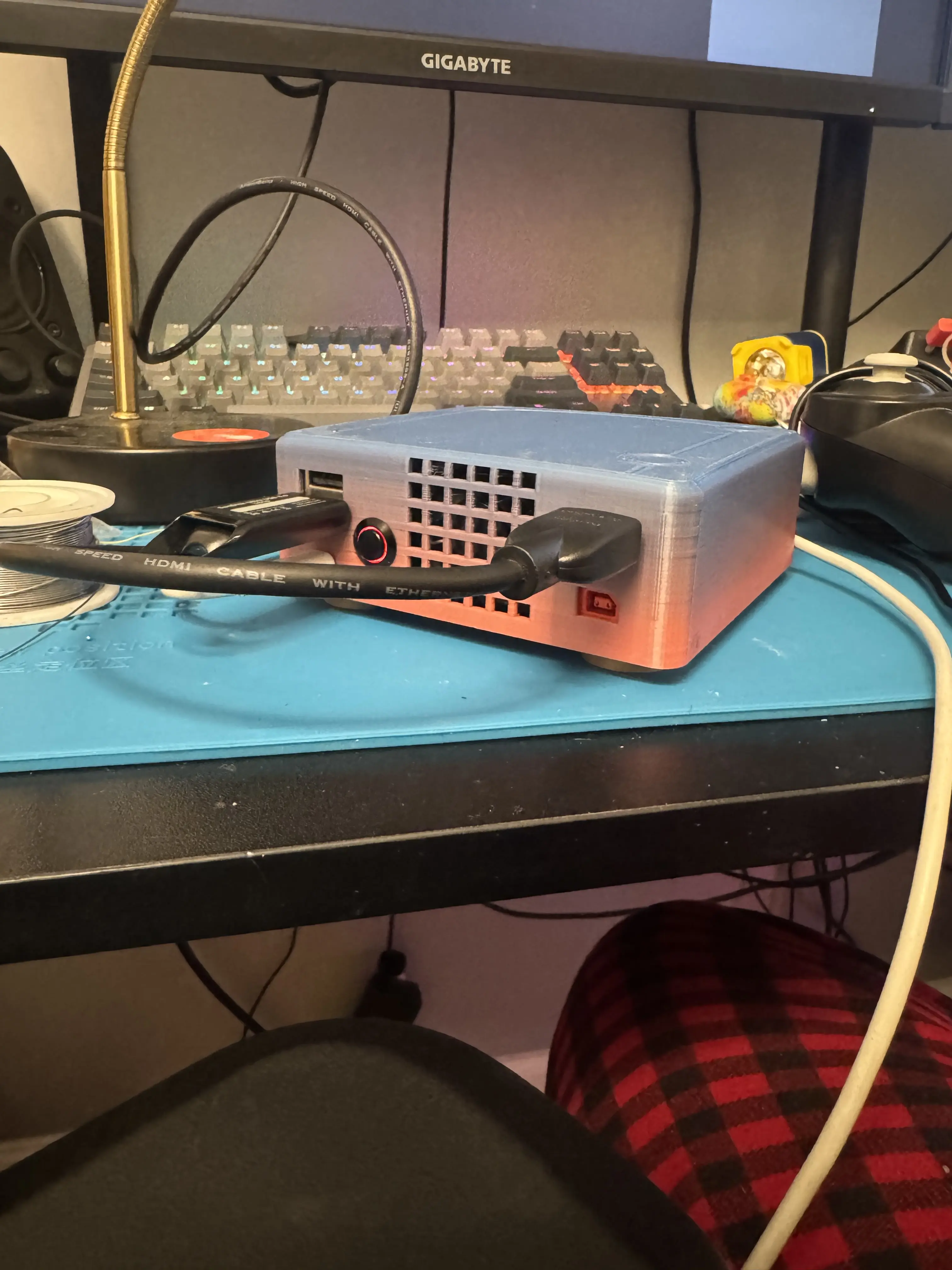

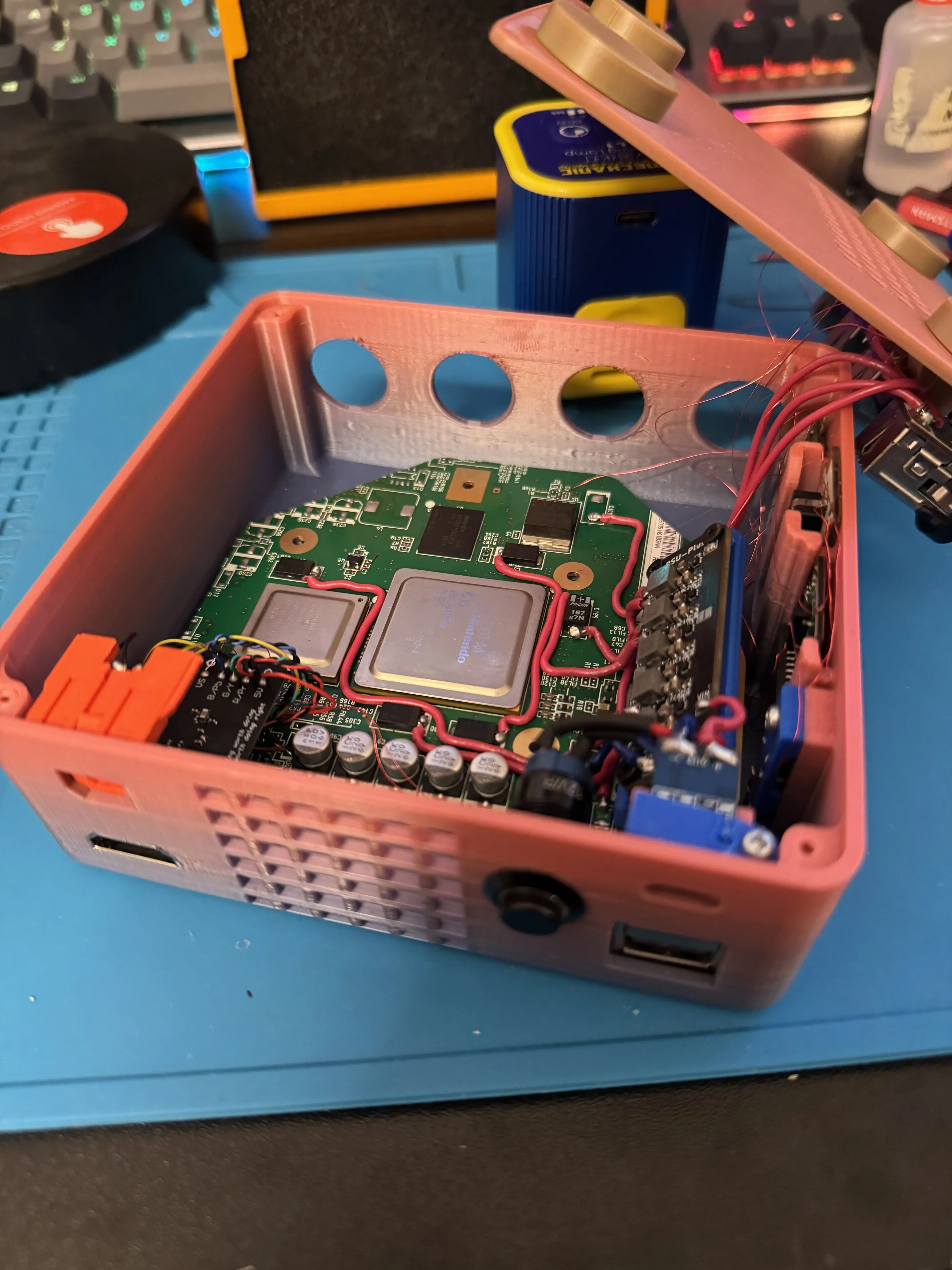

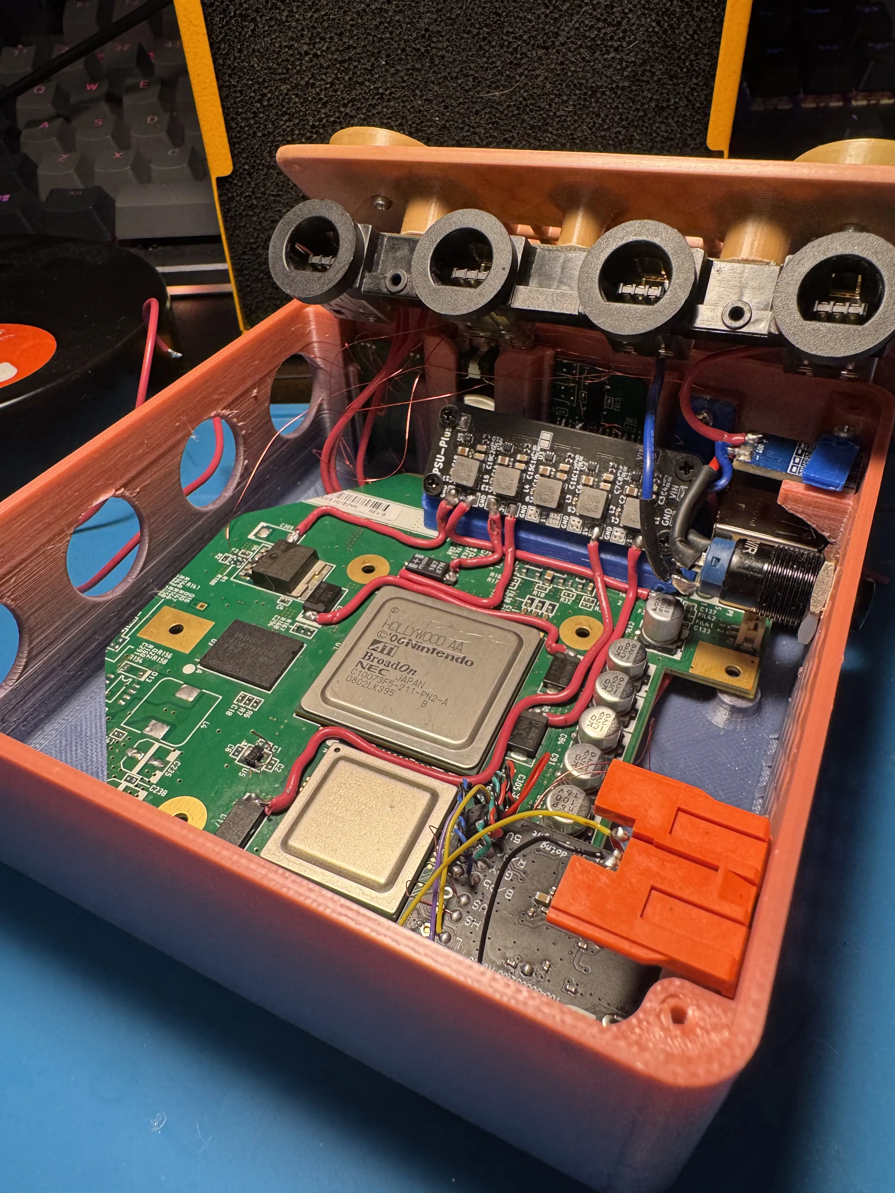

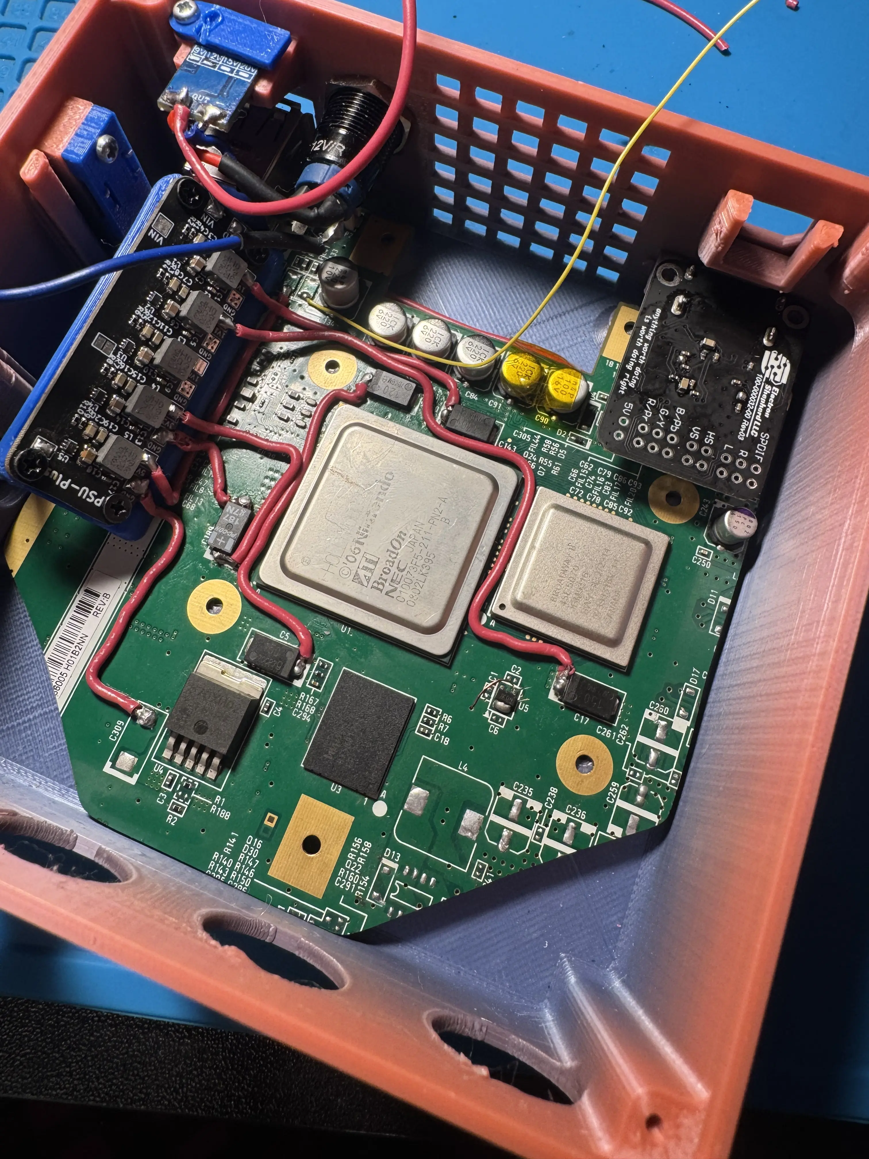

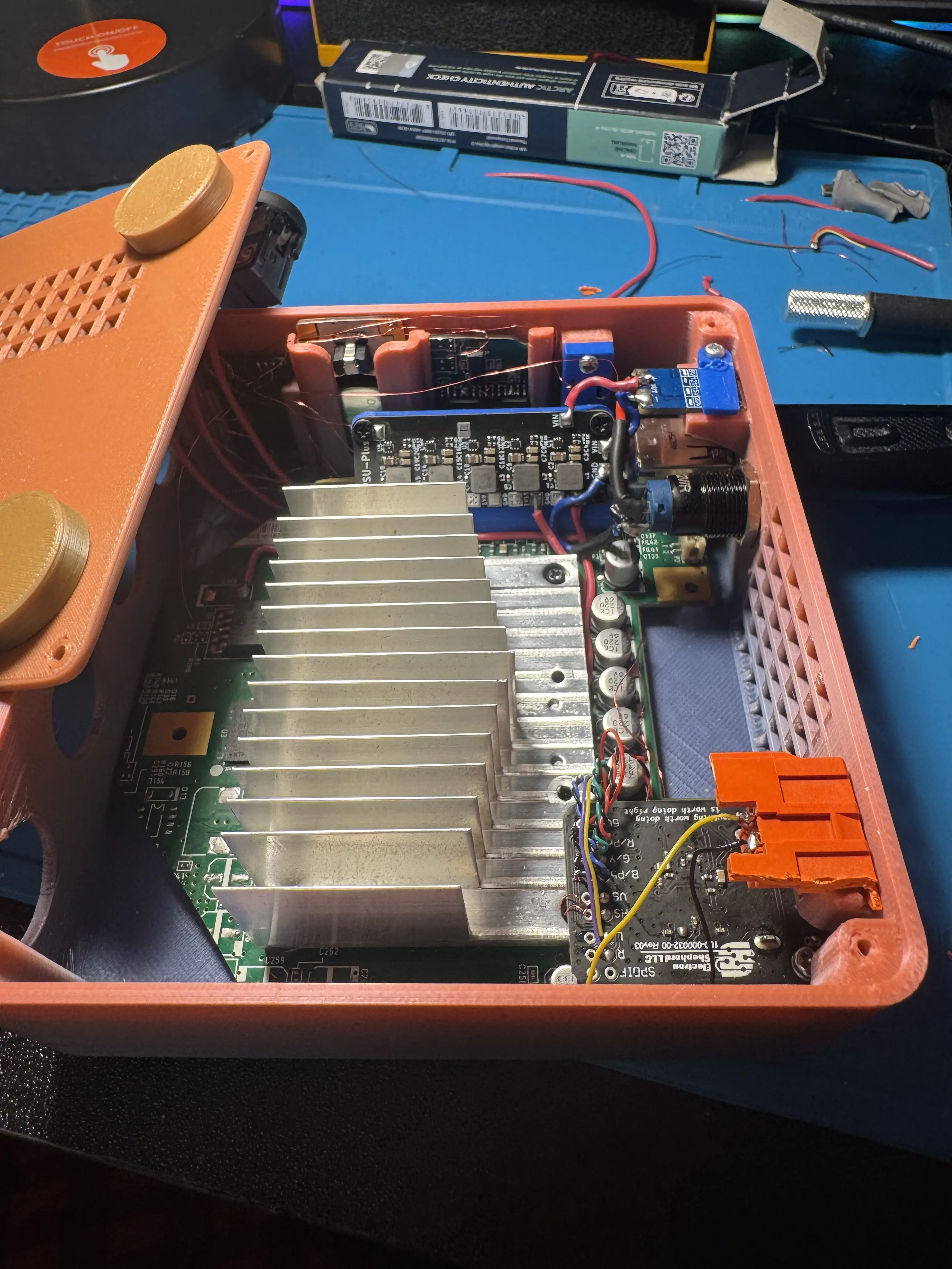

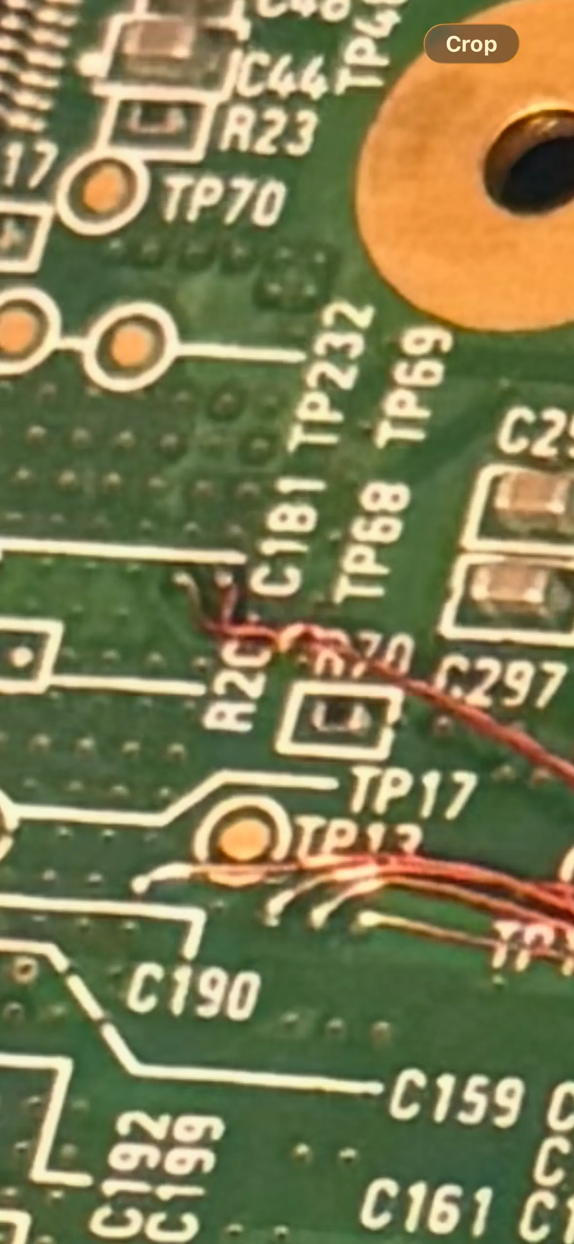

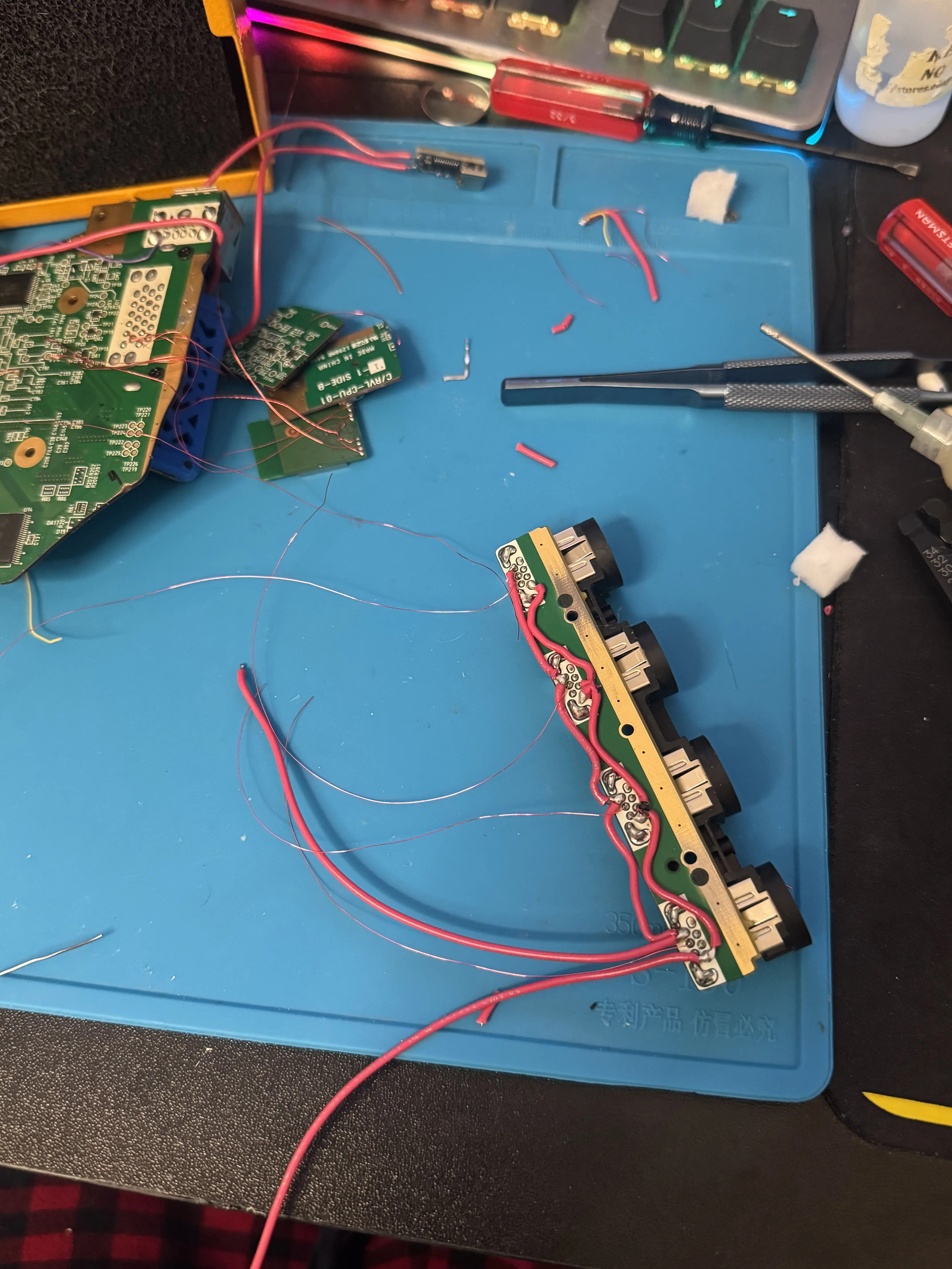

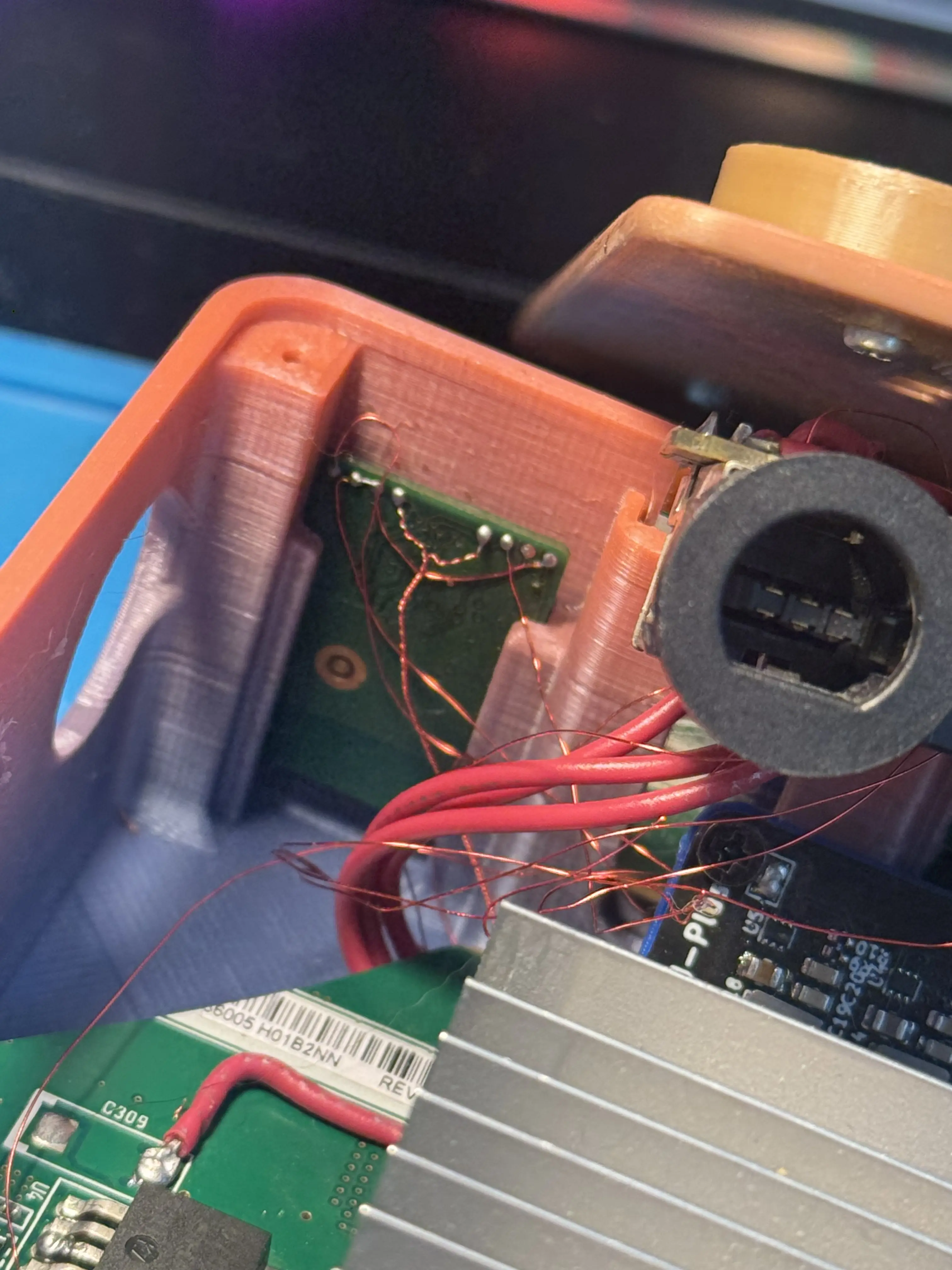

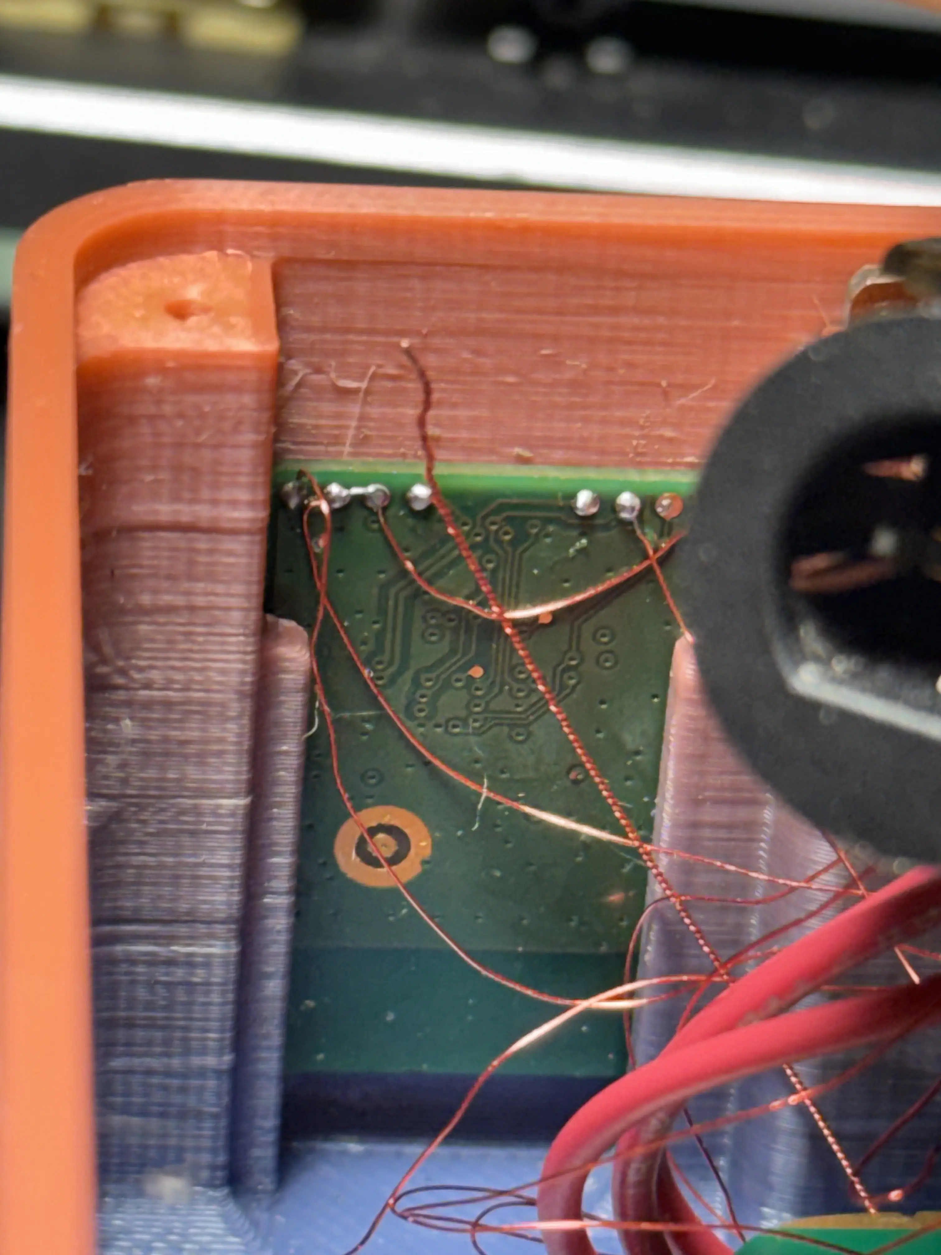

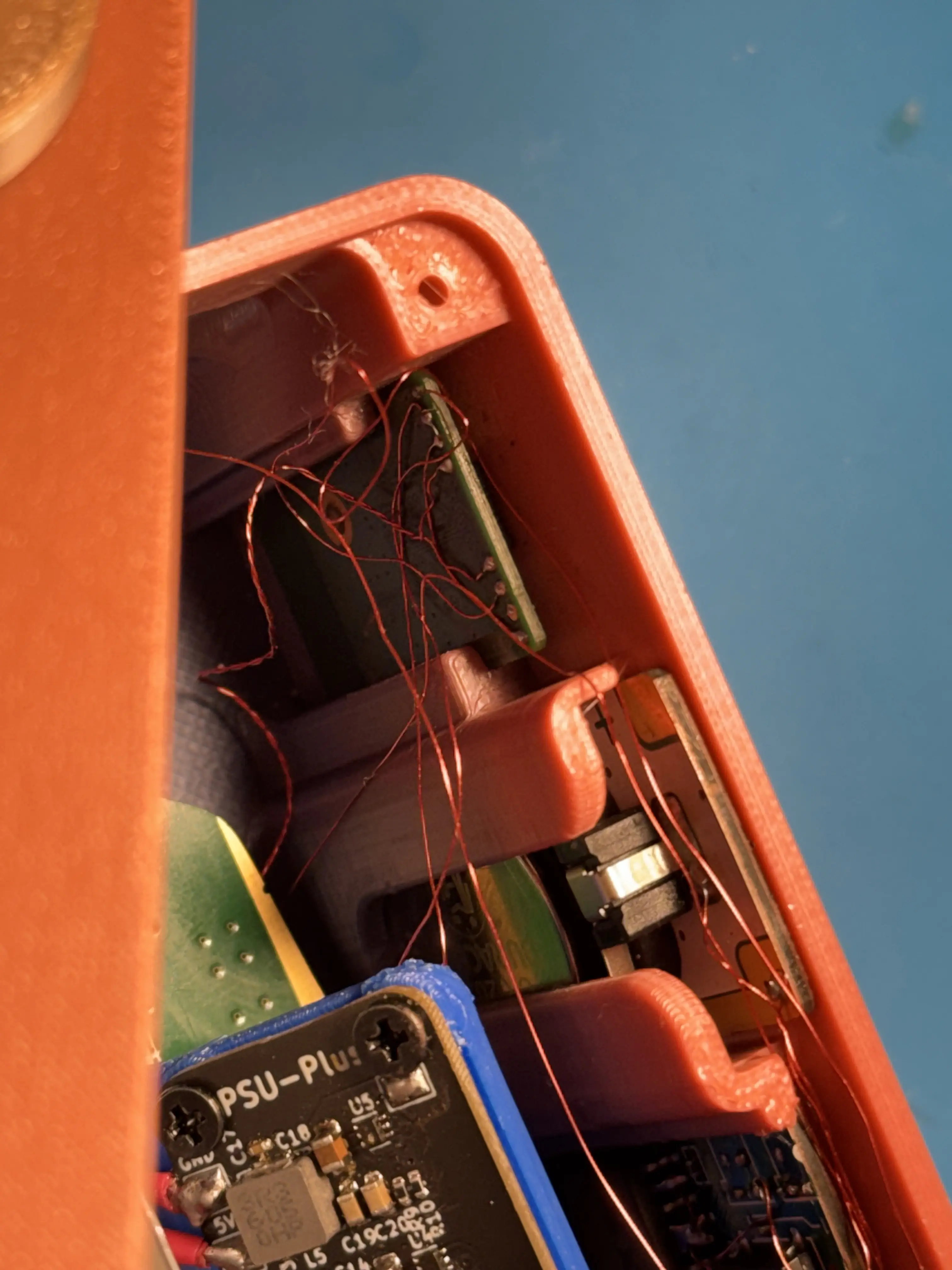

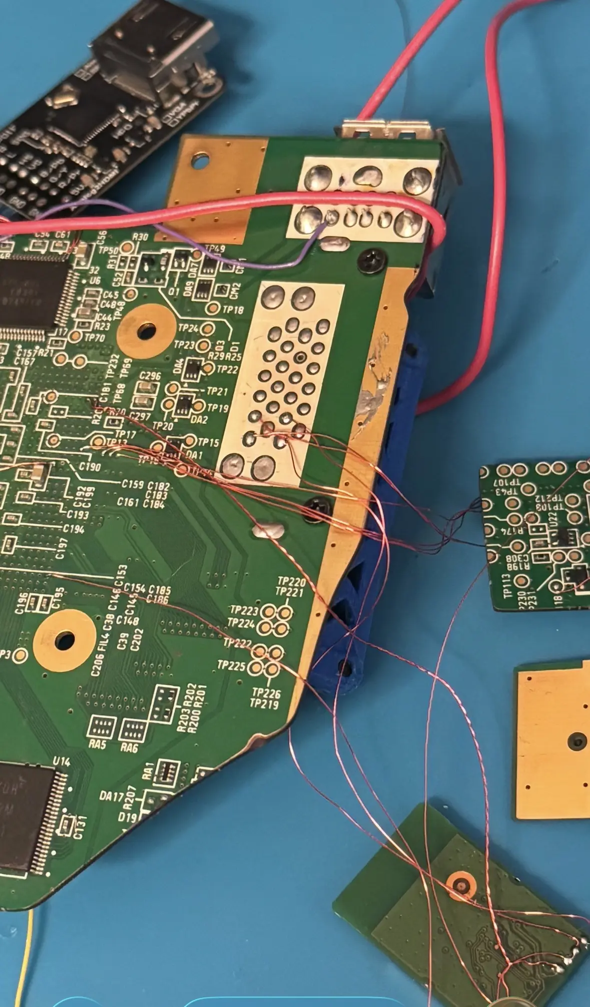

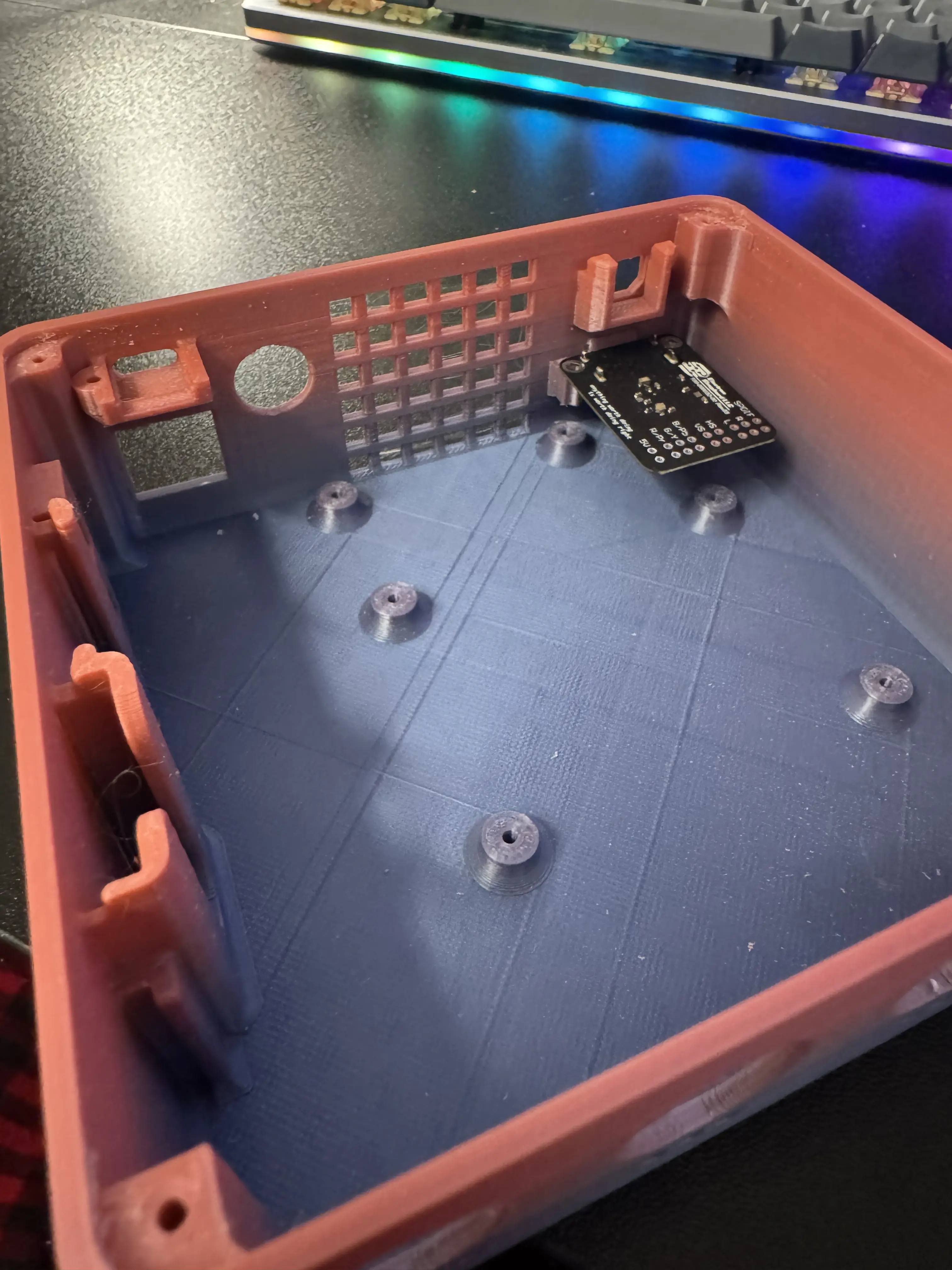

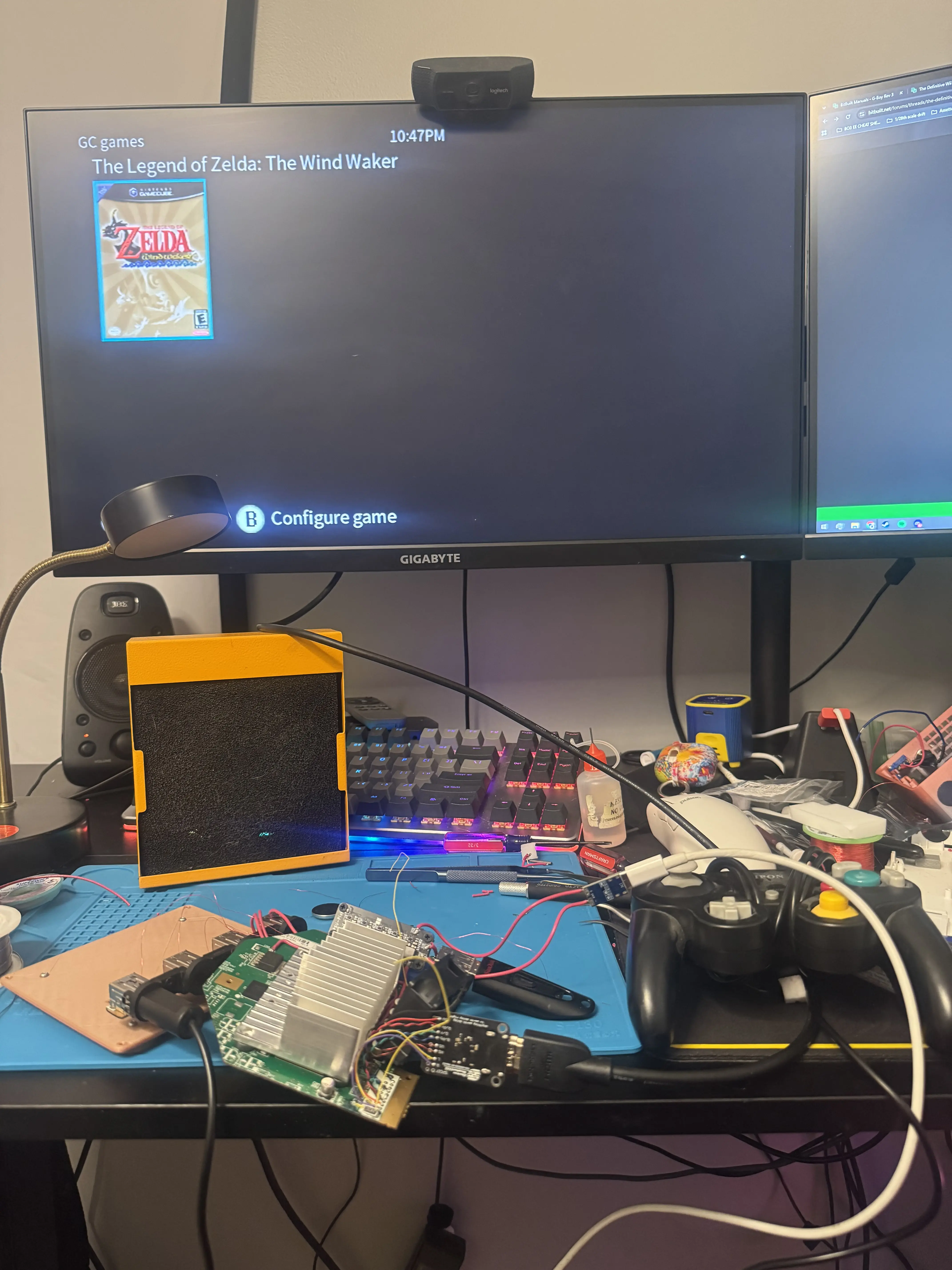

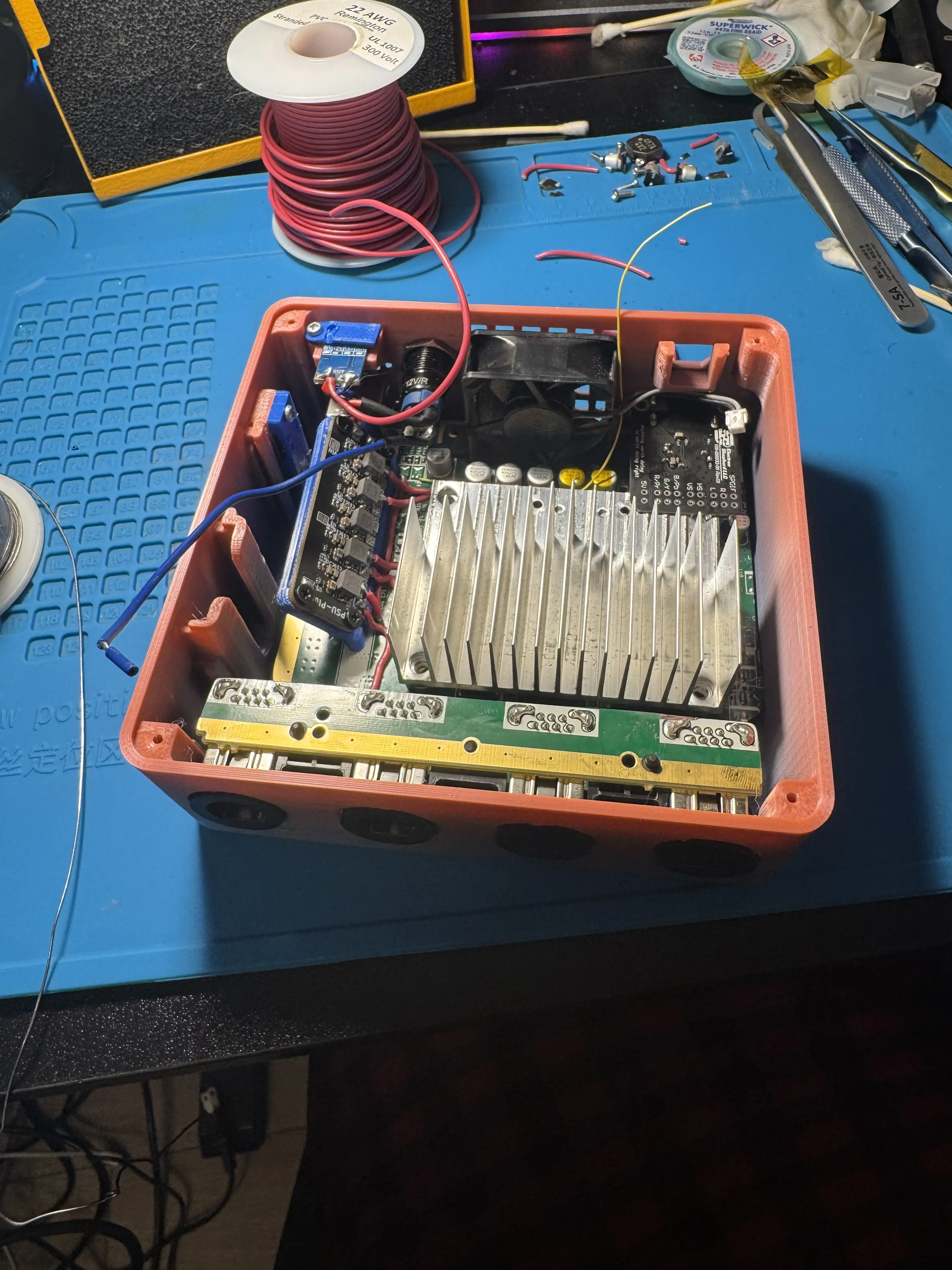

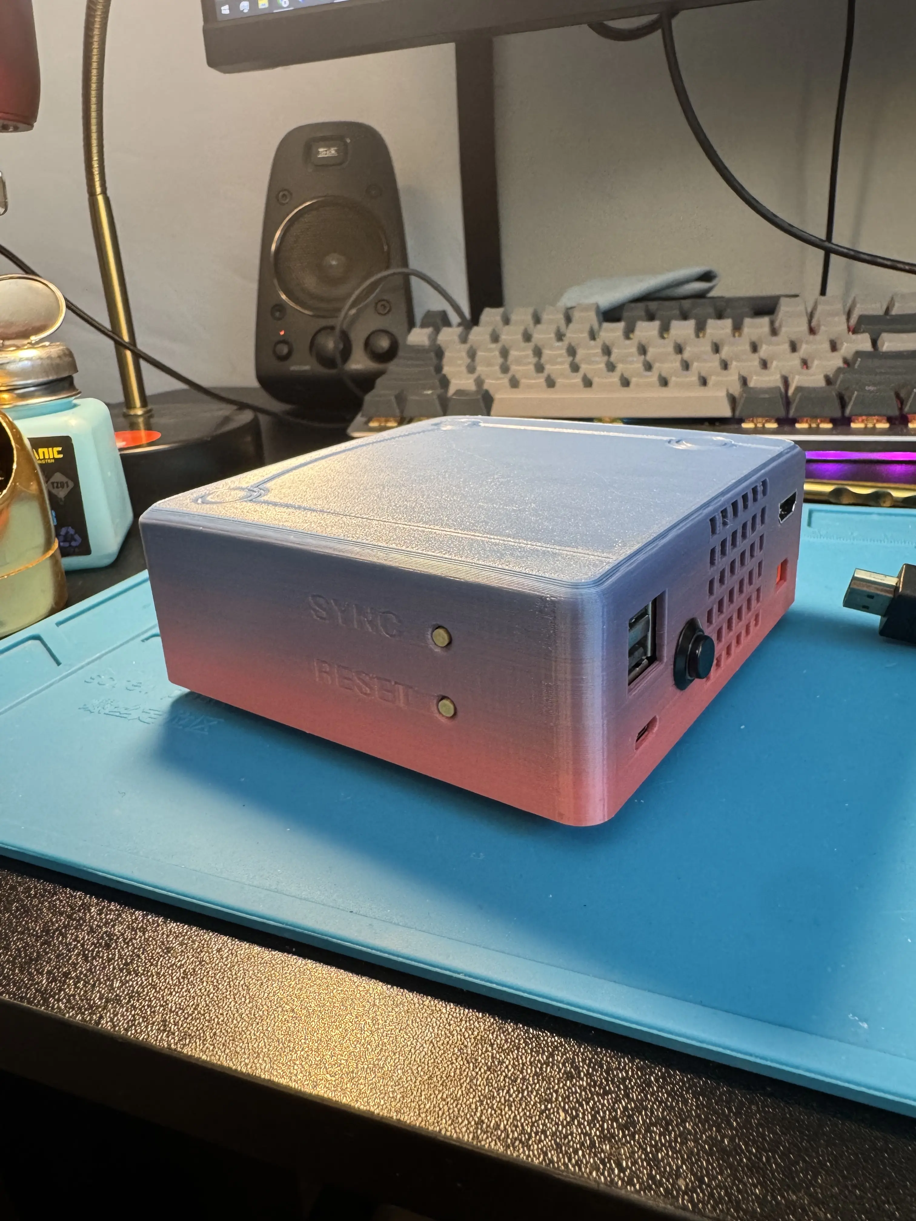

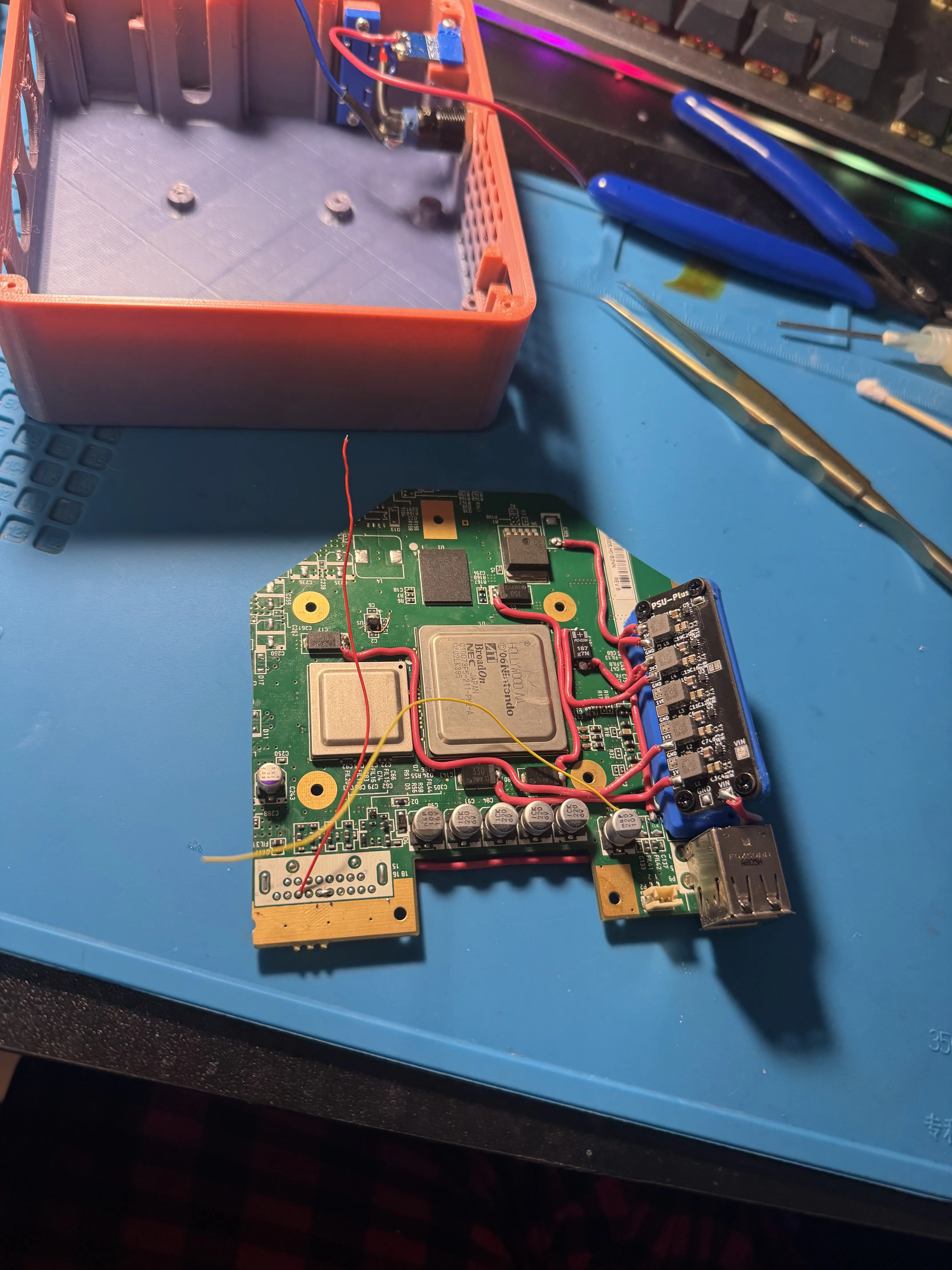

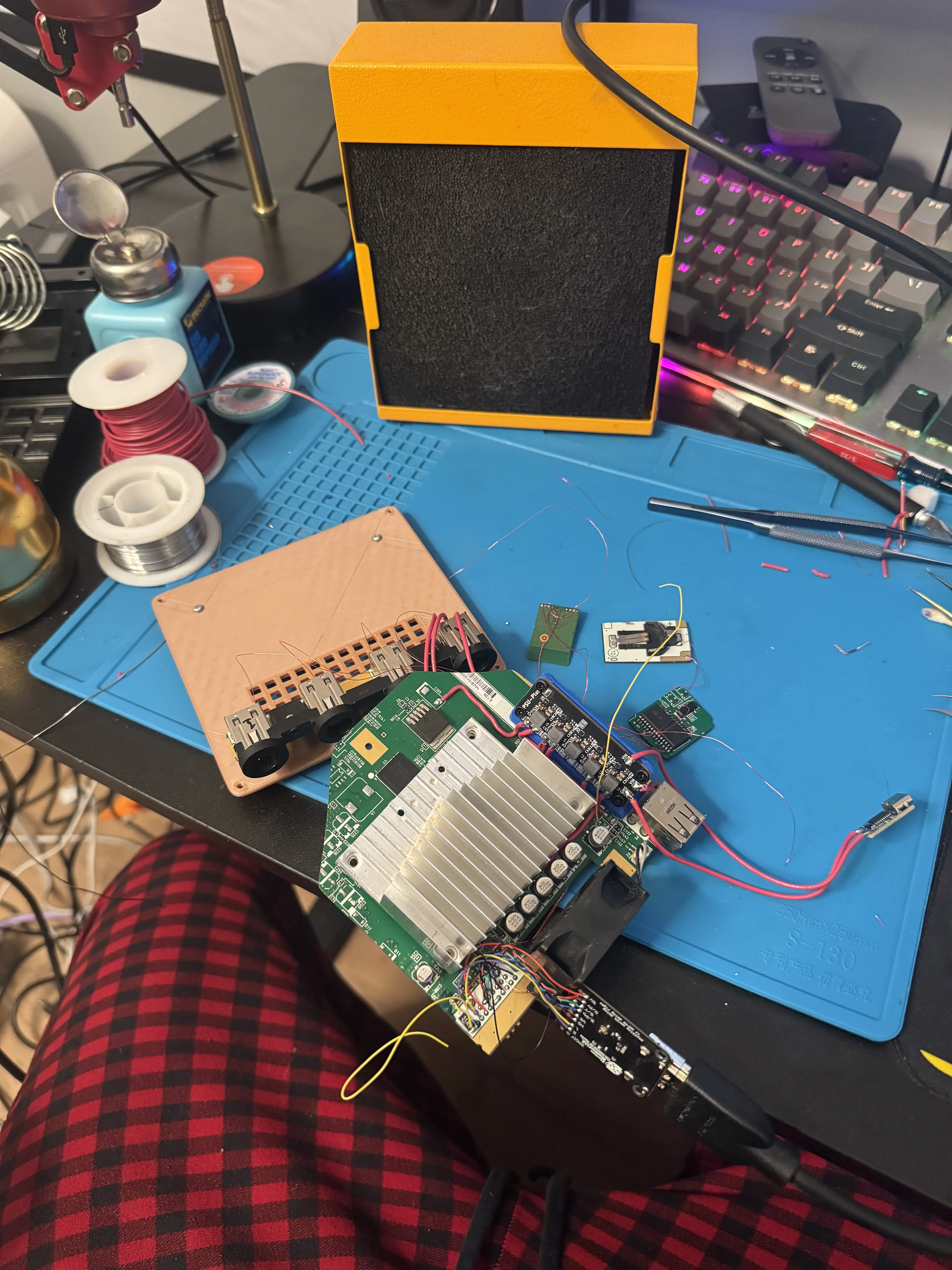

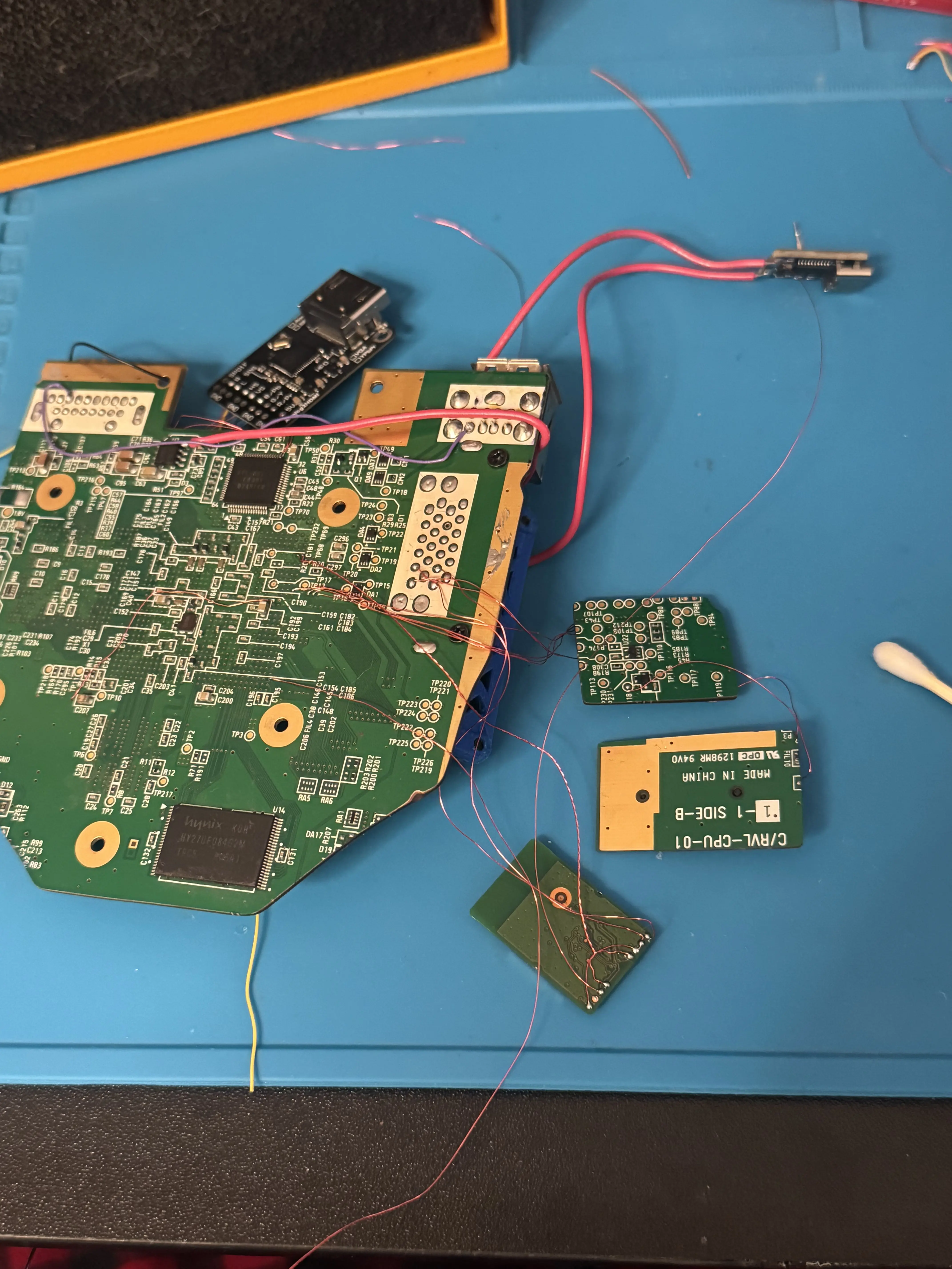

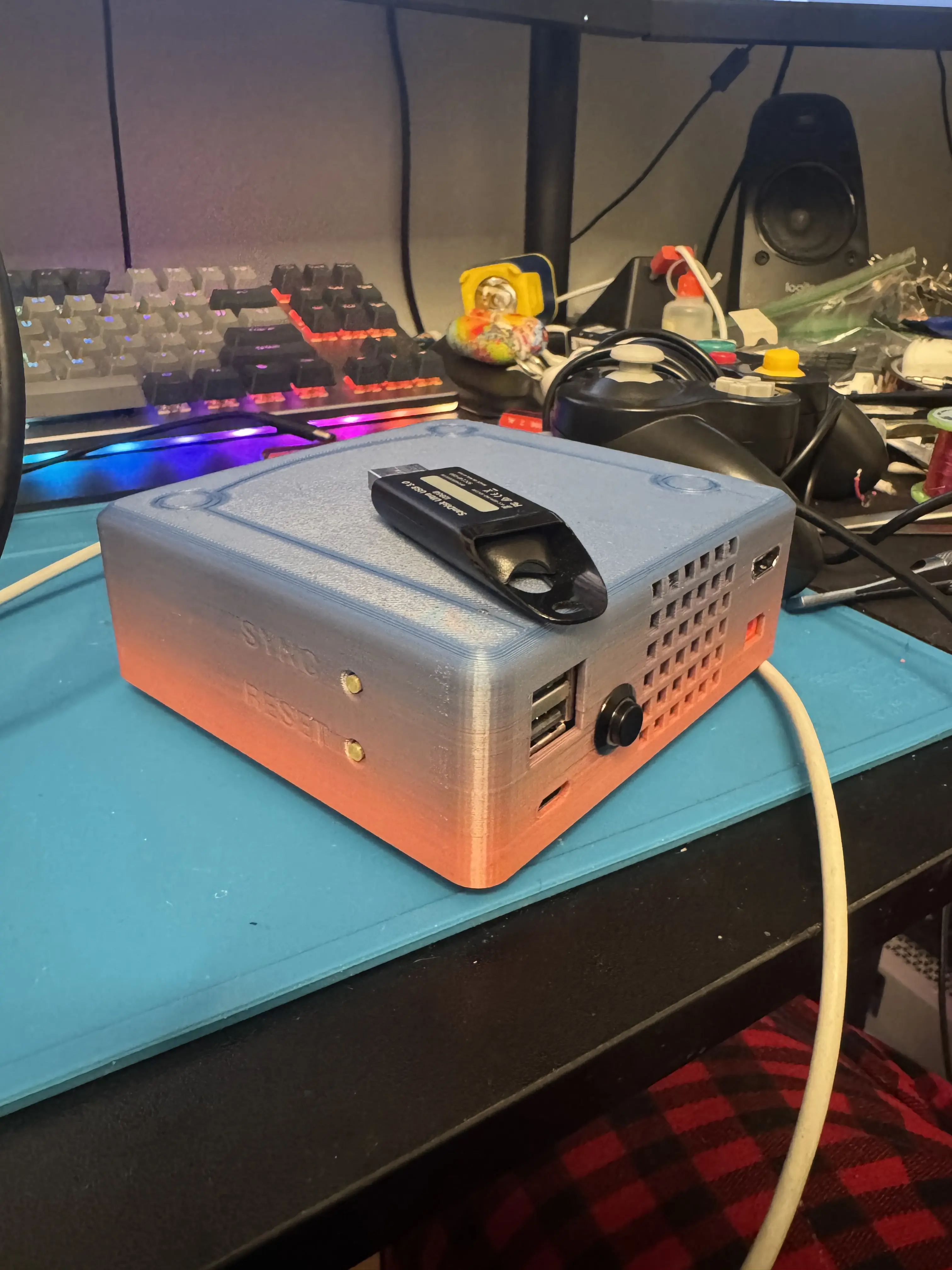

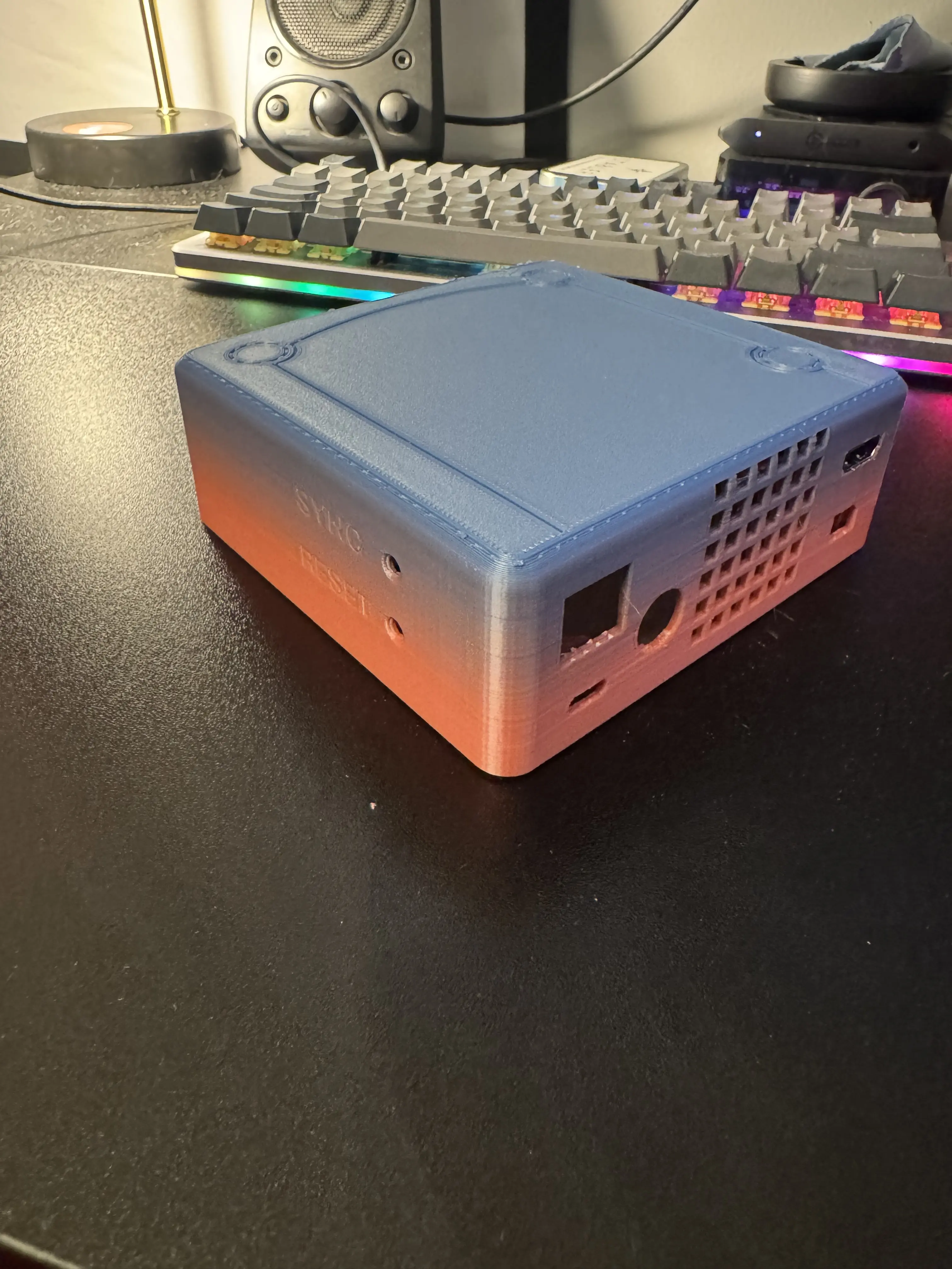

Decided to finally come back and try and do some more projects. Going to be rebuilding my G-Wii soon (that I disassembled fully many years ago bc I was having issues lol).

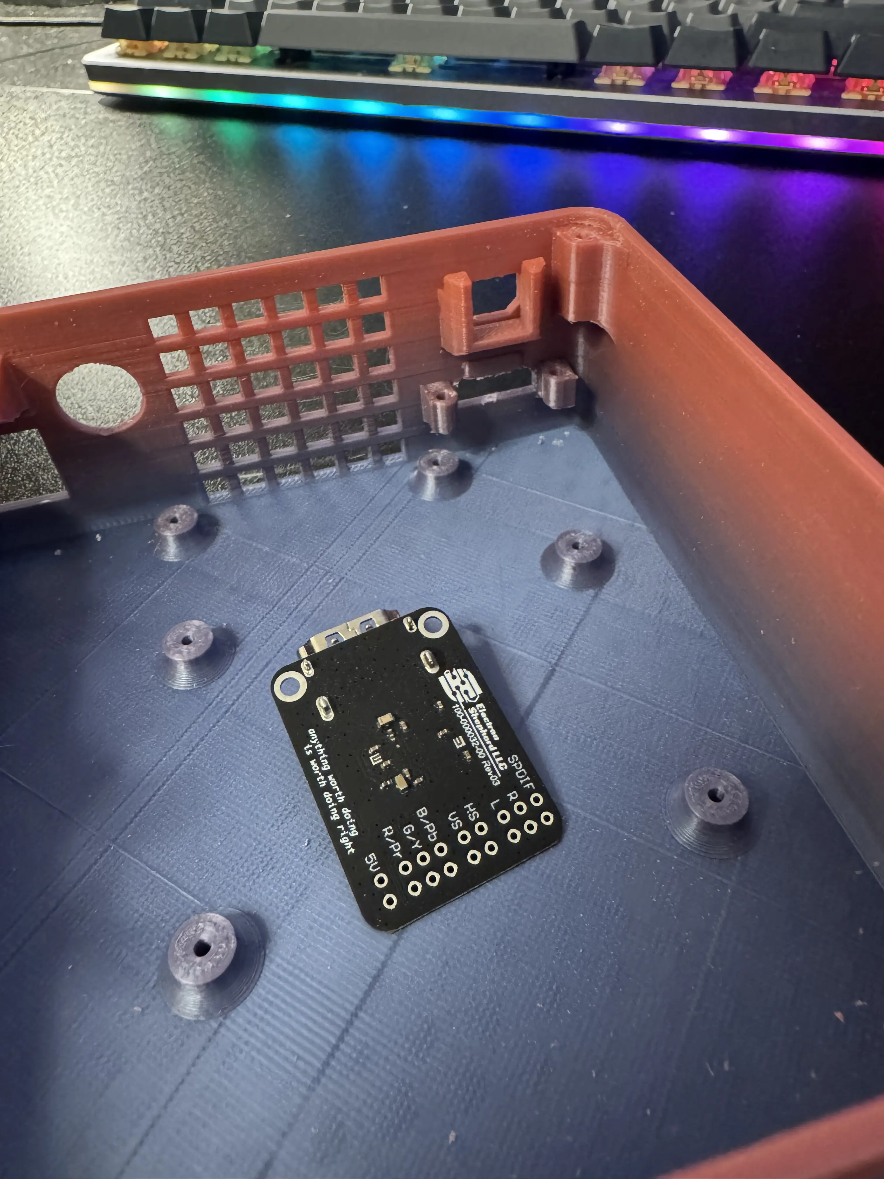

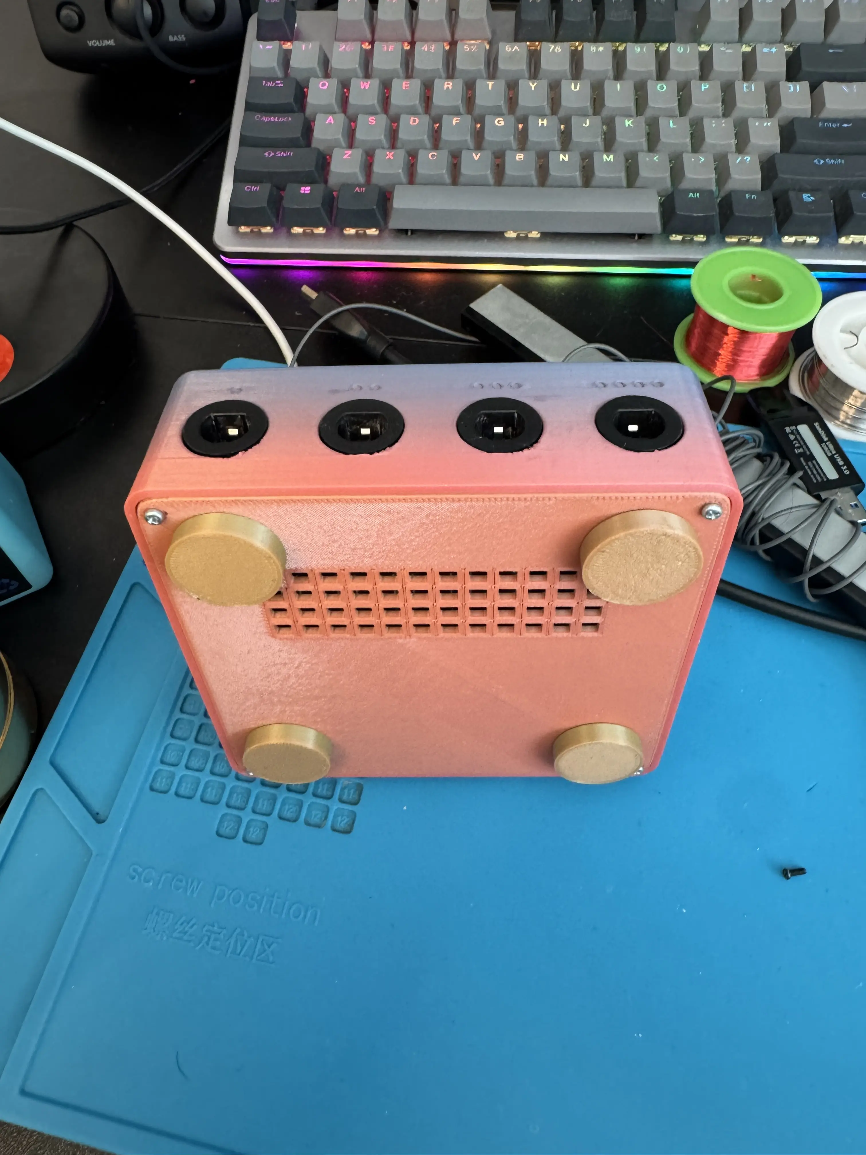

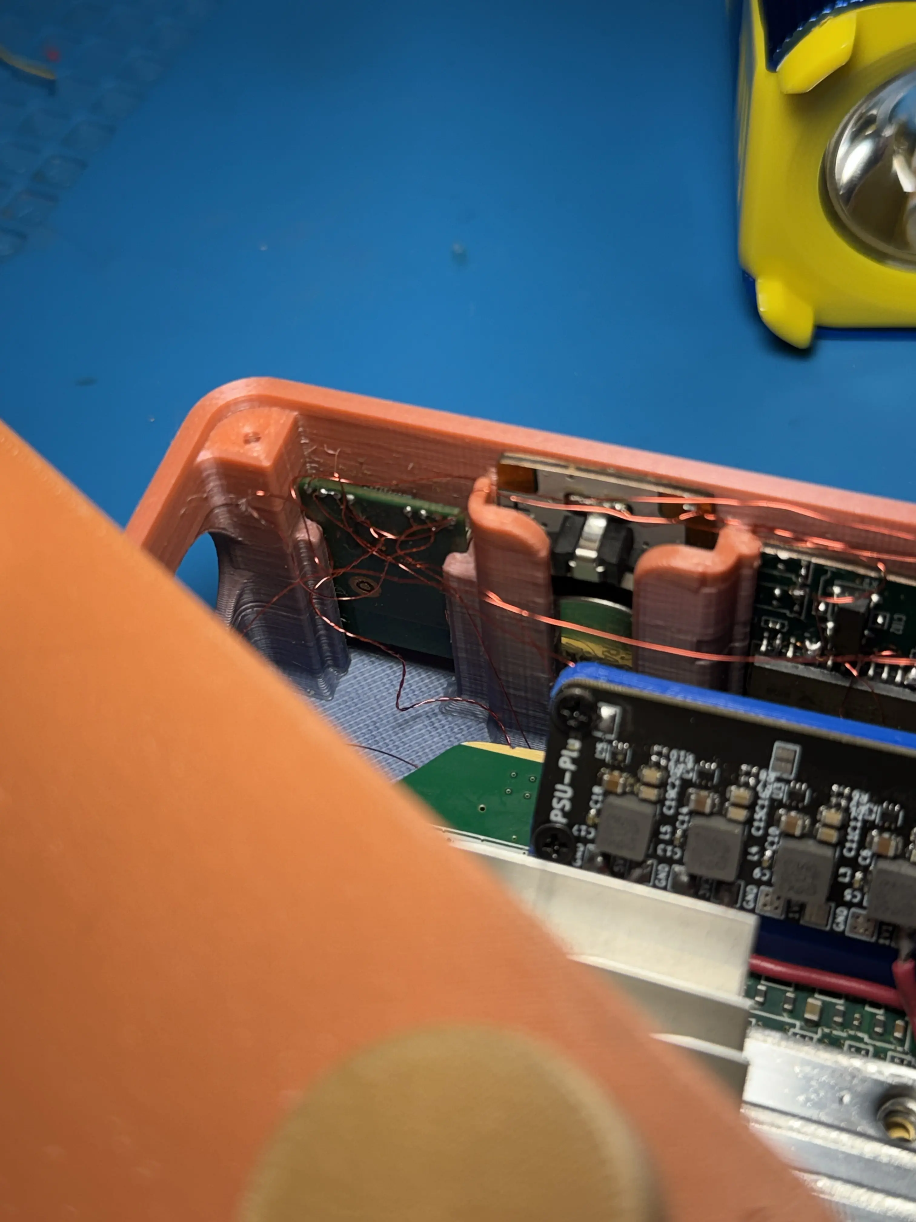

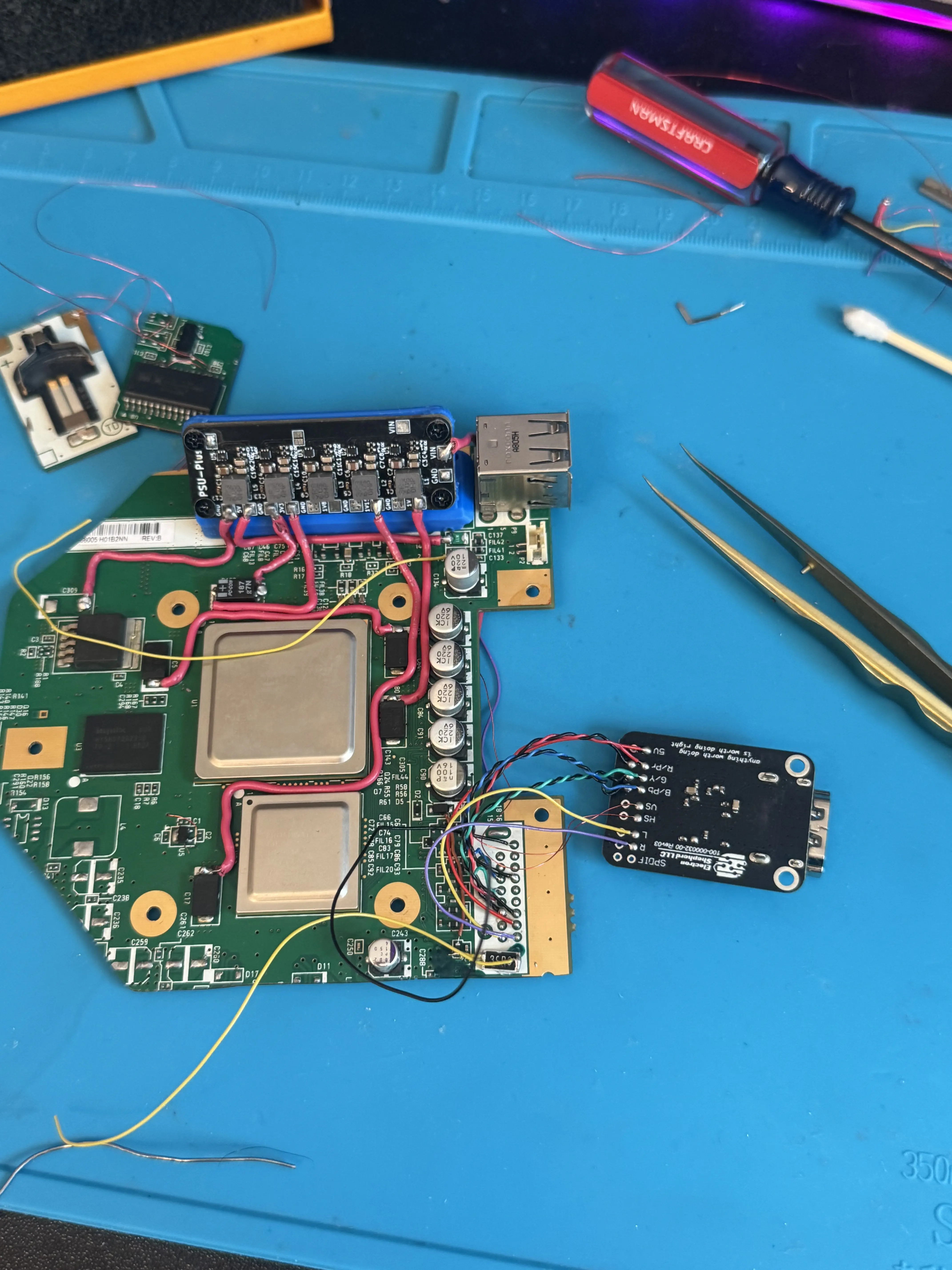

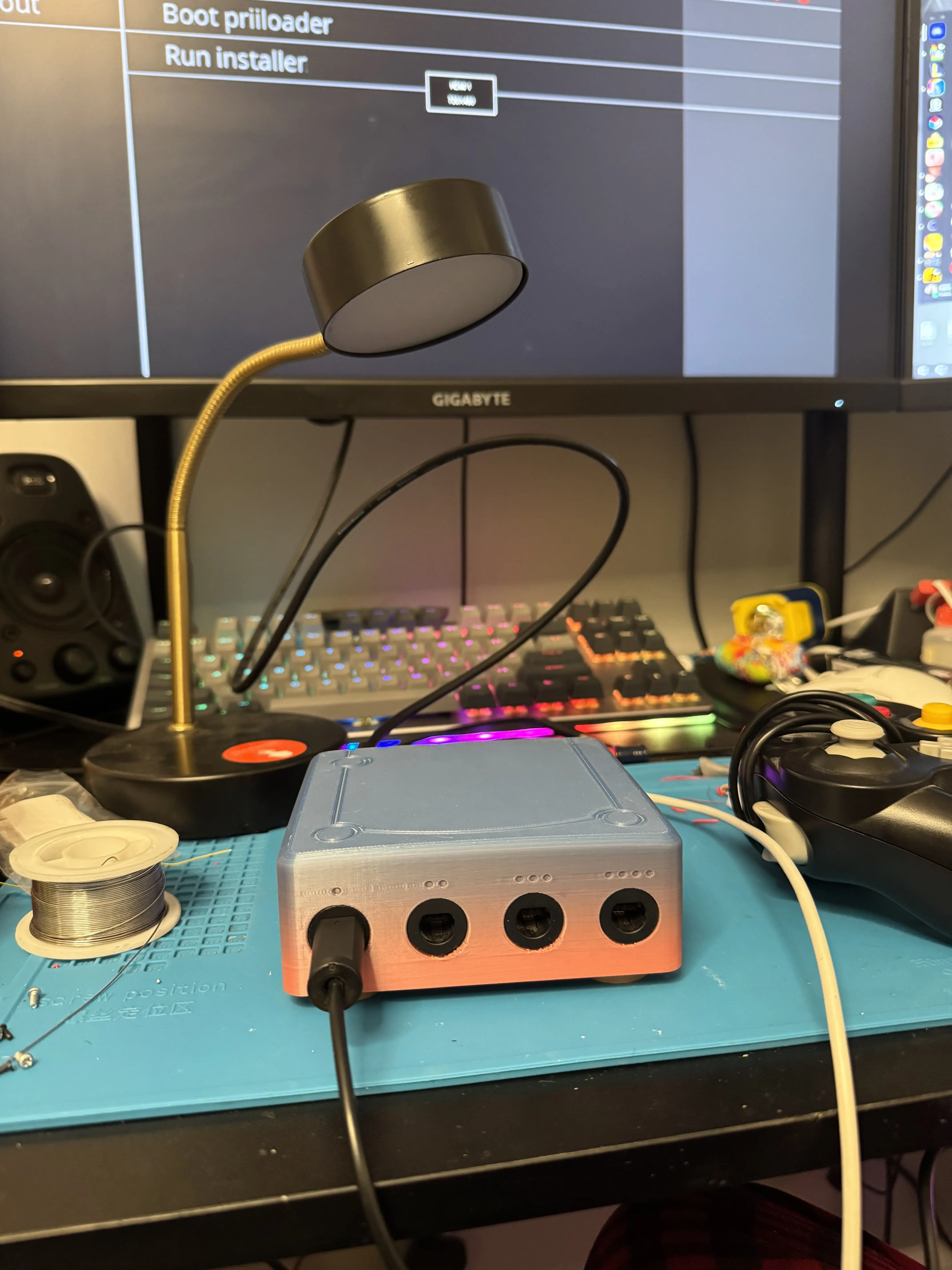

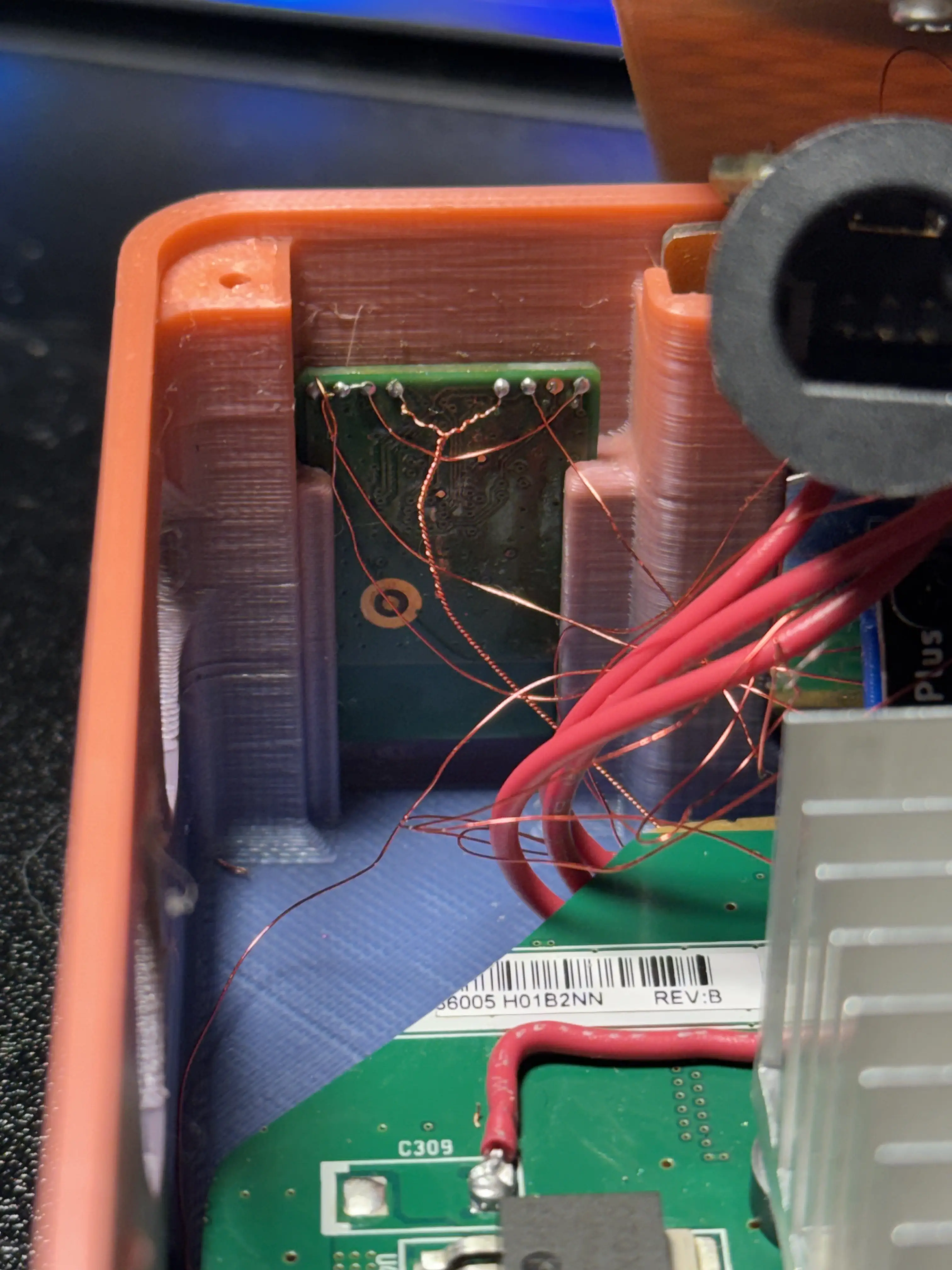

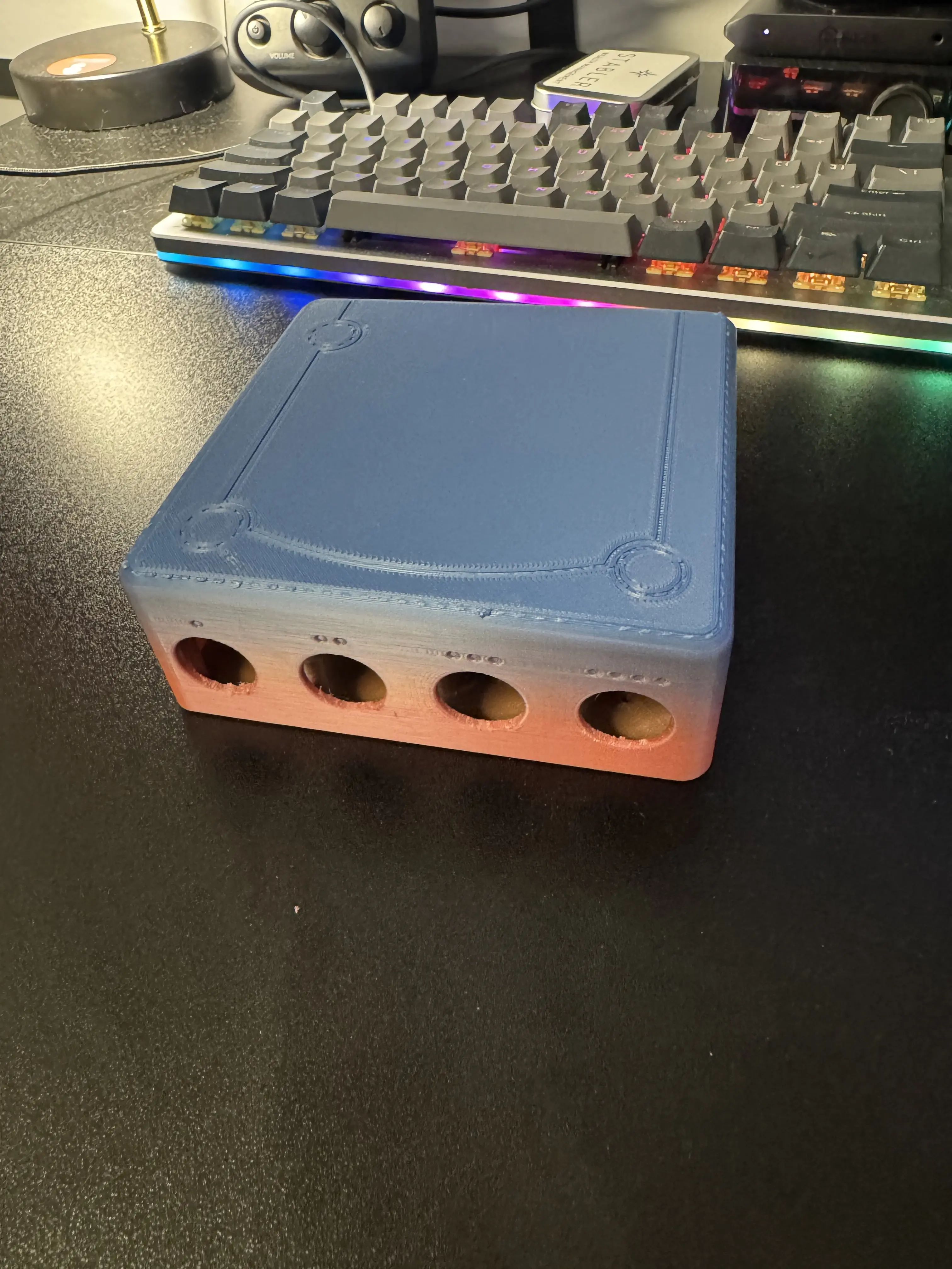

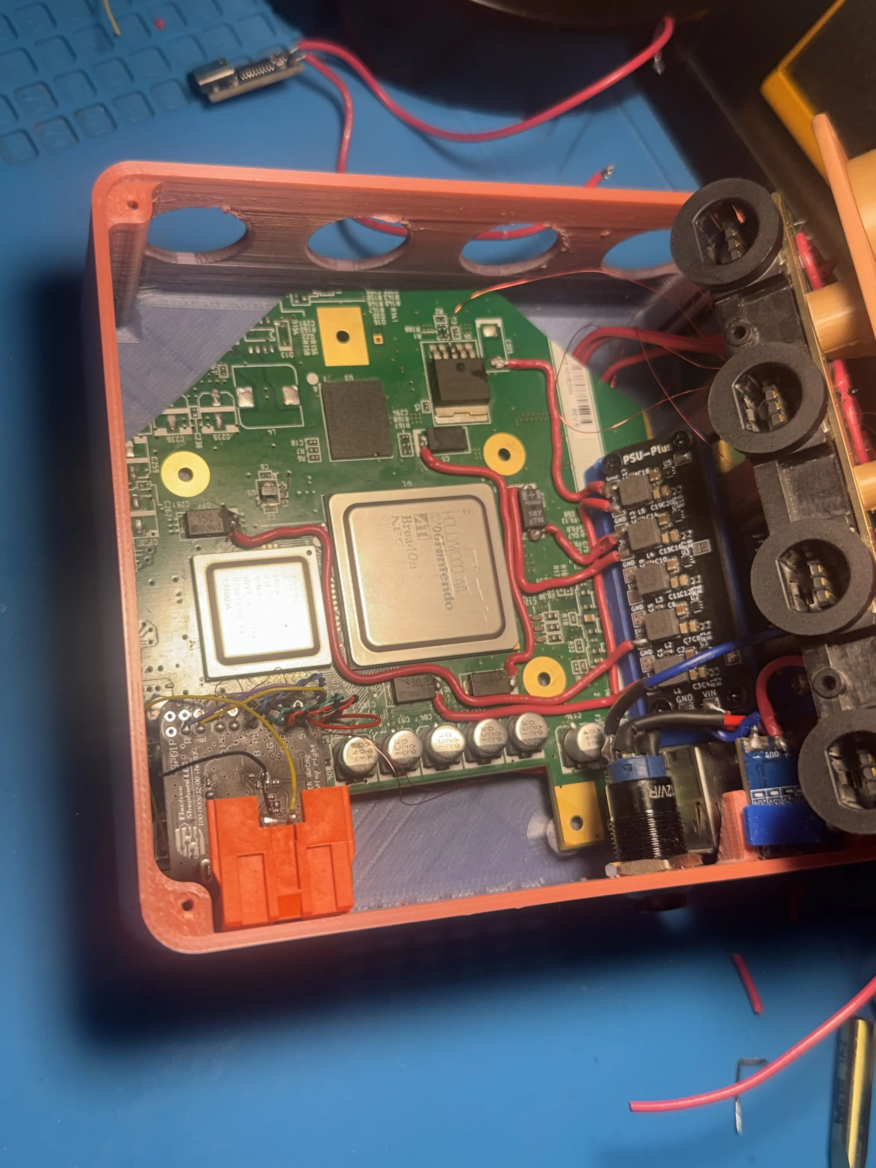

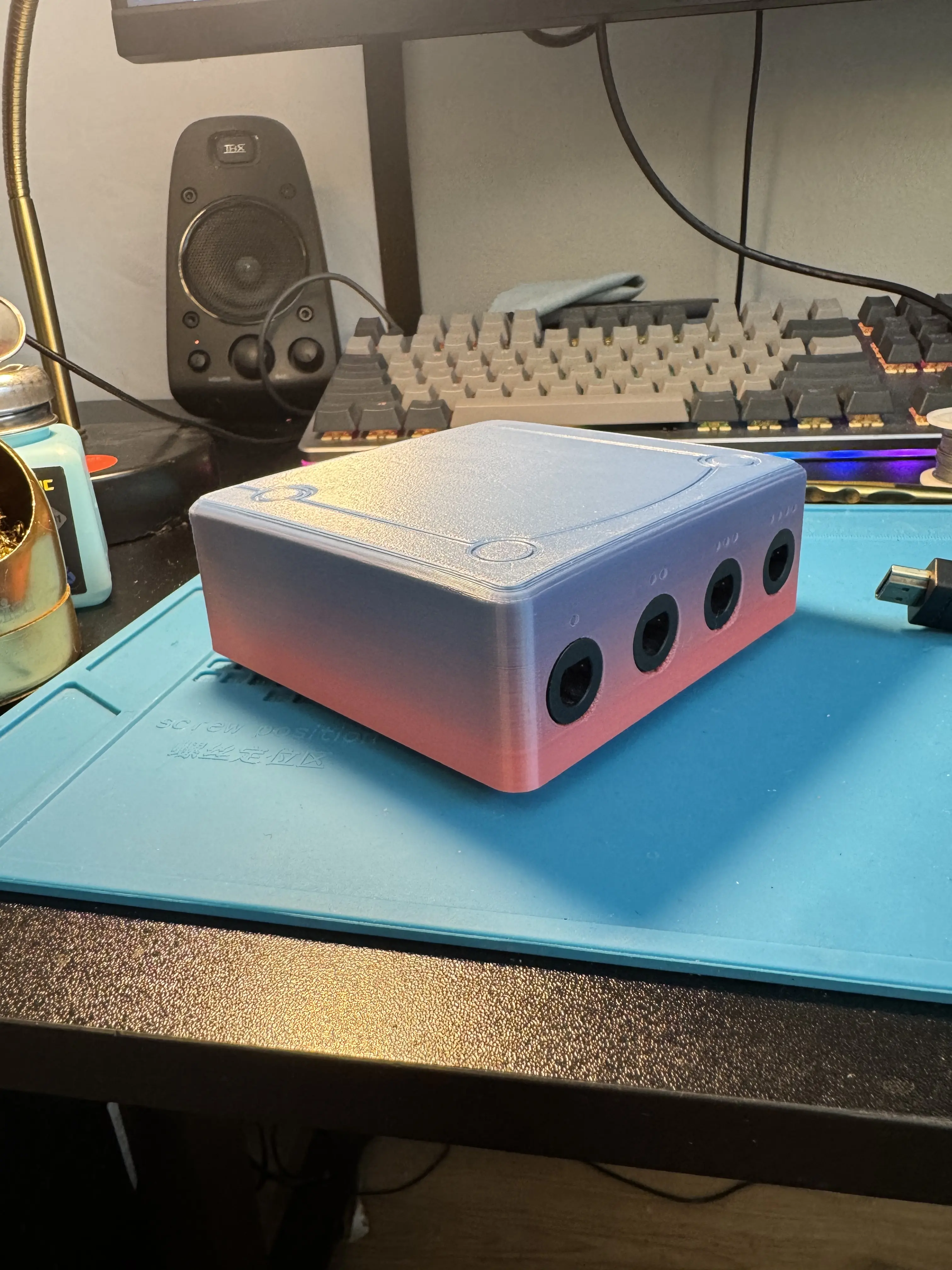

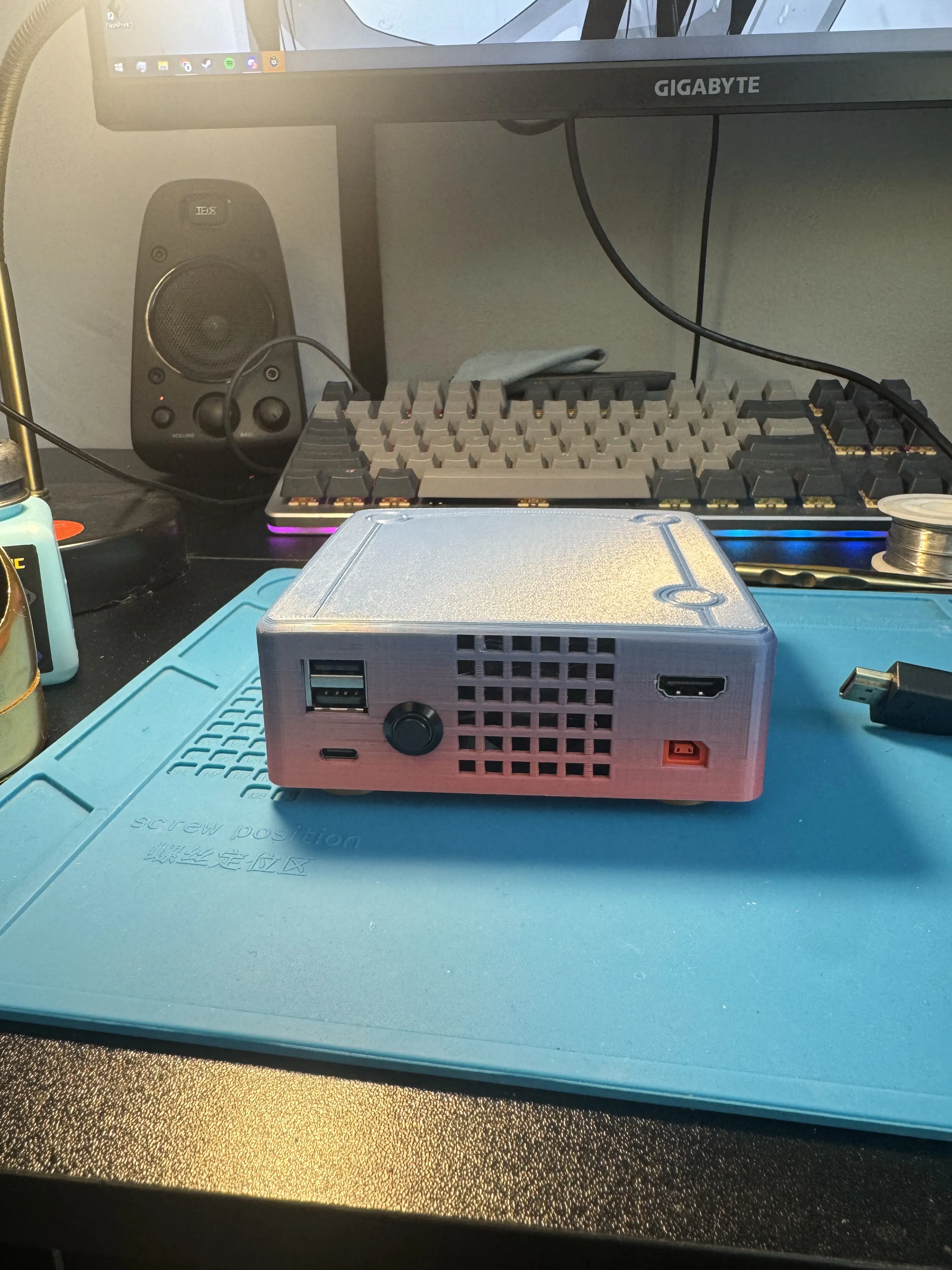

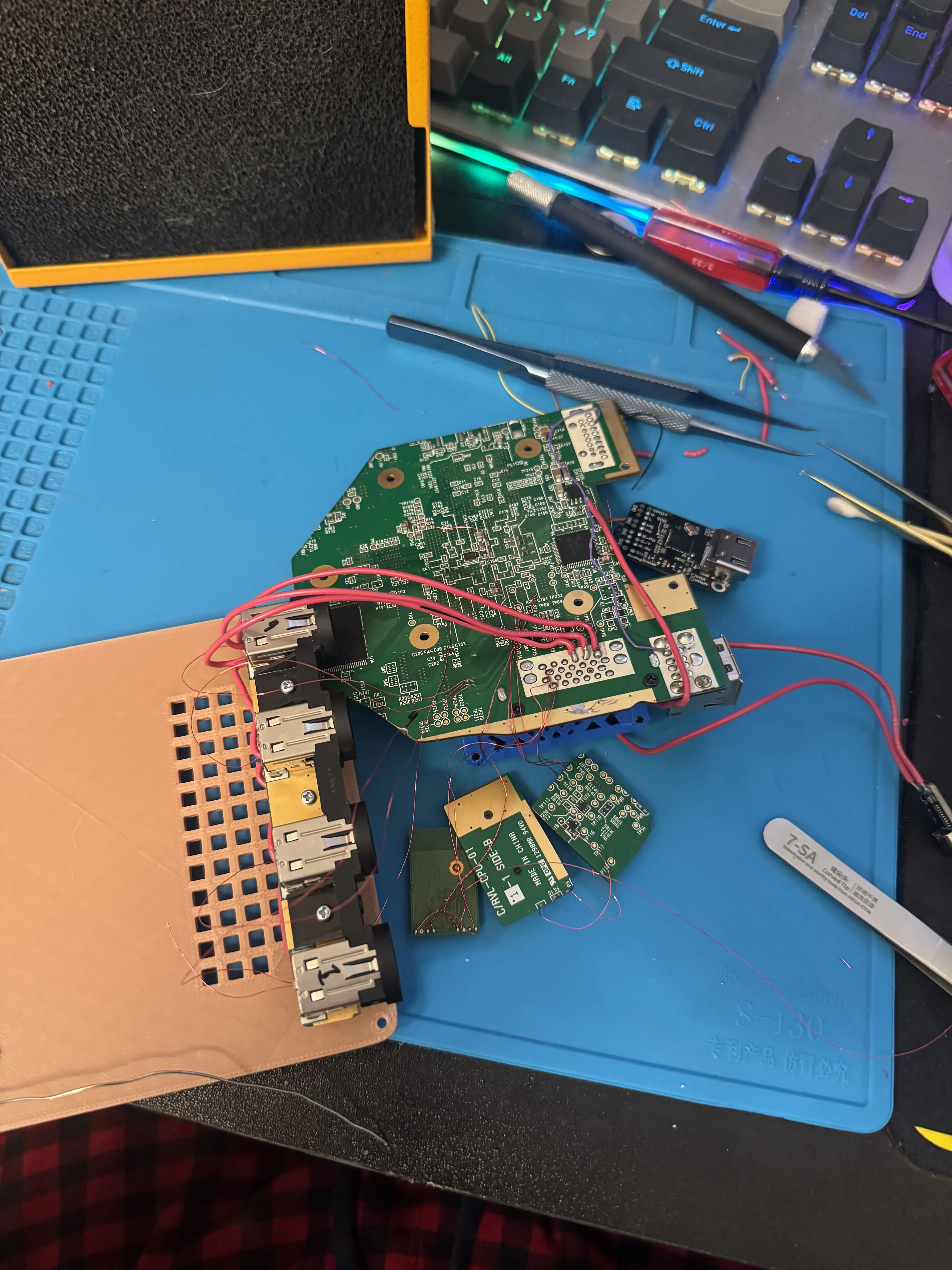

Starting slow with a Wii Micro build because I always wanted one! I’ve decided I wanted something like Benge’s that has USB PD and a push button switch but also equipped with hdmi. I edited the STL’s and created a version that uses analog2hdmi board from ElectronShepherd. Here are the pics :) prints came from a FlashForge Finder I got for free which is what sparked me to start this project in the first place! All it cost was filament and the PSU for the printer. I’d say the hdmi board fitment came out pretty sweet for first time adding to an STL or doing cad in general.

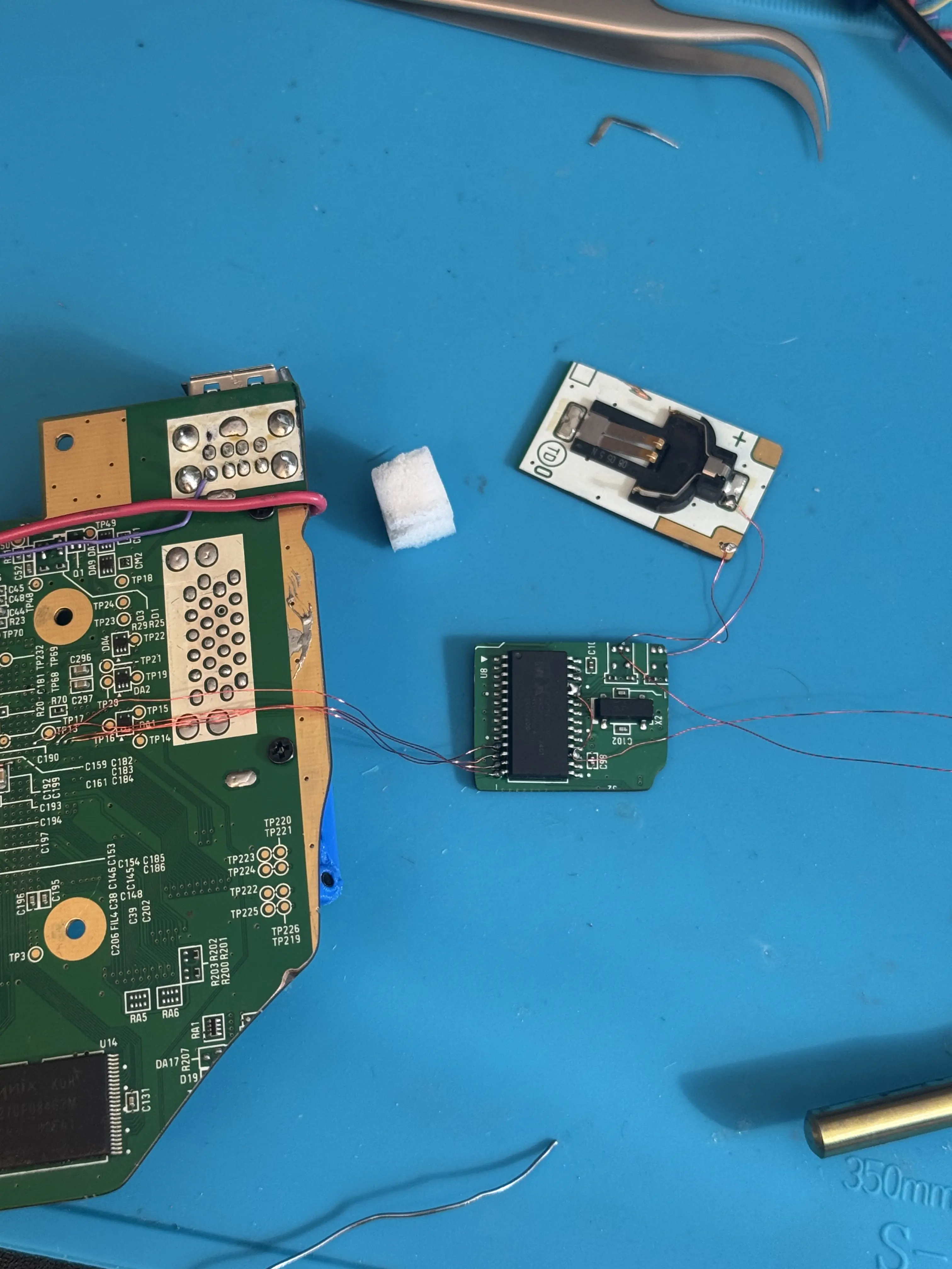

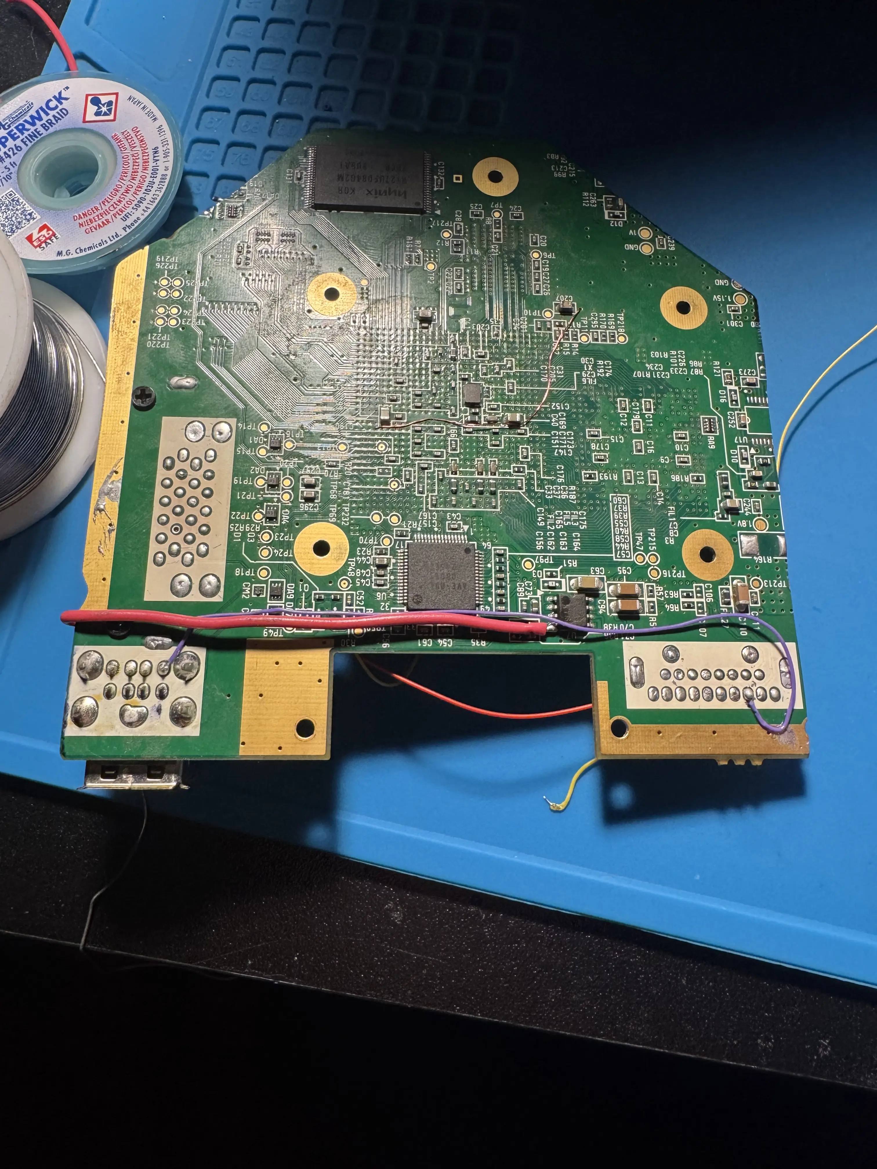

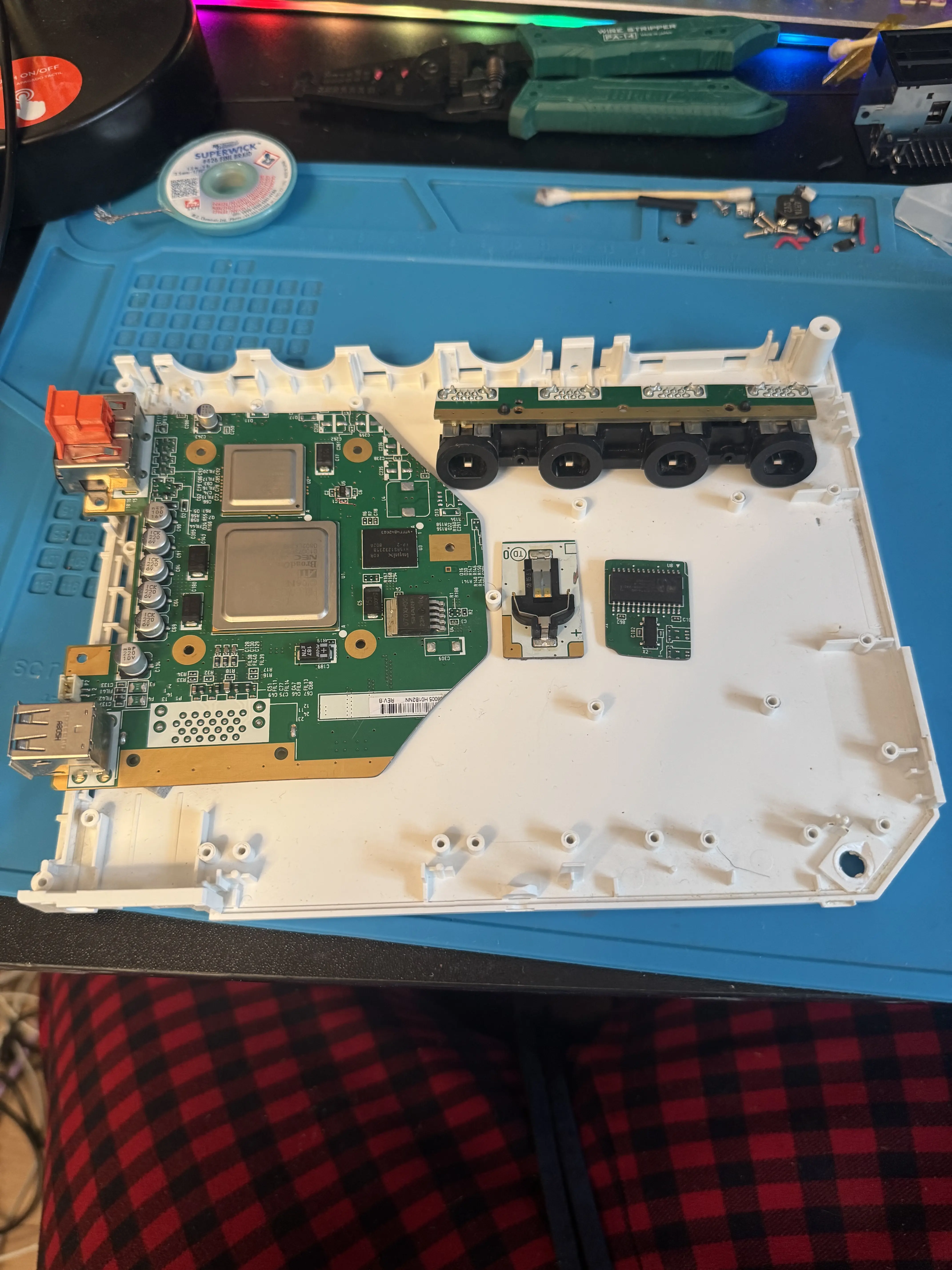

I also got my 6 layer motherboard working with U10 relocation already. Just gotta wait for RVL-PSU’s to come from @CrazyGadget that I purchased from Etsy.
P.S. if anyone needs any more RVL-PSU’s in about a month let me know. I’m going to be assembling about 10 and can sell some of them.
