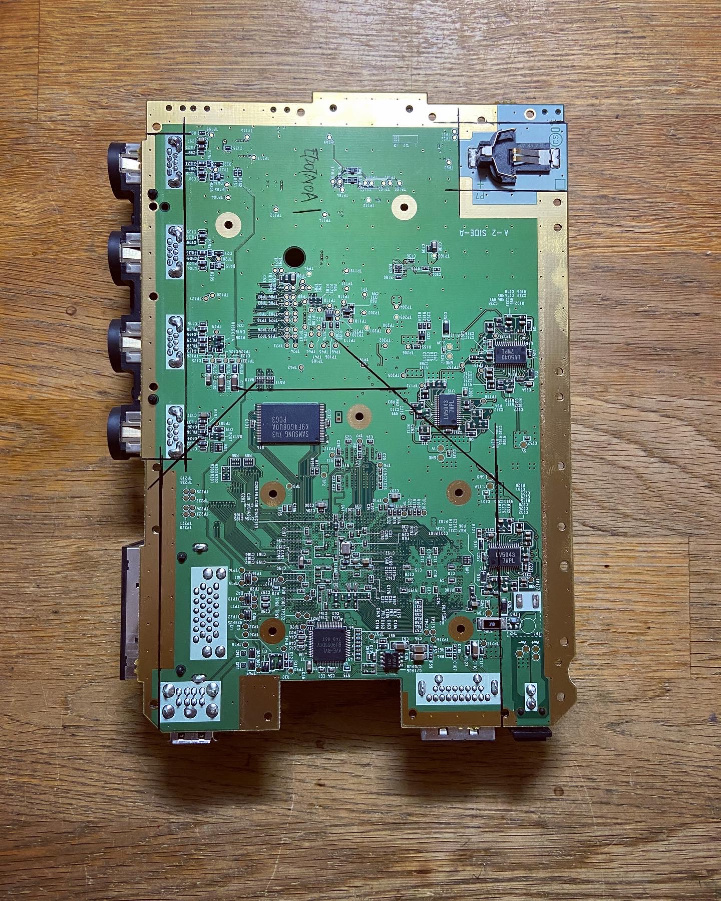

While the printer worked on the case I softmodded my wii with RVLoader and marked up the cutlines on the motherboard
I totally forgot (didnt think of) the U10 relocation, but somehow by accident I acctually didnt cut through it when I trimmed the board and still could harvest U10 and solder it in place.
