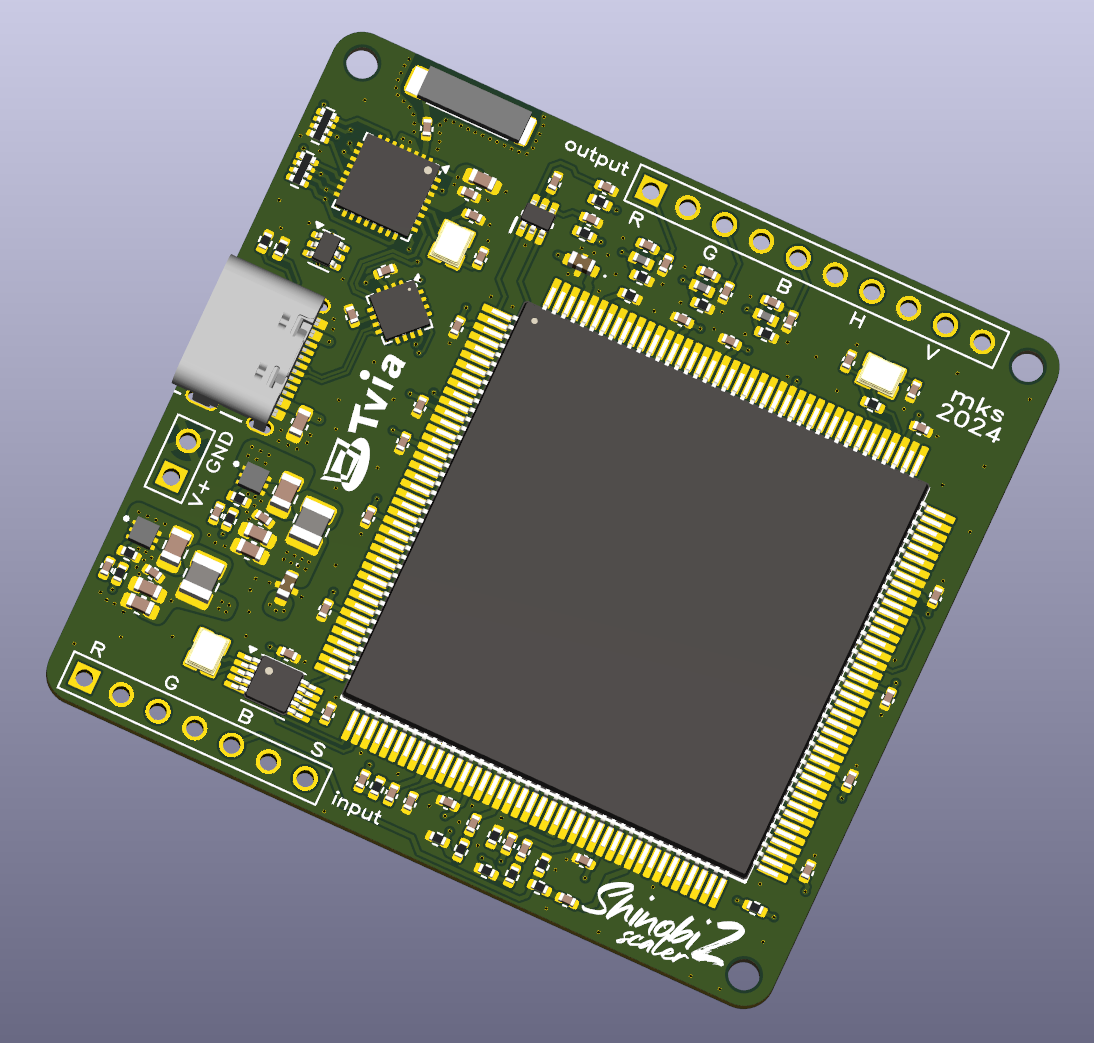

Recently, @thedrew did some undervolt testing with Shinobi Scaler and cut the power in half by running the 3.3V rail at 2.5V and the 1.8V rail at 1.5V. This is more reasonable, so I created Shinobi Scaler 2 to take advantage of his findings:

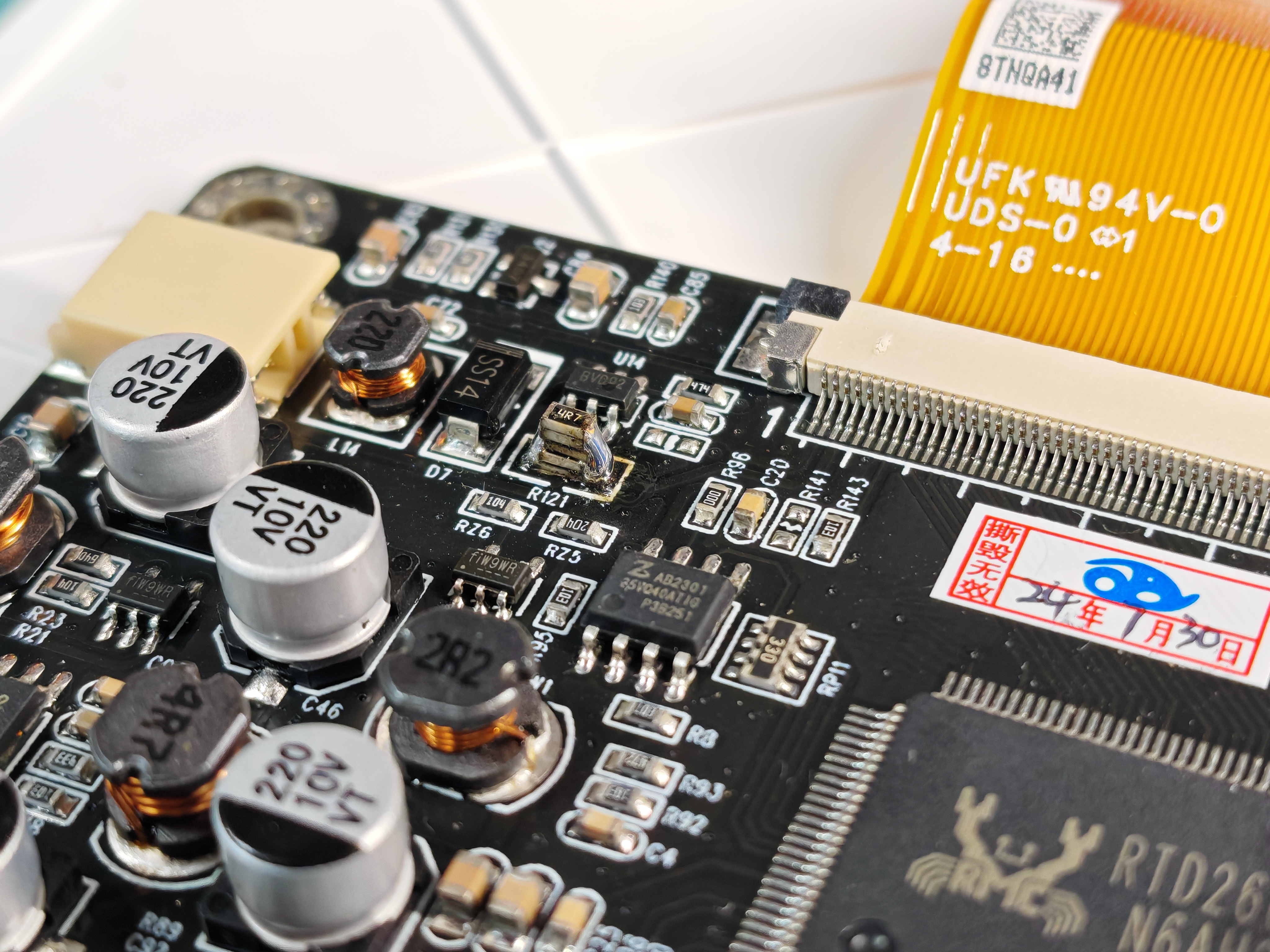

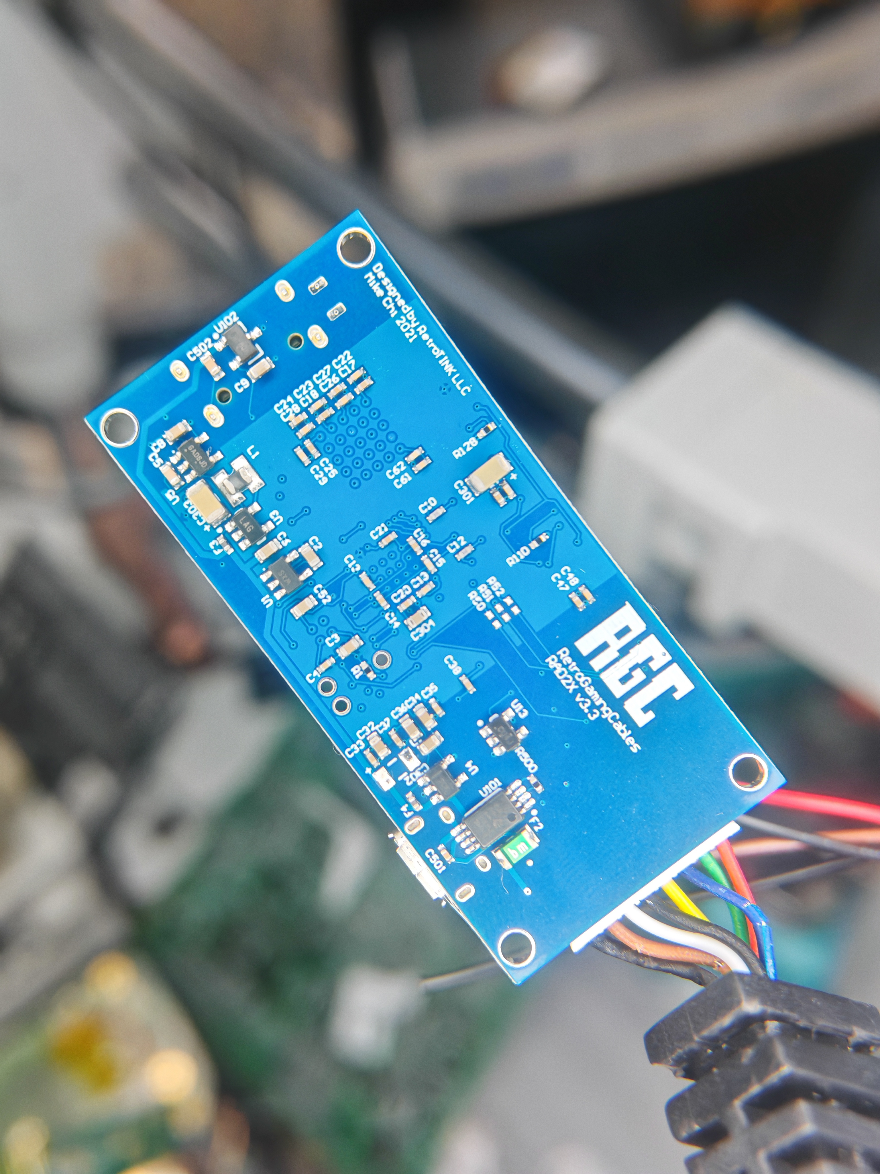

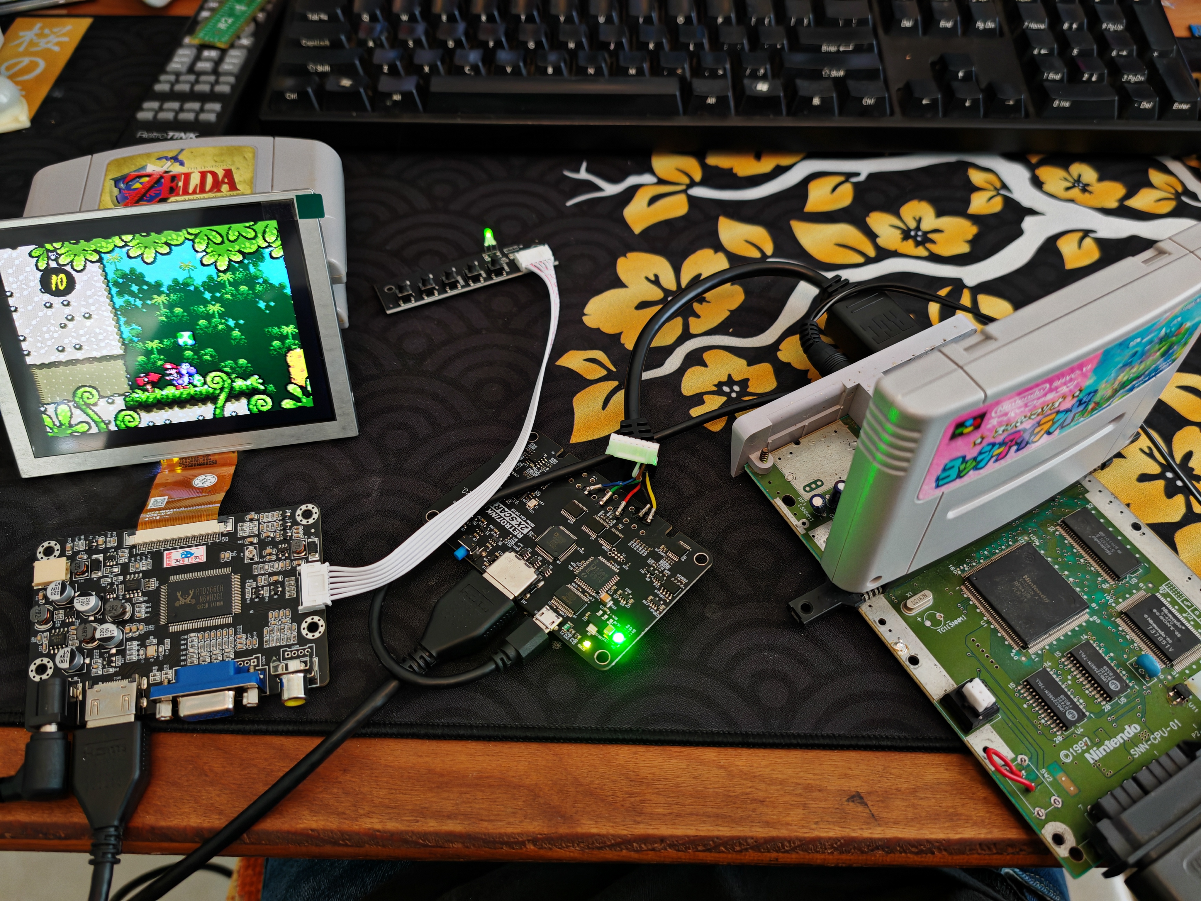

With how amazing my Retrotink 4K makes old consoles look, I decided to try out some of Mike Chi's cheaper offerings, starting with the RAD2X SNES cables. The RAD2X is essentially a miniaturized Retrotink 2X and uses an off-the-shelf ADC and HDMI transmitter to linedouble SNES RGBS to 480p HDMI.
(for those wondering, the interface between the ADC and HDMI transmitter is YCbCr, not 24-bit RGB, so a direct drive like the GEM is not possible.)

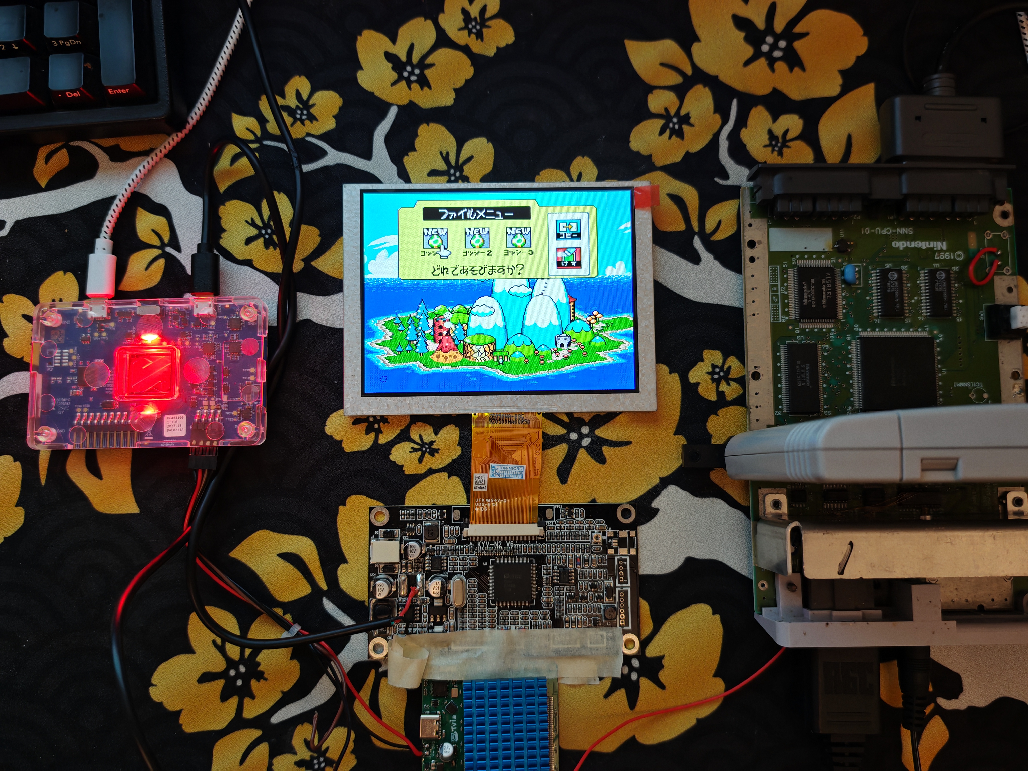

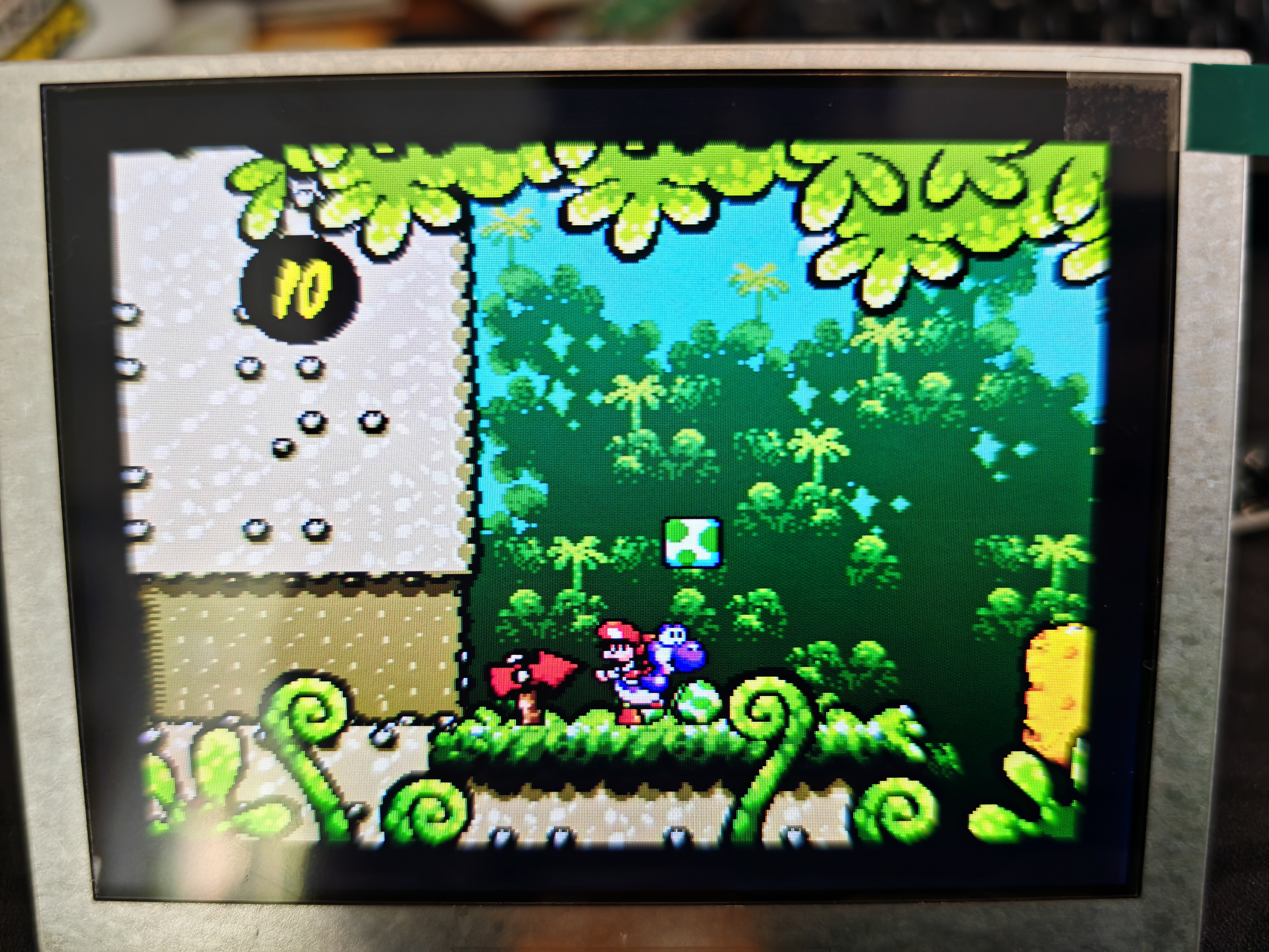

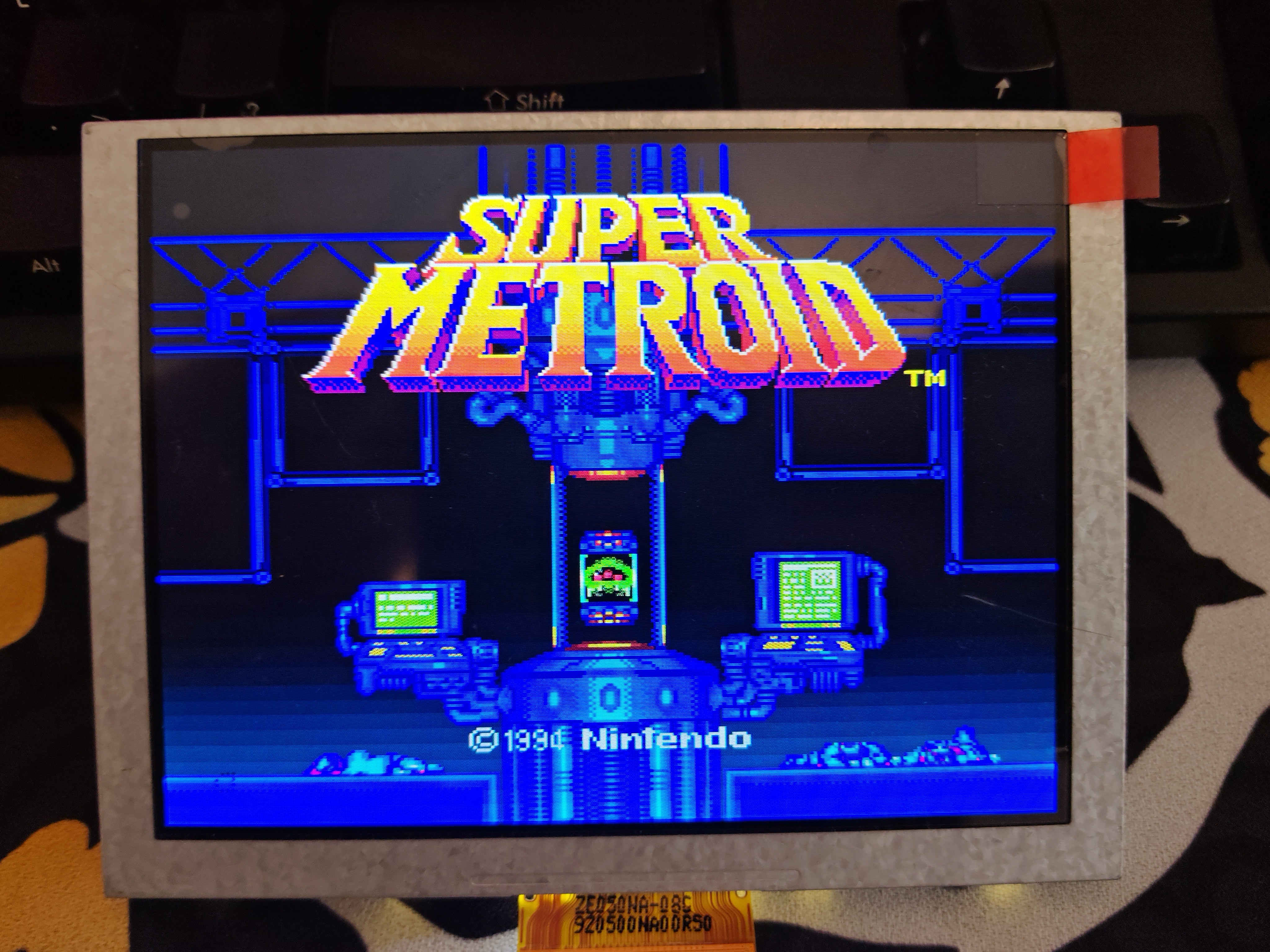

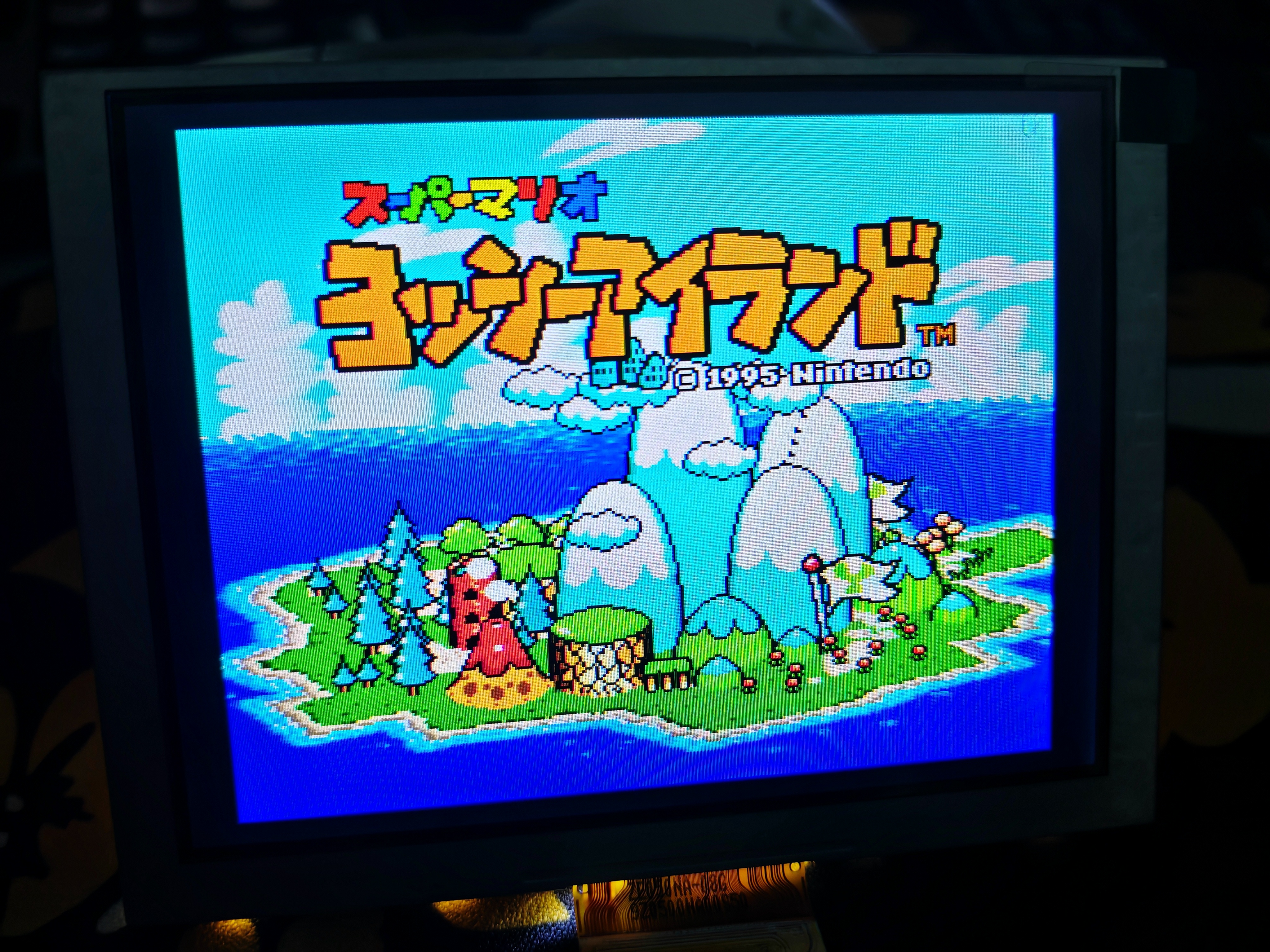

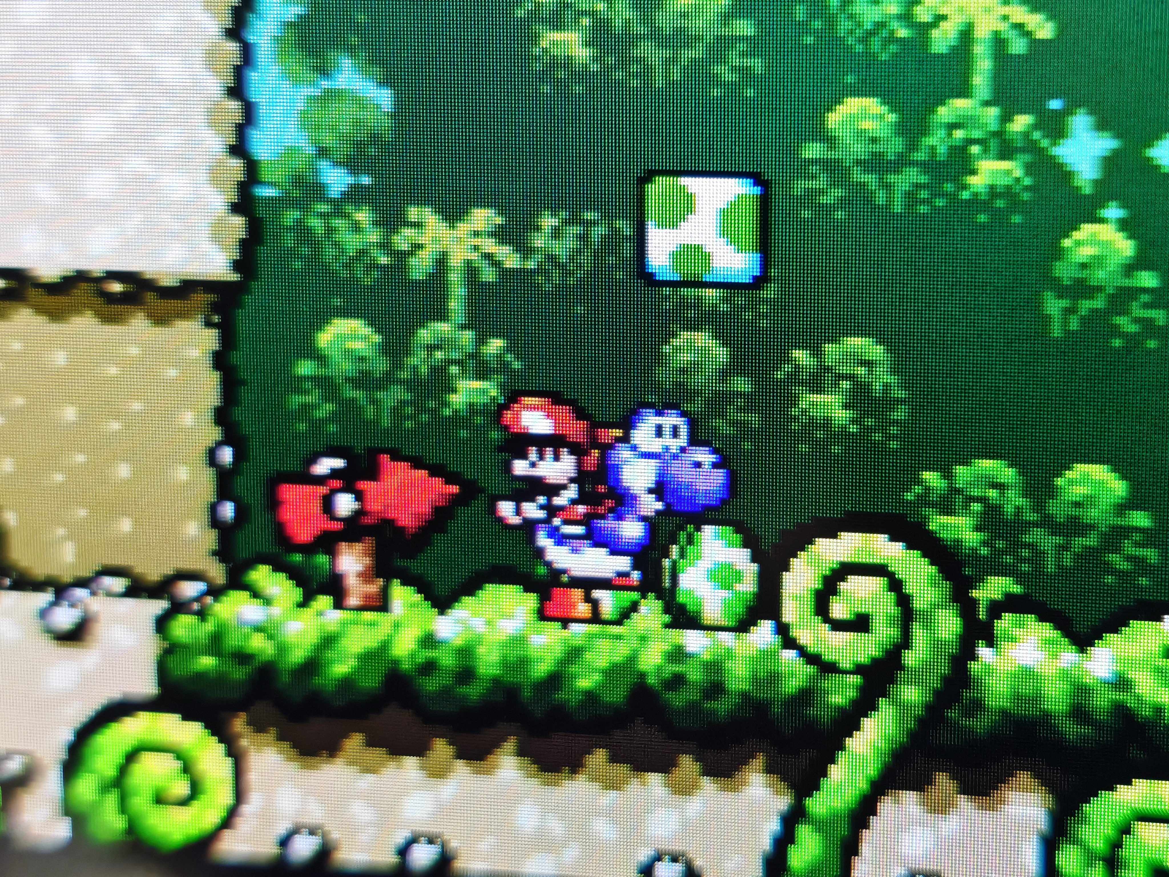

The output is integer scaled (512x448) in a 720x480 frame and looks quite nice on the ZJ050NA-08C LCD.
The RAD2X draws about ~200mA @ 5V while running, which matches Shinobi Scaler 2. There are definitely additional power savings on the table from strategically replacing LDOs on the PCB with switchers. It's also ~1/3 the size of a Shinobi Scaler.

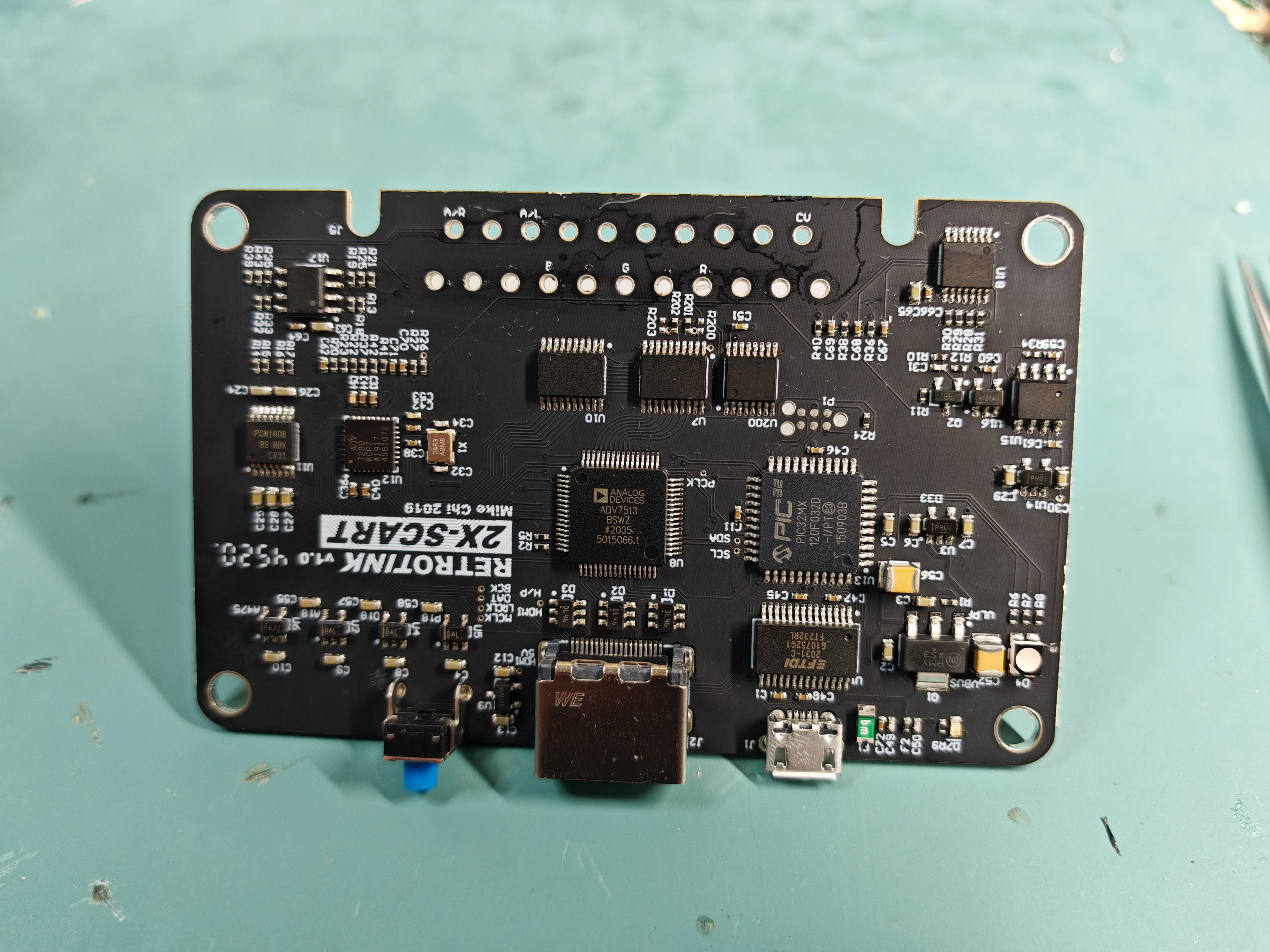

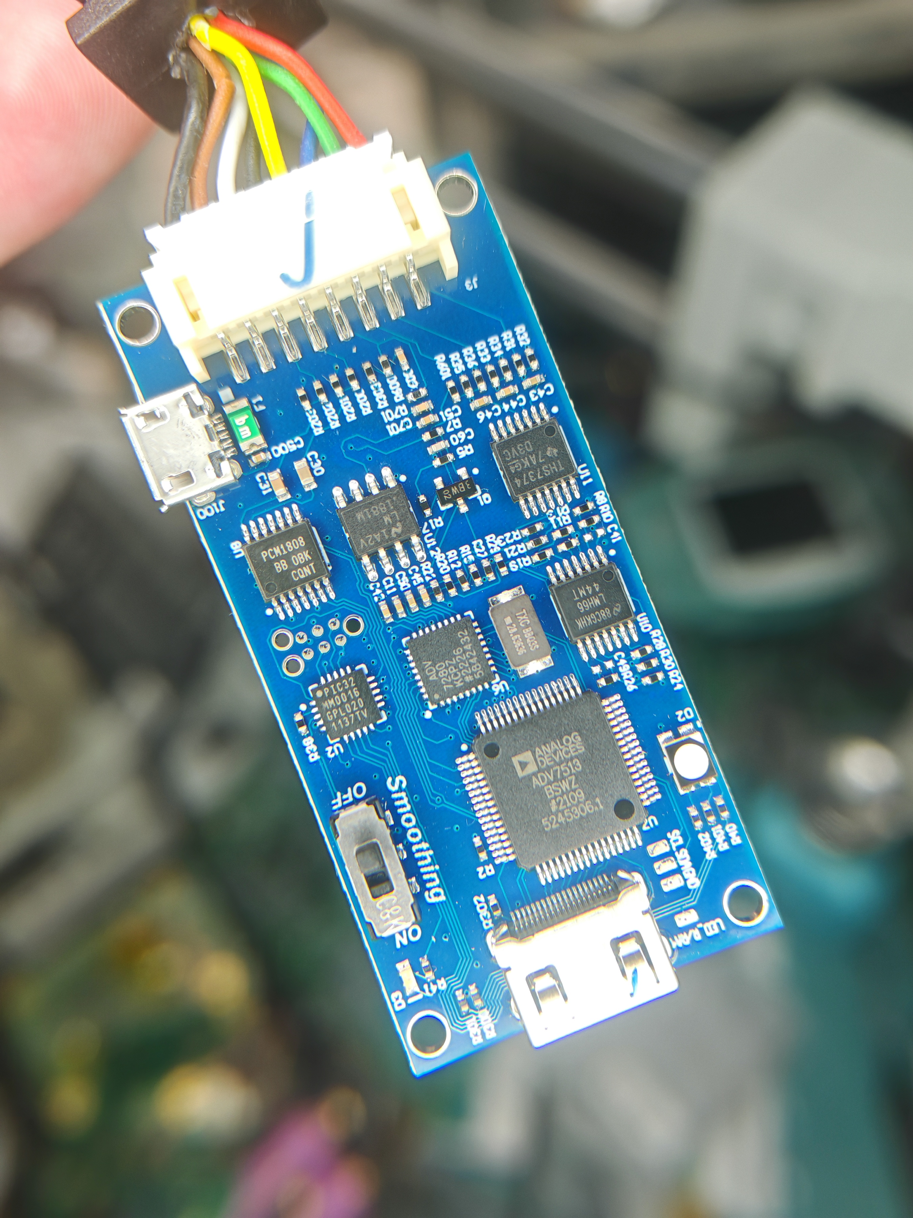

My 2X-SCART arrived! I like the silk labels for the input pins. The PCB has a couple mystery ICs; one seems to be an LM1881, and another is probably a THS7374. Not sure what the others are yet, but it'll become clear once I generate a schematic. The FTDI chip can definitely be yeeted once I update the PIC to the latest firmware. Overall, the circuitry is extremely miniaturizable, which is exciting!

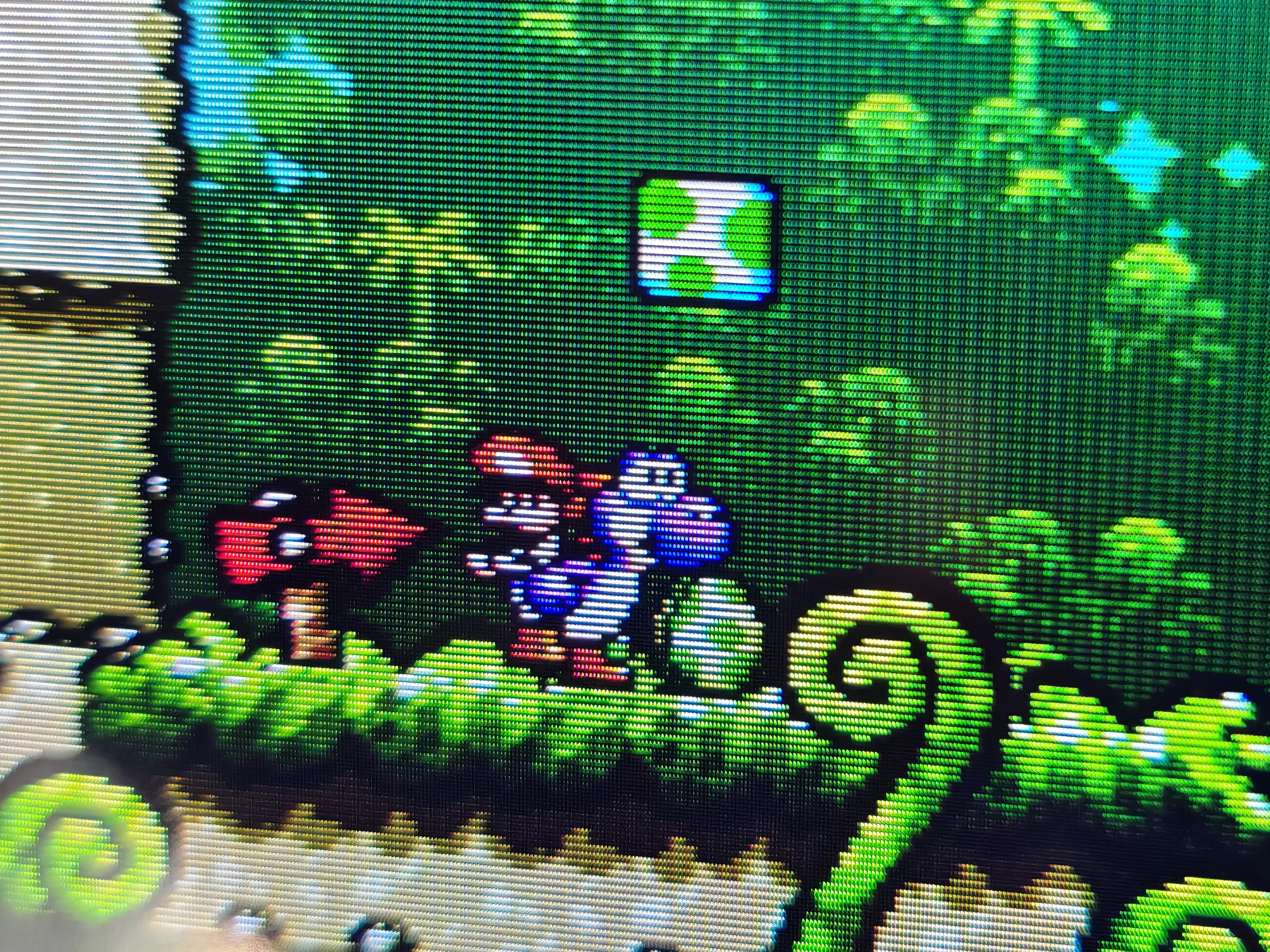

Unsurprisingly, the video output is basically identical to the RAD2X.

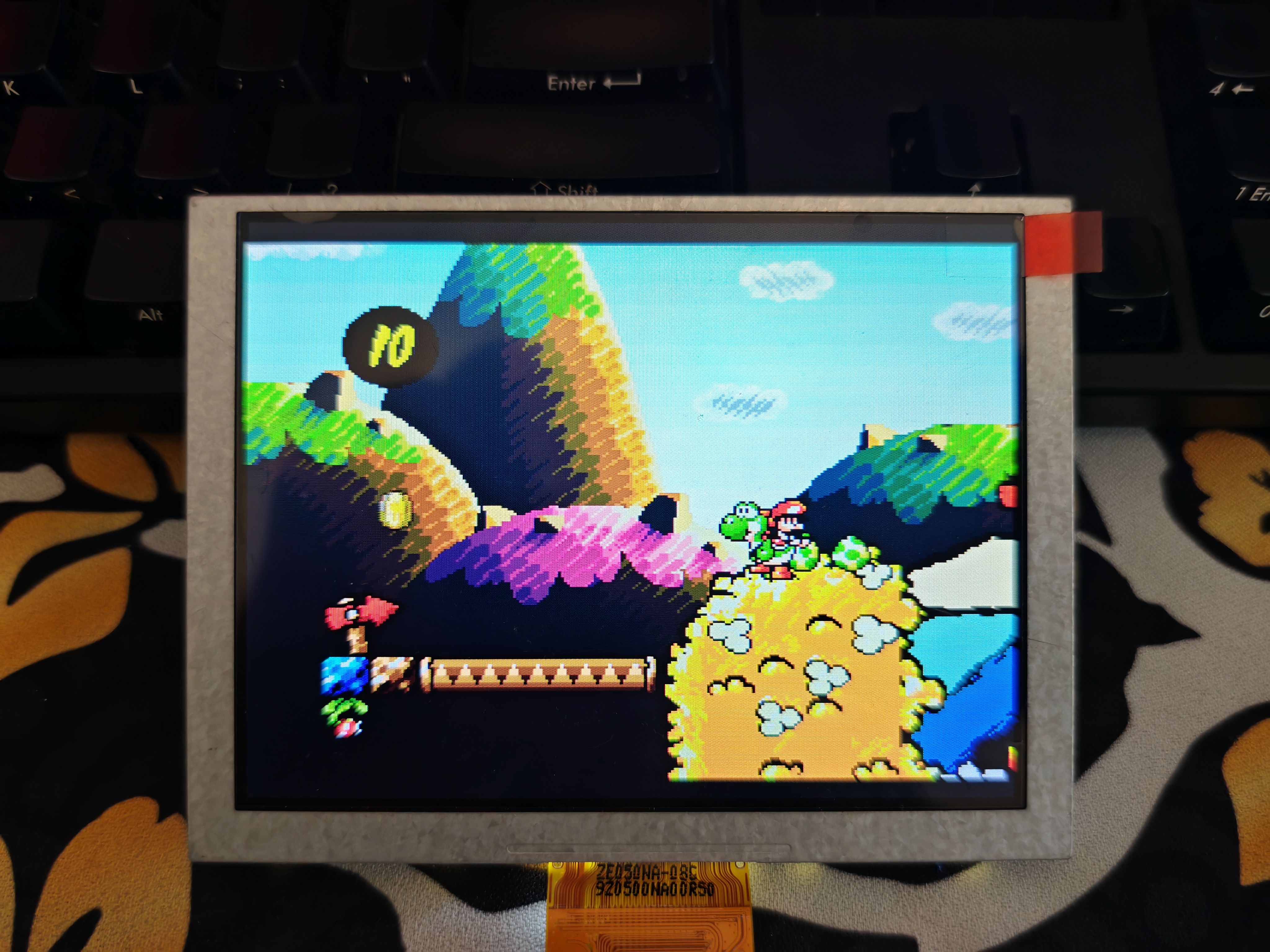

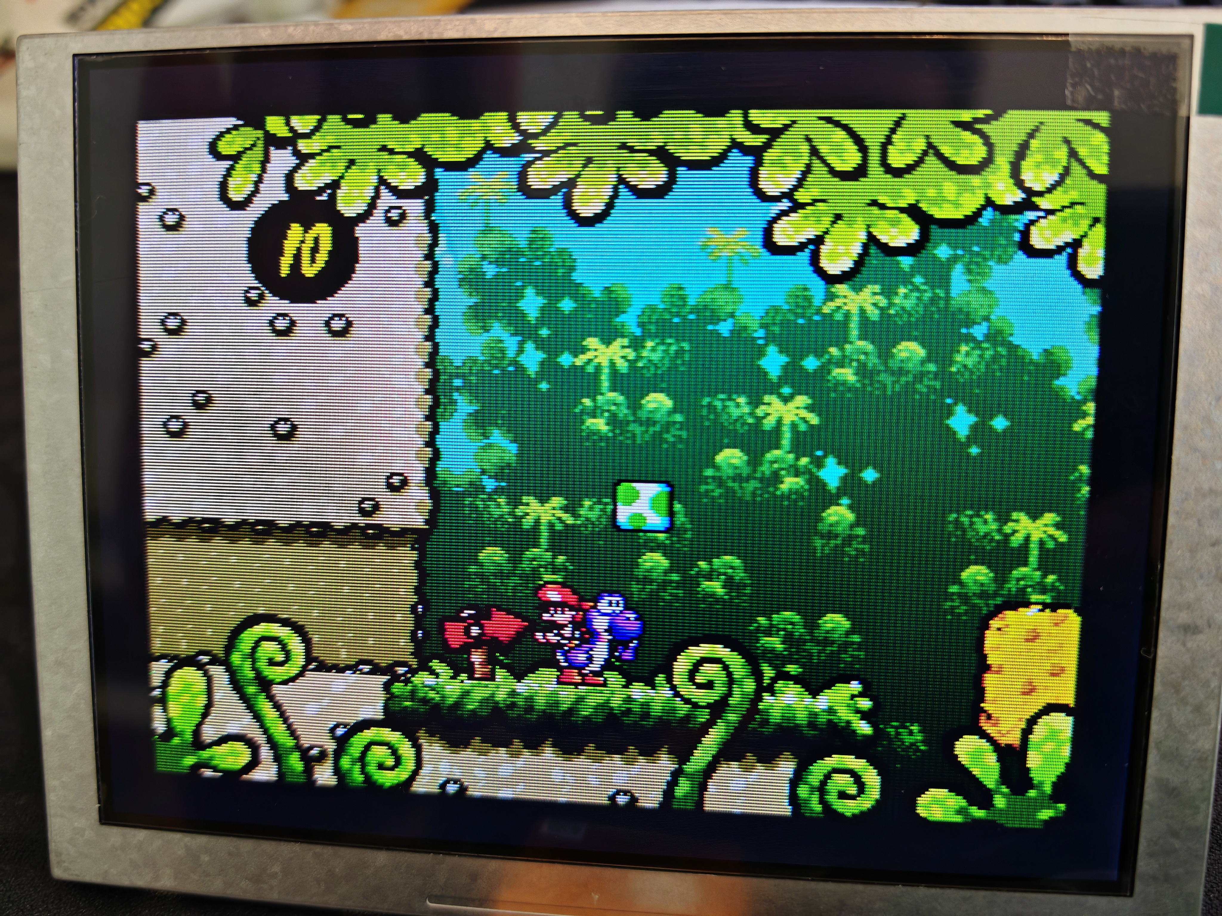

The scanline filter looks extremely good. Using a 2X-SCART is well worth it for this feature alone.
Scanlines disabled on the left, scanlines enabled on the right.
Close-up:
The only downside of enabling scanlines is the huge decrease in brightness that it causes. The 2X-SCART has no gamma boost options like the PixelFX products to compensate for this. My only hope is purchasing a high-brightness version of the 5" 640x480 LCD. The stock panel is a measly 250 nits, but 800nit versions exist and should be able to pump out enough light to make up for the doublestrike filter.

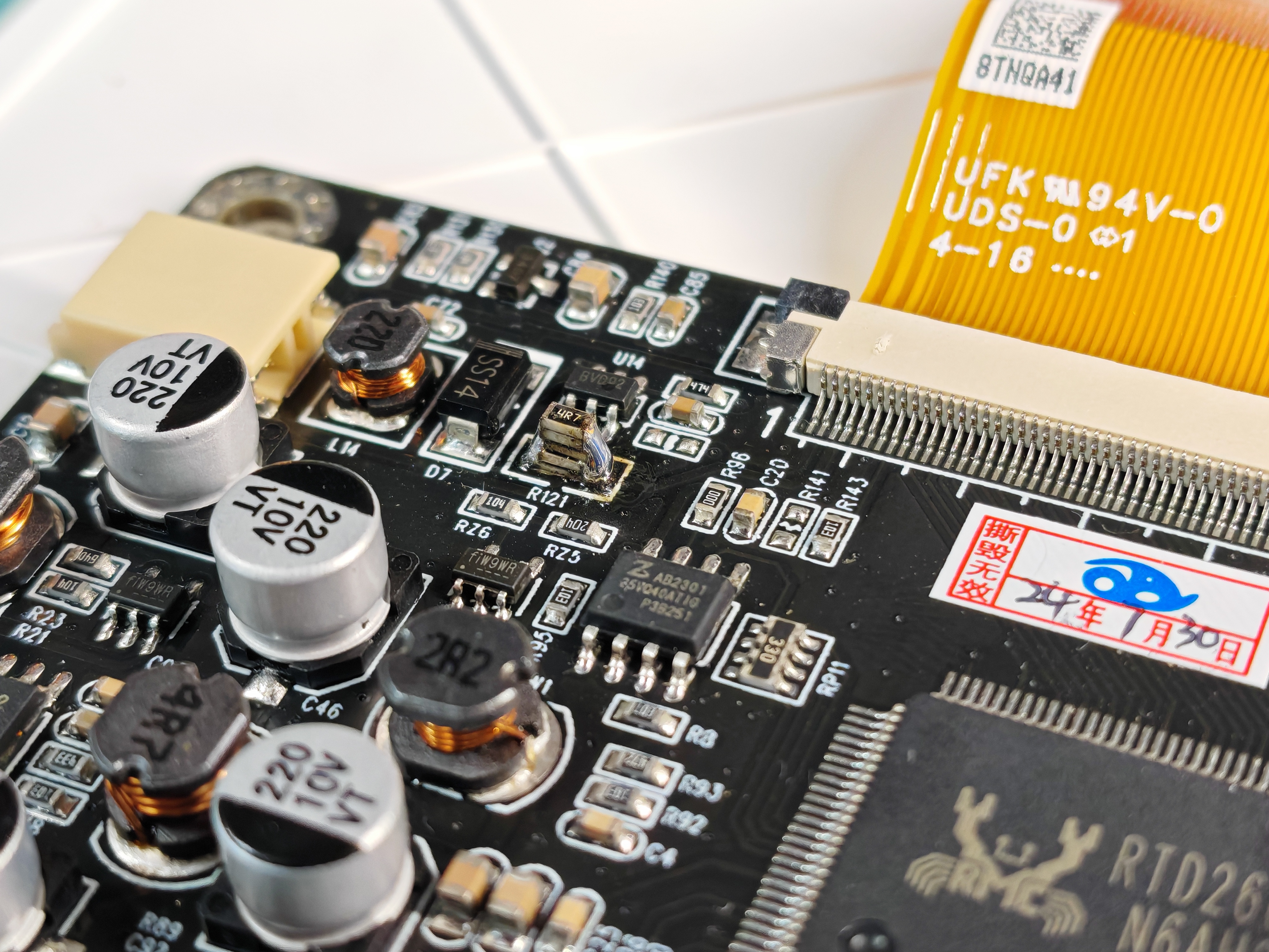

I'm a little wary of messing with the video levels in case it impacts the colors or contrast. But I found a workaround for now. Increasing the backlight current by ~1.75x makes the brightness in scanline mode good enough.
The stock boost converter is unhappy outputting this much current, but I can replace it with a better one in the final design. Hopefully this doesn't cook the panel LEDs long term

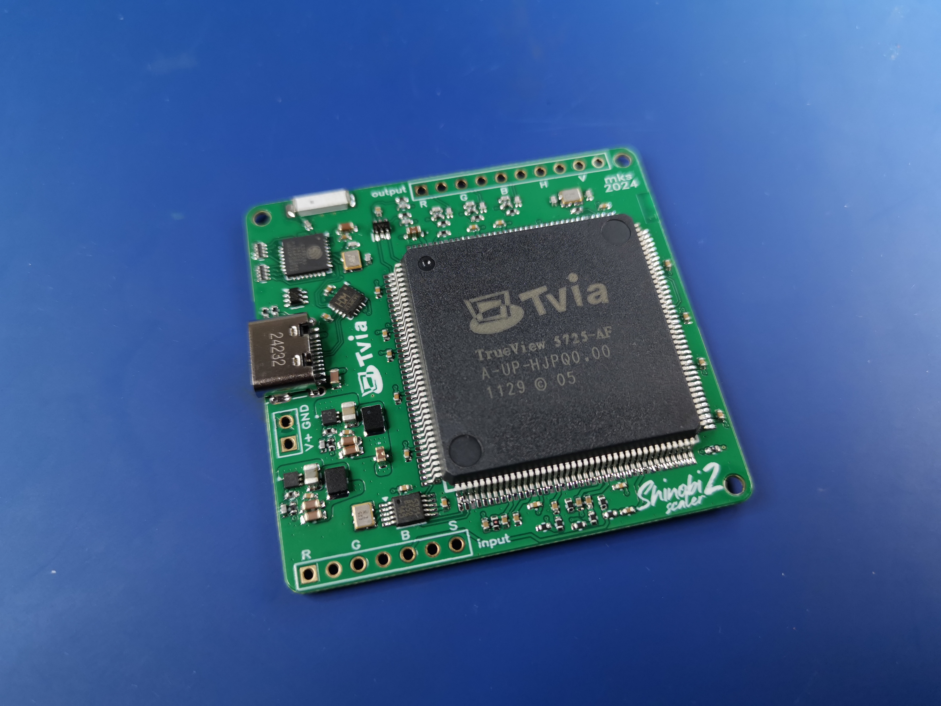

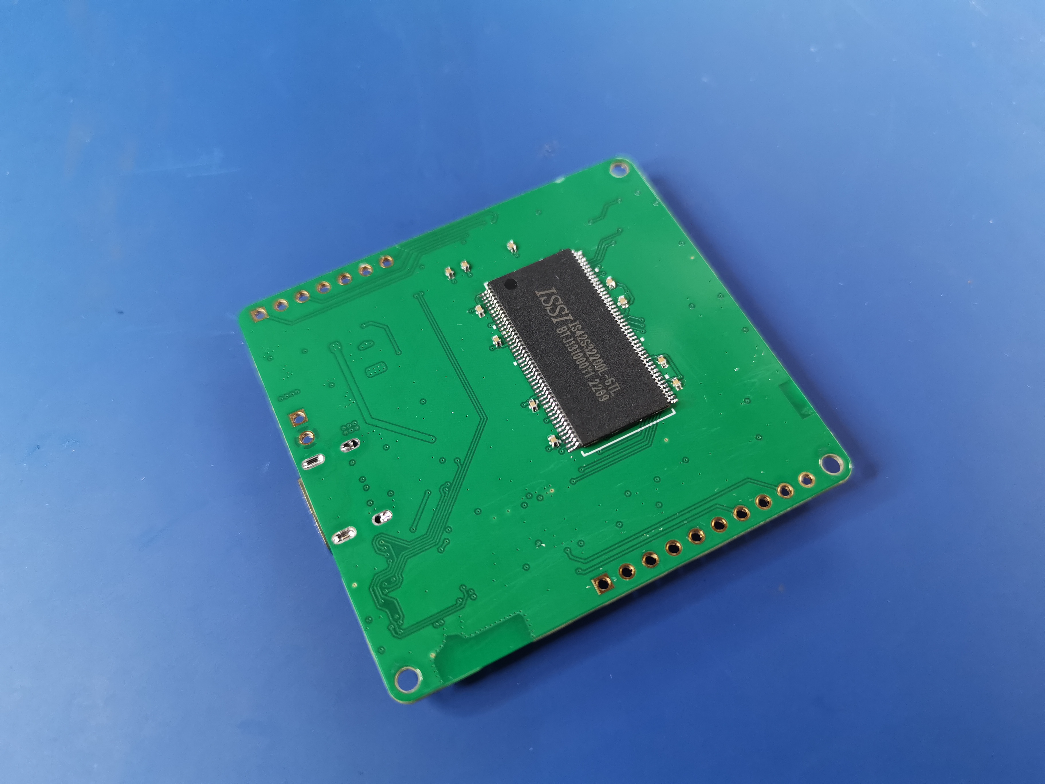

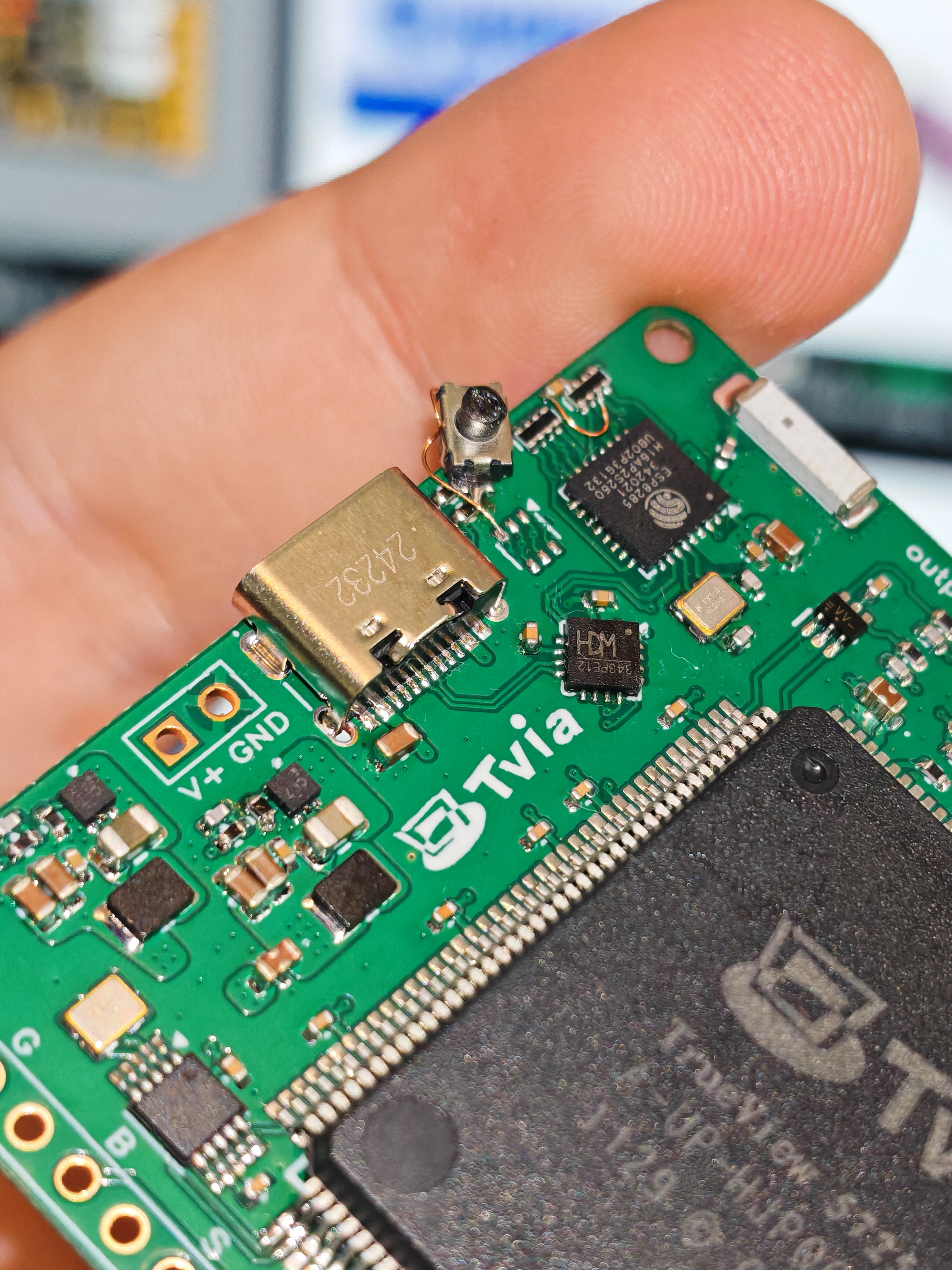

So, I bit the bullet and assembled a Shinobi 2!

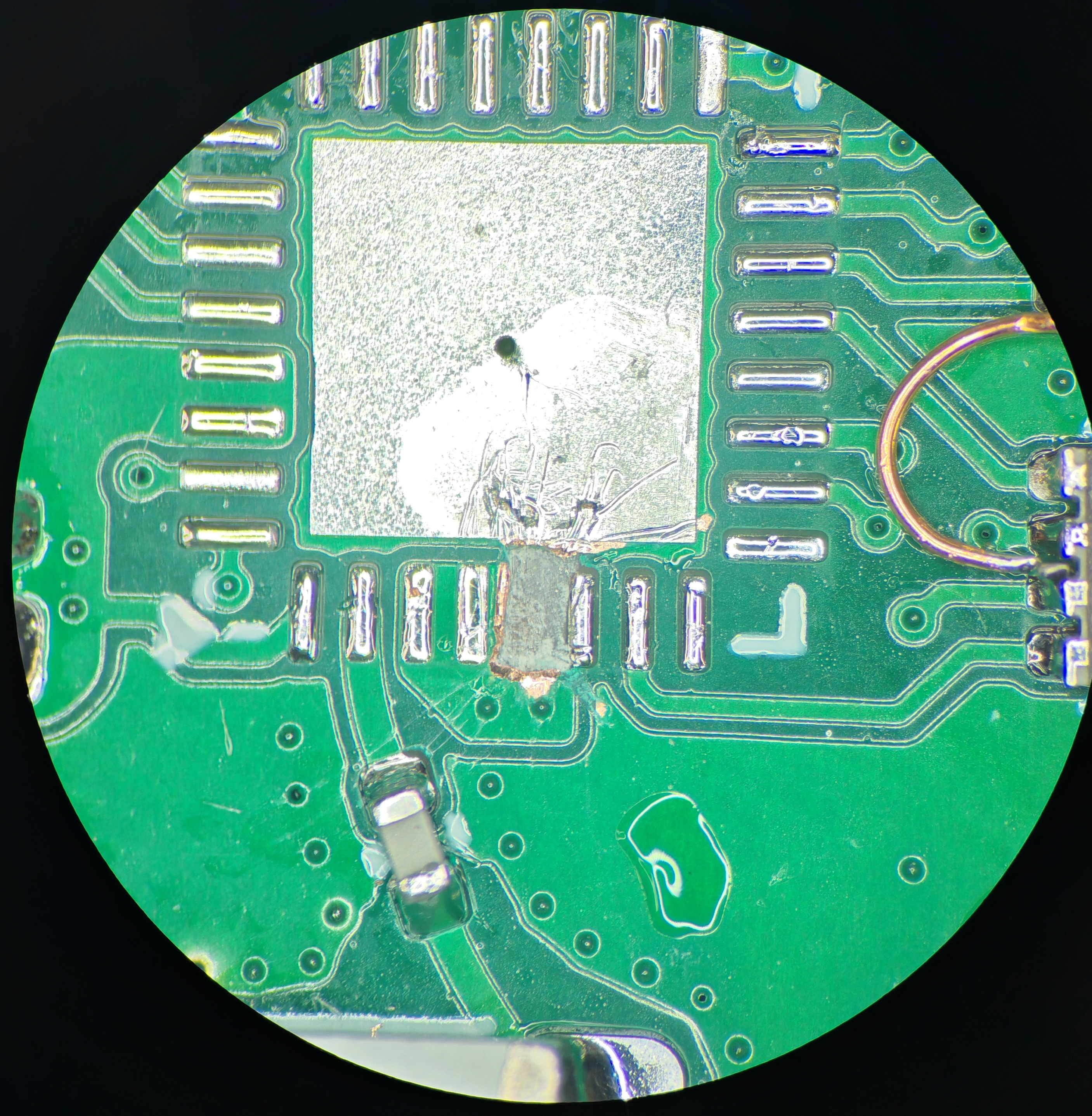

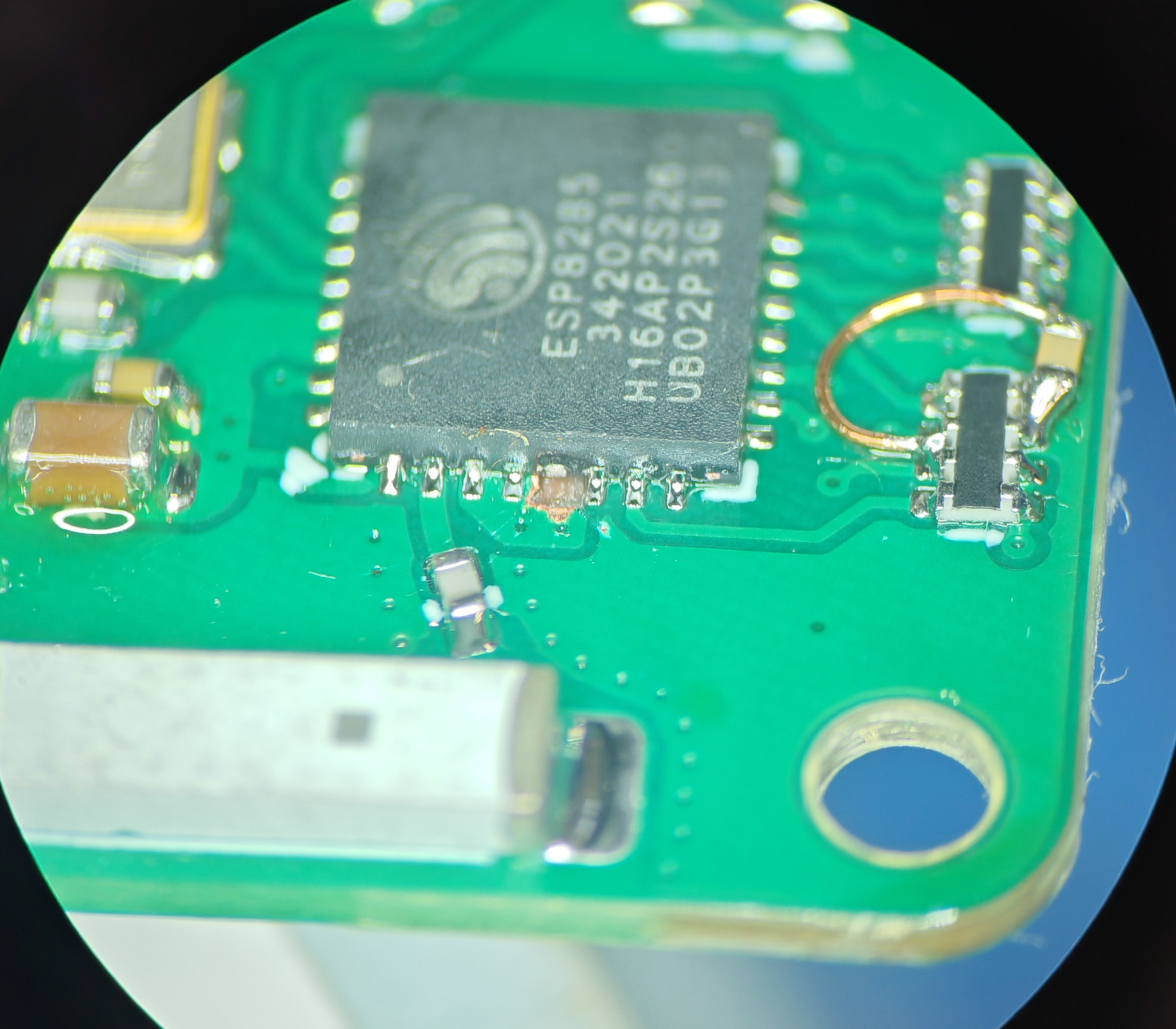

I was having some issues talking to the ESP8285 at first. The CH343P's COM port was showing up, but esptool couldn't see the ESP8285. I thought maybe my auto-reset transistor circuit was messed up, so I bodged in a program mode button, and a POR cap just to be safe. I also stacked another resistor onto the 2.5V buck to make it output 3.1V temporarily, to rule out the undervolting.
But it didn't do squat. In desperation, I even swapped out the ESP.
After looking at some other ESP8285 designs, it turns out I had mistakenly connected VDD_RTC (internal 1.1v reg) to all the other power pins. Sure enough, that side of the ESP was getting really hot. Surgery time!
After that, it programmed just fine!

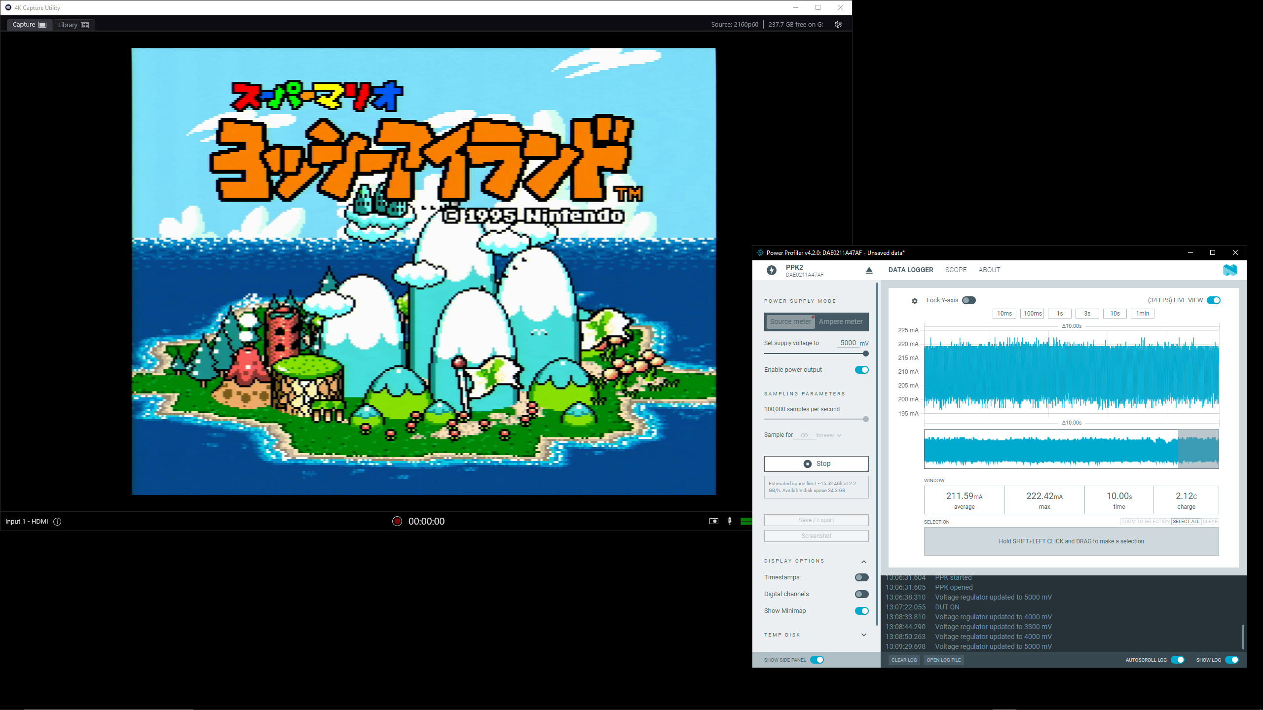

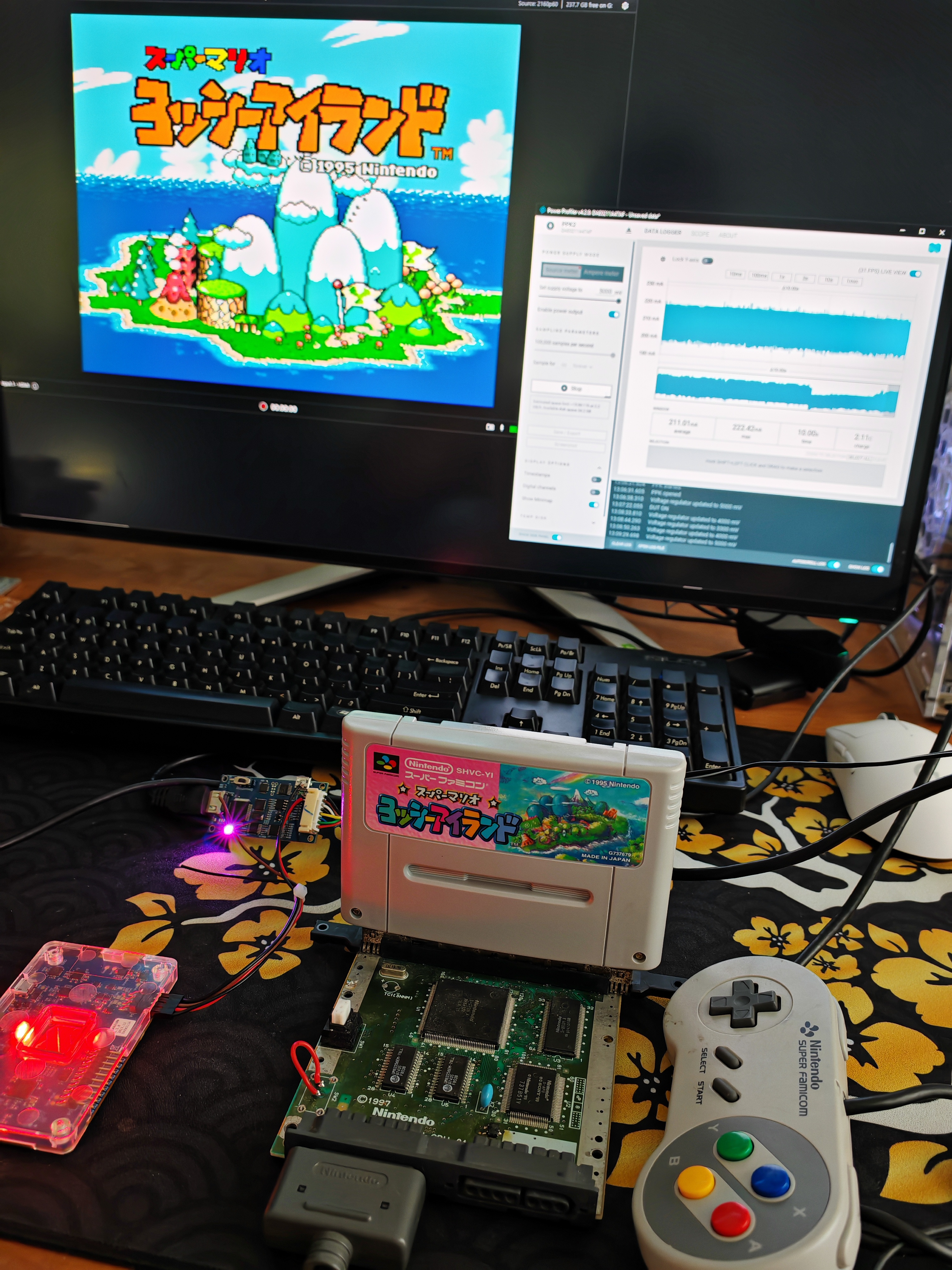

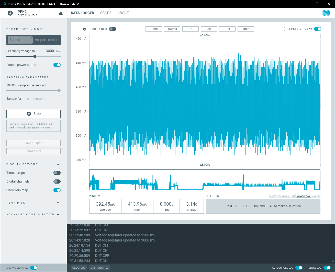

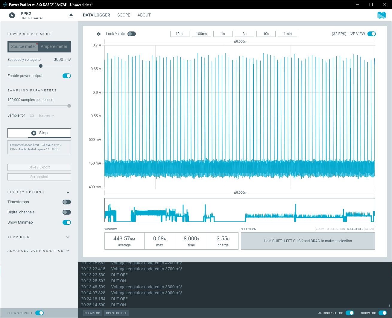

I undid all my unnecessary bodges, and did some power tests with the PPK2.
During these tests, I noticed that the screen was "wobbling" in a way that aligned with some nasty current transients on the PPK2 graph.
Those spikes are nearly 300mA! I immediately suspected the Wi-Fi block of the ESP8285, so I changed line 7211 of the Arduino sketch to disable Wi-Fi and the web UI entirely.
I also rewired my setup to use CSYNC (it was using CVBS as sync before. oops) and added a 68uF electrolytic cap to the output of the 2.5V regulator. These things not only fixed the wobble, but also eliminated the transients and reduced the power consumption by 150mW!
Here are the final power consumption numbers when scaling 240p->480p, with Wi-Fi disabled. This is the total input power to Shinobi Scaler 2, and doesn't include the screen or anything else.
  • 247mA @ 5V = 1.235W
  • 286mA @ 4.2V = 1.20W
  • 320mA @ 3.7V = 1.18W
  • 359mA @ 3.3V = 1.18W
  • 393mA @ 3.0V = 1.18W
The original Shinobi Scaler used 650mA @ 3.3V (2.15W). So this is a monumental improvement! With a small heatsink, the board only gets warm, instead of hot enough to burn you like Shinobi 1. I now feel comfortable integrating it into αSNES! Special thanks to @thedrew for doing initial GBS-8200 undervolt testing and inspiring me to revise Shinobi.
With some small code tweaks, I can switch between two video profiles on the fly using a pushbutton. One profile will be what's shown in this post (non-integer scale, screen filled) and another will be integer-scaled with scanlines. This way I get the best of both worlds and can toggle between them depending on the game. Also, Shinobi 2 takes ~8 seconds to boot up, so I will have to delay the LCD and SNES turning on for at least that long to avoid blue screen / video dropouts.

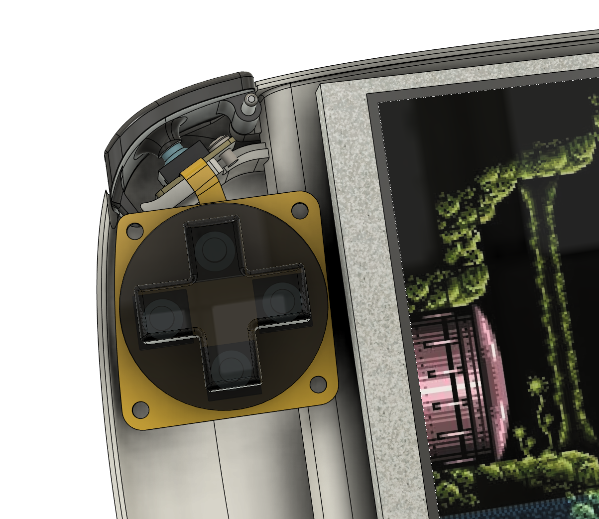

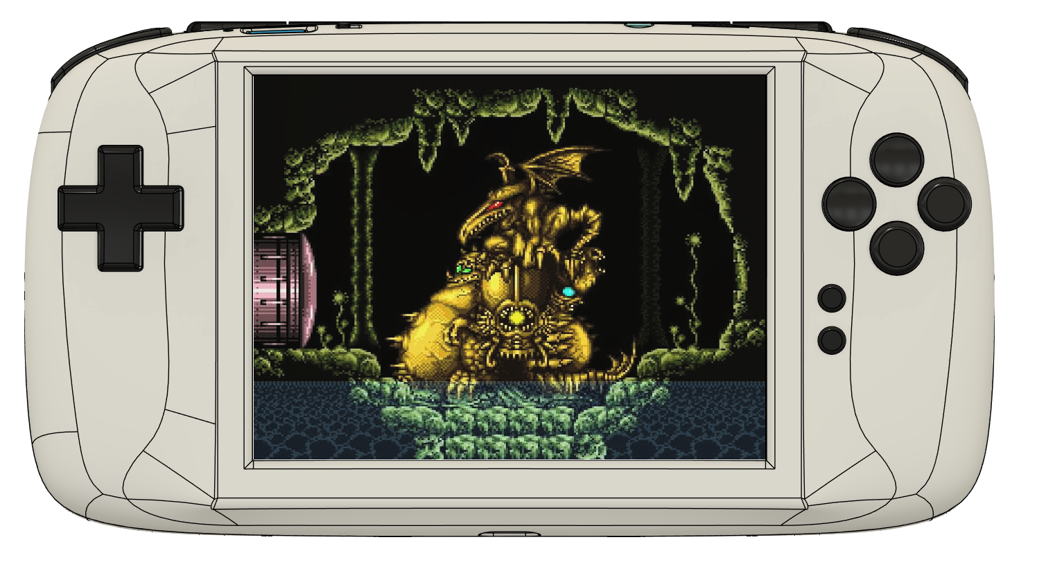

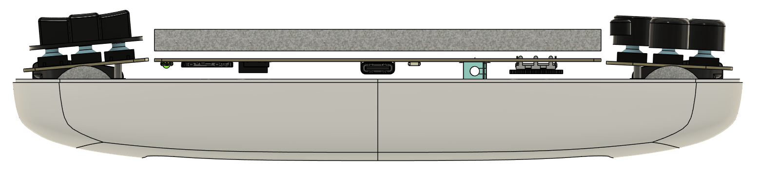

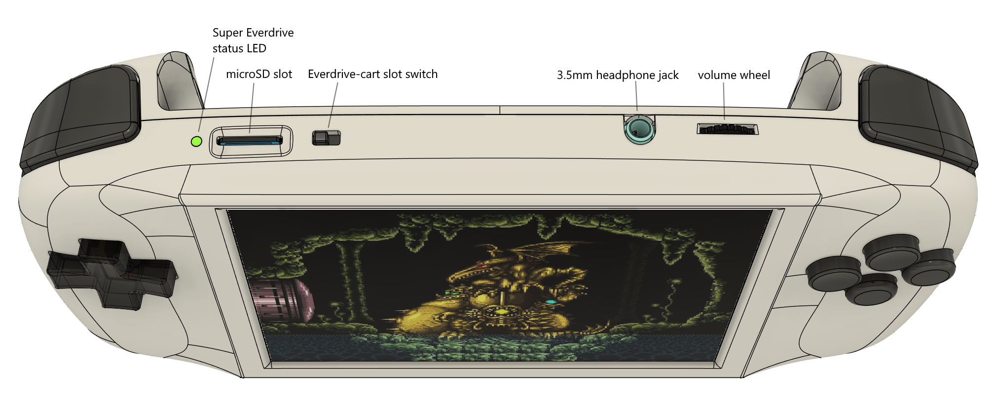

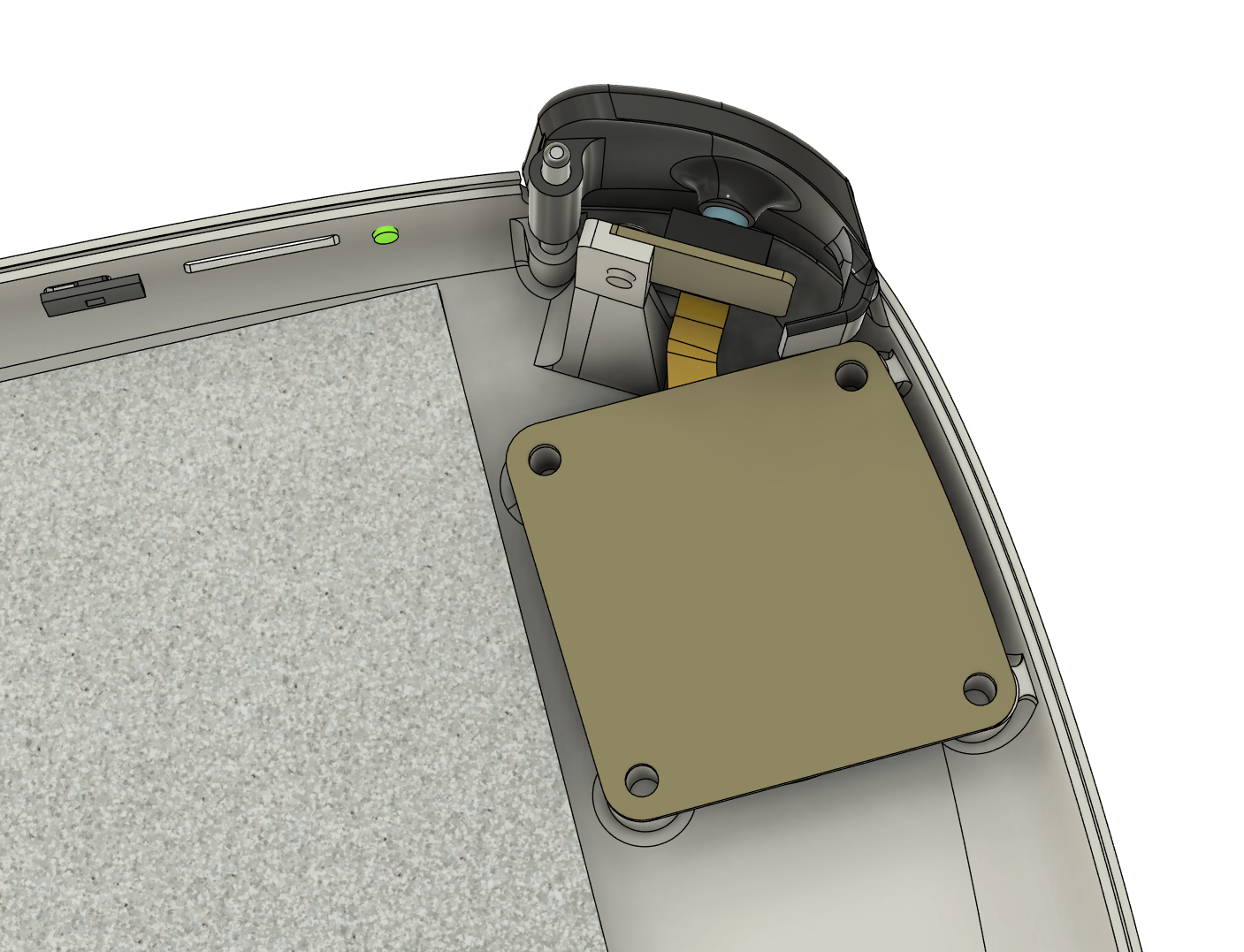

I've been working on the αSNES case CAD a little bit. The top IO is all done!

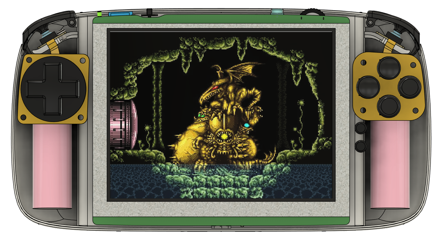

The triggers and controls are mostly done, too. I'm using a single flex PCB for each side, with 0.8mm FR4 stiffener to form a poor man's rigid-flex PCB. The flexes will connect to the mainboard via ZIFs.
The triggers are similar to the PS Hanami's and pivot on captive 2mm stainless steel rods. I haven't decided on the placement for Start and Select, but I'm leaning towards DS Lite style buttons.

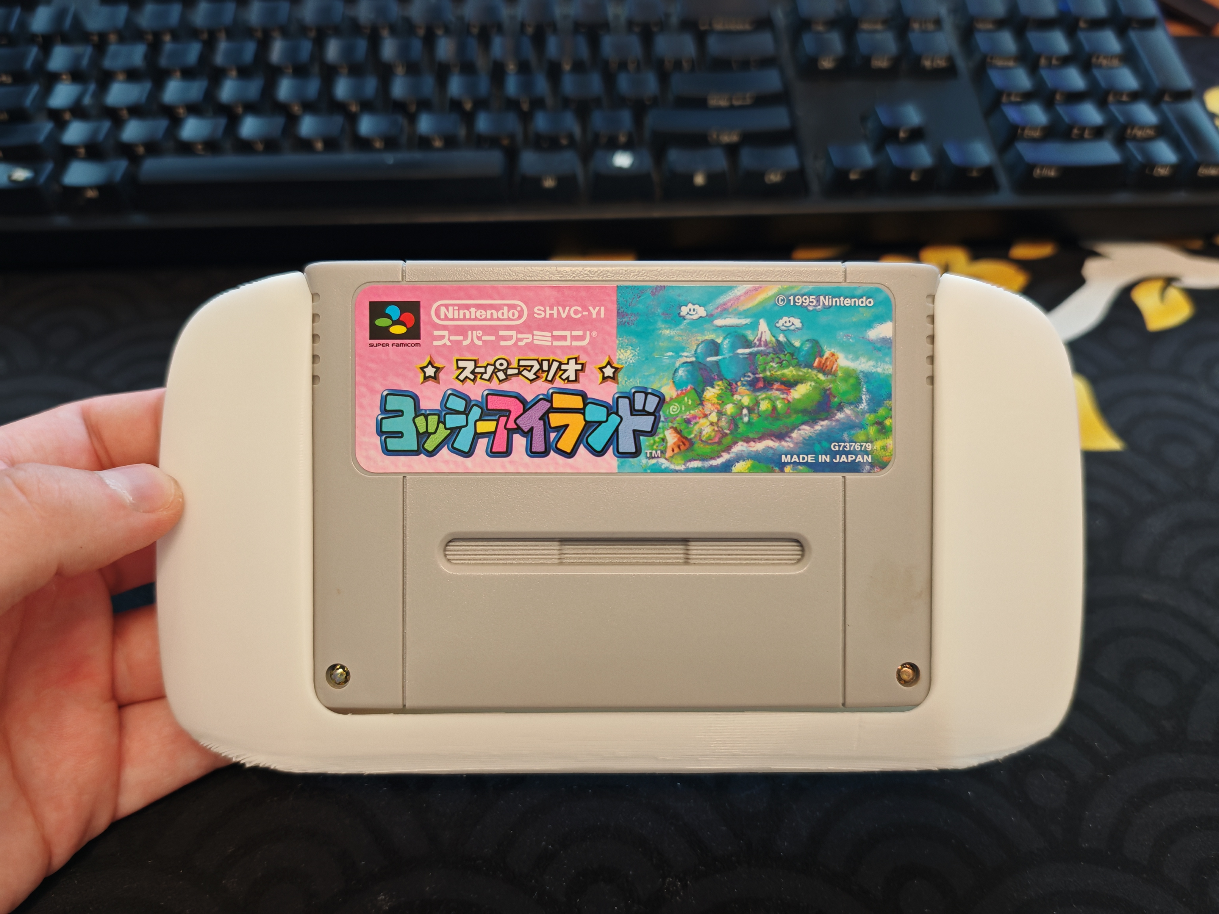

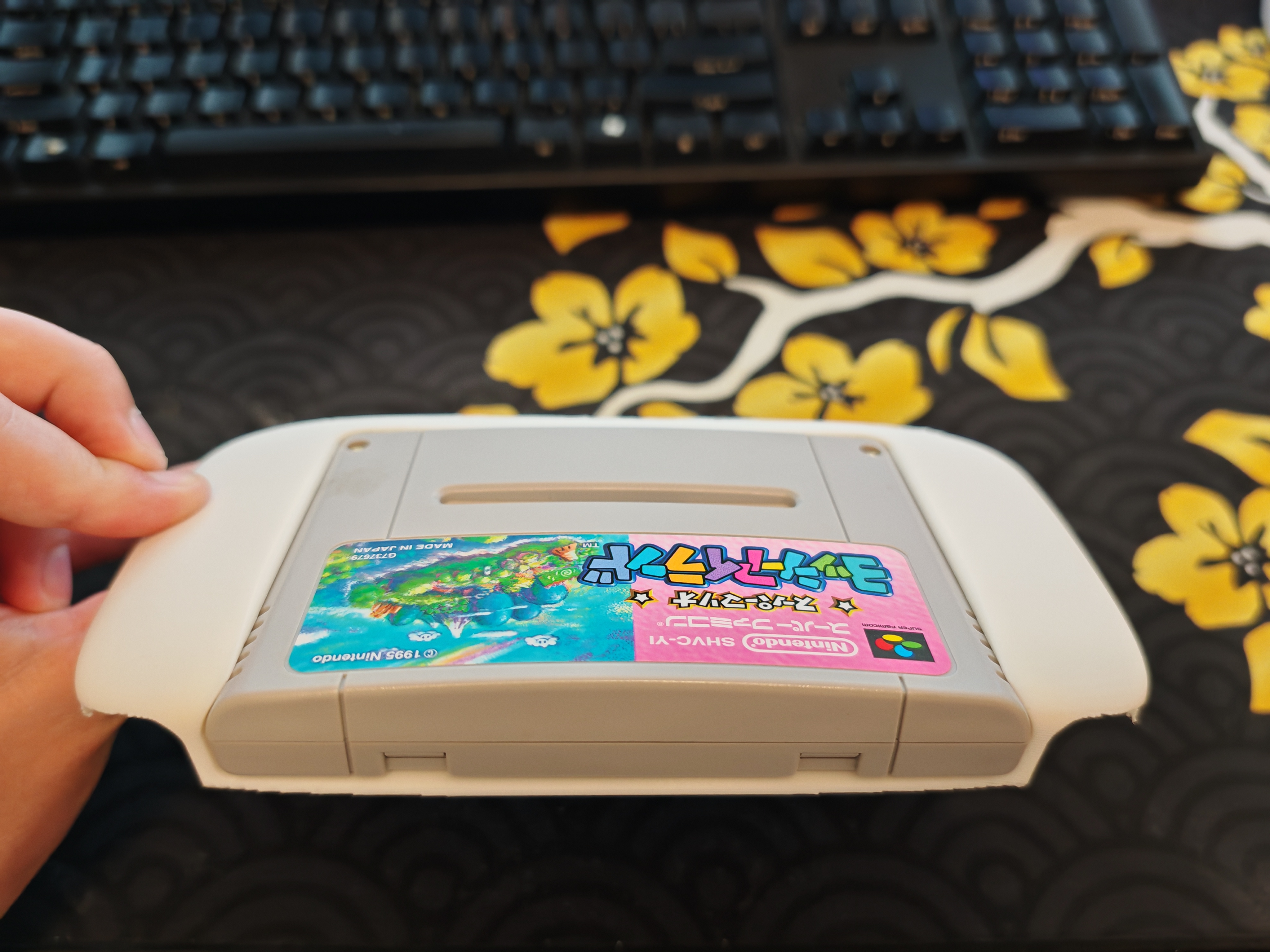

SFC carts fit snugly into the rear shell!

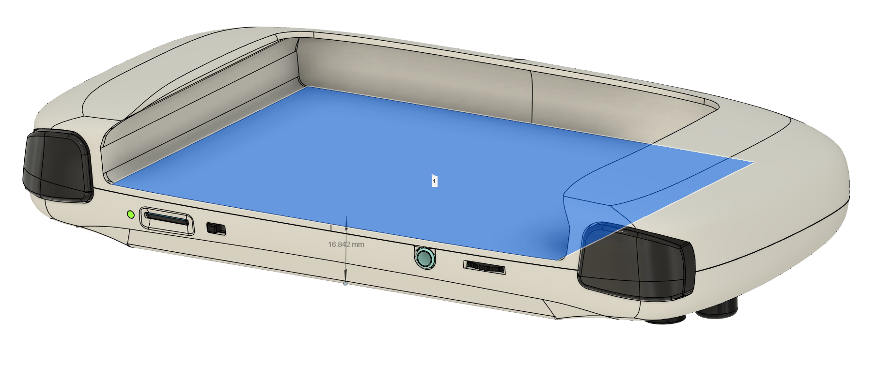

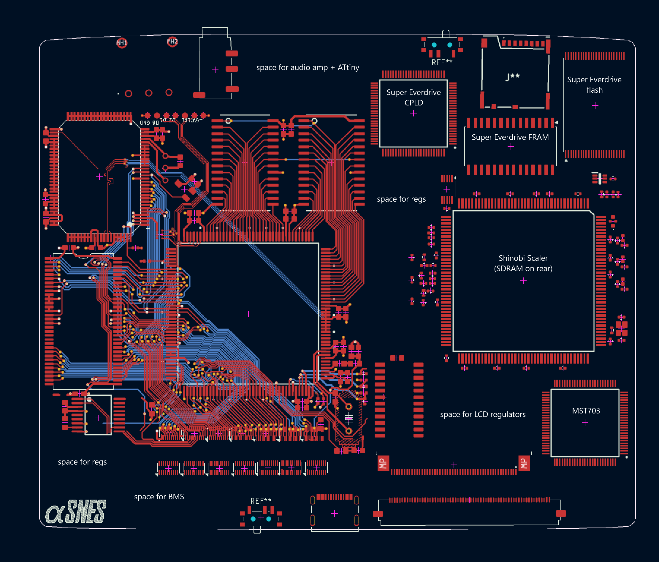

The fully integrated mainboard is going to be very tricky to route, but I think it's doable. 6 or 8 layers and JLC's tightest specs will be necessary to route everything optimally. The LCD and cart slot will also require custom flexes.
My work is cut out for me, but it's worth it to achieve the super thin form factor: less than 17mm in the middle section!

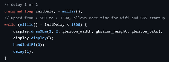

Last thing: when skimming through the GBS Control code, I found numerous second-long HARDCODED DELAYS that happen on startup.
Apparently they're Wi-Fi related. As I mentioned in my previous post, Shinobi 2 currently takes 8 seconds to start showing video. These hardcoded delays are clearly partially at fault for that. My Wifi-disabled GBS Control fork will strip out ALL such delays, as well as all the OLED communication, to decrease time-to-picture as much as possible.
