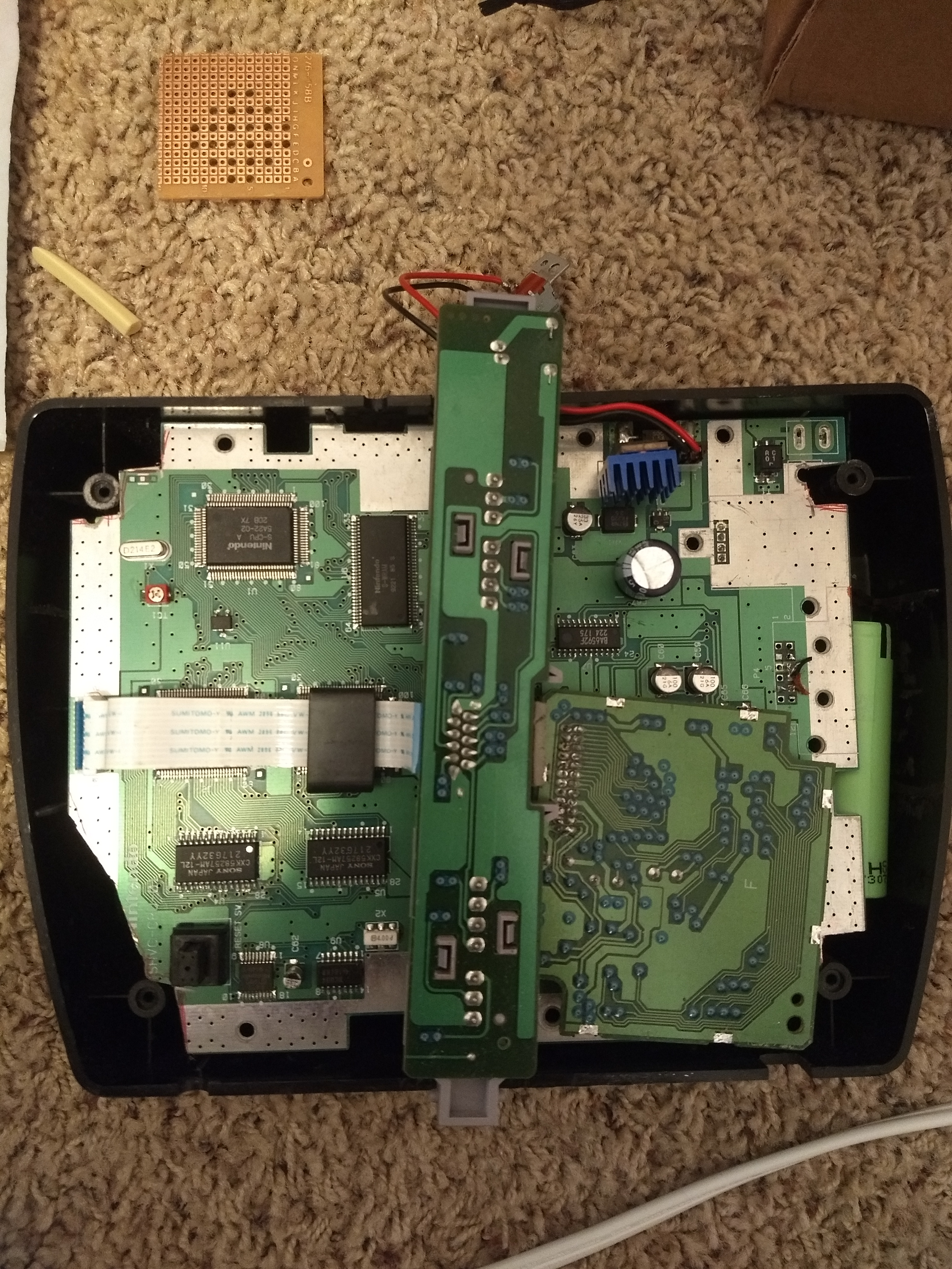

Made an oopsie... So I decided to finally cut out the pieces from the motherboard in order to make it able to fit around the screw posts. Just now realizing it would have been much much MUCH better and smarter to drill holes through the board and use the screw posts to hold the motherboard in place... It doesn't actually need to go down low like I thought it did, it would have been better for it to sit up there. So now I'm going to have to glue plastic pieces on to the motherboard so I can fasten it down. Oh boy I'm so smart some times...

Anybody know where I can find information on the power draws of an SNES like this? Will it run on 7.4v batteries? I can't find information anywhere, but I think the entire system might actually run on 5v? I really wish that right from the beginning I would have bought a Jr model (you can still get them from $50-75, and I would if I was rich, but I ain't) because there are SO many advantages, but that's not what I have, so unless someone tells me that there's a really important reason I should use a Jr, I won't.
Yes, the SNES can run off of 7.4v. The voltage line feeds directly into a 7805 step down regulator, so that’s why you heard 5v.
One of the board revisions (probably an early one) had a separate audio daughterboard that I think might require another voltage, but I don’t have any information on that. All I know is that when I tried to relocate one, I couldn’t get the SNES to boot anymore.
Edit: I just looked at your latest pic and saw that you do have the rev with the daughterboard. I’m not saying it’s impossible, but I recommend not trying to relocate it.
Well, lucky for me I already relocated it and it booted just fine B|, although that was with wall power, so we'll see if that changes once batteries are in play. Thanks for the info though! :D
