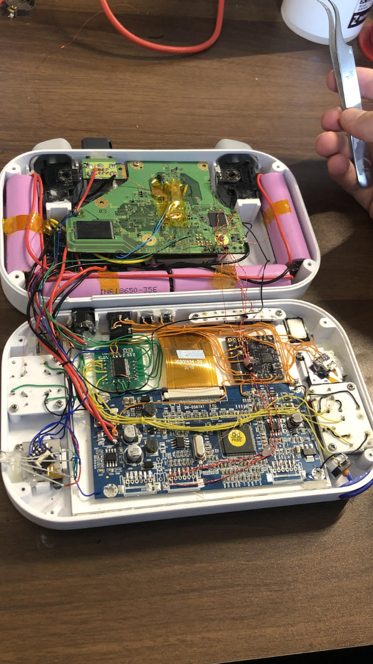

Ask for the noods and thou shall receive the noods. I also relocated the MX chip and RTC battery (not shown in this pic).
Great work! The internals look really clean, at least to me. Looks like a blast to play!
Thanks! Whenever I’m building, I always have the bad habit of starting the internals off looking really well, and then I’ll just try and rush it at the end so I can play it quickly. Woops.
