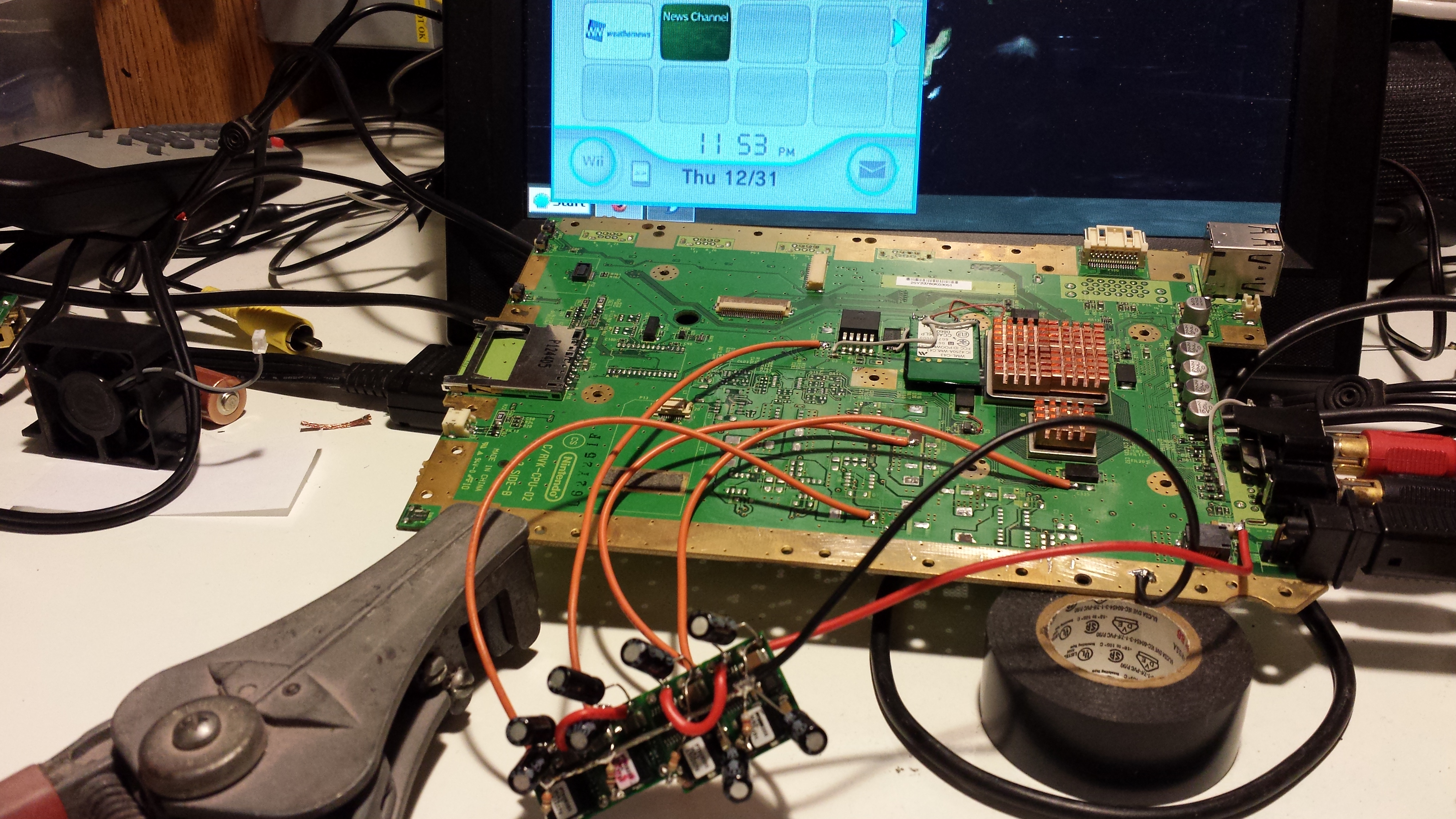

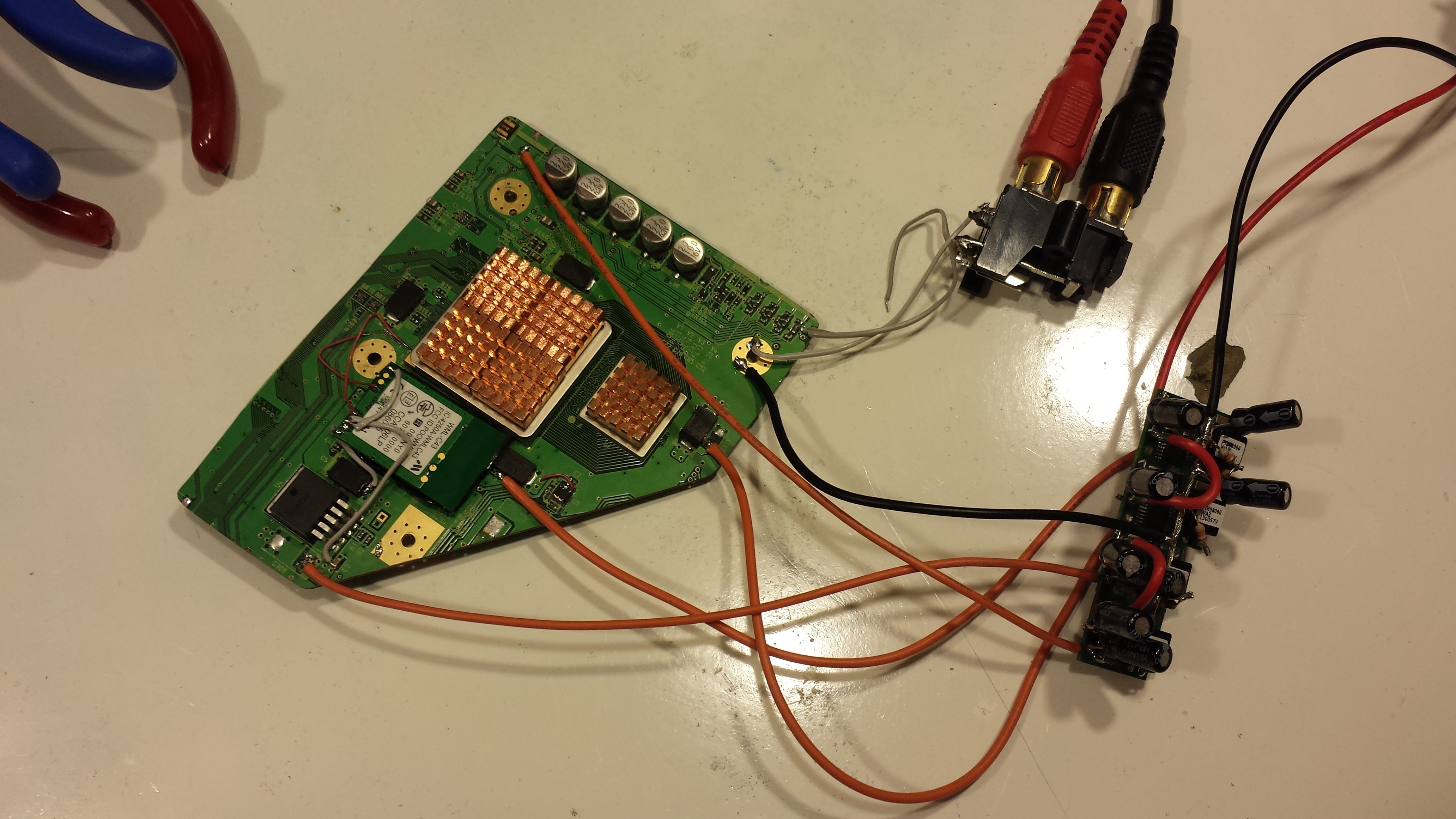

Custom regs. Output caps because bentomo peer pressured me.
Forreal tho, this basically confirms the OMGWTF trim, short of actually cutting the board.
The only think holding me up now is not having a wiimote, so I can do homebrew junk.

With this current setup, I shouldn't, because I don't think 12v is connected to the rest of the board, and it's required on the preamp. But I could just as easily tap off of the alternate points and get that back without doing additional work.

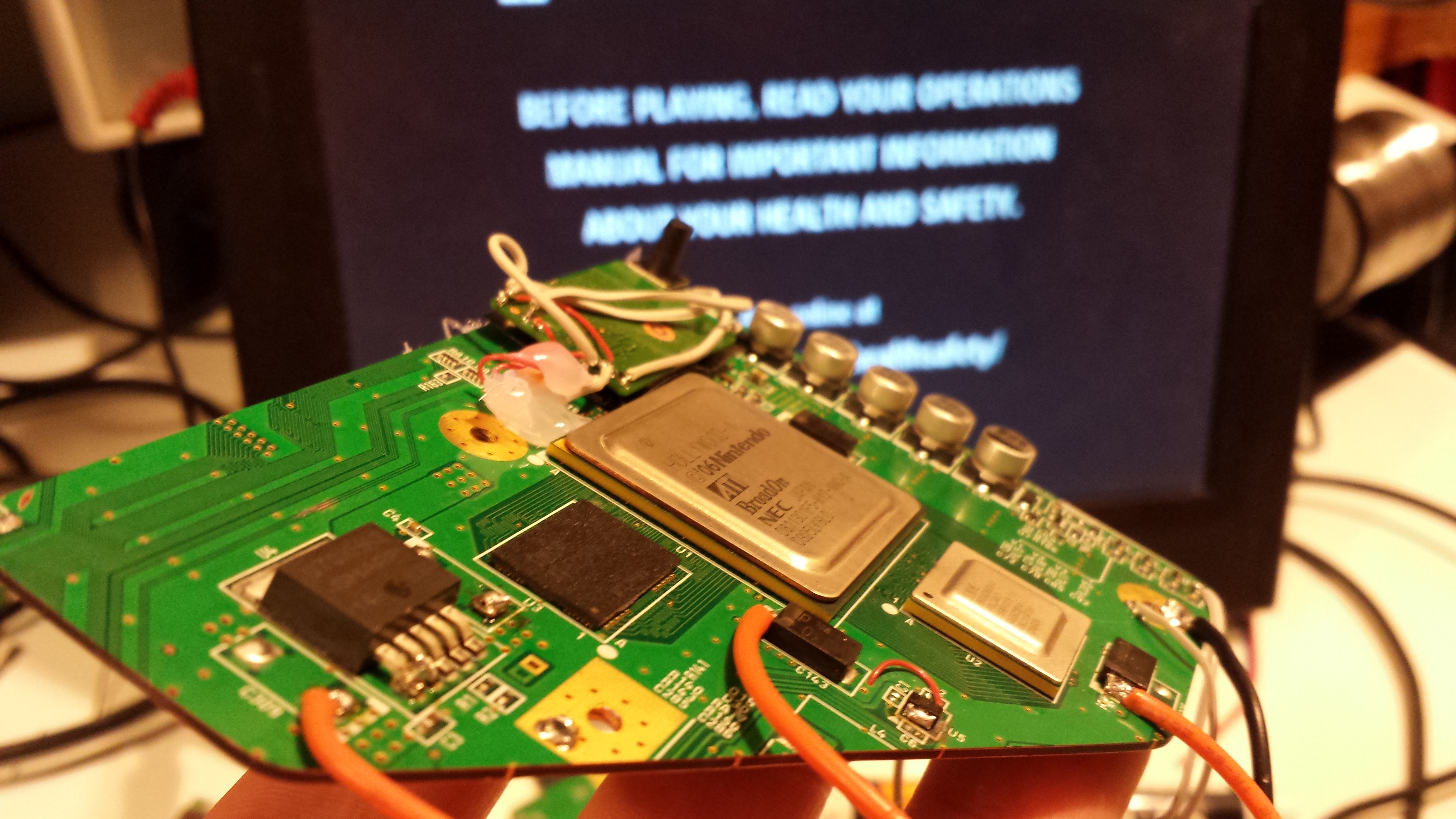

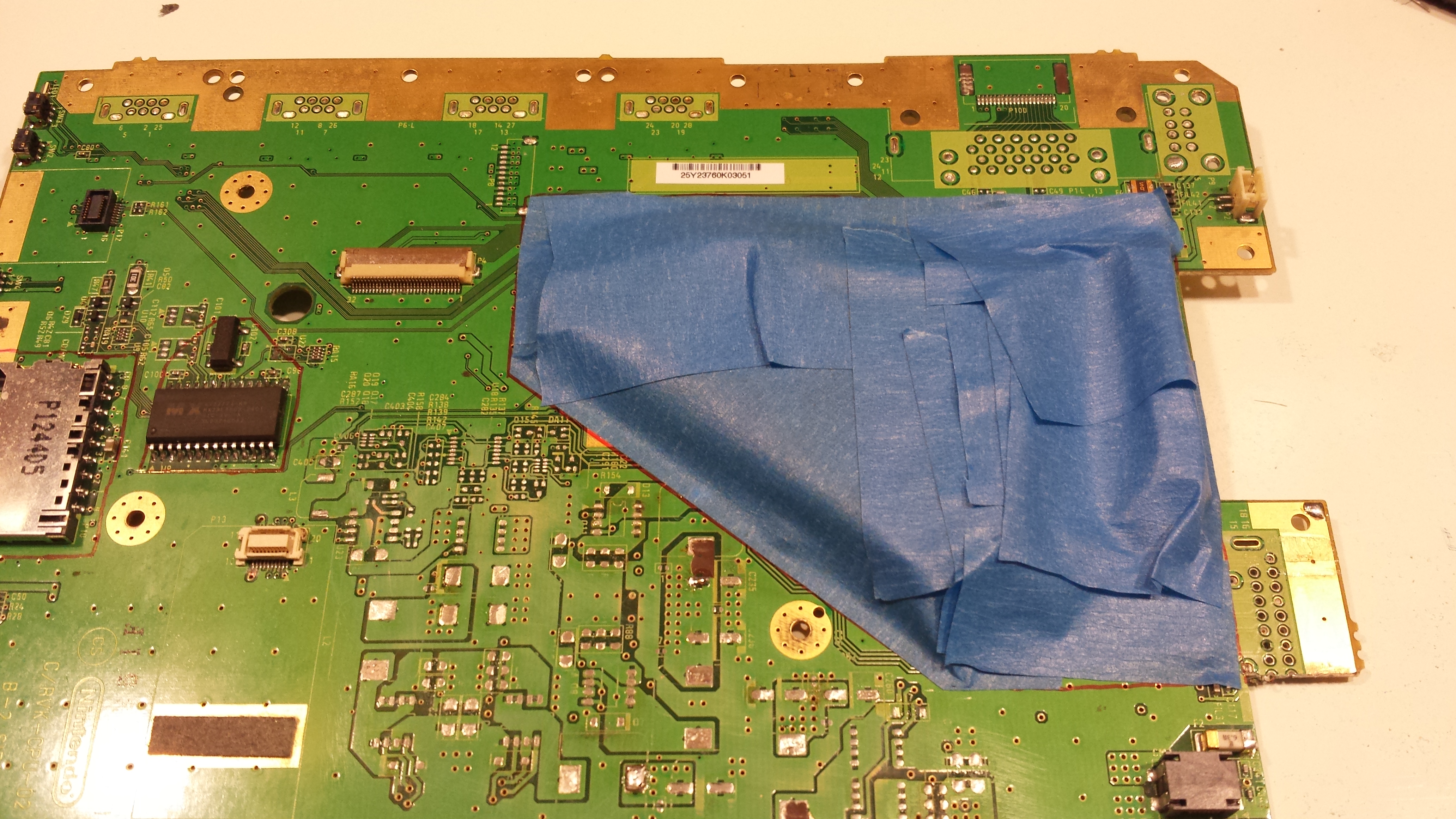

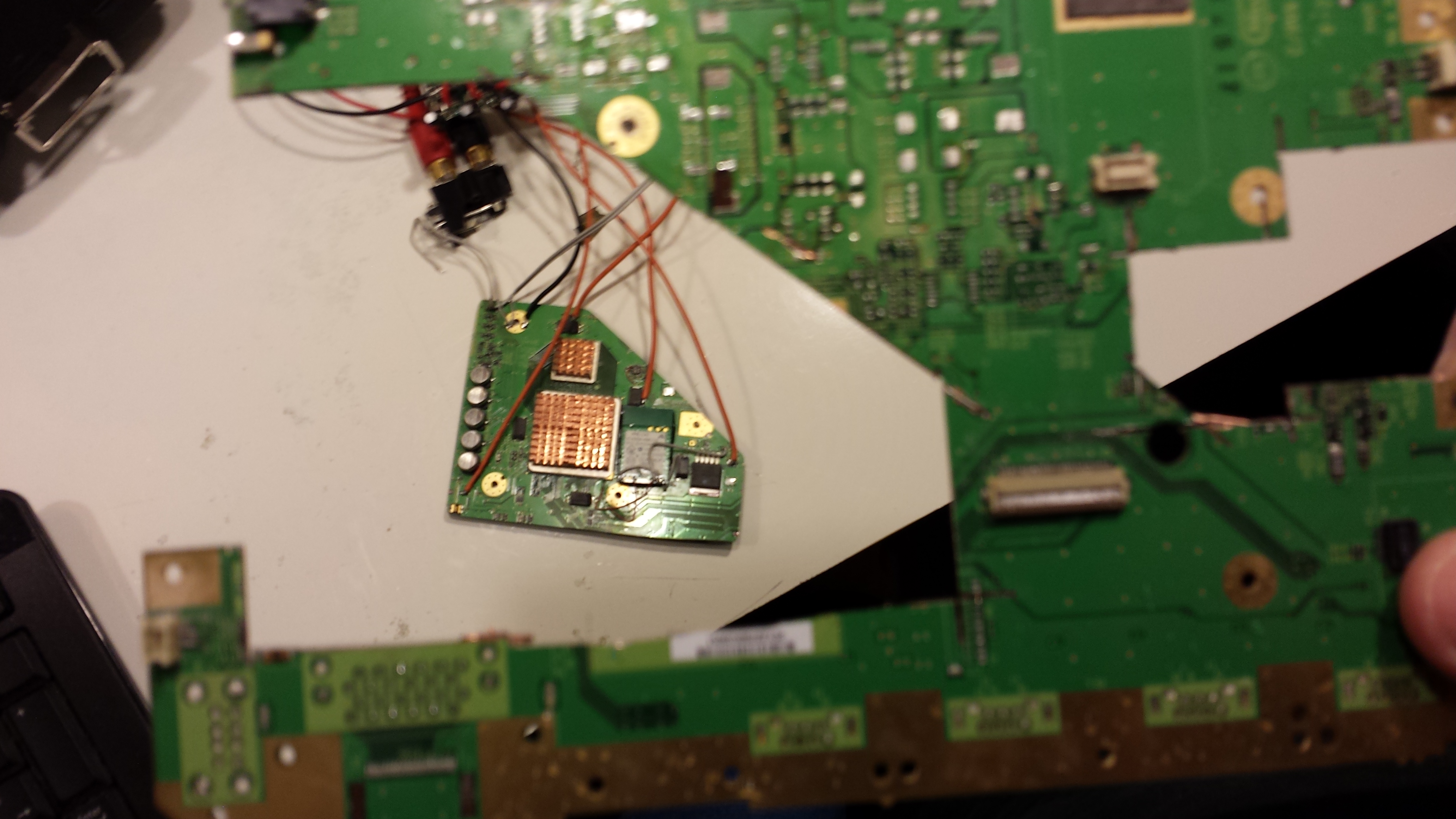

Woo! Finally the credit card cut!

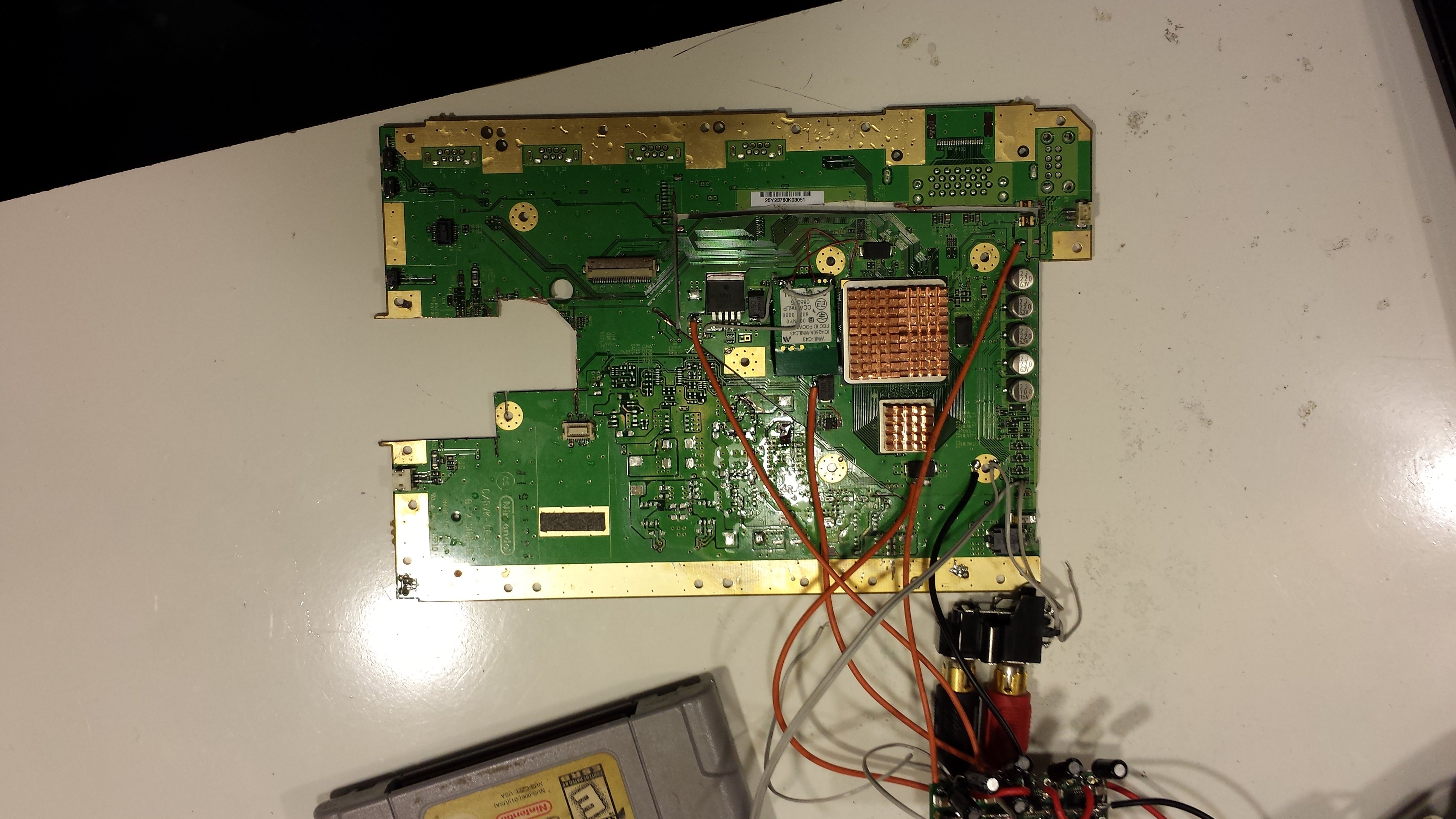

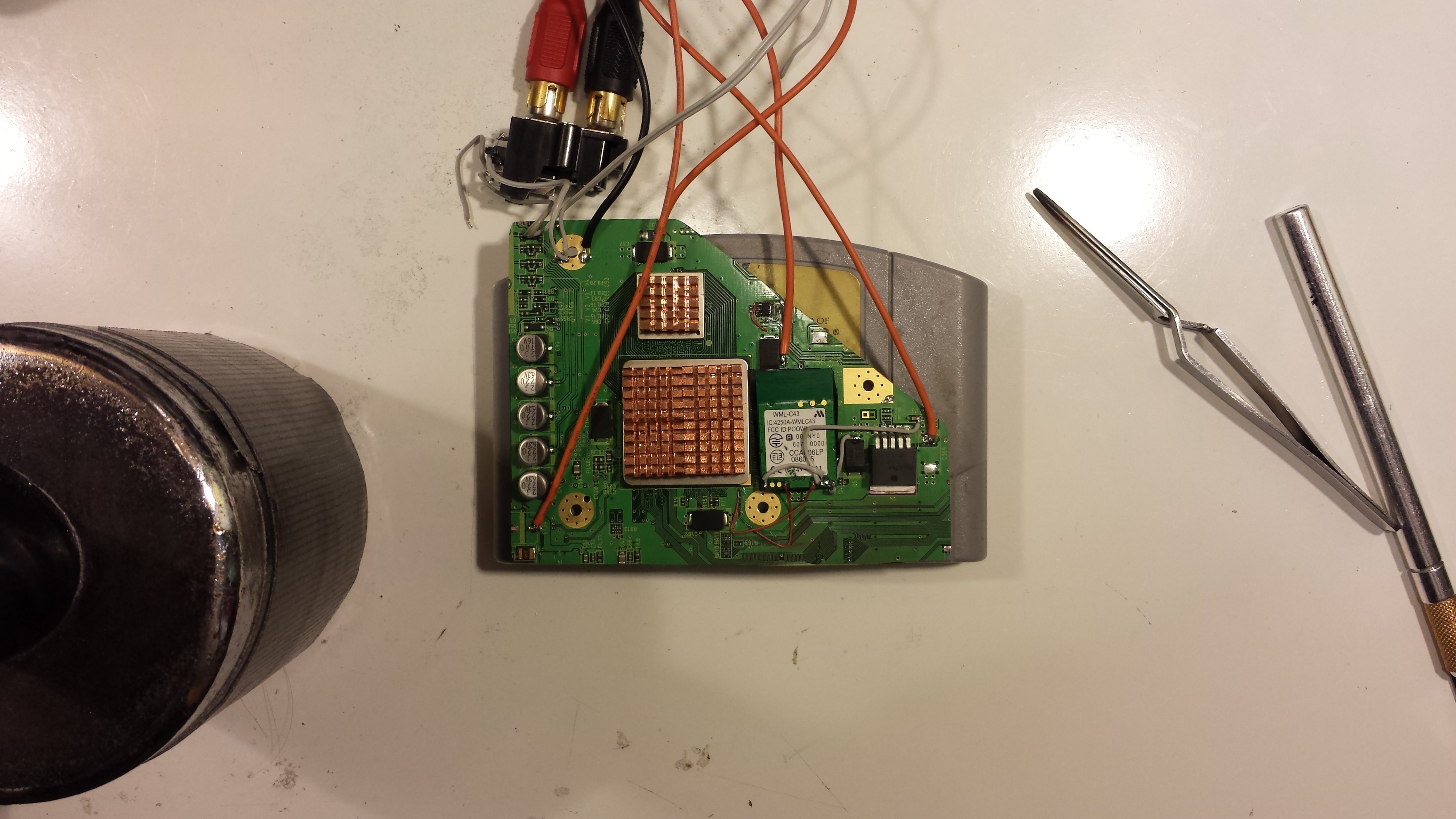

The best part is it can get quite a bit smaller in each direction, with a little tweaking of course. I'll be soldering up the SD and USB later, as well as the MX(just to test that the relocation works.)

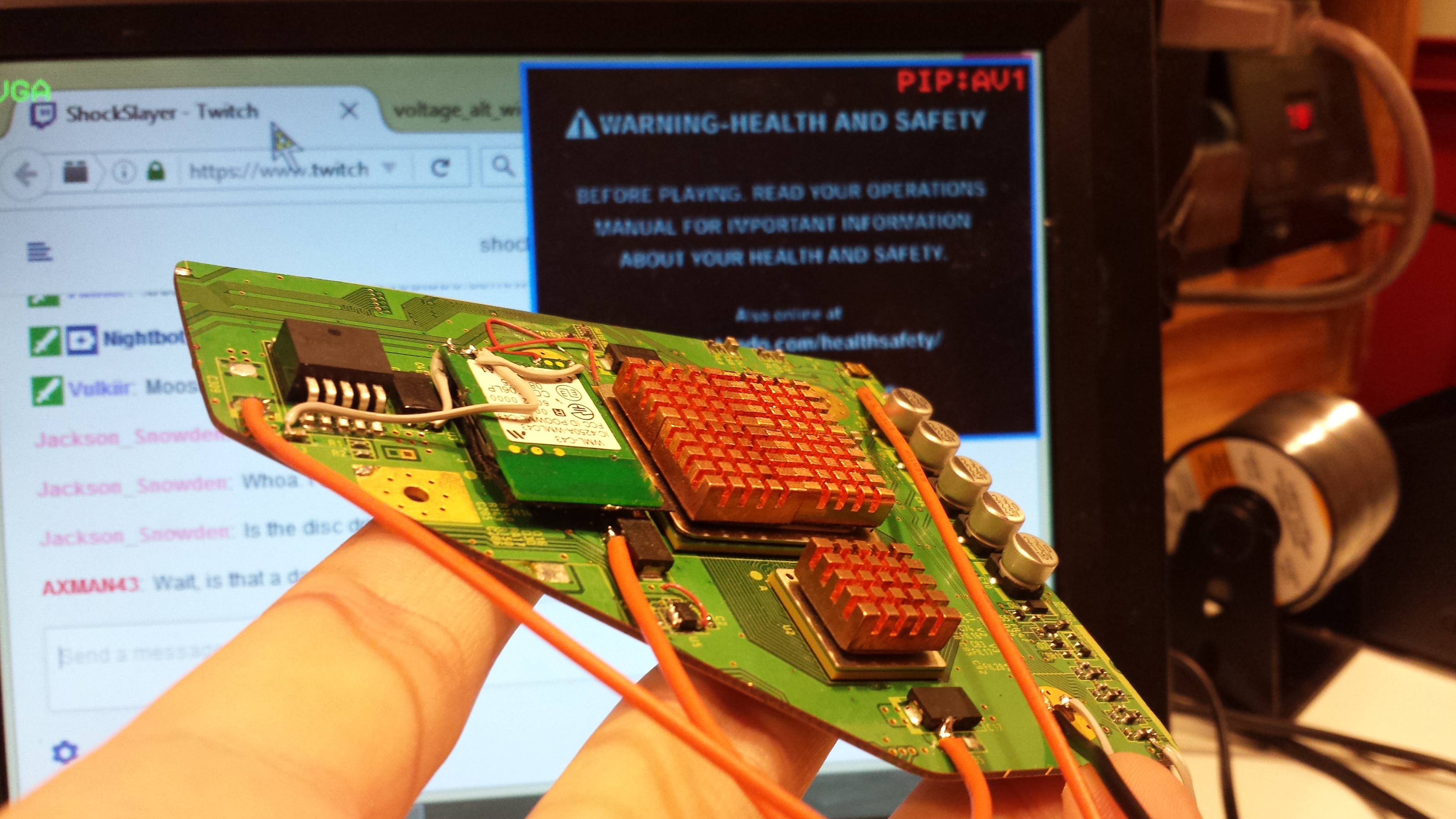

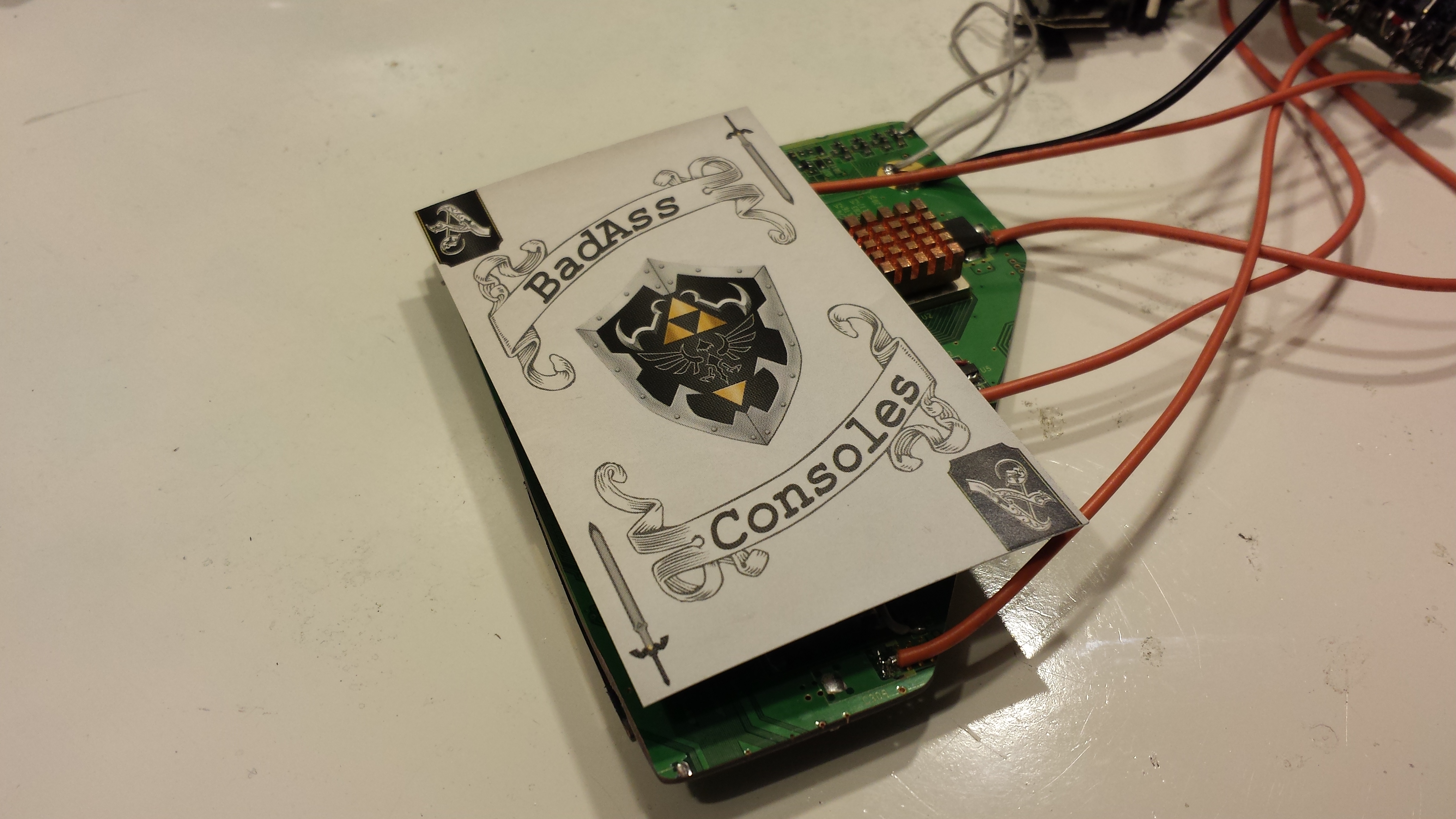

Have some additional pictures to celebrate the new age of portablizing:

Ive worked so hard and waited so long for this. Thank you for making it a reality. Cheese, Gman, Mega, Jackson, Zenloc, Shockslayer, Bentomo, JacksonS... It took everyones contributions to make this happen. Everybody deserves recognition.
All our hard work has finally paid off. A new era of portablizing is upon us.
The part I like the most is that you have only like 6 wires to get it all working, that will greatly simplify everything. My only question is how hot do those small heatsinks get... Besides that, I can't wait to do this trim myself! Good luck on this portable (though you probably don't need it :P)
You're absolutely right; in order to get the board to boot like this, all you need is custom regs, wifi, bluetooth, and U10 relocated. Granted, you technically also need SD/USB to be able to boot games(unless you're making the world's smallest VC), but that's a walk in the park compared to what's already done.
I have no idea about the actual performance of these heatsinks...because I don't have a wiimote, or homebrew...or any way to play games at all for that matter. So I can't stress test this by any means. However, I feel fairly confident that as long as I have a fan, this should be adequate. If not, I've got a lot of options, including some parts that I've stored away for this specific endeavor for years. We'll figure this out too.

Did a CPU-40 board this morning and confirmed the trim works for that too. Granted we sort've already knew that, but hey! Here it is.
