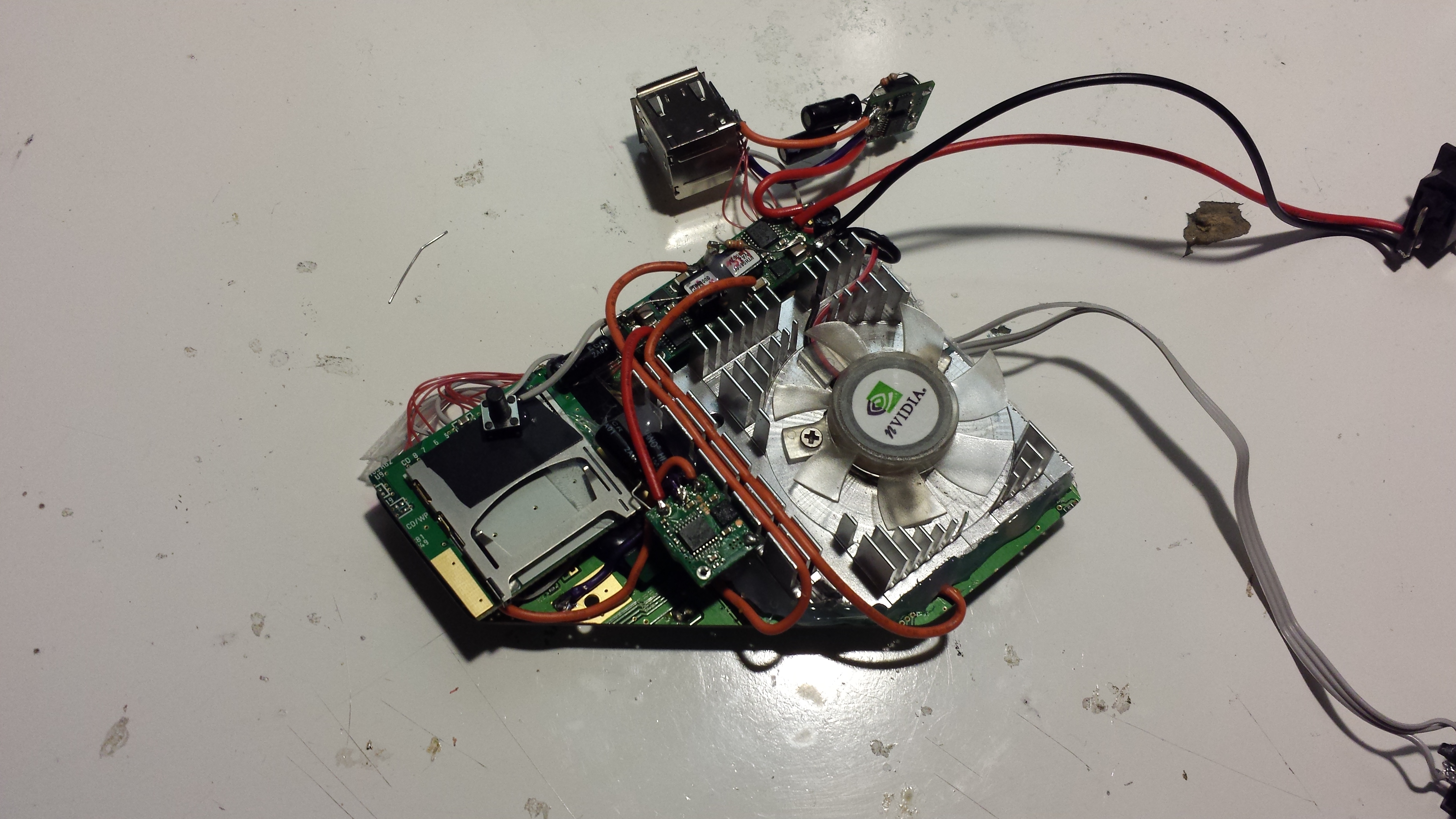

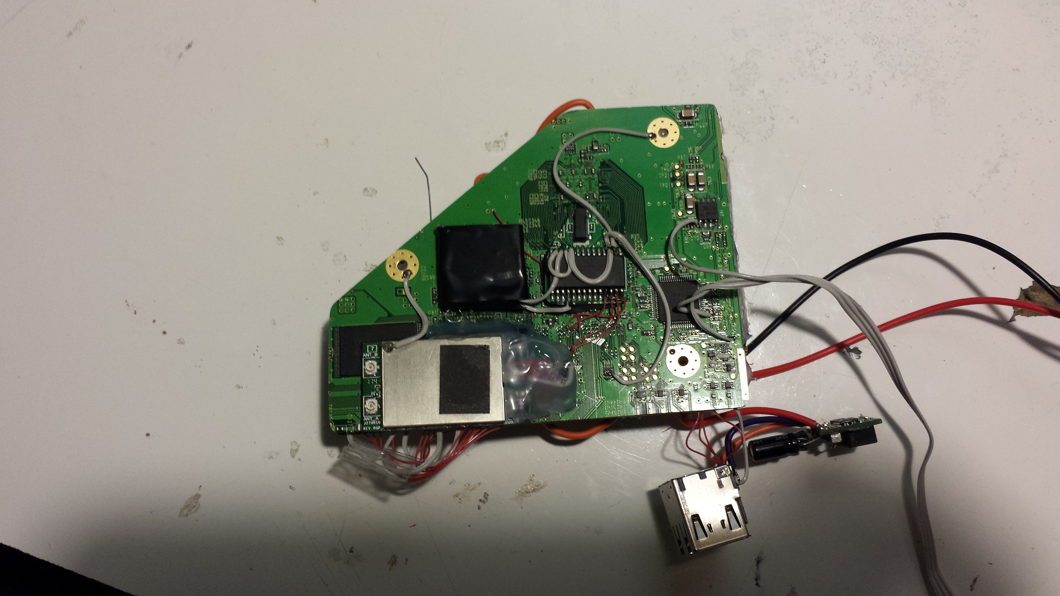

Ghosts SSWiiT Revitalized
@ShockSlayer make a regulator guide so I can do this pls
The nice thing is that the regular PTH08080's work for all the voltage lines.
All my wires were the same length at all times. It's distance that seems to matter.
Literally did everything I could without a wiimote. I'M READY
With this setup clock keeps time. Last thing to test is GC fonts, and then the guide goes live.
Clock kept time for awhile, checked later and it was wrong(well, it had stopped rather.) Turns out the battery voltage dropped by an entire volt. Swapped it out, we'll see how it does!

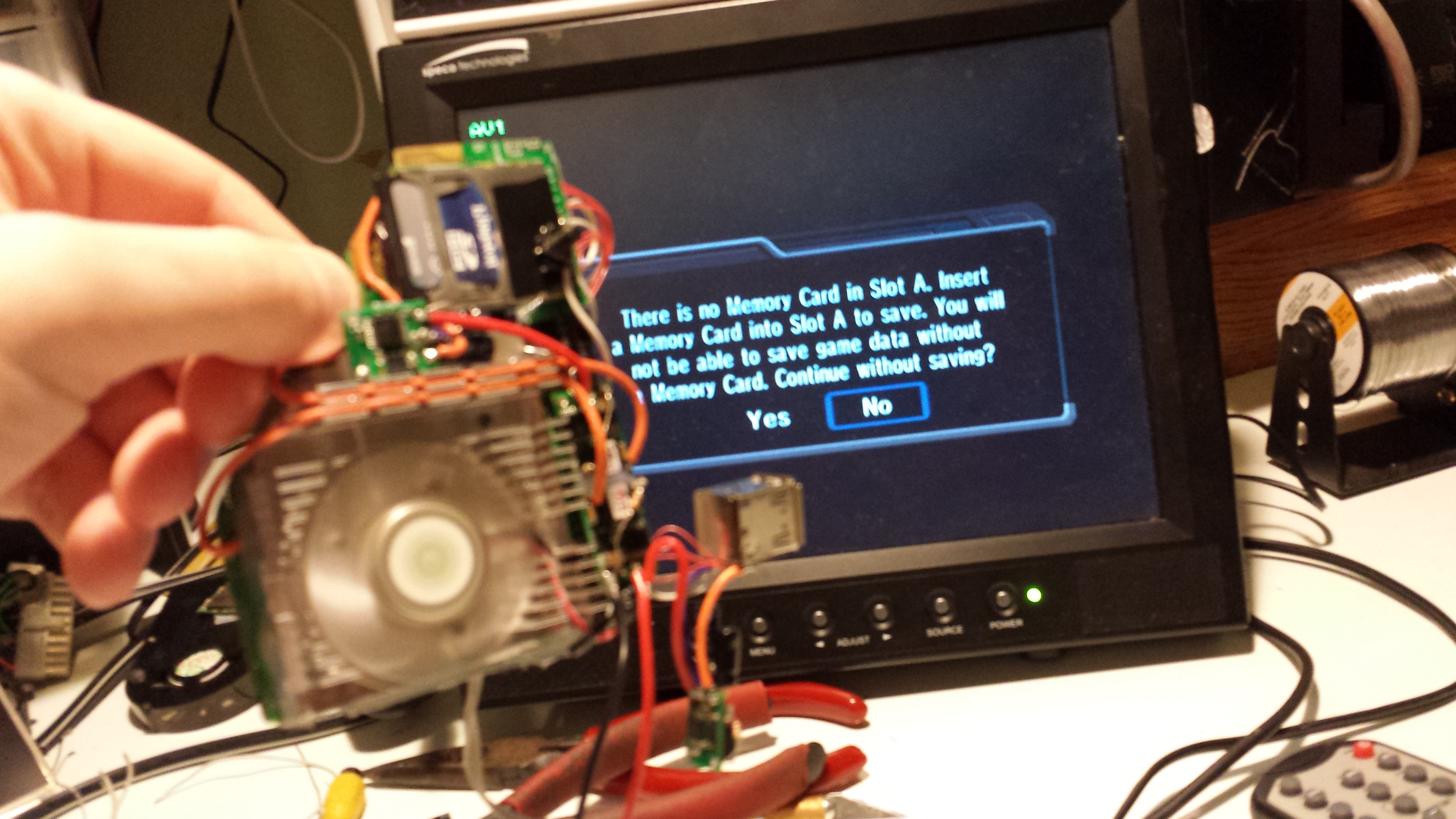

Grabbed latest version of nintendont and got it working from this guide
Did not take me longer than 10 minutes at the most, spent more time copying ISO
Loaded starfox from SD to test font data, worked first try.
Was this supposed to be hard or did I miss something

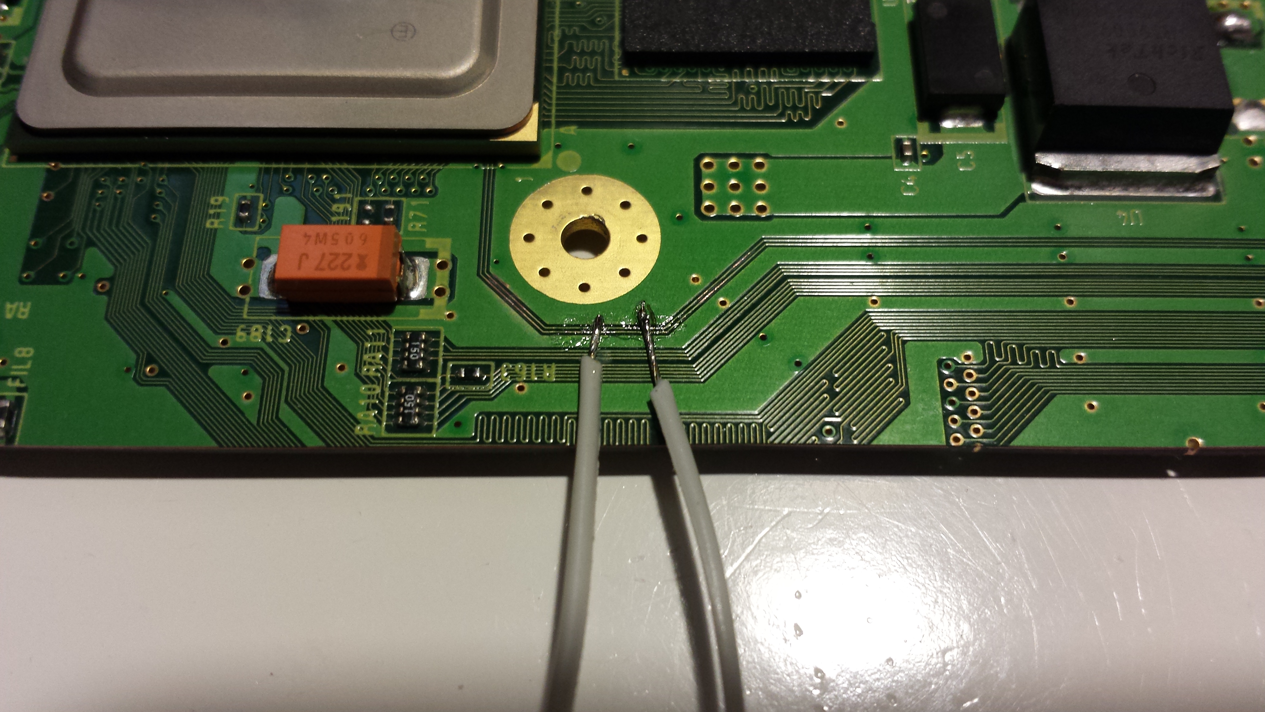

I call this technique kektooth wiring
100% continuity and no bridging. Standard multi-strand IDE wire.
