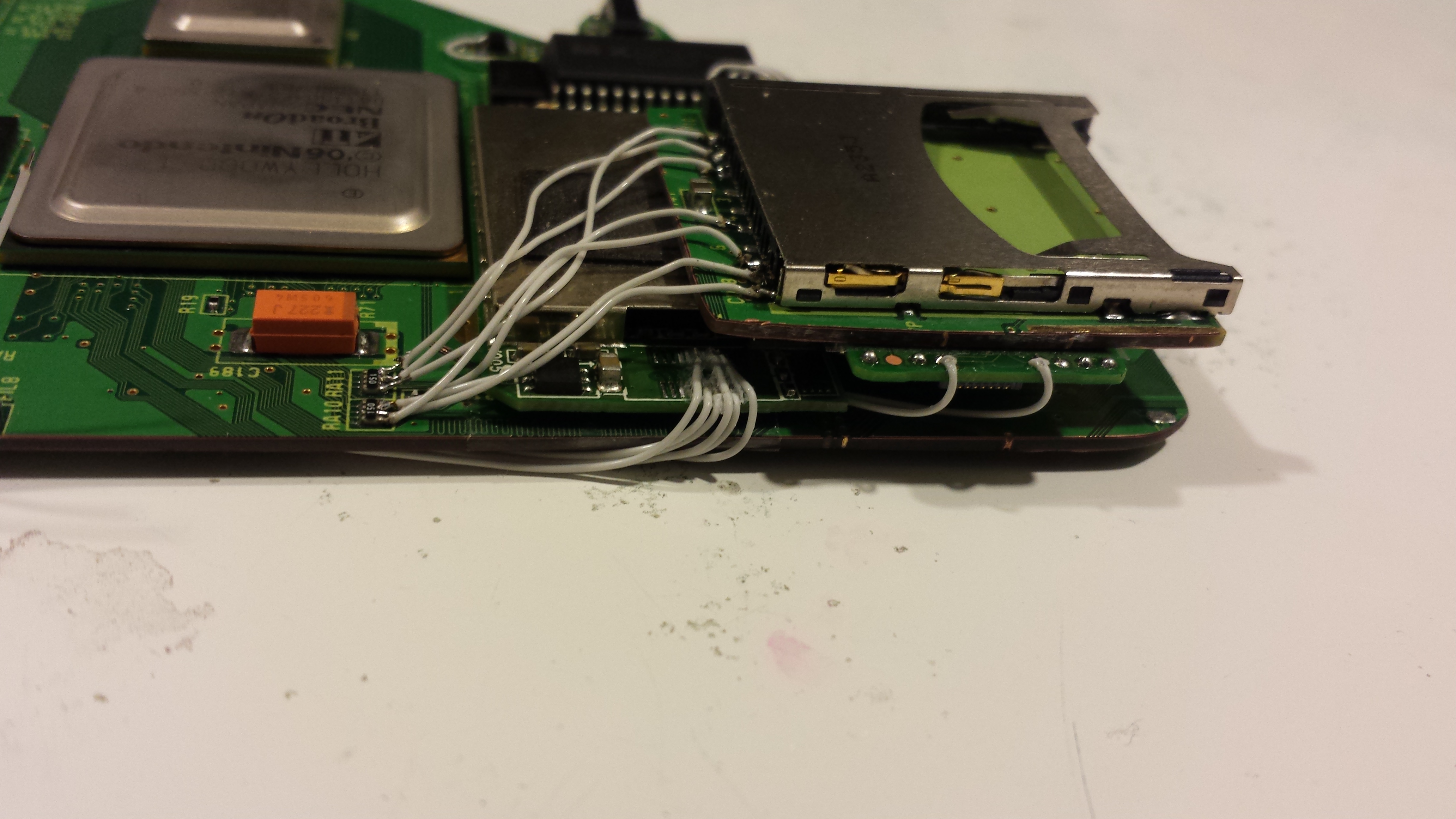

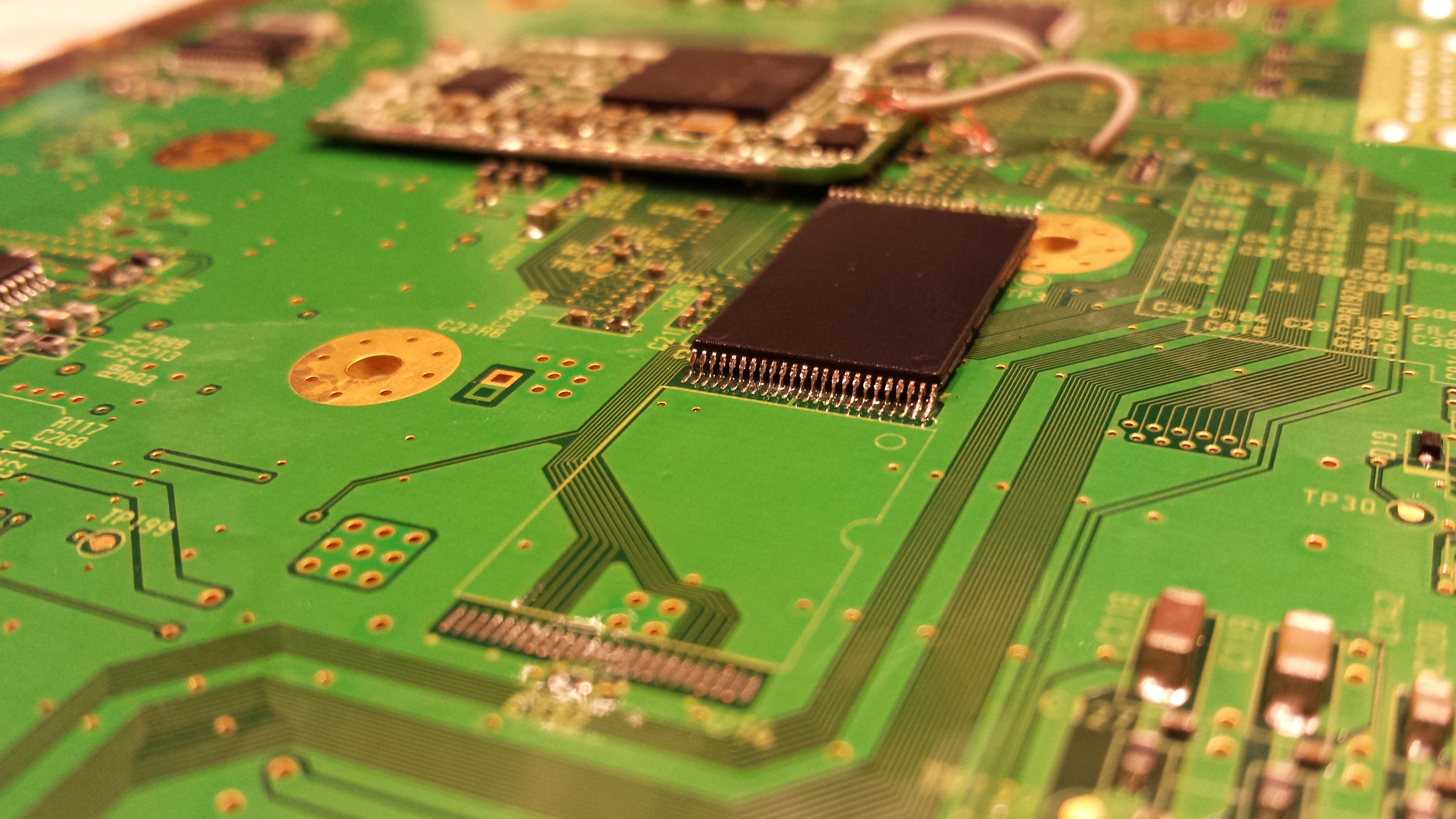

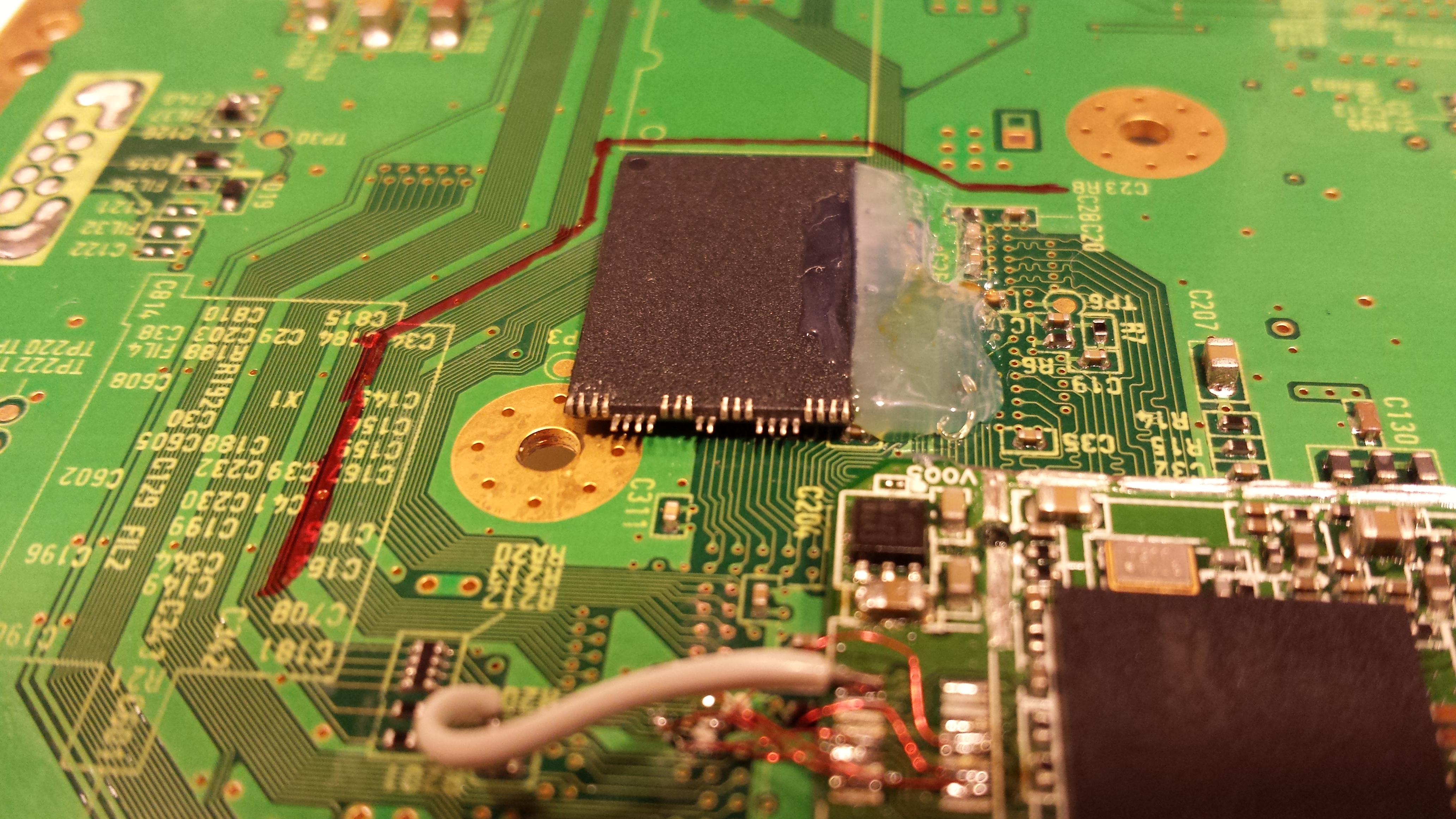

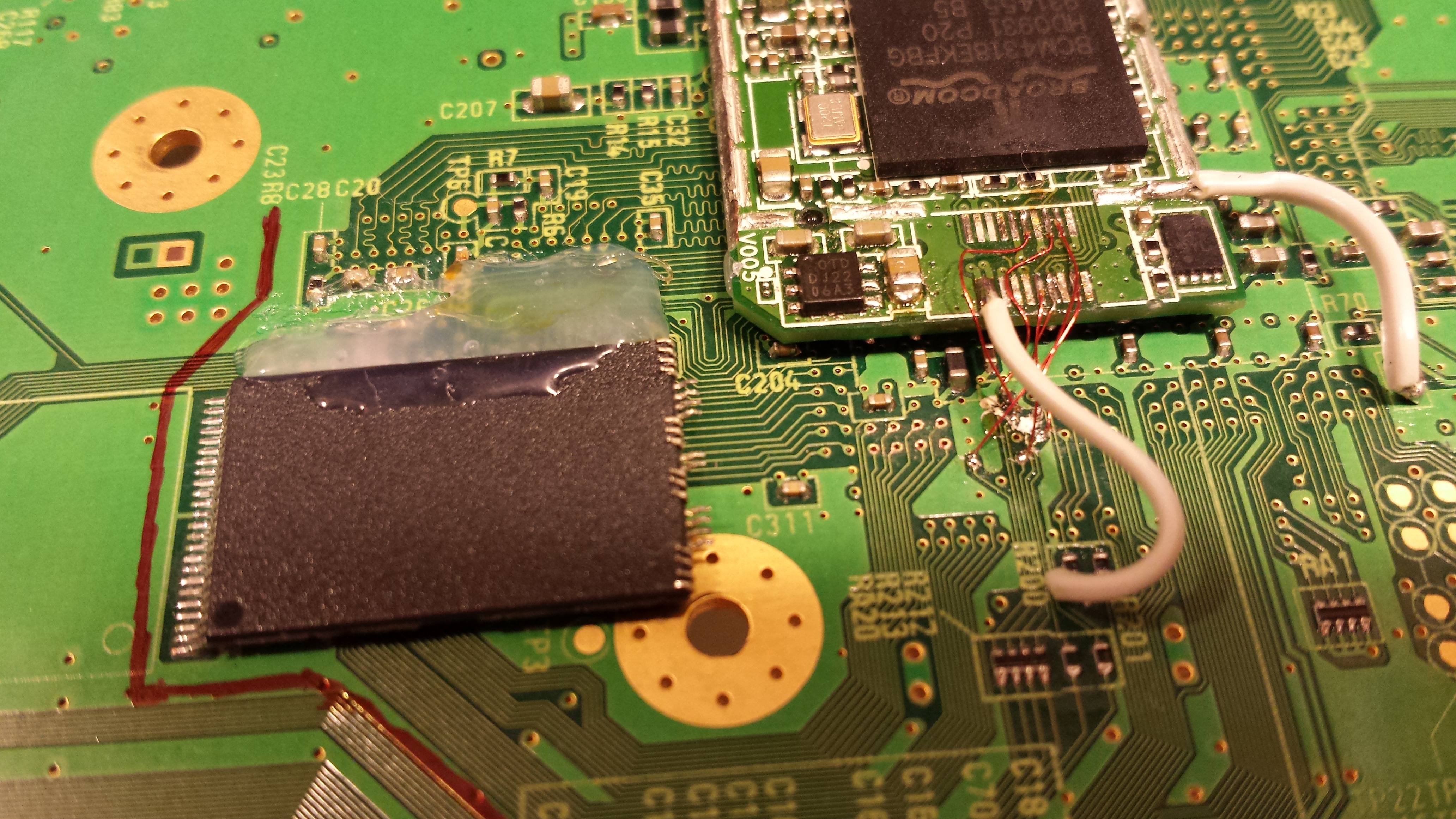

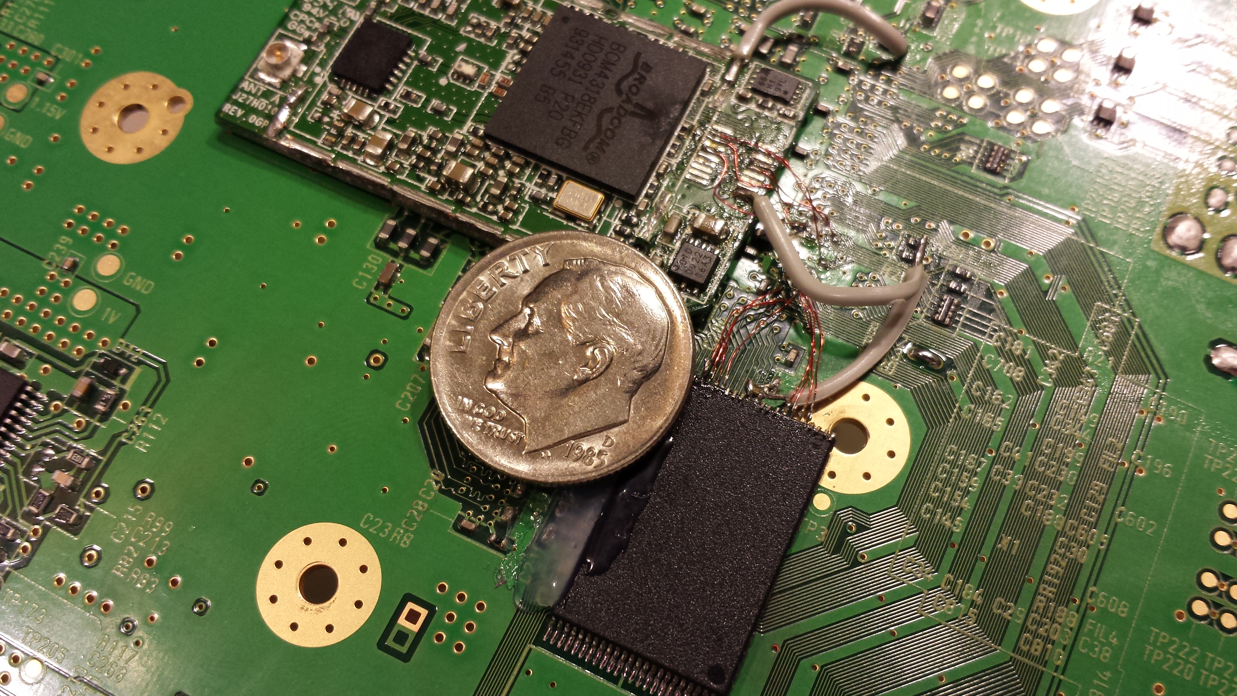

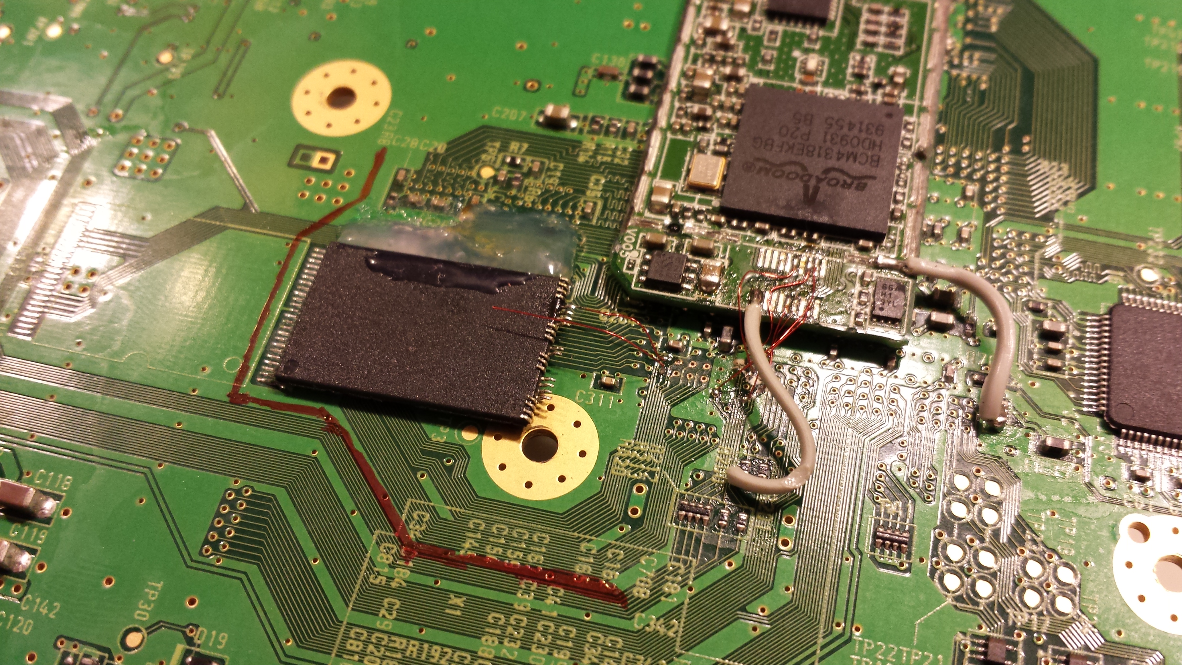

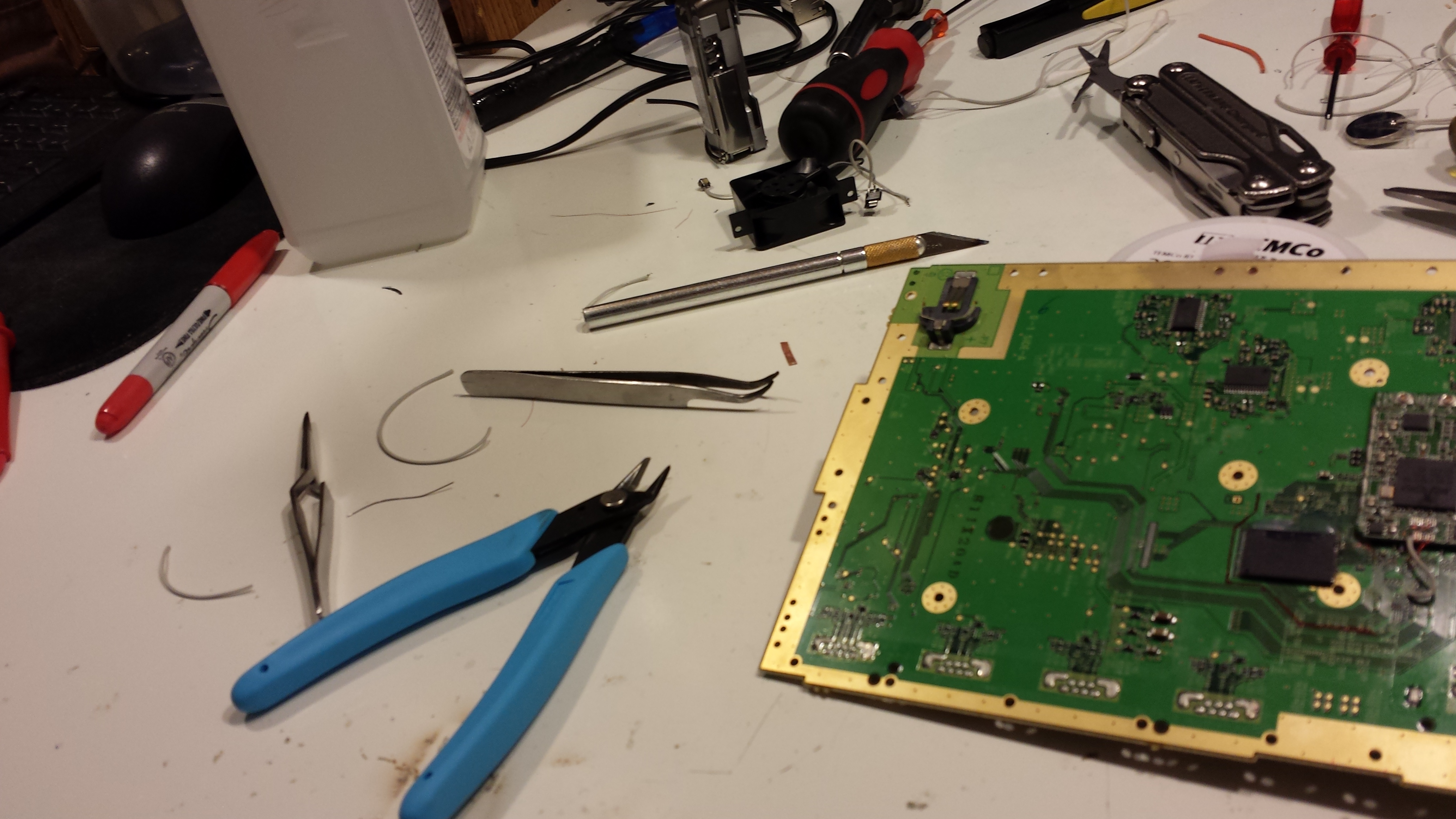

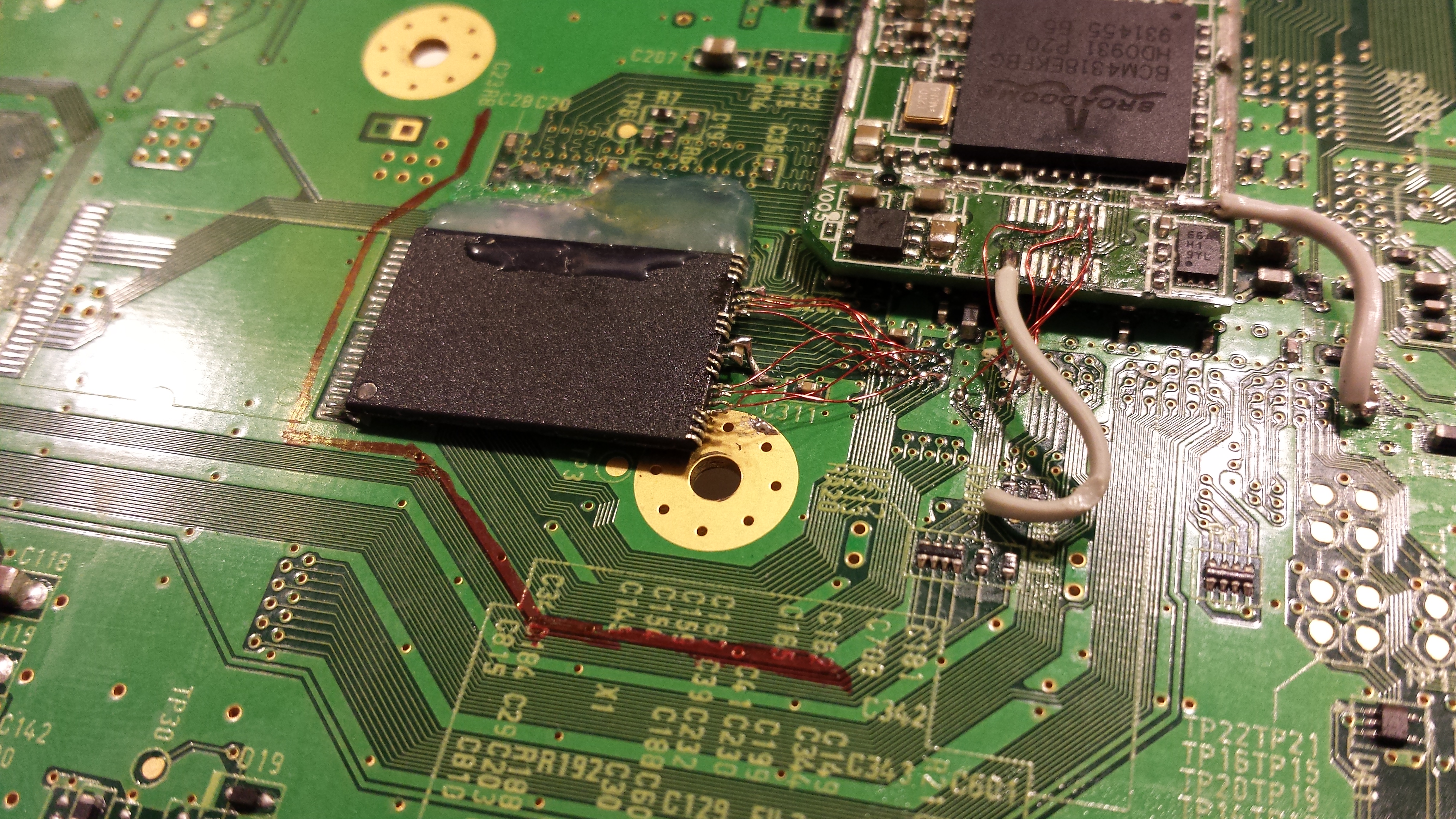

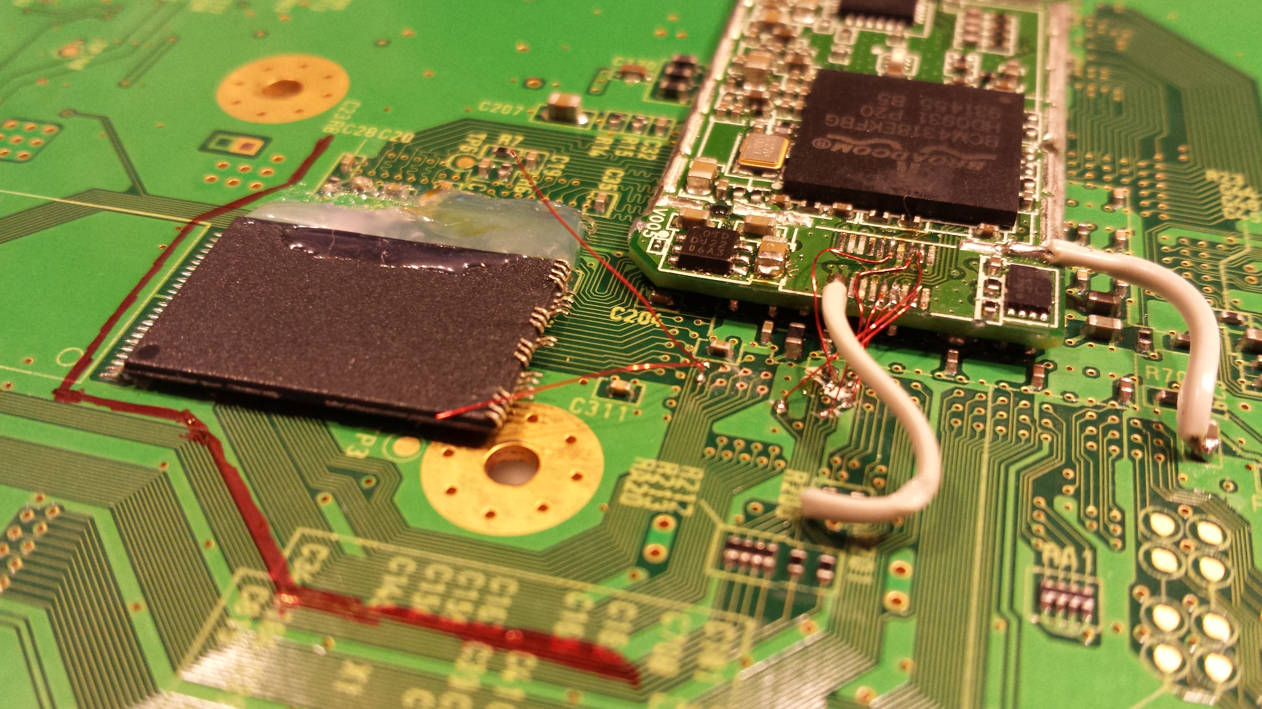

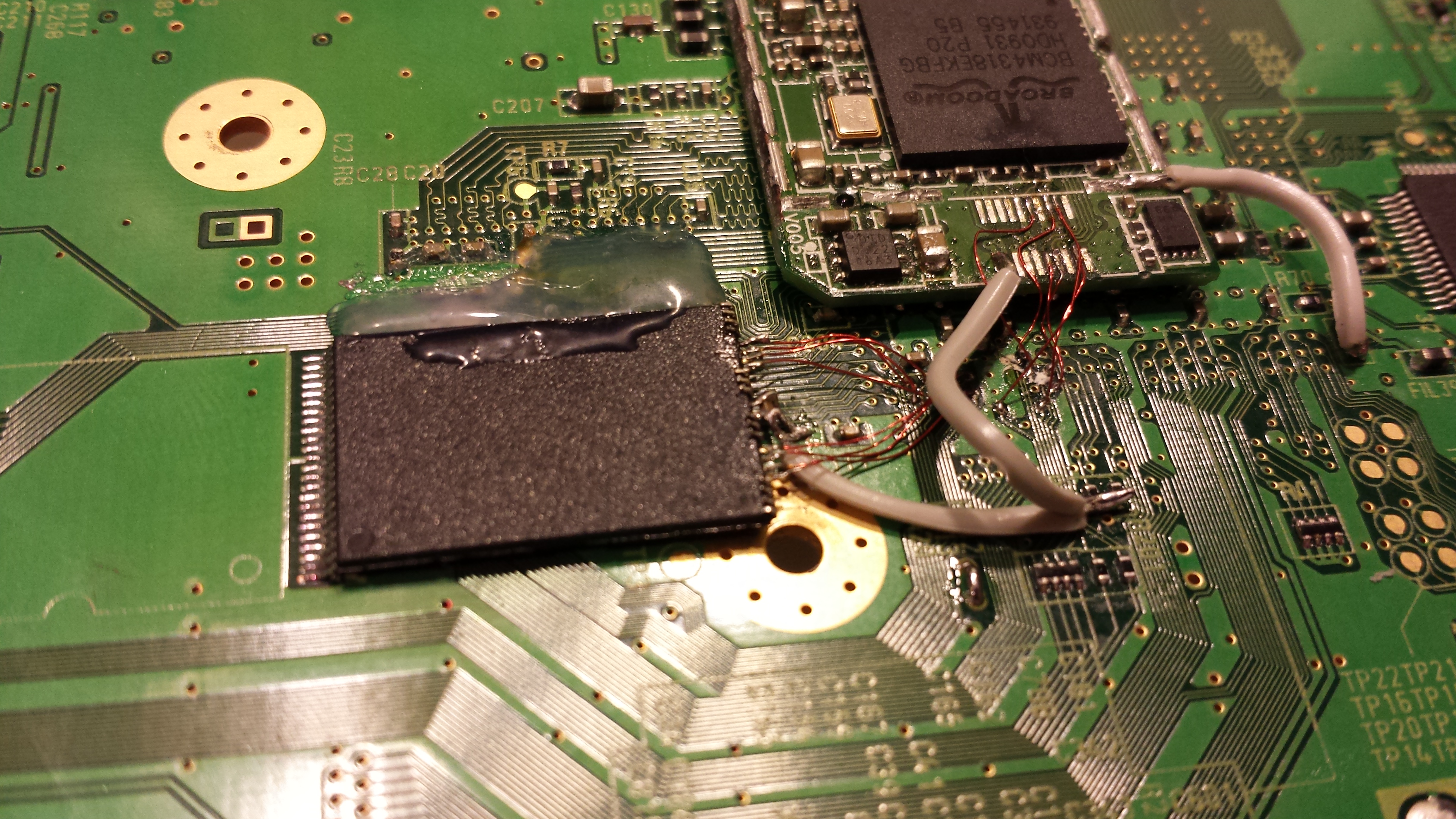

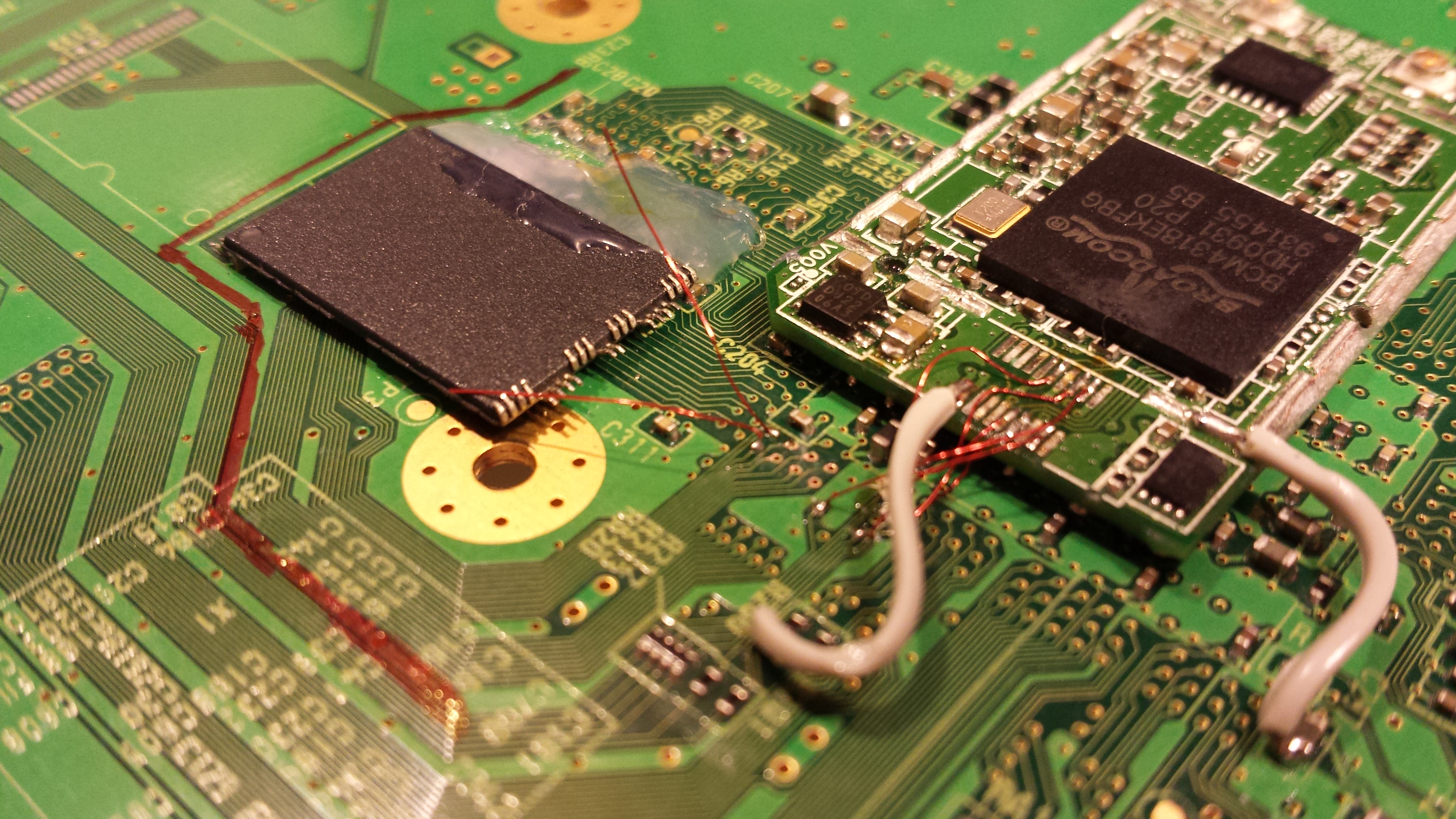

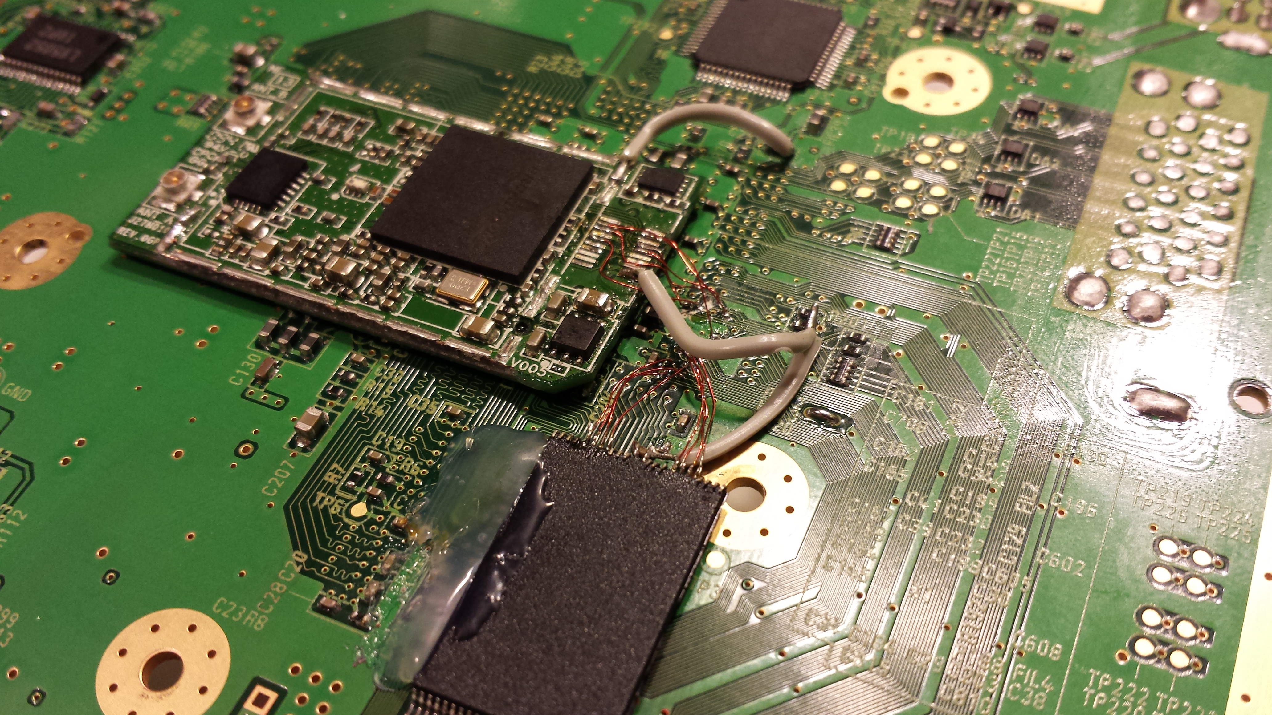

Stacked all nice and everything. I have no idea if any of this wiring works yet.
Does the wifi module need some form of heat dissipation? It does have thermal paste in some consoles.
Have not been able to test that myself. I'd think probably not, however it's positioned like this so it's easier to add heatsinks and position a fan to be blowing on it.

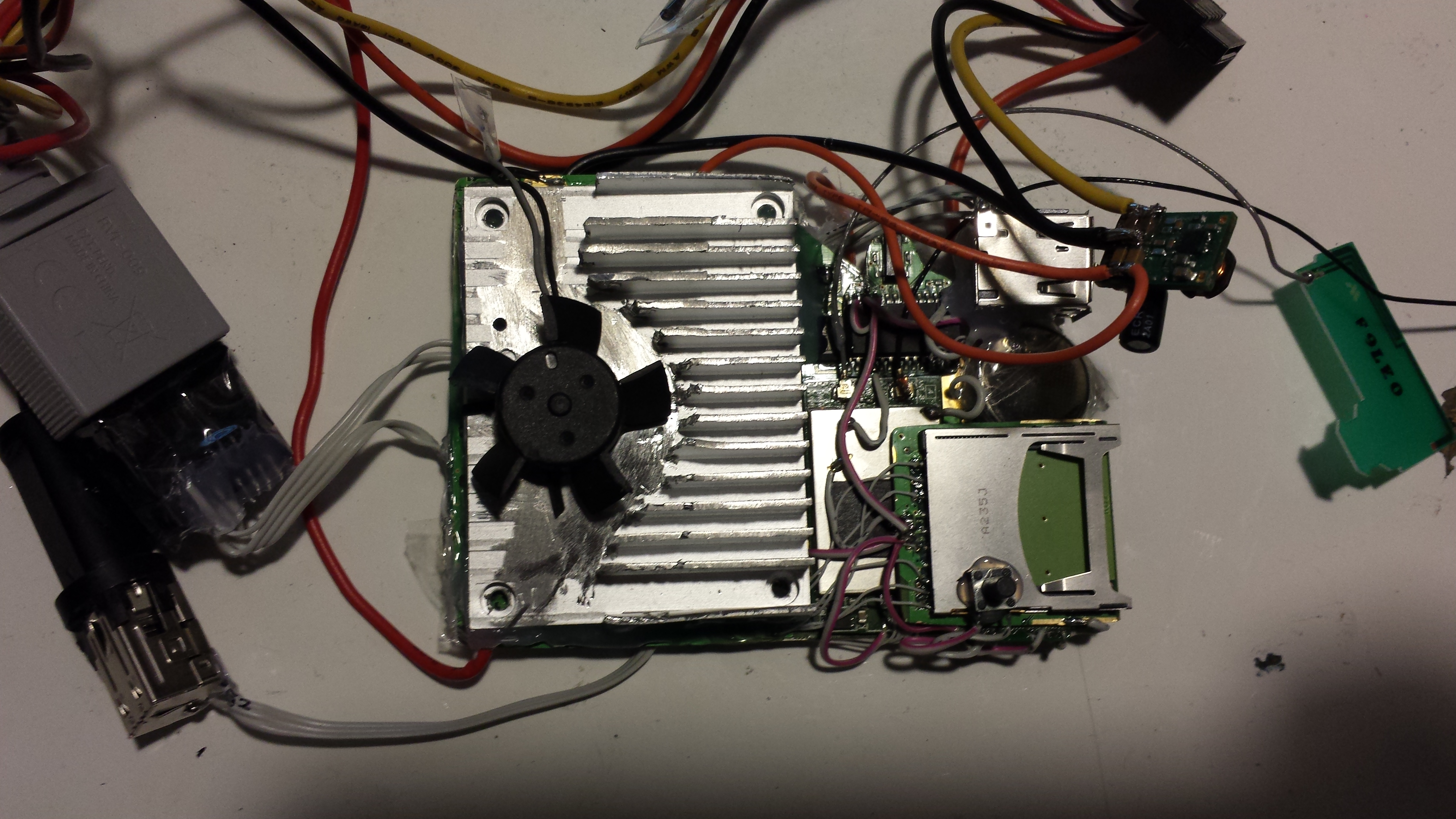

Behold the cheapsink
Trimmed down the fan blades and everything. Will be testing it extensively tonight.
