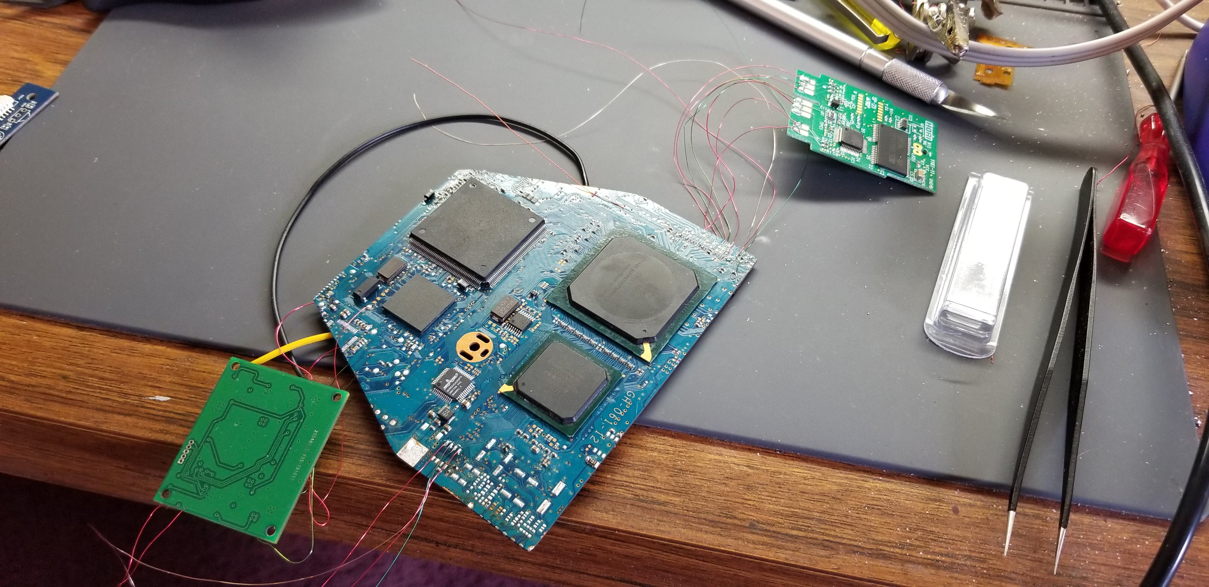

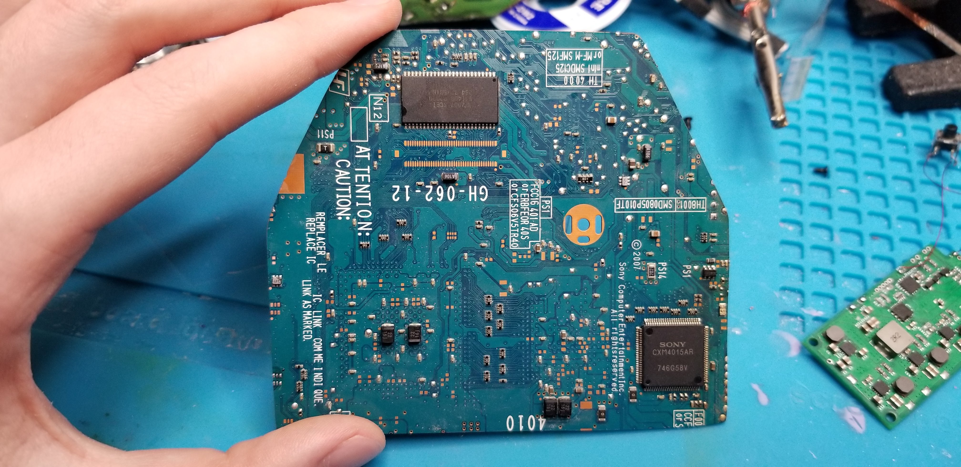

Made some decent progress this past week. First big step was trimming the PS2.

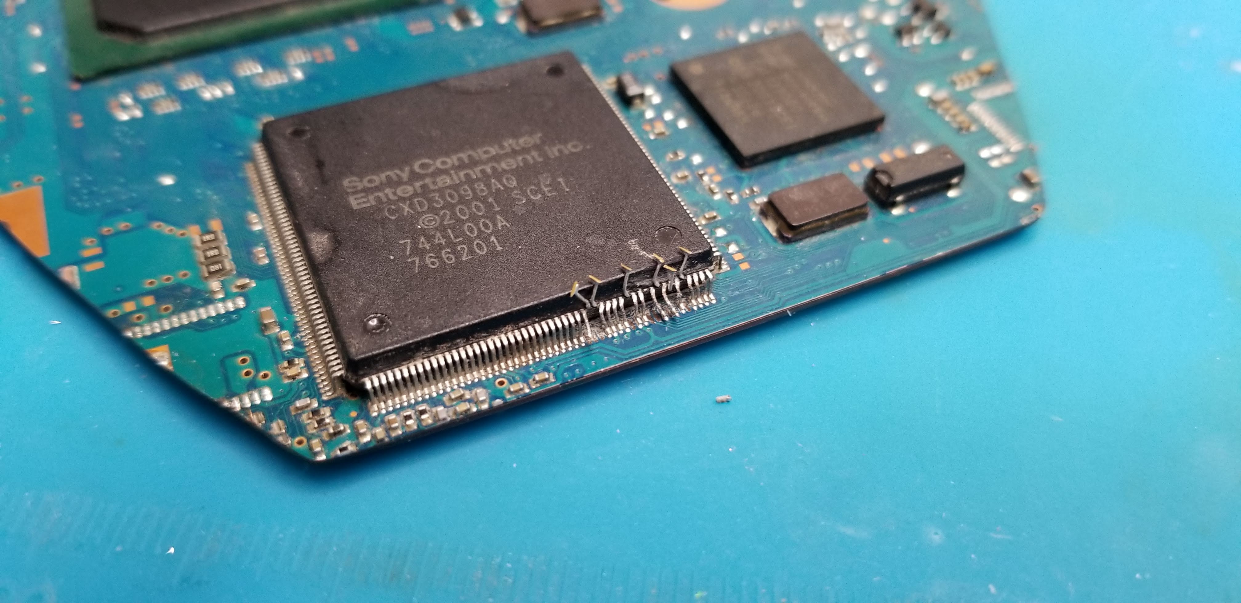

The trim went pretty poorly by my standards. My dremel was struggling to cut cleanly and it took me a long time to cut out the entire motherboard. Unfortunately I had one big slip, which happened to bring the dremel crashing into a row of pins on one of the ICs.
I've gone ahead and pulled all the legs that got rammed apart from each other, unfortunately one pin broke completely. Gman says that this chip is responsible for the disc drive stuff, so it's possible that I got lucky and this won't be a board killing mistake. Got another board on the way just in case I can't get this board to work.
Now that I've removed some of the ICs that were sliced through, I'm going to go back through and do some more sanding/cleanup before I try to power it on. My PS2PMS is supposed to arrive tomorrow, so I should be able to attempt a boot this week.

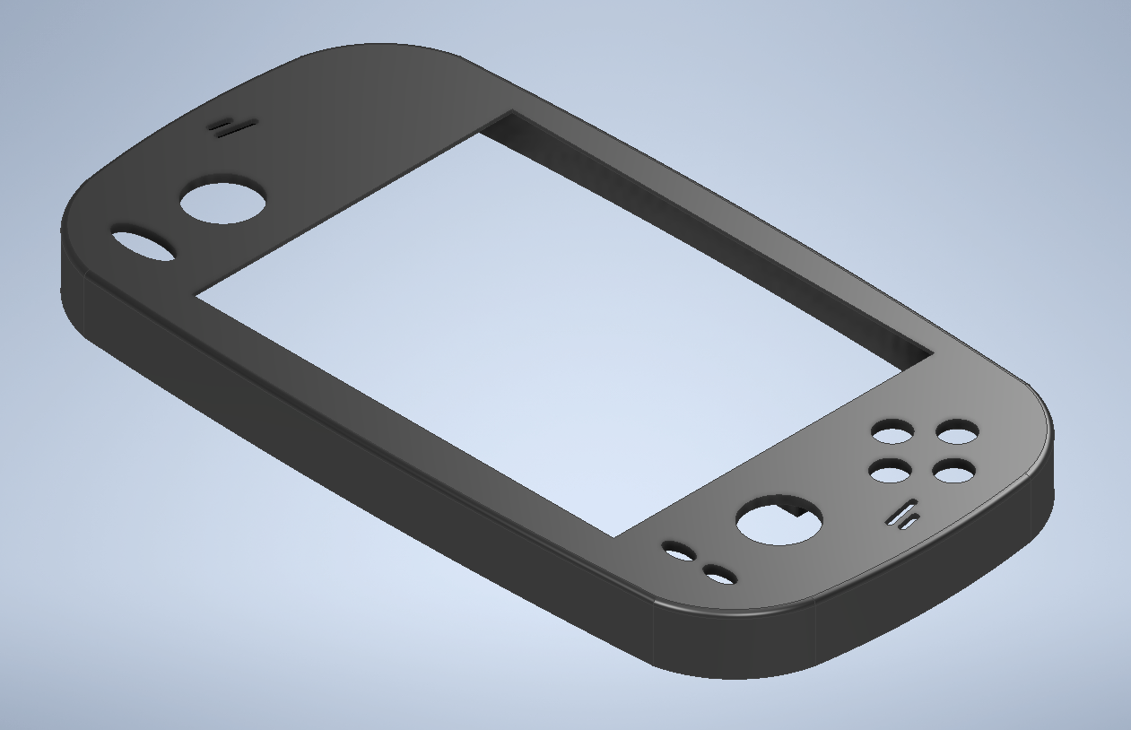

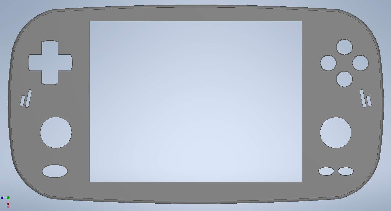

I've also made some decent progress on the CAD work for the build.

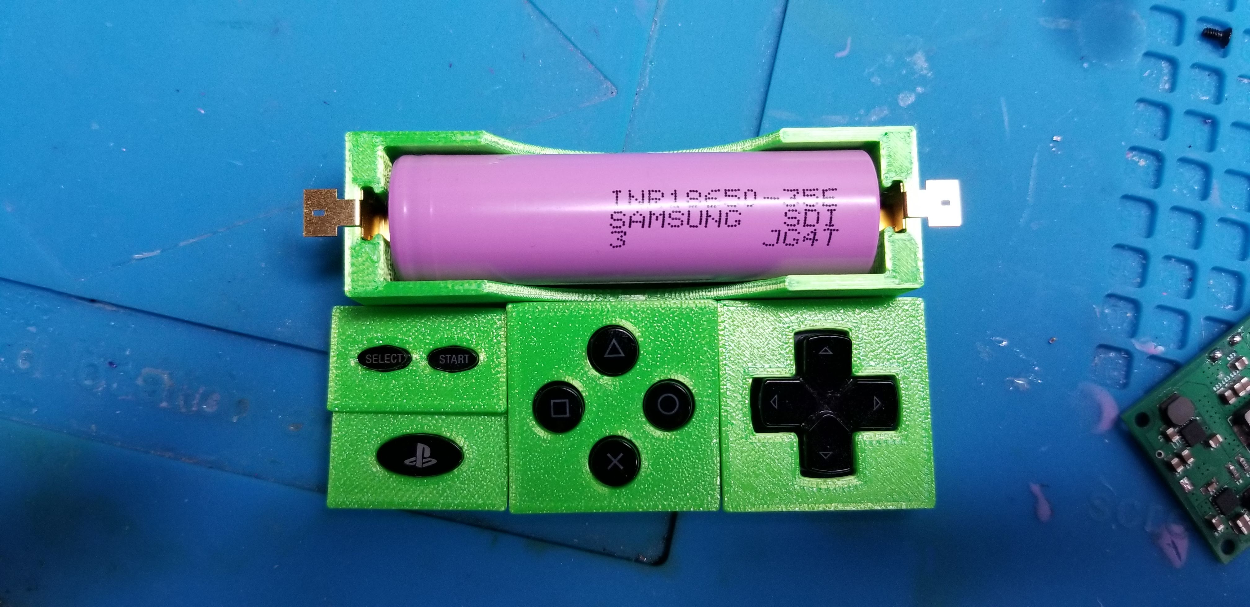

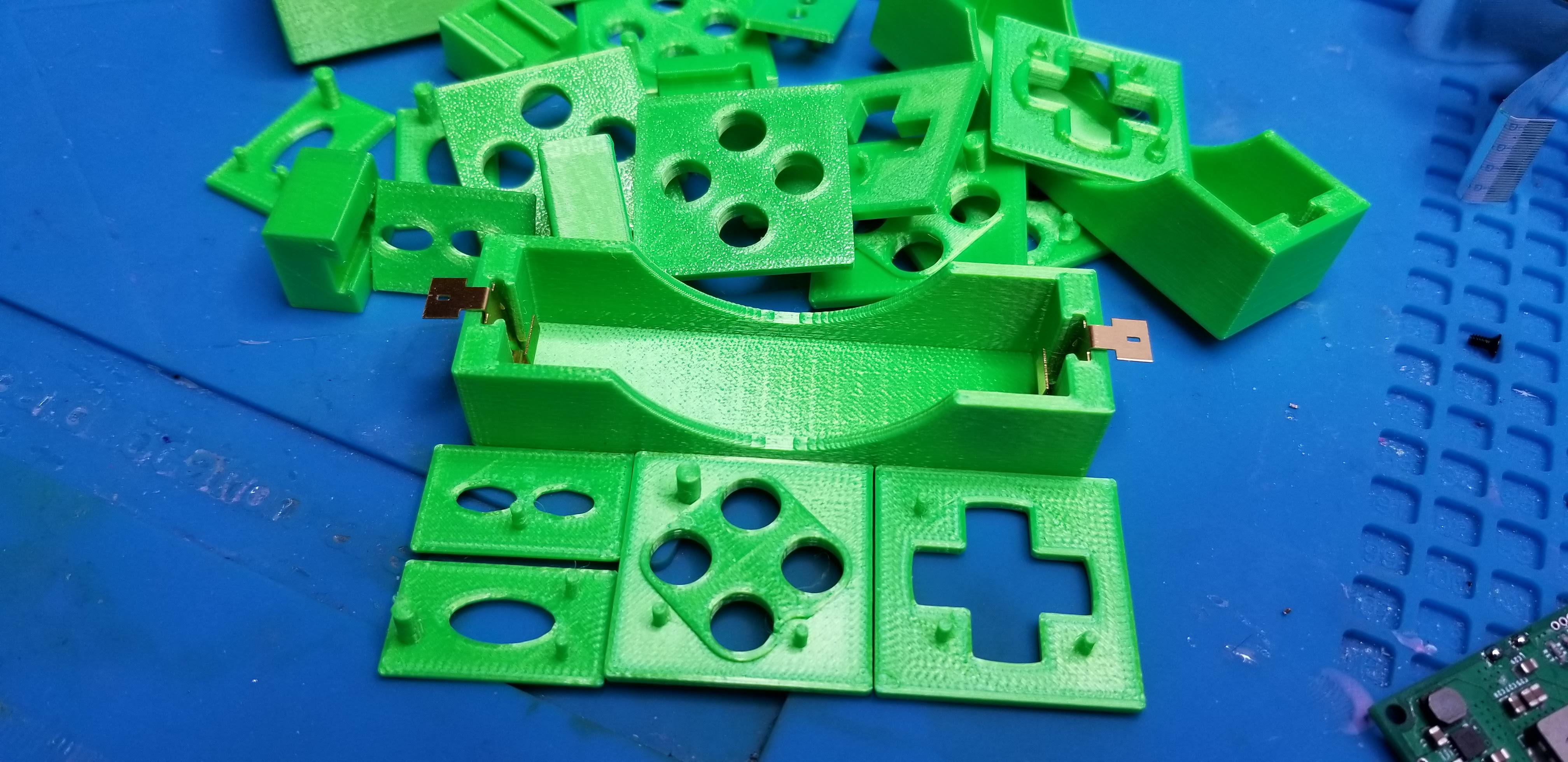

My Vita buttons and battery holders came in, so I was able to work on some individual assemblies for these before implementing them into the main case. The button holders were tricky, I was really glad I have my own printer to make small tweaks and retry on.

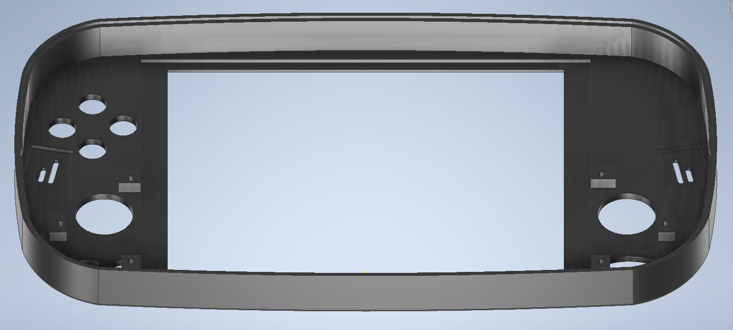

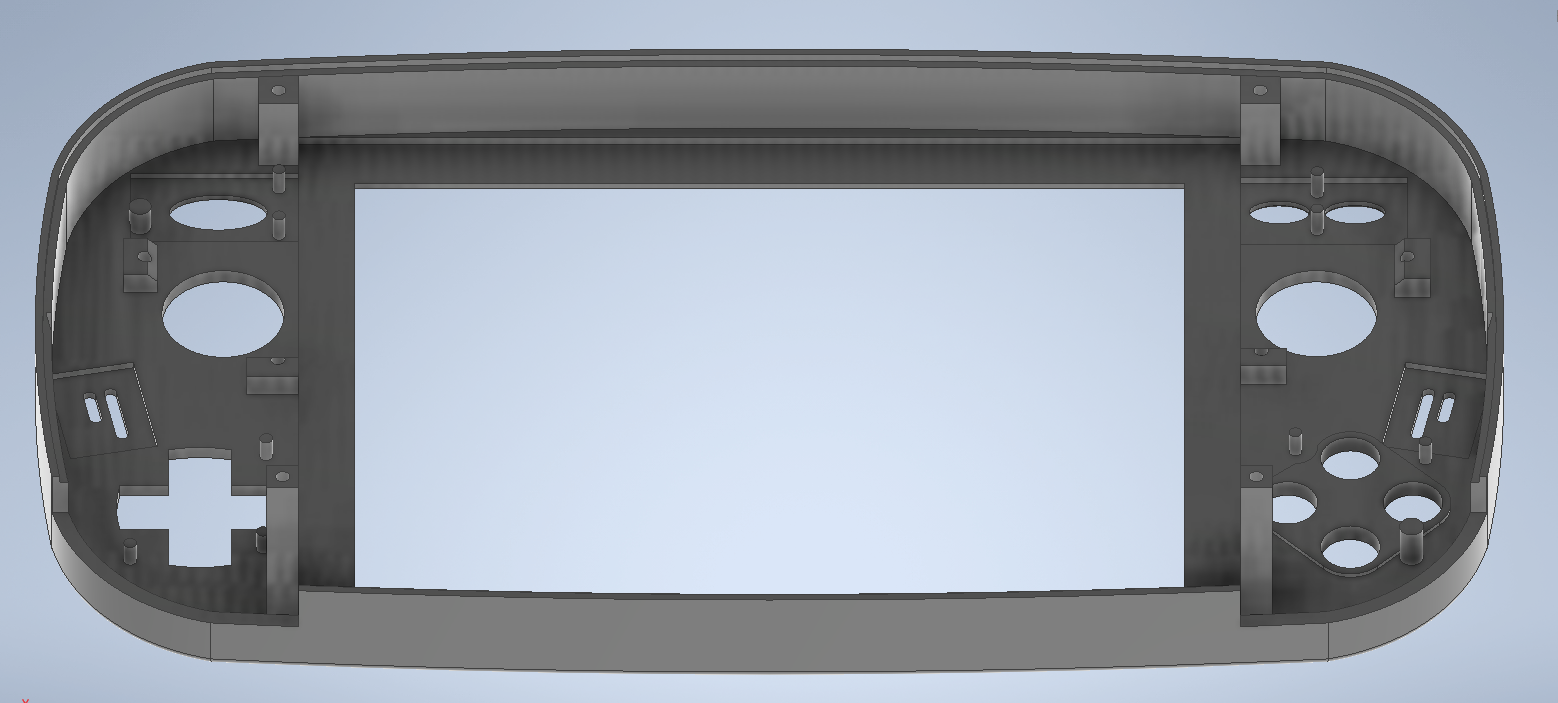

The front half of the case is pretty close to being finished.
Buttons, screen and speakers are all in order, mostly just need to add some more screwposts to mount button boards and such on. I also need to work out exactly how I'm going to do bumper buttons. I'd really like to make them pressable from any point on the button, as my fingers seem to hit it at different points depending on whether I'm using the ABXY/dpad or the sticks, due to the increased height of the case compared to the Louii. I'll definitely take my time to come up with a clean trigger assembly on this.

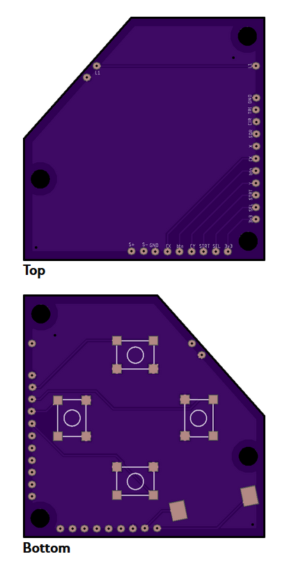

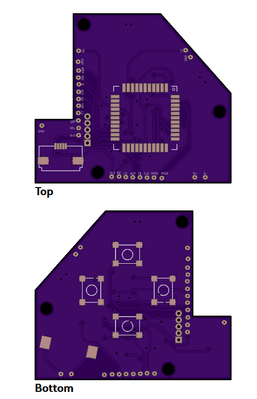

The first thing I did was get the controller PCBs cranked out really quickly. Pretty simple boards overall, just connectors for joysticks, built in buttons for controls, and the PS2+. I did forget a filter cap on the PS2+, so I'll need to add that on manually. I opted to use a larger package for the PIC, so soldering it should be a breeze.
I also designed a few smaller boards for the trigger, PS, and start/select buttons. Those aren't terribly interesting though, so I'll save you the time. All of these boards have been ordered along with the boards I need for the Wiiboy Color, so in the meantime I've focused my attention on the CAD work.

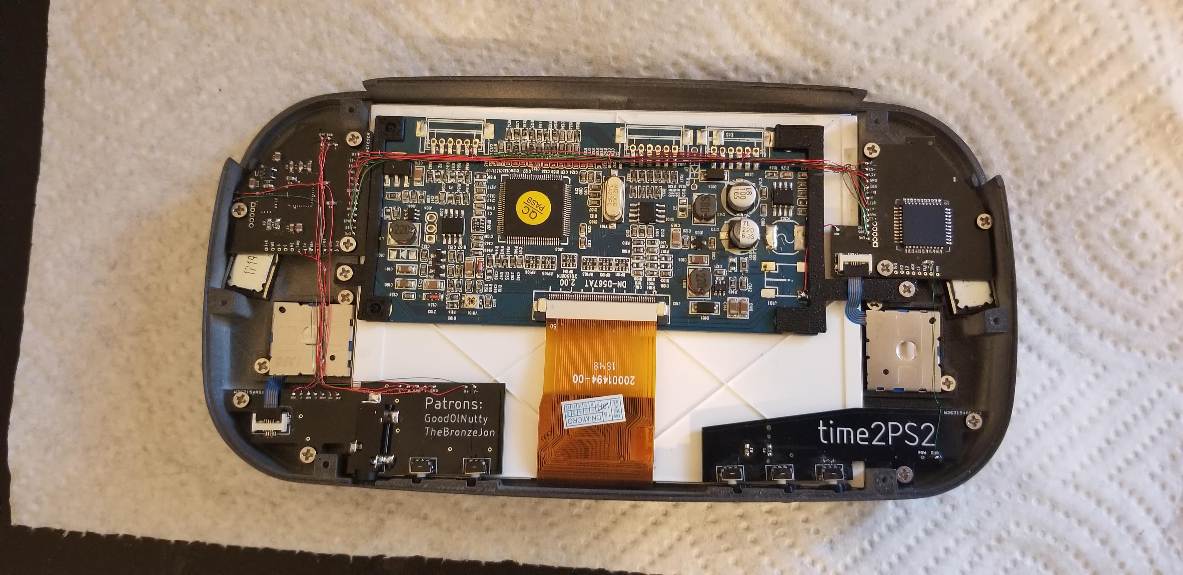

I ended up changing or redoing almost all of the circuit boards from last year. The ABXY board now houses the circuitry for a U-amp, and I've made a board for the back of the portable that is essentially a clone of USB-C PD v1, similar to what was in the Wiiboy Color. These boards went pretty smoothly, though I did mess up the part of the U-Amp that tells it what console's audio it's using, so it was configured for the Wii instead of the PS2.

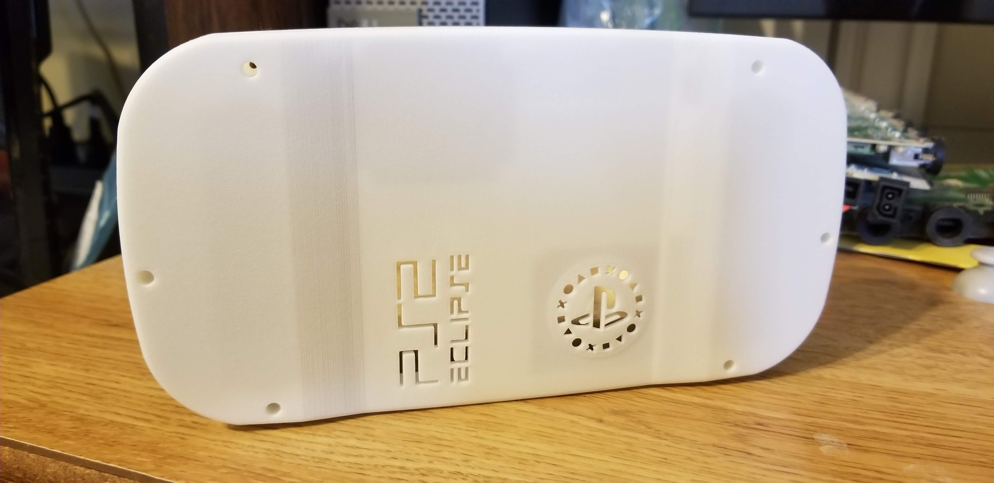

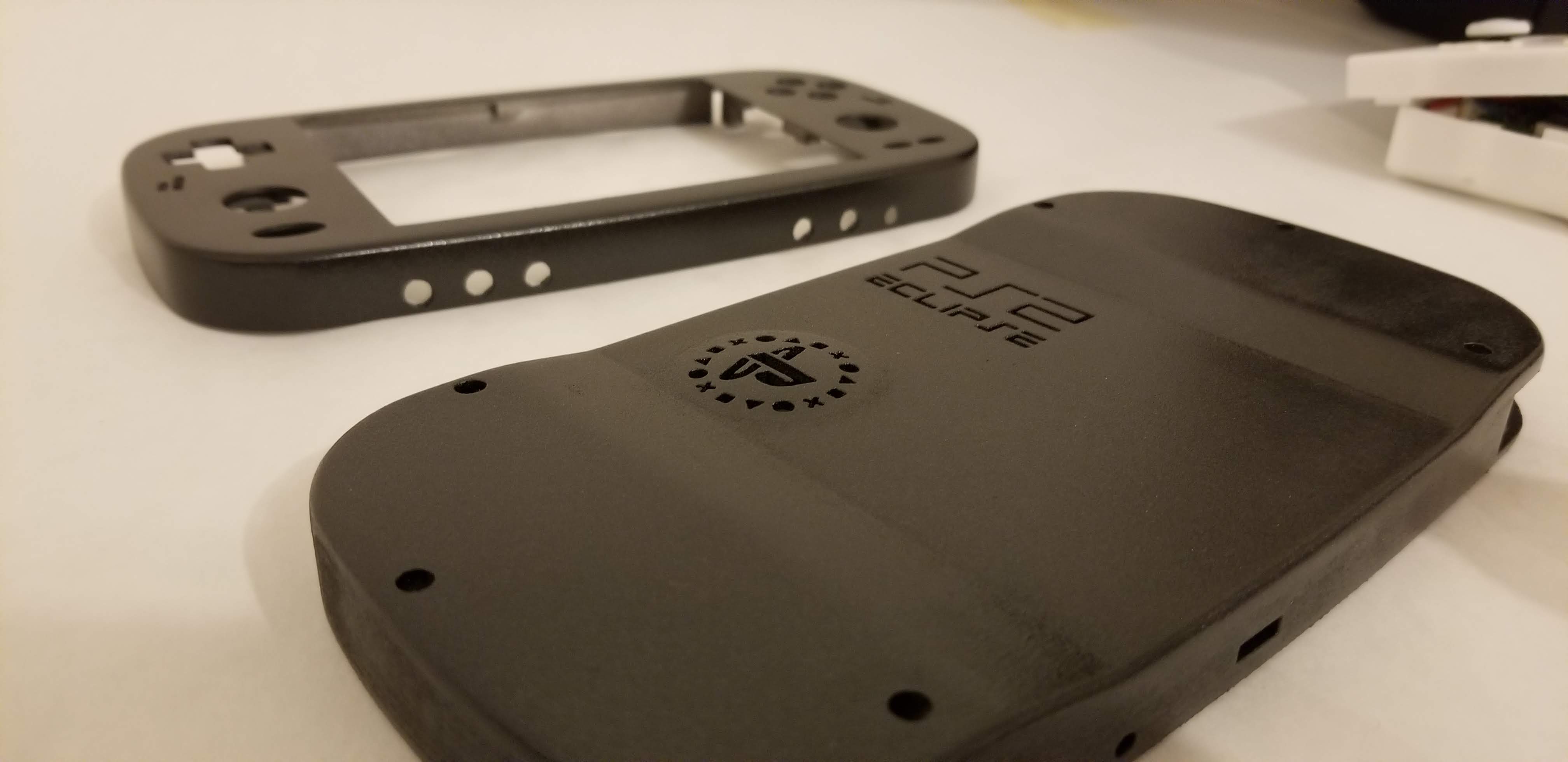

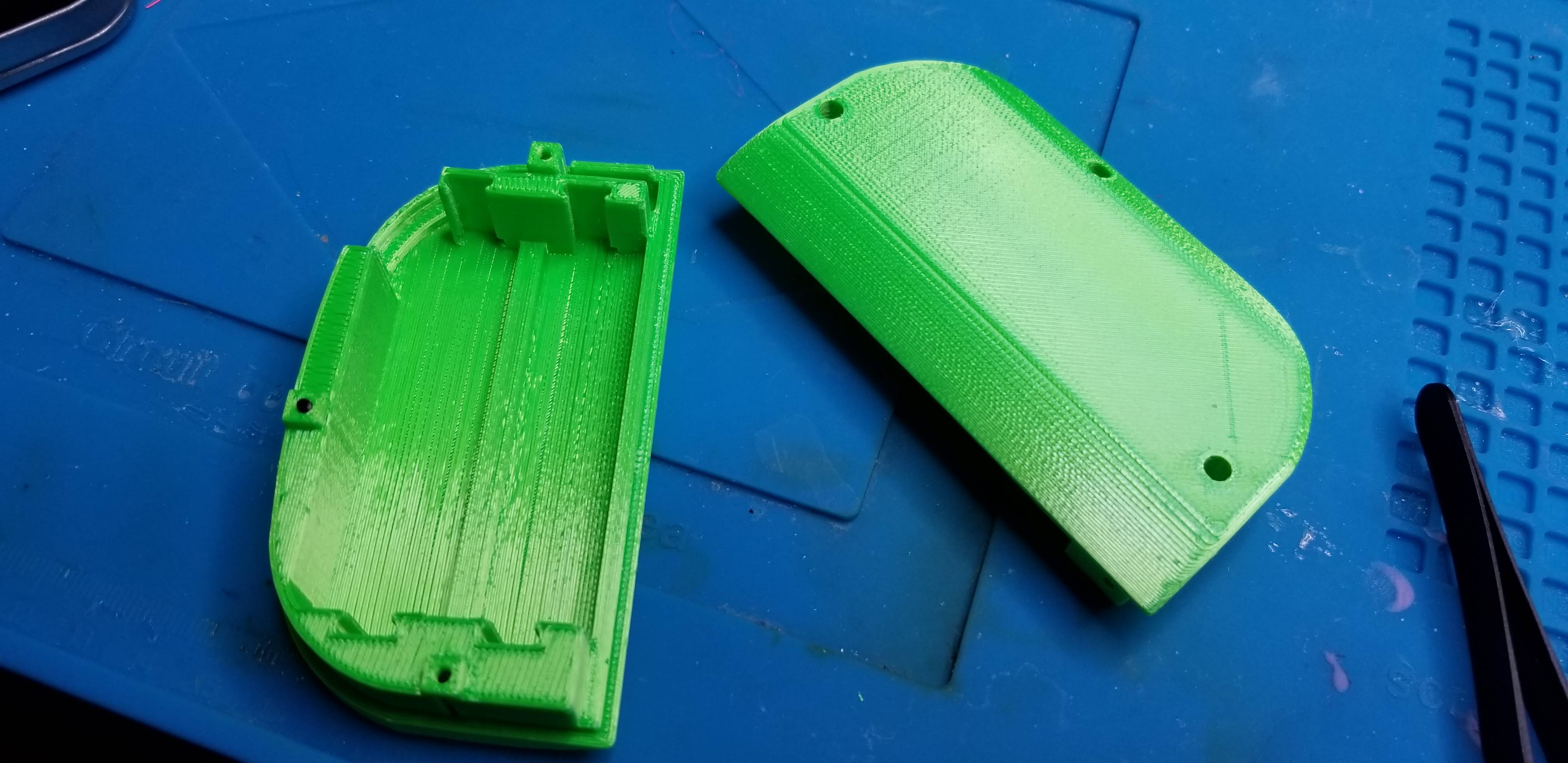

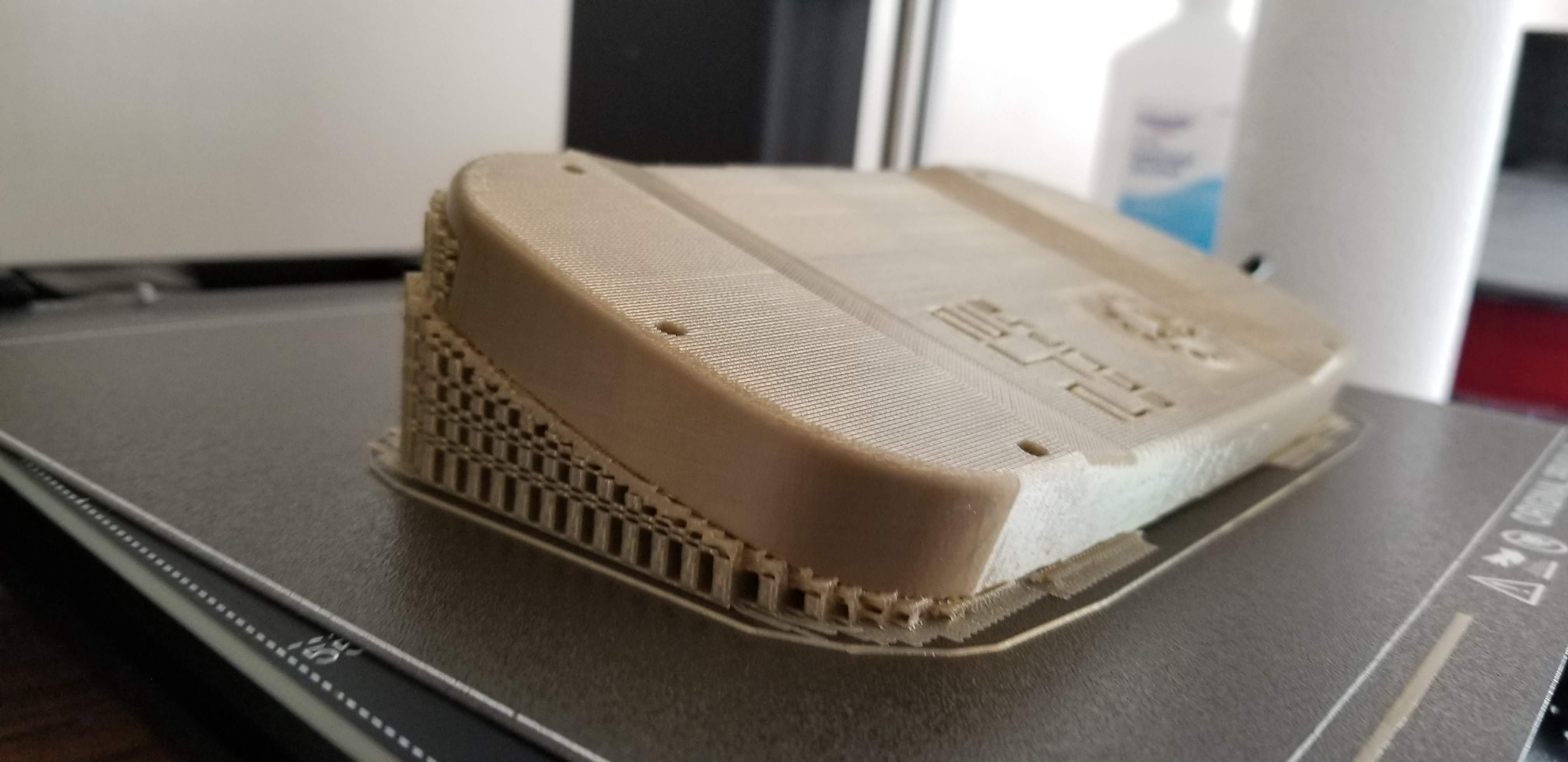

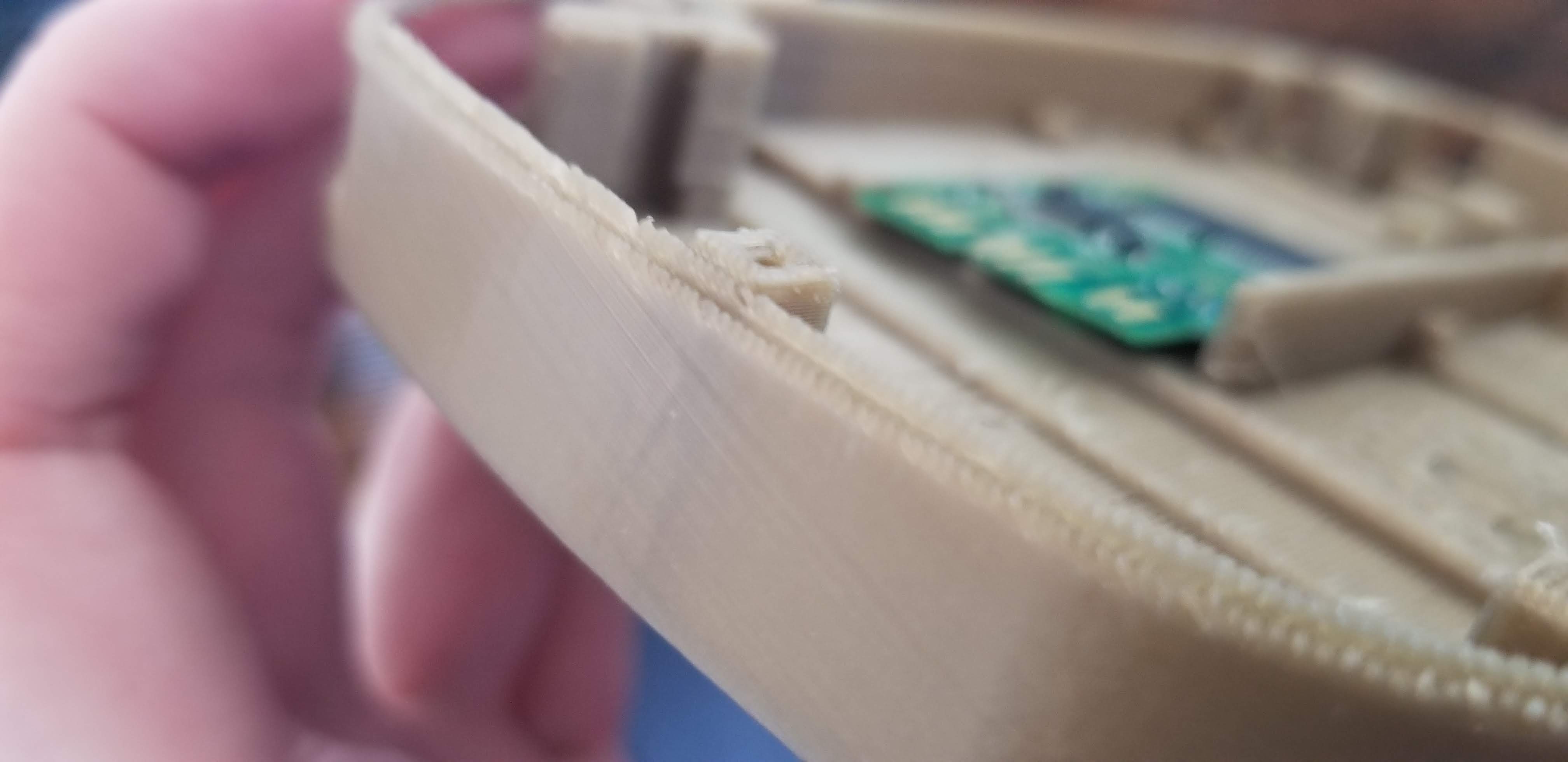

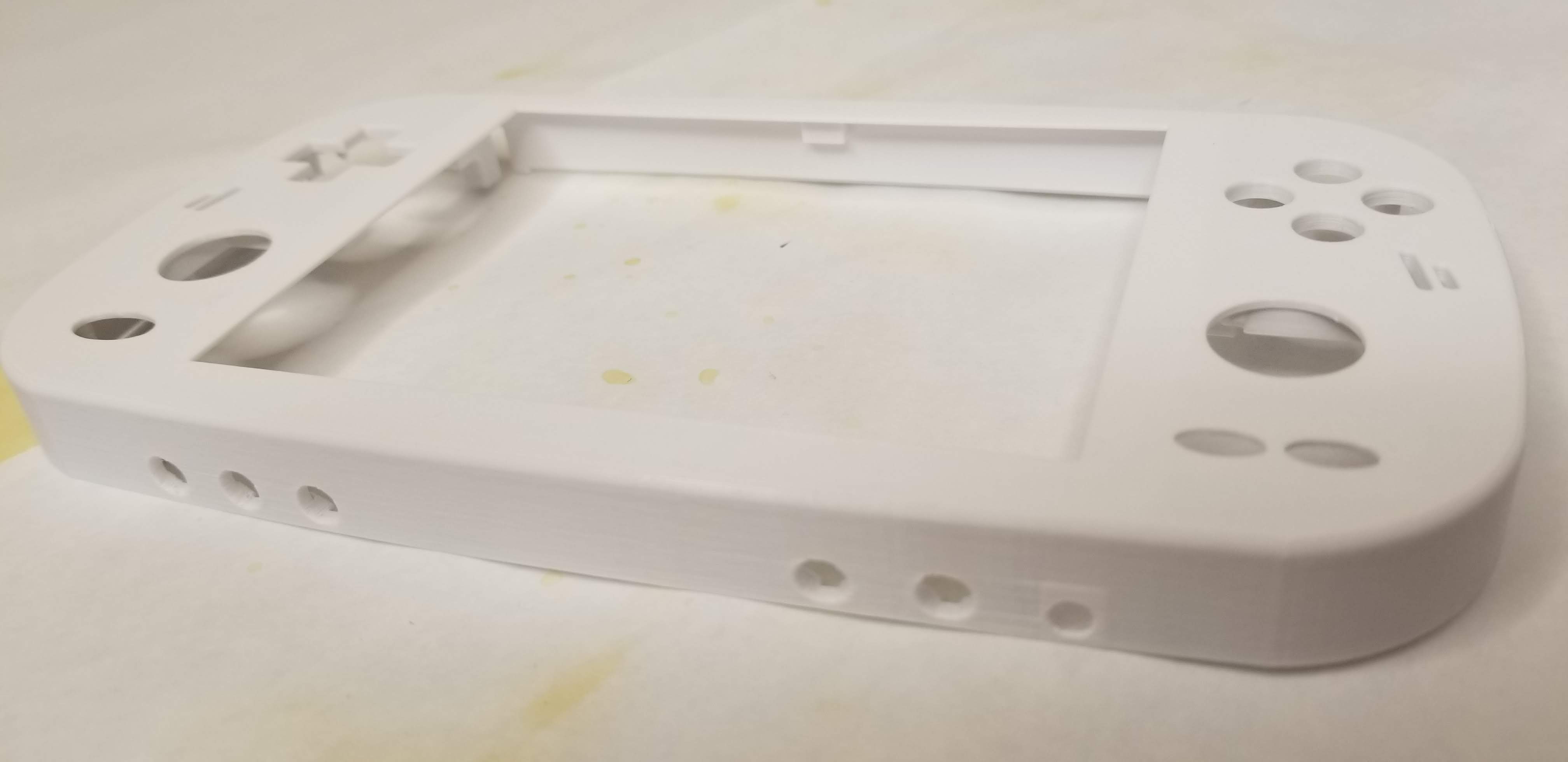

From there I finalized the case. I was originally going to have the grips as separate pieces from the back that would screw into place, but that seemed like too much of a hassle. I also redid some measurements and found that the grips were pretty unnecessary, so I opted to make them a lot less pronounced.
The one downside to that is that I'm not a 3D printing wizard and couldn't get the back half to print in a clean manner where it could still lock in nicely withe the front half. I opted to just order it from Shapeways, which was pricey but worth it in the end.

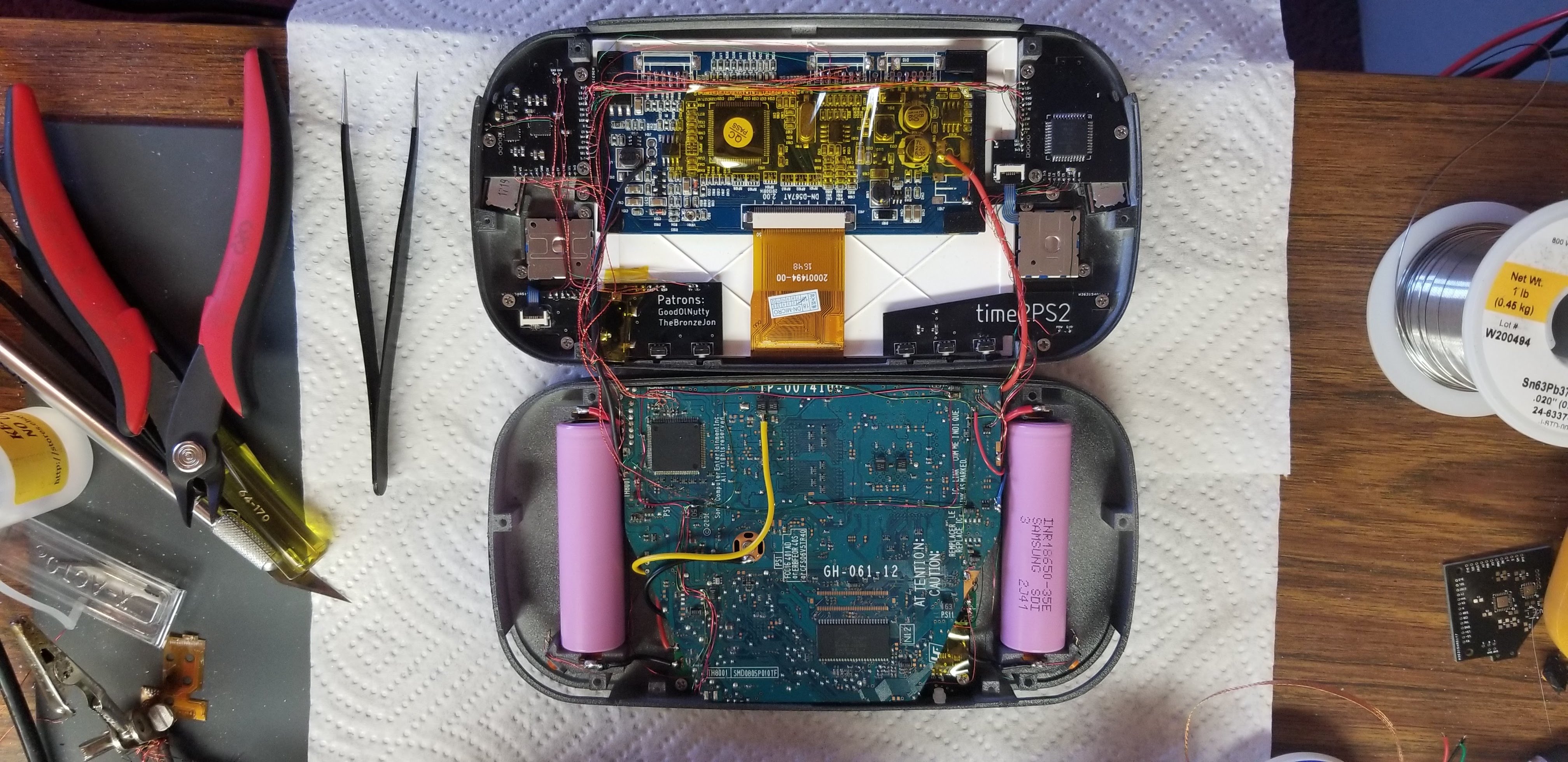

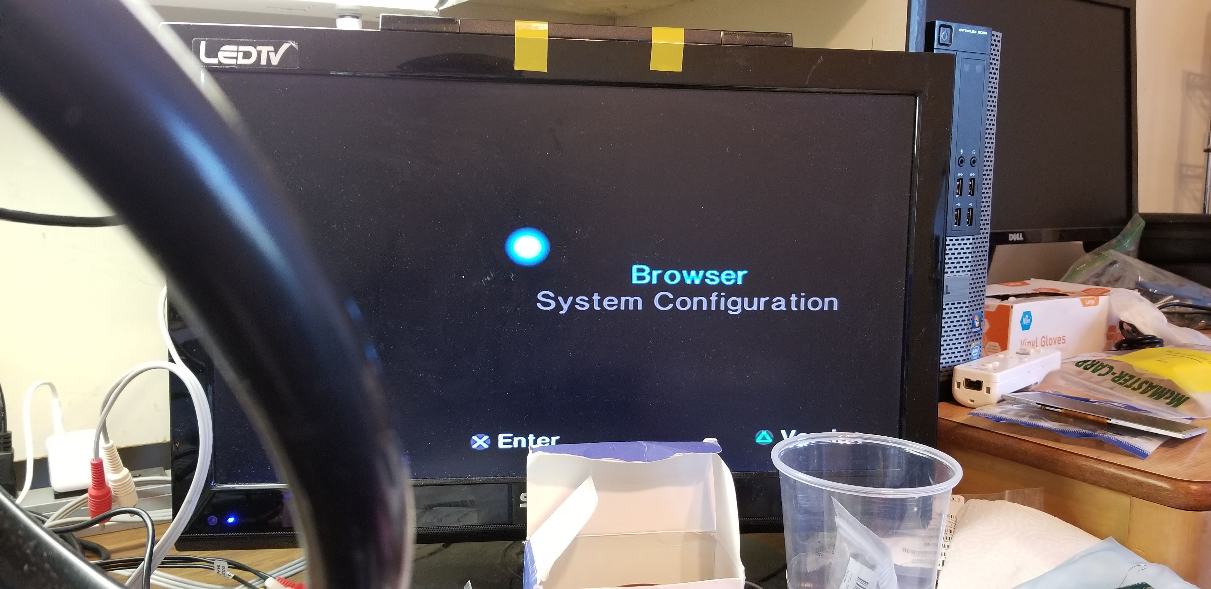

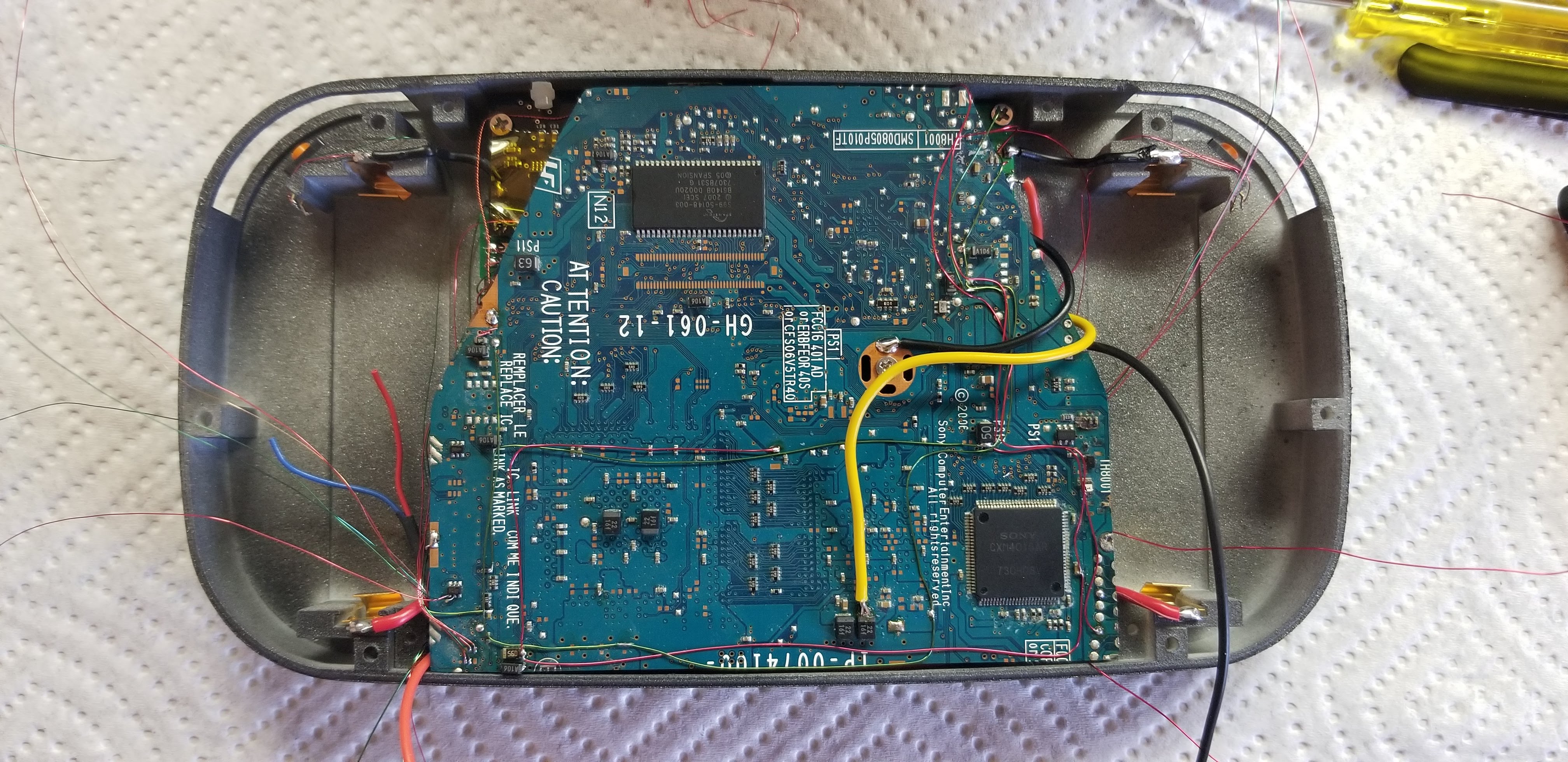

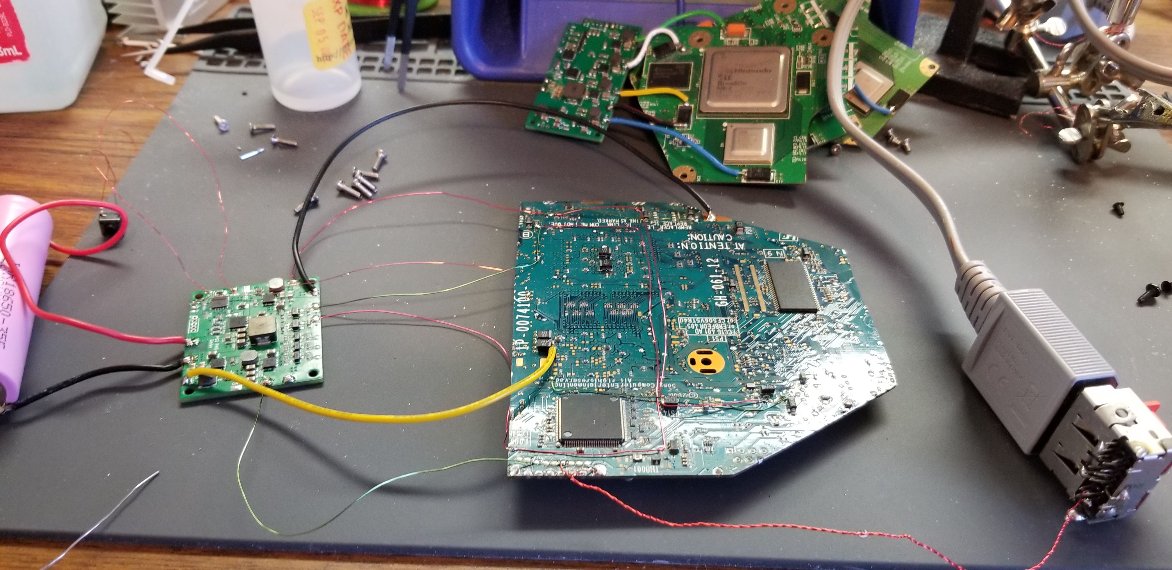

Last year I was having issues with the PS2 trim part of it, this time around I pulled it off first try. I actually did 2 successful PS2 trims this year, I did a second one because I thought I had killed the first one after it stopped booting after a while, but I'm a dumb dumb and didn't realize that I had removed some of the composite filters after trimming and testing, so I needed to wire it up closer to the AVE (or whatever the video chip on the PS2 is called).
From there I started doing relocations. USB is a bit of a pain because of the trace scratching, but the memory card and controller were pretty straightforward. I'll admit, I was really missing the fact that the Wii has 100% of the critical relocation points accessible from the back of the motherboard, having to screw this thing in with the majority of the points I soldered to out of reach without pulling out the entire motherboard was a bit nerve wracking.

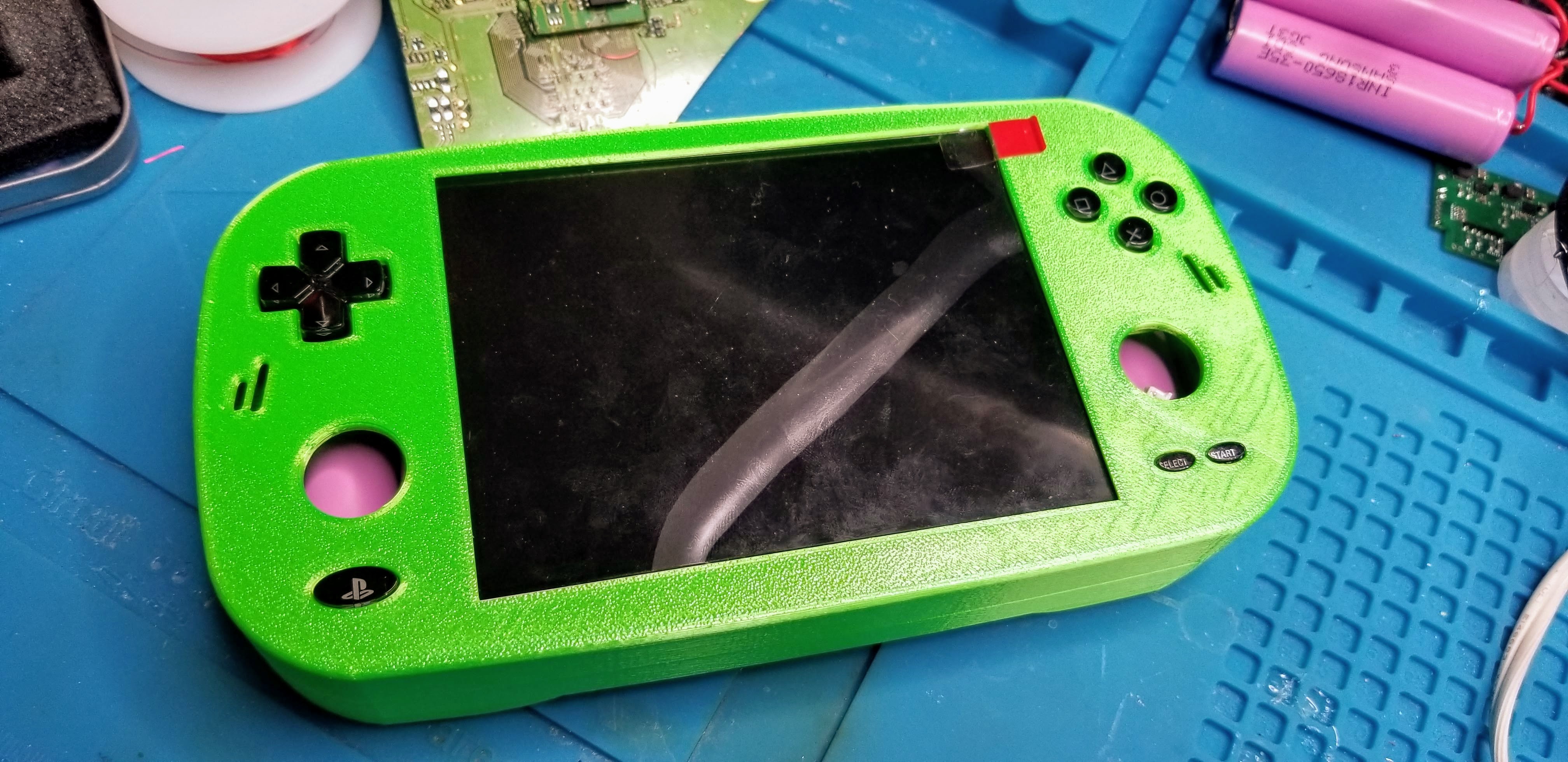

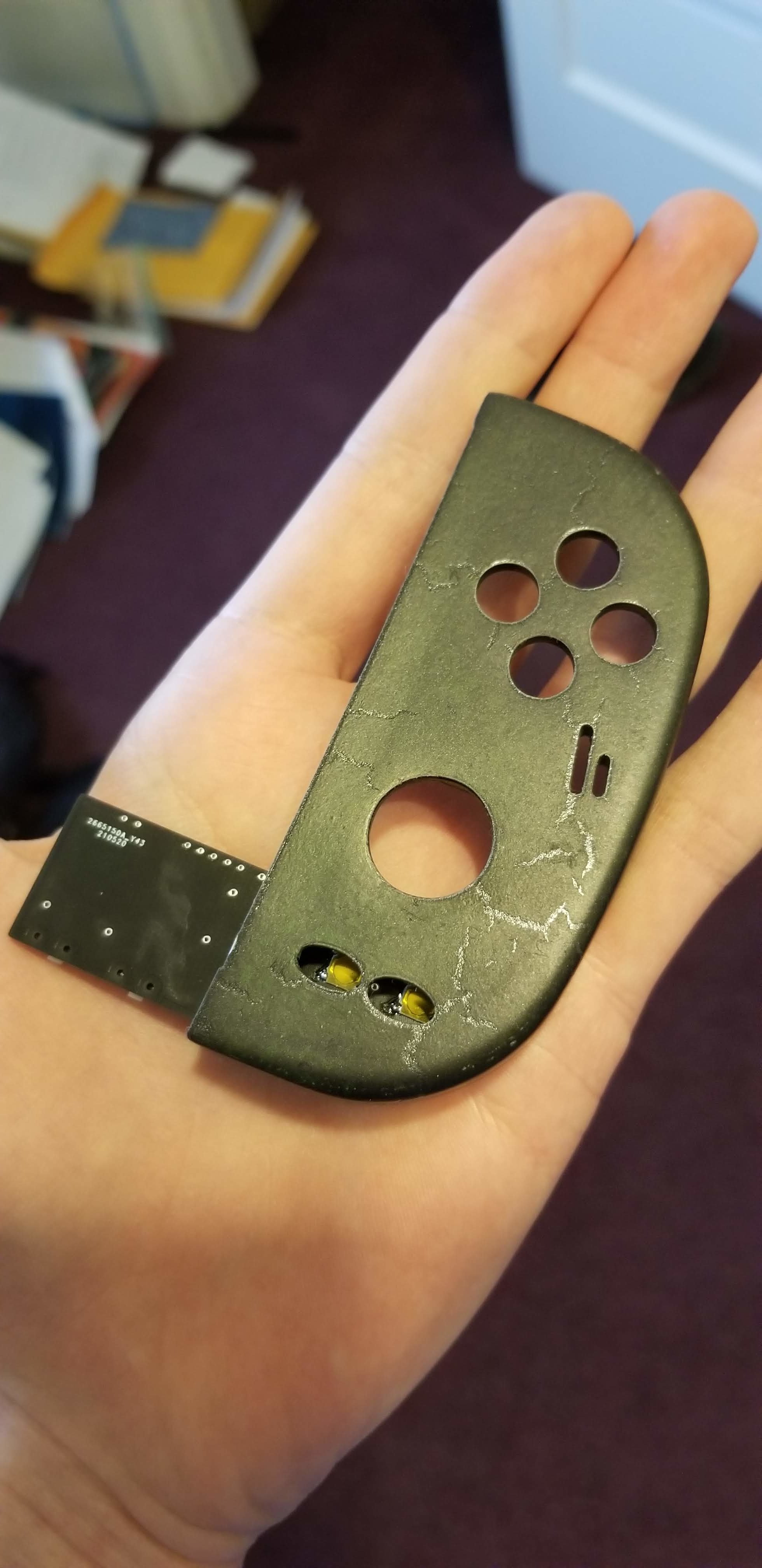

I wanted to give the case an all black paint job, so I did the usual sand, prime, paint, clear coat process.
I had this fancy pigment that creates this thermochromic effect when you paint it over something black, but it ended up just making the paint super cracked on a test piece I did and kind of changing blue if you held it in your hand for a while. I probably wasn't doing something right, so I decided to just stick to a simple metallic black.

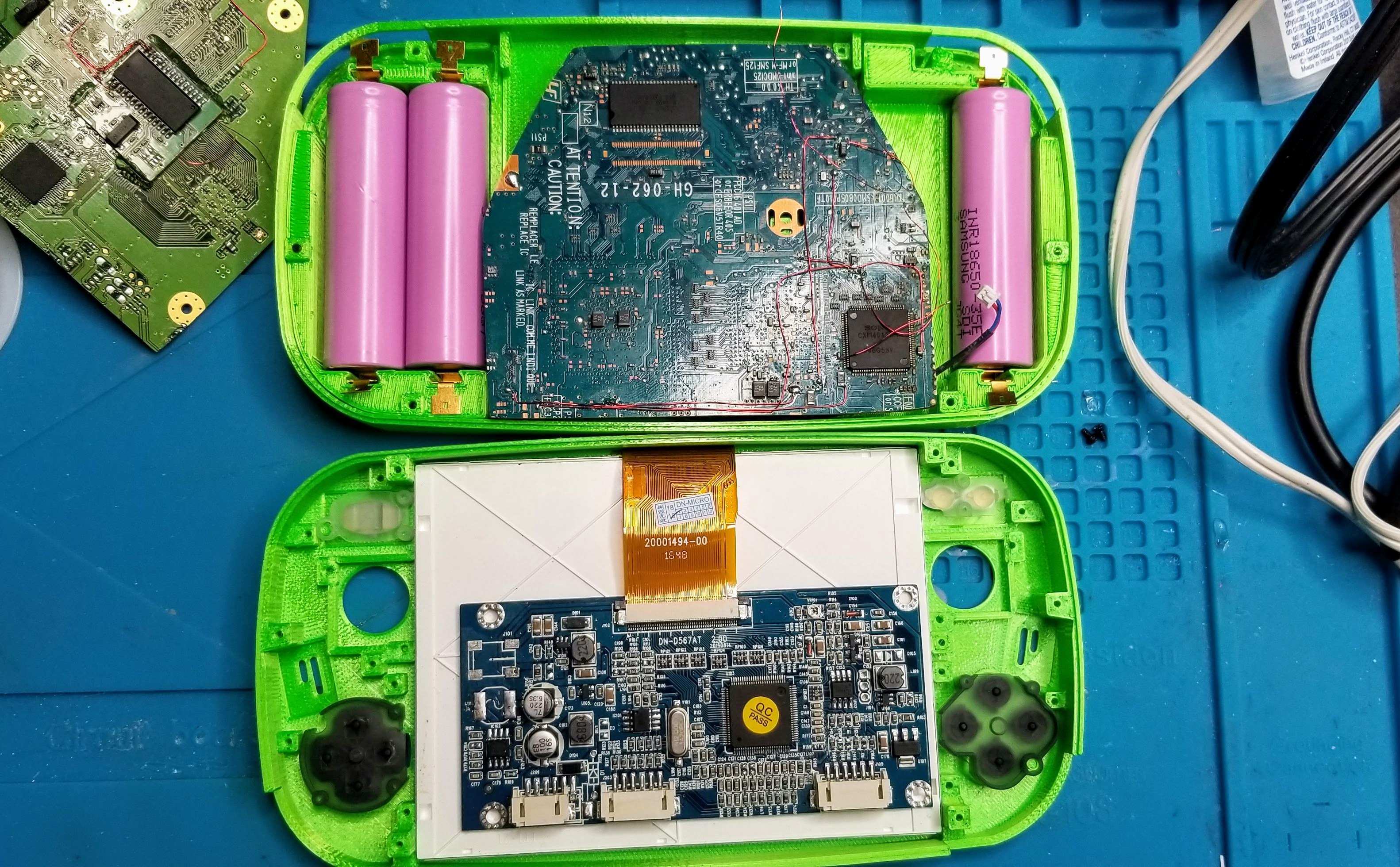

After letting the paint job chill for a week, I went ahead and did the final assembly.
All in all it went surprisingly smooth, definitely easier than any other first portable I've done. I did have issues with the aforementioned audio, found out that the joystick configurator doesn't actually work on PS2plus (big thanks to @Benge for helping me with the code to manually set the ranges), and didn't know that you have to set the PS2 to be RGB in the PS2 settings, or else it'll just be green. There weren't any issues that required completely tearing it down though, and for that I am very happy.
