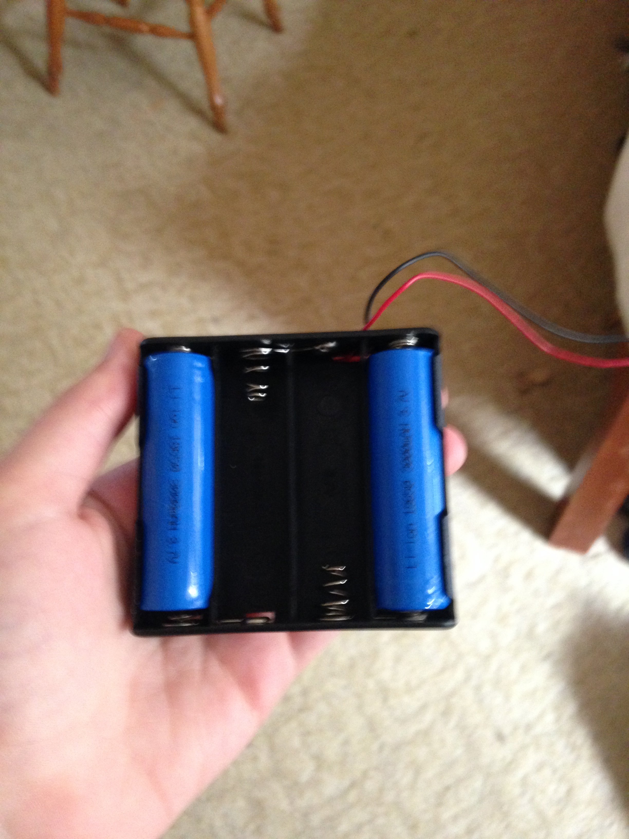

Ok cool as. I have a battery pack like this btw:

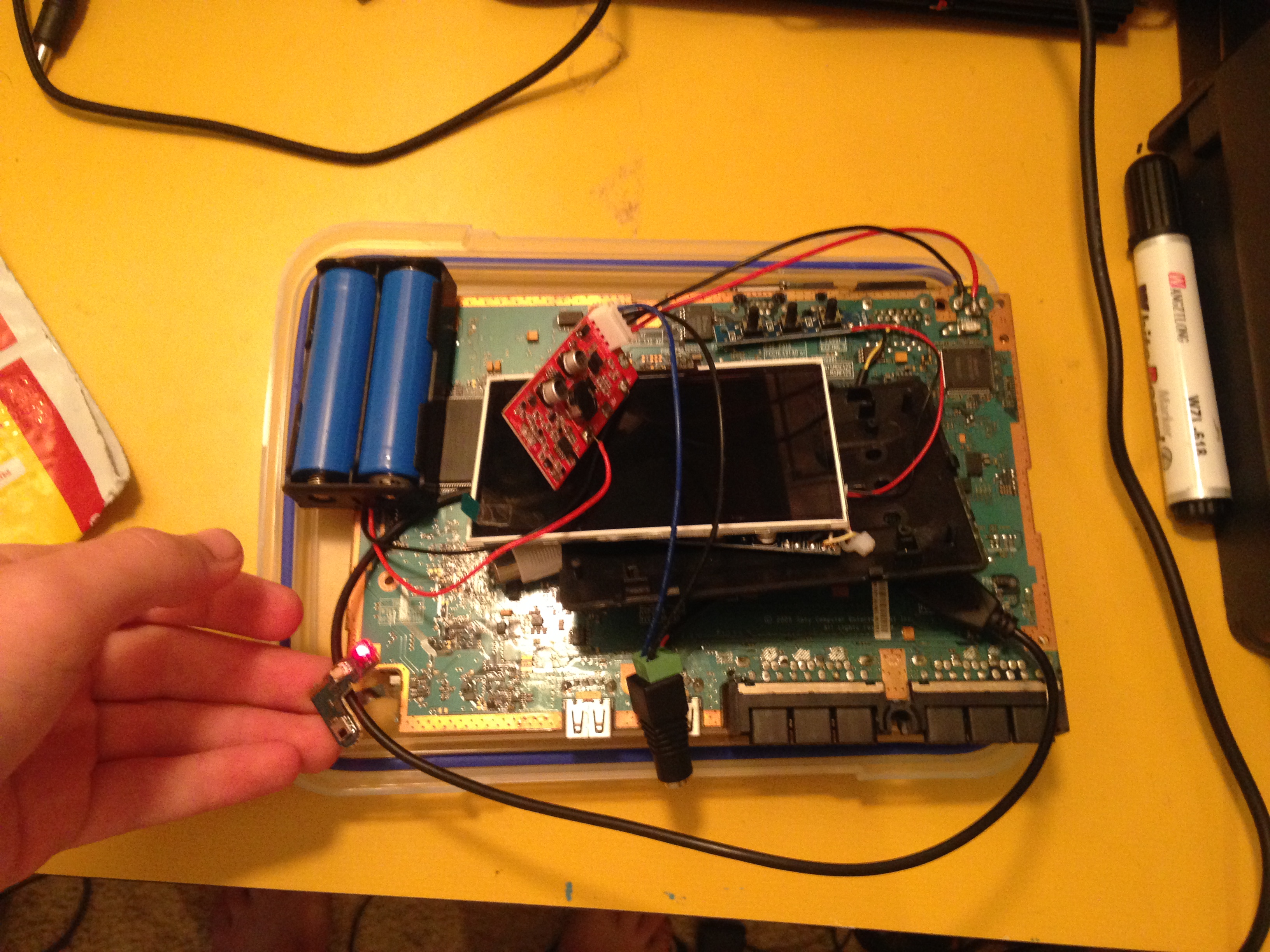

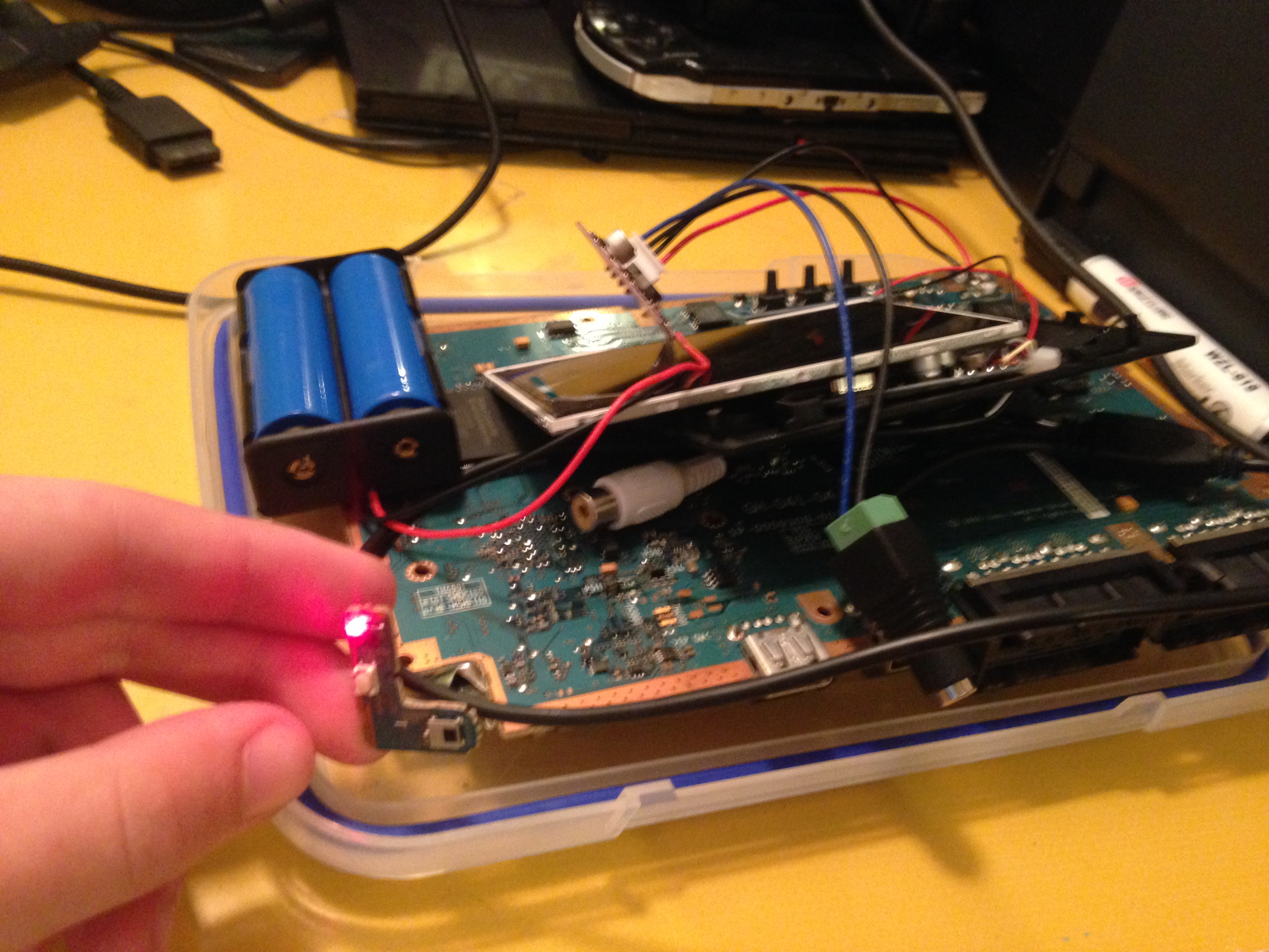

Hey I need a bit of help. My batteries are hooked up and the ps2 led does turn red but it will not turn on without the charger being plugged in. If I try turn the ps2 on, the led will just turn off. Any help?

I'm not an expert on the PS2 and it's voltage needs, but it sounds like your batteries aren't providing enough oomph to actually power the PS2, since the charger is able to keep it running. What kind of batteries are you using?

I am using two 3.7v 3000mAh batteries in series.

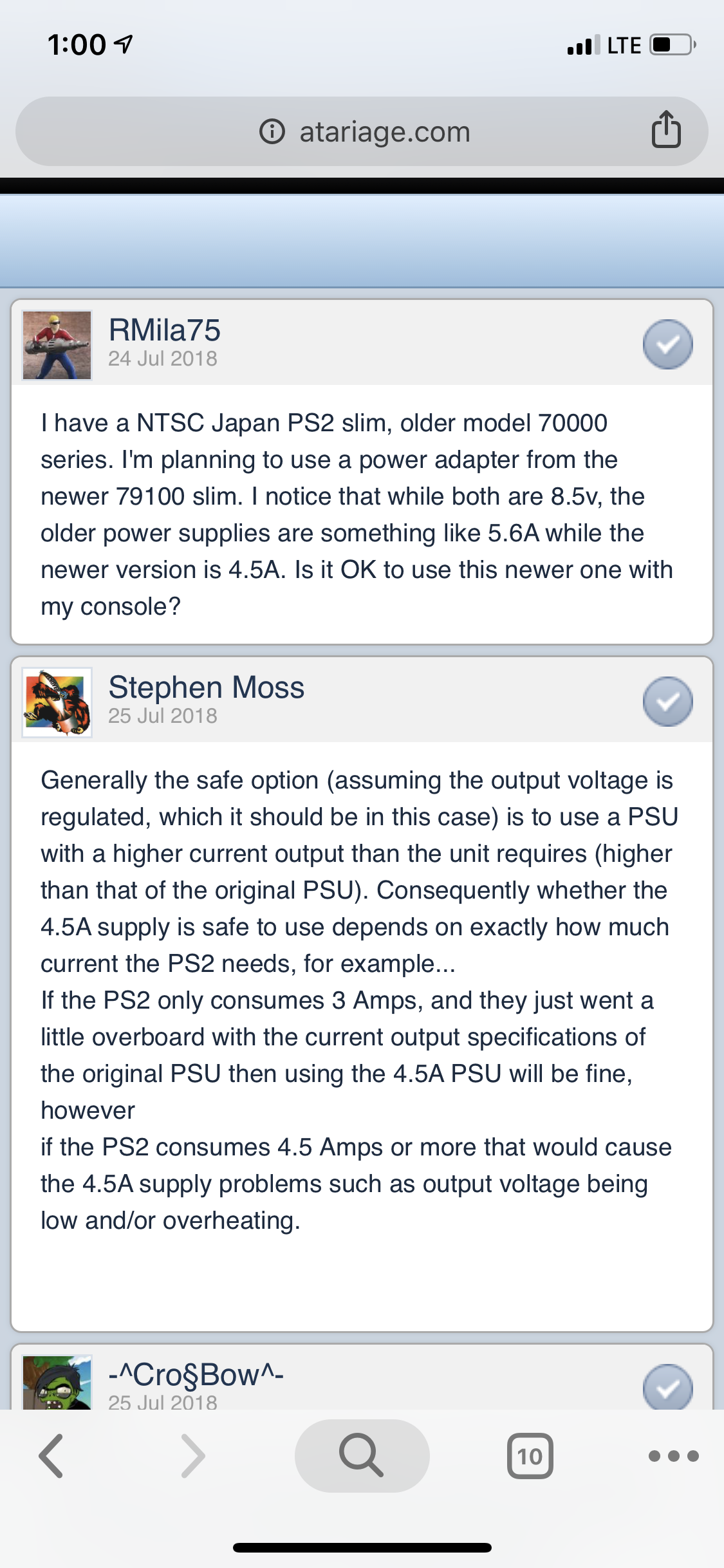

This is just an educated guess, but possibly yes, test the leads to the normal charger too, because mine for an example supplies 8.7 not 8.5, and as the charge of the battery goes down the voltage of it does too, so let’s say you supply 8.5v, as soon as the battery goes down the voltage will too and it’ll turn off, BUT, before you supply more voltage, check the rated amps of the batteries you’re using and make sure they supply enough current for what the PS2 requires, that’s the more likely issue here, but yes older models were less efficient and needed more volts even without the disk drive from what I read online
Here’s a screen grab about the amps needed for a 79100 series and what the common wisdom is about supplying enough amps

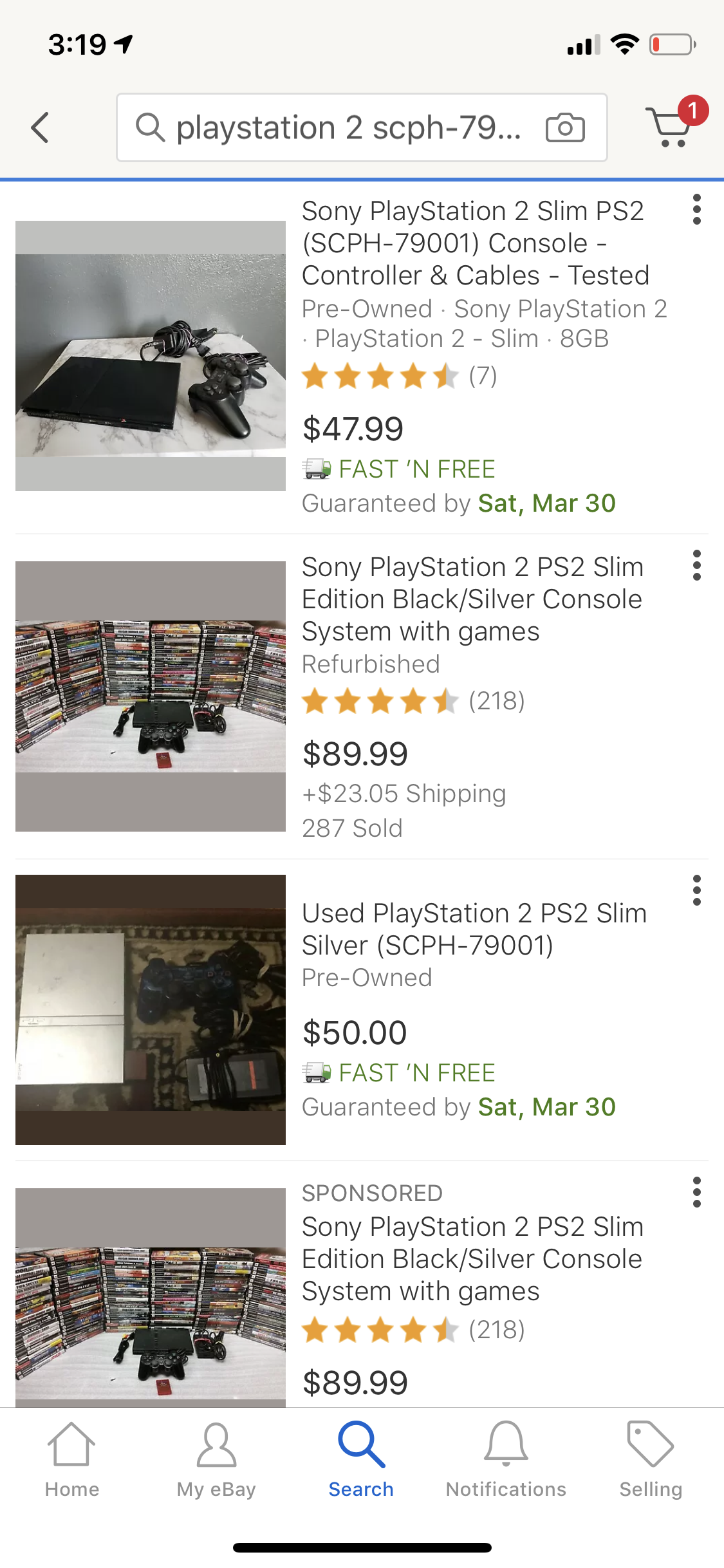

Ok that sucks. I cannot find a single 7900x model anywhere on the internet, it's like they are secretly sold or something. I'll check the voltage of the ps2 adapter and then I am guessing that I need the exact same voltage as the ps2 to get it to turn on.

eBay man, I buy ones that say “disk drive is broken” since I don’t need it for my portable, though don’t buy too many lol I still need more of them, and like I said man, double check the amps it needs before you supply more voltage, if you’re supplying less than the required amount it’ll either not turn on or overwork the batteries and overheat them you can be supplying 10v but if the amps are not enough then it won’t turn on because it doesn’t carry enough current

I can't find a single 7900X model PS2. I look every once in a while and I'm never successful in finding one. I was thinking of getting two 4.2v batteries to get it to 8.4v. I'm not sure if that would work yet.
Like I said man, eBay trust me.
