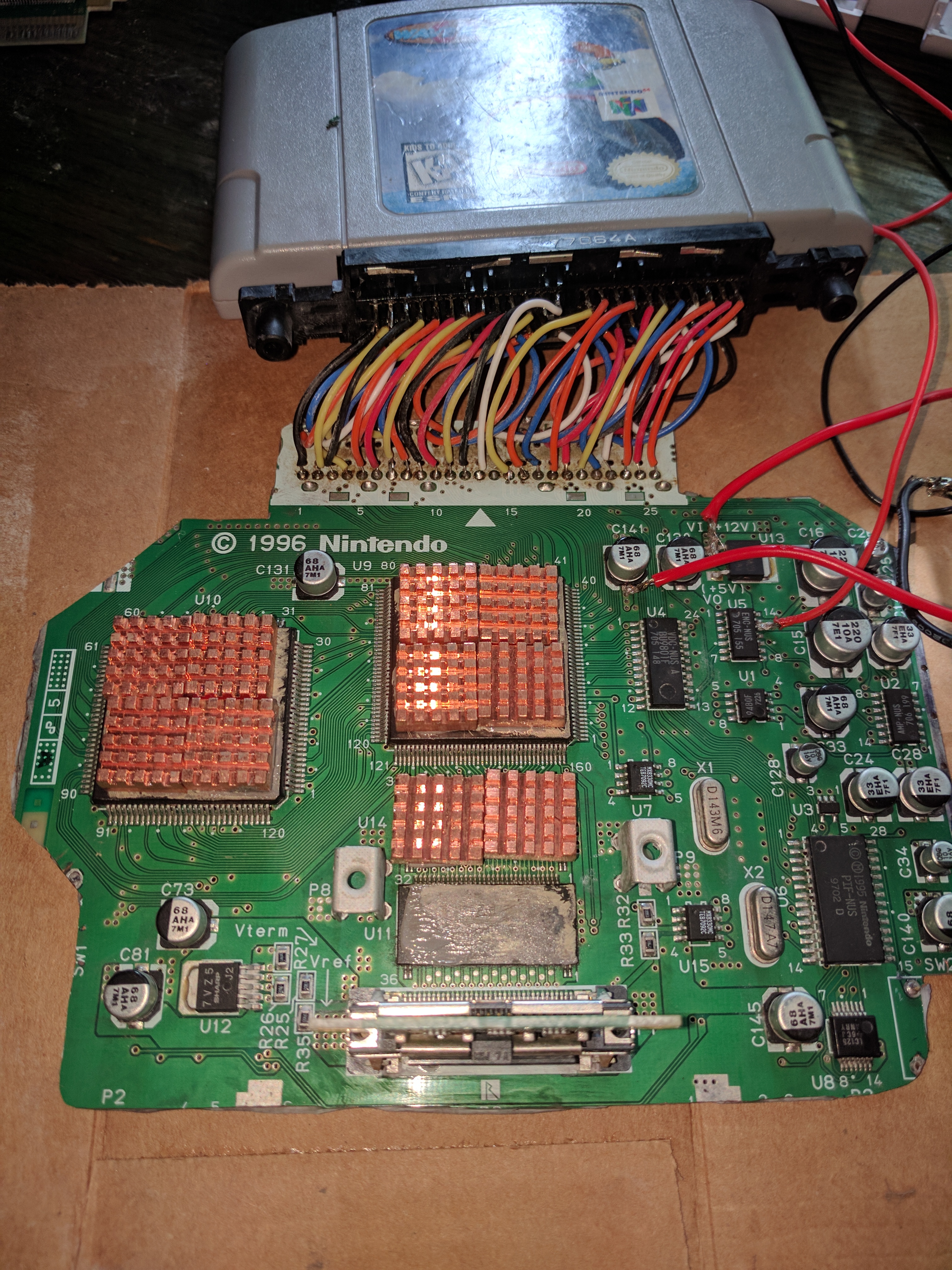

and then started in on a board reduction. I didn't bother with sanding yet because im going to go for the full reduction. A single board reduction will not fit into the gameboy advance carry case.
I wanted to test it after I did the first reduction, but I made the mistake of taking off the cart port. Although the LED came on... I need to do a full test before reducing it again, so Im currently in the process of wiring up that cart port.

Just finished up for today. First, I wired up the cart slot to the board
Then I tested it to make sure everything worked after the first reduction... I used wave runner :)
I then reduced the board even further..
And cleaned up with iso alcohol
and made sure it fits into my case

Heres a shot of my board
It wouldnt boot up today. There is probably a jump somewhere on the board and I will test it again after getting some compressed air

As to your problem, my money would be on a wiring issue. If it was working before, but isn't now, something probably got bumped. Make sure there's no stray piece of solder bridging anything or a loose wire. Also try a different game.
I would suspect that something is up on the n64 end, not the screen. You're getting picture to the screen so everything checks out there.

In regards to my issue, I got some compressed air and blasted the cart slot. A little piece of solder fell out. I also rewired a couple of cold joints on my card slot relocation. That seemed to have done the trick and were back in business.
Felt so good to see waverunner64 boot up after hours of frustration >:D
