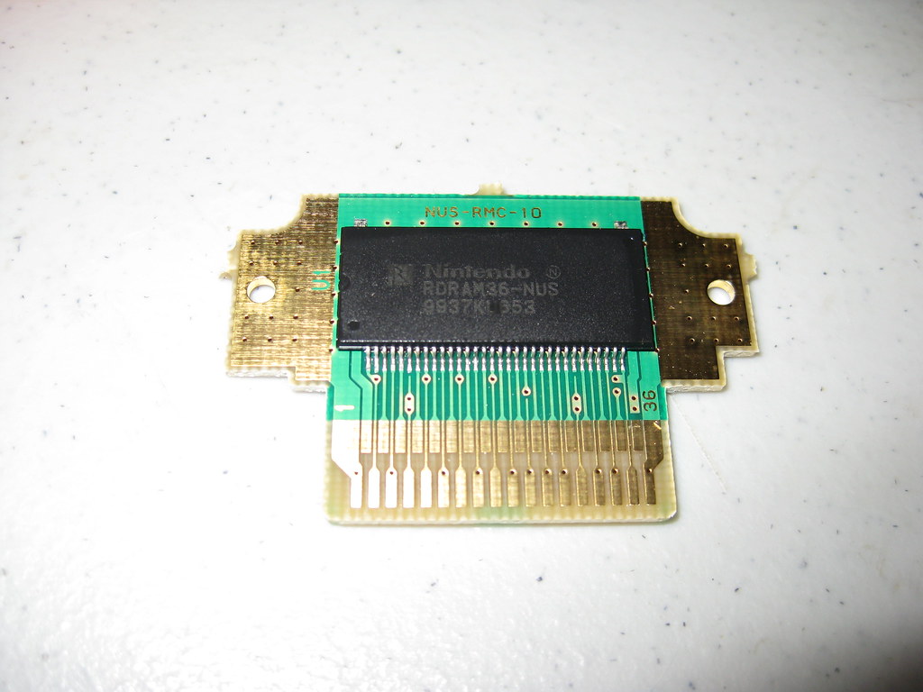

Hi again all, back from another break on this. I finally bit the bullet and trimmed my second motherboard. This time it came off a treat, working as expected.
I've hit a bit of a snag though with the expansion pack. I went to bend it as per the instructions by Bacman from way back when, I cut through most of the way and bent it with equal pressure. It looked fine and I reattached ground on the back as well as connecting the pins to the rear of c7 and c8. After being plugged in it didn't work and in the process of trying to troubleshoot I removed and inserted the board several times resulting in the thing snapping. In my reluctance to by another expansion pack I spent the day tring to manually wire the thing back together, I used my phone as a magnifier and all the connection looked good but no joy.
Am I missing something when it comes to wiring the expansion?

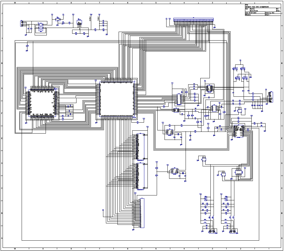

It looks like you bridged pins 1 and 2 on the ram stick. One should be GND and the other should be VCC at least according to this schematic.

Thanks for having a look. I bridged the 2 pins as it looked to me like they went to the same contact. Is that not the case?

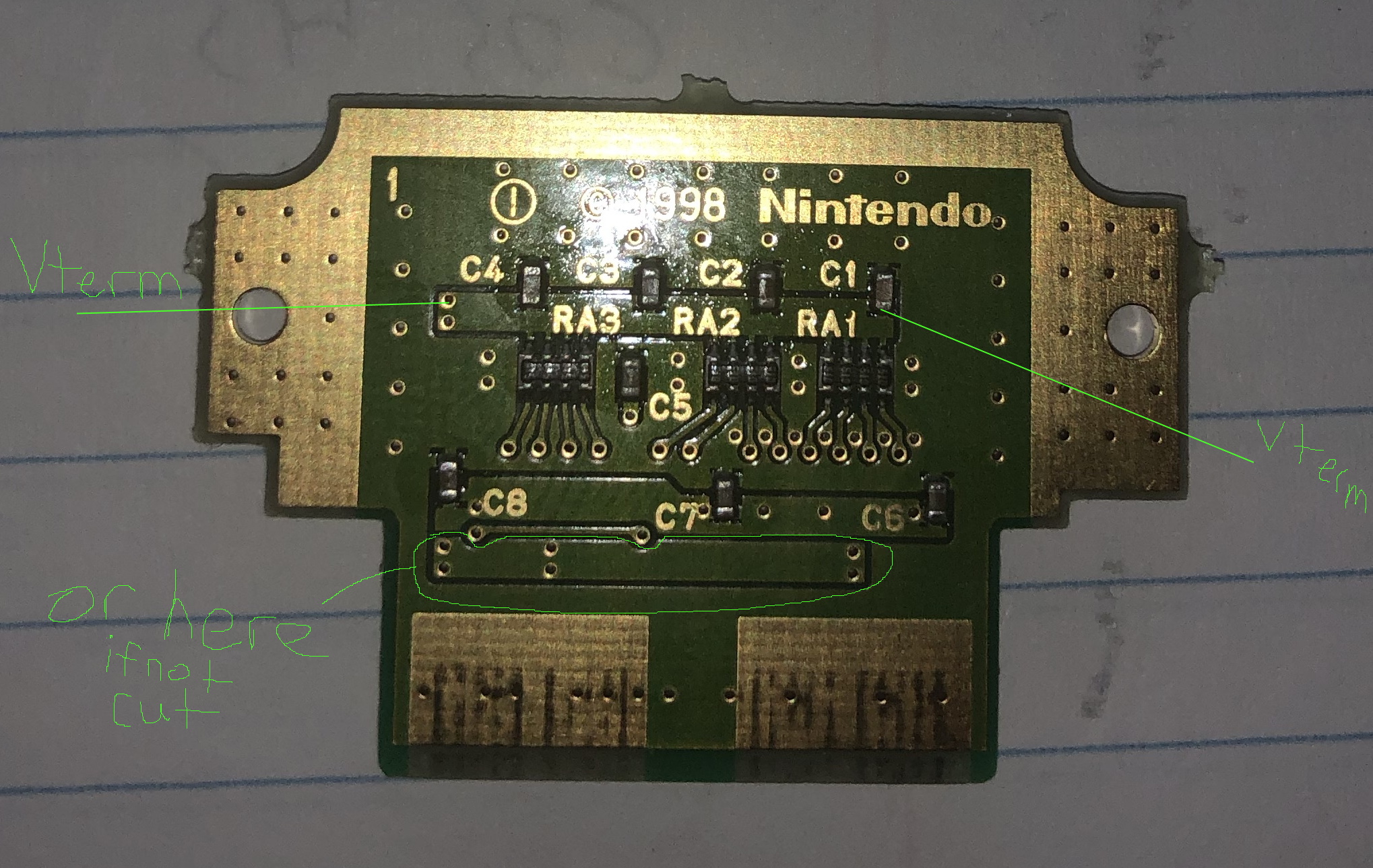

TLDR:connect pin 1 of the RDRAM to pin 4 of the expansion pak board and pin 2 should be connected to ground( pin 1 of the expansion pak board should work).
When I tested it with a multimeter pin 1 of the RDRAM (far left) went to pin 4 of the expansion board and pin 2 of the RDRAM was connected to all the blue. The blue pins should all be ground and the red should be VCC(3.3v) with pin 3 of the expansion pak board being the result of vterm after a voltage divider looking thing. The green pins 8 and 28 of the expansion pak board should be a signal straight from vterm.

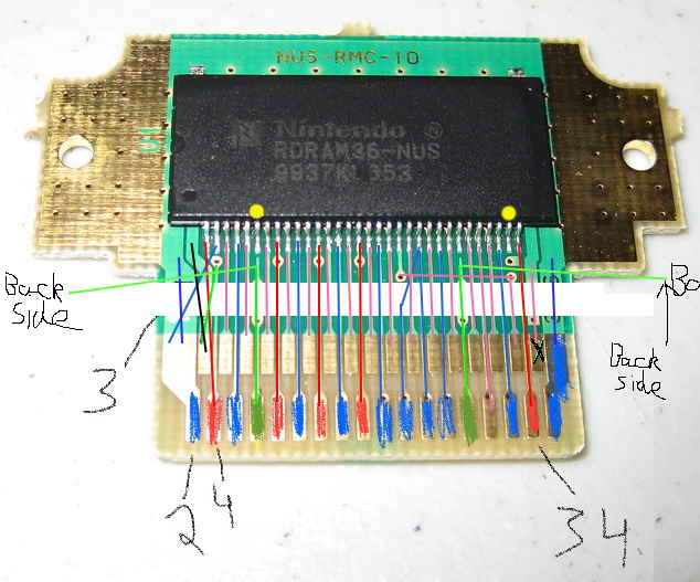

Thanks again for your assisance with this. Based on your notes would this be an accurate diagram of the wiring? I want to make sure I know what I'm doing before I put a bunch of time of something that might not be correct. Also, I marked 2 pins on the chip in yellow that I'm not sure what they connect to, any ideas there?
Looks like you are talking about pin 6 and 31 of the SDRAM. Pin 6 I believe is NC(not connected) to anything and 31 is GND along with pin 30 so those can be bridged. I want to say that is an accurate drawing you did minus two things. Your first green line needs to go more to the left at the top( I drew a black line) Your other two green lines need to connect to the back of the board on the area that I noted. That should get everything wire back up correctly.I do know that others have talked about wire impedance and how the wire that connects the jumper/expansion pak needs to be a certain length but I don't know how long or whether that applies to this situation. Have fun wiring that up :)

Cool thanks so much for the clear instructions and images. I'll give it a go, it's going to take me hours but I have to give it a go. Could you tell me one last thing, the wire I'm using is super thin, should it be ok for the 3.3v connections? I'll try to keep everything as short as possible, man I hate tinning magnet wire!
No problem! I spend the past week going over the n64 motherboard schematic so it’s pretty fresh for me. Mmm I want to say yes the magnet wire should be fine. AFAIK you shouldn’t use magnet wire for things like wiring your batteries to the PMS/PMS to the n64 board or anything else with a relatively high current draw. Although I got to say watching magnet wire get red hot is pretty satisfying ;) Yeah, tinning magnet wire is not very fun.
Well I got it done, checked the continuity as I went, looked all good. Didn't bloody work. Looks like I'm buying a new one :'(
Well rip. One last thing you can check check is if have continuity between pins 3 and 17 of the pak board.... if you do, then rip. If not you can try connecting them and seeing if that works.
Unfortunately the process of removing the pak from the motherboard dislodged a lot of the wires. I haven't got the inclination to try a sort that mess out on the chance there could be one more wire I need to connect. It took me about 5 hours to wire all that up and trying to solder around stuff that's already there will be another level of frustration. The other option is to start again and work from one end to the other, so I can stay out of my own way, but I really can't be bothered to do it when the outcome could be another bust. I'm off to bed.
