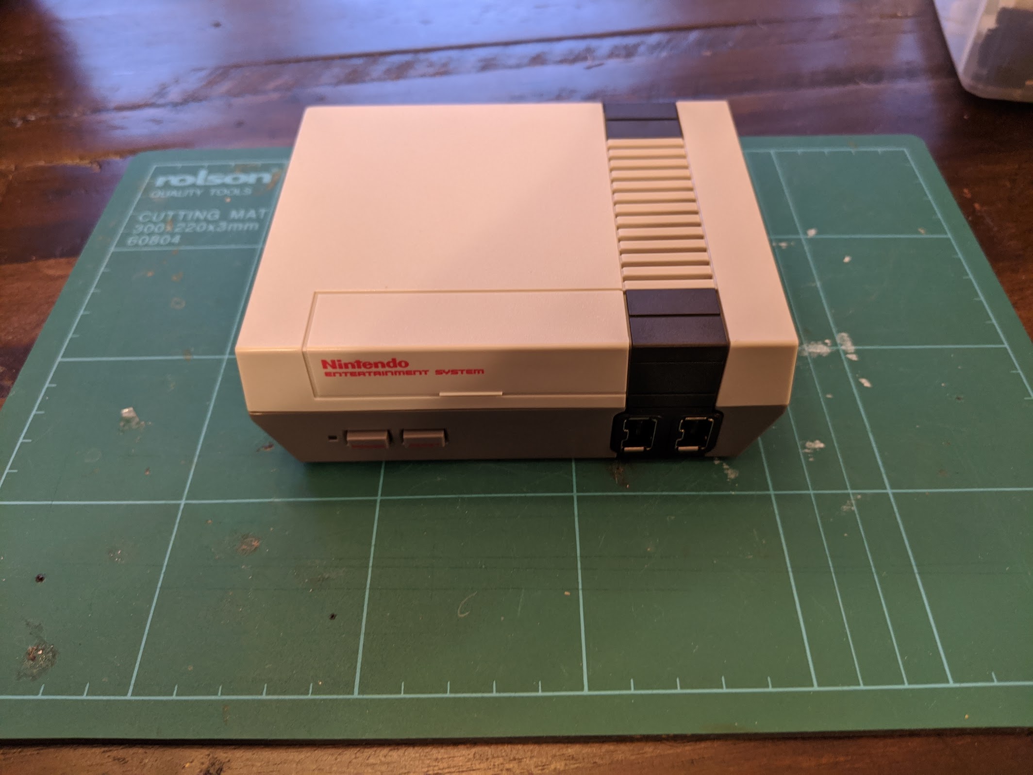

Case
I found a "for parts" NES Classic on eBay for $10 delivered, the original PCB seems fried but the case and buttons are in perfect condition.
The power button is a nice clicky latching switch, just like the original NES, and the reset switch is a little tact switch.

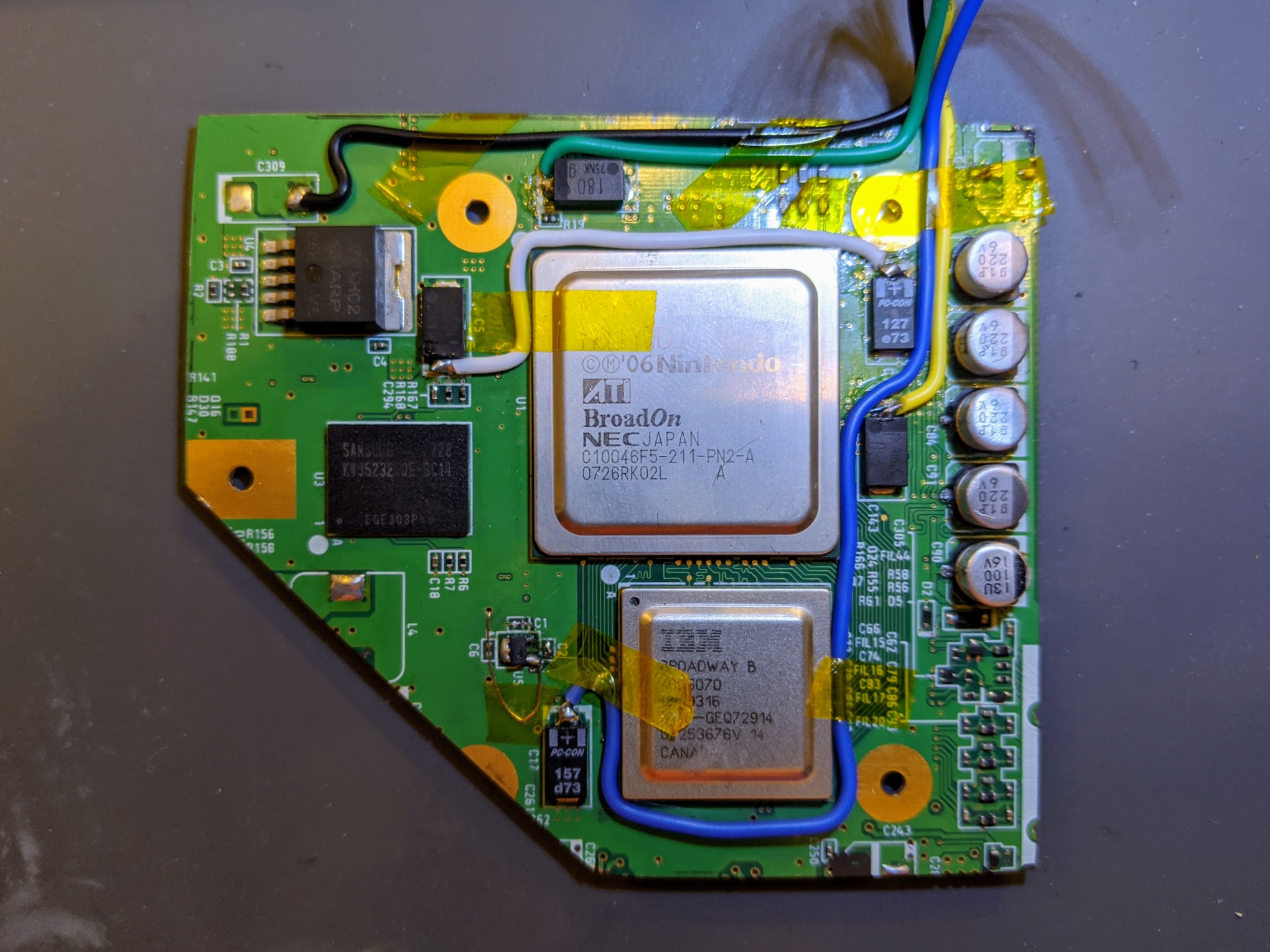

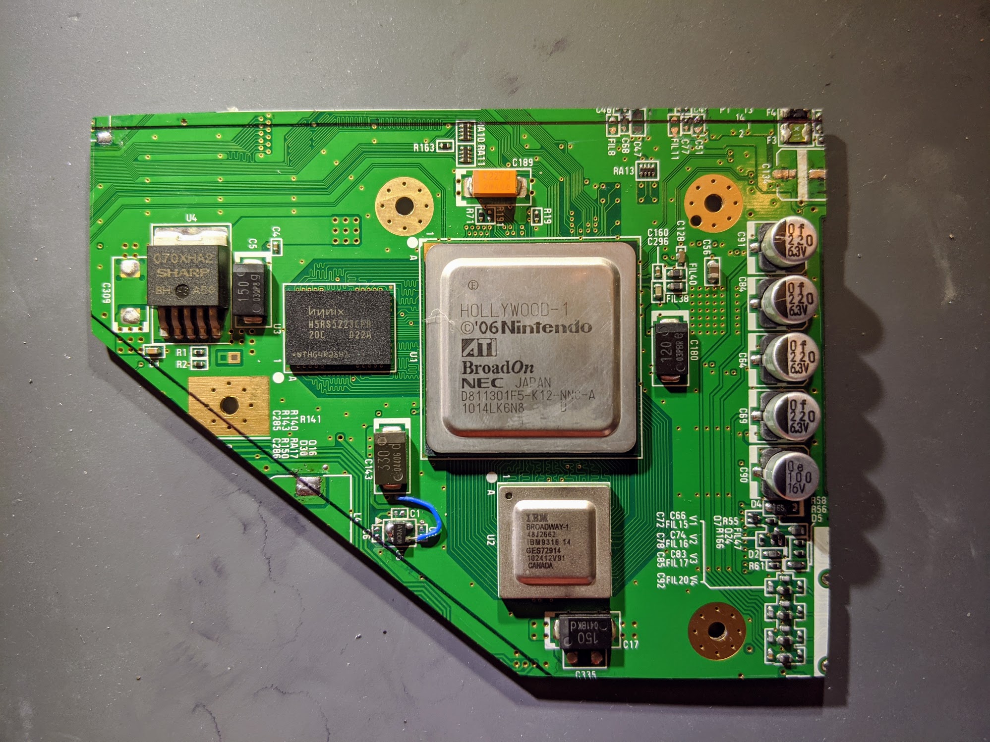

I originally attempted a a 6-layer trim, since this isn't a portable and 6-layer boards are so cheap. Unfortunately I could never get it to work after trimming so I abandoned ship and bought a 4-layer console.
This time the trim worked great. I had a bit of practice removing (cough, destroying) the U10/U9 chips on my previous attempt, so I cheated and used some ChipQuik which made things WAY easier. The actual trimming and sanding part went well too.

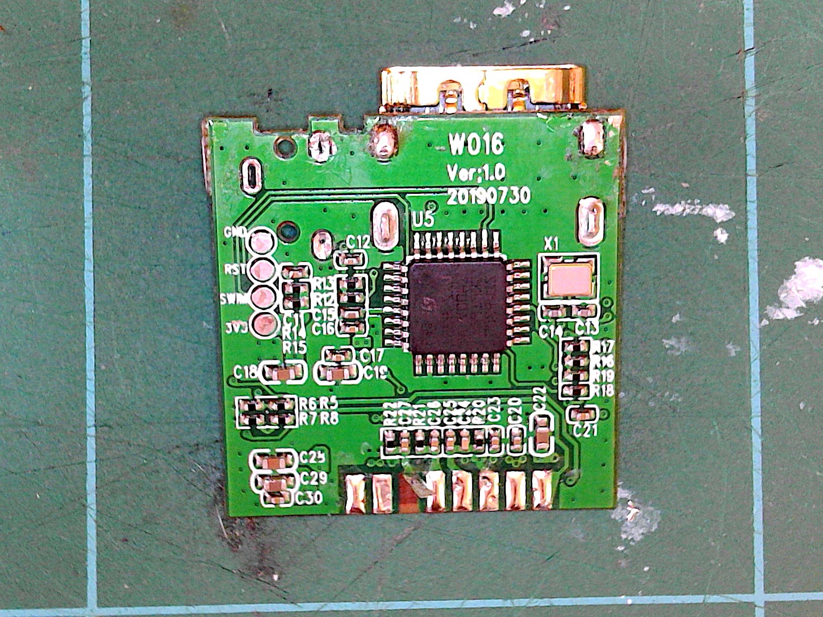

I decided to go with the Mayflash Wii to HDMI adapter due to it's good quality and small footprint. I desoldered the headphone jack and Wii A/V header. I managed to pull one of the pads when removing the A/V header, but epoxied it back down to the PCB.

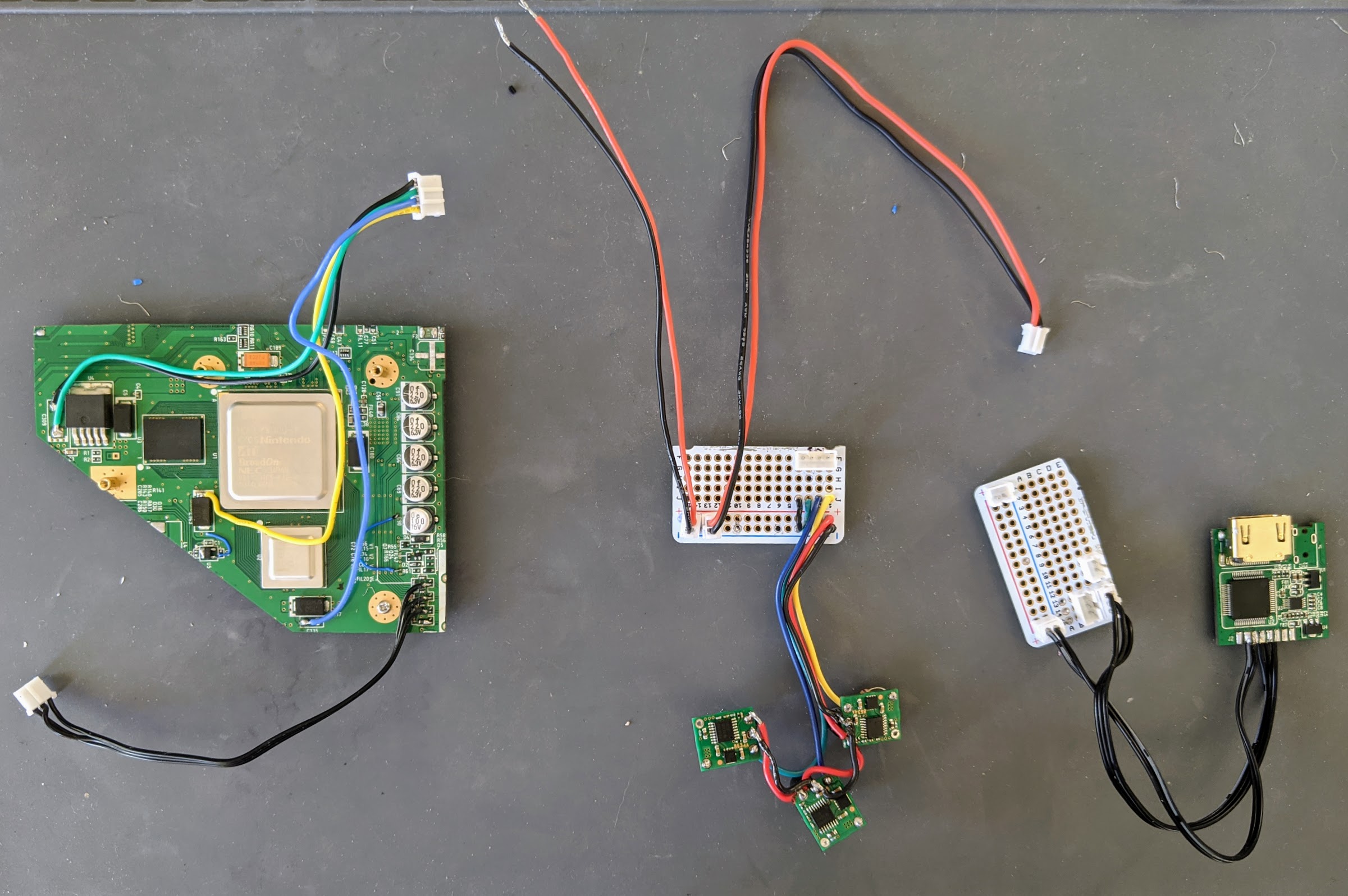

I knocked together a couple of breadboards for testing power and A/V, and used some JST connectors I had from a previous project to make things easy to test without soldering and desoldering.

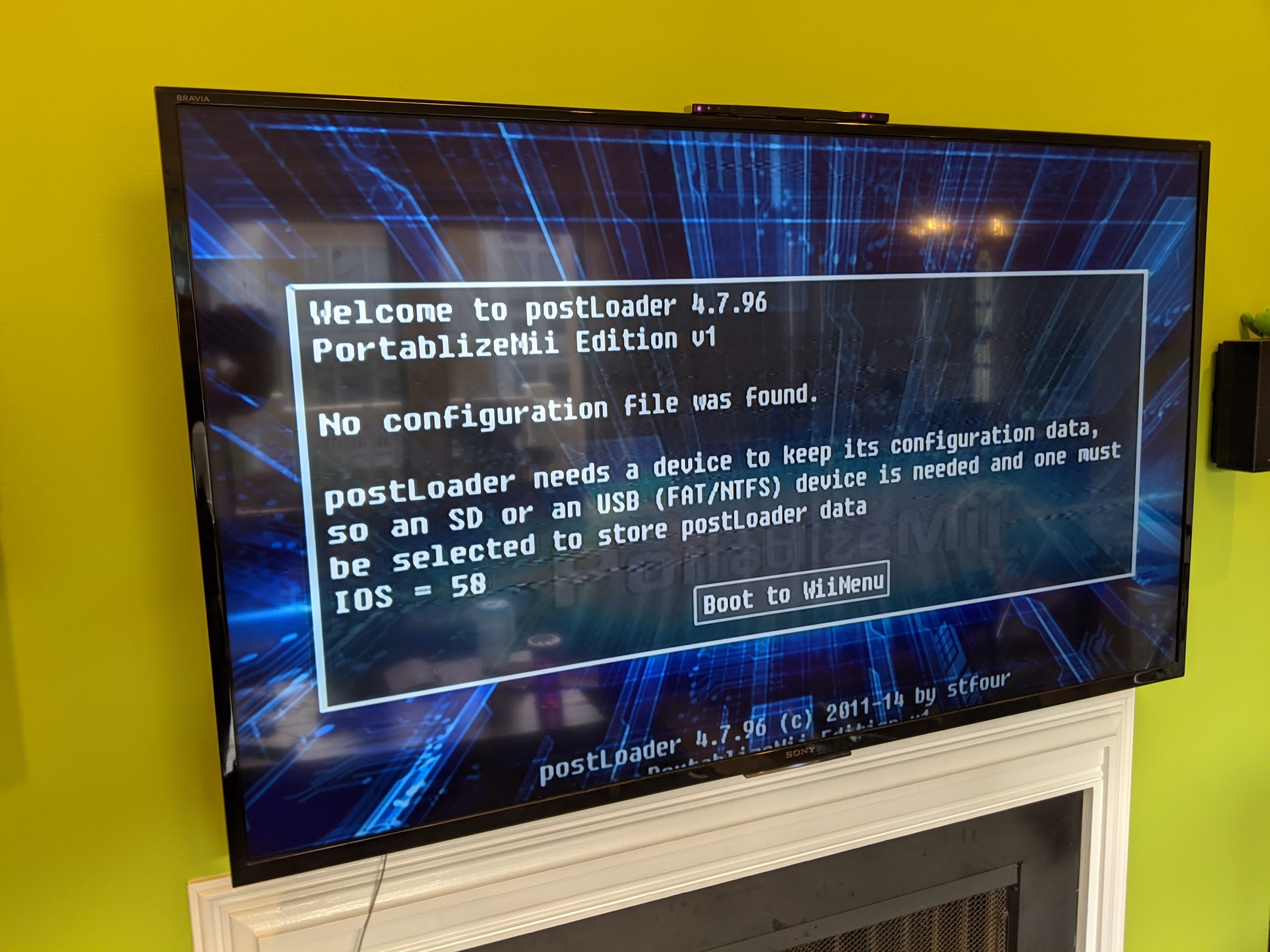

I was finally was greeted with this beautiful sight

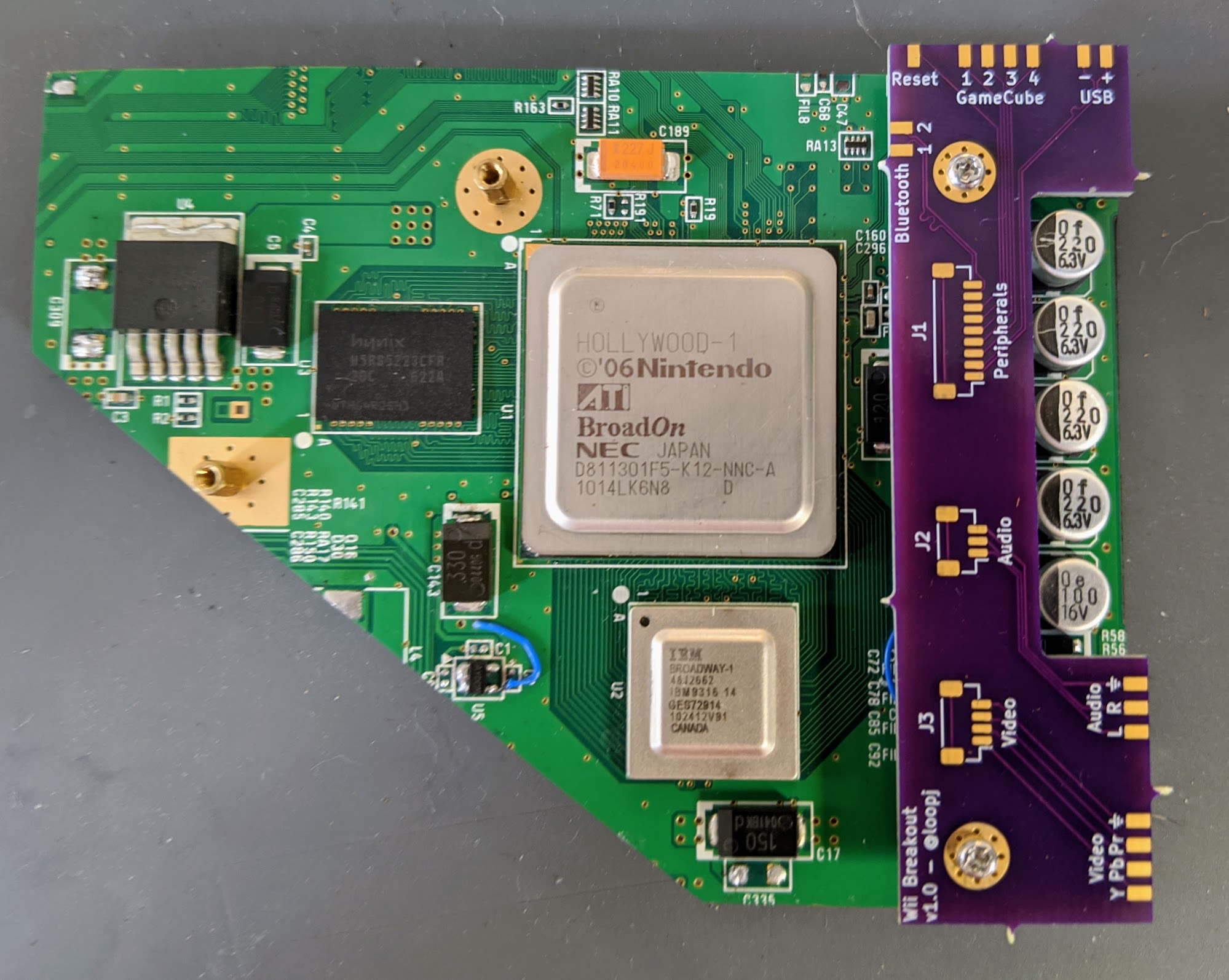

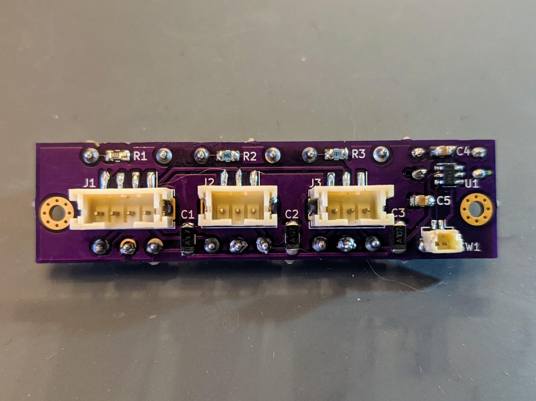

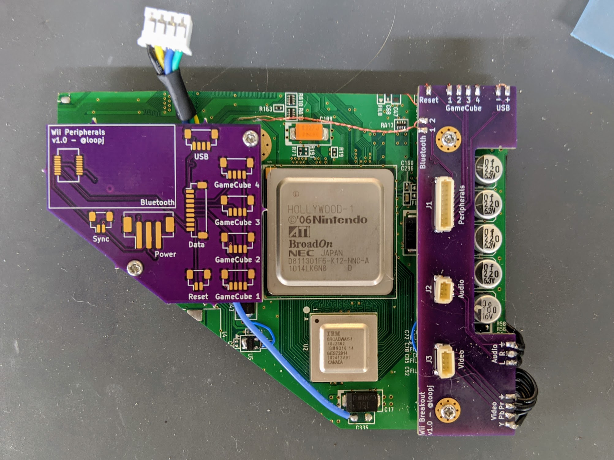

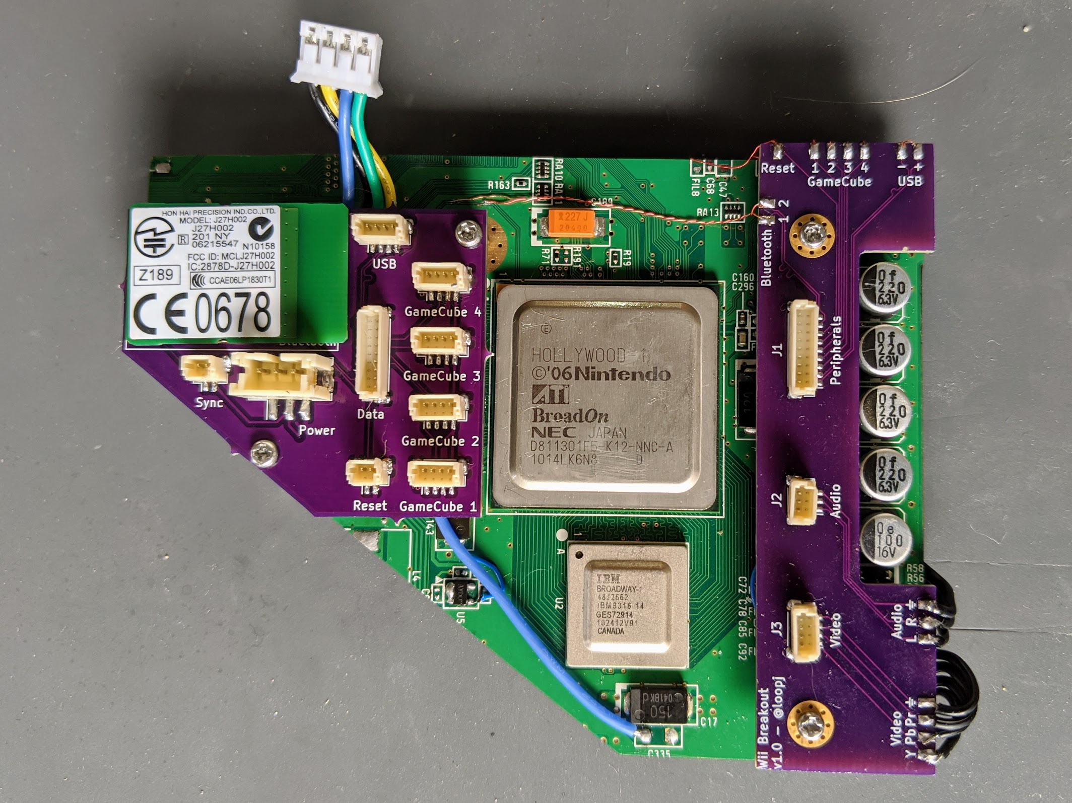

2. Breakout PCB
  • A board to "break out" the wires/traces from the Wii motherboard to headers
  • Mountable to the Wii motherboard
Here's the bare board mounted on 5mm standoffs to the Wii motherboard:
Here's the board populated and wired up:

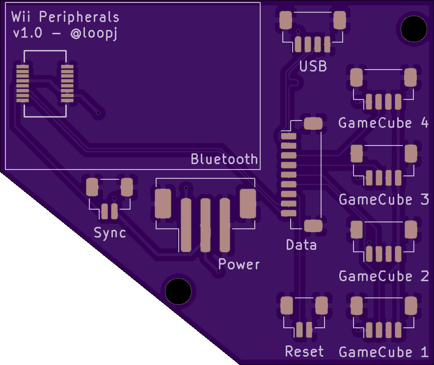

3. Peripherals PCB
  • Takes power in from a Regulator PCB header
  • Takes data lines from the Breakout PCB header
  • Header for directly mounting the bluetooth module
  • Header for USB
  • 4 headers for GameCube controllers
  • Header for bluetooth sync button
  • Header for reset button
I'm still waiting on this one to come back from the fab, but here's a preview:

My peripherals board arrived yesterday, here it is mounted to the mobo:
And here it is populated:
The bluetooth module is removably mounted to the same molex connector originally found on the Wii motherboard. The connector is a real pain in the ass to solder.

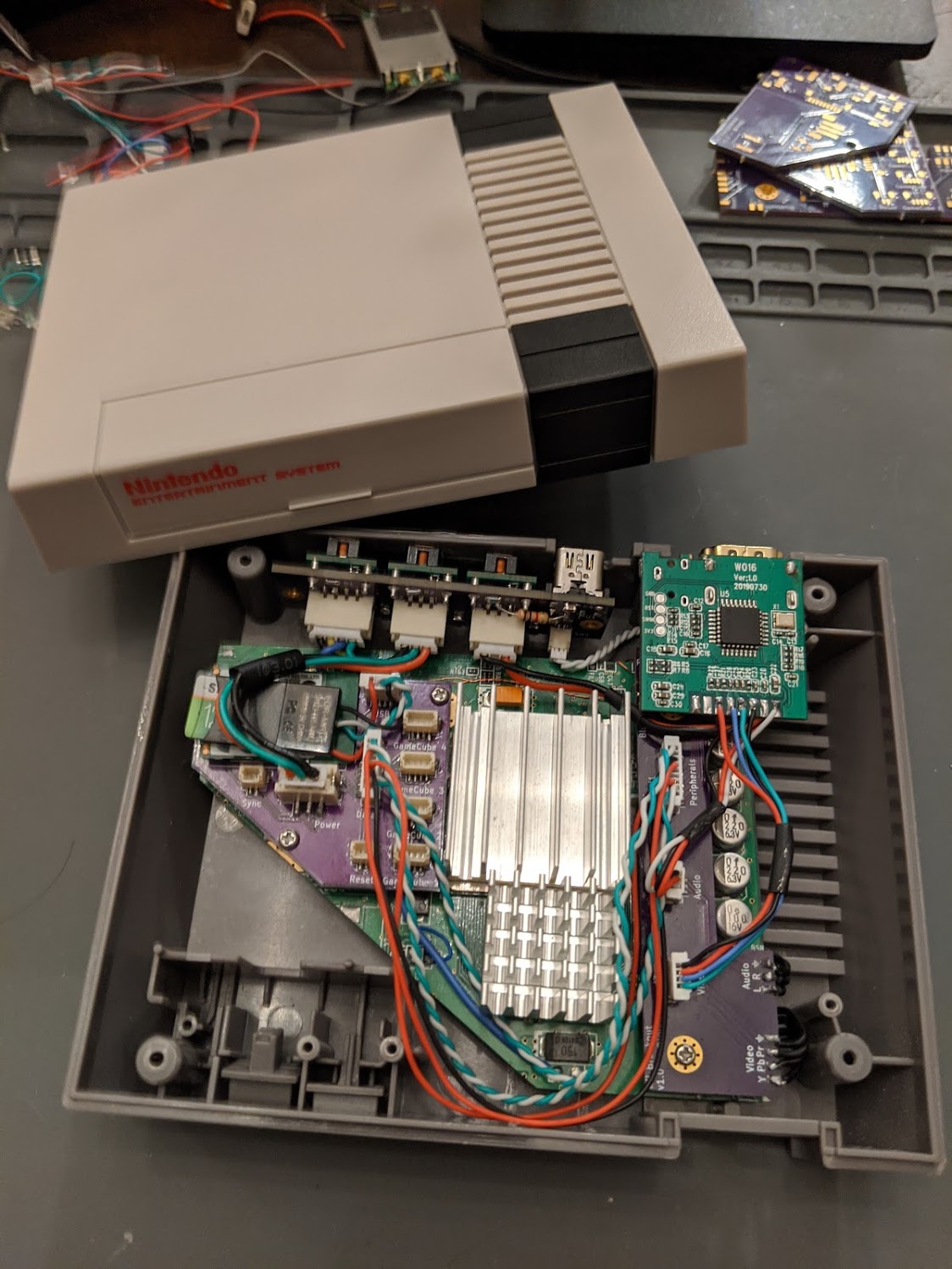

Heres what it looks like with most of the cables connected, I also did a test fit with some raspberry pi heatsinks:

I really like the Peripherals PCB. I presume you desoldered the bluetooth connector from the wii. If so, how did you go about that?
