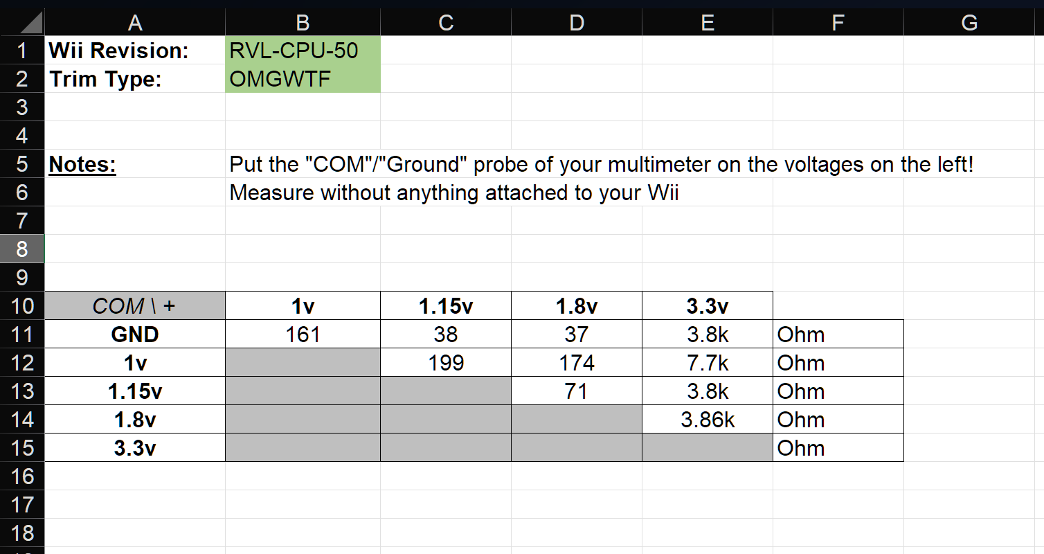

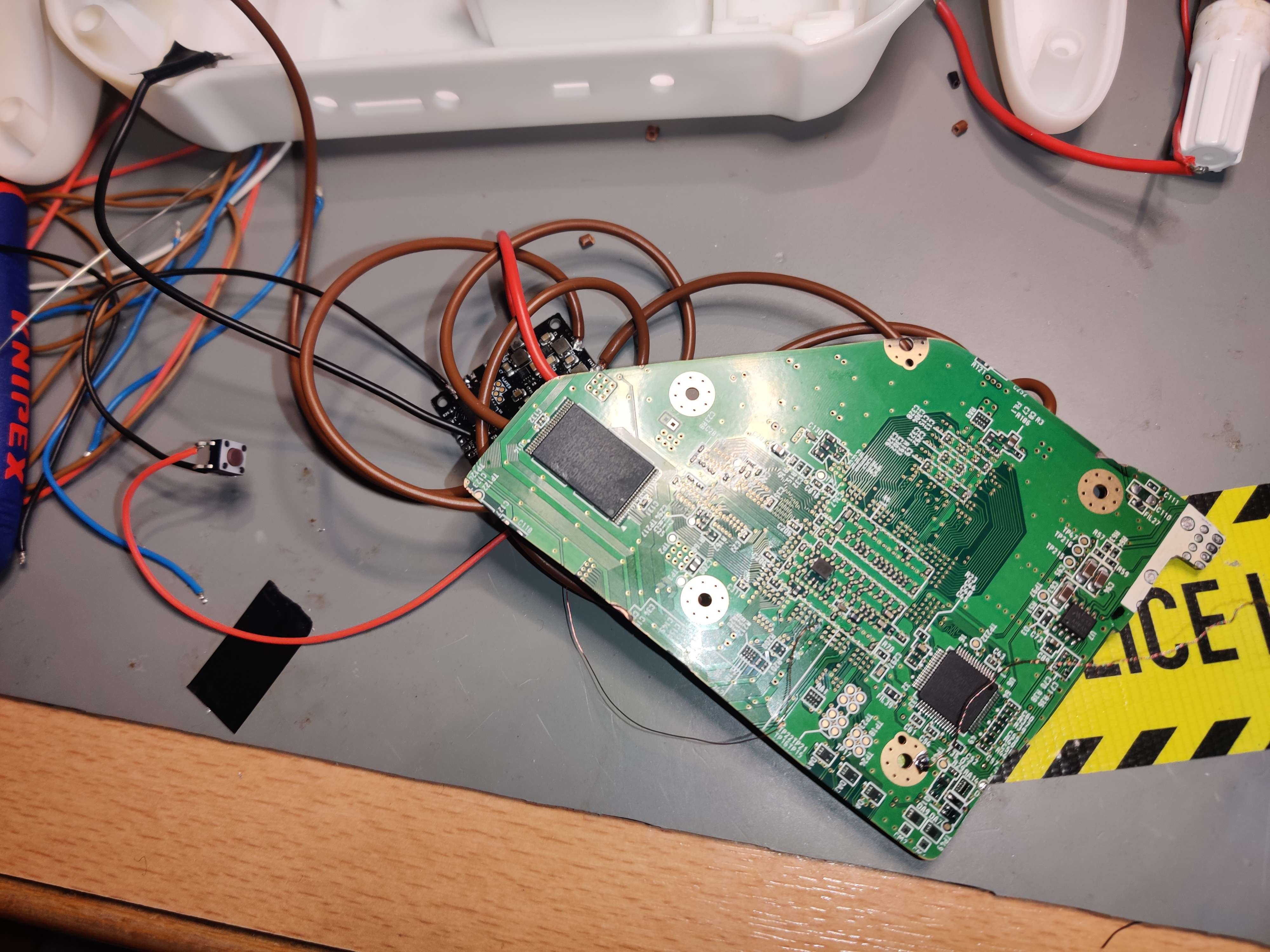

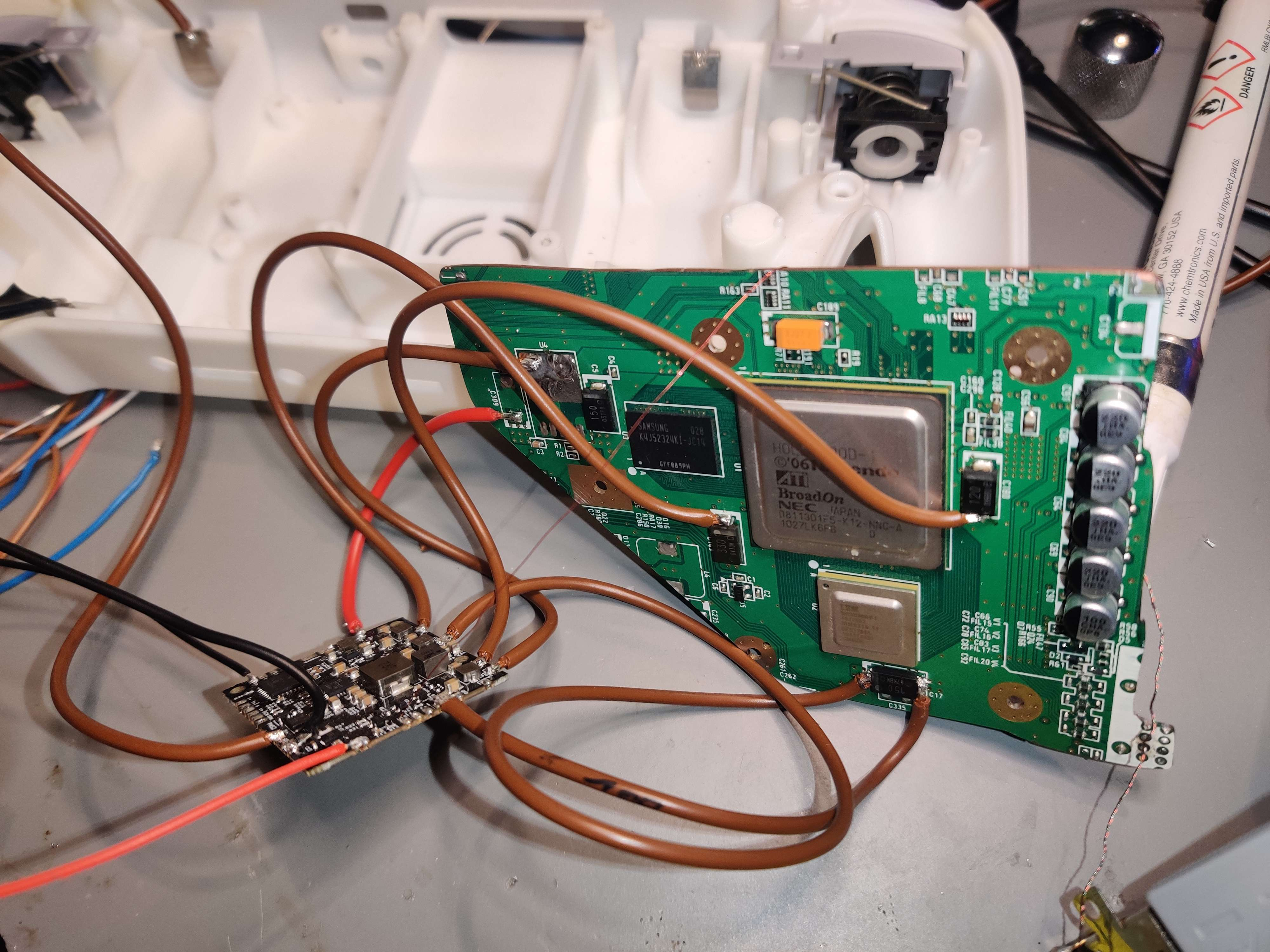

to clarify a few things: I'm using 20AWG wire, my battery measures 4.14V, I'm getting 1V, 1.14V, 1.78V and 3.27V from my PMS2, resistances look fine, the wii gets warm when powering on and gets all the right voltages, U10 makes a solid connection, I've switched between all points on the wii that are for outputing component (caps on the front, point near C57 on the back), i confirmed that the cable and tv are working, port is working as well and i didn't accidentally switch component and ground in my twisted wire, I've tried shielded wire for the port as well. and yes i did install rvloader and patched out wifi.
I'm a little lost because i don't know what to try next. any ideas? I have included pictures below.

i rechecked the voltages and on the pms2 board I'm getting 1V, 1.14V, 1.79V and 3.27V but on the points i soldered the cables to on the wii I'm getting 0.956V, 1.098V, 1.751V and 3.241V. is it possible that this isn't enough for the wii to fully boot? should i try different wires / shortening my wires further?

i remember reading in the wii undervolt "guide" that "1v is pure silicon lottery, some can run at 0.8v while others can barely manage 0.99v.". I might have to look into that since its only getting 0.956V. do the others sound fine?
That voltage under load should be fine

Can i be sure that the trim has no issues solely based on the resistance values looking good or could it still have issues? In RVLoader before trimming i toggled Patch Out Wifi "YES" and VGA "YES", waited till the process was done, booted it up to confirm it installed correctly and then went onto trimming. so it shouldn't be an installation error either.
The resistance values only indicate if there is a short between the voltage lines, other issues will pass that test and require more involved troubleshooting. Your resistances look fine to me, so there's likely something else at play. First thing I can suggest is reflowing all the solder joints. Your 1.8v wire in particular looks like it might not be making good contact with the Wii

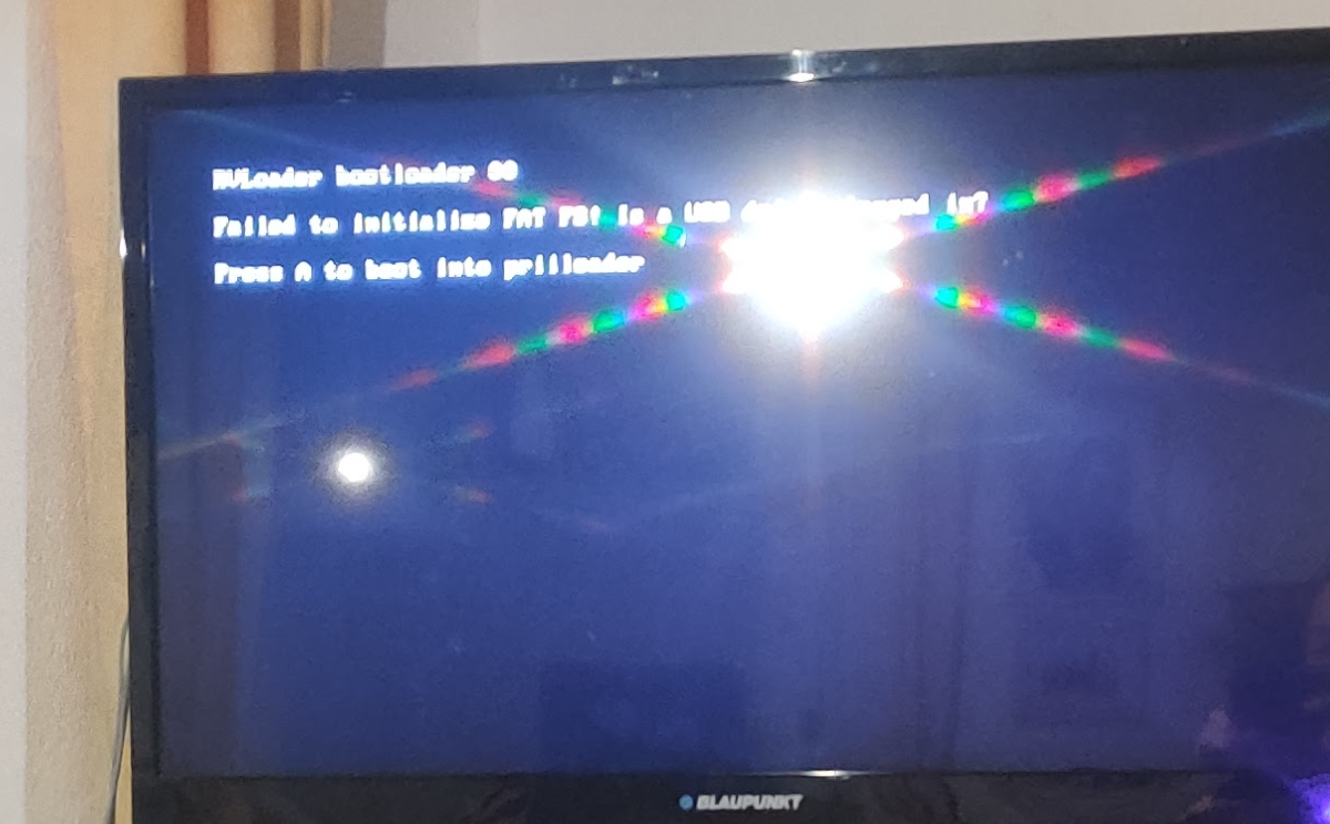

it outputted composite video just fine. I'm using the pms 2 and pms pd because i felt like the batteries aren't charged. whenever i went the near the button on the pms pd (which i used to turn on the pms 2) the output stopped for a short second and the image was a bit static-y. like interference. is this a power issue or a composite video issue?
Hard to say. How many cells do you have connected to the PMS at the moment?
Just one. It's probably very low. It looked like a video issue because the Wii wasn't rebooting and it stayed on that USB error message screen. I'll try again today.
Sometimes just one cell cannot provide stable enough power to the Wii. Try with two fully charged cells and see if anything changes
