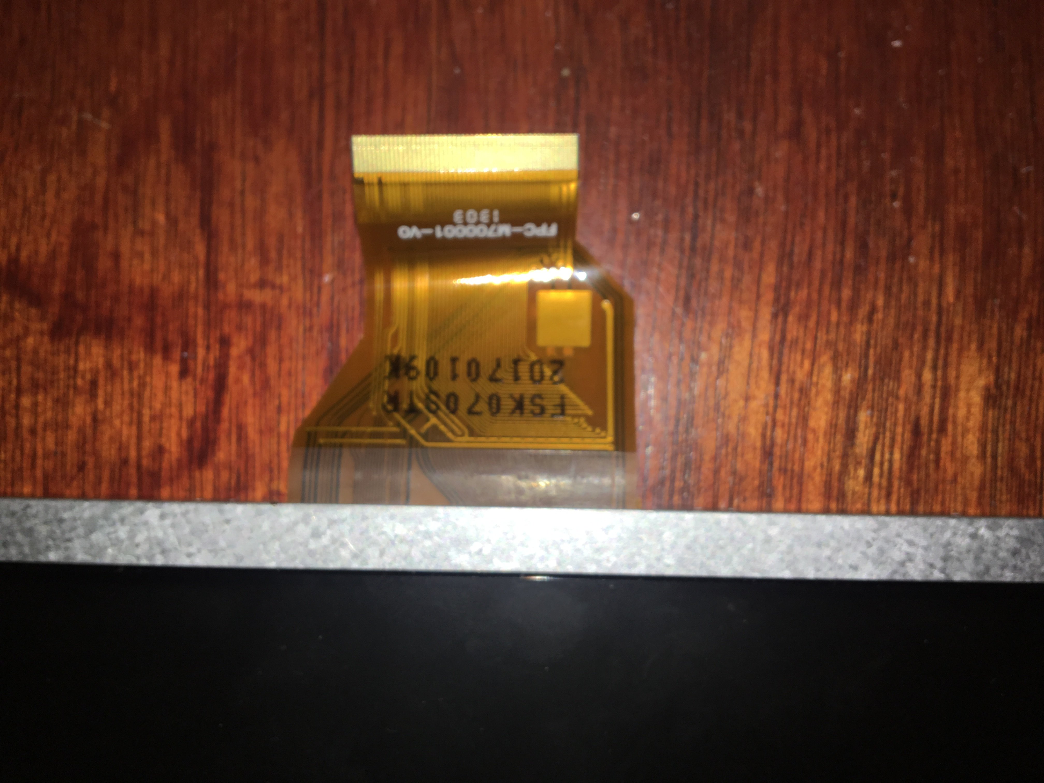

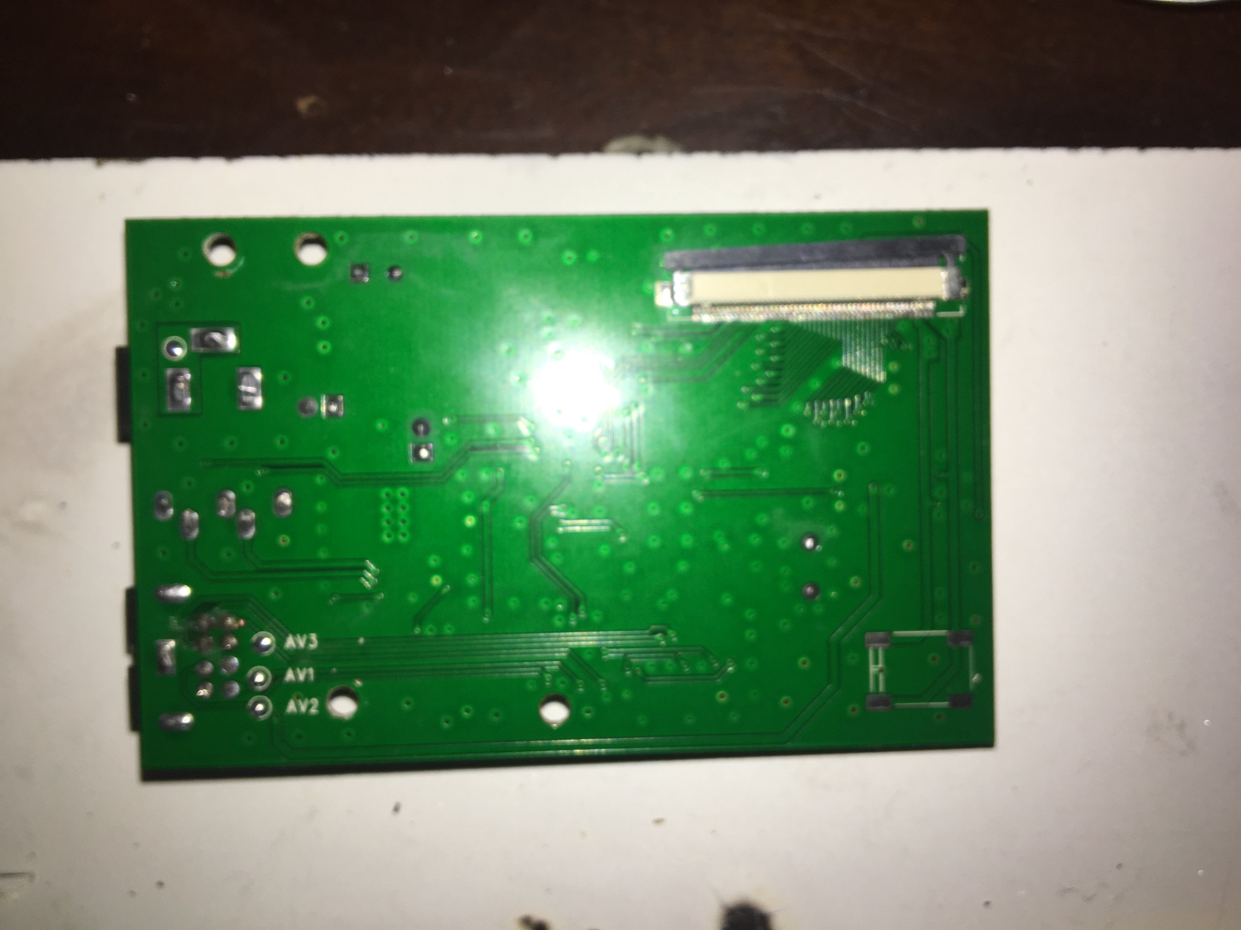

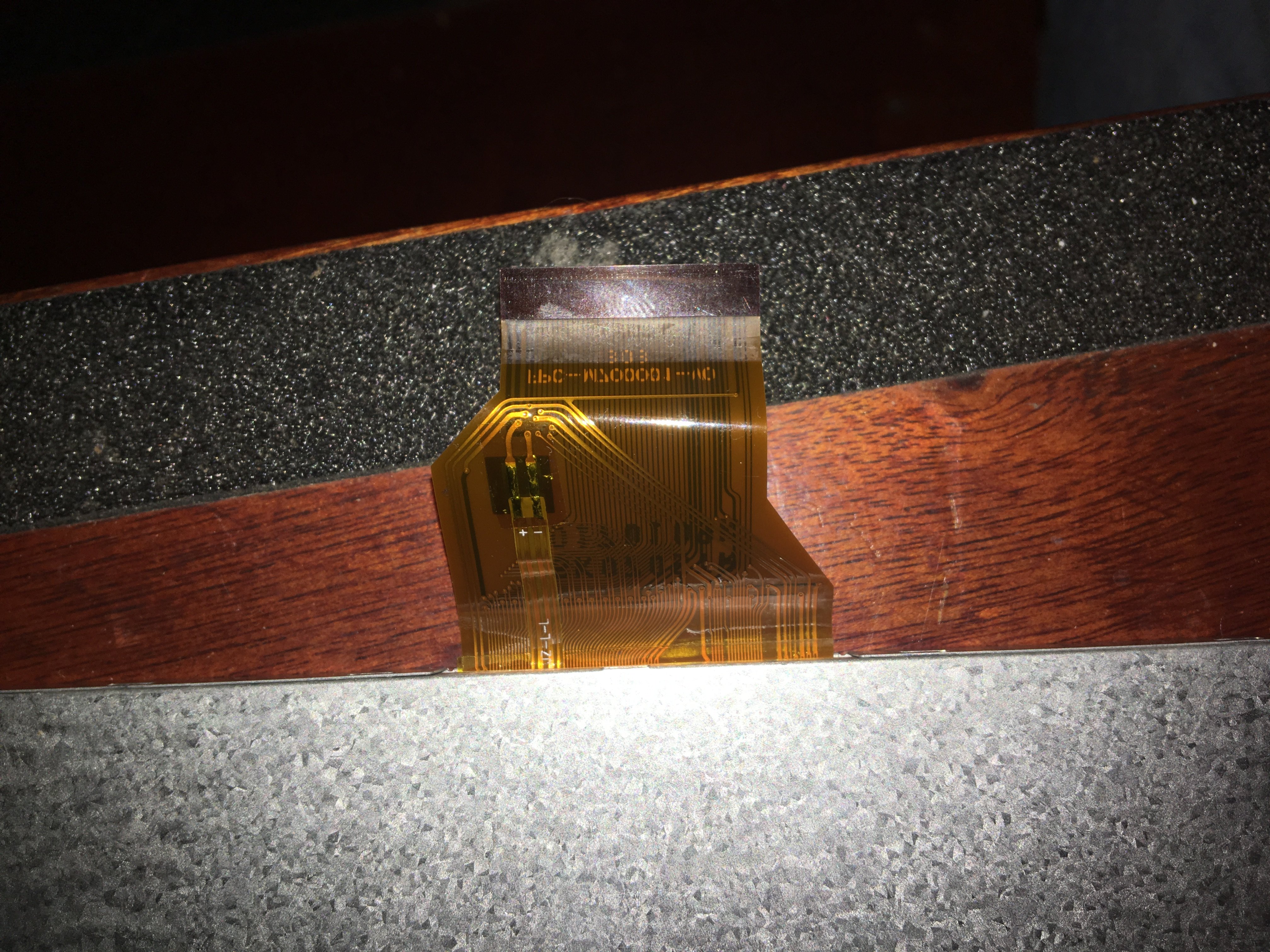

I think my display driver board is dead.
I don't know why but the center chip heats up to the point that I can't touch it, after 3 seconds. It draws about 6 watts, even when the display isn't connected. It's an L7009 display. I know @Aurelio has one of those displays so maybe he can help me. Here are some pictures of the driver board:
Driver board by itself: (the MST703-LF chip is the one that heated up, it is the big chip in the center)
Driver board bottom:
Display front: (don't know if it helps but why not)
Front ribbon cable:
Display back ribbon cable:
If any of the pictures isn't clear just tell me, I'll upload another one. Also, I would like to have this worklog moved back since there is a chance that I'll finish the portable in time (if I don't need to order a new display at least, since shipping takes ages)

Shit me I did a fuck
Front ribbon cable:

As for the screen, are you absolutely sure you're giving it the right voltage?
No, it was just turned on without video input displaying just a blue square with no signal on it.
Then it randomly shut off and stopped working. I really hope DX can ship me a new one in less then the 5 - 7 business days that it takes according to the shipping information. That is because the only other screen I currently have and can use is a 7 inch 480x234 display that only works with composite. I looks worse then a 240p youtube video.. If DX doesn't ship fast enough I don't think I'll be able to finish my portable in time.
