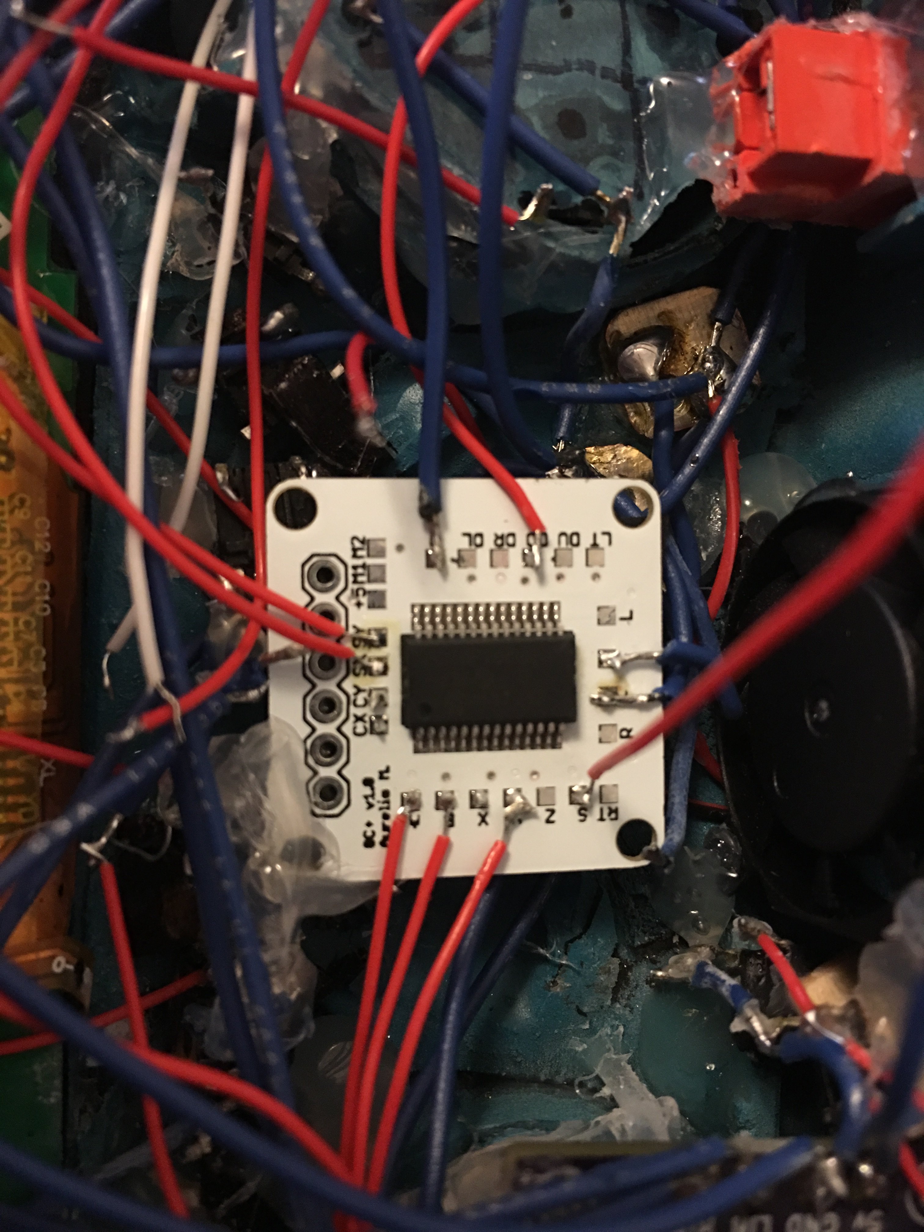

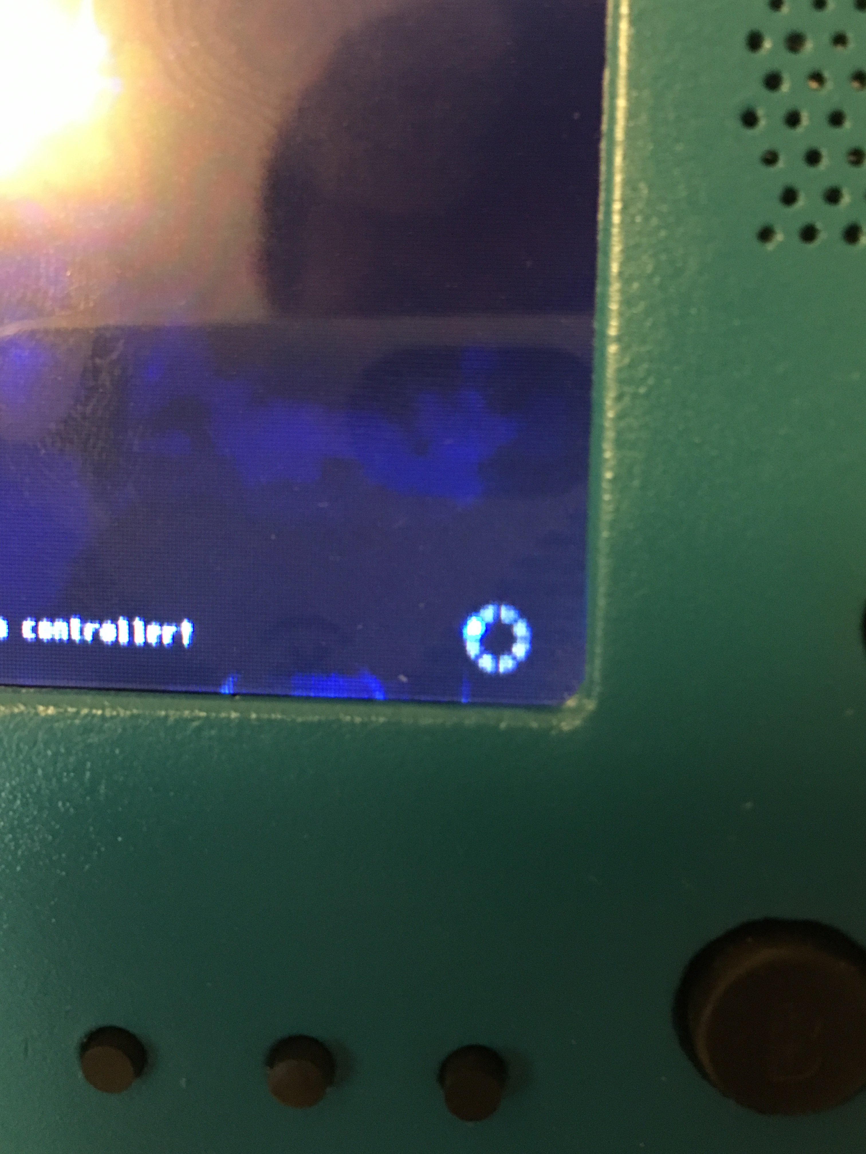

Sooo this a a weird one... I'm wiring up my gc+ board and some weird stuff is going down. Specifically with my main analog stick. I'm testing it out on melee and if I slightly and slowly tilt the joystick up and down, it works, but if I hard tilt it, I'm getting c-stick moves.. and my c stick isn't even connected. I don't know how it's possible but it's happening. Also, in the PM main screen, I'm getting a weird loading icon in the bottom corner of the screen(bottom picture) when I quickly tilt the analog stick. I can barely use the stick to make my way around the screen. Any help would be much appreciated!
View attachment 1894 View attachment 1893

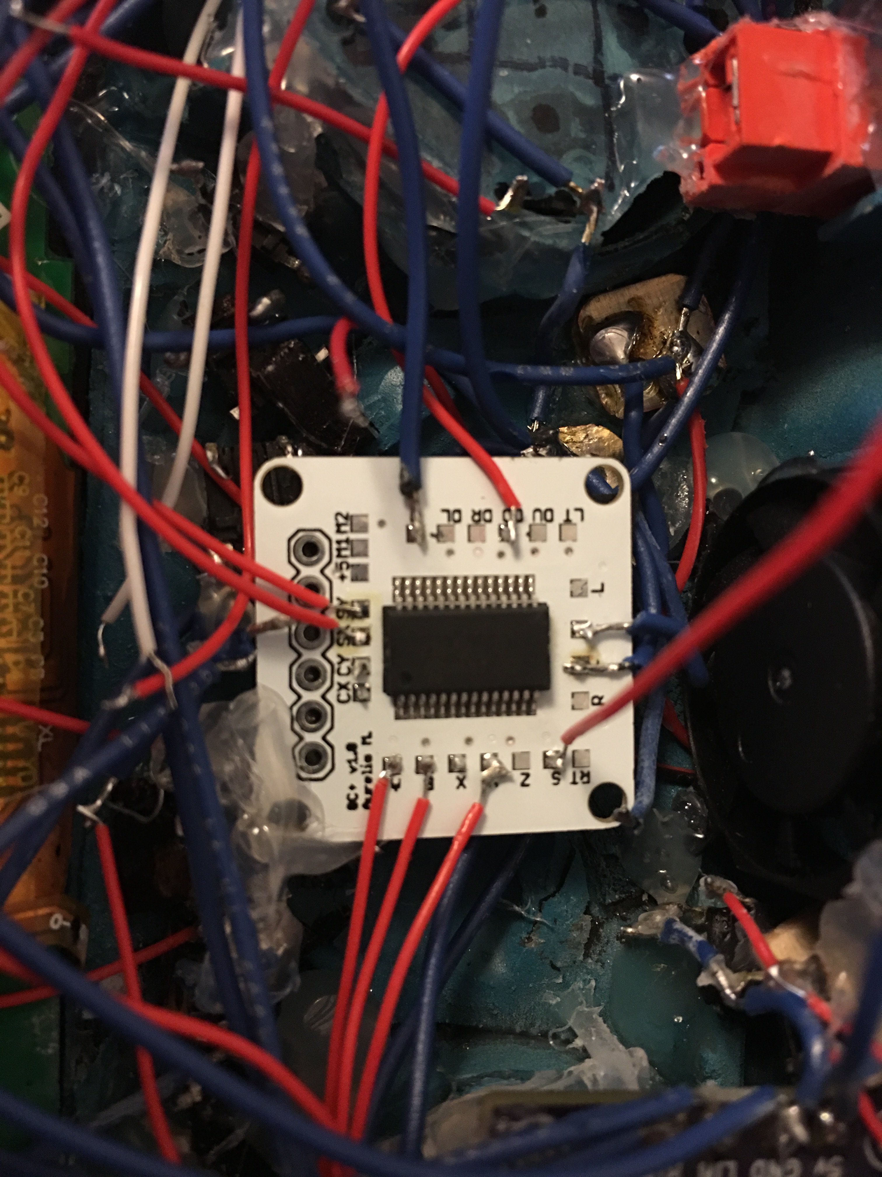

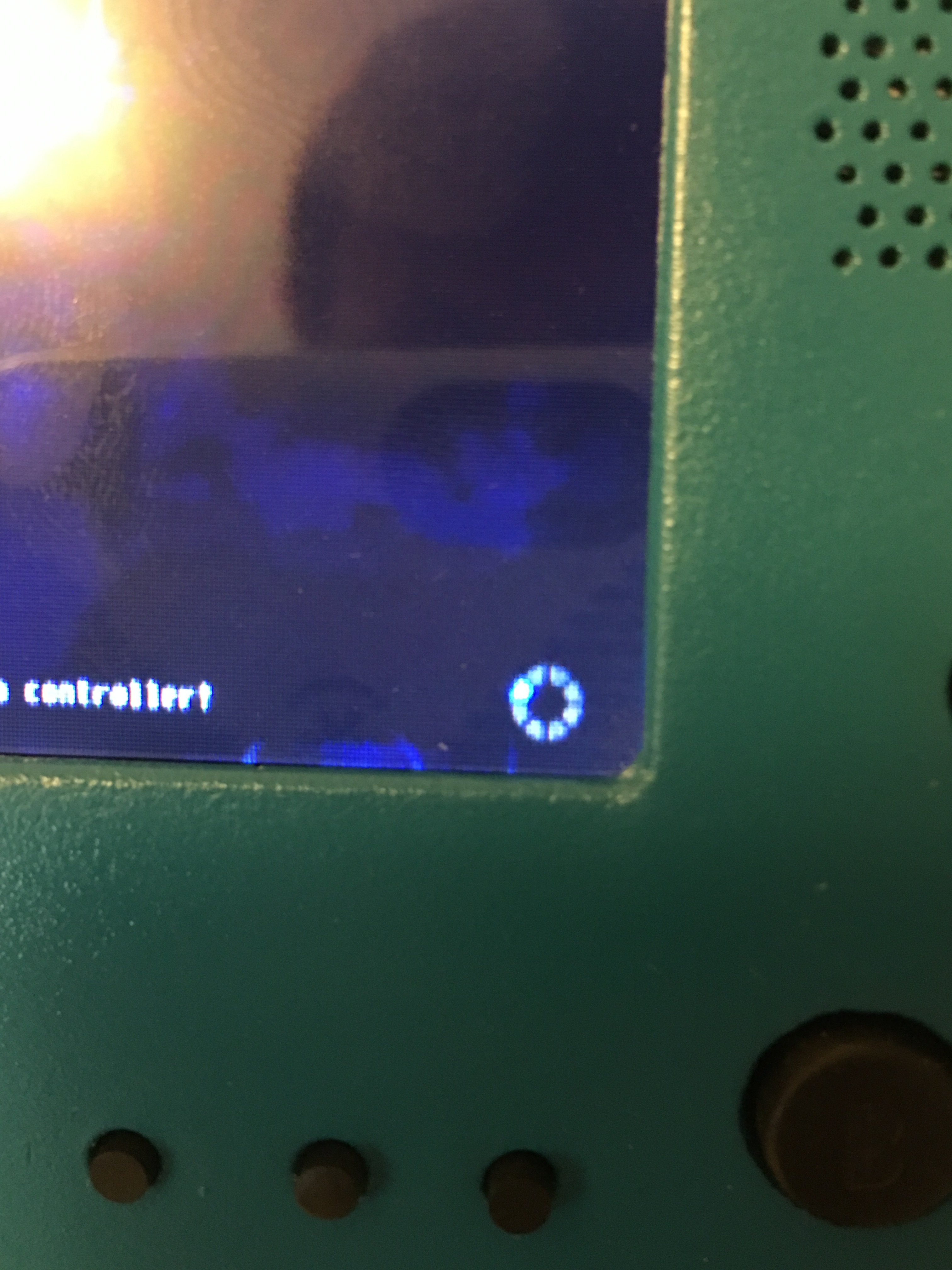

I think I read about this problem somewhere... but I'm too lazy to go looking. I think @cheese said that you'll see problems like this when the sicks aren't wired up. I could be wrong though. Try wiring up the C-stick and see if the problem persists.
