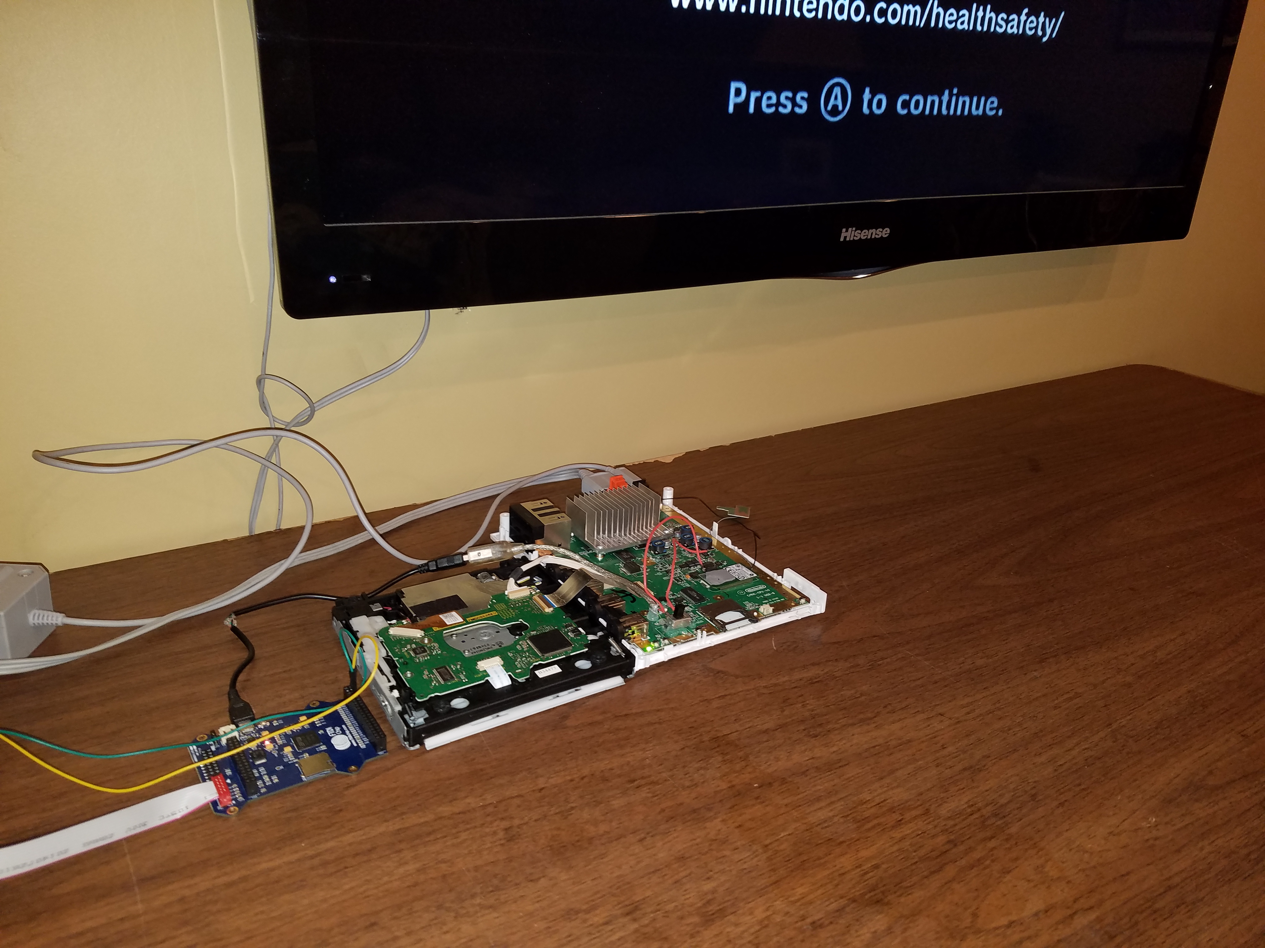

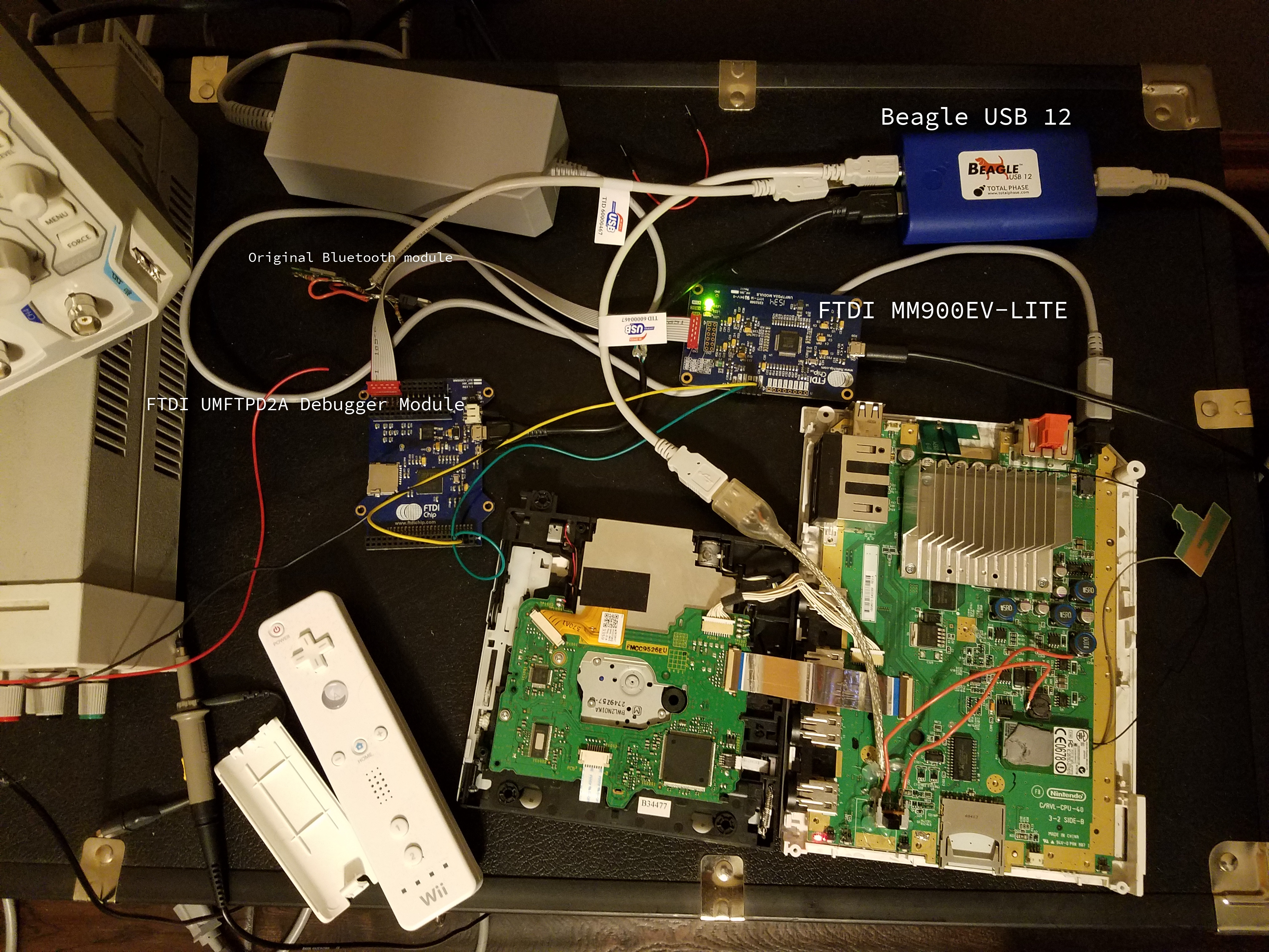

Here is the testing setup (edit: the FT900 board and the debugger labels should be swapped, too lazy to fix right now, sorry):
Alongside the dev board is a USB capture device (for sniffing traffic between USB devices), a programmer/debugger attachment to the dev board, and various Wii guts spilled all over the place. I've soldered a USB jack onto the bus where the Bluetooth module used to be and added a USB plug to the original module so I can switch out the modules easily as well as connect both modules to the capture device or a PC.
After writing some USB enumeration code and copying the USB descriptors of the Wii's module, the custom module is connected. Bluetooth has a standard interface called HCI that is used for communication between the Bluetooth host (Wii) and controller (module). Before it finishes booting, the Wii issues several HCI commands to initialize and configure the module, most of which require responses from the controller in the form of HCI events. Once proper responses to all of said HCI commands are implemented, the Wii boots right up:

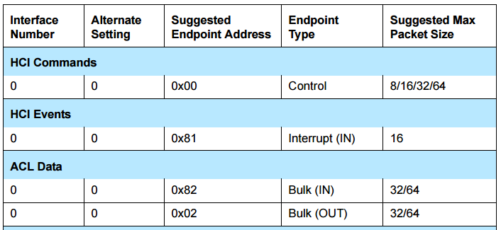

In USB Bluetooth devices, there is a typical, recommended endpoint configuration for USB Bluetooth adapters. Here is the relevant part of a table from the Bluetooth HCI spec:
From the table, HCI commands are sent OUT (from the Wii) on endpoint 0, HCI events are sent IN (to the Wii) on endpoint 1. The 0x80 bit flag in the endpoint address indicates the endpoint direction is IN. Notice that ACL data, which is used for Wiimote data, is sent IN and OUT both over endpoint 2, addresses 0x82 and 0x02 respectively. This is important.

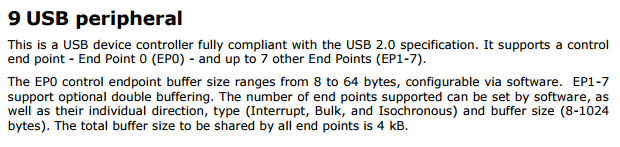

Here is the description of the USB peripheral features in the FT900 microcontroller user manual:
The manual states that 8 endpoints are available, which is more than needed. However, it is a bit vague about how they can be configured. Specifically, the USB hardware in the FT900 only supports a single direction for each endpoint and not both IN and OUT (probably for hardware simplicity and because for most uses this is not important). Thus, the recommended endpoint configuration for Bluetooth controllers described above is not possible with this device.
