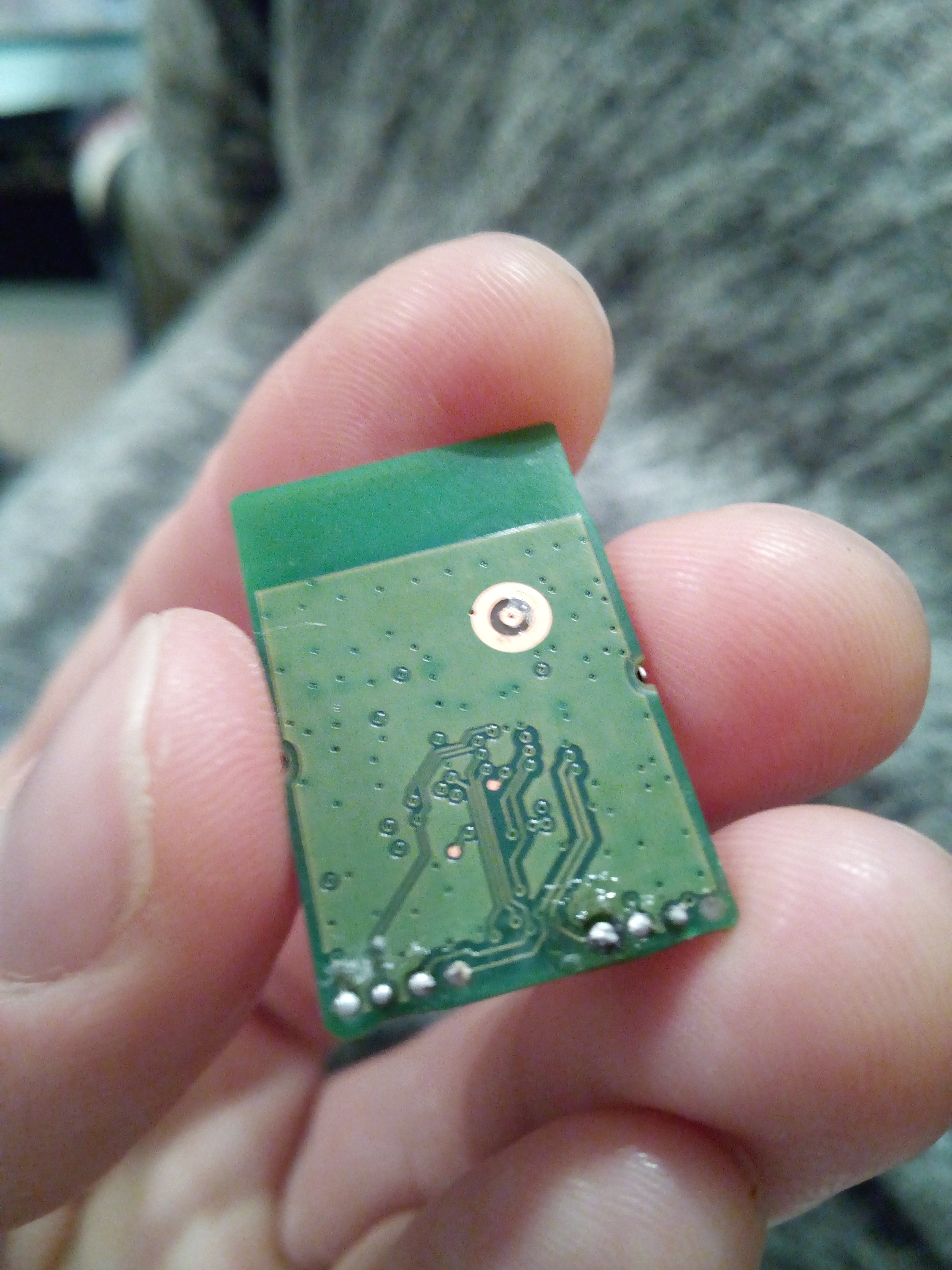

Today I was starting to solder the bluetooth module and when I was tinning the test pads one of them came off.
Acording to the trimming guide that pad was for gnd.
My bluetooth module is a bit different from the one shown in the trimming guide so I'm not sure were I can get another place to solder the gnd.
Is there any other place were I can solder it or is there any way to fix the pad?
Please check the picture of my bluetooth module.
Thank you!

The large ring around the pad at the top is ground (not the pad itself, but the ring around it)

I ended up ordering a new bluetooth module because the power pads also came off.
As soon as I aplied solder they stick to the solder blob and come off.
I'll try to be more careful next time, they seem to be very fragile

Yeah the pads broke off for me a lot of times, and I just followed the trace, scratched it and soldered there instead. Be very light on the pads and make sure when you are adding wires that they don't have so much stress because that can also rip off the pads.
