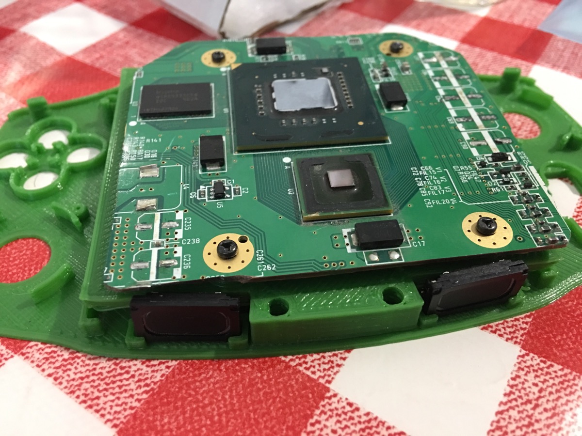

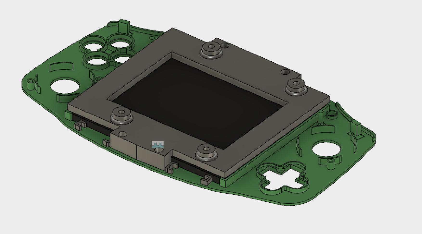

I think I should post some updates on this for those who aren't on discord :D
I'm also about to finish the custom PCBs designs for this. I'll show them eventually :)
Hold up, are those triwing screws?
They are lol. I actually used them in my Piizza as well. This time I had them next to me, so I used them temporarily, but I don’t think we’ll end up using them in the final build :D

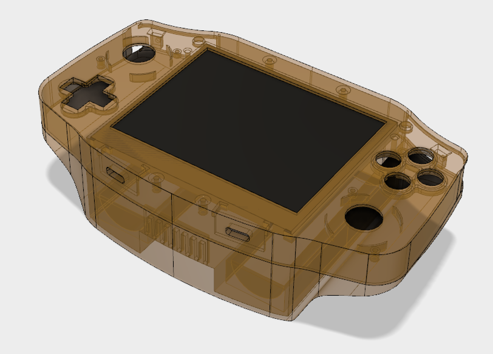

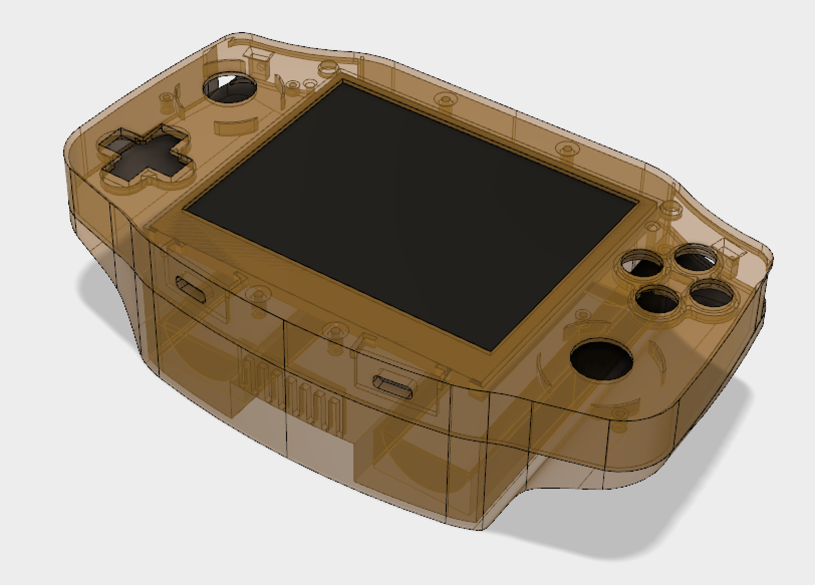

I knew this was going to be thick compared to a GBA, but that's not too bad. Excited for more!
It's approximately 1cm thicker in the middle, while on the sides it's pretty much the same
