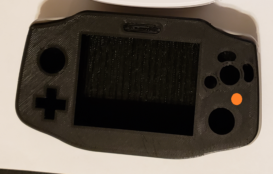

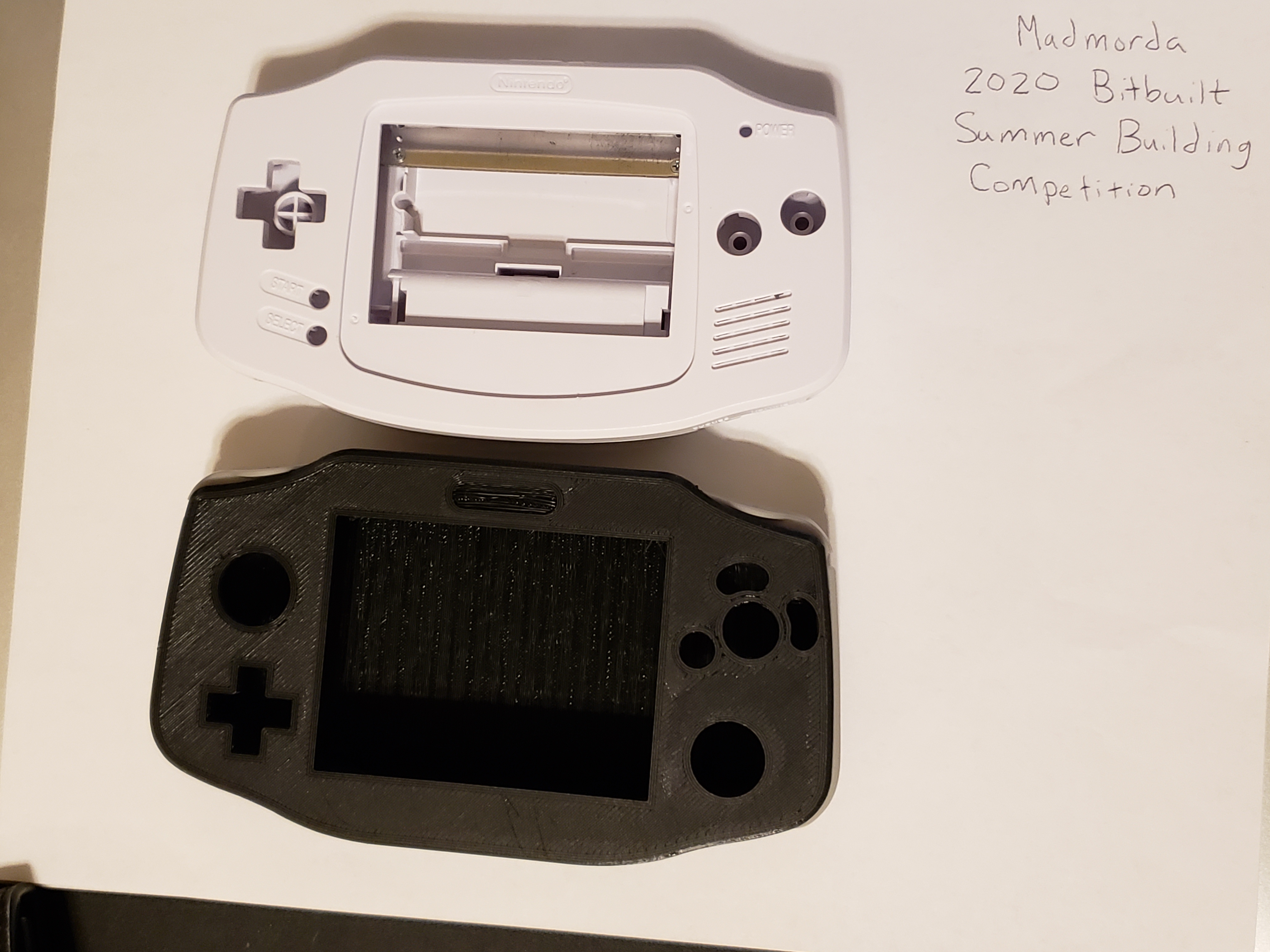

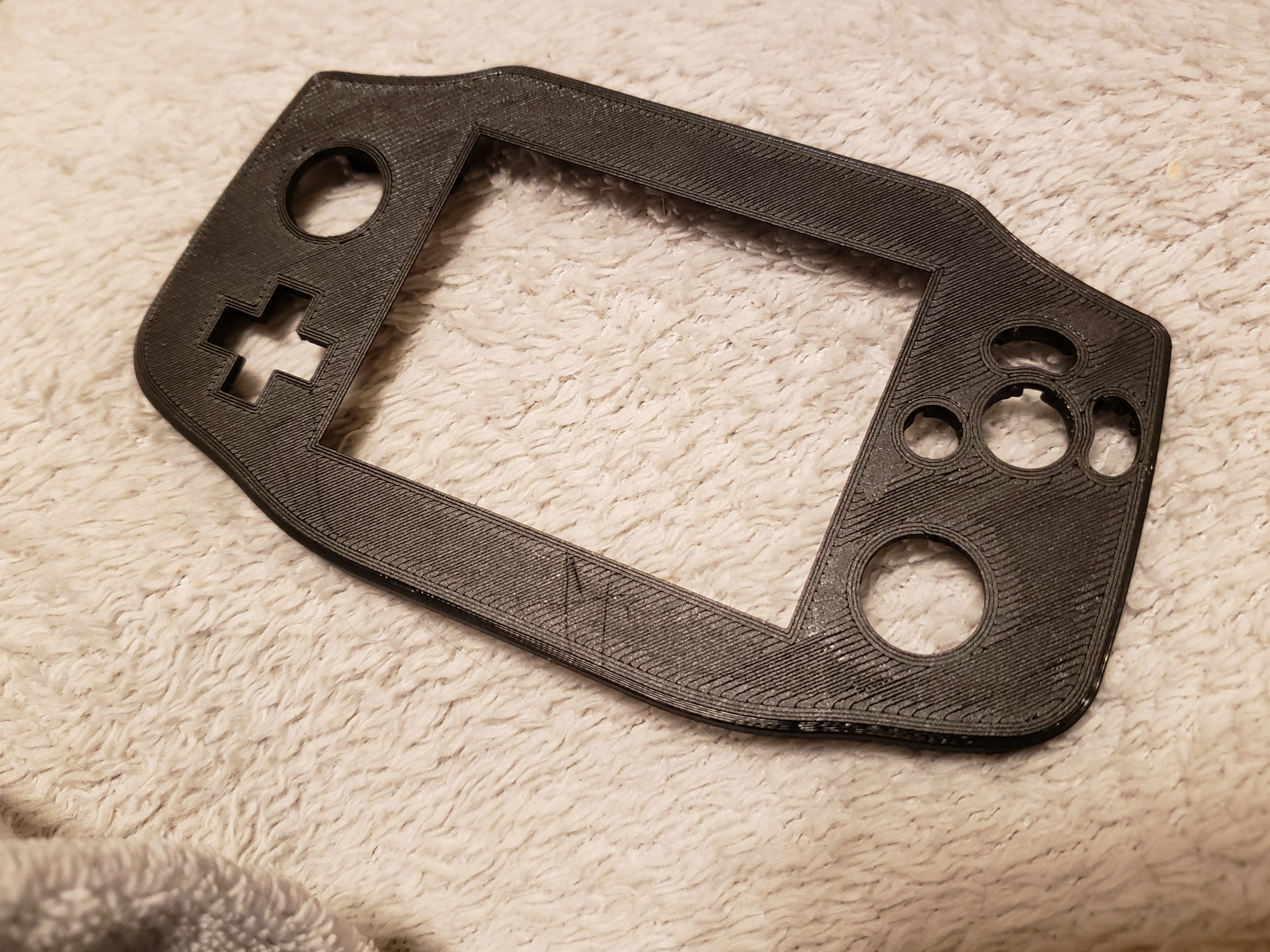

I'm a little late to start my worklog, but I hope to actually finish my entry this year! I'm building something I've been wanting to build for a long time: a Gameboy Advance shaped Wii portable. My main idea here is to try and keep both the size and the shape accurate to the original GBA without adding any additional space if possible. I've been working on the case for the last few days and finally have enough to start my worklog :)
Size comparison to the original shell:

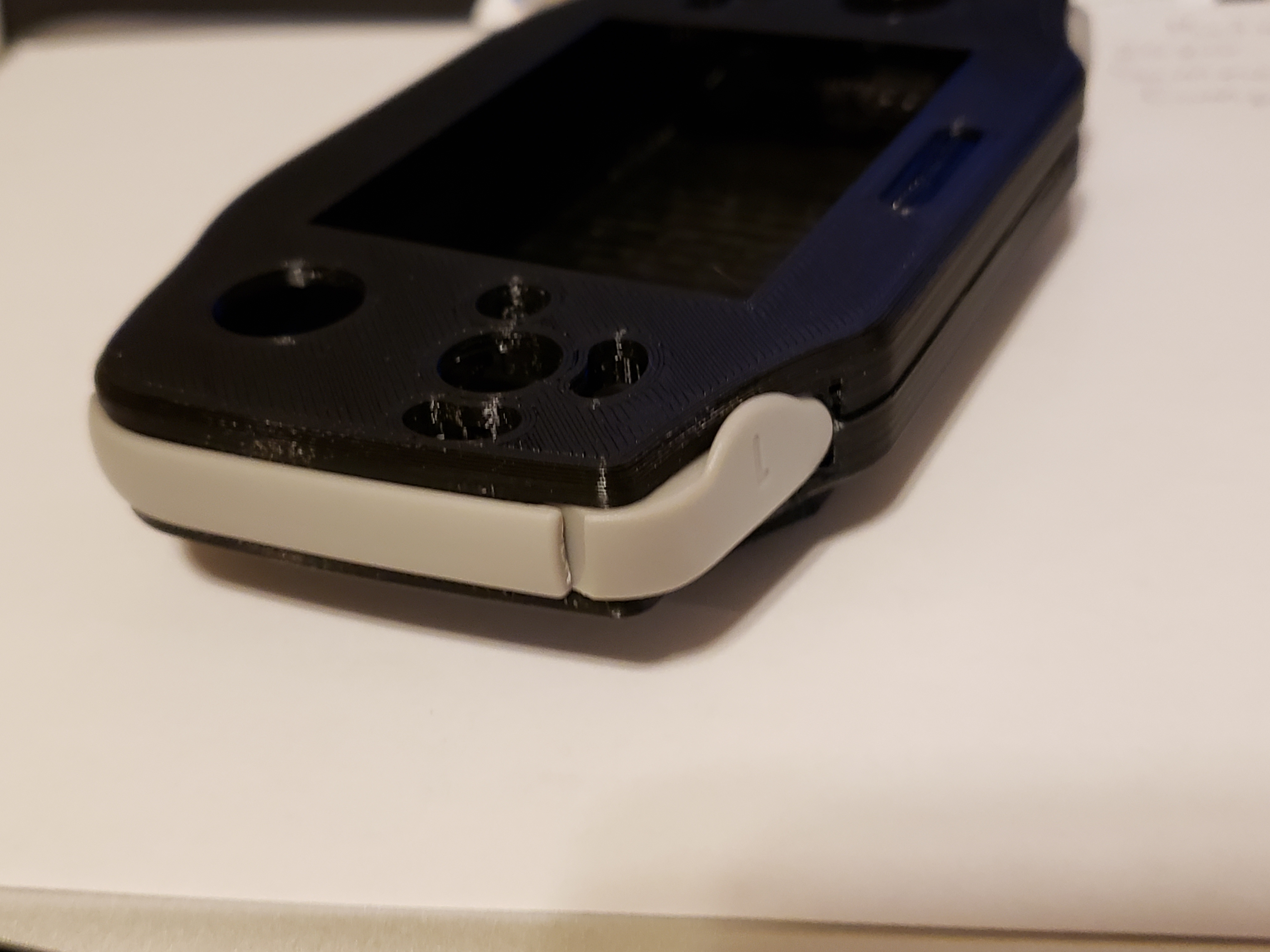

I'm aiming to keep as much of the original aesthetic as possible, which means I'm also using the GBA's side wings and triggers:
The oval at the top of the console is for a Nintendo logo from a GBA SP. I'm hoping it will lend some authenticity, since the shell will most likely look 3d printed instead of painted. The controls include 2x switch joysticks, original triggers, and 3d printed ABXY/DPAD. The ABXY/DPAD buttons are custom to fit the console, and I will be resin printing those buttons on my elegoo mars. It seems that they sell teal, red, and grey resin that are pretty close to gcc colors. If I'm not happy with how the colors or feel of them turn out, I will polish them and then resin cast them instead. The form factor is surprisingly comfortable :)
Here's the specs that I have so far, however they are subject to change since my main concern is the shell and everything else will be working within that constraint.

My biggest concern for it is how the final case will look. I'm personally not a fan of the 3d printed look, so I may experiment with ABS to see if a vapor bath will help. I don't want to paint it, because I intend to actually play it without worrying about chipping the paint. I do have a resin printer large enough to print the case, however my tests with other shell-shaped objects has led me to believe they will warp and not turn out well.

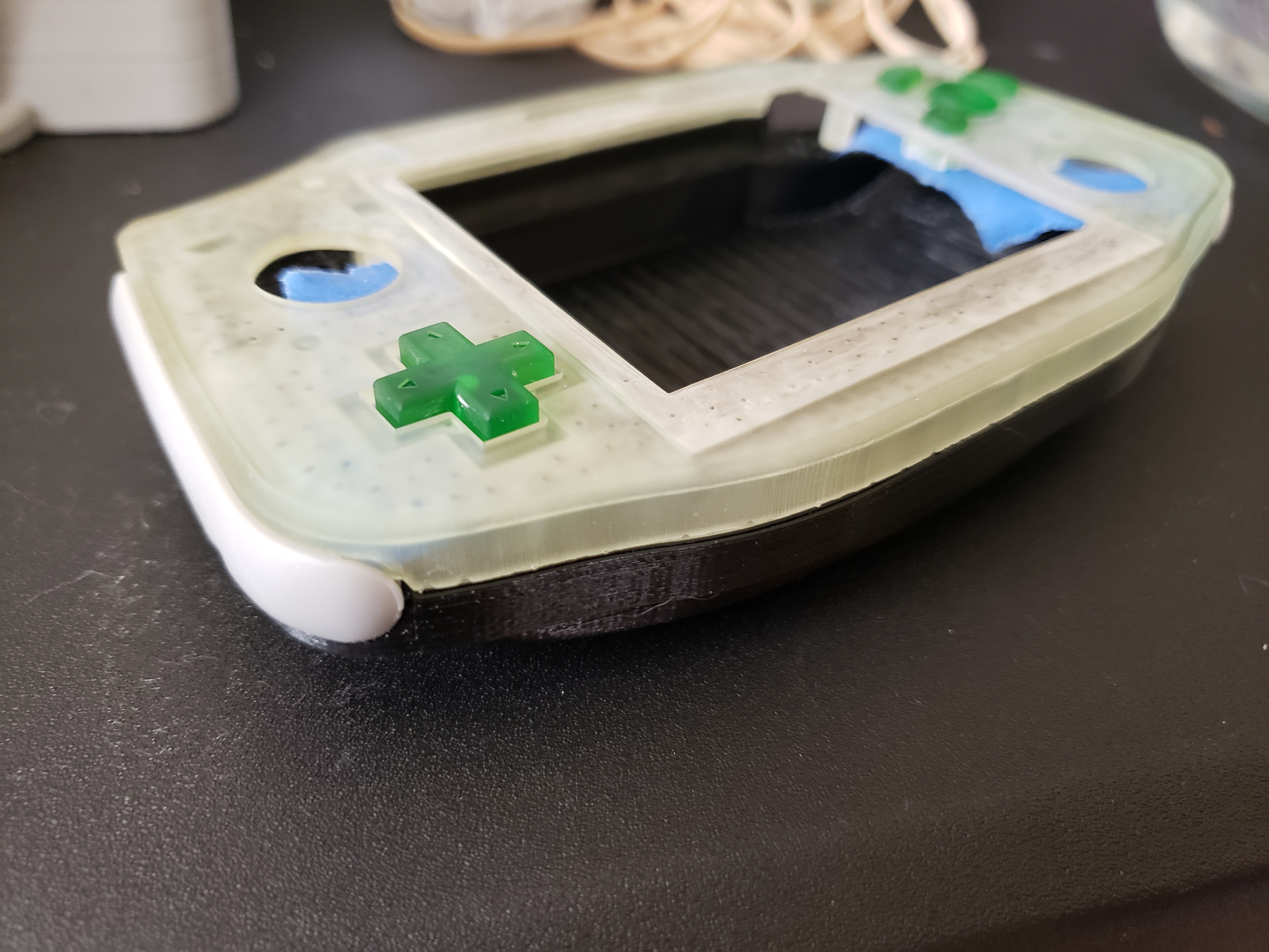

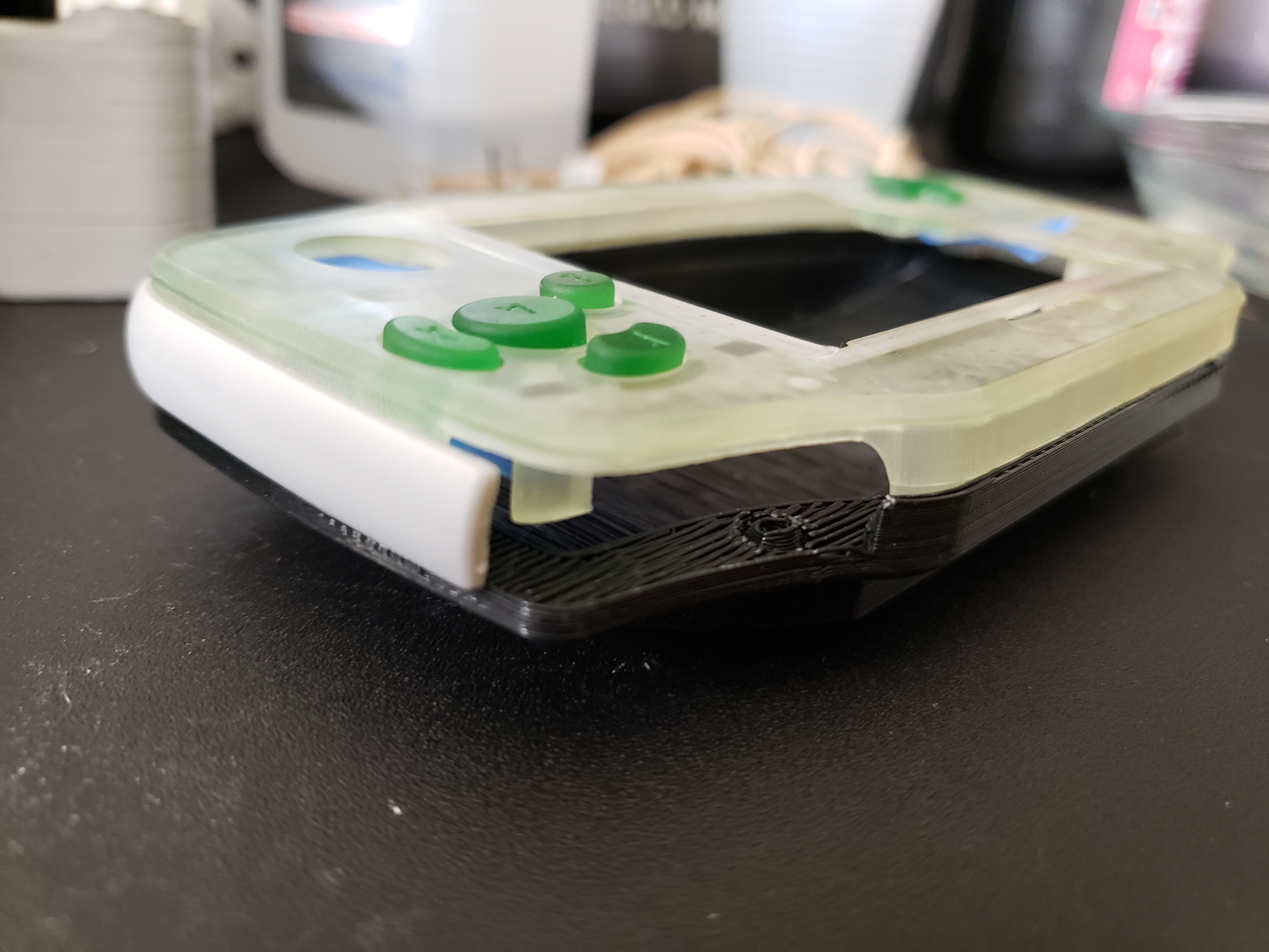

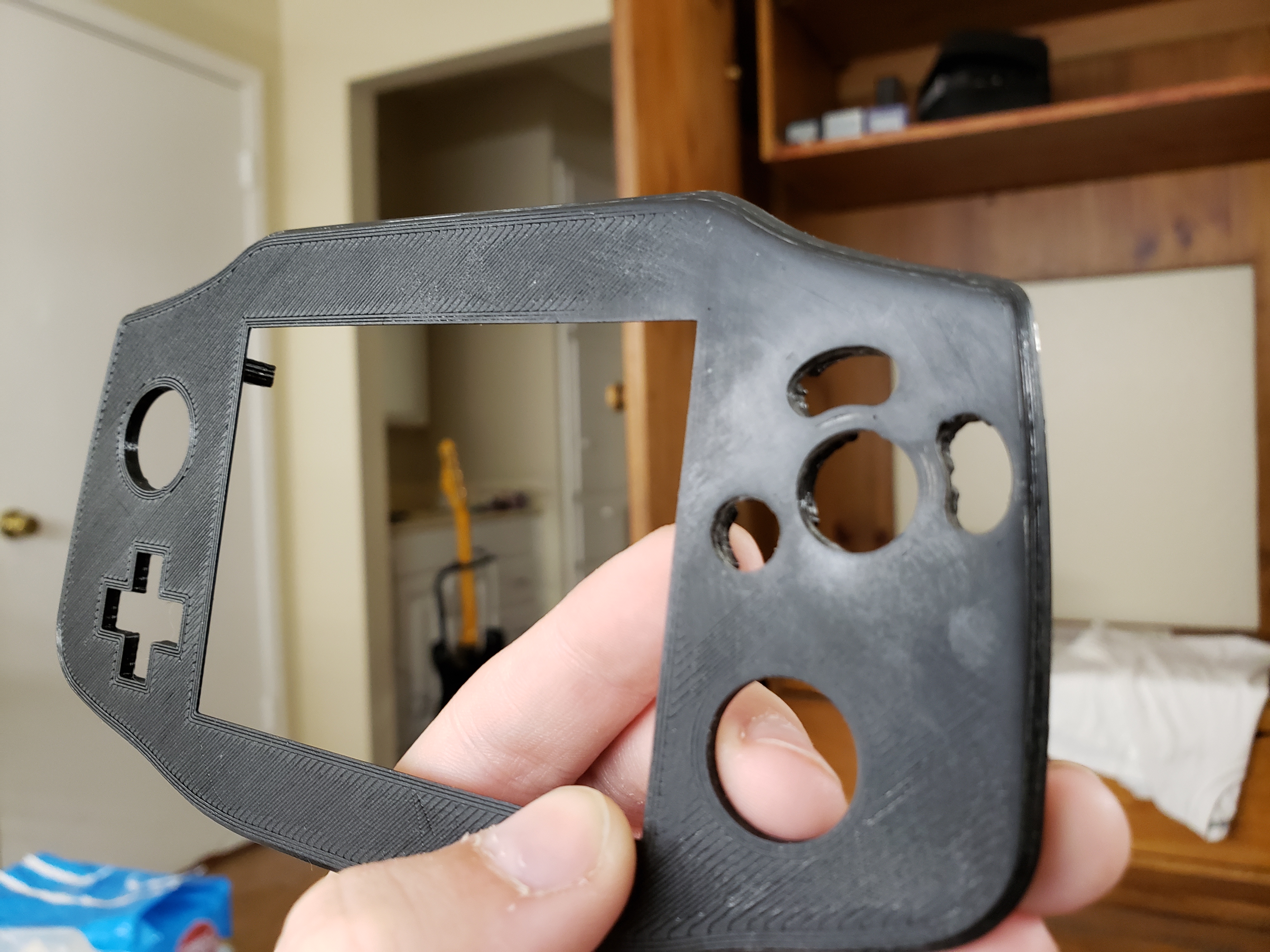

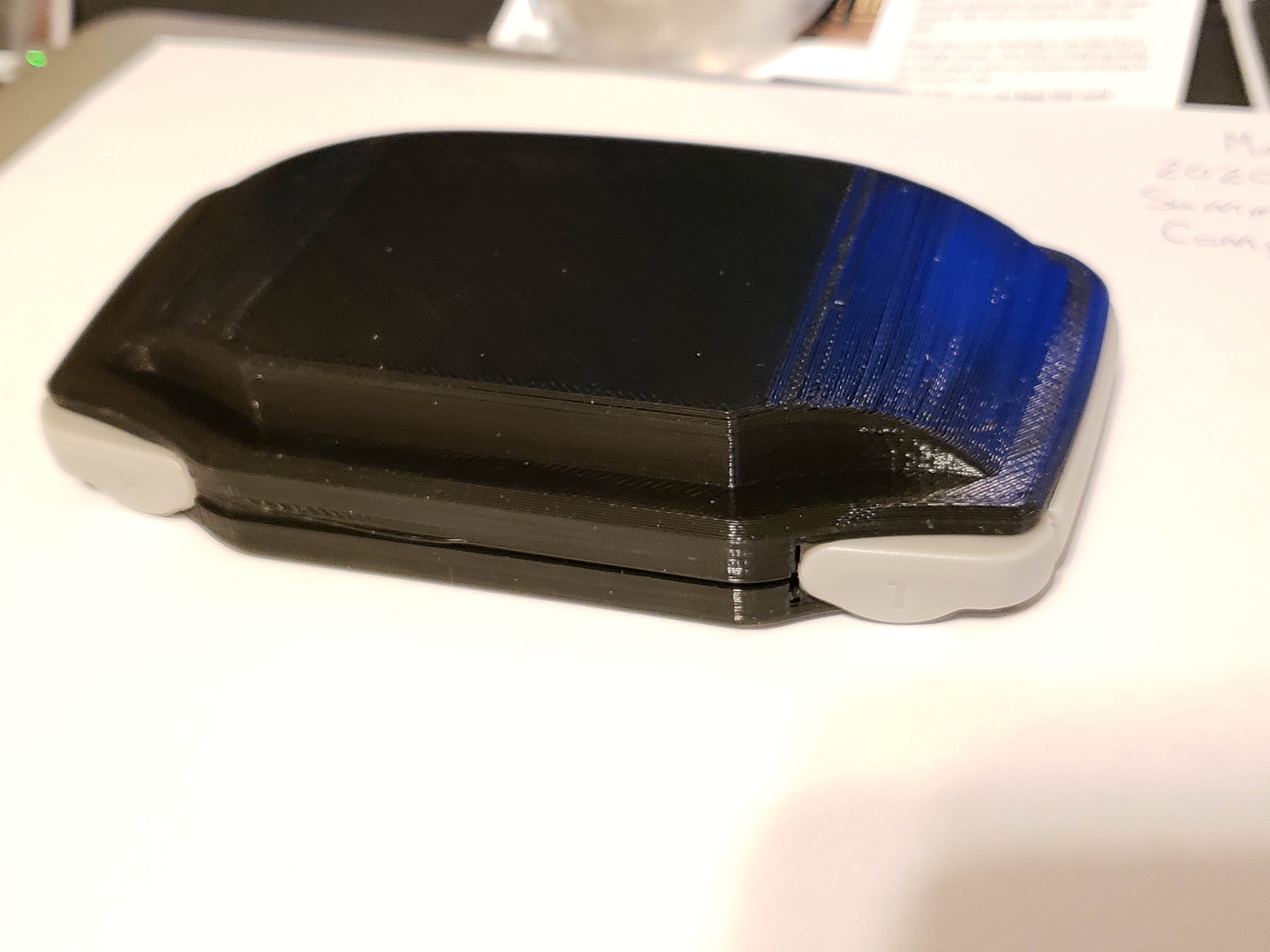

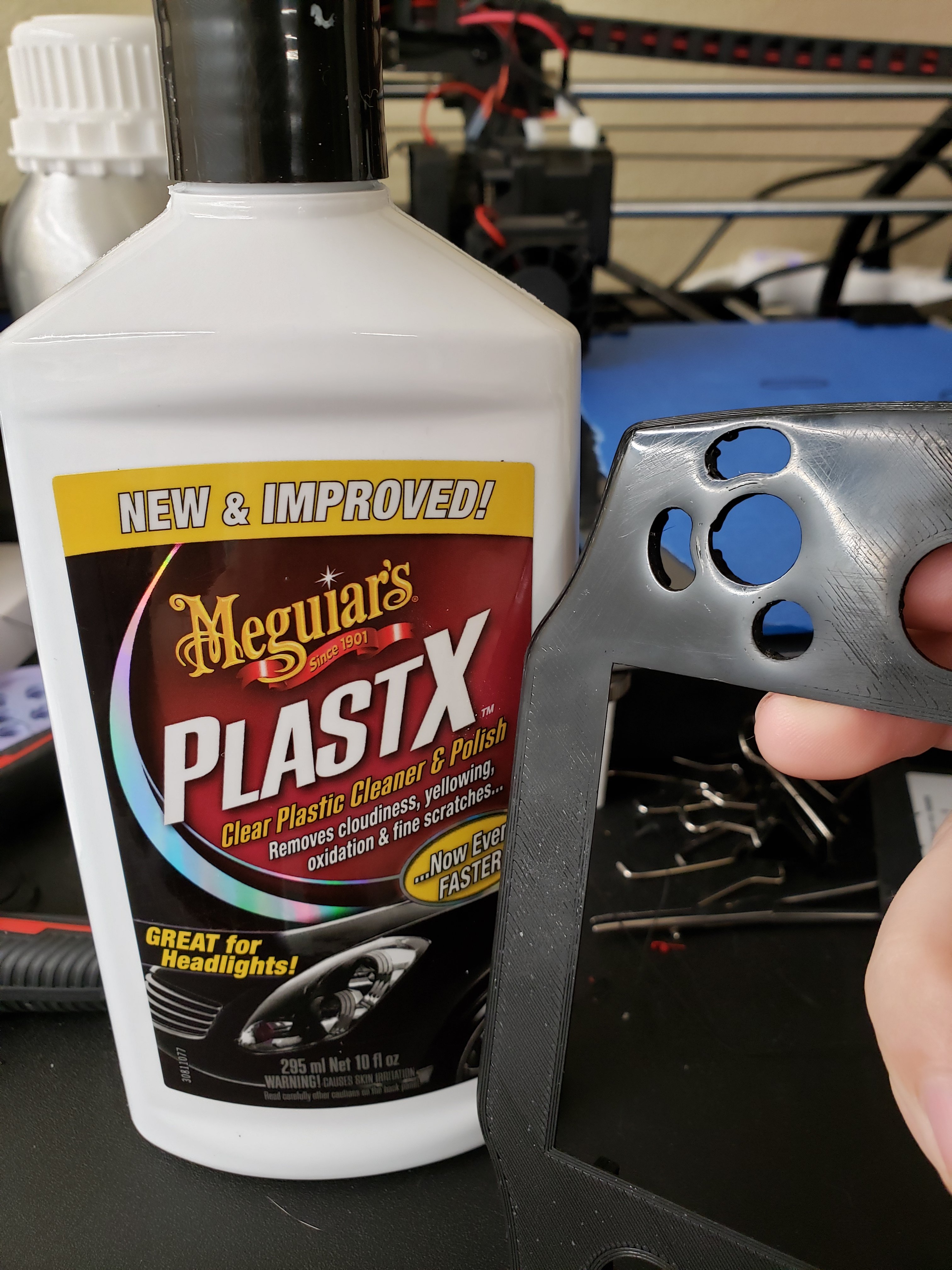

Here's my original case that I'm trying to make look nicer:

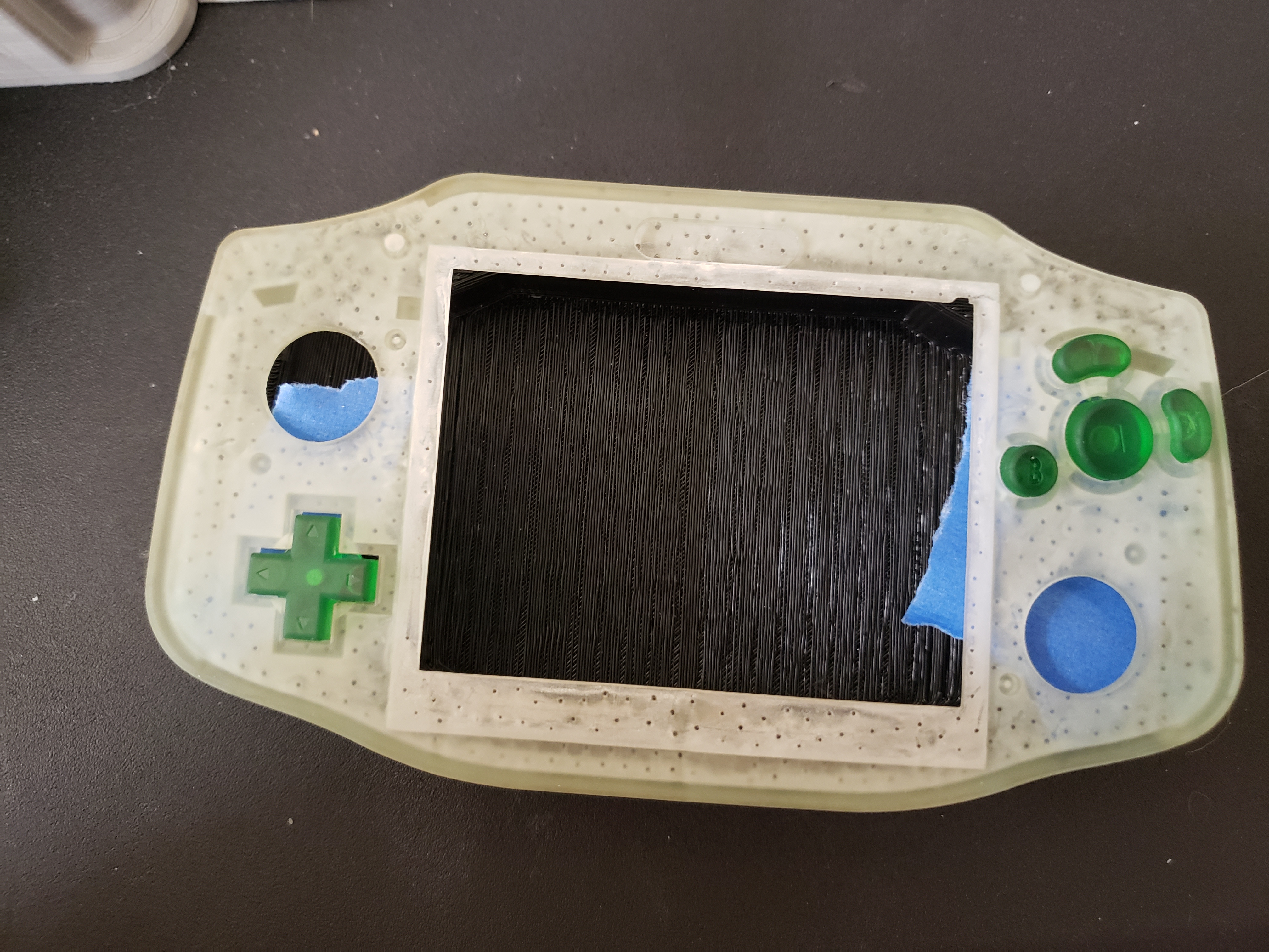

The first thing I tried was wet sanding, and the results are pretty good. I was able to get rid of the lines in this corner, but it makes it look matte.
Next, I tried polishing it with my Dremel's buffing wheel and Meguiar's PlastX (~$7 in Walmart or harbor freight automotive section). I think I got excellent results, it almost looks injection molded after the sanding and polishing (dont mind the sandpaper scratches). This polishing compound also works on resin printed parts.

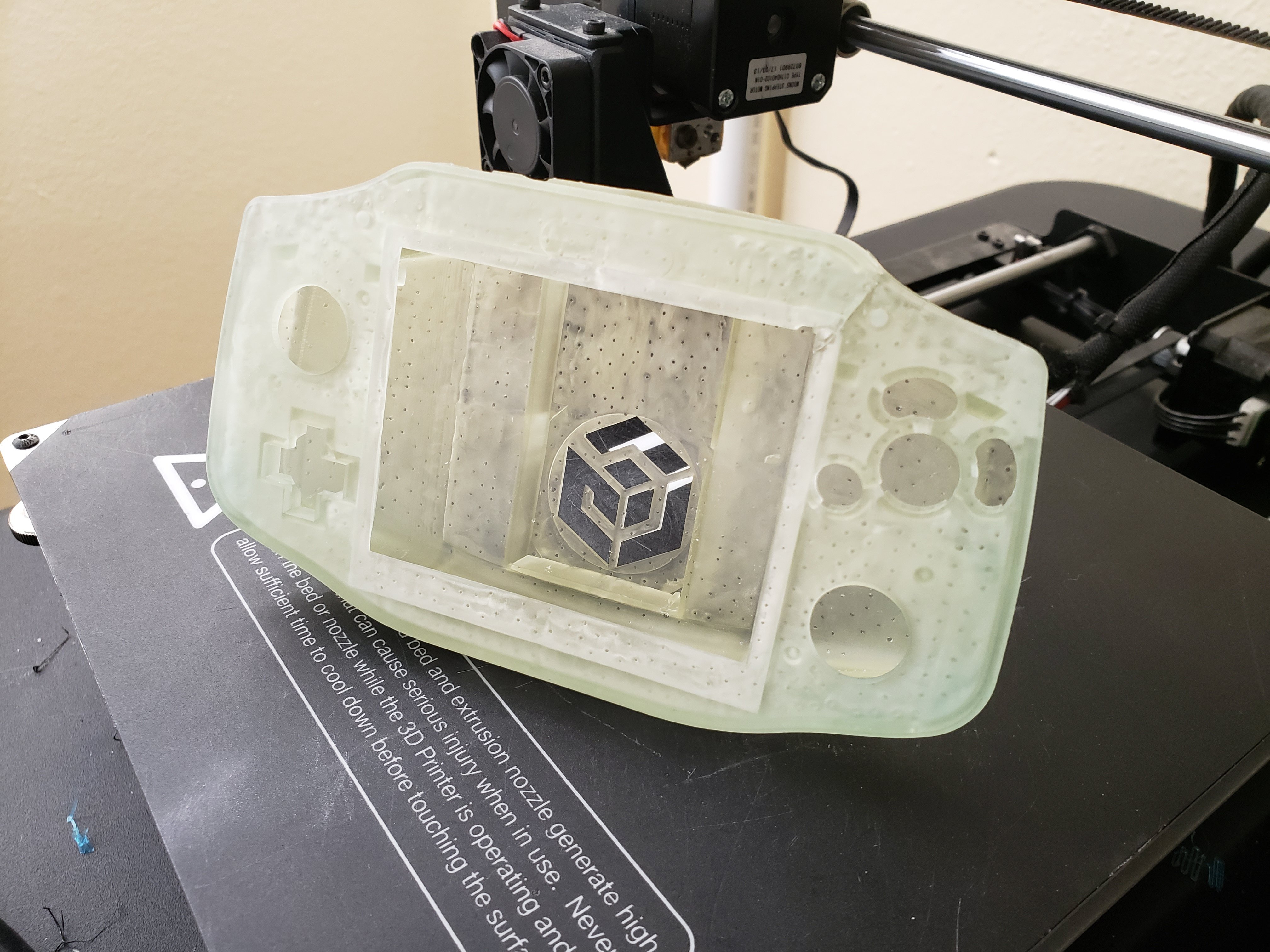

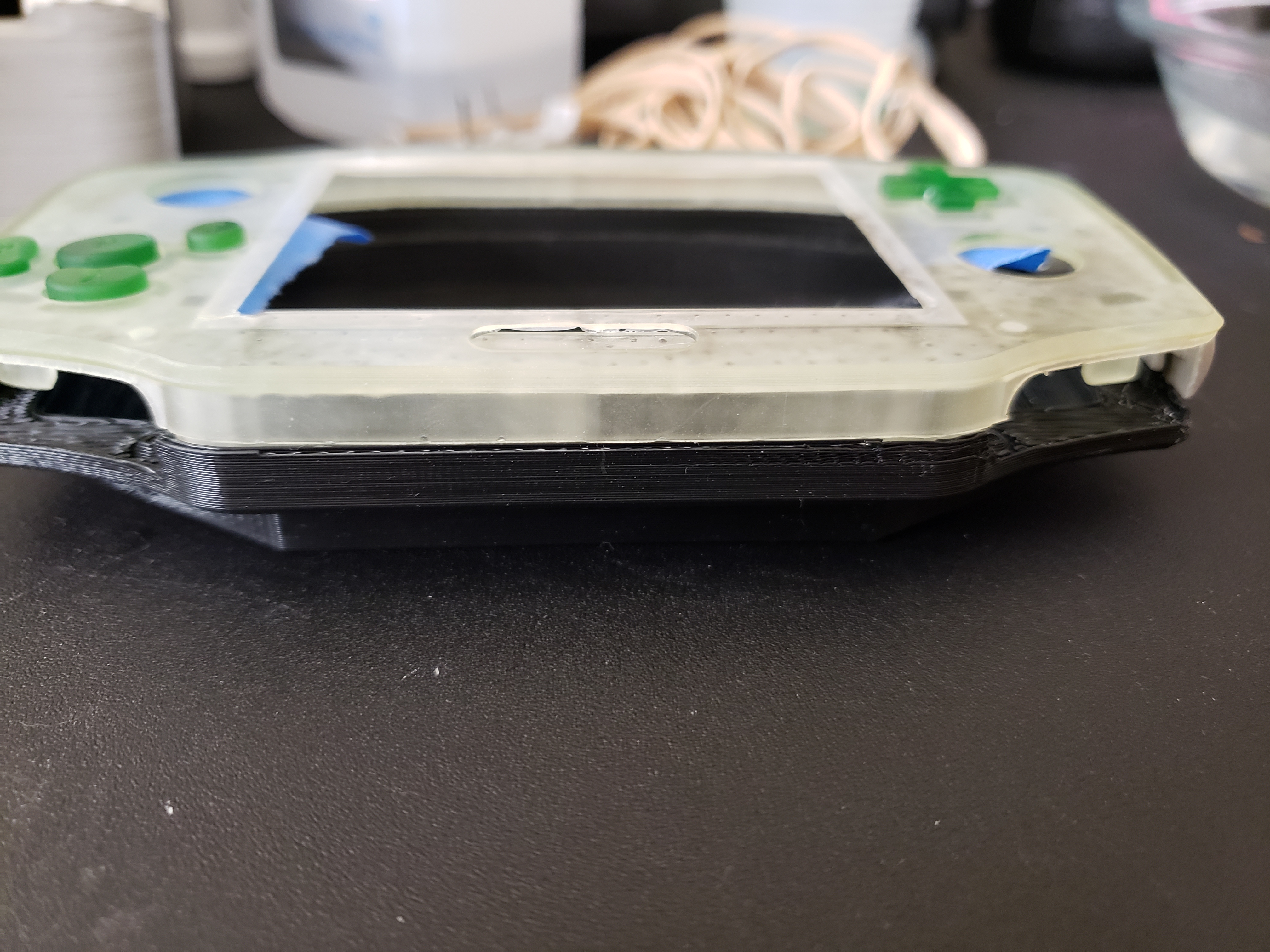

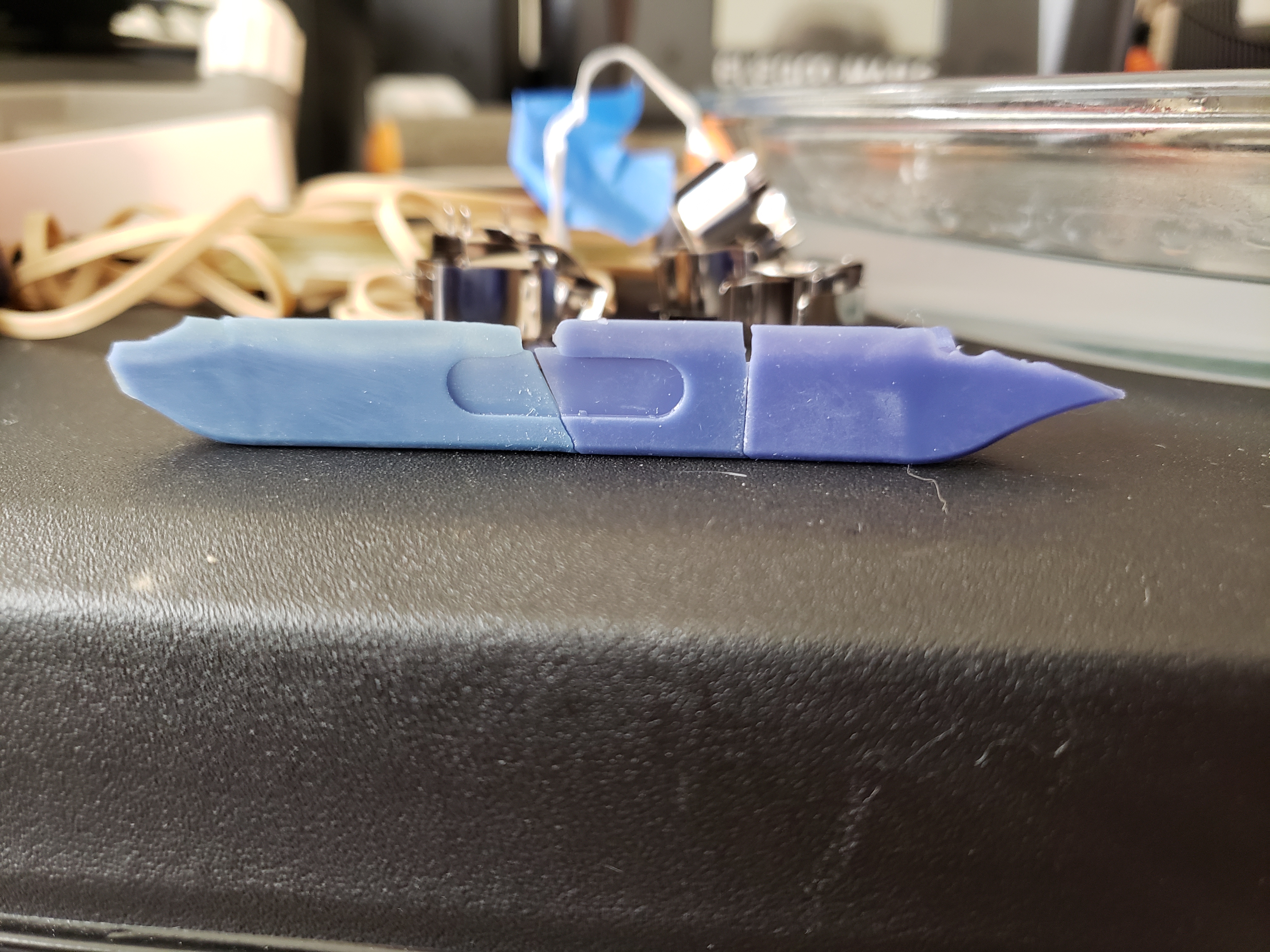

As a last resort, I also thought I would try resin printing my case. I've tried resin printing other shells in the past with no luck whatsoever, but I figured a test wouldn't hurt. AND IT WORKED. I have had a hard time printing similar shapes, so I dont know why this one turned out differently, but I'm happy about it.
There is little to no warping, and it fits seamlessly with the FDM printed back half. The dots are on the inside of the case from supports. If I do end up resin printing my case, it will be a solid color (most likely orange). This may mean that I don't need to do any sanding to get the look I want, and since the polishing compound does work on resin, I can buff it to a nice shine.

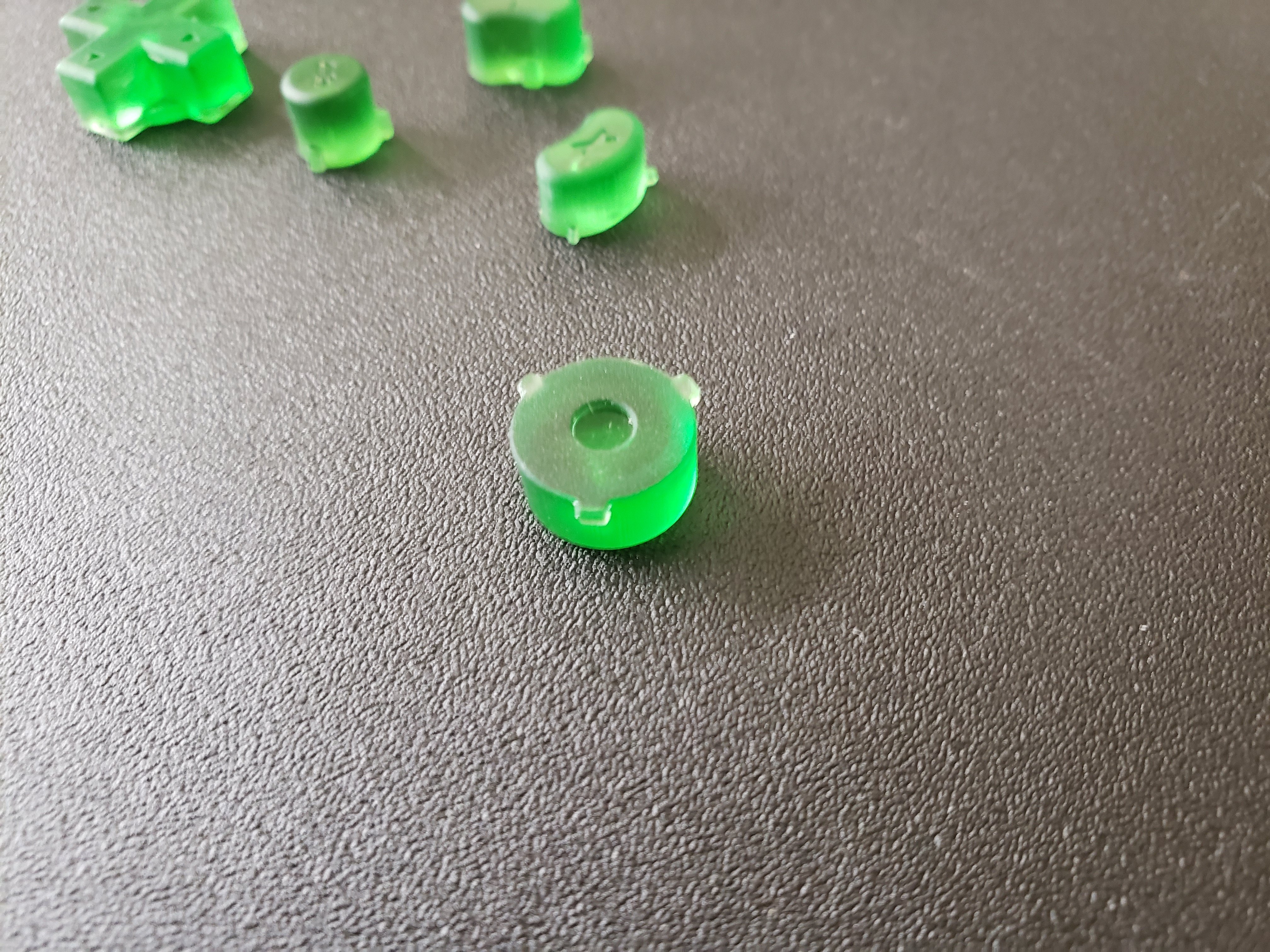

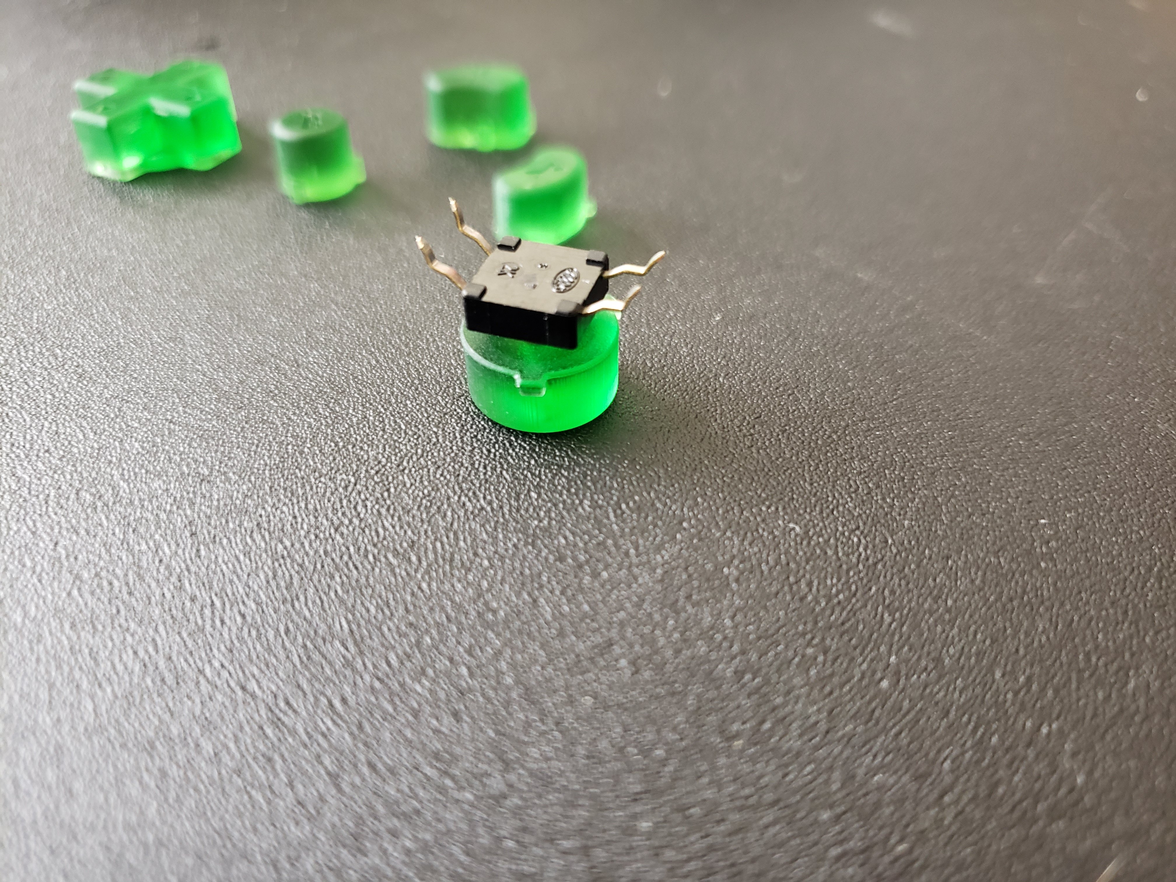

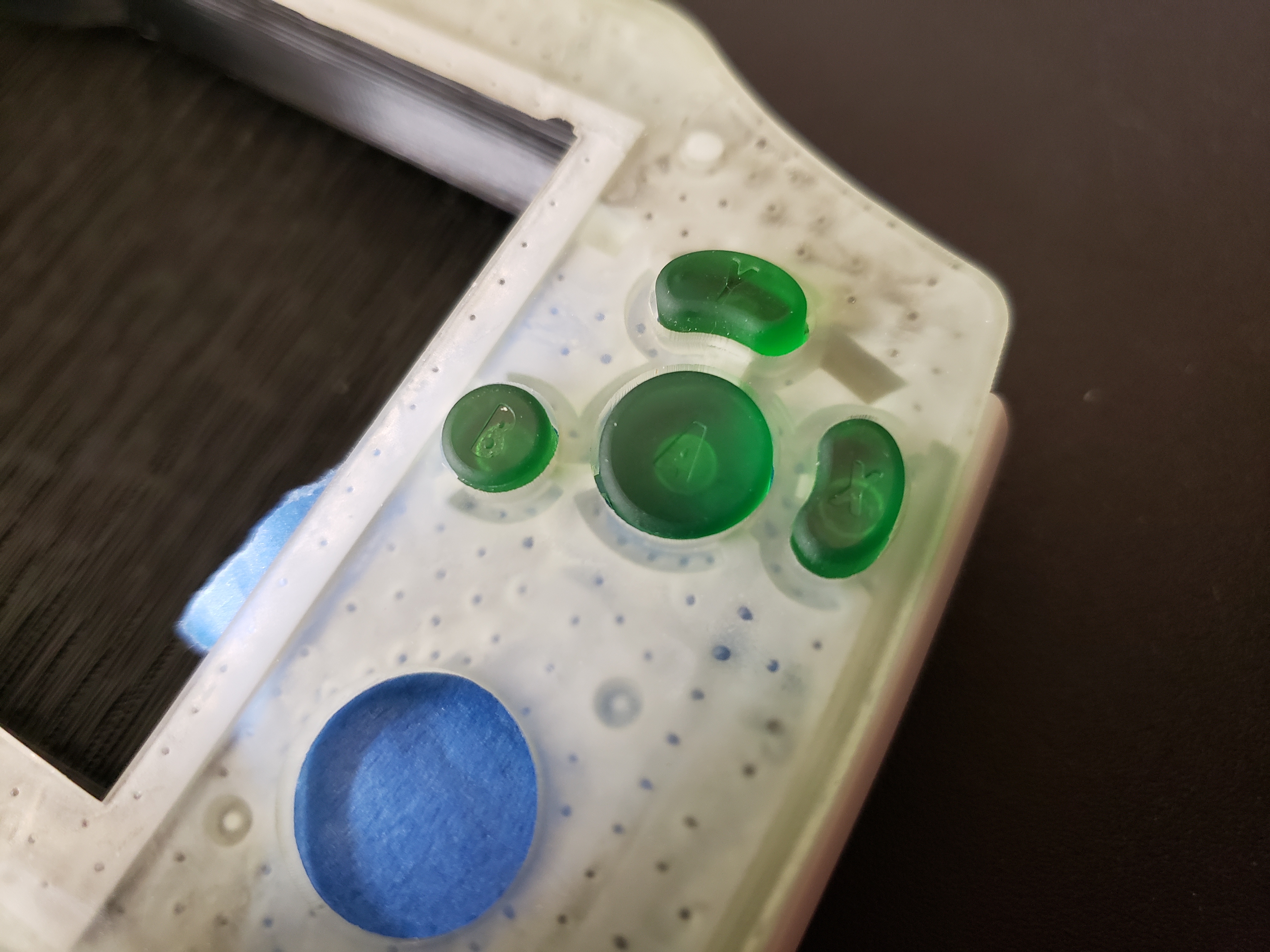

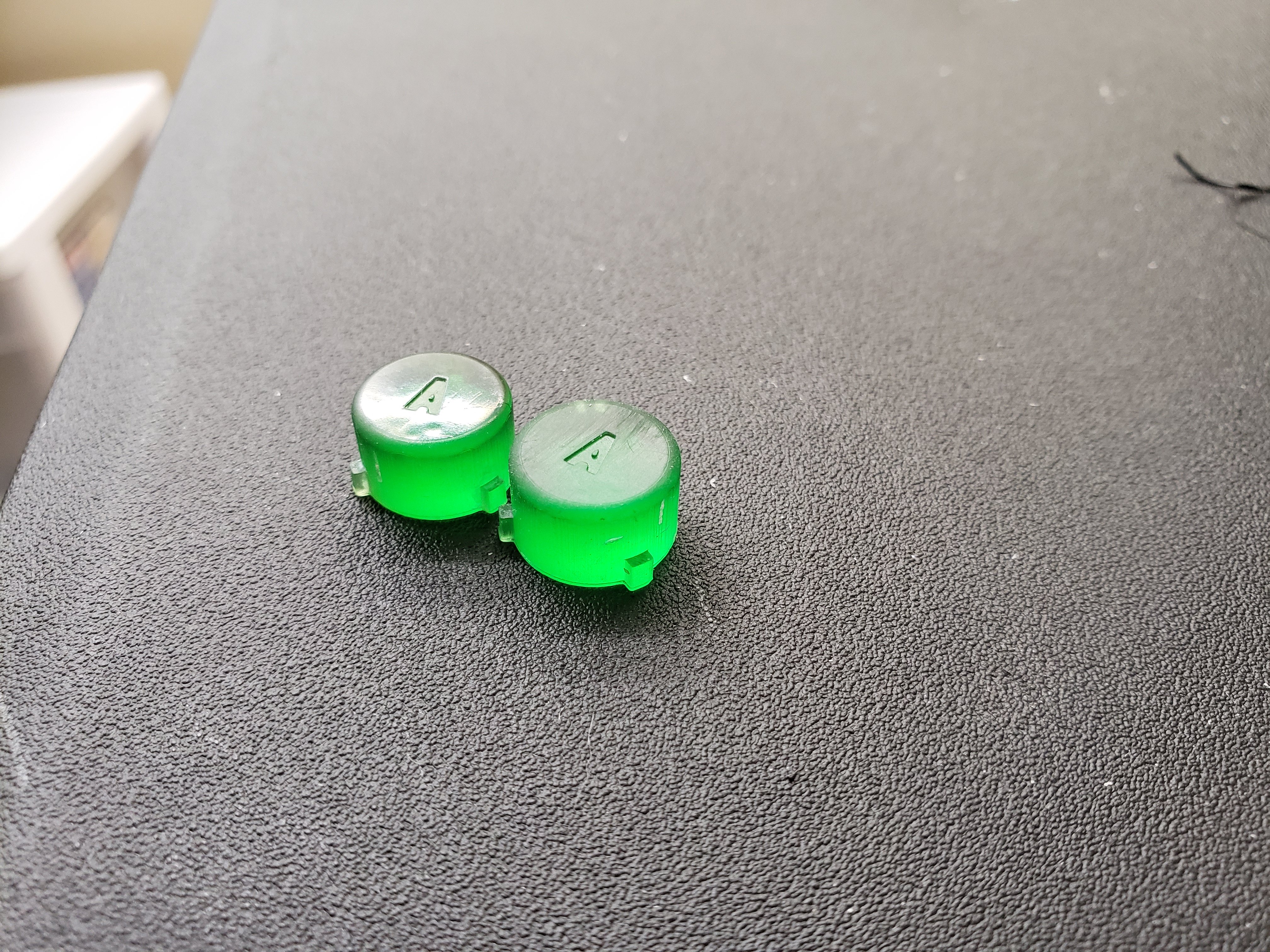

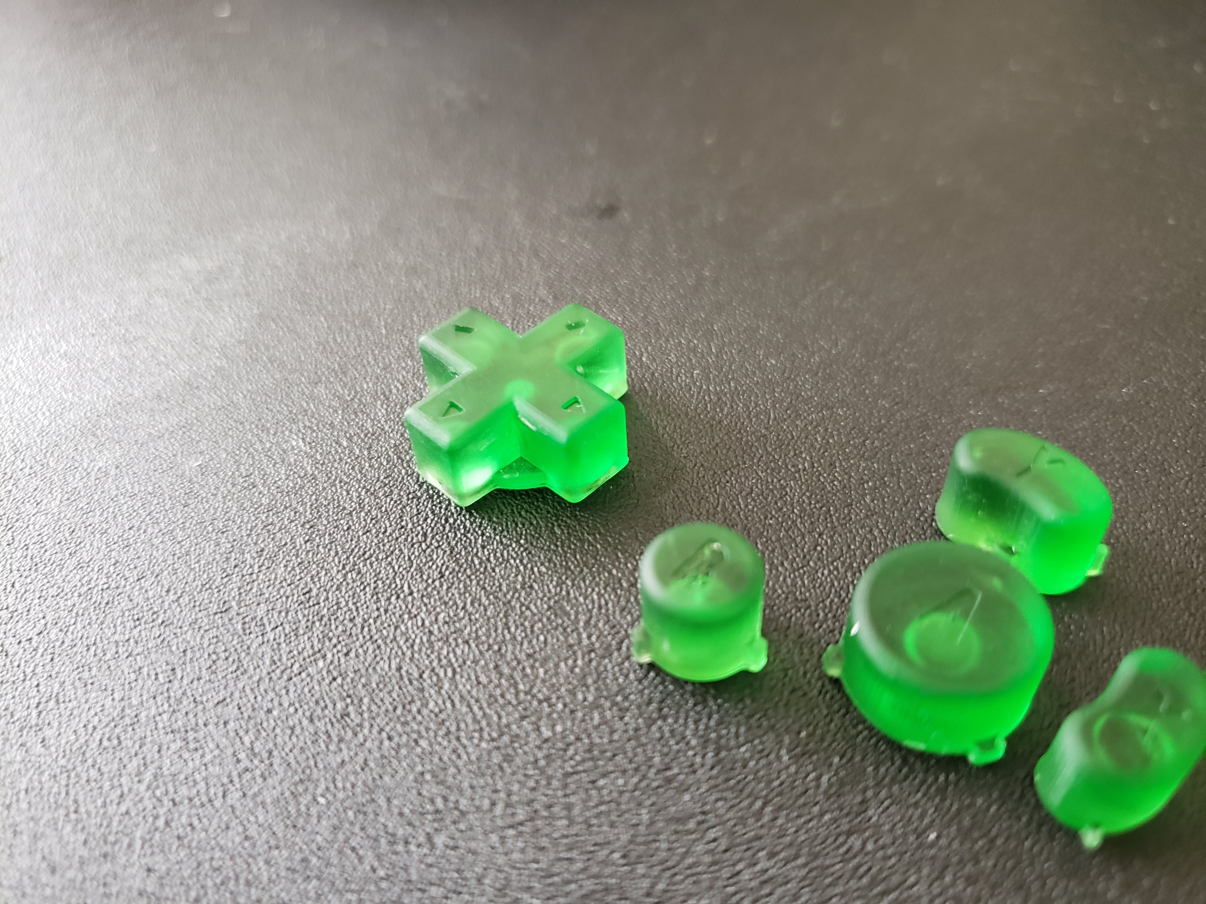

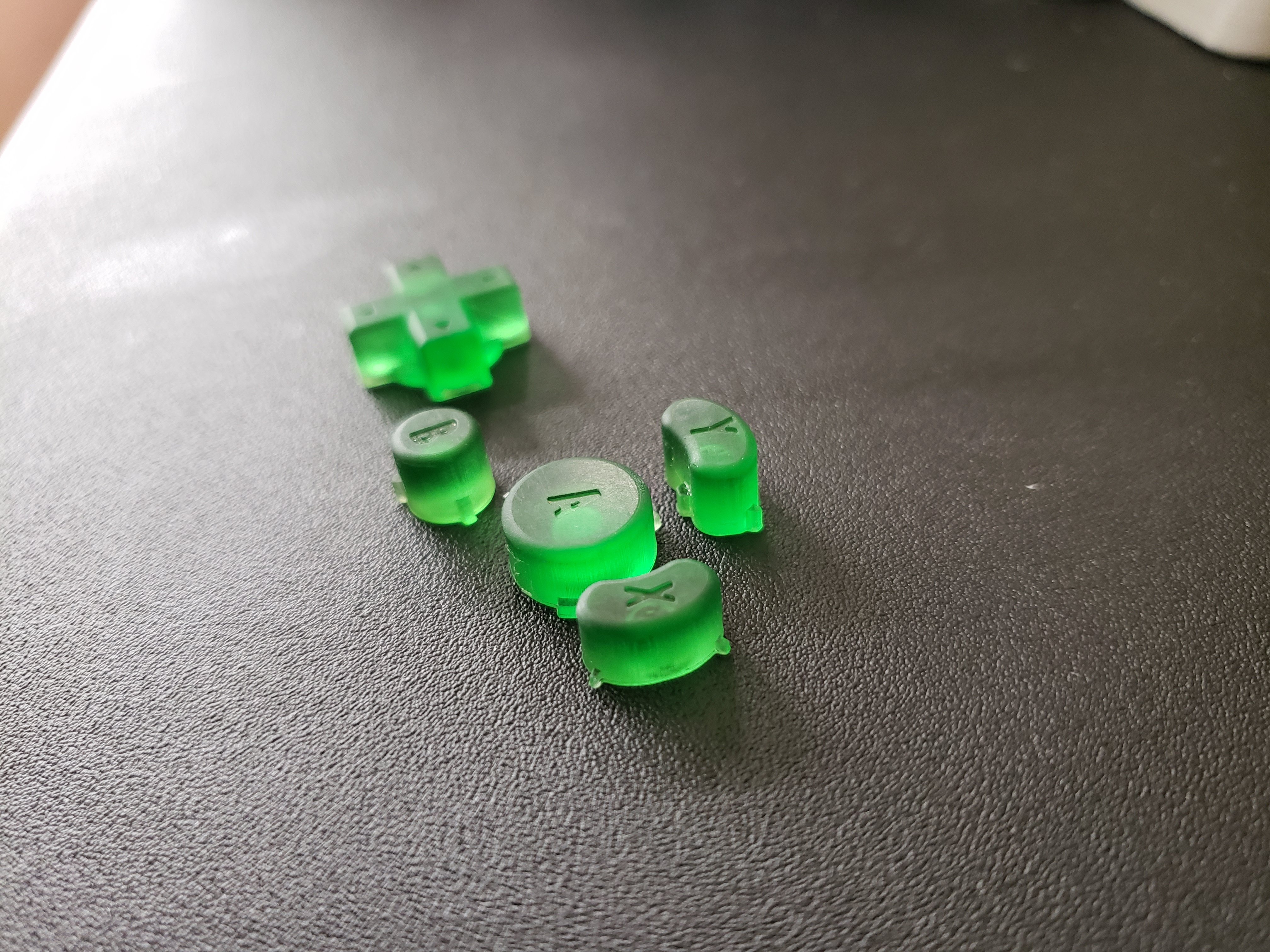

As for the buttons, these are 3d printed mini-gc buttons specifically made for this case. They are as big as they can be without interfering with anything else, and are designed to save as much room as I can while using orange tacts. Their final color will be gamecube button colors, as by happy coincidence, they sell real, red, and light grey resin for printers. If the colors don't look right, I will mold them and cast them in better colors :)

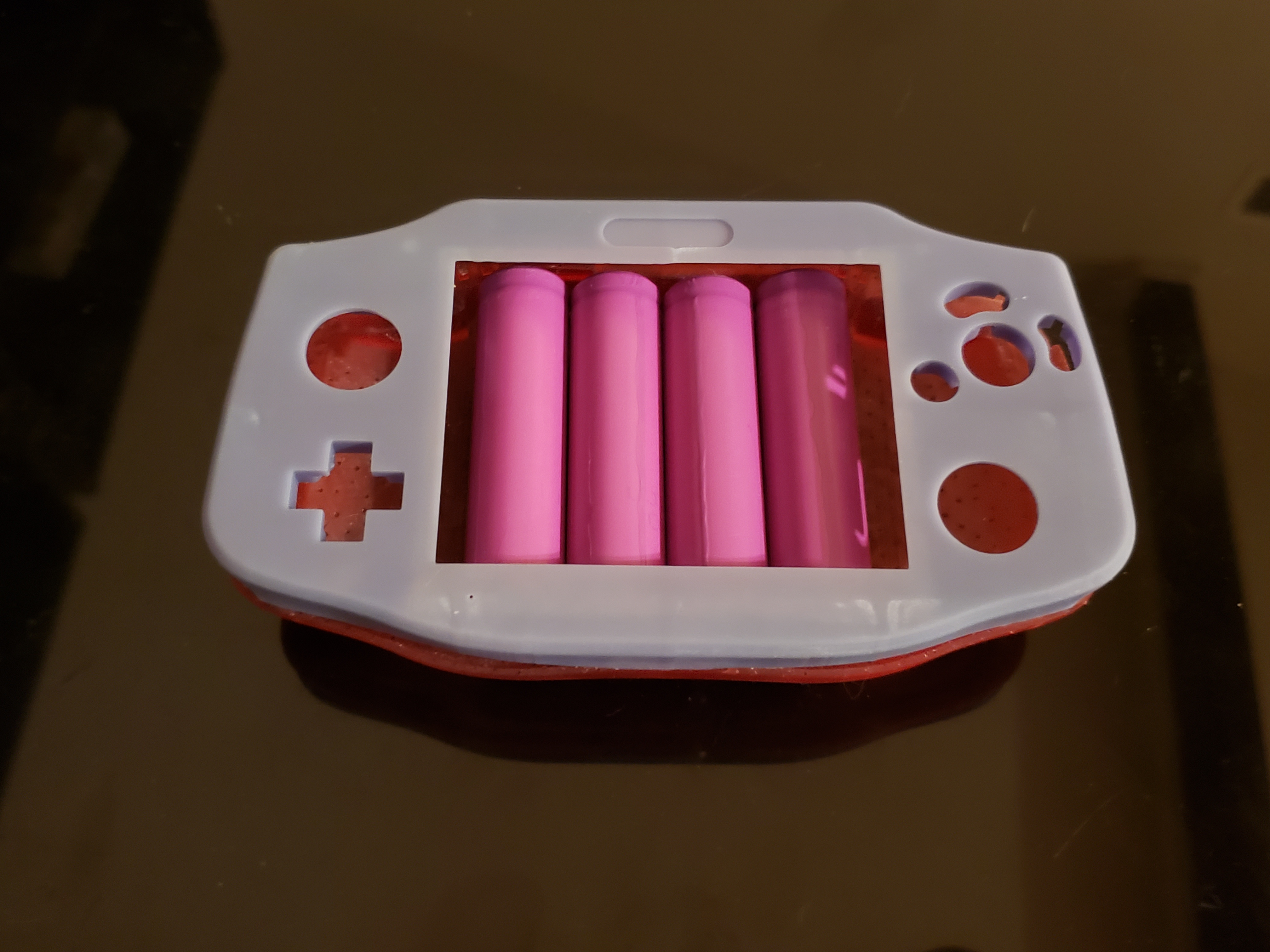

I went through all of my options for batteries and finally settled on some lipo cells. I think I can fit 4 1800mAh batteries in this case (about the equivalent of 2 18650s, or 2-2.5 hrs of battery life).

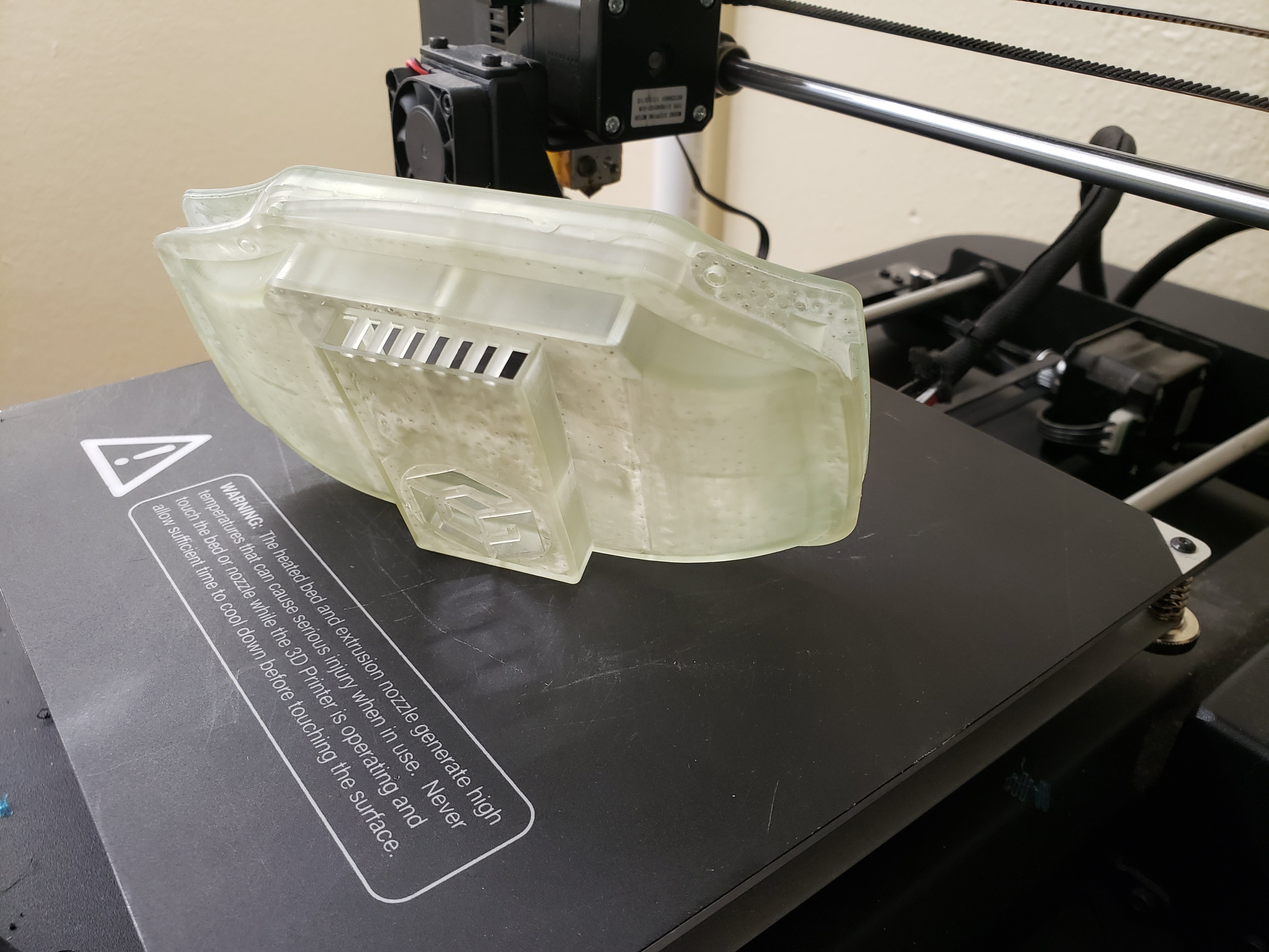

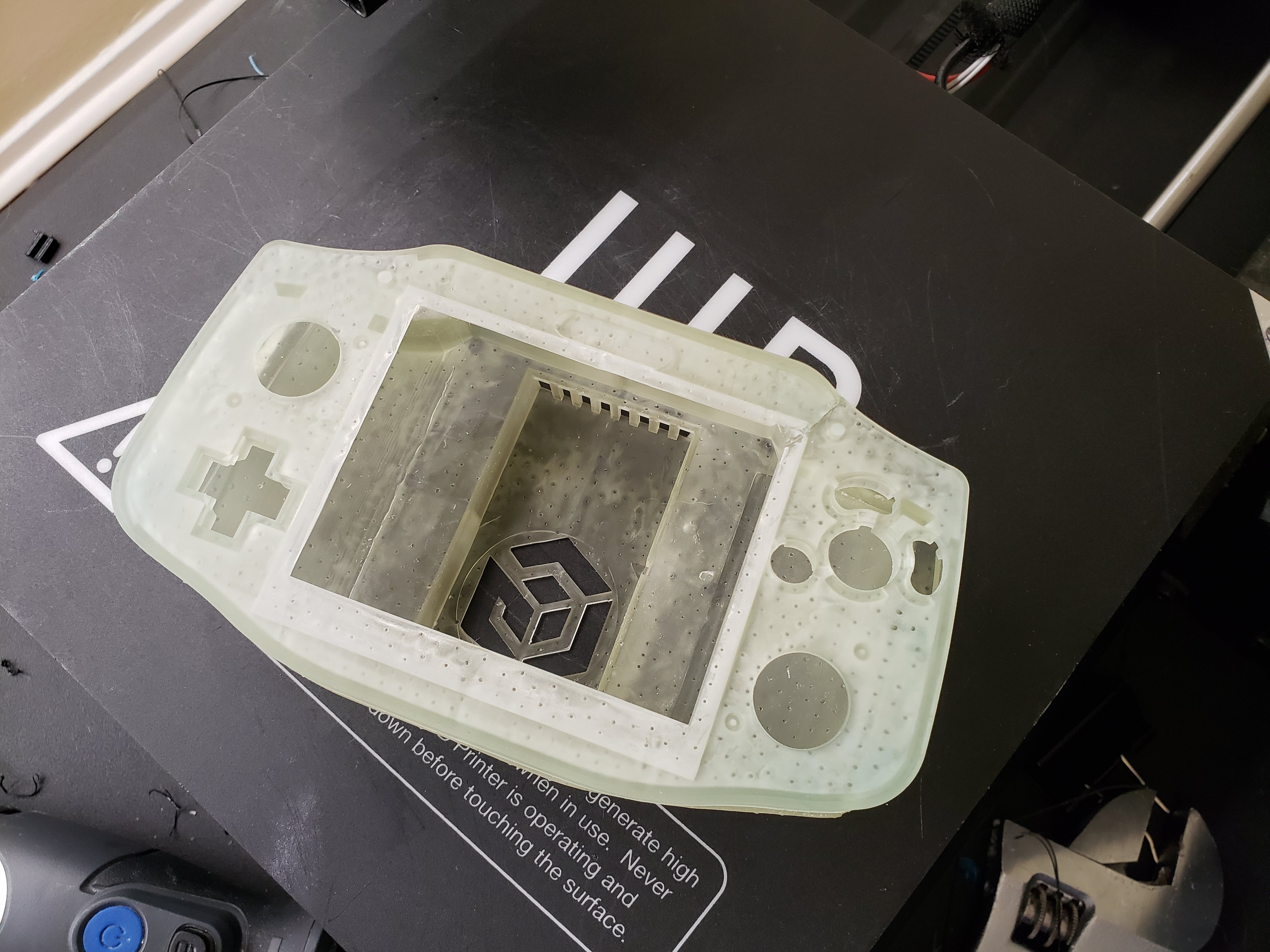

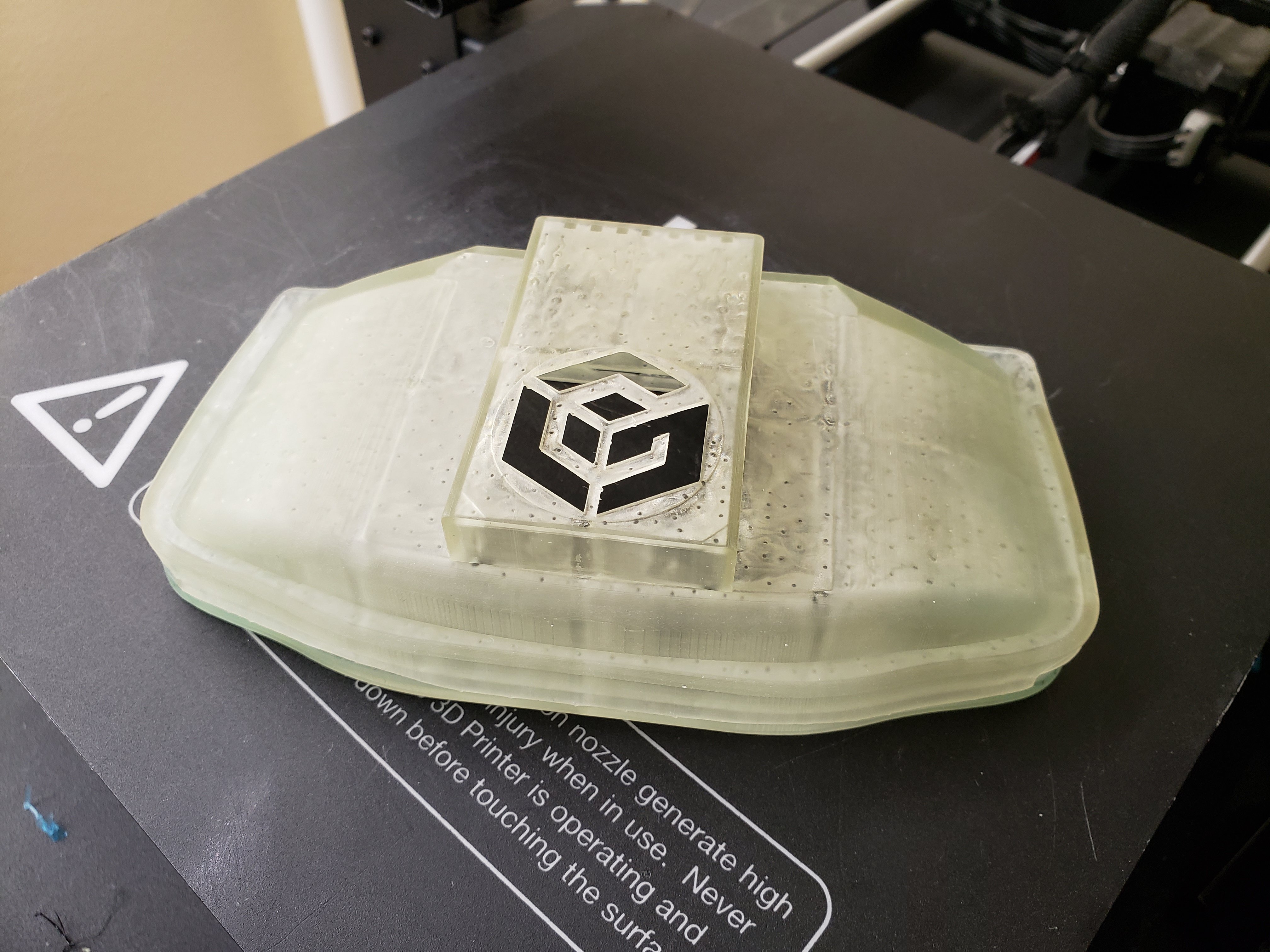

I also decided to add a fan vent and heatsink section to the back of the case. This wasn't an easy decision, but in the end I decided that good cooling was important, especially since I'm using lipos. However, this fan vent area has a nifty gc logo and it also acts as a stand for the case, so that it naturally props up at a nice angle for playing with a wireless controller. I believe I can use some of the space saved by the heatsink and fan to add a wavebird receiver for wireless play.

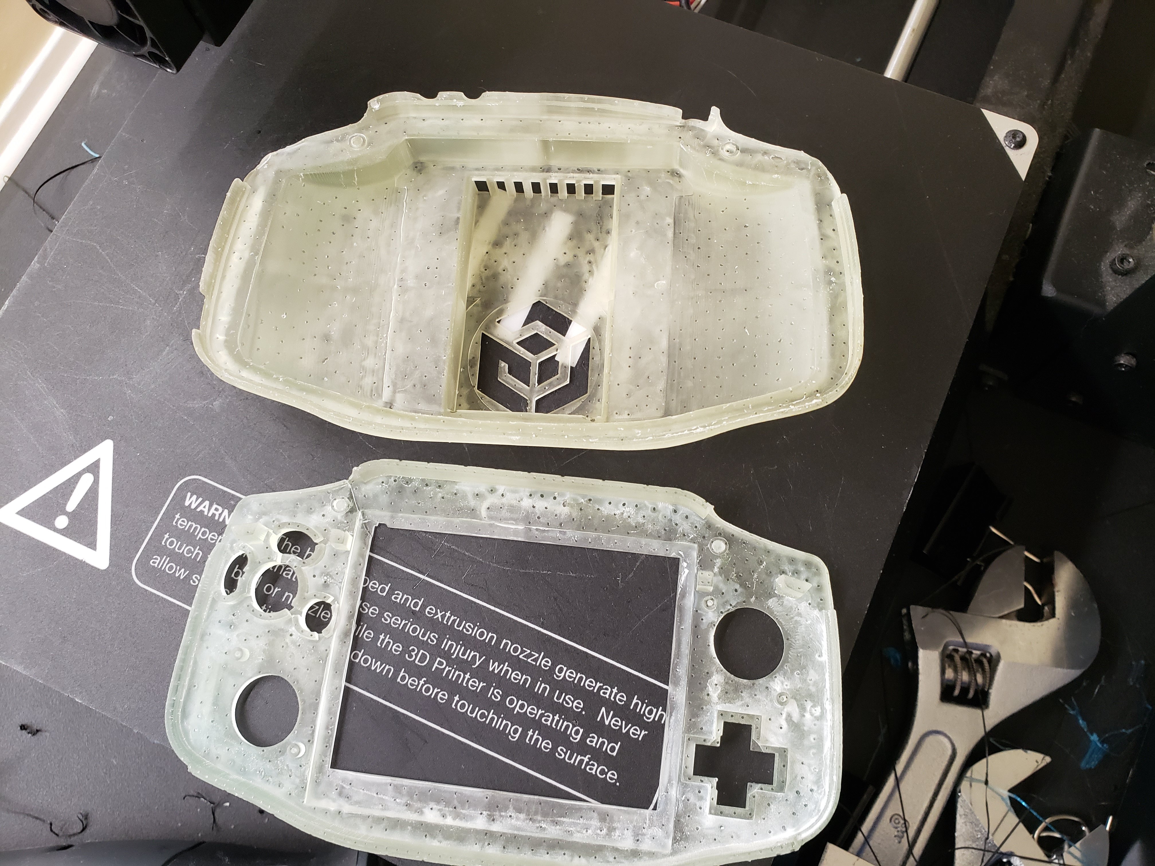

I also went ahead and printed out the back half of the case in resin, and I still believe that resin is a viable option for a case. There are a few warped sections around the edges, however keep in mind that this was a first attempt test print with default settings and support (I've definitely had worse FDM prints with default settings).
It looks like the warping I see is being caused by a couple areas around the edges of the print breaking loose from the support and then bending during the print. I think that adding some custom support, I can greatly reduce or eliminate this warping. I was mostly worried about warping that might happen as the print was curing in the light, but that seems to be fairly unfounded so far.

So I have finally figured out my batteries. I will be using 4x 16650 battery cells, which are basically 18650s, but about 2mm thinner in diameter. I will get about 2125 mAh each, meaning that 4 of these cells will hopefully give me about 3 hours of battery life.

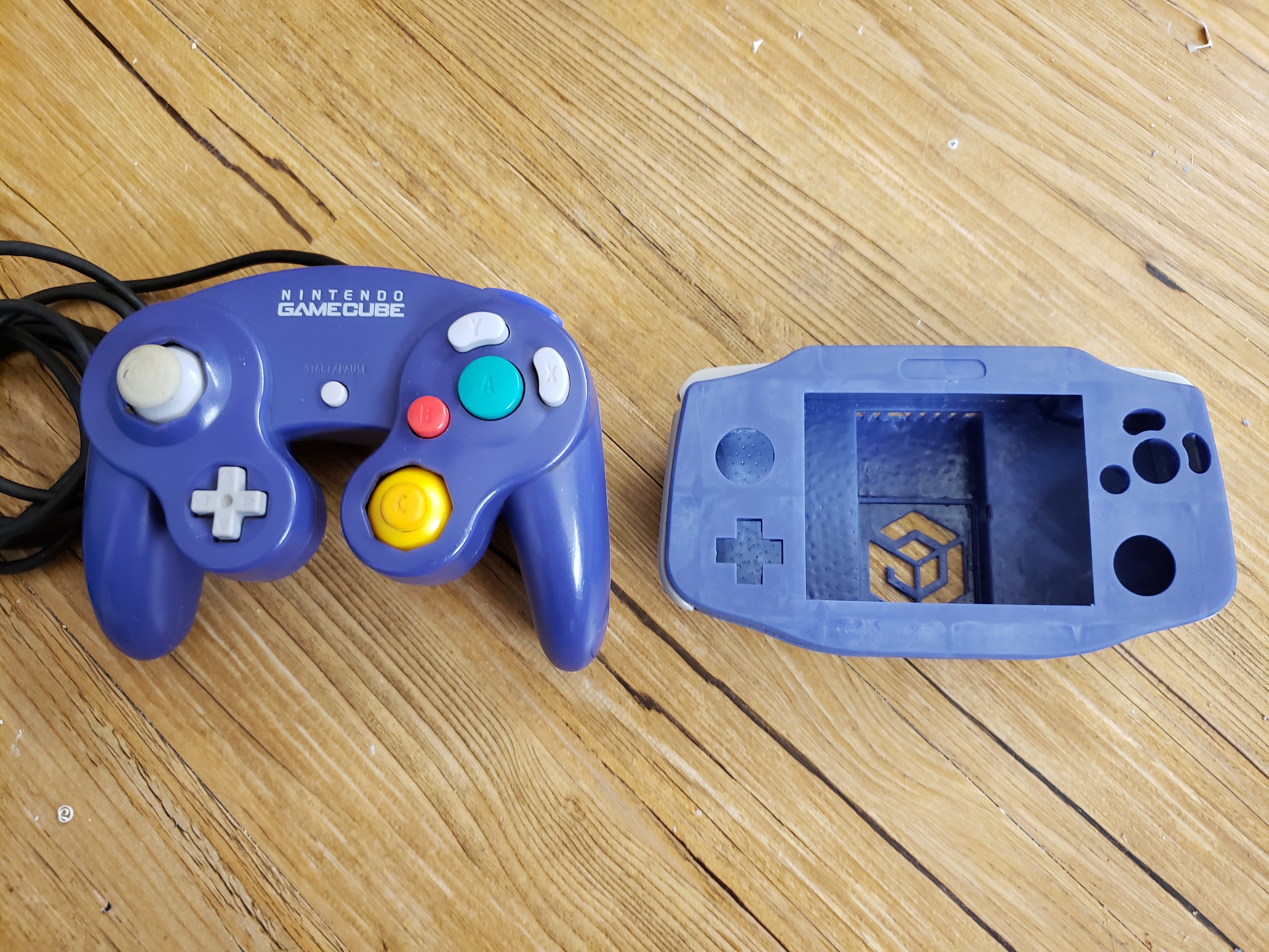

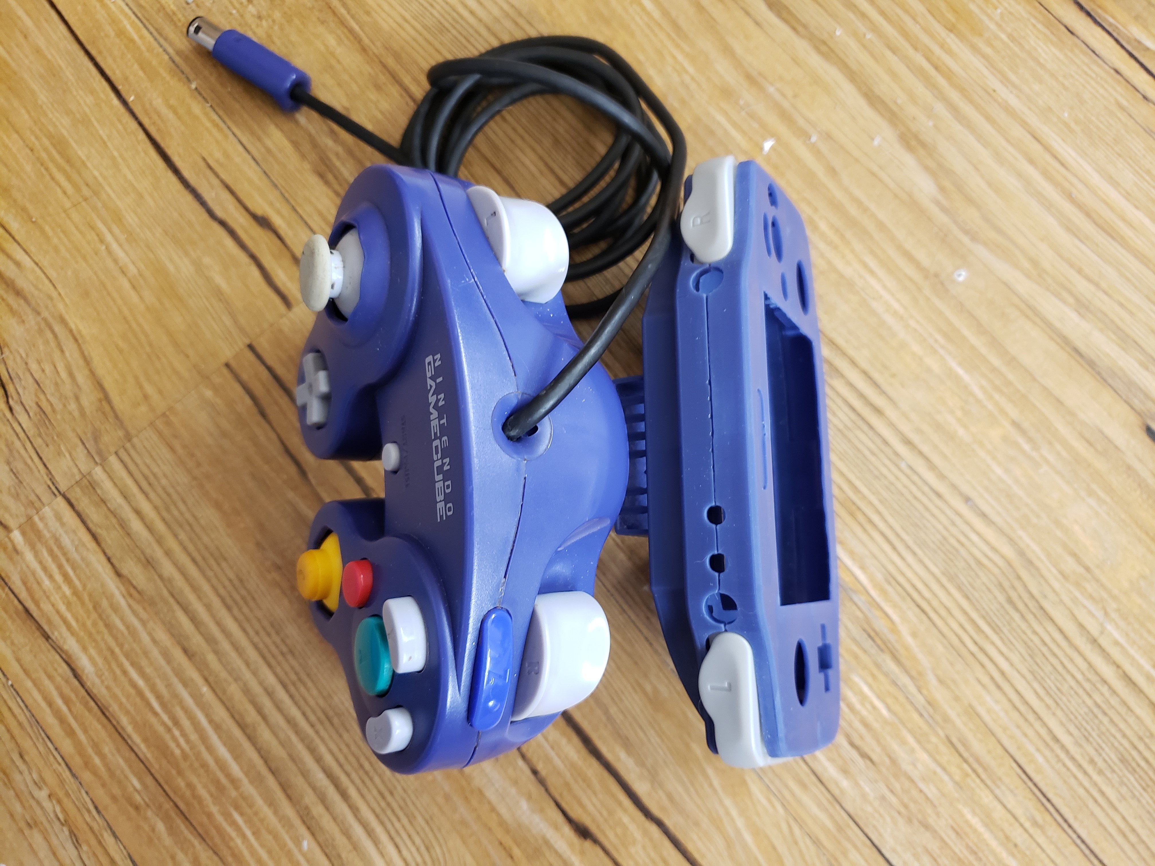

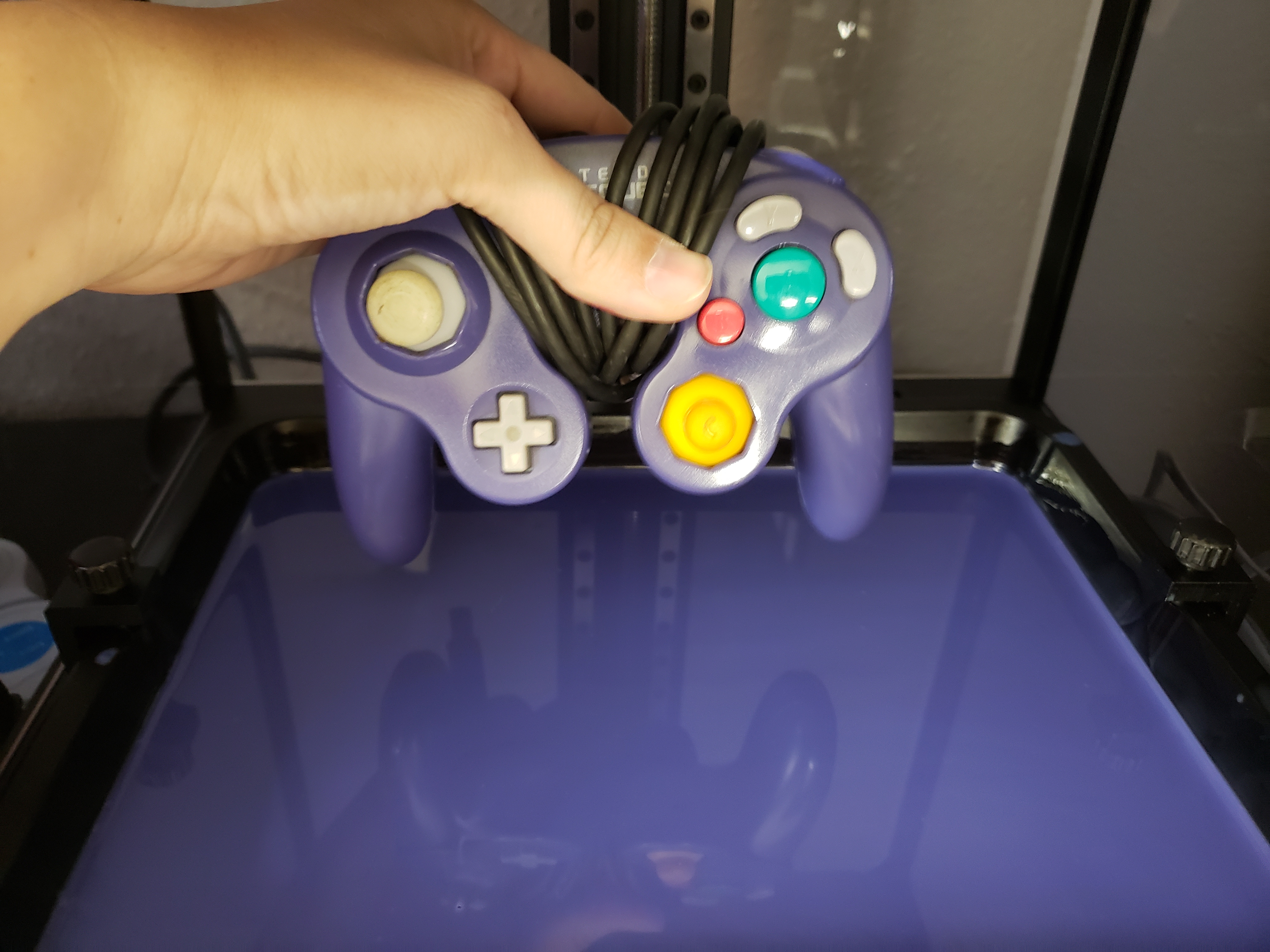

Thanks to @eggbowl, I was able to order some pigment and mix my own resin. I was able to get it fairly close to the gamecube color :)
After printing and curing, it's a pretty close color match, but it's sort of pastel. Rather than the vibrant glossy Gamecube indigo, it's a fairly flat color. This might be able to be glossed over with some sandpaper and polish, but I haven't tried it yet.
The biggest downside to this white resin with pigment is that the resin does discolor slightly once cured. Here is a sample of some over-cured resin on the left, reasonably cured resin in the middle, and fresh out of the vat resin on the right. As you can see, it doesn't discolor too much unless you over cure it, but I am concerned about it curing over time from exposure to light in the room while being played. It would happen slowly, but I want to future proof my portable as much as possible.

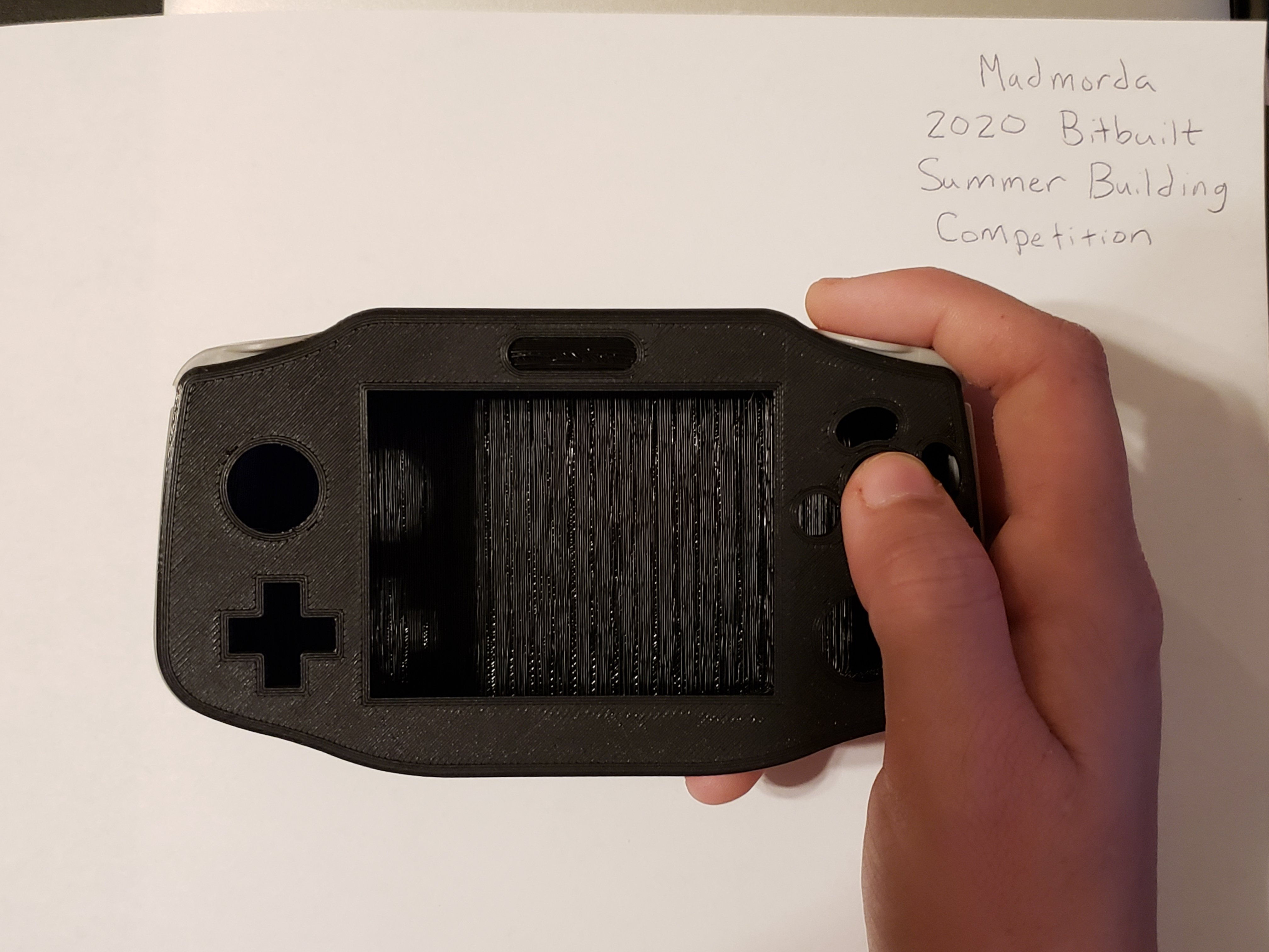

I have also added some speaker pockets along the bottom of the Gameboy (not the back). I tried very hard to fit them on the face, but there just wasn't any good way to do it, so the bottom is the next best thing.
This week, I will be working on printing some flat pieces to hold the tact switches in place behind the abxy/dpad buttons. More next weekend!
