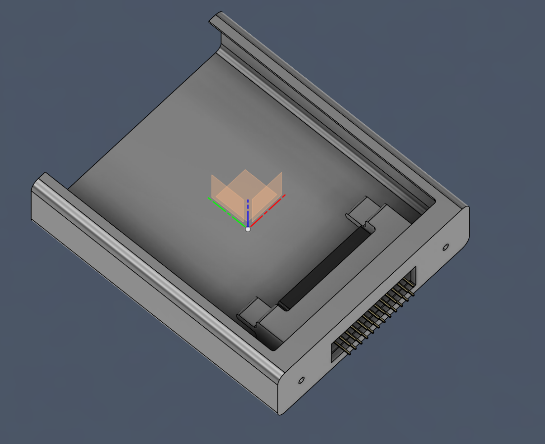

As for current progress, I started working on this project in the beginning of May, and first started by recreating the Atari 2600 cartridge in CAD as closely as I can to help model out a well functioning cartridge slot. I already released the model to the Model Repository, and so far it's proven very useful. I already pretty much have the shape of slot nailed, and after 1 or 2 test prints, cartridges insert and remove very smoothly.
A big requirement I had when it came to the cartridge slot is that I wanted the cartridge to slot in from the top and be nearly flush with the unit, and I also wanted the label to be fully visible. I think this design nails these goals perfectly!

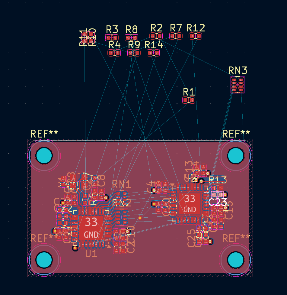

During this I was also trying to come up with a good solution for video output, as 240p video is a bit tricky to deal with using the screens that are most popular currently with the community. Most screens these days straight up won't accept anything less than 480p VGA video, and for a long time there wasn't really a good, low power & low latency way of upscaling 240p/480i content to be viewable on these displays. Enter Shank's LumaDoub project - an open source, low power, and lag free analog video encoder/decoder/line doubler. It can accept a variety of analog video standards in, and output a variety of analog video standards out. It's absolutely perfect for this project, with one issue: it's not released yet.
According to Shank, LumaDoub is feature complete, but just needs code cleanup & some spit shine before it's ready for prime time. Unfortunately, this would mean that I'm unable to use it for this contest until it gets released according to contest rules. However, Shank graciously decided to provide enough information on the Discord for anyone to be able to implement a basic version of LumaDoub on their own before release! The actual hardware design was pretty simple, it just requires a very specific i2c initialization routine, which he graciously shared with the class, enough to get CVBS/S-Video to 480p VGA up and running! Armed with the knowledge to perform great acts of sorcery, I set off to design the schematic, and came up with something that I'm pretty pleased with!
I also got started on the board routing, but haven't finished yet. My plans are to order this from Aisler using their 0.8mm ENIG service, which right now has a coupon for $20 off, so the boards are basically free at the price I was quoted!

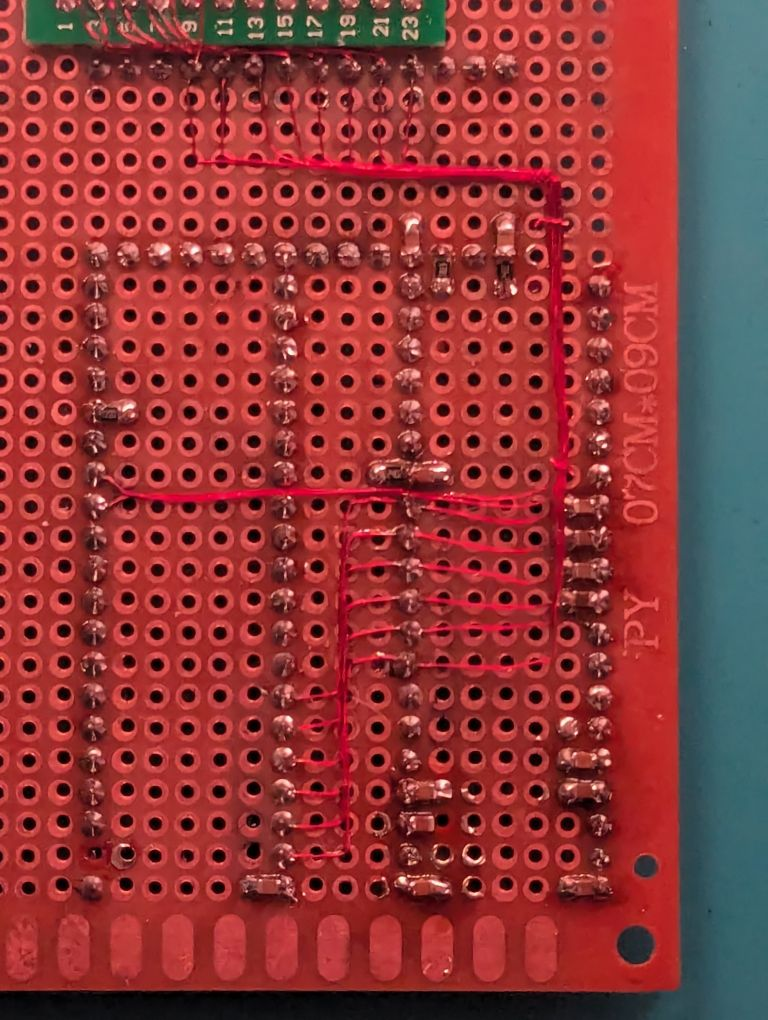

Finally, once I got some of the necessary parts in from Amazon, I got started soldering the Atari board. I went with a chip layout very similar to Ben's original design, but I'll be doing all the routing my own way to try and keep things as clean as possible. So far I finished the whole data bus, and started laying out some of the basic passives. I still have quite a bit of work to do on this!

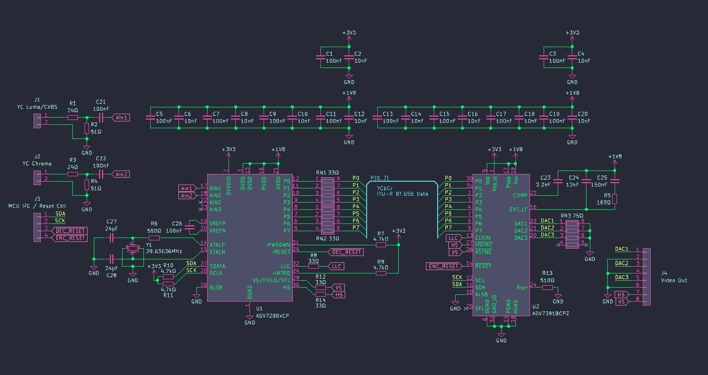

Lumadoub's core circuit is based on the ADV728A Eval board. The schematic can be found on Analog Devices page here.
Startup Sequence can be found in the datasheet here.
Example scripts to get the ADV7280A (and ADV7391) running in this configuration and others can be found in a .txt file here.
Additional parameters can be adjusted via i2c. Info on that is in the programming guide here.
Additionally, turning on fast lock can fix stability with 240p. And finally, resetting bits 3 and 4 of ADV7280A VPP map register 0x5A will disable the field blending, making it perform simple line doubling. Shoutouts to Mike Chi of RetroTink for sharing that info
This is basically all the info one would need to make this video circuit.
