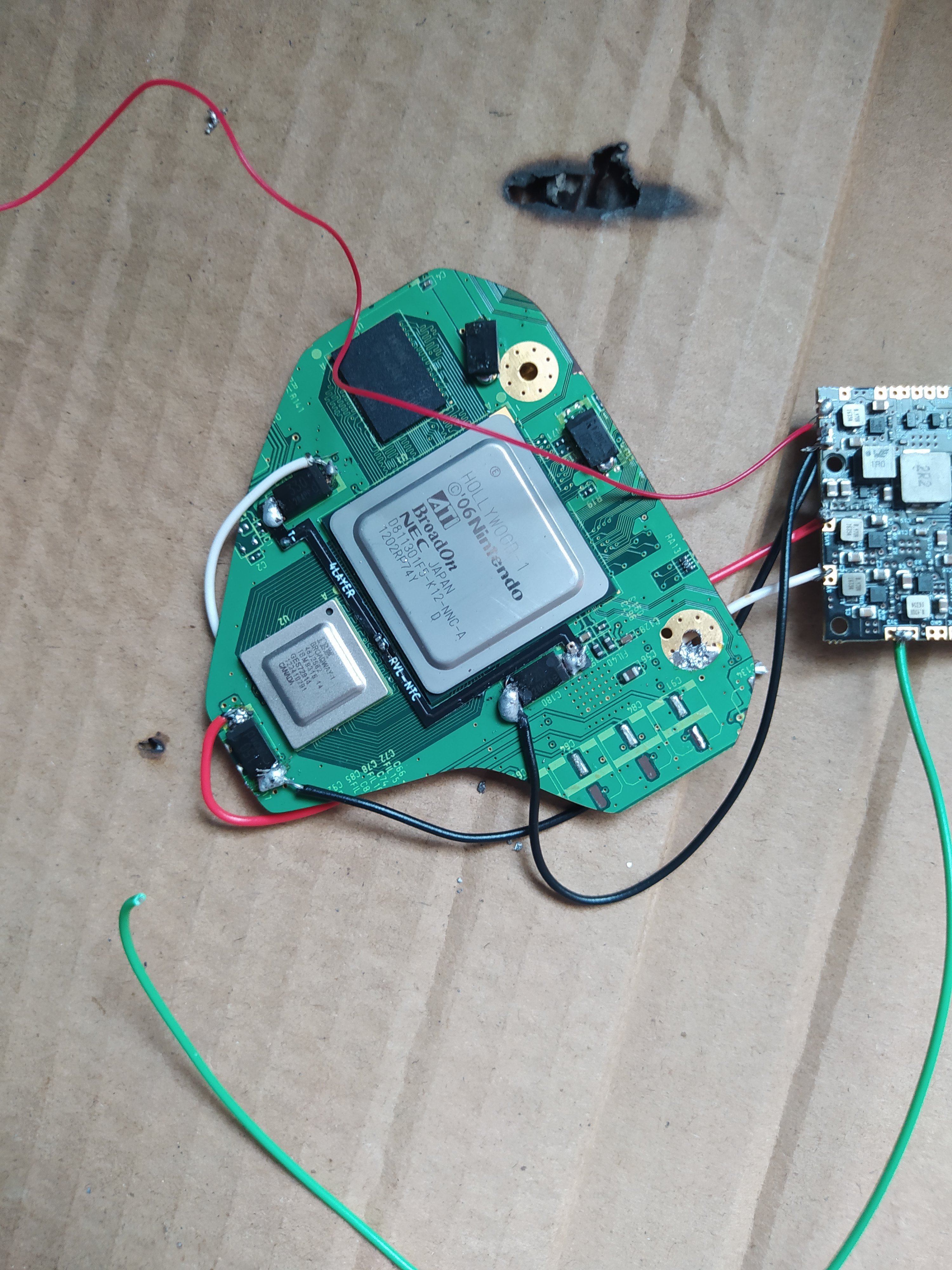

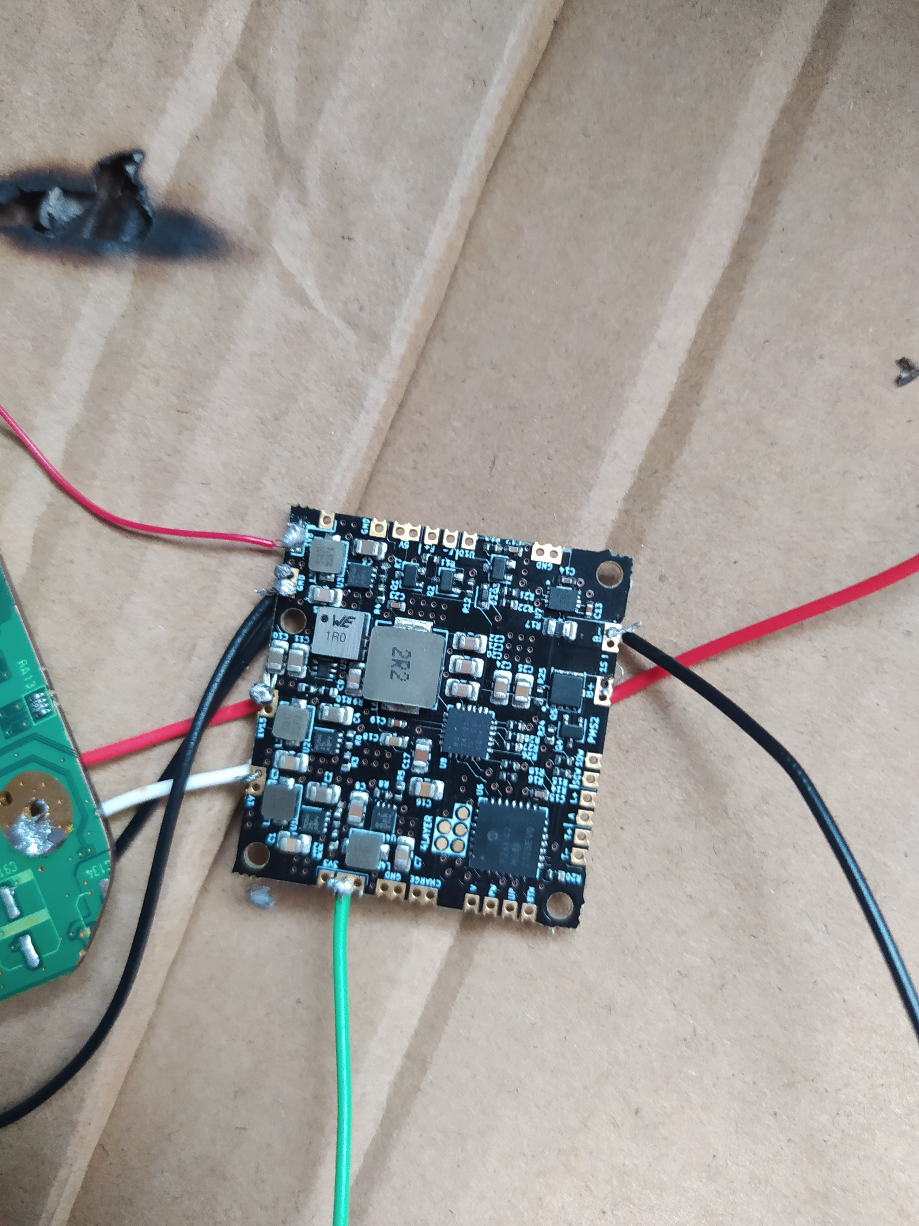

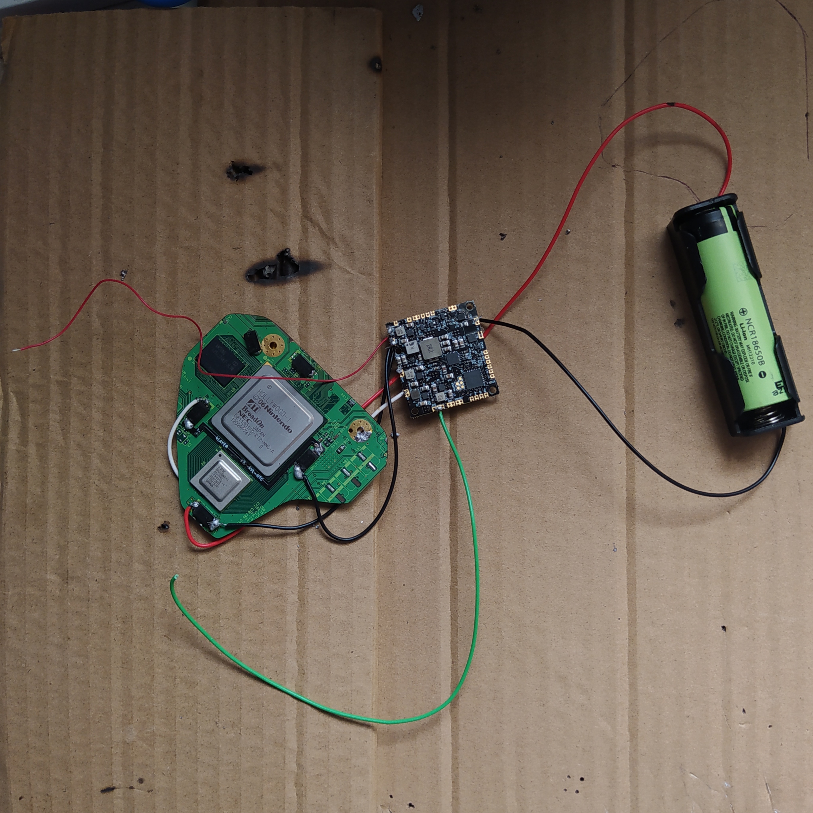

This is what I have of wiring the RVL-PMS to the Wii. All I have to do is wire the 1.8V and the 3.3V.

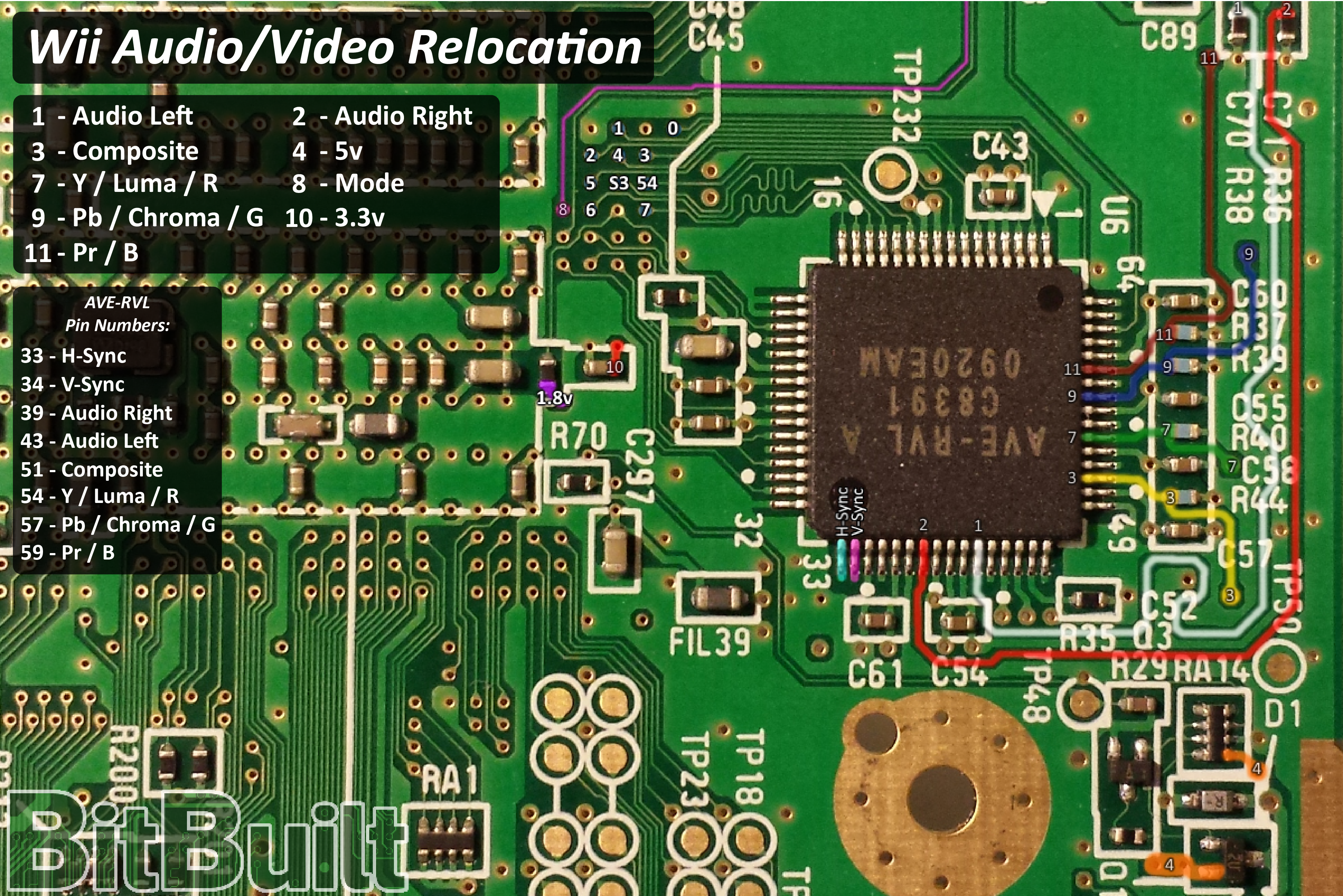

Come on dude, this is getting frustrating now. You performed the 1.8v tantalum capacitor relocation, but don't know where you should connect 1.8v to? Connect it to the positive end of the capacitor that you relocated, this is basic stuff. Also, if you'd read the Trimming Guide properly, you'd have seen in the Voltage section that the tantalum capacitor directly above the Hollywood chip is one of the 2 major 3.3v locations. Also also, if you'd read the Trimming Guide properly you'd have seen in the Audio/Video section that C91 to the right of the Hollywood chip is a convenient solder point along the composite video line.
I must say though, nice trim. Good clean, neat edges.
Side note: Your solder joints are cold and cloudy, I'd increase your soldering iron temperature and get some no-clean tacky flux.

See the attached image from the guide. Pin 3 of the audio video encoder, in yellow, is composite. Run the composite video wire to any of those points.
As for 3.3v and 1.8v, there isn't really any specific ideal place to put them, on any trim for that matter. You don't have to run those or ground to the specific points in the 4 layer documentation: those are mostly a quick reference. All the points of the same voltage are connected through a big voltage plane on the center of the board. So as long as you are connecting it to part of that plane, you should be good. You can connect it where you see several vias, or to the relocated tantalum capacitors.
Also, your U10 line is not wired up, so your system will not boot. You will also need USB wired up as well.
Additionally, your wires look pretty thin. Make sure you are using at least 22awg for your power rails.
Regarding your soldering, I would advise touching it up. The joints look cold and not properly joined, which can cause issues down the line. Some of your leads are too long as well. You also have some scary stray strands going on, like one from the B+ that looks like it's about to short out your lithium battery to b-.
