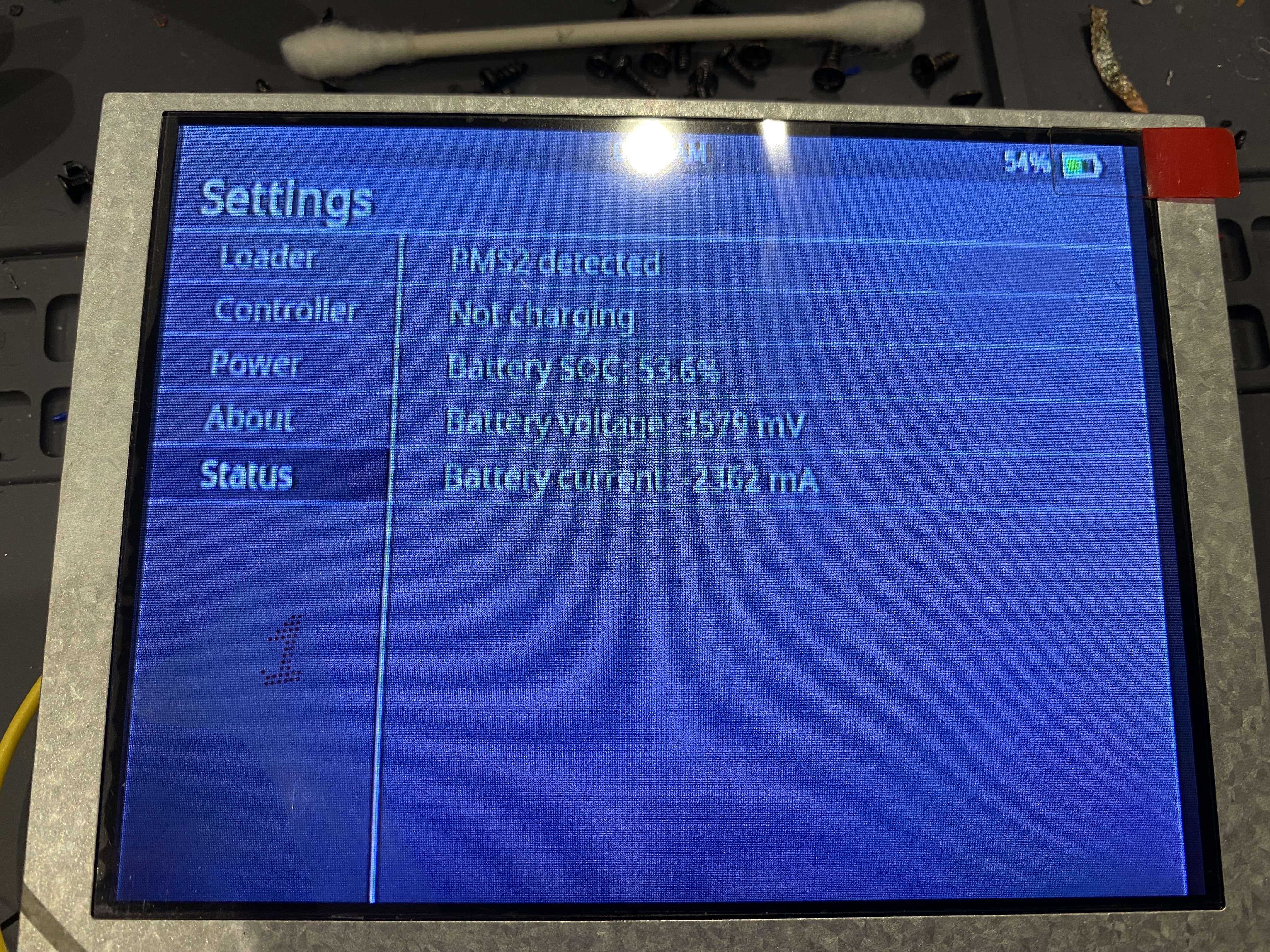

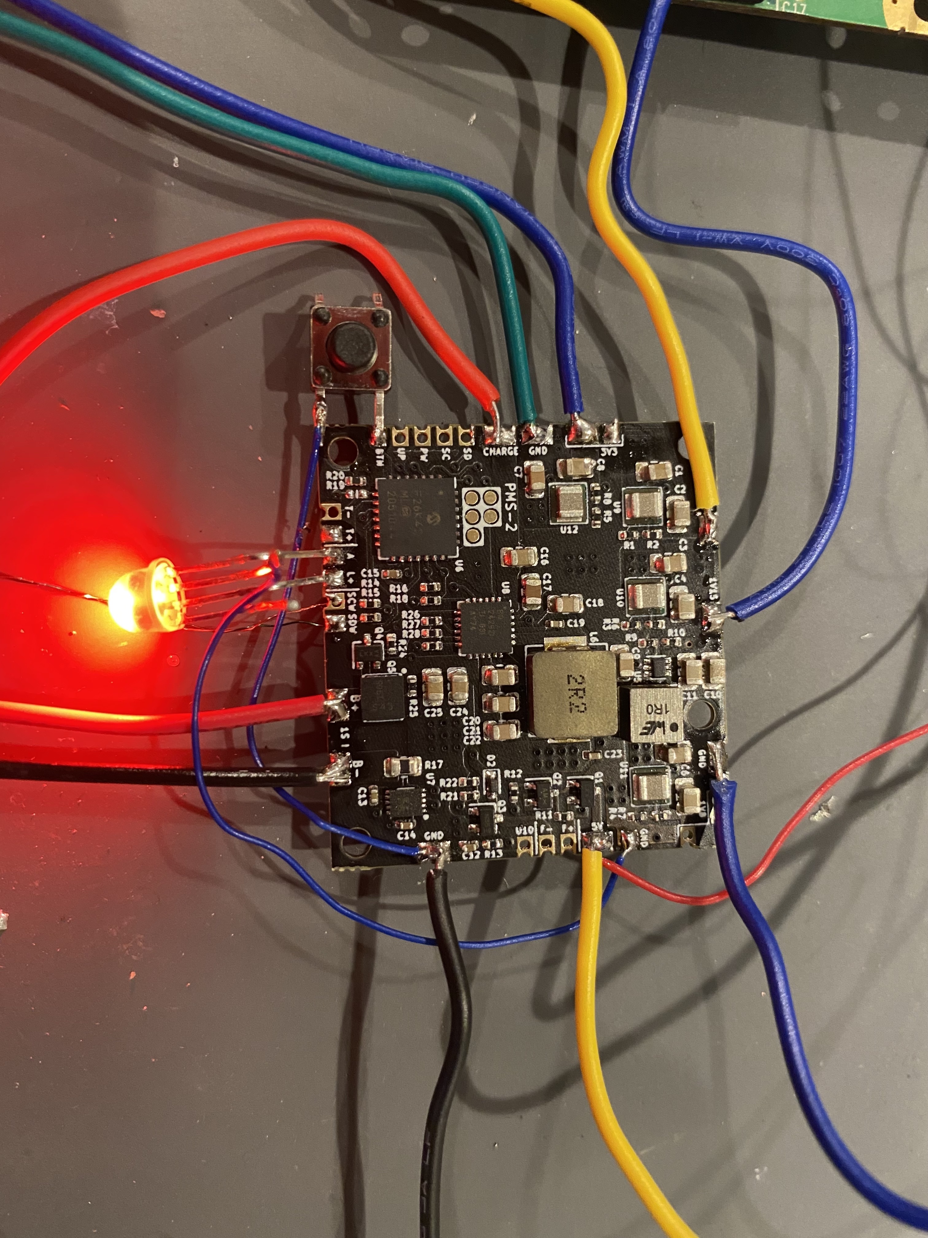

  • The battery led shows red when it is at 50% charged and green when it is on low battery. Not sure if this is intentional.
  • The Battery current is showing as negative in RVLoader. This could be why the LED indicator is backwards since it thinks the battery current is less than zero.

Status menu

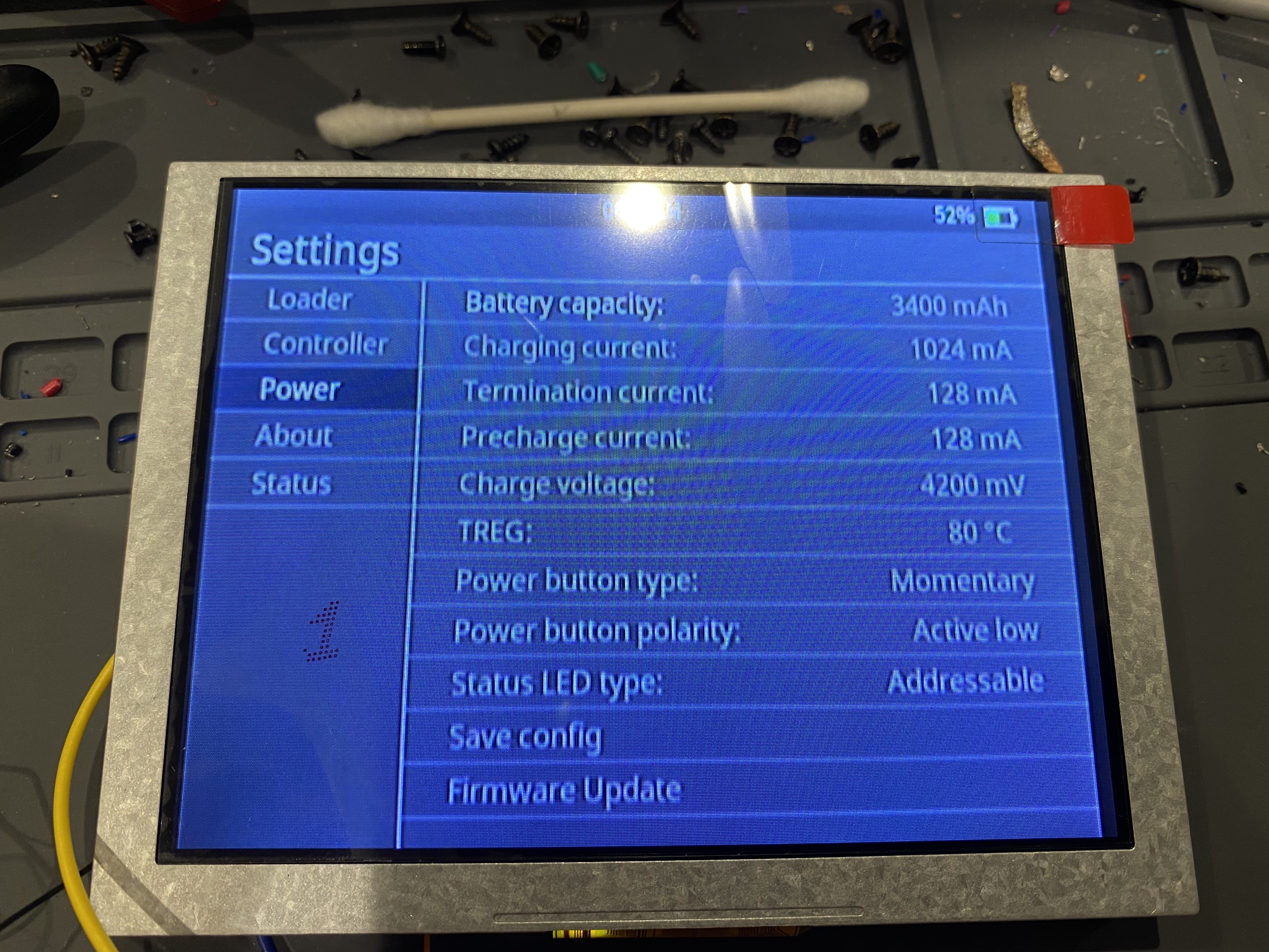

Power settings menu
RVL PMS Board wiring
SCW and SDW wiring
Not sure if these images help much but I believe my wiring is correct.
The battery current is negative when it is powering the wii, and positive current when the batteries are charging.
Okay cool I wasn't sure. Also is the LED supposed to be Red when the battery is charged and green when charging?
We are going to look into it and make a test. I'll get back to you.
I tested the addressable led and I have the same result you experience. The datasheet of the one we purchase for the pms leads on that it is the same as any other ws2812 led however this one seems to be different. There are many styles of addressable leds out there however they are not all the same. We are going to make another test and create a new firmware for it soon to address the colors. So continue what you are doing and it only takes a moment to update the firmware of the pms from rvloader.
Okay awesome! Just wasn't sure if I was wiring anything wrong wire since it seemed to be the opposite as the original PMS.
