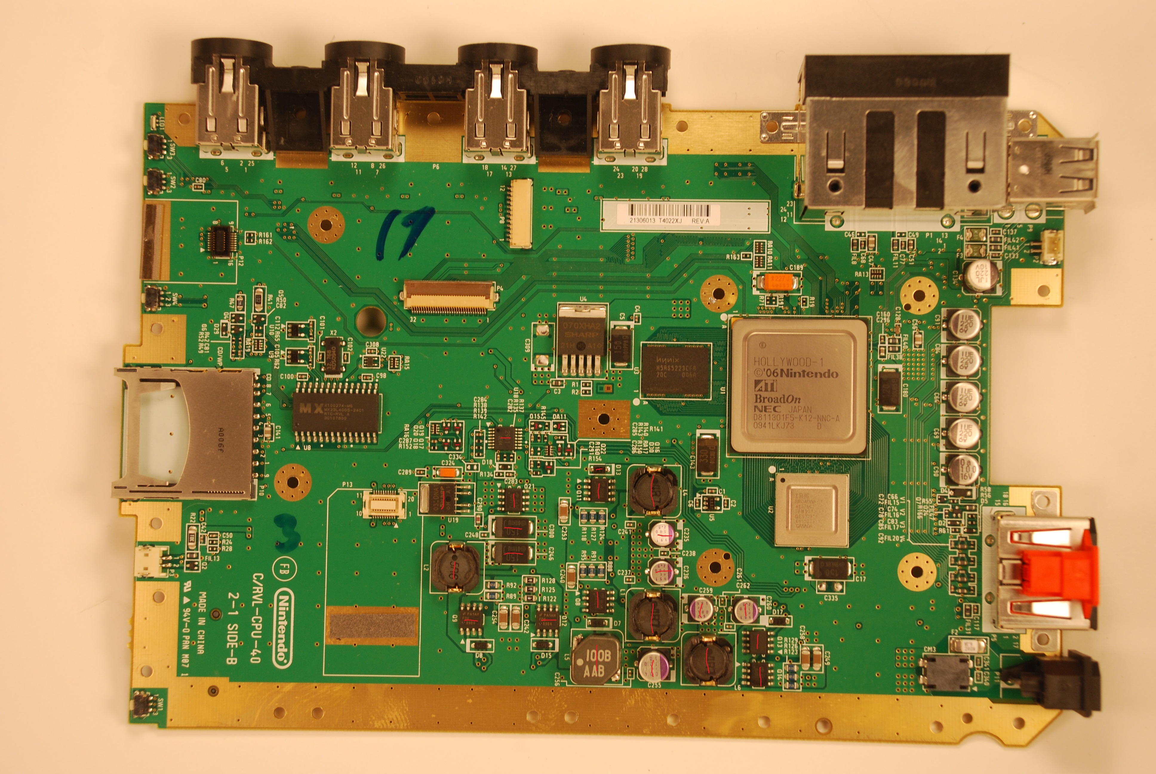

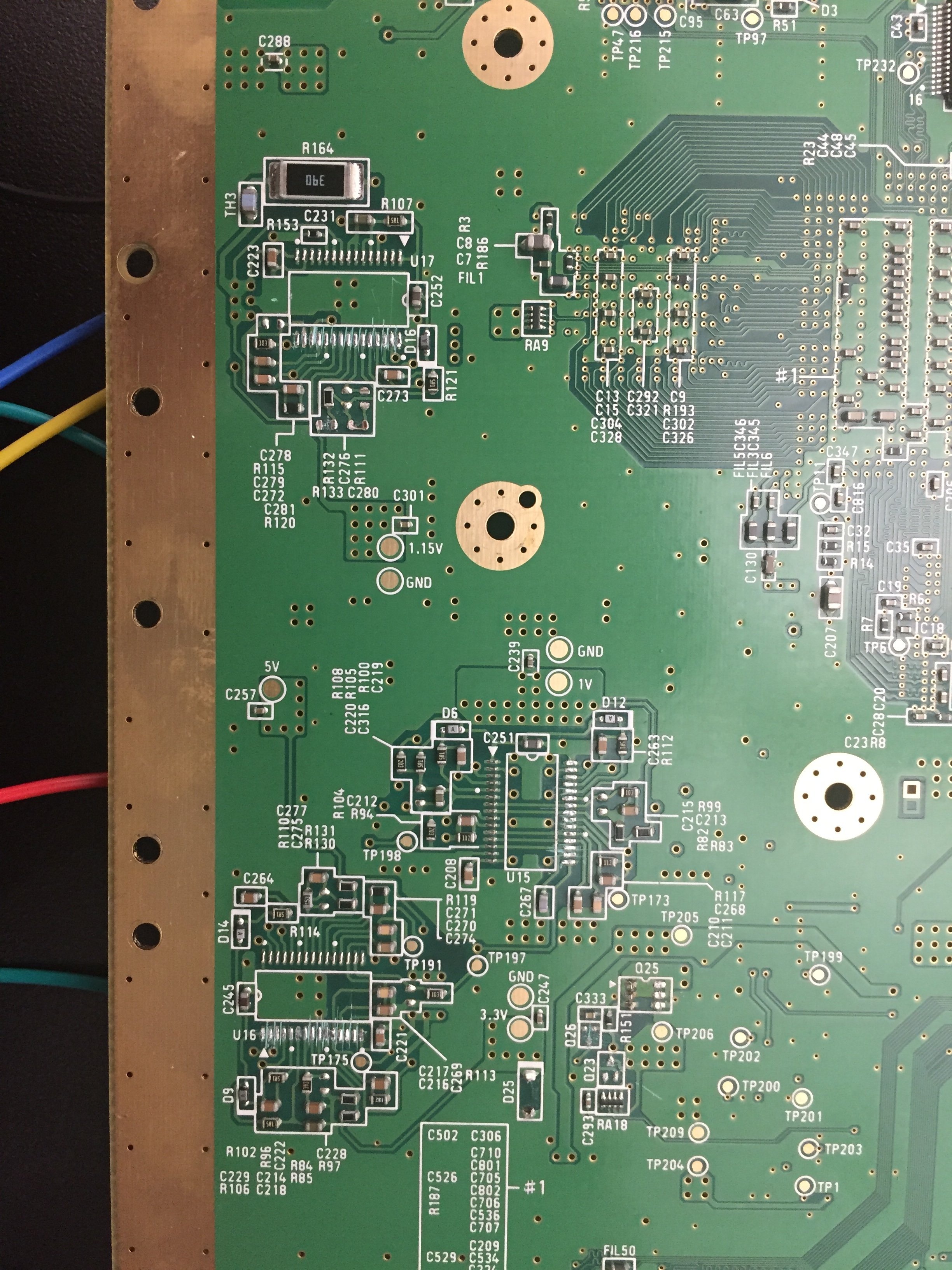

So I got to work on the motherboard! I removed U15, U16, U17, U18, the 3.3v standby regulator, the 5 large electrolytic capacitors on the top in the regulation area, the 5 inductors on top, the 8 8-pinned ics on the top, all of the little transistors near U18 and a few more on the bottom side. Pretty much everything except for the passive components. I have marked on the below pictures in red all of the components I just talked about.

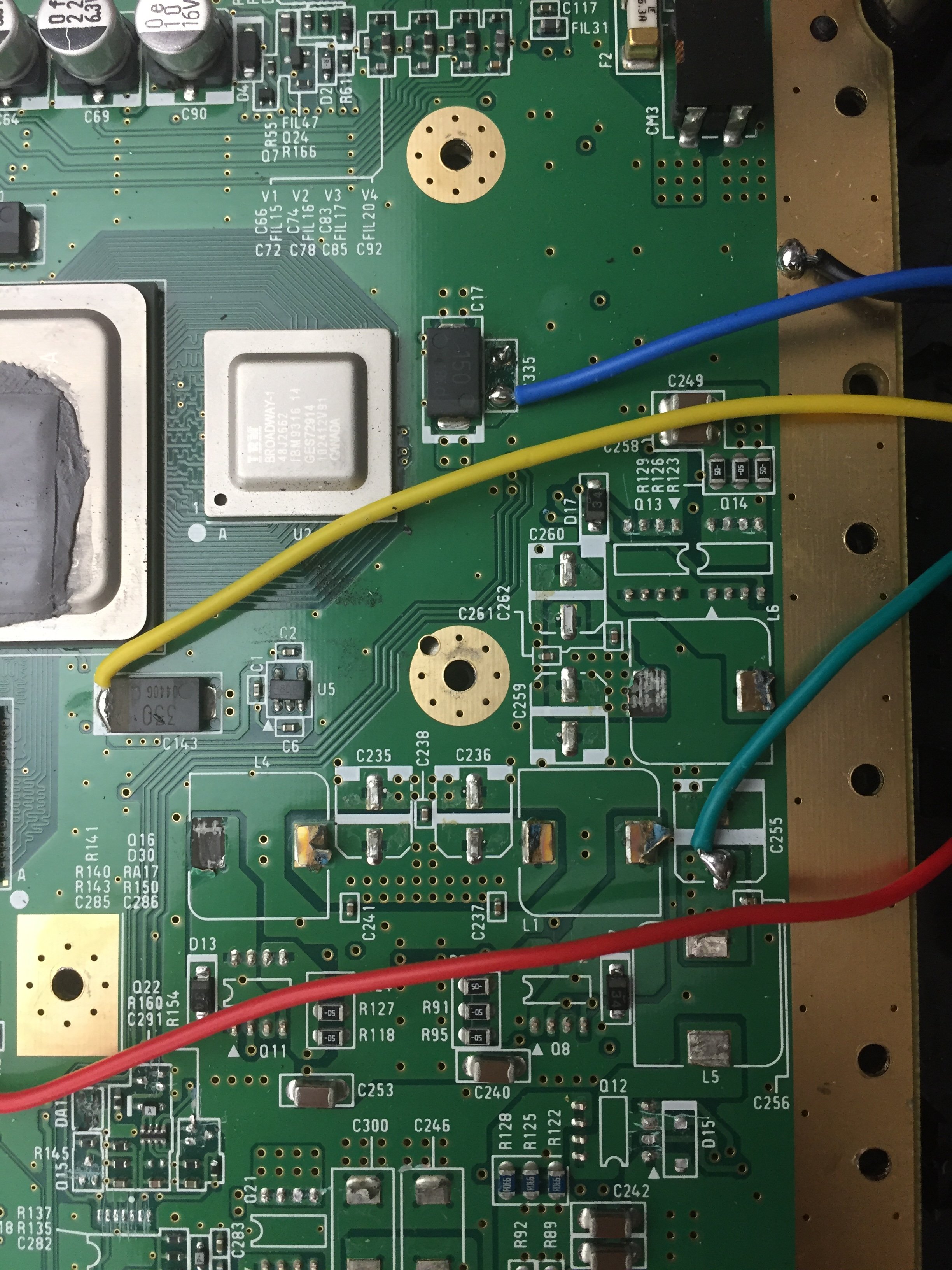

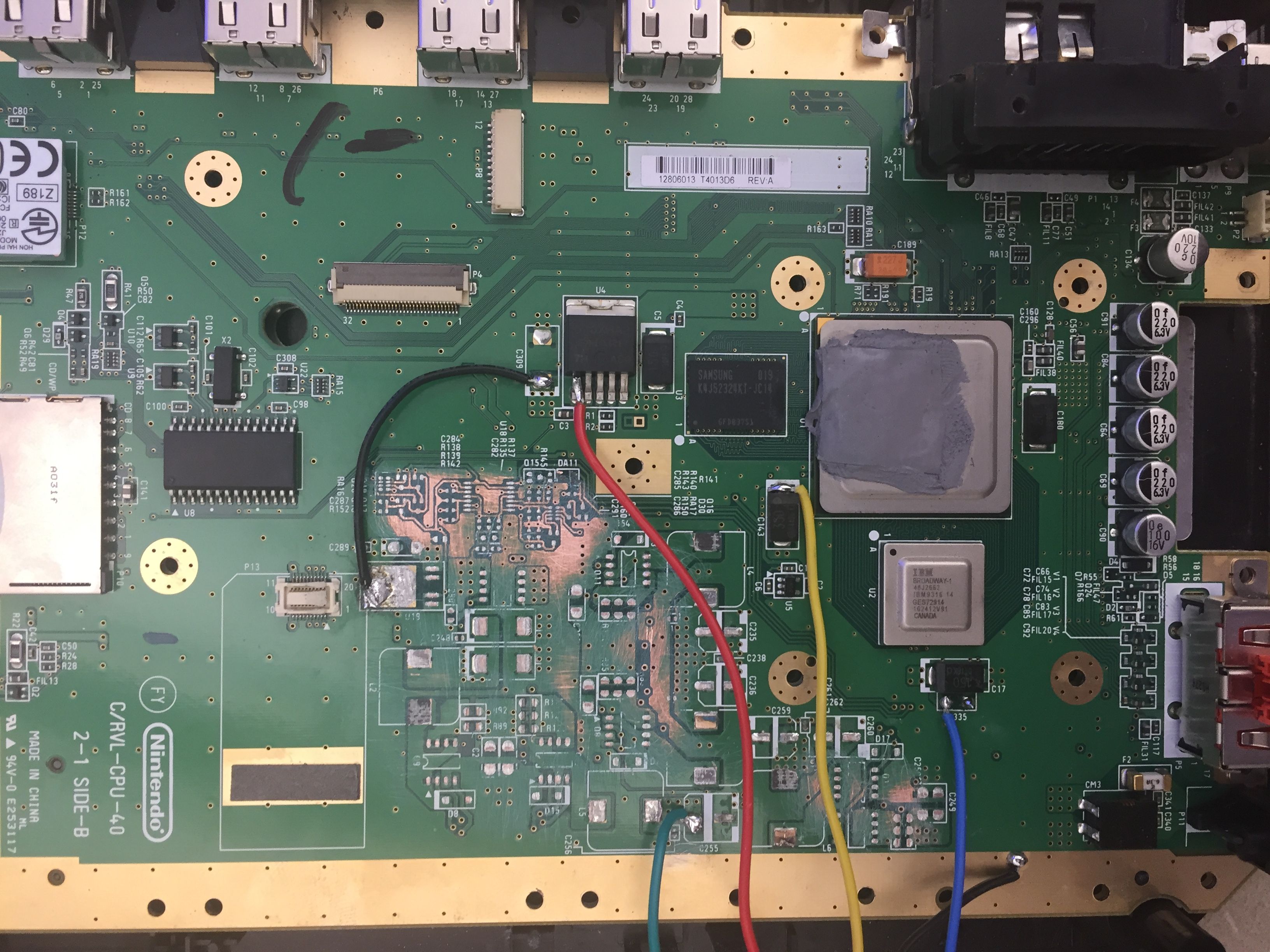

After that I made the below connections on the board to my regulators:
Blue Line: connecting 3.3v Standby line and regular 3.3v line
Orange circle: 5v (When I looked at the Wii compendium this spot on the electrolytic connected with 5v everywhere else I think)
Red Circle: 3.3v
Blue Circle: 1.15v
Yellow Circle: 1v
Black Circle: Ground
When measuring with my multimeter, My 3.3v volt line drops a lot, to under 1 volt. I am not sure what can be causing it as I did no trimming to the board.

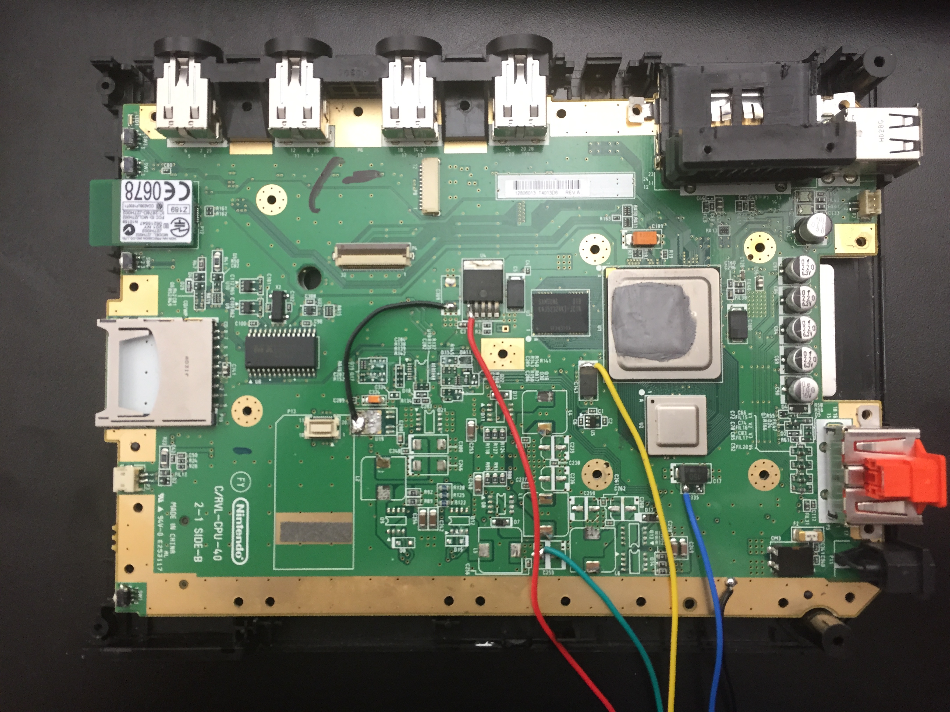

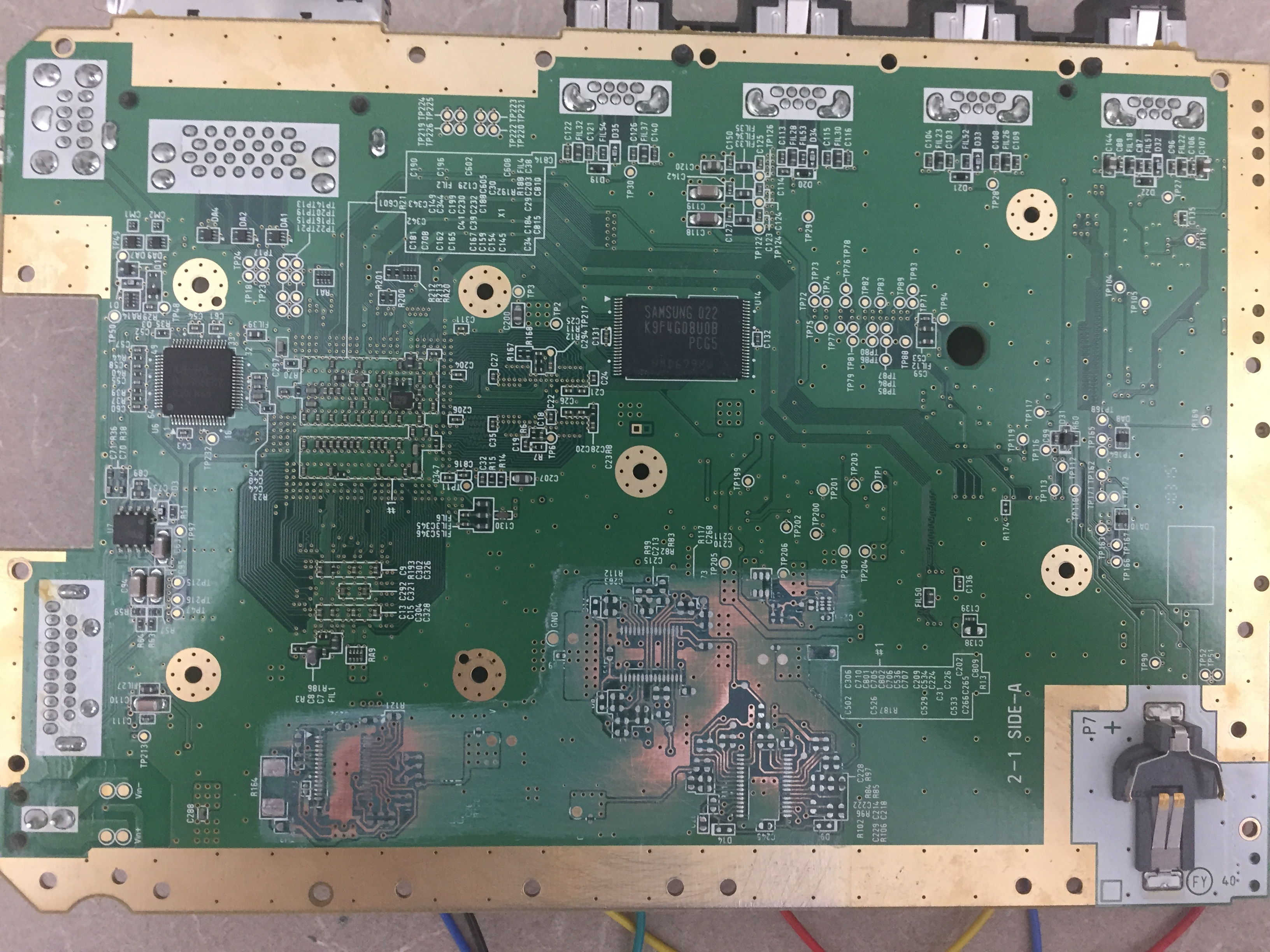

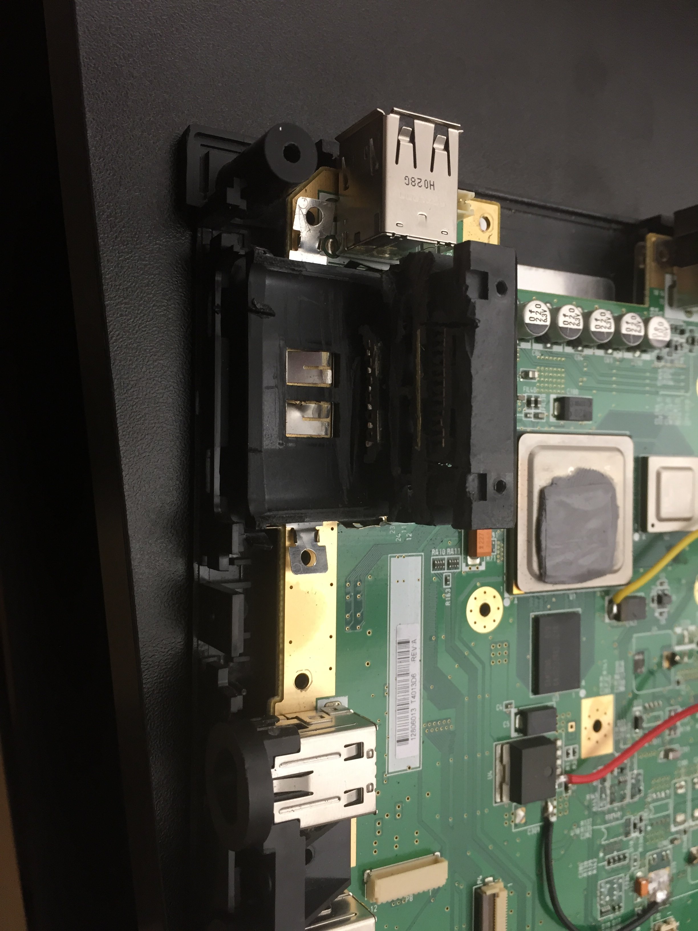

I have uploaded some pictures of the board. some notes I wanted to make:
1) I did trim back the gamecube memory card ports to provide space for the power switch, led status lights, audio jack and volume potentiometer but i tested the wii before even touching the onboard regulators and it booted up fine, so I do not think it is a short on the gamecube memory card ports
2) Removing the 3.3v standby regulator took a long time with my iron, I suppose I could have toasted something while trying to remove it
3) I also used a razor blade to knife between some of the legs of the removed ic's to ensure there were no shorts. I come from a background of making guitar effect pedals, and this is useful to clear out between those legs

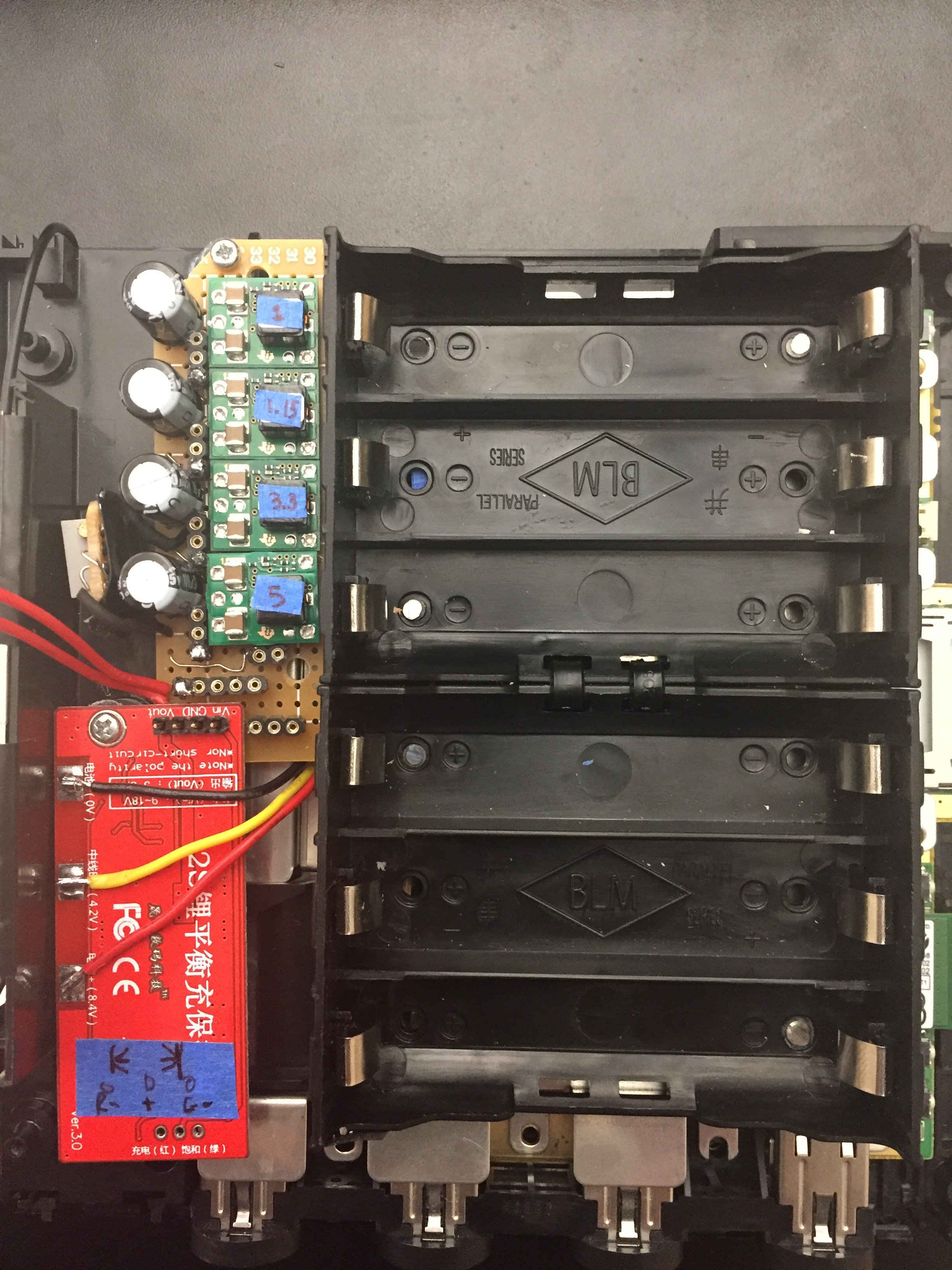

And here are pictures of my regulators and battery compartment. Next time I am able to work on it, I will take pictures of some of my multimeter readings

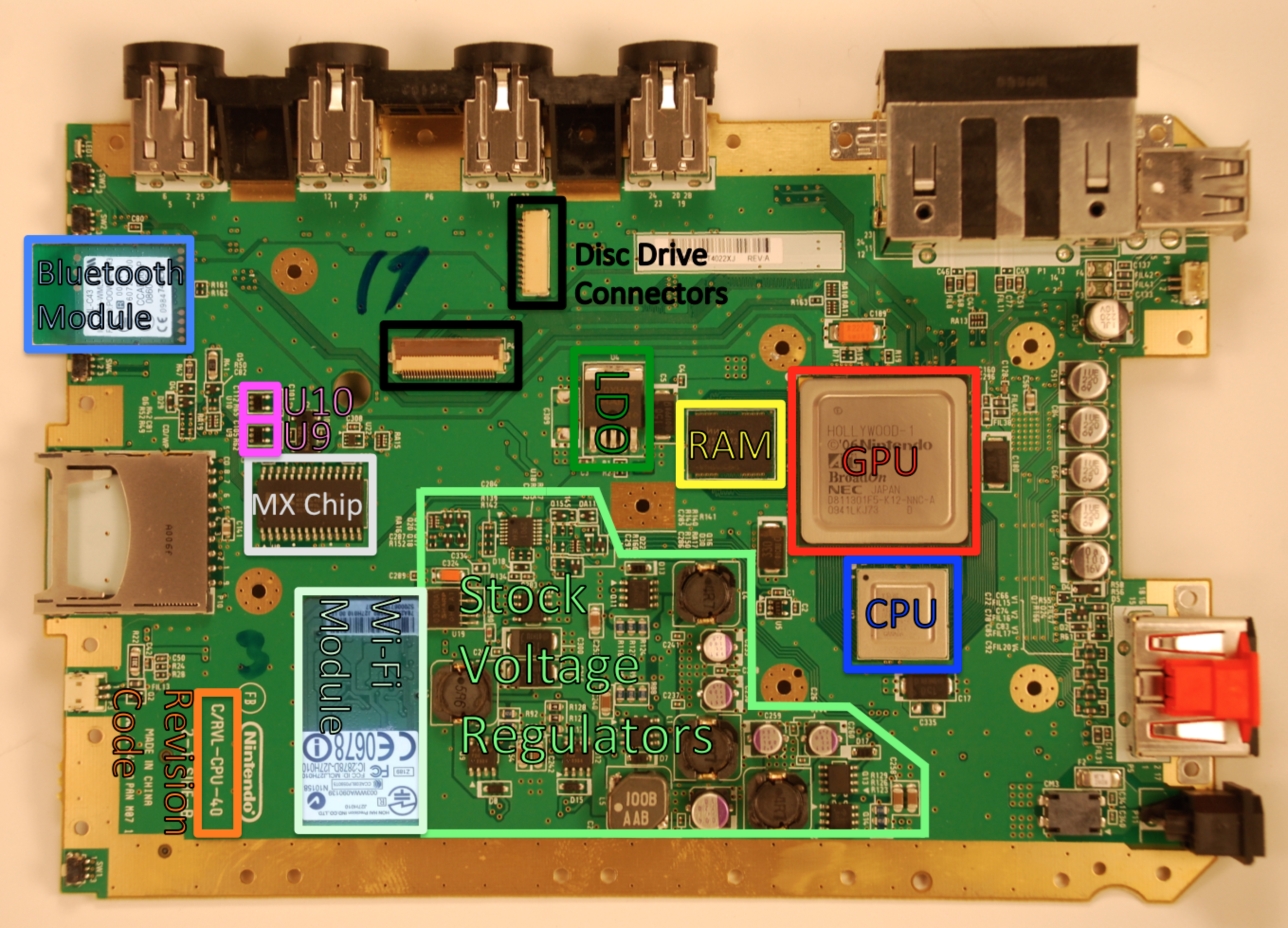

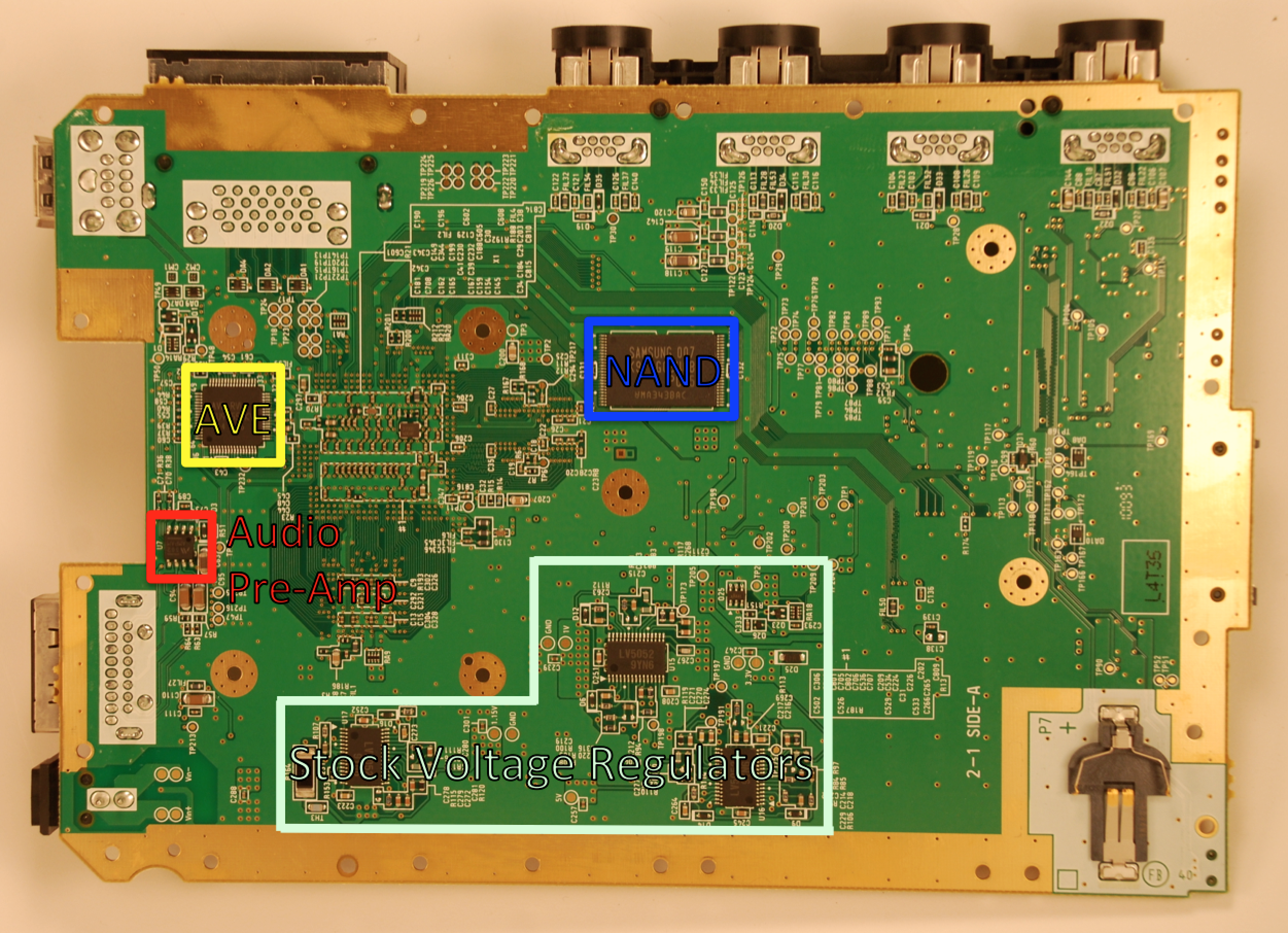

I would start by removing everything within the bounding box of the "stock regulators" outlined in these two photos. The behavior of the stock regulators isn't fully documented, so there could still be stuff going on with the remaining passives.
If you still have a short on 3.3v to gnd, I would suggest temporarily disconnecting the jumper wire between the 3.3v and 3.3v standby so you can tell which of the two is shorting to gnd.

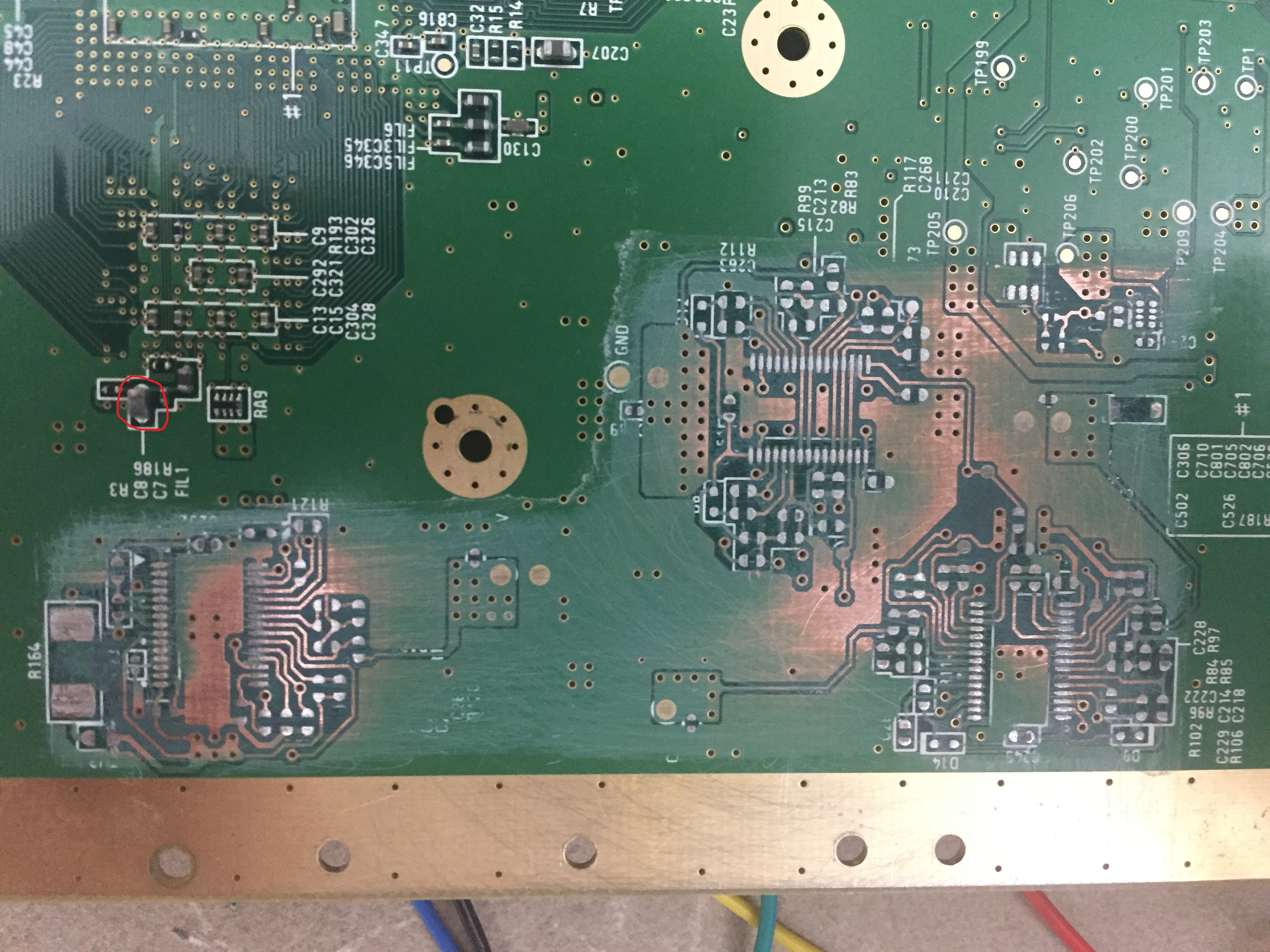

I did however accidently sand off a little bit off the top of the below circled in red component. Do you think that could cause the wii not to boot? I see that the group is made up of 2 capacitors, 2 resistors and a "Fil1." I think it is possible for me to replace it, but I am not sure what component a FIL1 is.

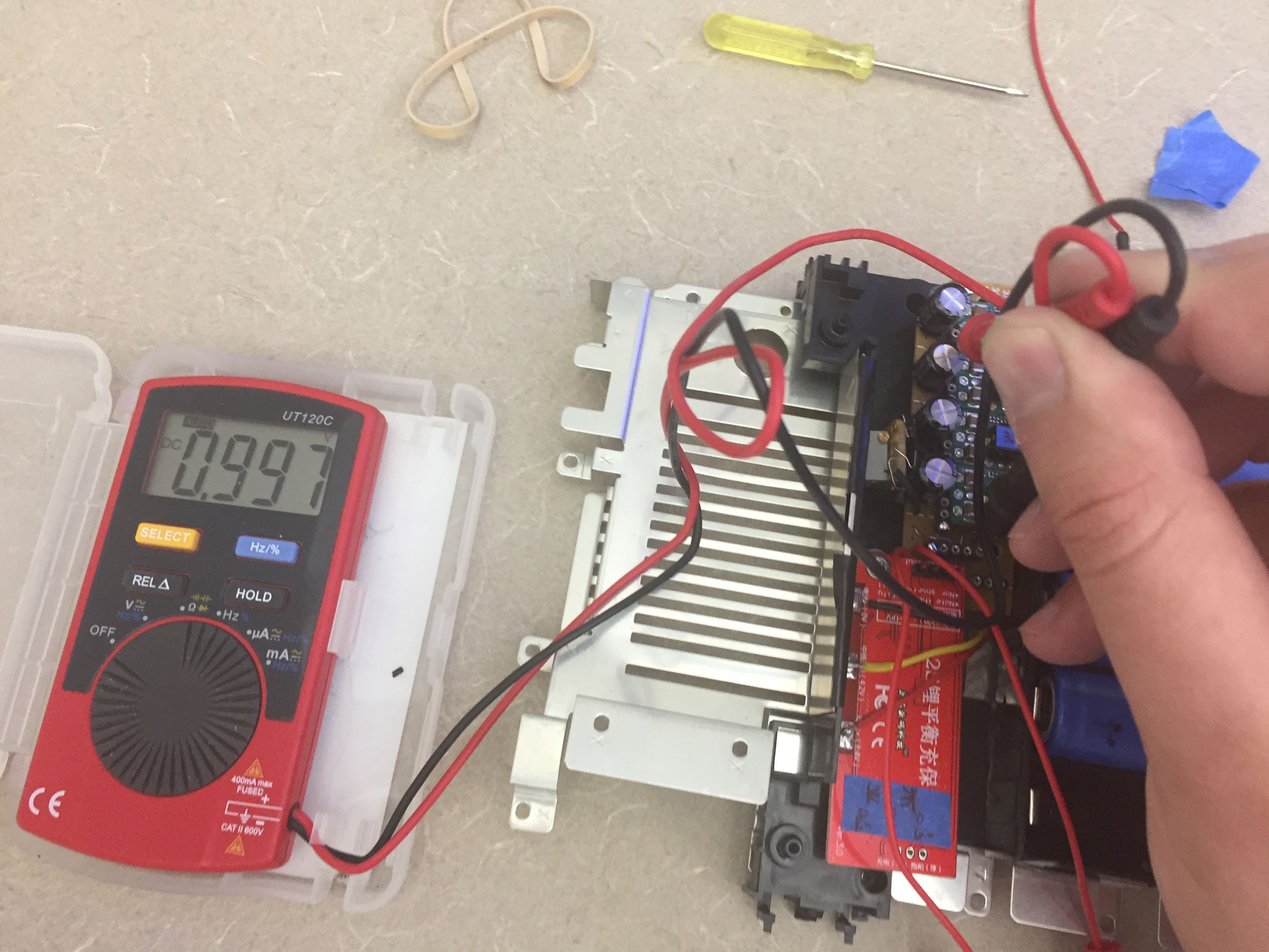

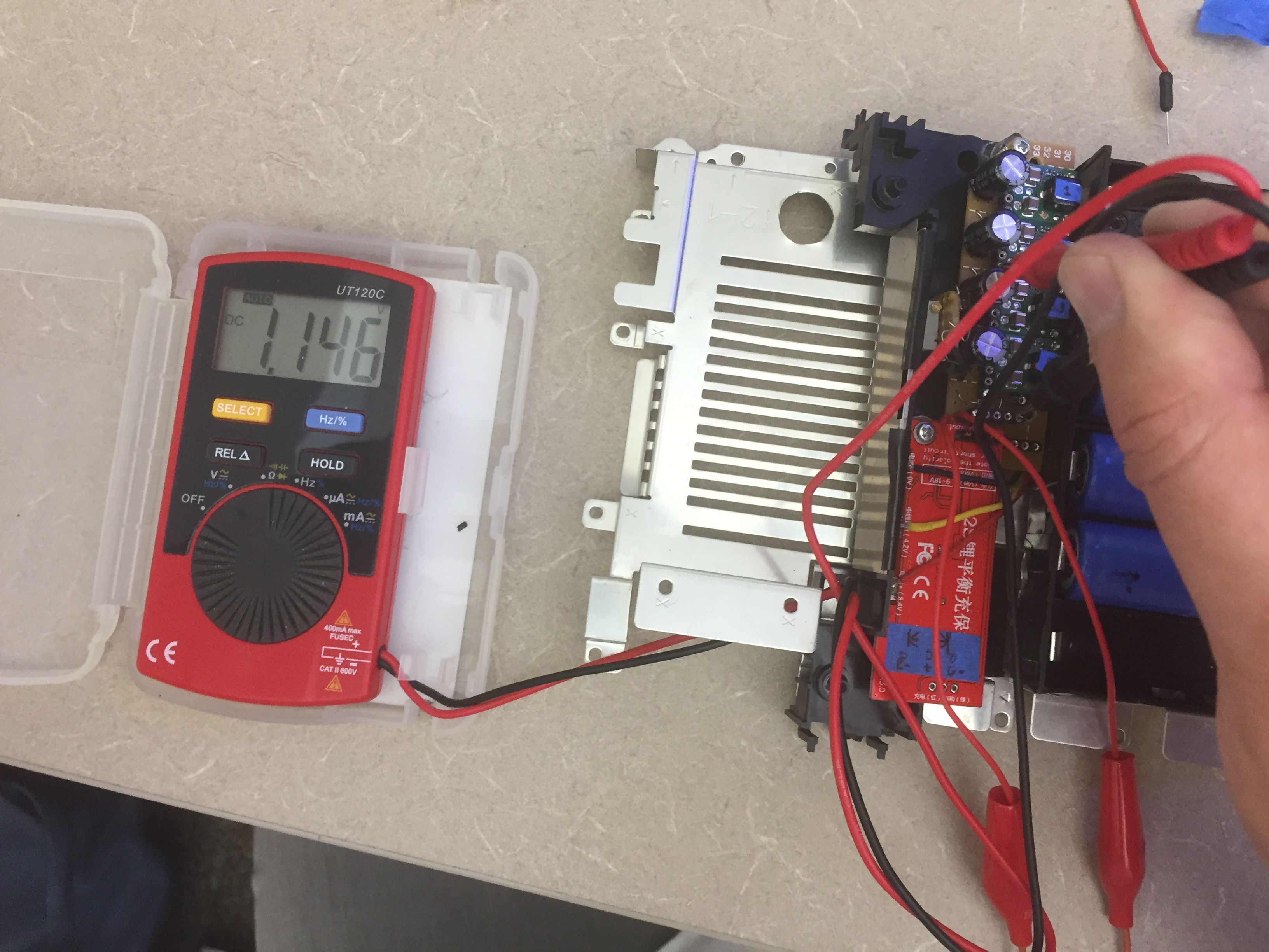

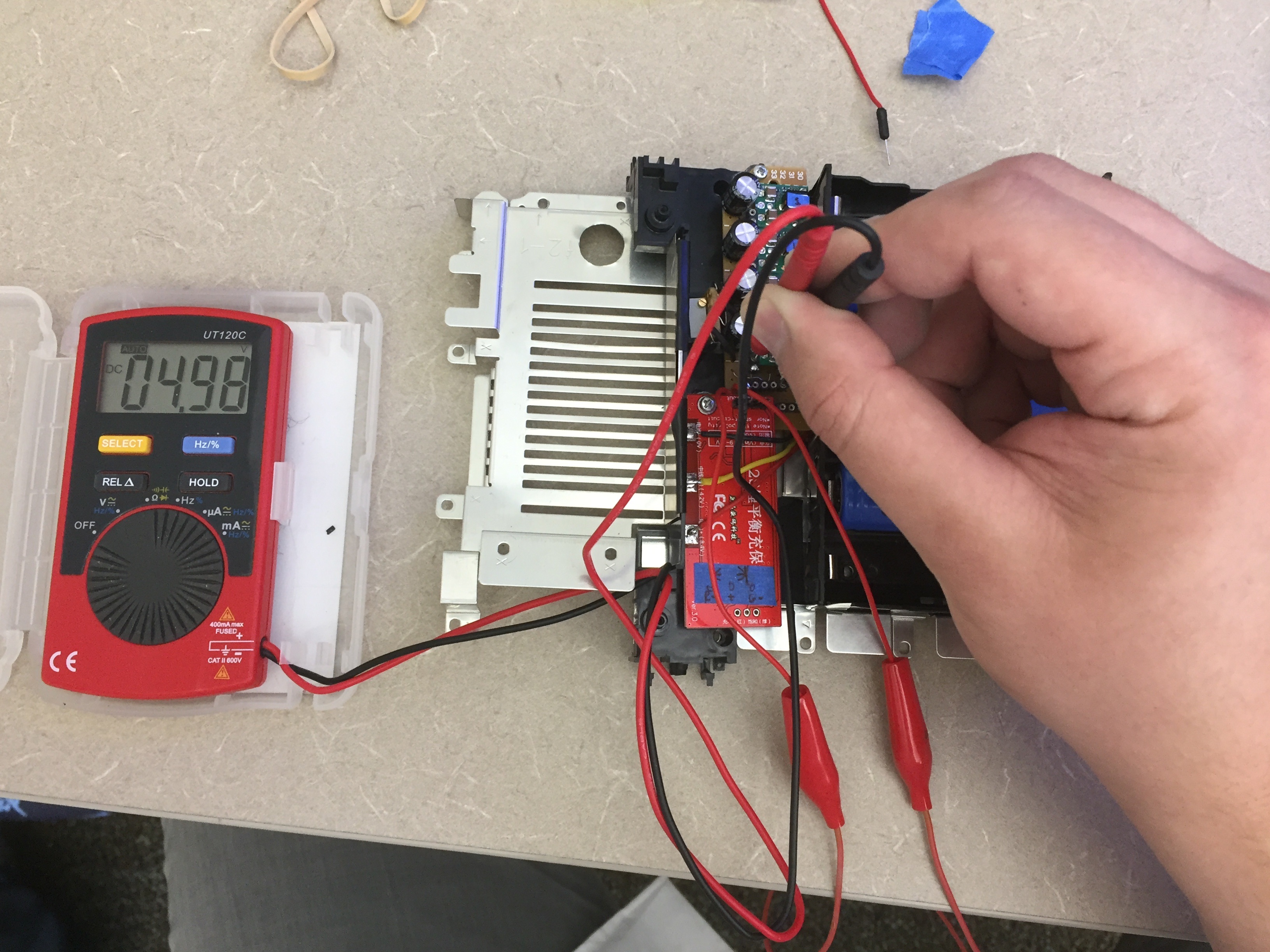

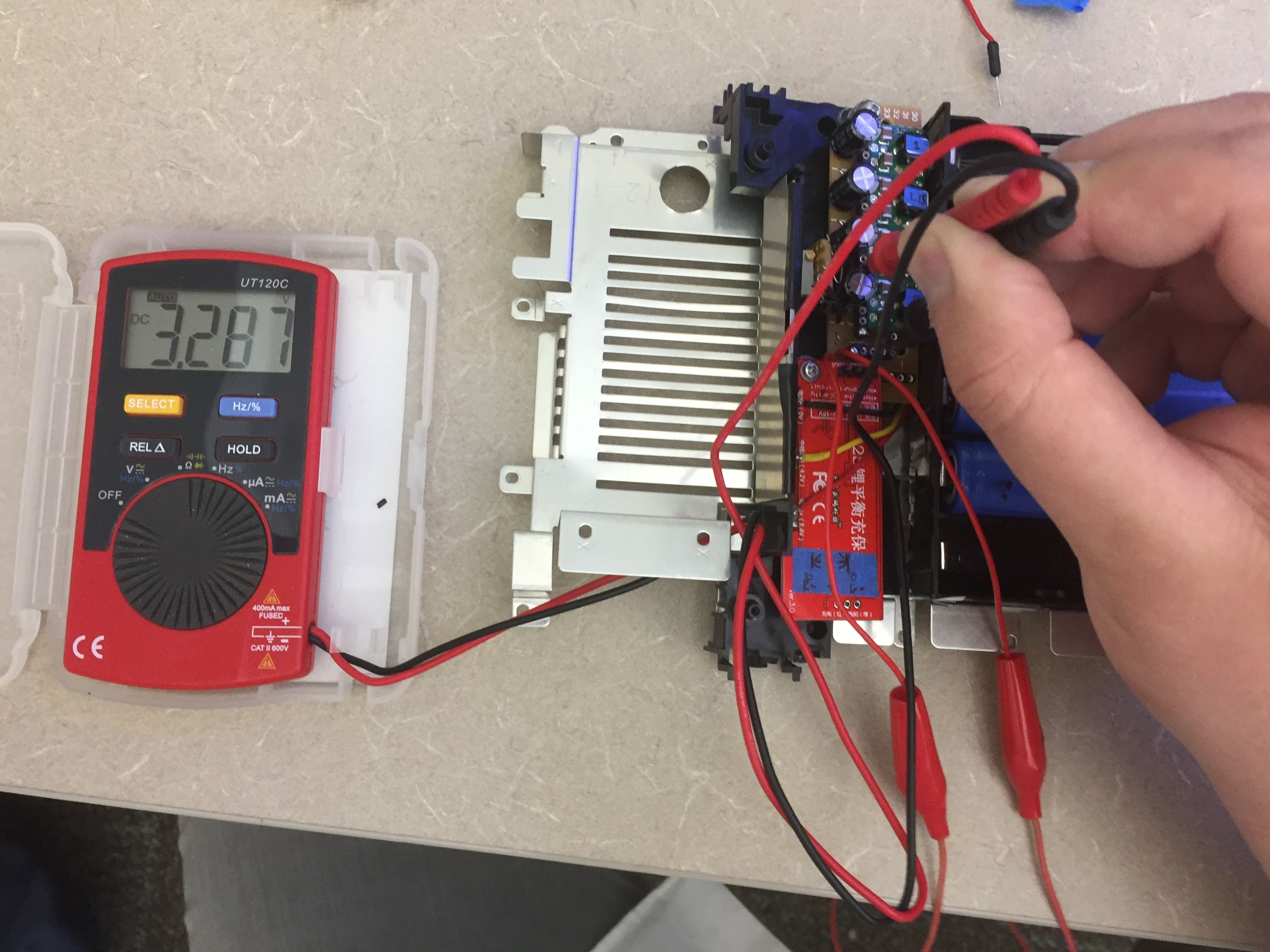

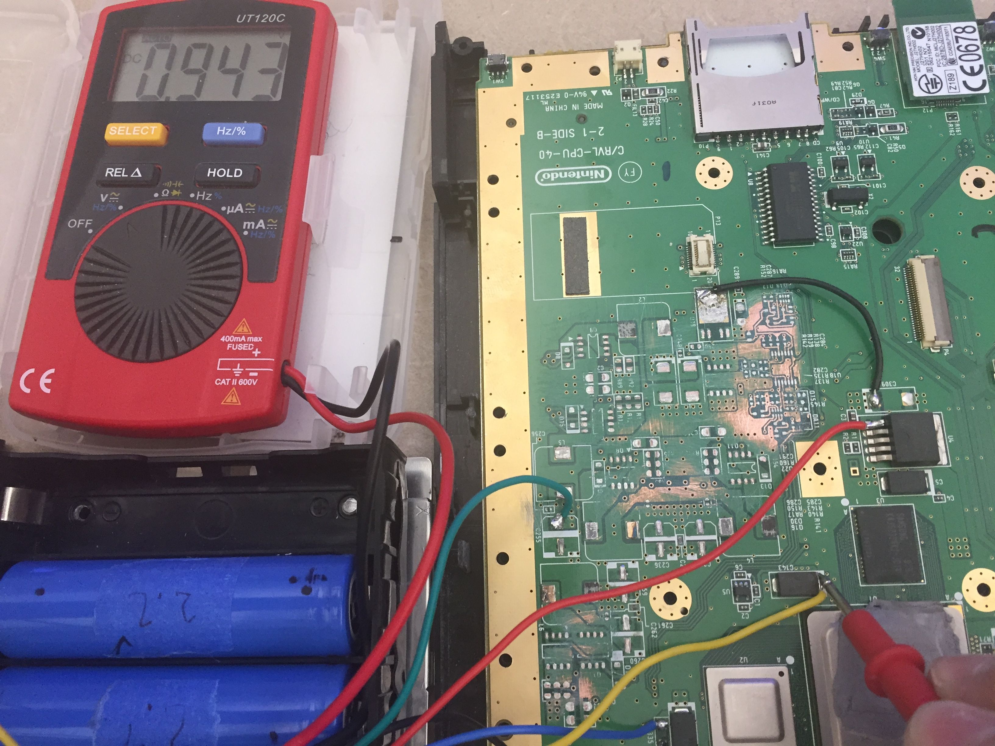

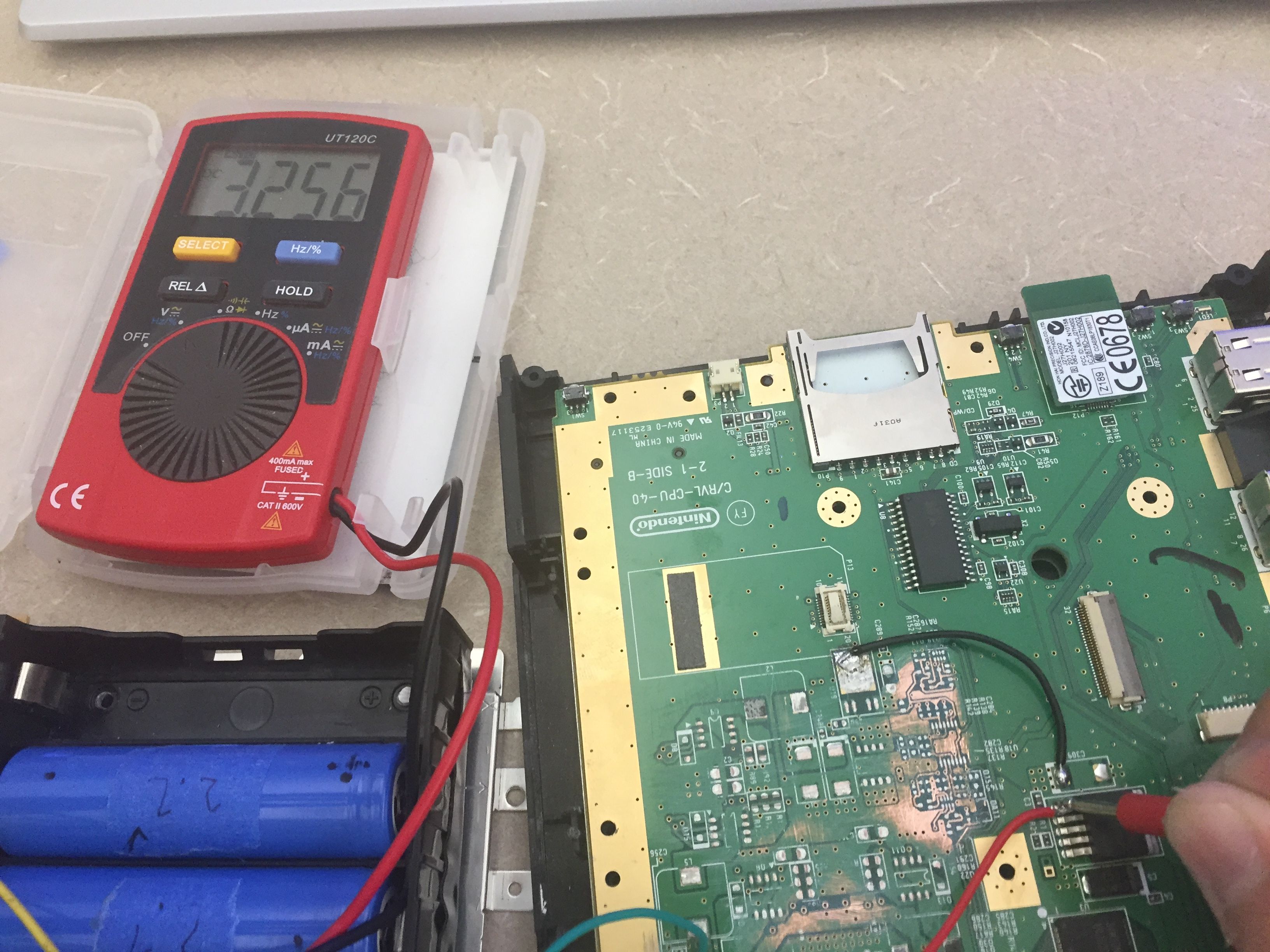

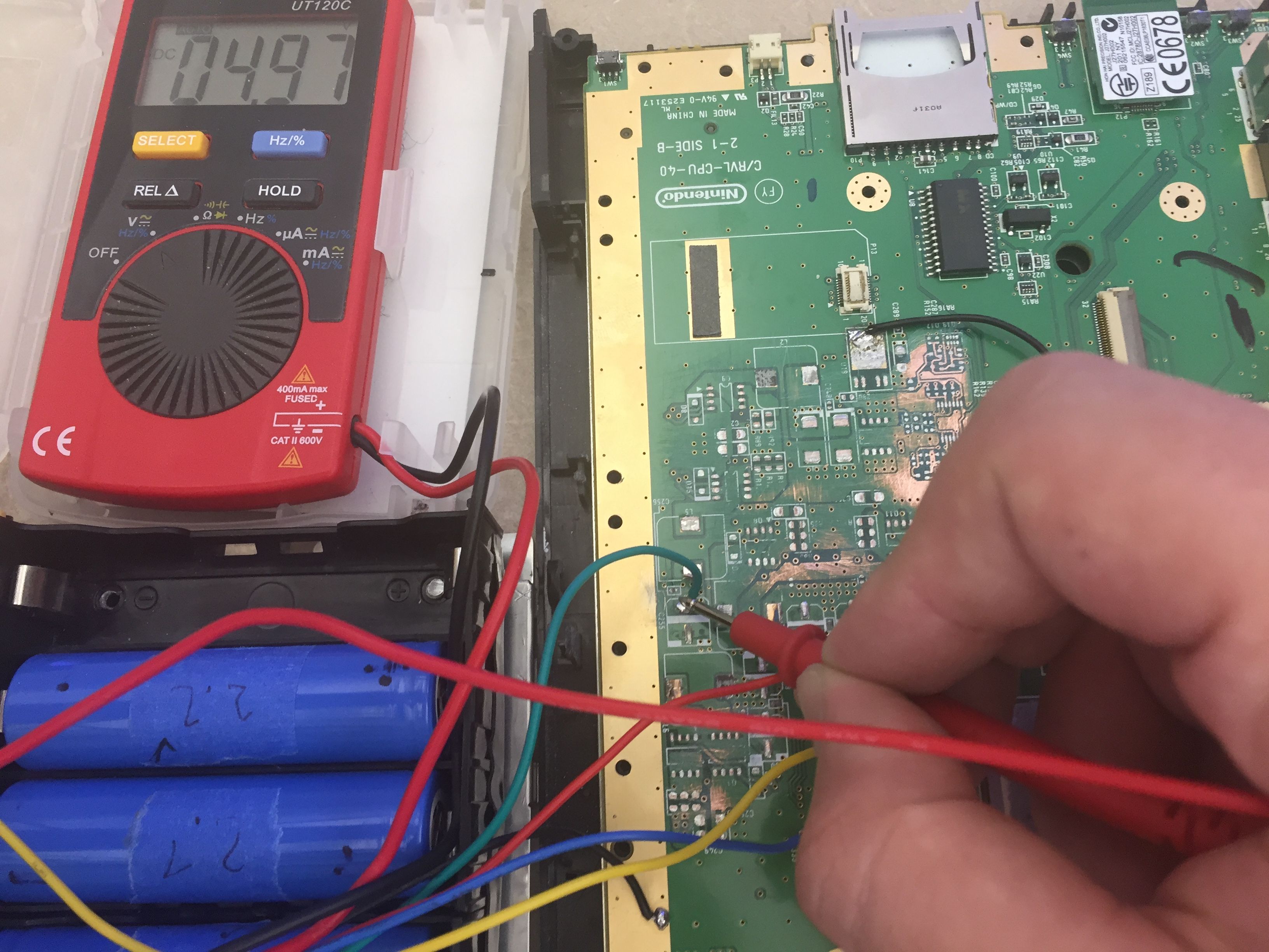

I also have pictures of me measuring my regulators (I saw somewhere on here that it was okay if the voltages were a tiny bit lower, but I do not know by how much)

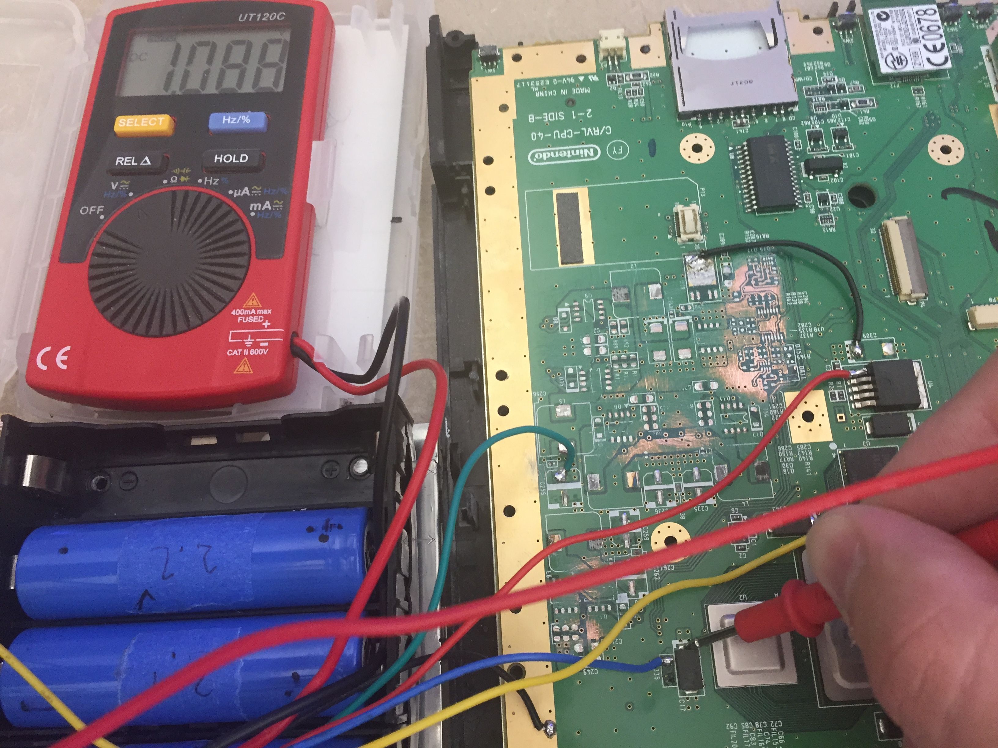

and then my measurements once the regulators are connected to the motherboard. This time the 3.3v line is a lot closer to what it seems like it should be. however, some of the others look a tiny bit lower (notably the 1.15v line).

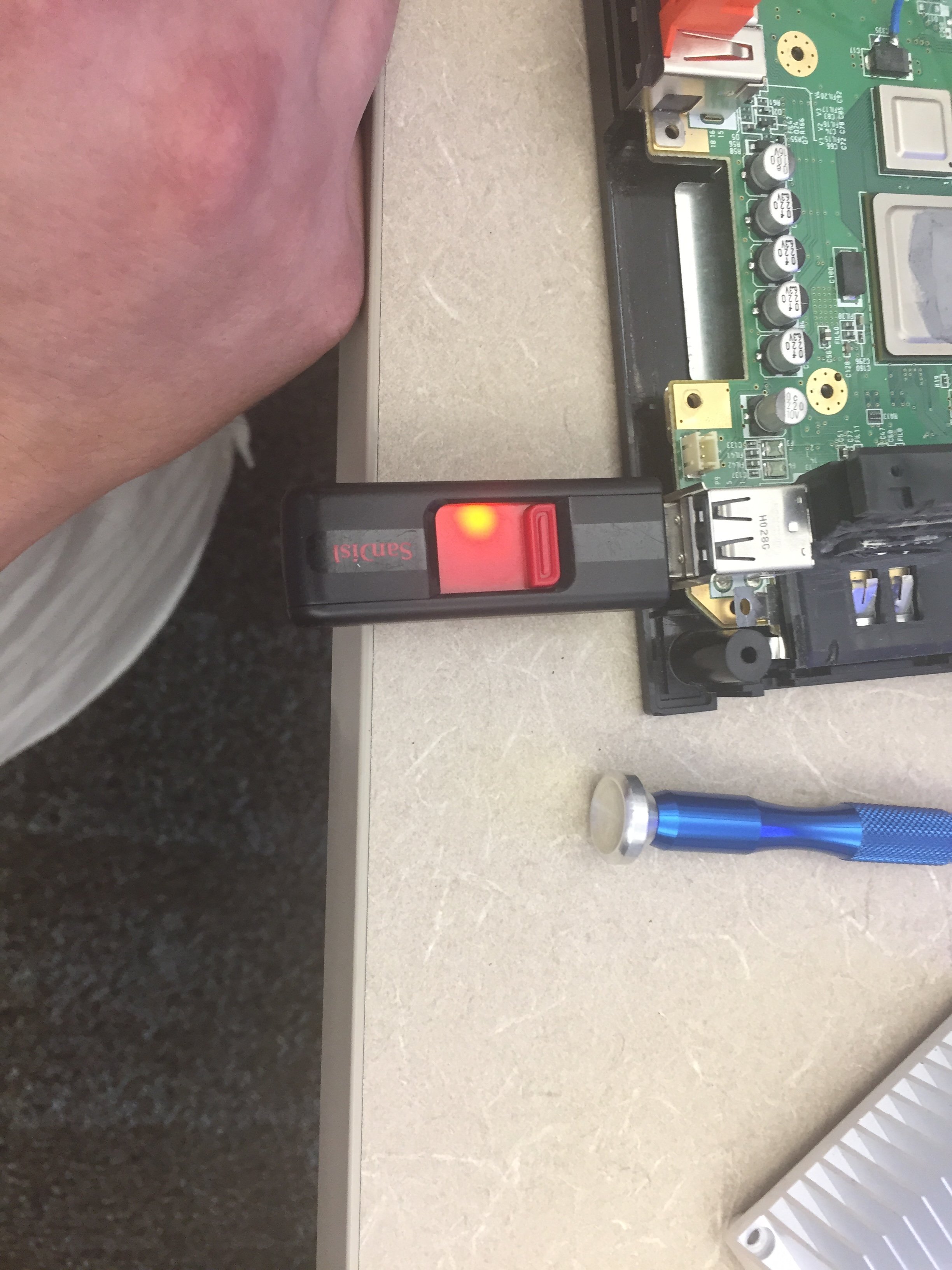

Also, below is the picture of my usb drive lighting up to show that I am getting 5v to the usb ports

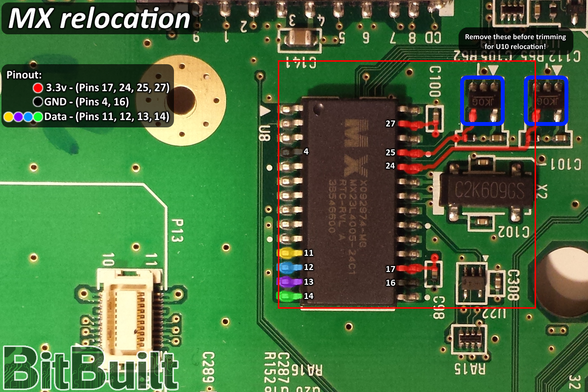

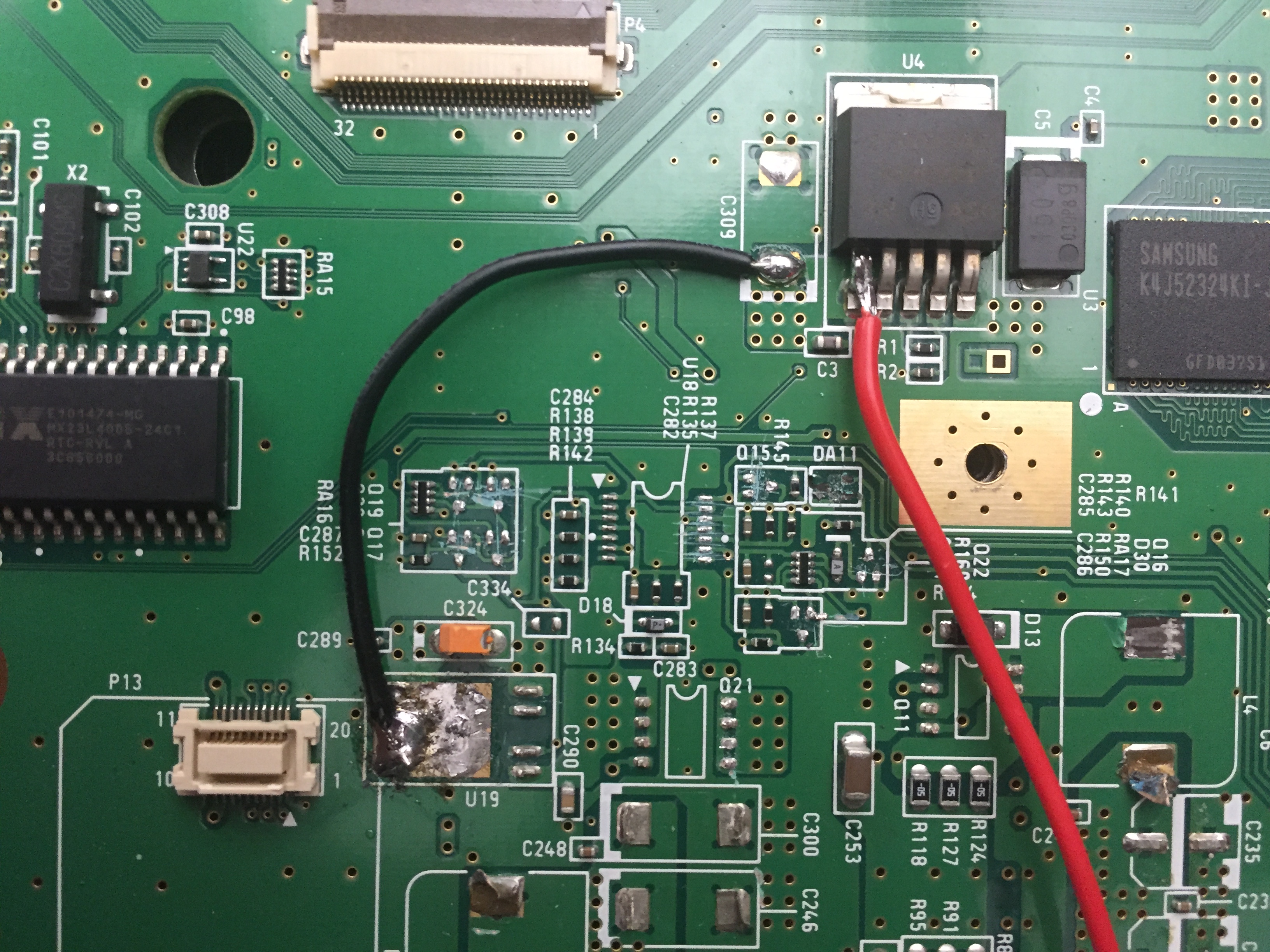

That made me think that something with the MX Chip or Standby 3.3v line was causing issues. I tried just connecting the 3.3v standby line and regular 3.3v line with a wire, but that caused my board to not boot at all.
My next step was lifting all of the 3.3v pins on the MX Chip. (you can tell which ones in the picture below) At this point the wii would do the laggy/crashing boot and the power button fix wouldn’t work (makes sense since the MX chip was getting no power.
My holy grail moment was then connecting the 3.3v custom regulator to where I jumpered the U9 pins. I know this spot needs to have the 3.3v and it usually gets it from the standby line but after this, I was able to have the console boot up normally! At this point I was so happy to finally have my untrimmed board boot without having to take off all of onboard regulation circuitry and still use the custom regulators!
I am not sure if this will work if U9 was still there, maybe someone else can try it out and confirm.

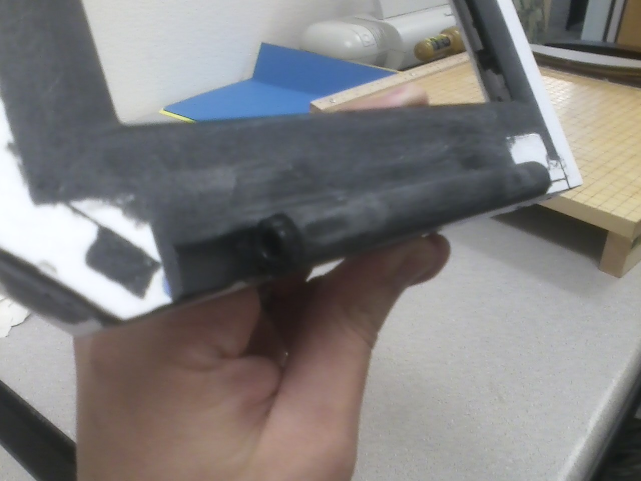

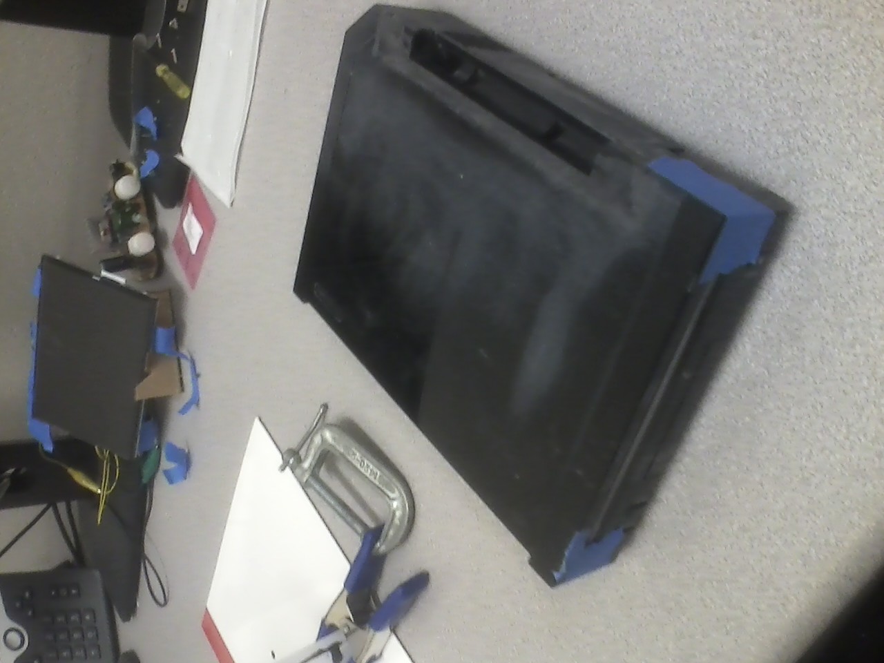

Right now I am mainly working on the laptop hinge/screen for this! Since I had 2 dead wii cases, I wanted to try and be thrifty and use those cases as the top part of the laptop. After a lot of chopping and frankencasing, I have the top part slimmed down, added the hinge mechanism from an old portable dvd player to both the lid and the body and put in the screen bezel for the portable dvd player screen. I found a secondary monitor that only required composite, 5v and ground and had a tiny driver board so I have been happy with it. Below are some of the pictures. As you can see I have a lot of sanding to still do hahaha
If I do this again, I will probably try and create some type of laser cut or 3d printed lid that will screw onto the top part of the wii so that you don't have to modify the main wii casing with all the components in it.
