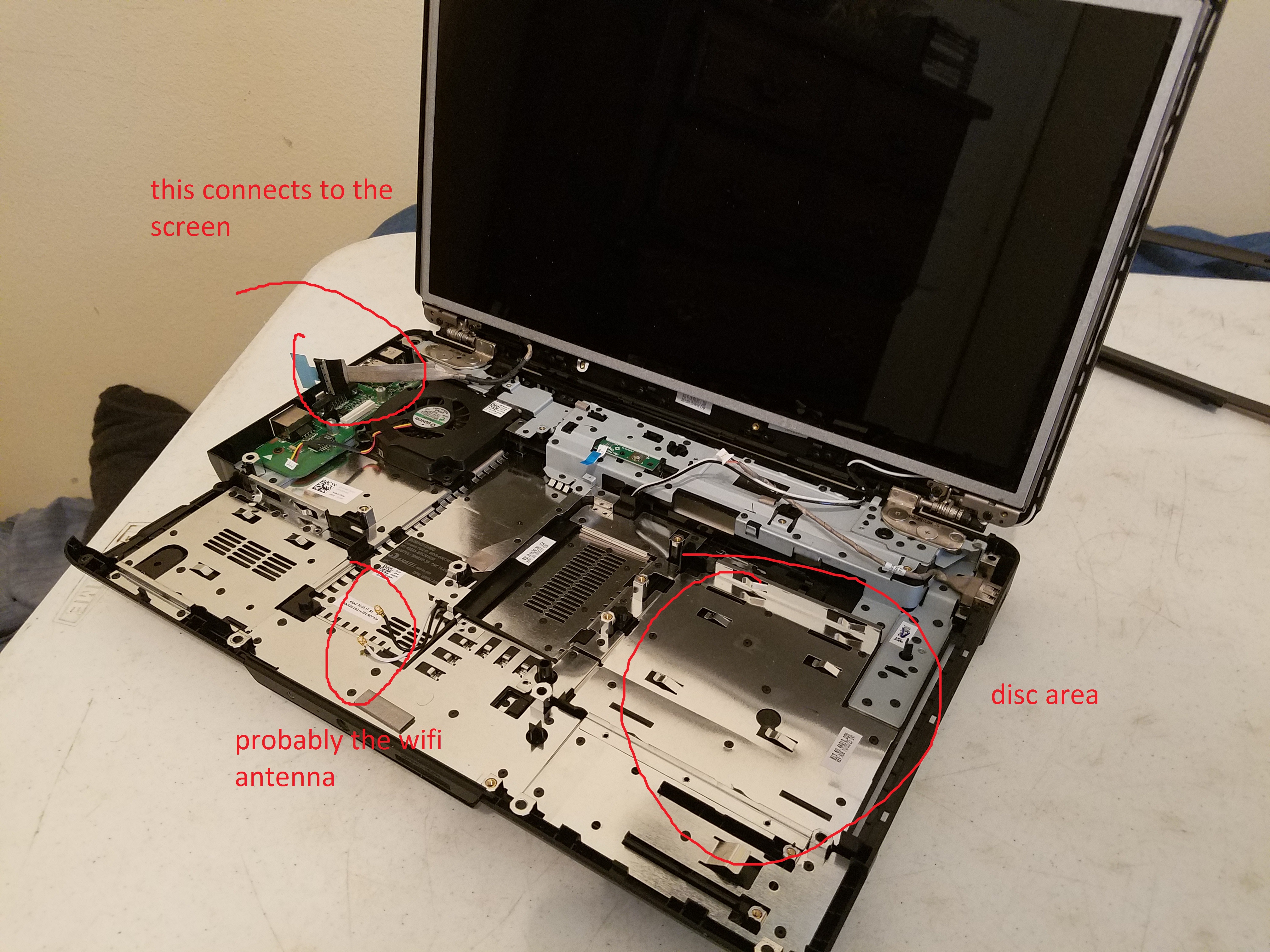

Good choice with the laptop, it looks like it will be thick enough to easily house all the components, and you can probably even stick a decently sized battery in it as well. Assuming the screen, battery, speakers, or hard drive still work, you can probably re-use them with minimal effort. If the laptop has wifi, you may also be able to re-use the antennas in the screen with the Wii's wifi board to get better range. It may also be possible to re-use the original heatsink and fan that was on the laptop's processor.
All in all, solid build plan, can't wait to see more!
Gutted the laptop today, I officially hate screws now. I removed everything but the fan that went above the heatsink and a few ports next to it (VGA, 2 USB, Ethernet). I'm not quite sure yet what I'm looking for in terms of the LCD connector but it looks like it was already fed through the casing to the motherboard. I would have liked to include a place for the Wii's disc drive but I'm not sure if that's the way to go anymore. I know for sure I will need places for GC controller input. Another concern is the place where the battery connects to the laptop. It appeared to hook directly into the motherboard and considering the battery is part of the case, I was wondering how exactly I might go about modifying it to work with my system. Probably all I'll be doing today until I find out more, will keep posting updates.

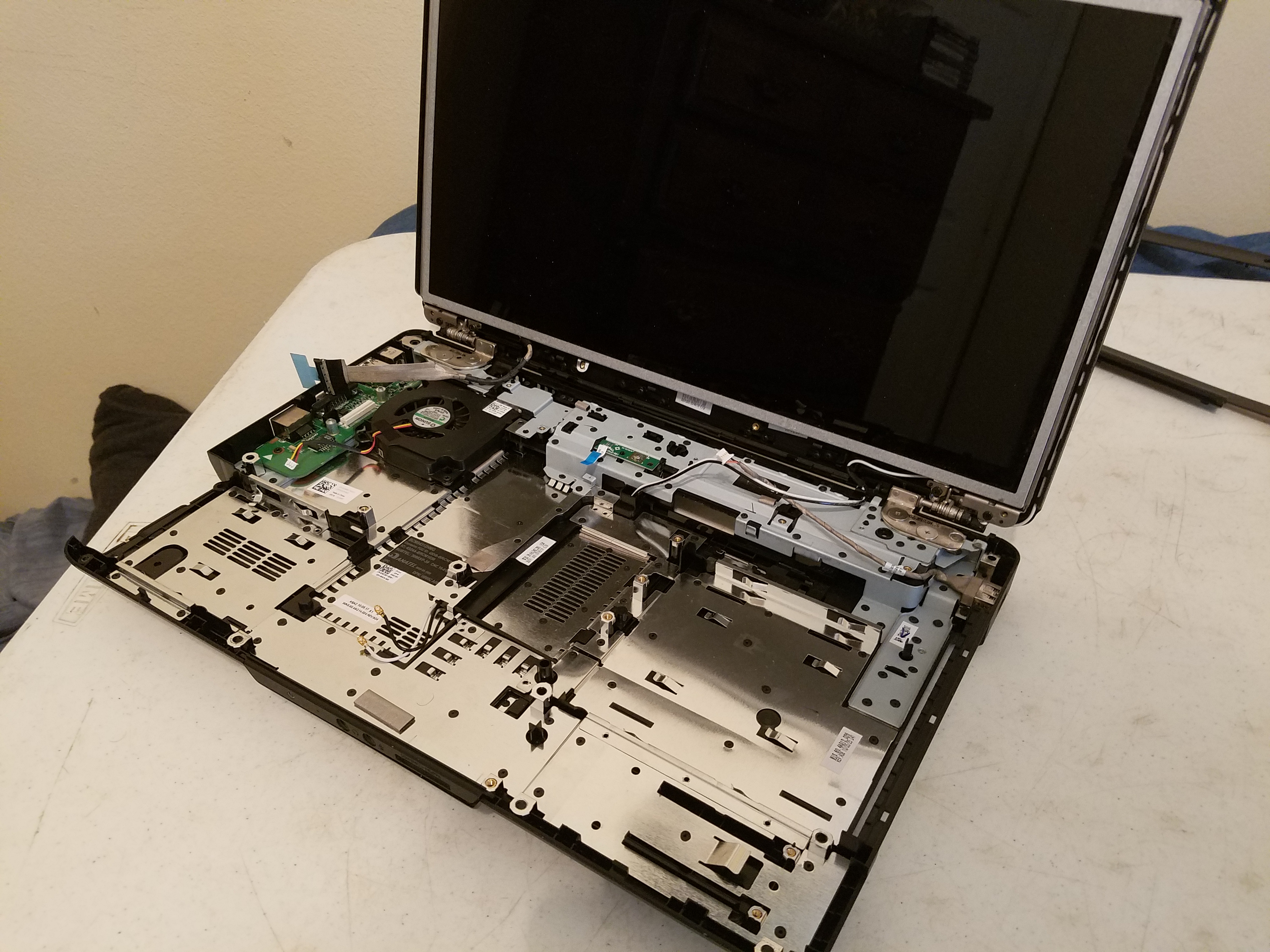

So the board for the screen came in today.
EDIT: Its probably worth mentioning I have no idea what to do from here.

The blue cable that came with your board that plugs in to the 40-pin connector goes to the connector on the back of your LCD. The cable I got with mine was too short, so I had to order an extension. I can't say whether or not you will need one, but if you have any doubt as to whether or not it will work, buy an extension. Here's the one I got: http://www.ebay.com/itm/170897391959
Test what you've got, make sure everything works, and start planning on where you're going to put all your boards. Make sure to leave extra space for wires, and batteries if you plan on using ones besisdes the one that came with the laptop.
