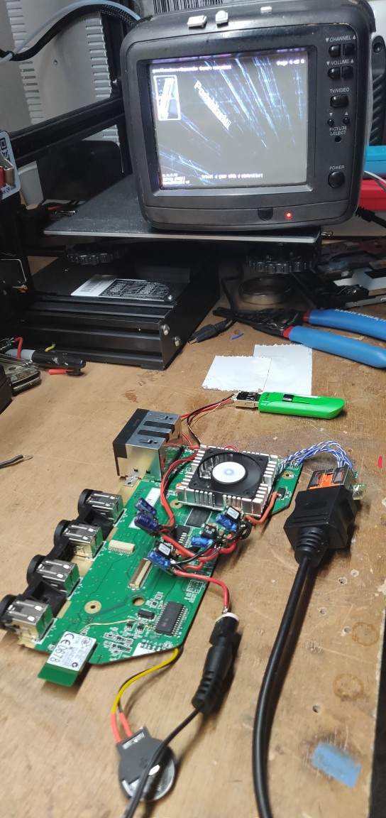

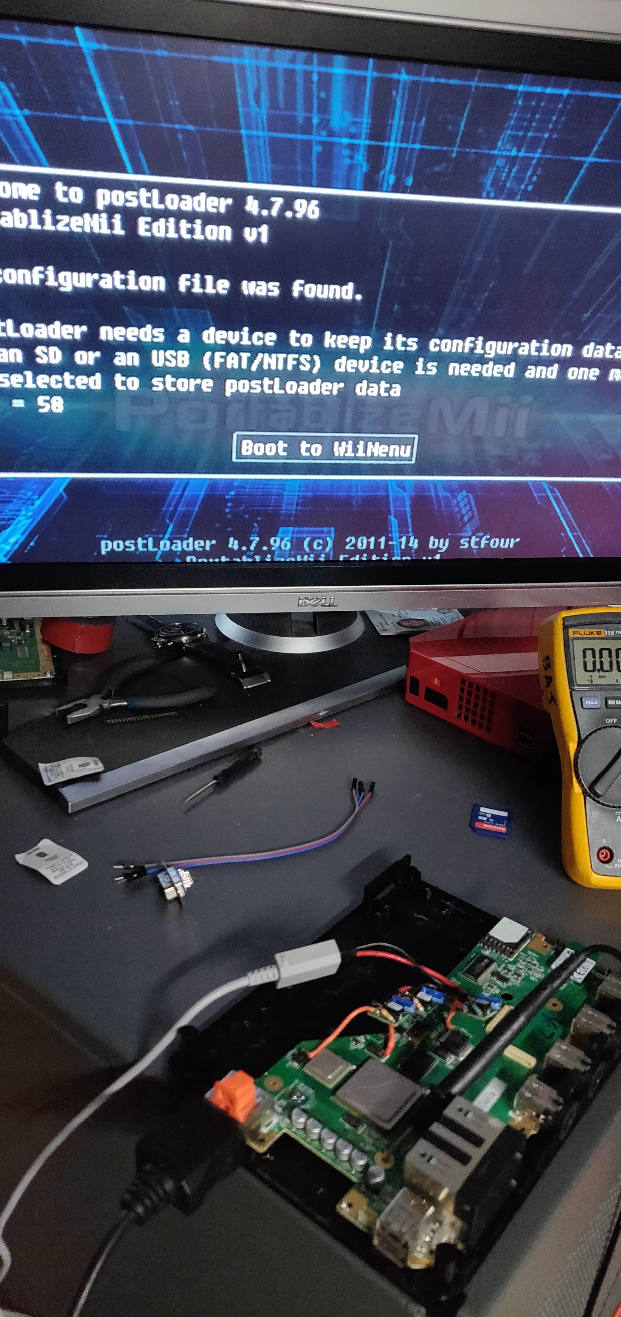

I have returned from a 2 year slumber! I am reviving this project, as I've been re-inspired by how much Wii portablizing has progressed since I last was here.
New!

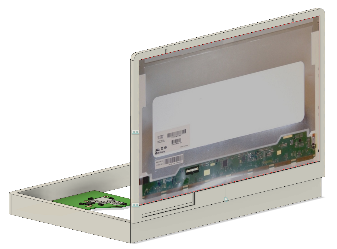

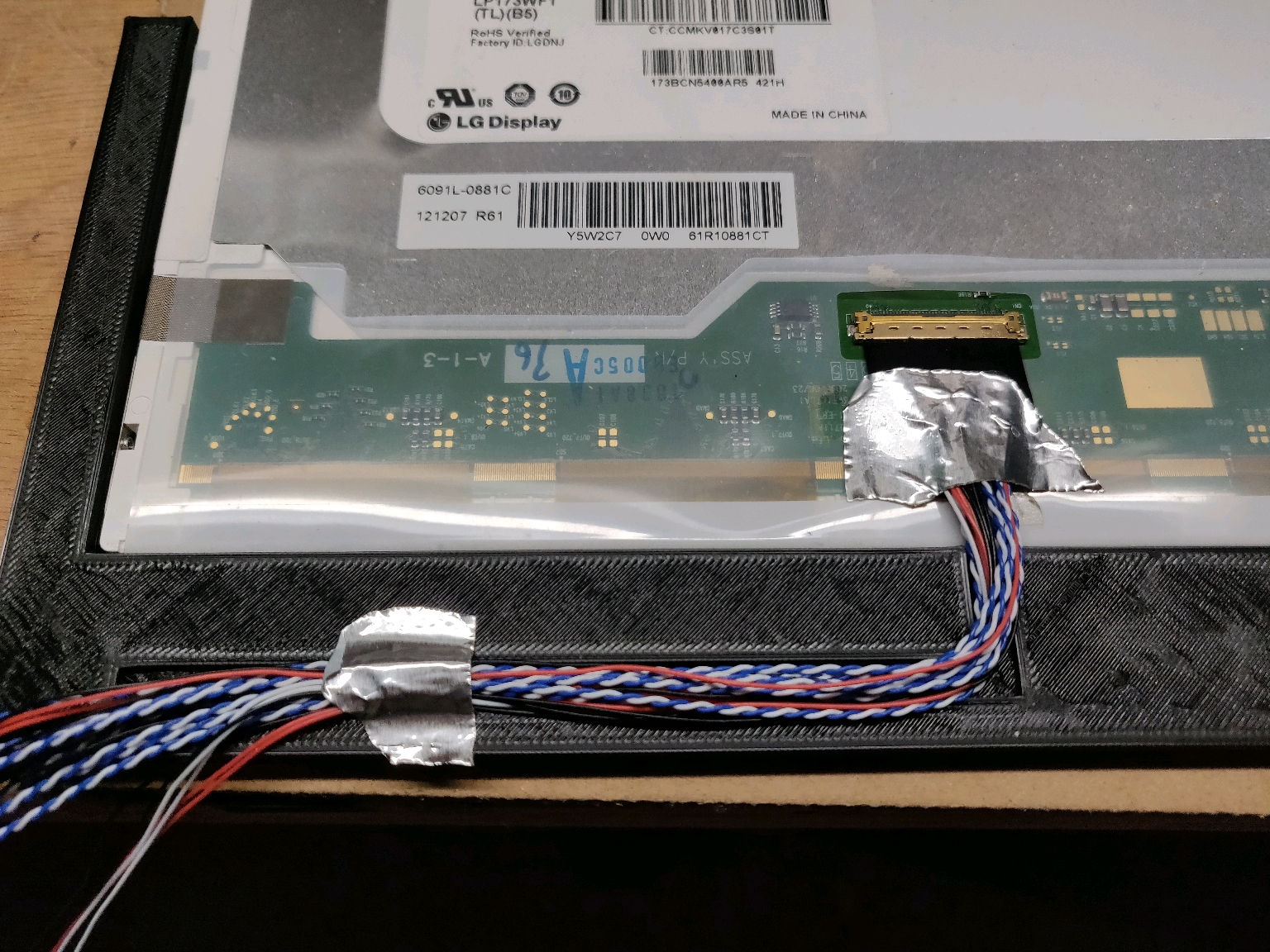

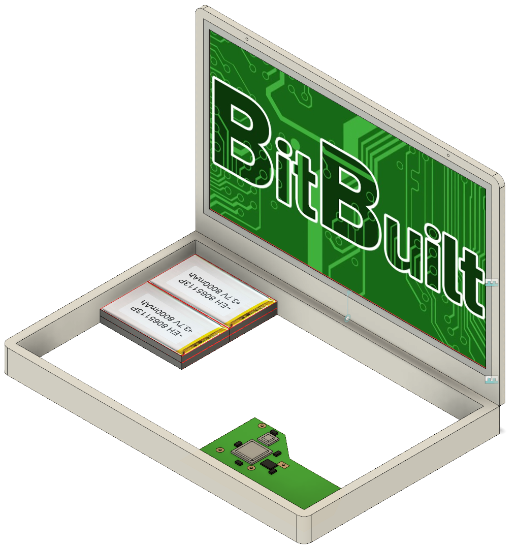

The LCD will also have a 3d printed bezel, and polycarbonate for the back.

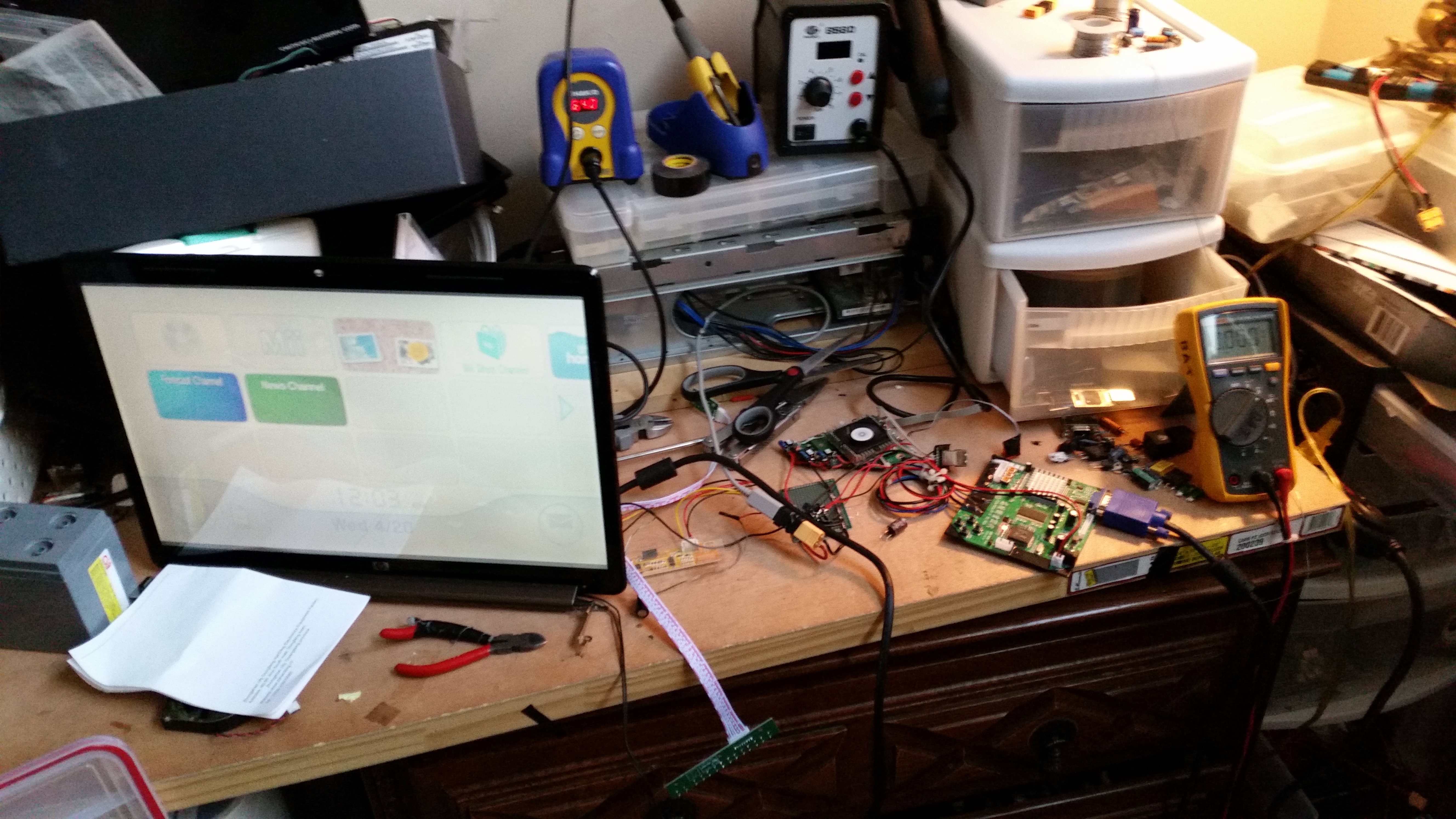

Picture time!
Update Video 1 - 11/10/18

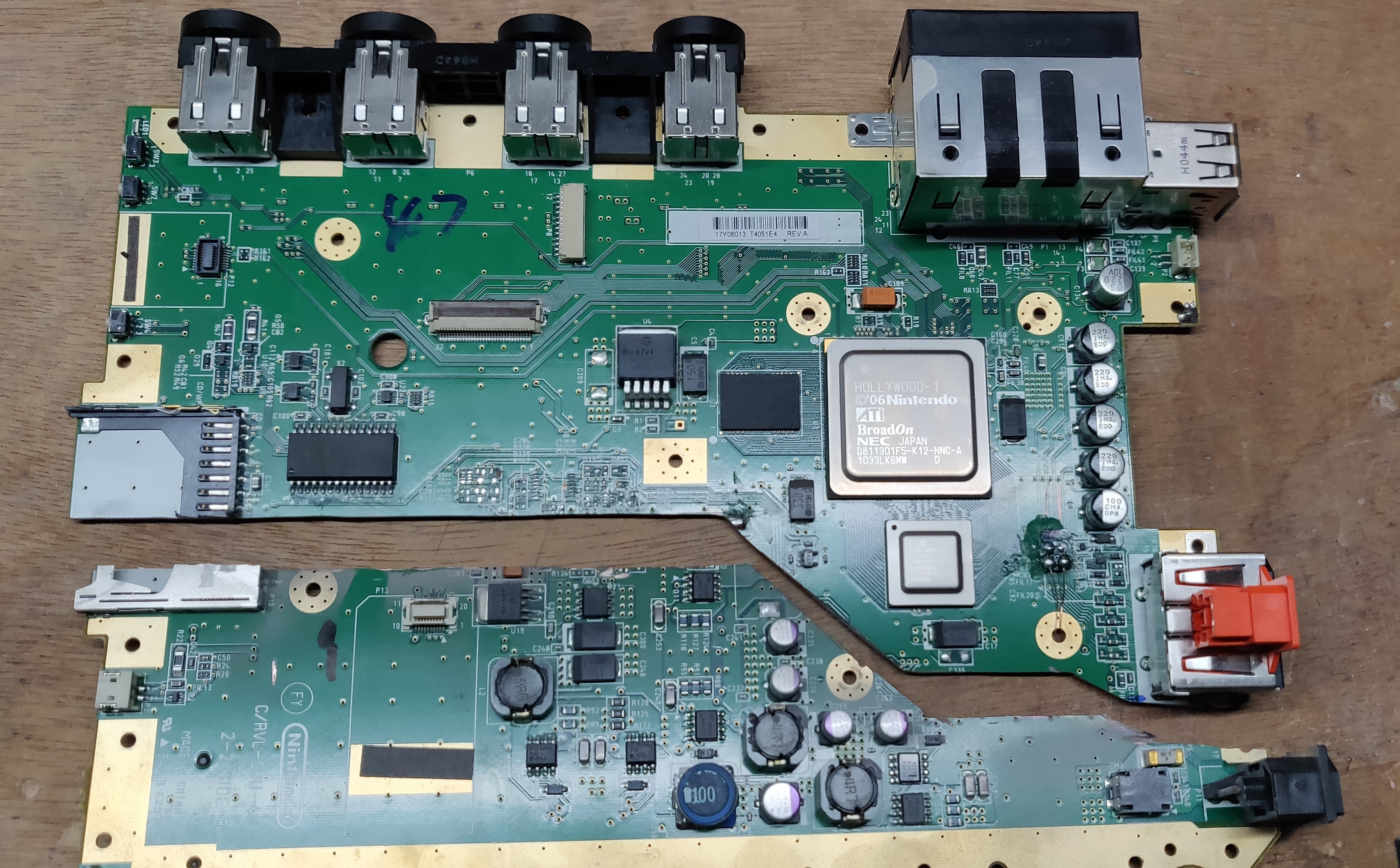

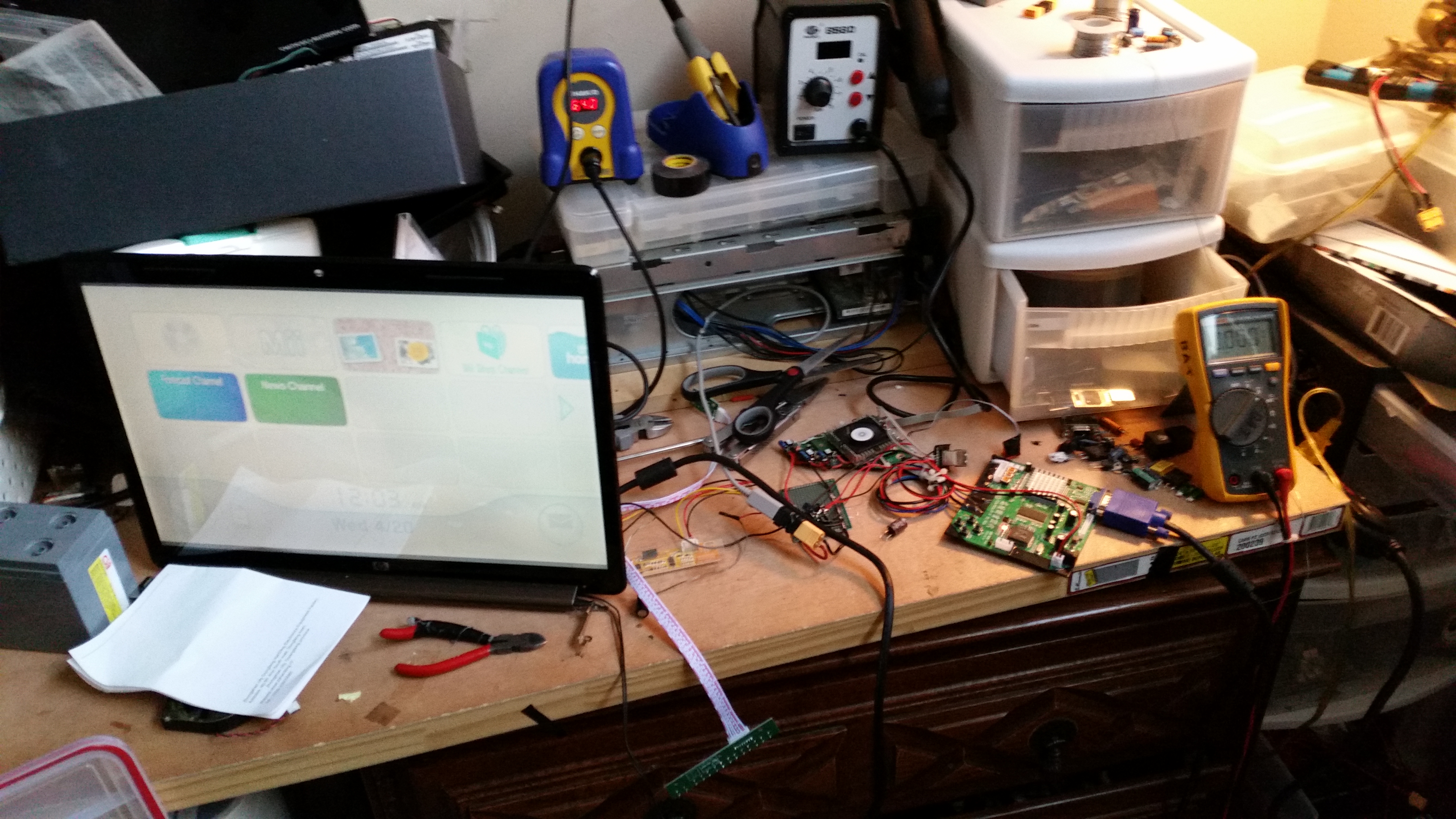

- 1920x1080 17.1in screen, now LED backlit!

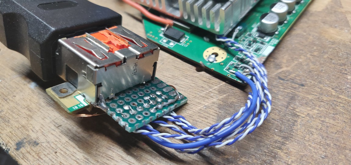

- Beautiful VGA output thanks to @Aurelio (no more YPbPr->VGA board!)

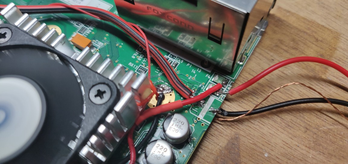

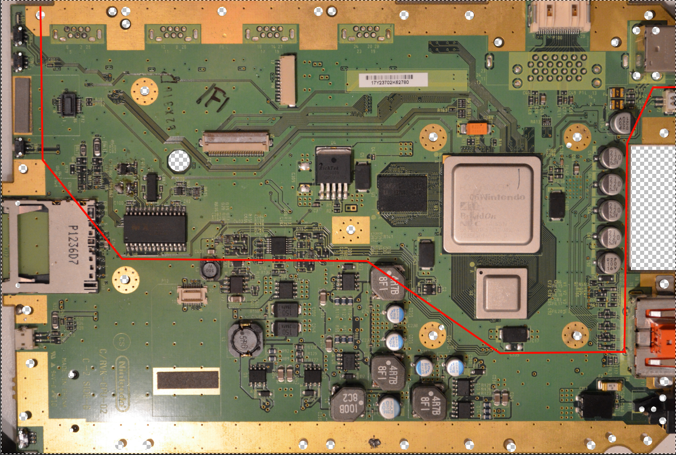

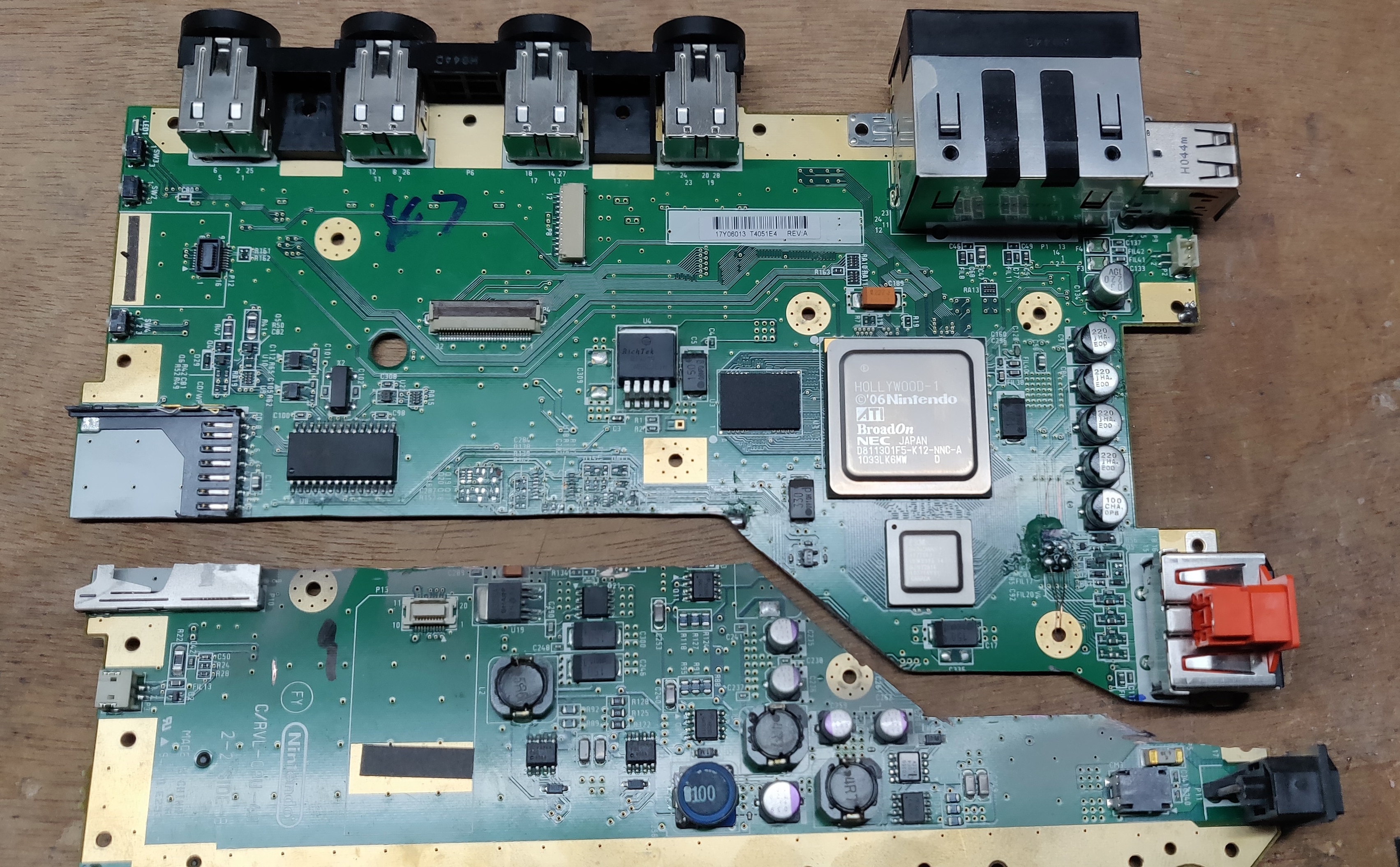

- Custom trim to reduce relocations and work (removed stock regs, SD)
Picture time!

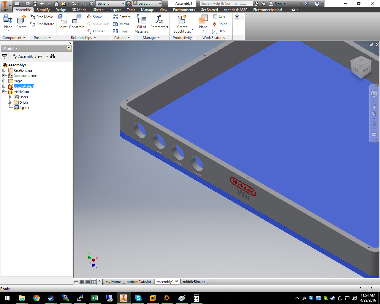

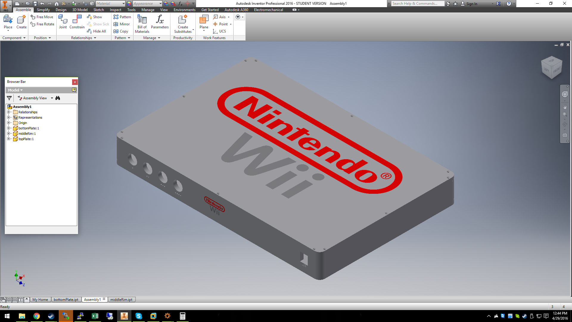

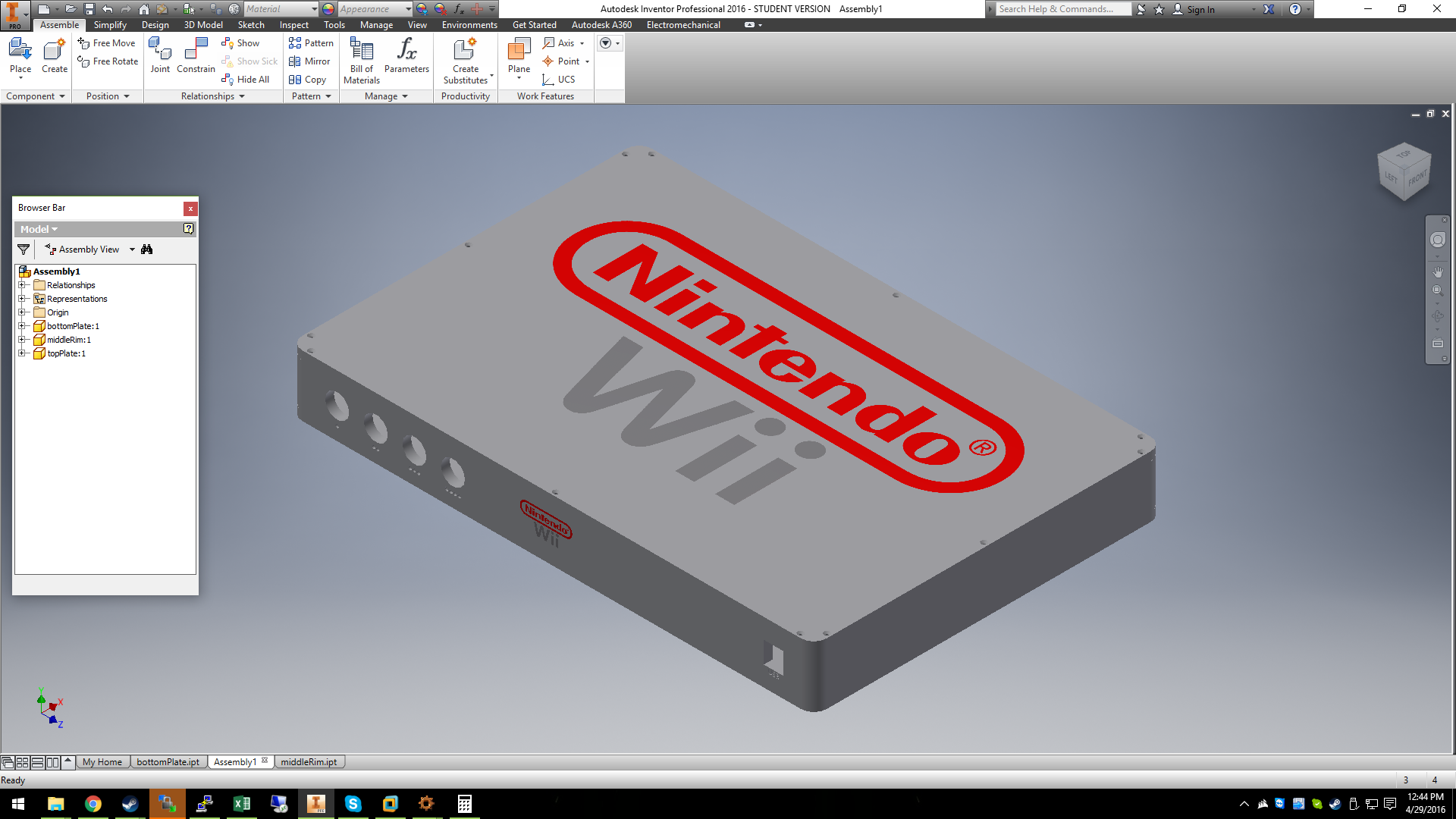

I've already begun using CAD to design the case. Here are some pictures.

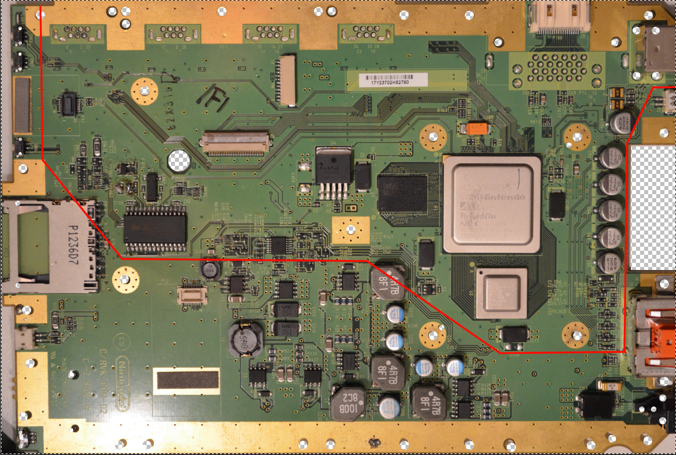

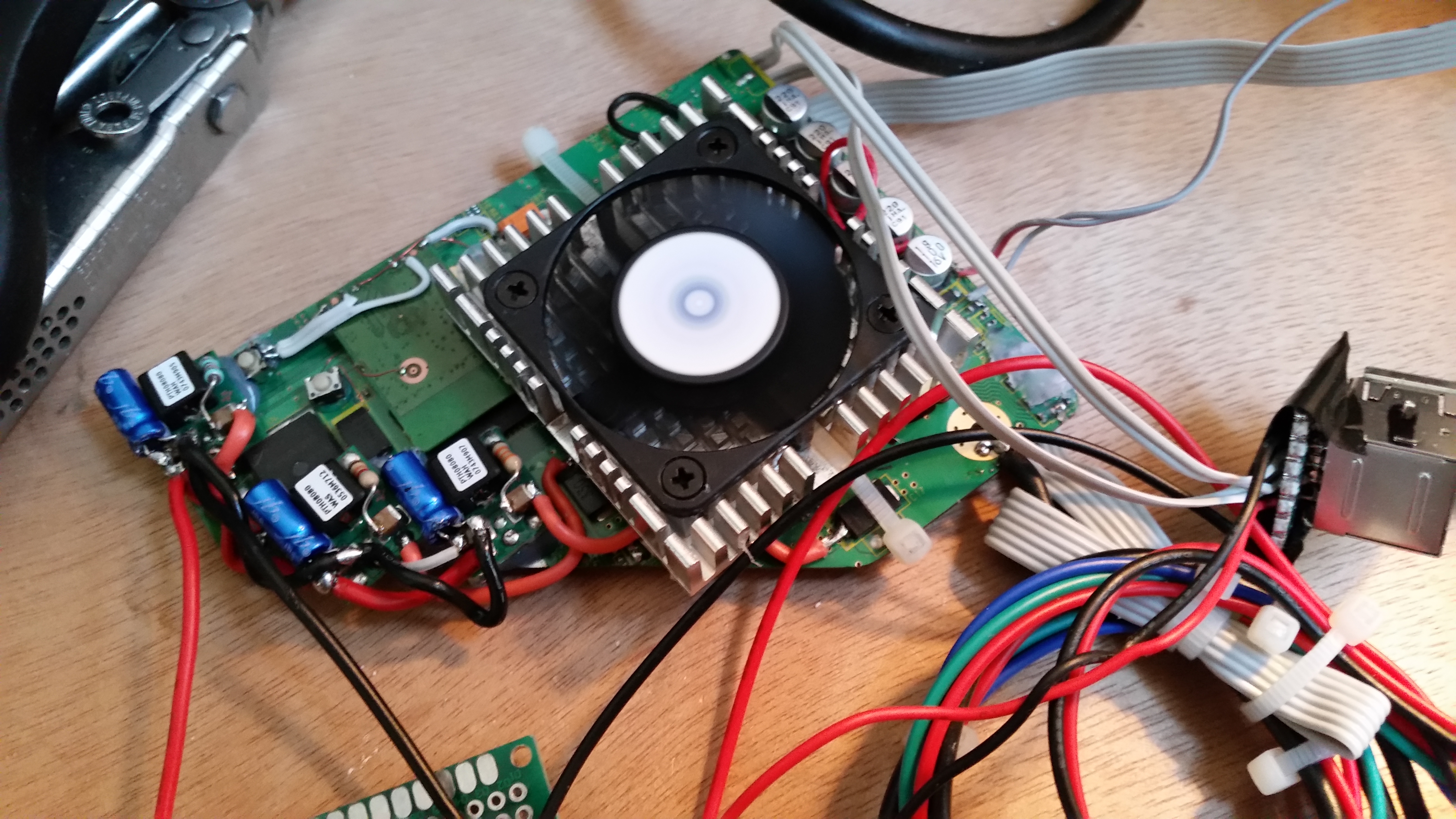

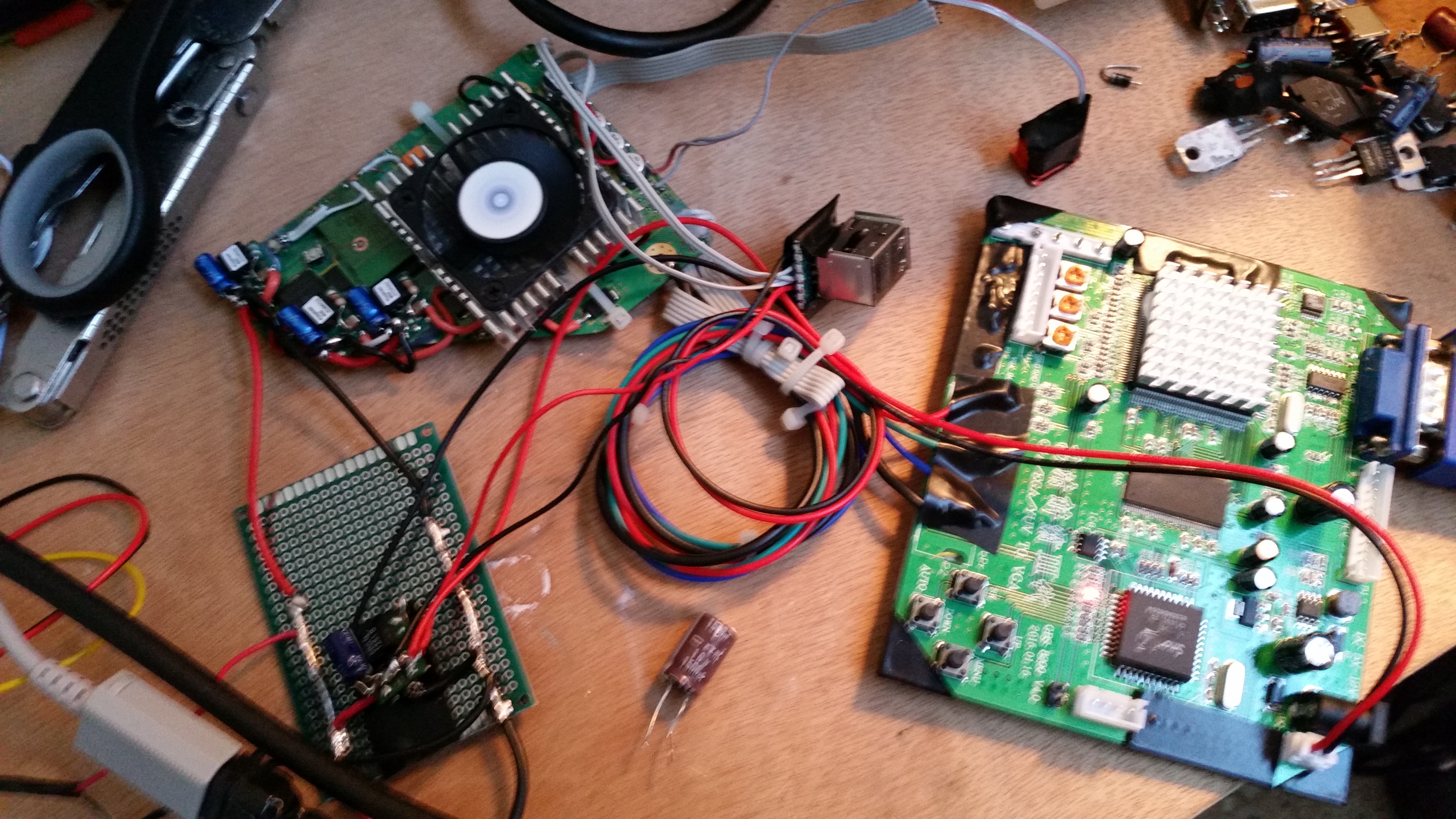

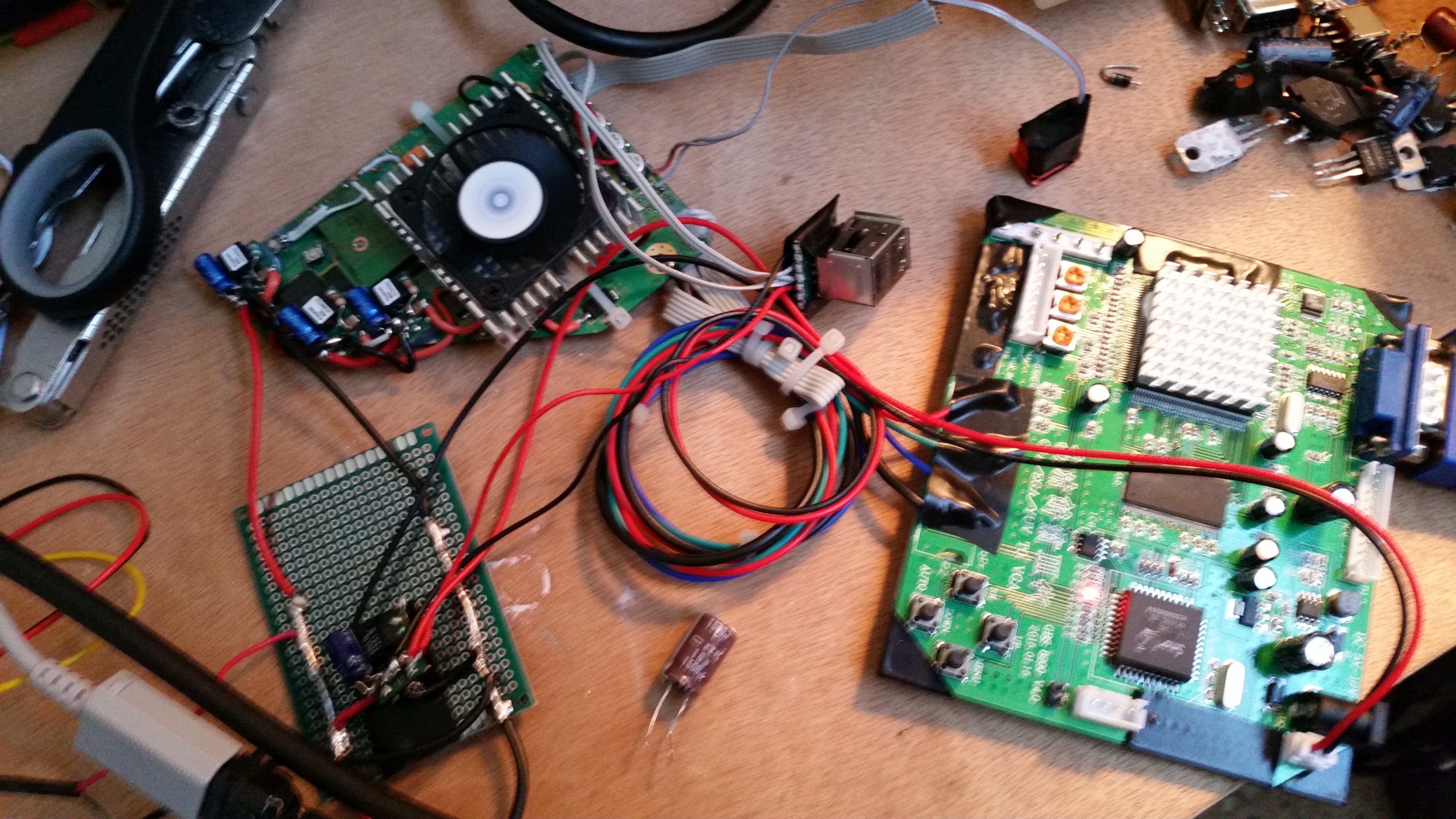

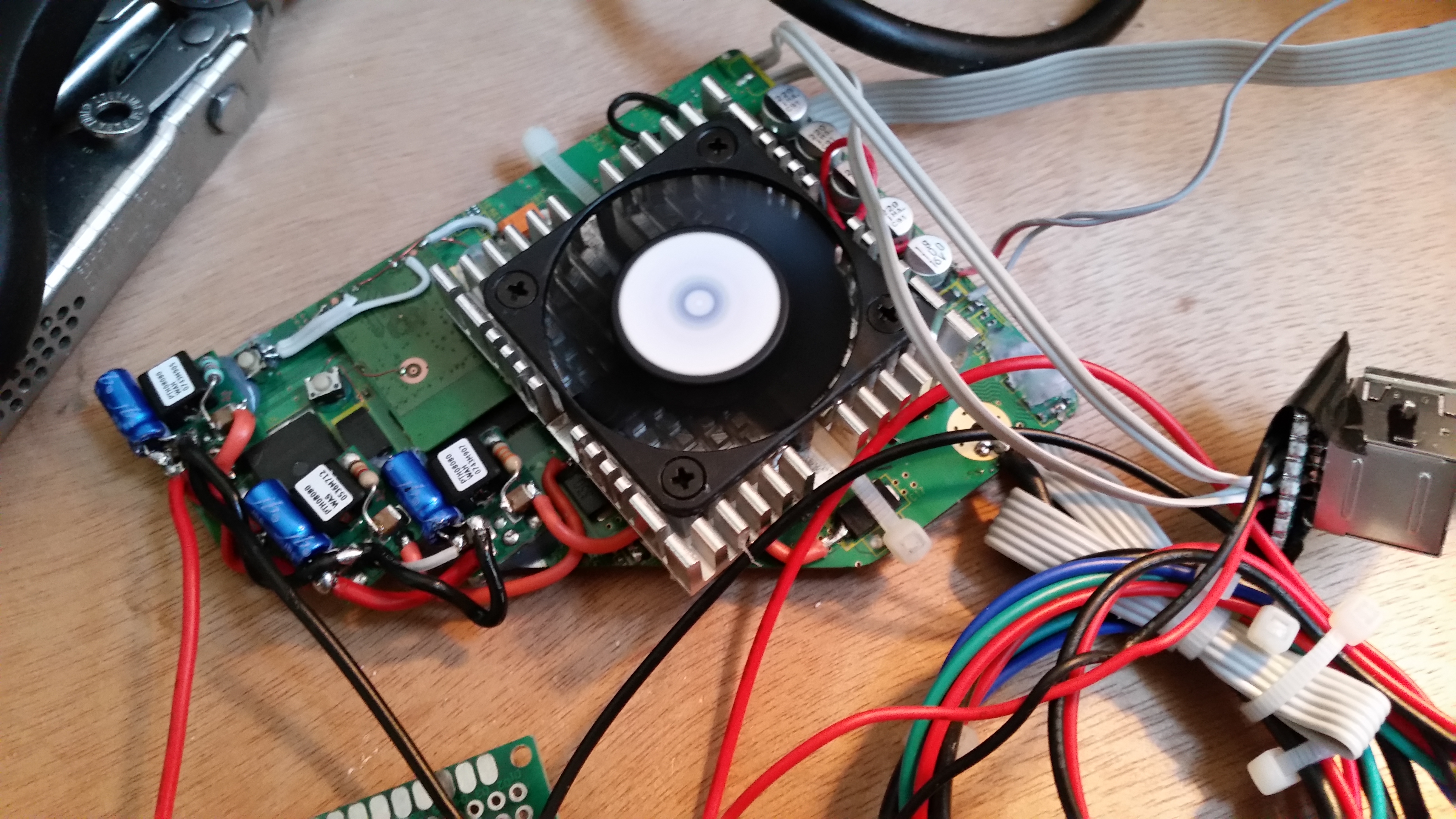

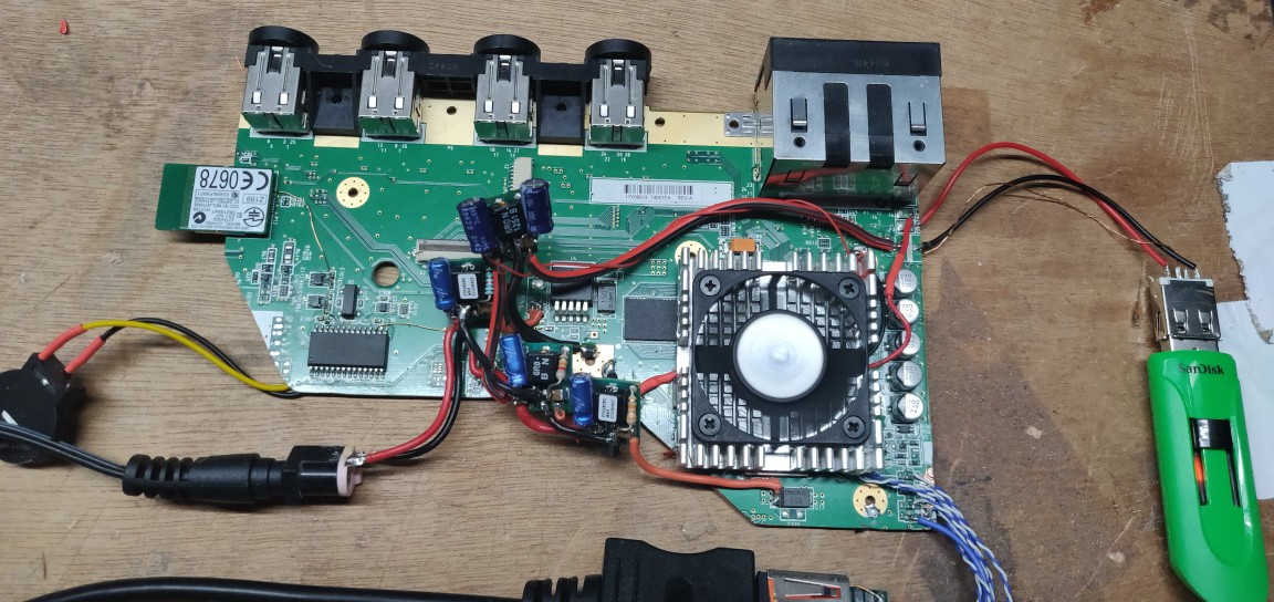

Here's some pics of the progress as of 5/20/16, along with the commissioned motherboard from @ShockSlayer.

Progress as of 5/24/16 is:
- Full GC Compatability
- Audio, Video fully working (using YPbPr->VGA converter)
- 12v and 5v regs working
- Able to run off of a test battery for 30 mins (it was a 4 cell series pack with old cells that had a low capacity, about 700mAh total pack capacity)
- Mockup case made of scrap wood and plastic, with screen mounted on hinge
- Extensive play testing (20+ hrs)

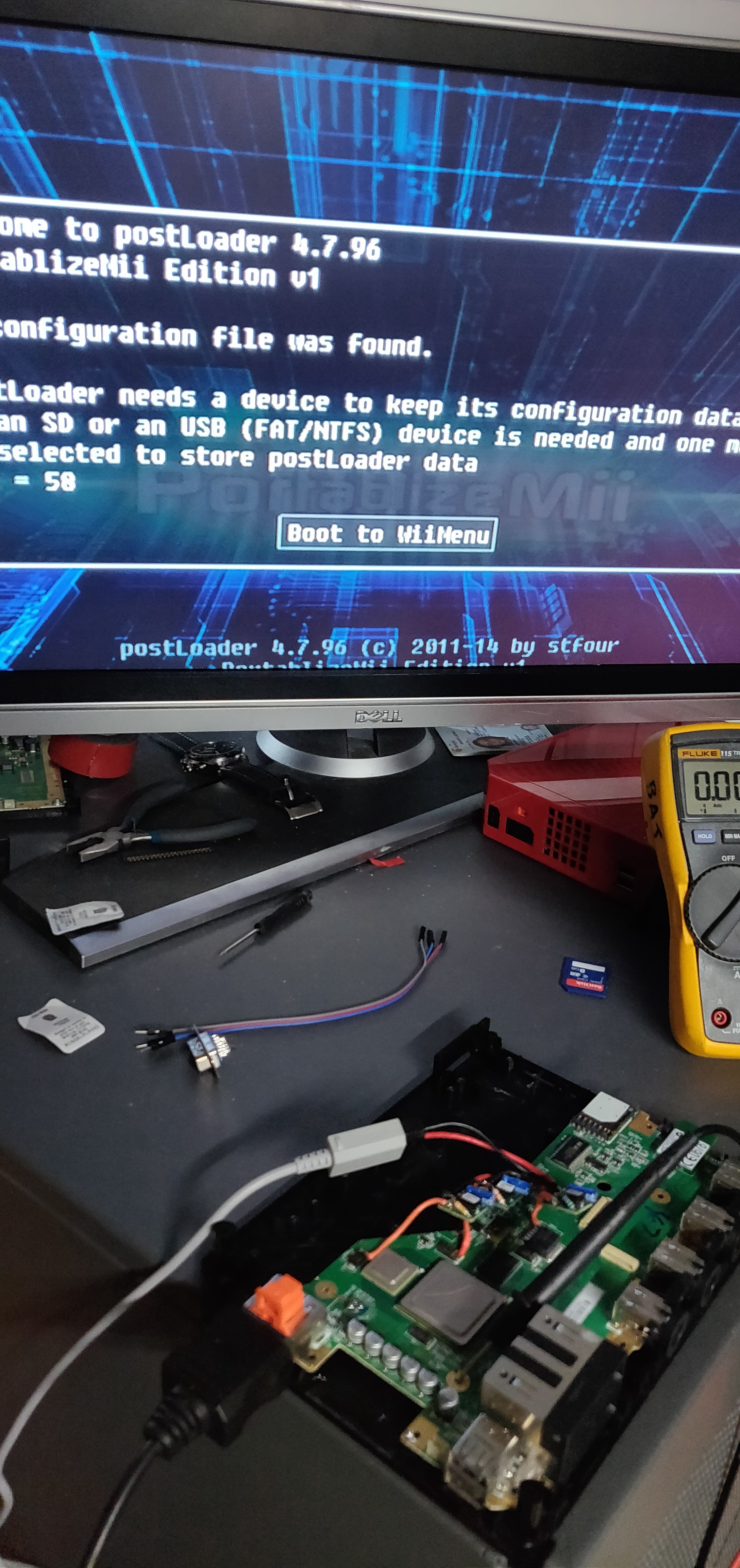

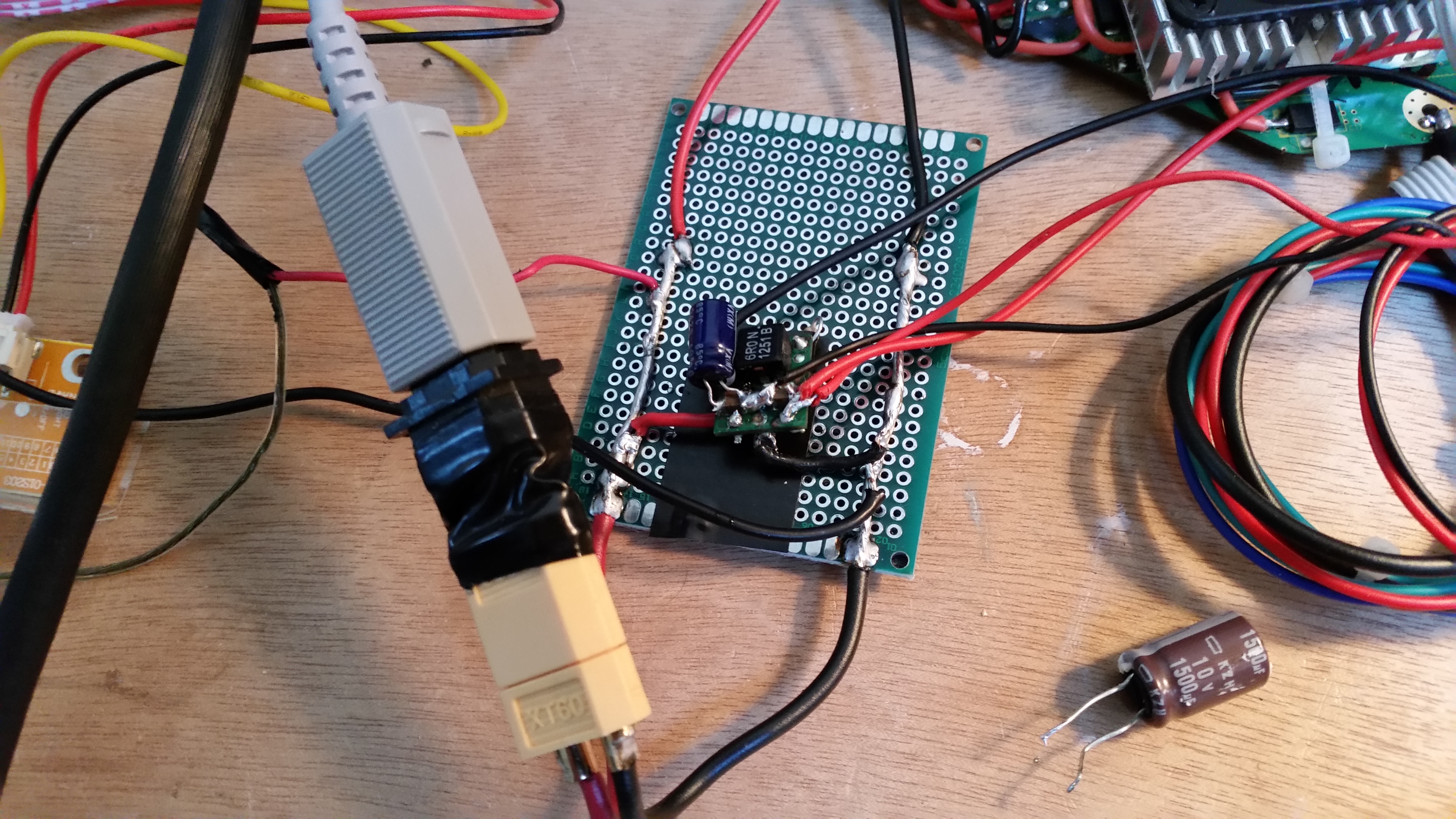

- PortablizeMii installed for full game compatability (along with emulators)
- Battery pack made from 3400mAh Panasonic cells (7.4v@6800mAh)
- LCD LVDS cable extended (causes almost unnoticable horiz. lines)

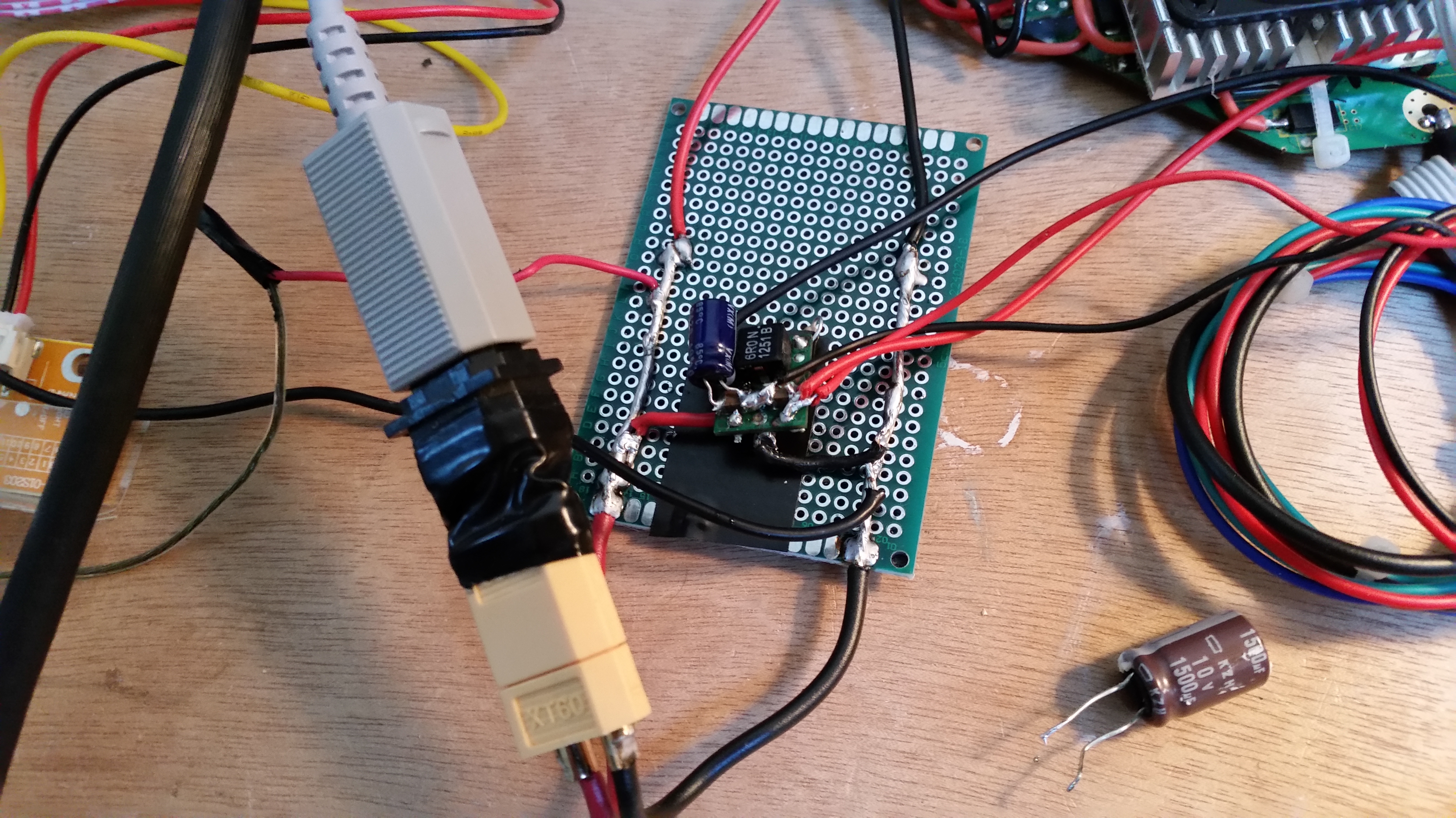

- BQ24172 Eval board ordered for charge and play (will trim it)
- Fixed USB stability issues
- Still in shitty wooden case
