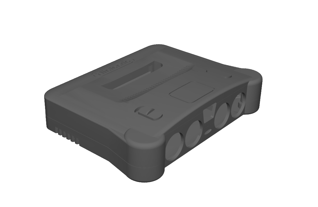

Rather than make a like-for-like smaller version of the N64 console I designed this mini console on how I feel Nintendo would have made it look if the N64 was smaller. I suppose you could call it "Cute-ify".
You can take a 3D look of the current WIP case here: Wesk's N64 Mini

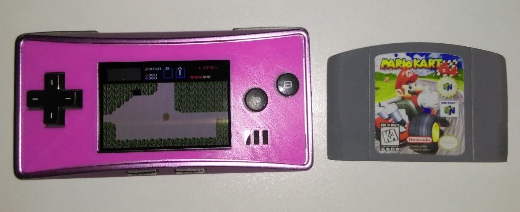

And here is an idea on the size of the cartridges:

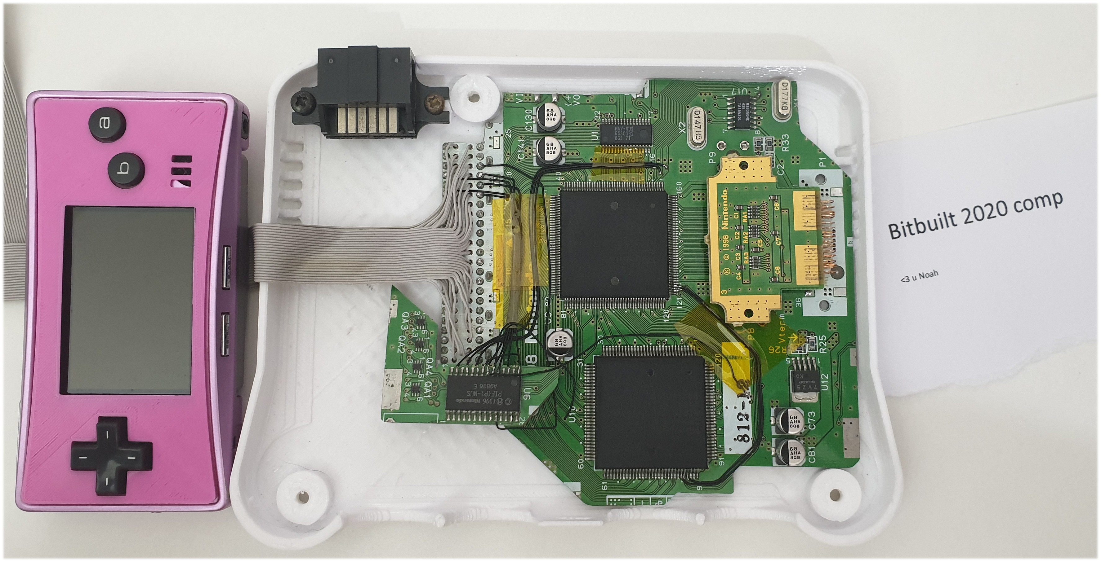

Board
= Trimmed ✔
Exp Pak = Rewired ✔
PIF = Relocated ✔
Cartridge port = Wired ✔
Case Fit = Needs slight adjustment ✘
I did run into an issue with attempting to wire the Exp Pak 1:1 as this variant is slightly different having only 35 pins and not 36 as it states. I detailed information here: https://bitbuilt.net/forums/index.php?threads/nus-rmc-10-expansion-pak-variant-pinout.3329/

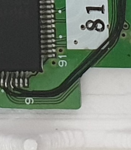

I also made a slight fuck-up with the main board trim as I went a little too far and severed 2 traces, I've run 2 wires in their place while trying to keep wire length as close to the original trace length as possible.
The case also required a little bit of tweaking, I've raised the height by about 5mm. This will allow for a bit more space for cooling, controller ports and to fit the Everdrive. Having a working cartridge port takes up a surprising amount of vertical space.

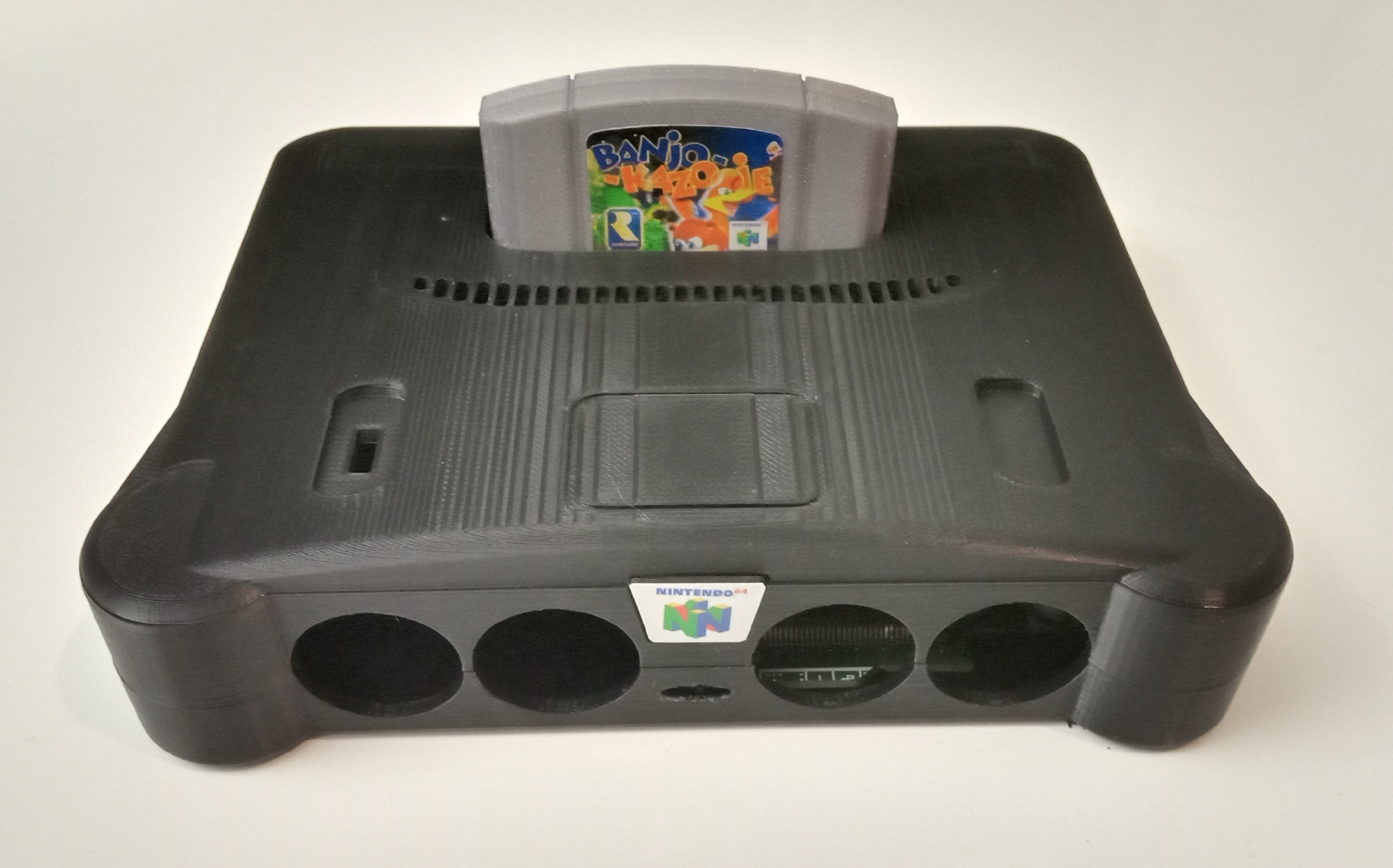

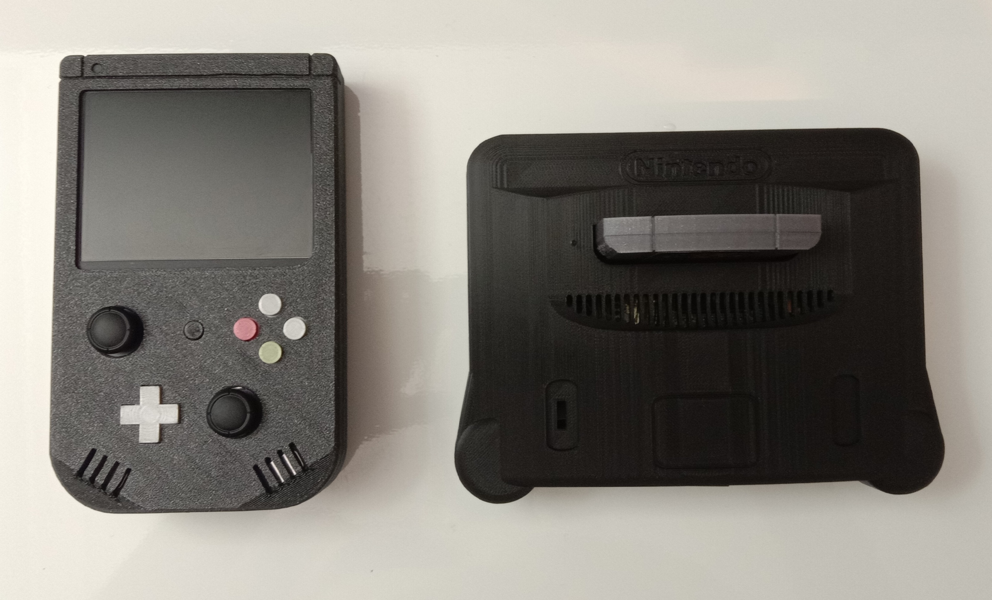

Quick update:
I have mad slight modifications to the overall design to make it more symmetrical from the top-down and made it ever so slightly taller.
Initial print and test fit are looking good.
Front:
Top + Gboy for scale:
This looks amazing, but the controller slots might be a hard fit, interested to see how this goes.
Surprisingly the controller ports have the most space out of almost everything, the tightest fit is going to be the heatsink and the Everdrive. I've been trimming more and more of the Everdrive PCB to make sure it fits, every millimeter counts.
