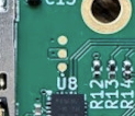

The Wii Power Strip supplies power to the Wii motherboards using a Molex Pico-Lock connector, and additionally has footprints to help relocate of a couple of capacitors which are typically removed when trimming a Wii.
Periphlex is a flex PCB which breaks out the Bluetooth, USB and GameCube controller data lines, as well as the power, shutdown, and reset GPIOs. These are then made available via a 14-pin FFC connector. This approach replaces 11 magnet wires with a single, removable ribbon cable.
On the back of the motherboard, I'm using two open-source boards designed by the very talented YveltalGriffin. fujiflex provides digital A/V output using GCVideo, and nandFlex relocates the Wii's NAND memory chip, to enable the tight trim.

    • Perform a wireless U10 relocation, test it still boots - you may wish to wire a magnet wire to the SHUTDOWN via first
    • Install fujiflex, and test digital A/V output works
