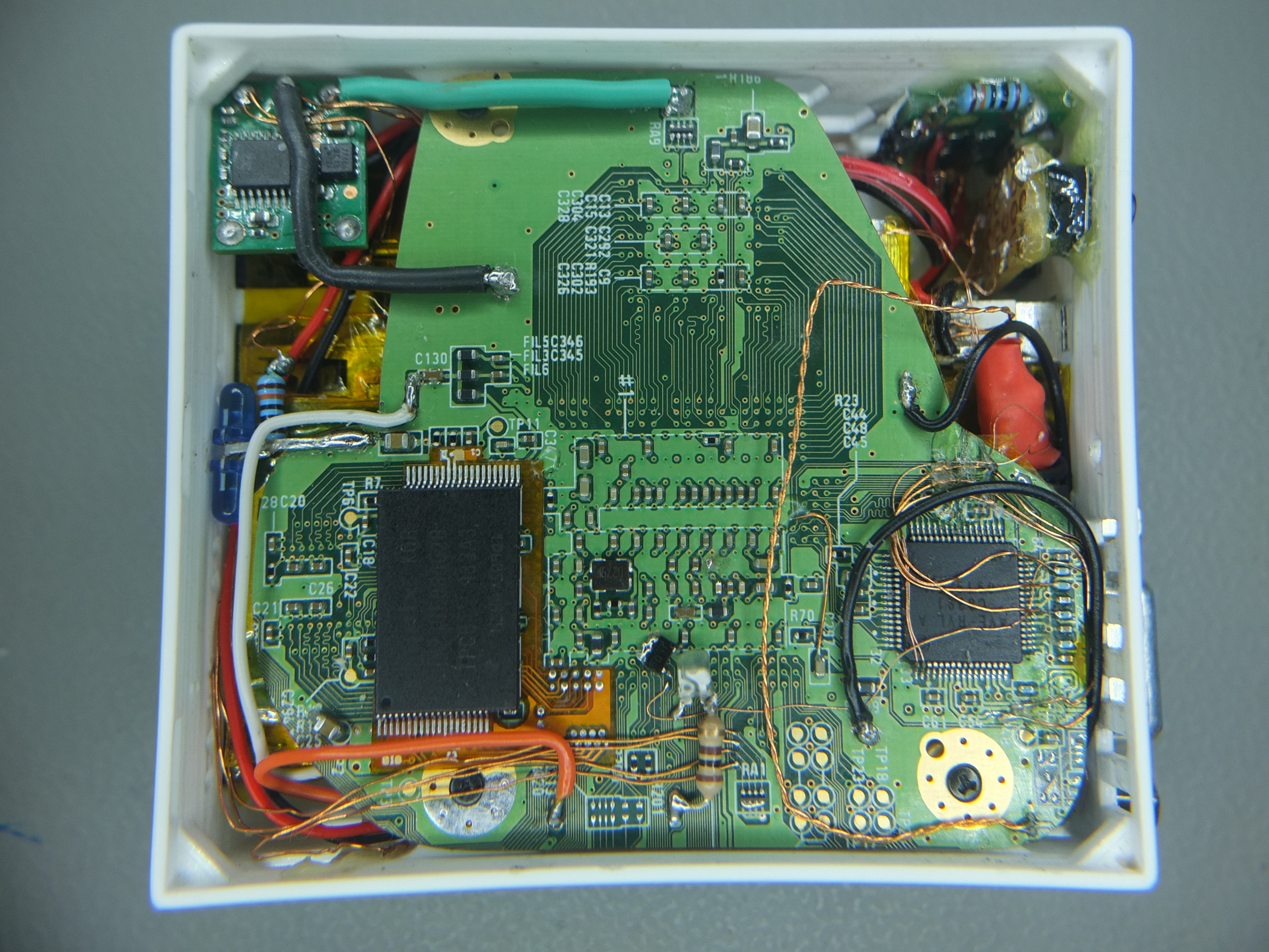

Here are some nice pics:
Internals:
The PTHs perfectly filled the rest of space...
most likely about $300, maybe even less because nold probably had the parts on hand
not really.. it's basically not much more than a wii [~15$] and 3 PTH regulators [~20$].. nand flex pcb [~5$}, a few buttons, jacks, heatsink and ofc the filament for the 3d prints. It's really not that expencive, but mostly time consuming.
