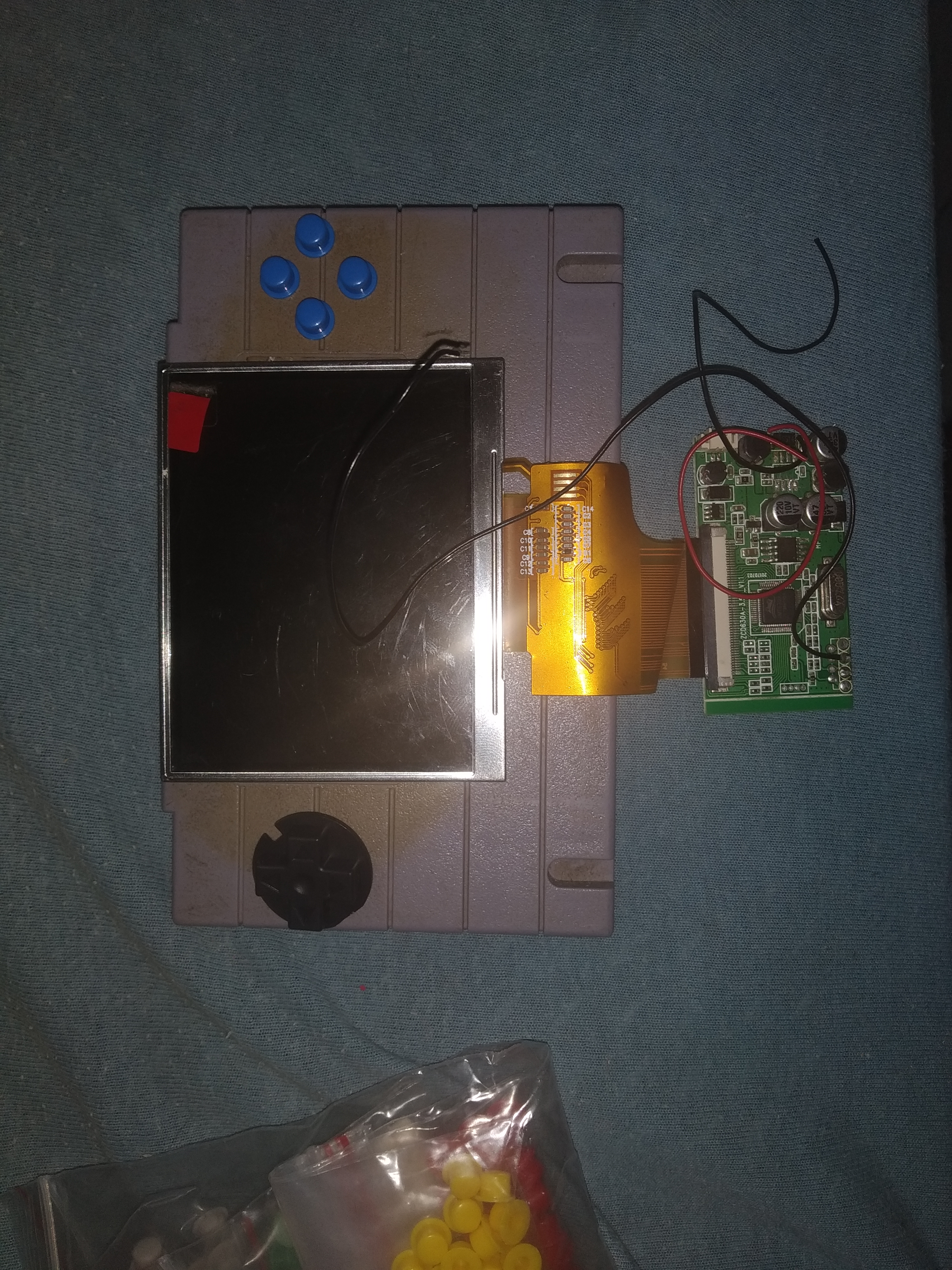

Didn't think it would be possible making a much smaller one after the 2015 record, this one is 23.3% smaller! To push any further you'd really have to start making sacrifices like even tinier screen. And honestly this one isn't very comfortable to play, but atleast it fits in my pocket.
All N64 Buttons Accounted for:
Left stick click is L. Pressing the right stick click changes the left stick between analog and dpad mode. R and Z are on the corners. The right stick emulates the C buttons.
Other Specs:
3.5” 320x240 LCD Display
1 18650 battery cell which can power it for 1.5 hours
Headphone jack and speakers. The plus/minus buttons on the front are volume increase/decrease
Uses 12V DC barrel jack charger and it can play/charge at the same time
Does not have an expansion pak. I don’t play many expansion pak games, I can live without it. Expansion paks are expensive these days and it would significantly decrease the battery life
The trim is based on the advanced N64 trim, cut very close to maximum and cartridge slot RCP wired.
