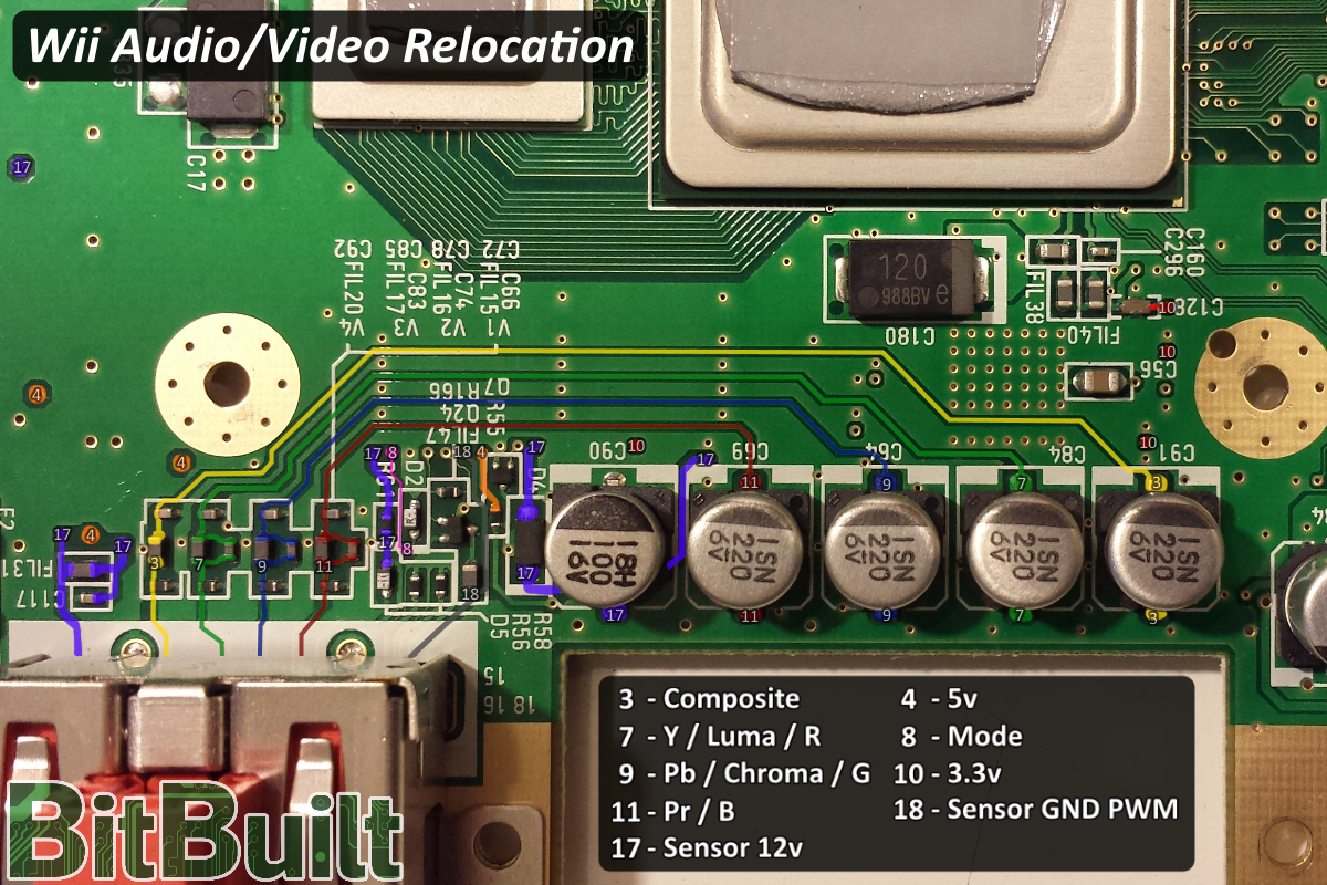

Hey @Shank, what voltage are you powering the IR LEDs with? Is it 5v or less? I see on the trimming guide there is a 12v PWM point (and gnd) for the sensor bar but I don't think that is necessary to power two IR LEDs.
I'm building a system in a Wii U gamepad and it has two IR LEDs built-in along the top and I was just planning on running a gnd and vcc wire to each of them from the 1v regulator. Looking at data sheets for similar IR LEDs from Adafruit or Mouser, they all state a voltage of ~1.3v.

I used 3.3v, and ran the IR leds in series and through a resistor. You can run them from any voltage, as long as you have the right current limiting resistor. The stock Wii sensor bar runs on 12v, but if you are using your own LEDs, it doesn't matter the voltage as long as you have a resistor to create the desired current. Read your datasheet, and match the numbers. Here's a good calculator I use to calculate it easily.
As for LEDs, just order a bag of them off ebay or from china. Mouser and especially adafruit overcharge exorbitantly for LEDs. And I adafruit's customer service blows, so that too.

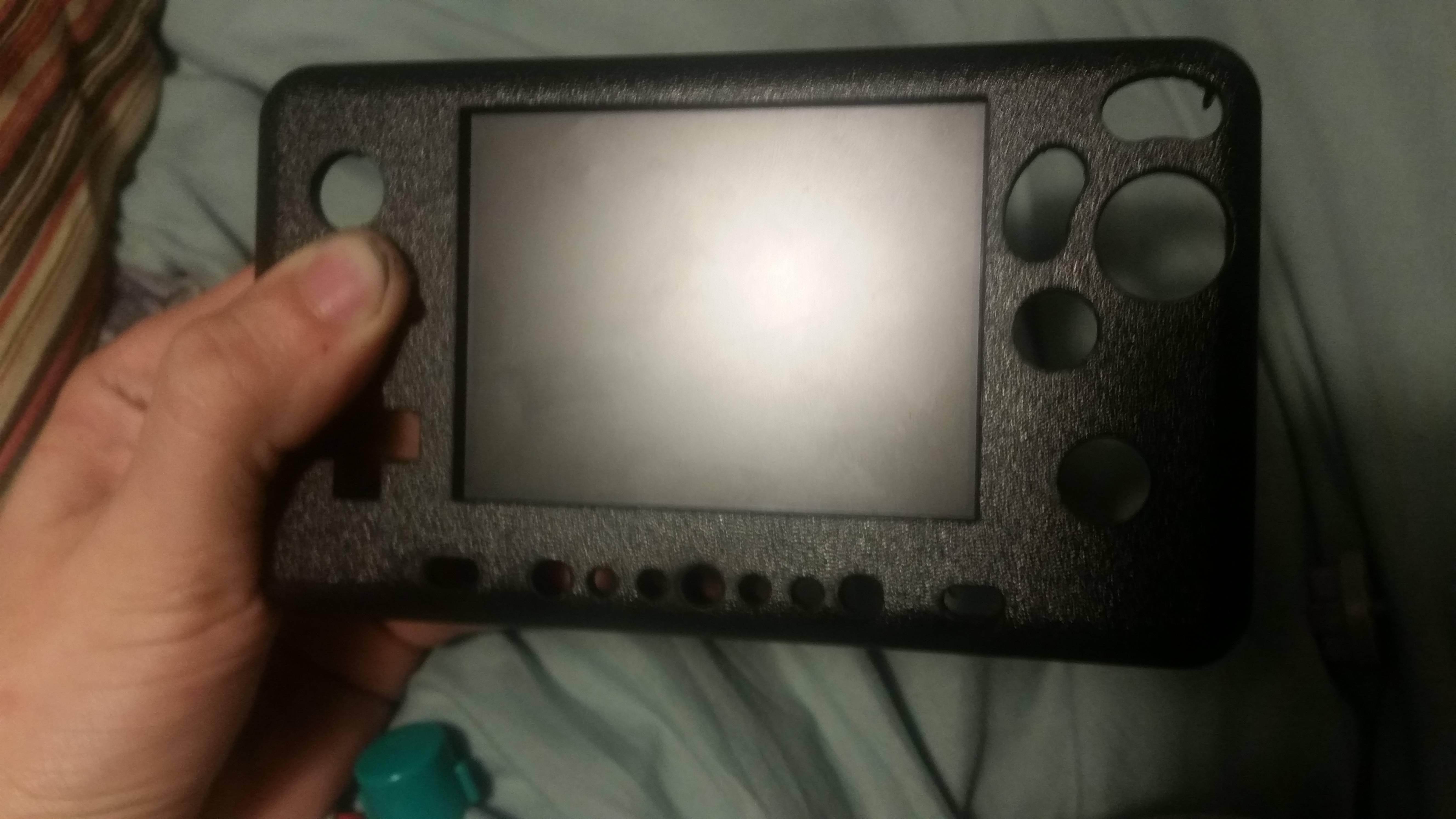

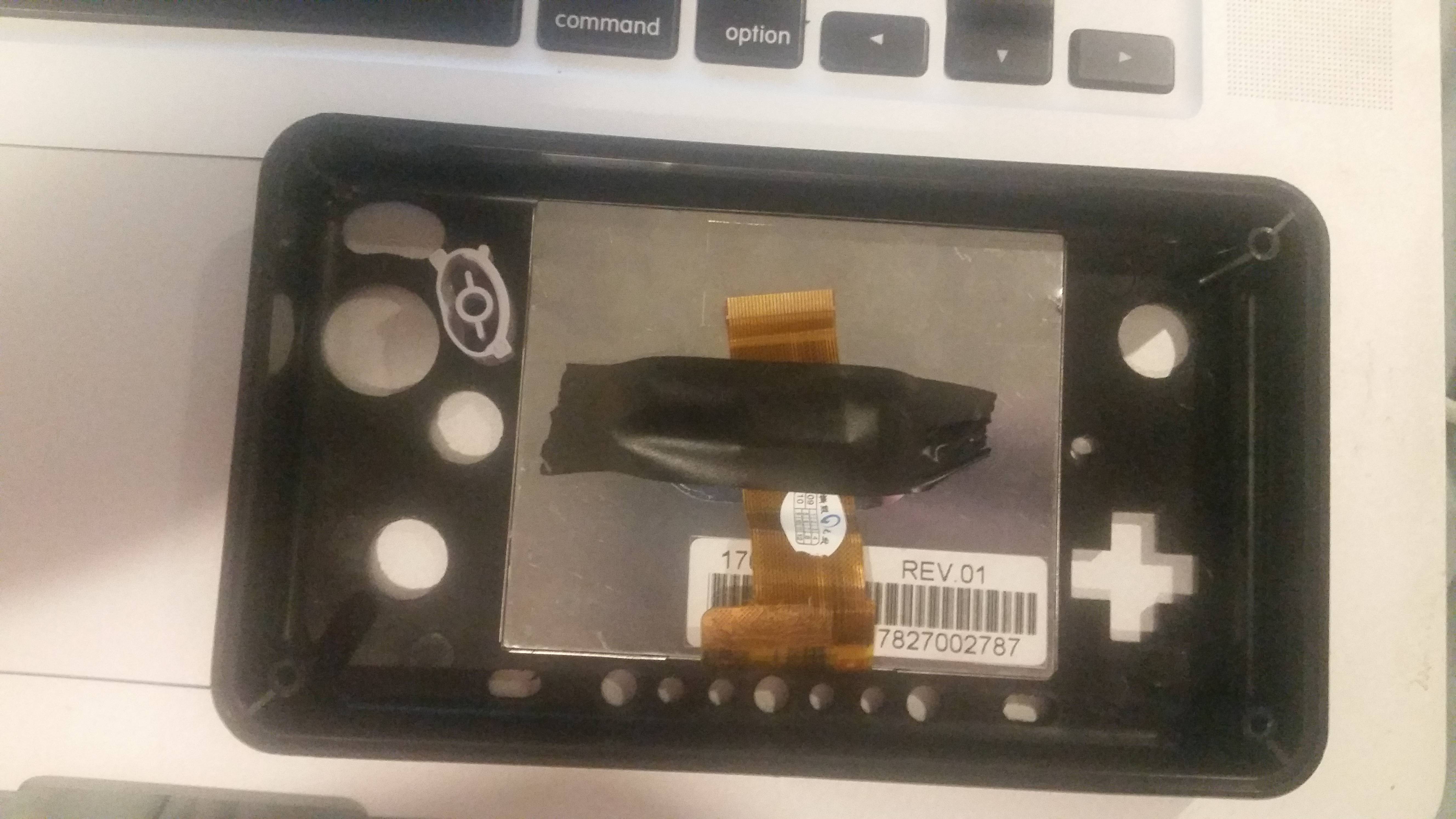

Unfortunately, in a form factor this small, I have to go with this 3.5" screen. I could dish out another $100+ for a nicer screen, $15 for a converter, and remove batteries to accommodate the larger drive board and a converter, but on a screen this small, it isn't worth it unless I can find a better alternative
EDIT:
Screen mounting method isn't done. I can hold it in by hand and try to hold my phone steady, but for now thats the best I can do. Everything fits, with enough clearance to not obstruct the nearby components :DView attachment 466 View attachment 467
