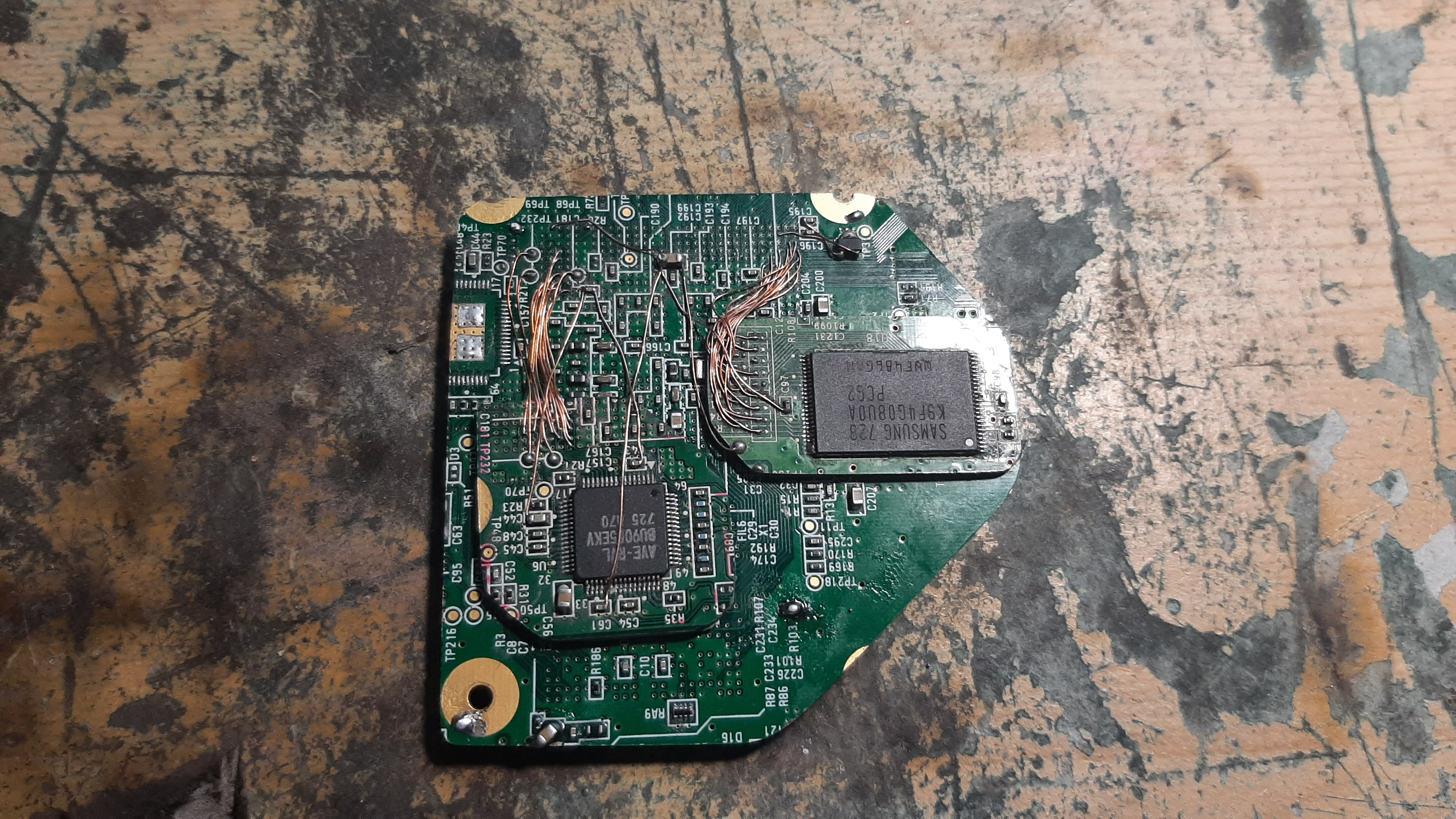

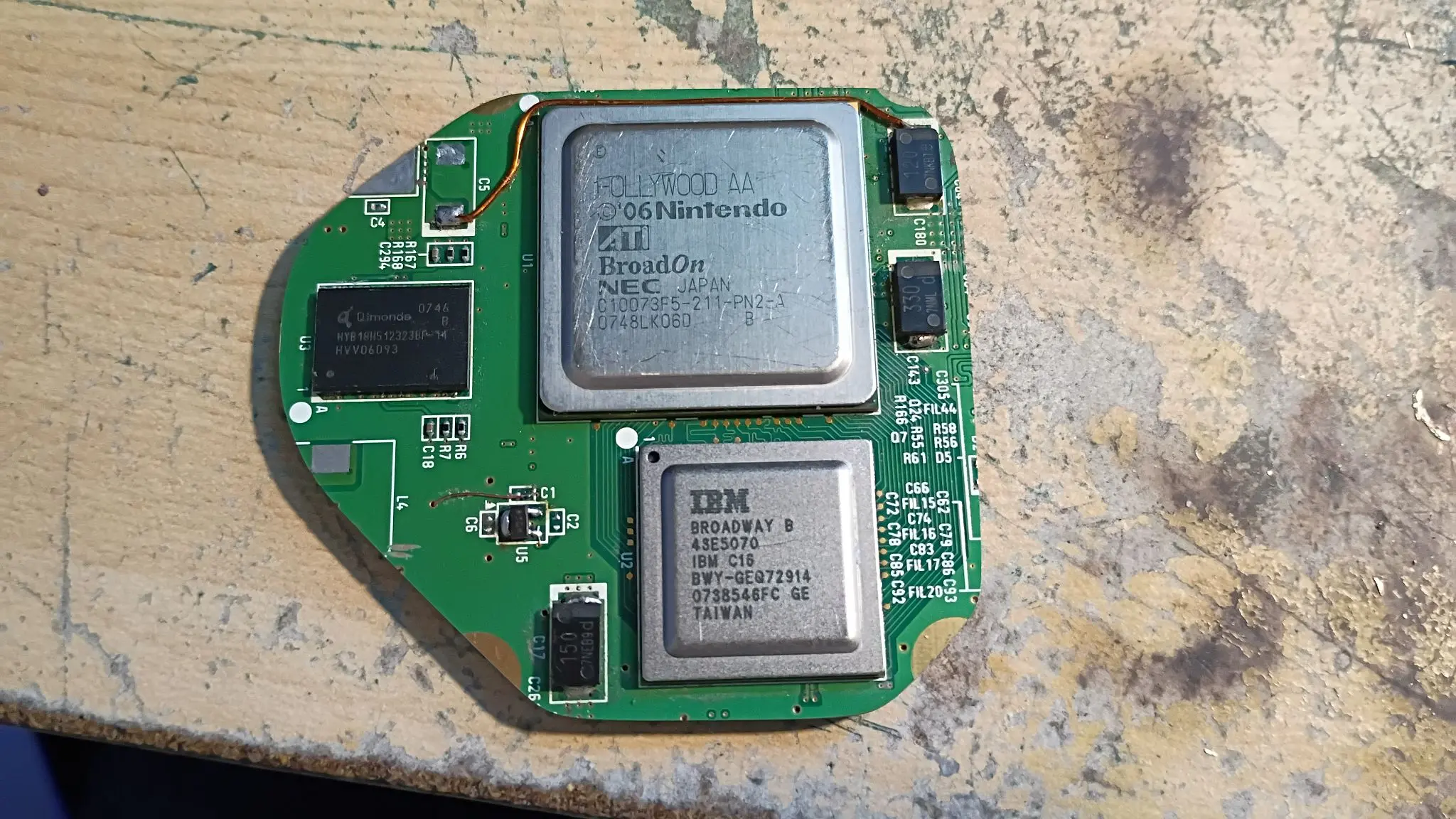

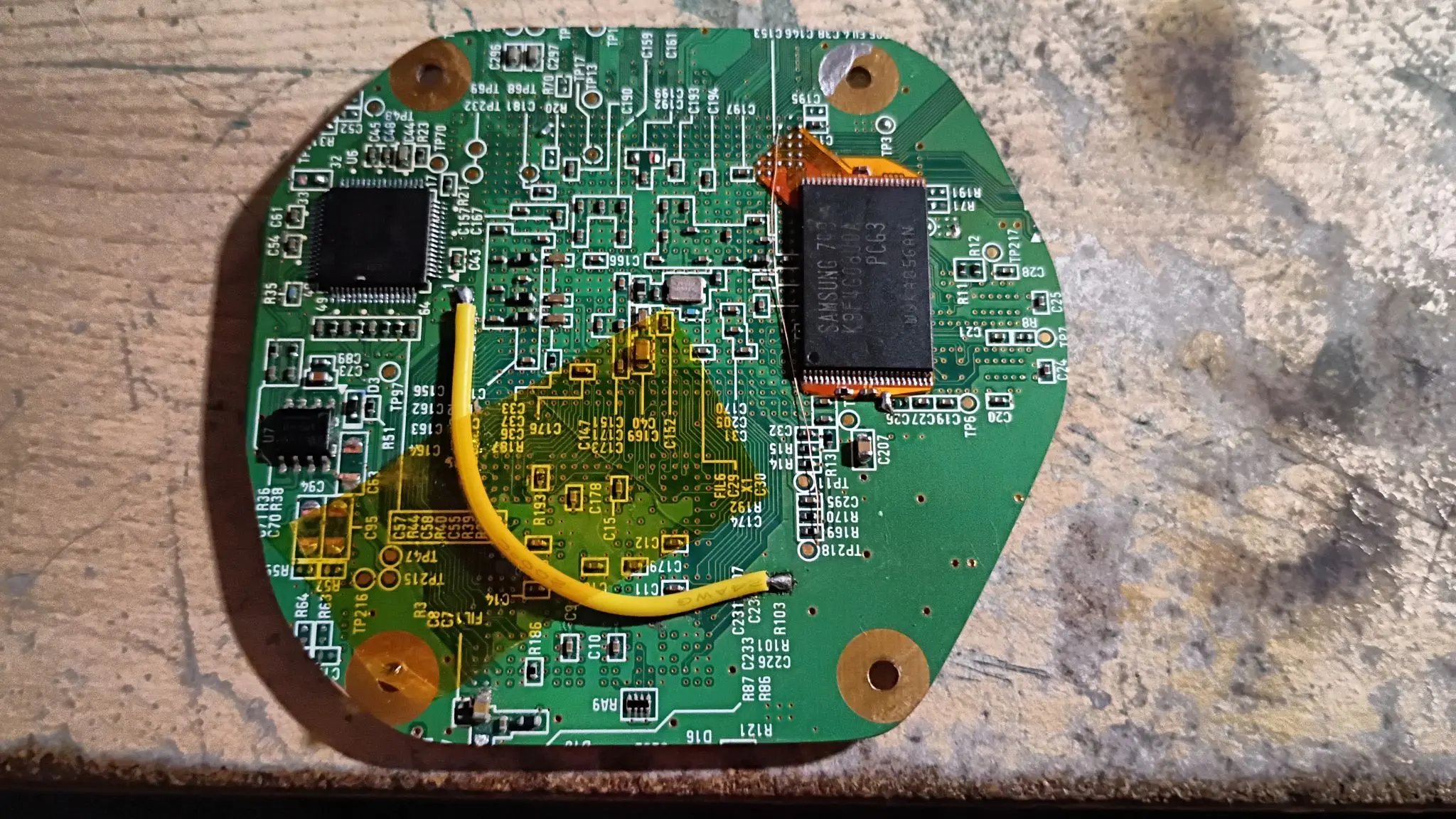

There is no point in this existing, but it was fun to work on alongside @Mrak408! Really put my Wii knowledge to the test - which isn't very much compared to others, but it's just enough to get a working trim!

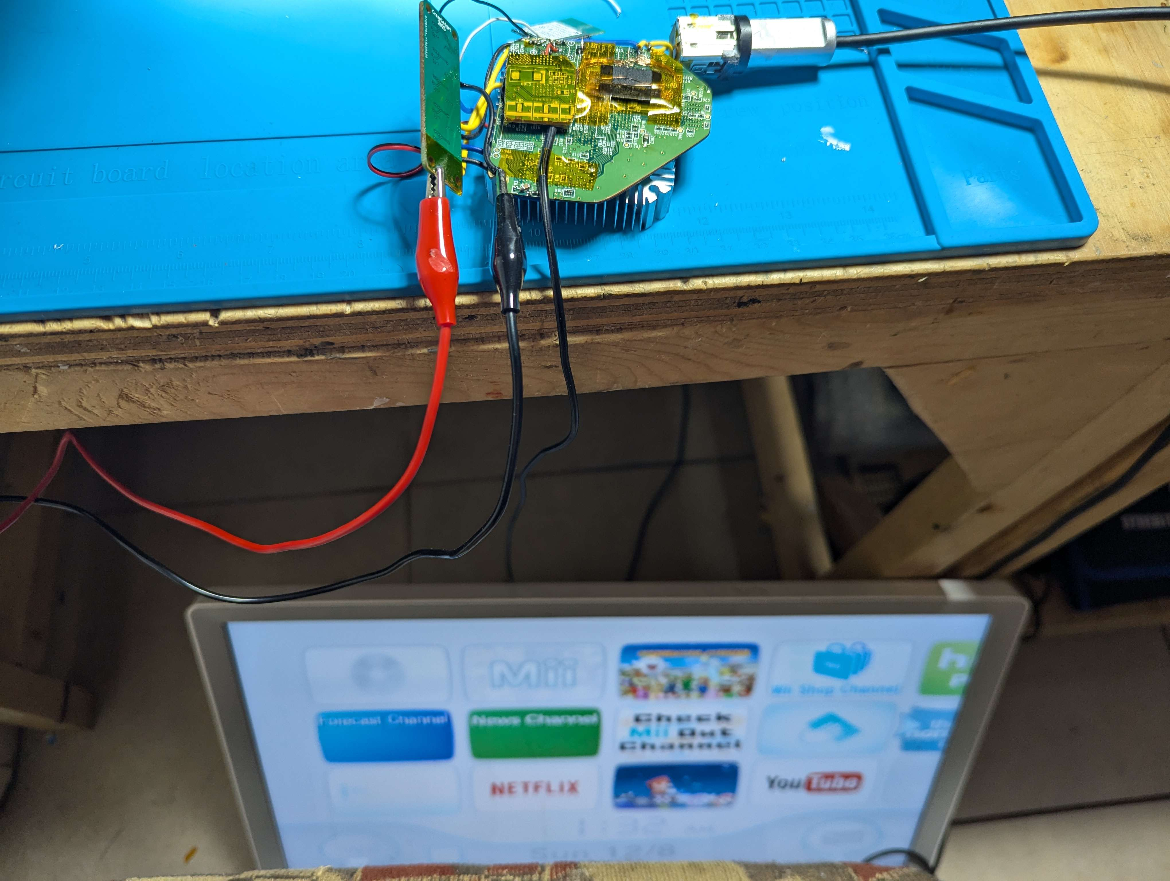

Here's the real OME6A we've been yearning for, but never had until now:
And proof that it does work:

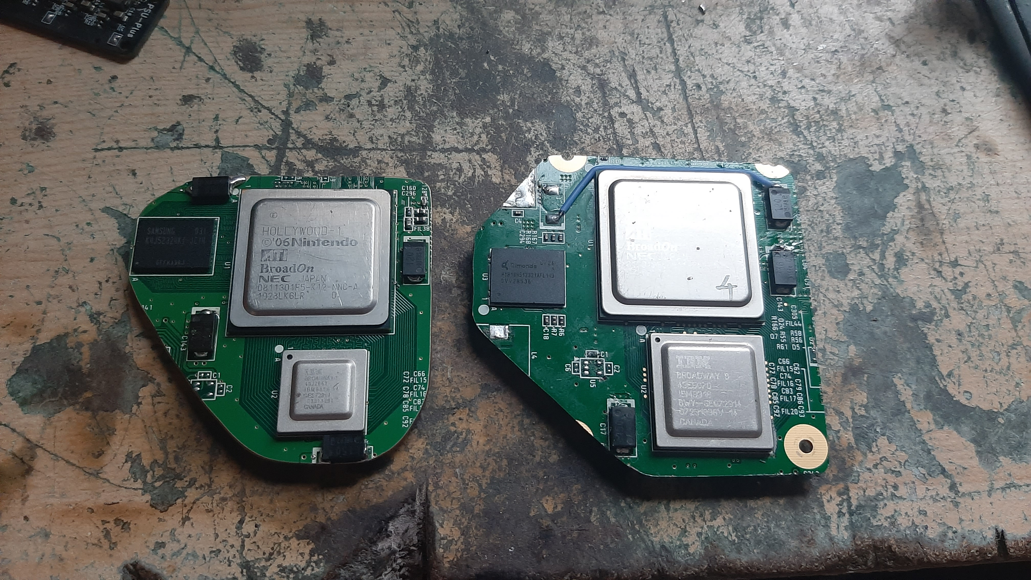

The crazy part is that its not much bigger than a 4L OMEGA:
I could have cut in a little bit more above the RAM, if it wasn't for my U10 relocation (I could have moved it but I just didn't bother to).
AVE daugherboard was taken from another 6-layer Wii. I somehow killed it prior, so there was no real loss here.
NAND daugherboard was taken from a Wii U. I had a few NAND/eMMC daugherboards laying around and just cut off the eMMC part. I did swap the TSOP, no NAND flashing here.
I do not see any portables using a OME6A considering the higher power draw compared to 4 layer boards, but maybe its useful for a micro console?

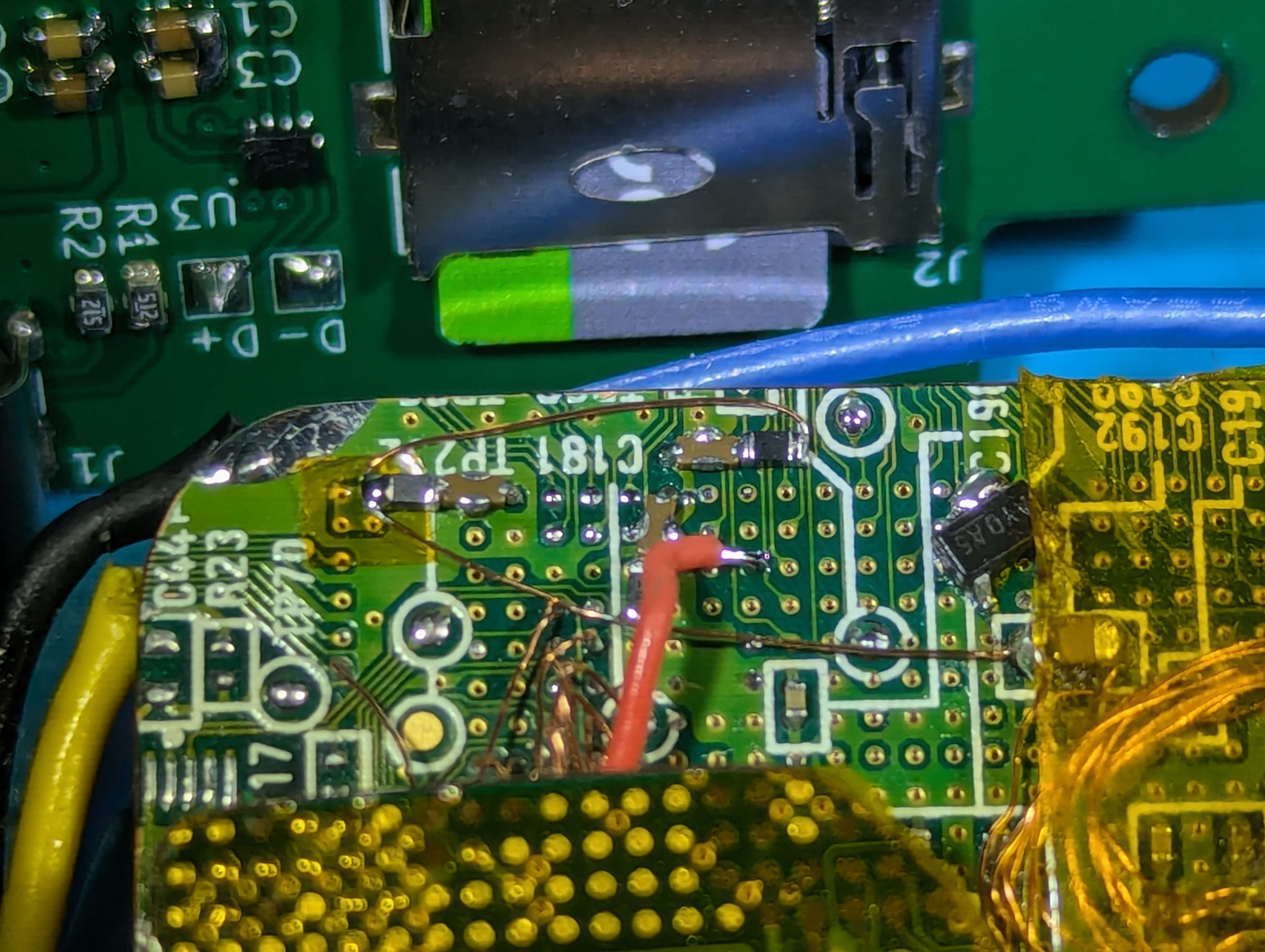

Before I start yapping, I know I'm several months late. Lazr and I started the quest at around the same time in December, however, I had hit a roadblock which stopped me from fully completing mine - that being the dreaded "black screen". To skip over the details, I had put the project away for 7 months due to a single resistor; the I2C pullup for the AVE. Most of my time went to redoing the AVE relocation and rewiring the nand while completely overlooking that tiny detail. But alas, I had gotten proper video out on through composite. Unfortunately, I was about to hit yet another roadblock. The Wii's USB phy requires 3.3v to be provided to 3 different vias, presumably one for each USB controller inside the vegas. In Lazr's trim, she had quickly discovered that the supply traces going to those vias were cut due to the trim; simply soldering a single wire to all of them. This method had allowed boot, but what was unknown at the time was that the USB wouldn't work on the Ome6a. Since it wasn't tested, It was understandably presumed that the trim was fully operational. In my case, I was also completely unaware about the USB issue - until I encountered it. Without going through the painful details, I had resorted to every known USB troubleshooting method: Reformating, using different drives, swapping the USB pair, trying the other USB port, even attempting to sniff the USB with a Pico LA (Which wouldn't even work for 2.0 highspeed lol). I had gone back and remembered about the traces that supplies power to their respective USB controller. Each trace had it's own filter circuit, comprised of a ferrite, a feedthrough cap, and a large MLCC. So basically, I relocated every component from the filter circuit in an unorthodox, groteqsue bodge (originally didn't include the large caps).

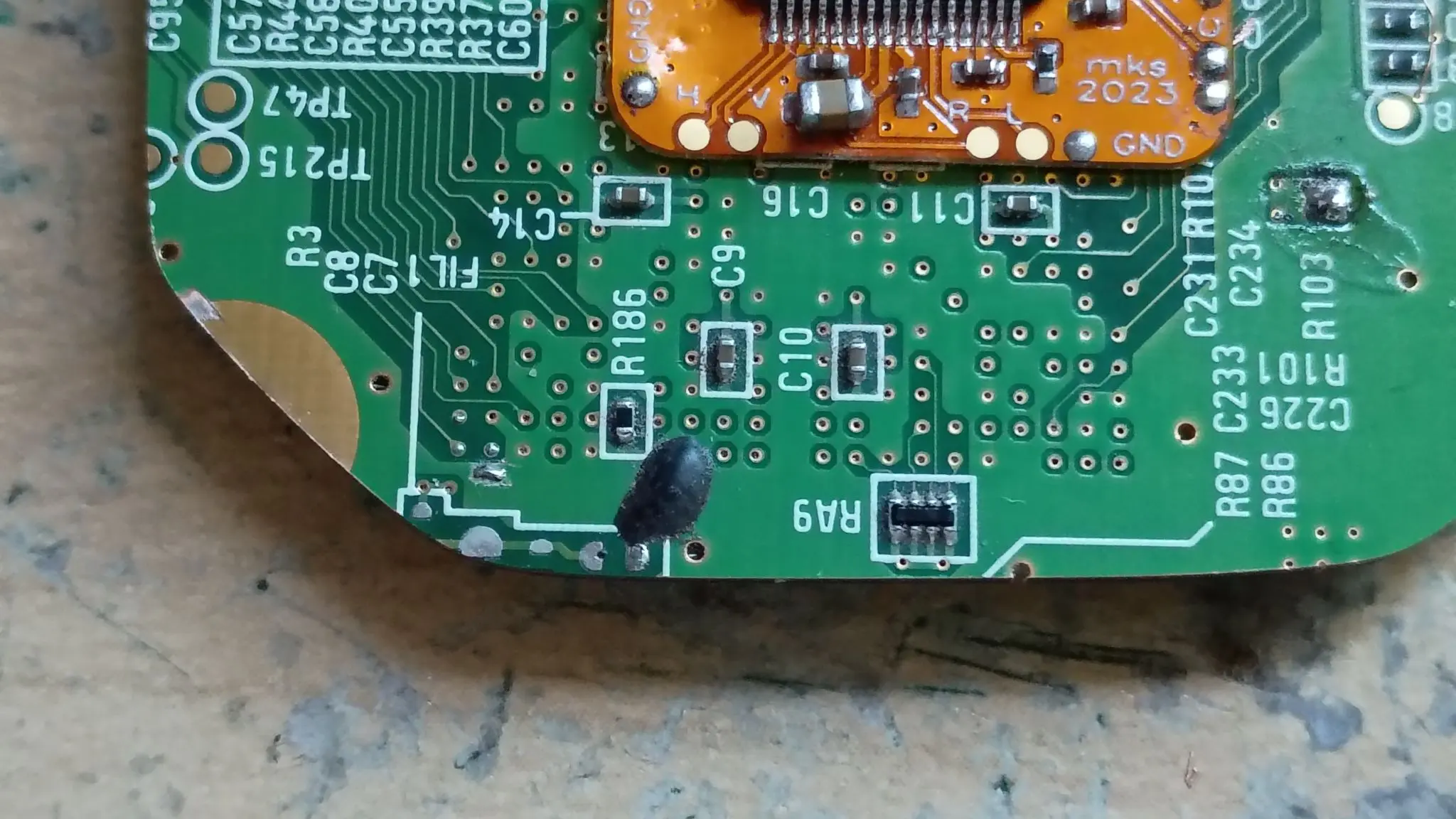

This... Didn't do much. But after a few hours of banging my head against a wall, I had remembered about a single resistor which was located nearby. R70 is a 12kohm pull-down resistor used for "USB_RCOMP", resistance compensation.This resistor is usually located under the Hollywood in a 4-layer, but it was outside the cut on an Ome6a. Omitting this resistor messes with the controller's impedence matching, resulting in the USB problems I listed. So I simply relocating the resistor back (along with the large decoupling caps for good measure), and...
ignore the soggy image
The first fully working Ome6a. (more pictures attached below)
I'm, again, skipping over many details (i.e: how I got the dreaded omega U10 problem, whether or not the USB phy filter passives were ever really needed, how I dug to the voltage layer twice to relocate 2 tantalums (and how the 3.3v one prob isn't needed either), how this trim would look with other 6 layer revisions, whether or not the CPU passives near the bottom are needed, possible room for an FD-Ome6a, etc.) But I'll leave that to whoever is insane enough to attempt this trim. It took me 7 months to relocate one resistor, then 2 days to relocate another, hopefully that won't happen again now that this information is available.

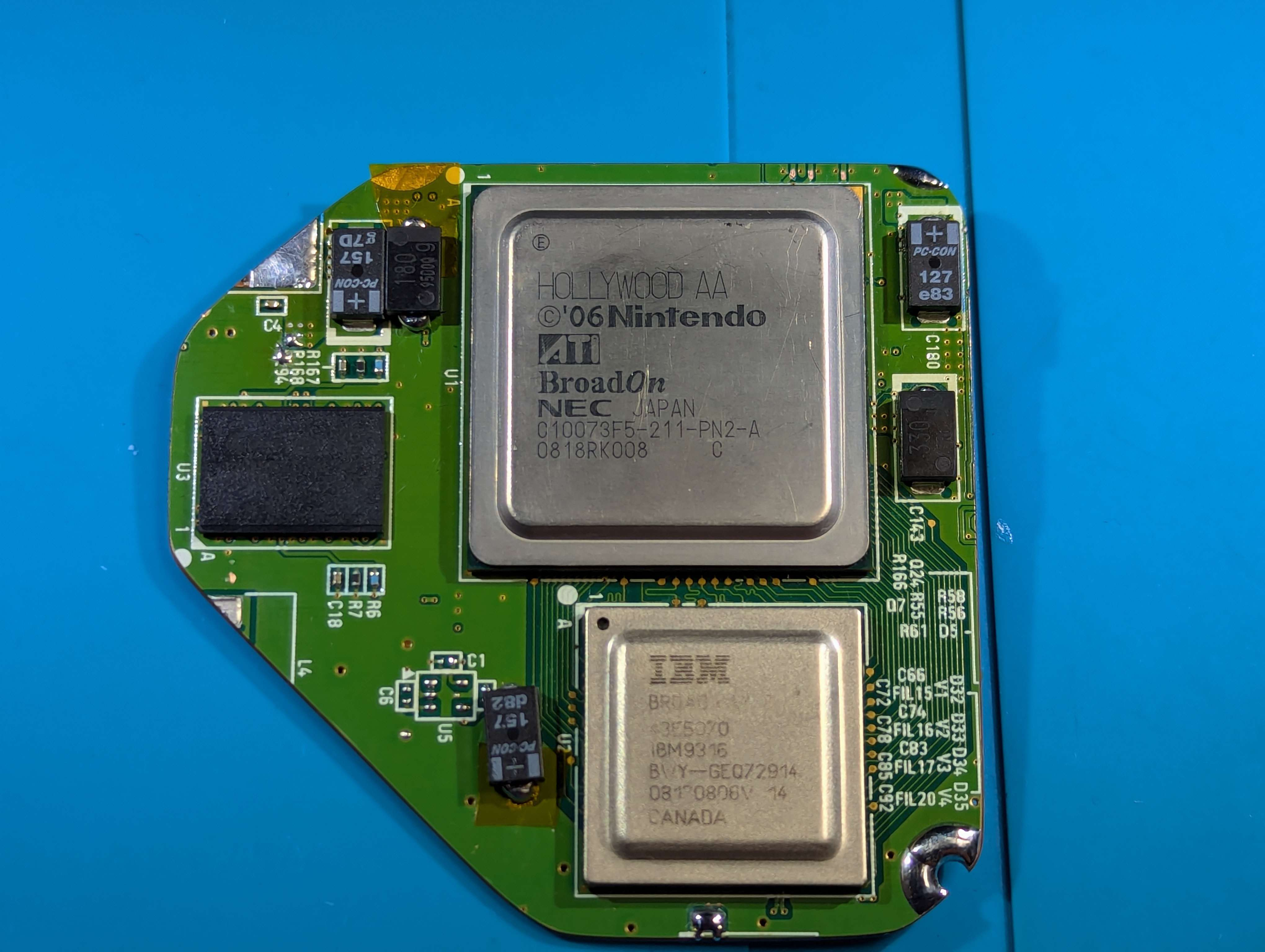

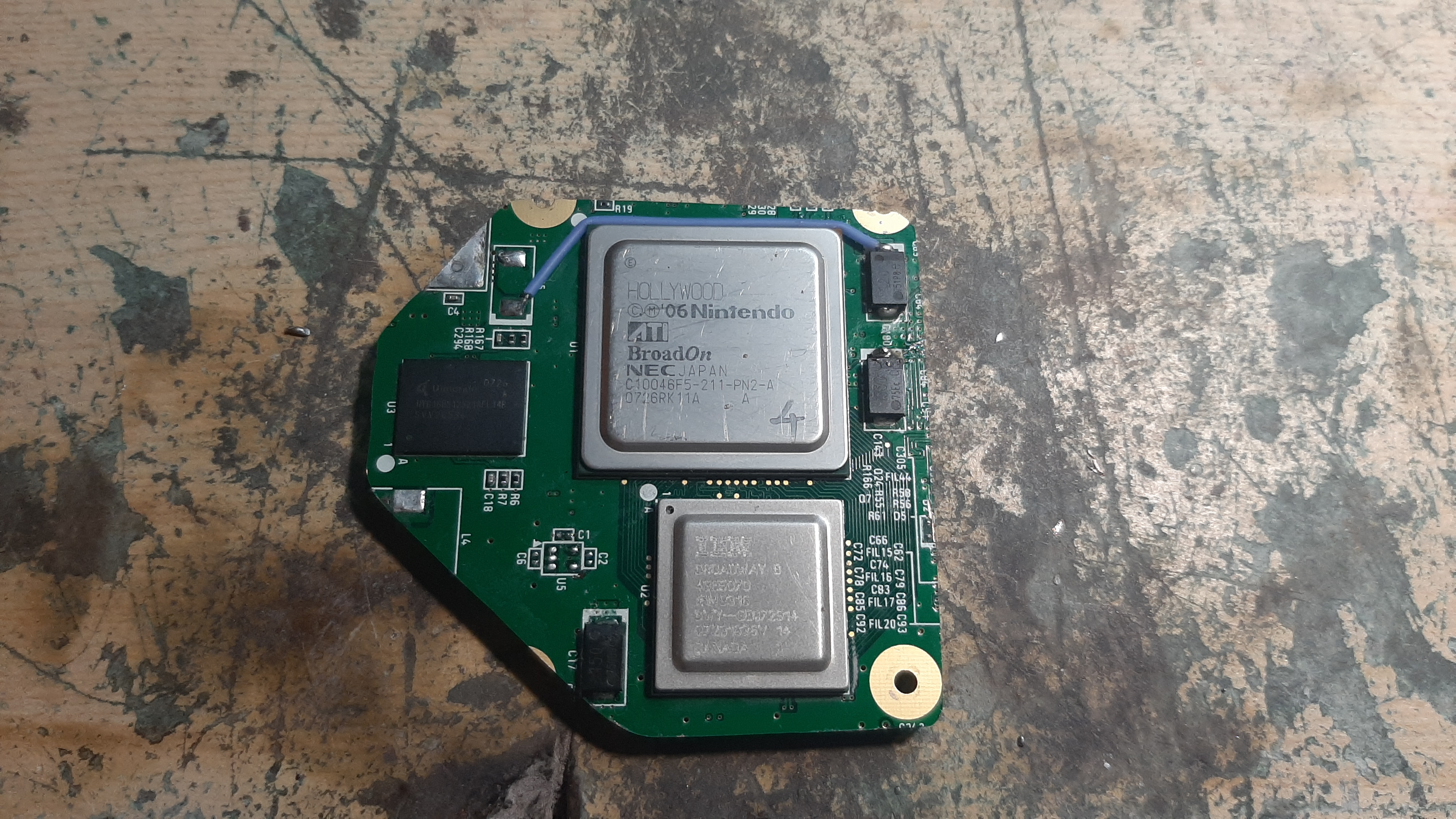

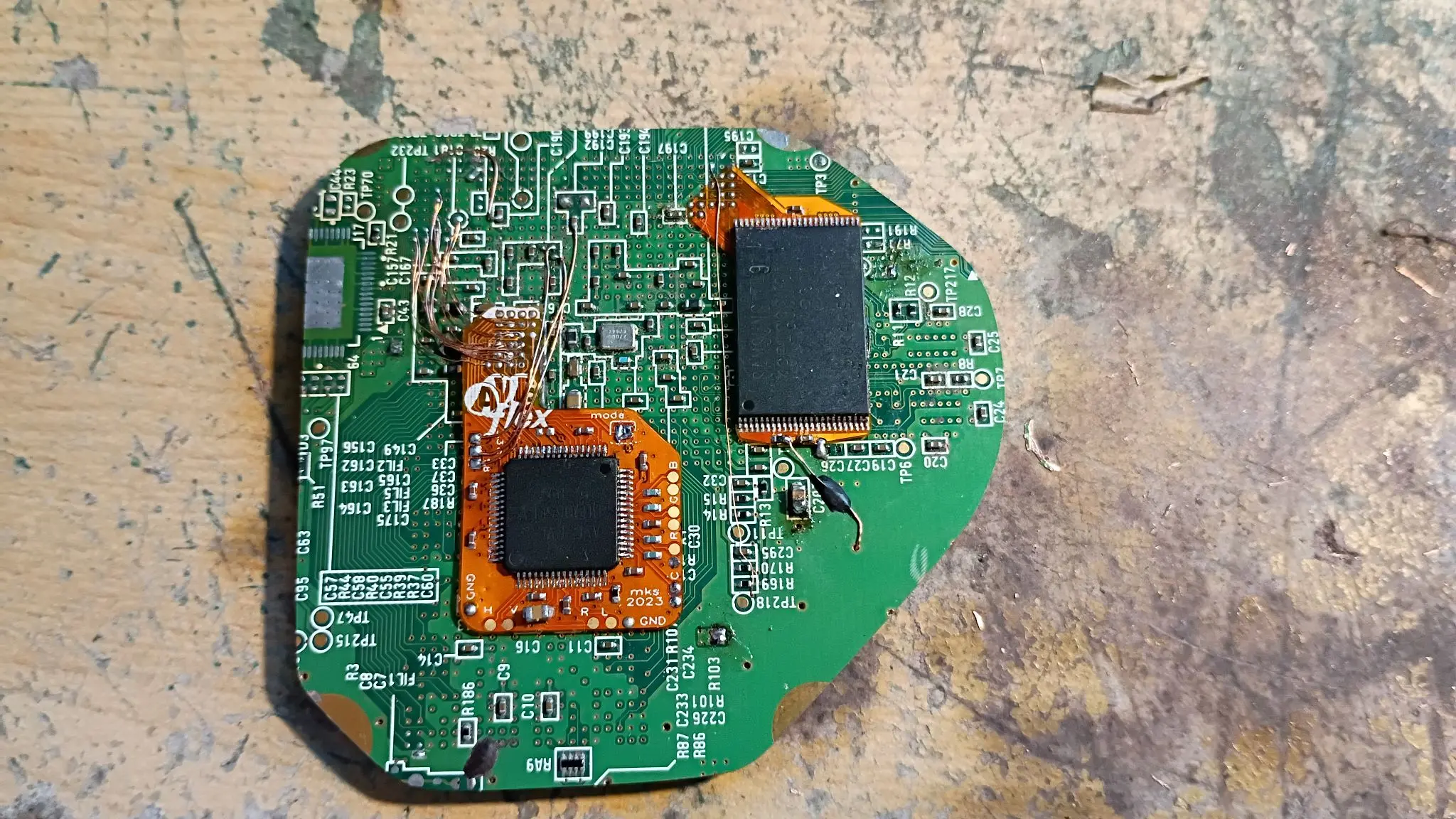

I got bored and made another lol
A few differences from my original one:

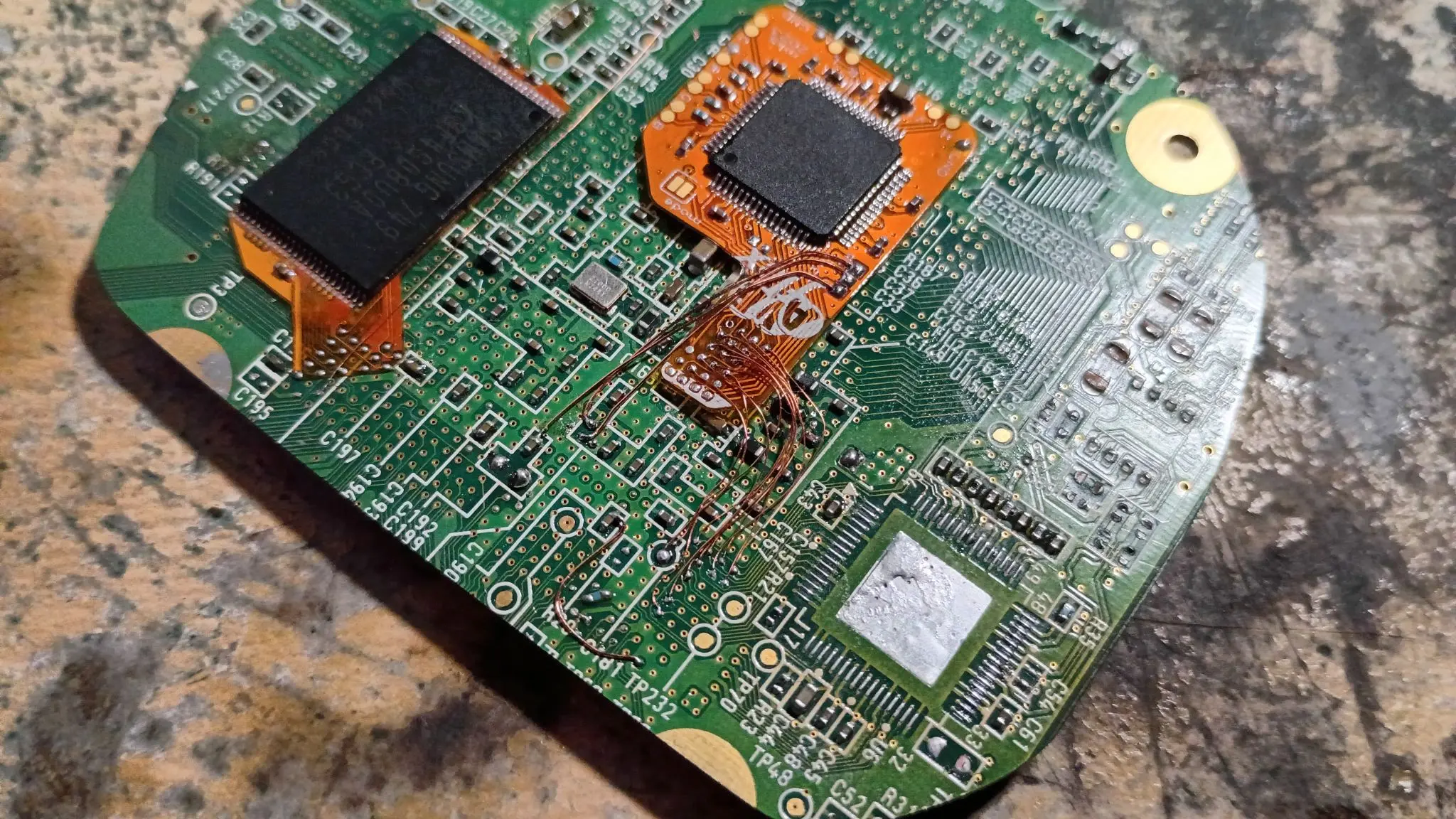

- 6L-NANDFlex!!
- deadbugged AVEFlex (maybe someday ill actually commit to design for 6L but for now this is fine)
- R70 relocated (instead of nuked)
- U10 is using the "standard" U5 footprint relocation
- CPU passives bypassed
The 6L-NANDFlex can be found here. I wouldn't recommend only relying on the castellation for mounting and would hold it down with some sort of glue.

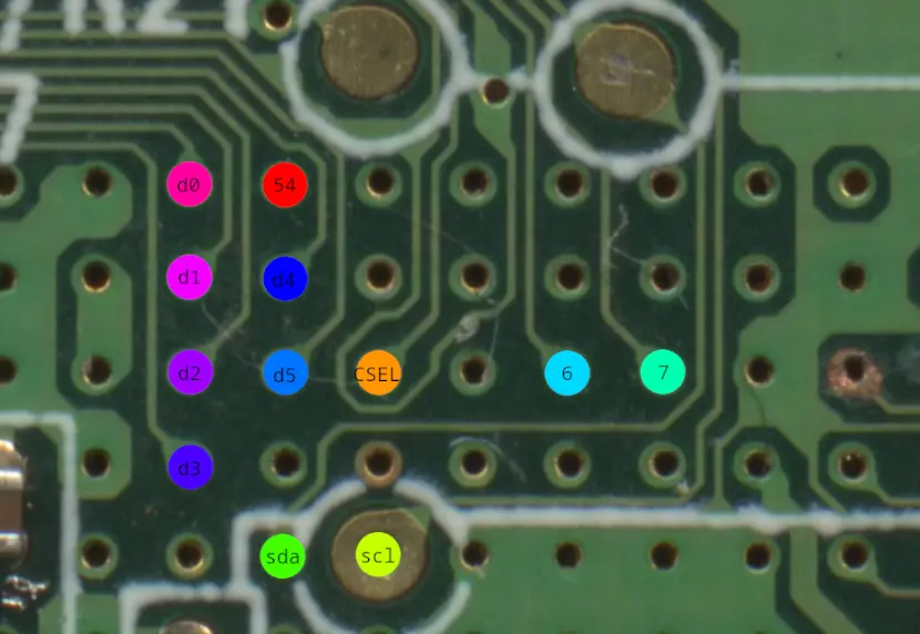

The AVEFlex was actually really easy, but that's probably because I spent the time to highlight which vias had to go where on the flex with my scans:
Again I didn't bother to wire up I2S because I doubt I'm going to use this in literally anything except as showpiece.

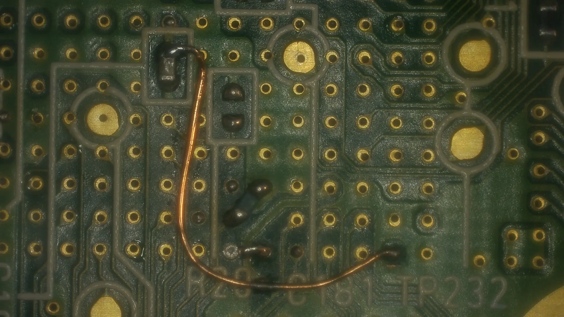

R70 relocation I did forever ago just because I wanted something to do (C128/C129/C130 capacitor bypass is also pictured here)

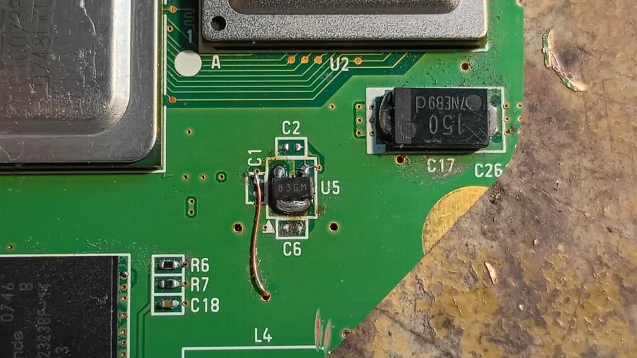

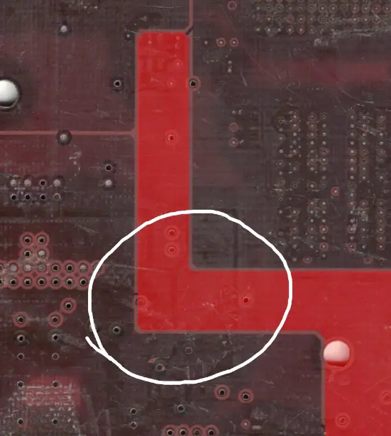

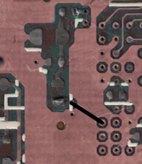

U10 at U5 on 6L trims only works if you don't cut through this portion of the 3v3 pour:
The OM6 guide just barely touches the corner, but on more extreme trims like this it wont work unless you wire 3v to pin 5 of U10:
The board was still booting before I realized this but I had to manually reset the Hollywood otherwise nothing would work properly.

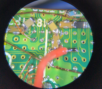

Not much to really note here. its just two capacitors, a ferrite bead, and a 2ohm resistor. Under the mask is just a wire so here's a representation on the scans

While I was working on this, I was using Yveltals bistro to power the board since the PSU-Plus was being used elsewhere.

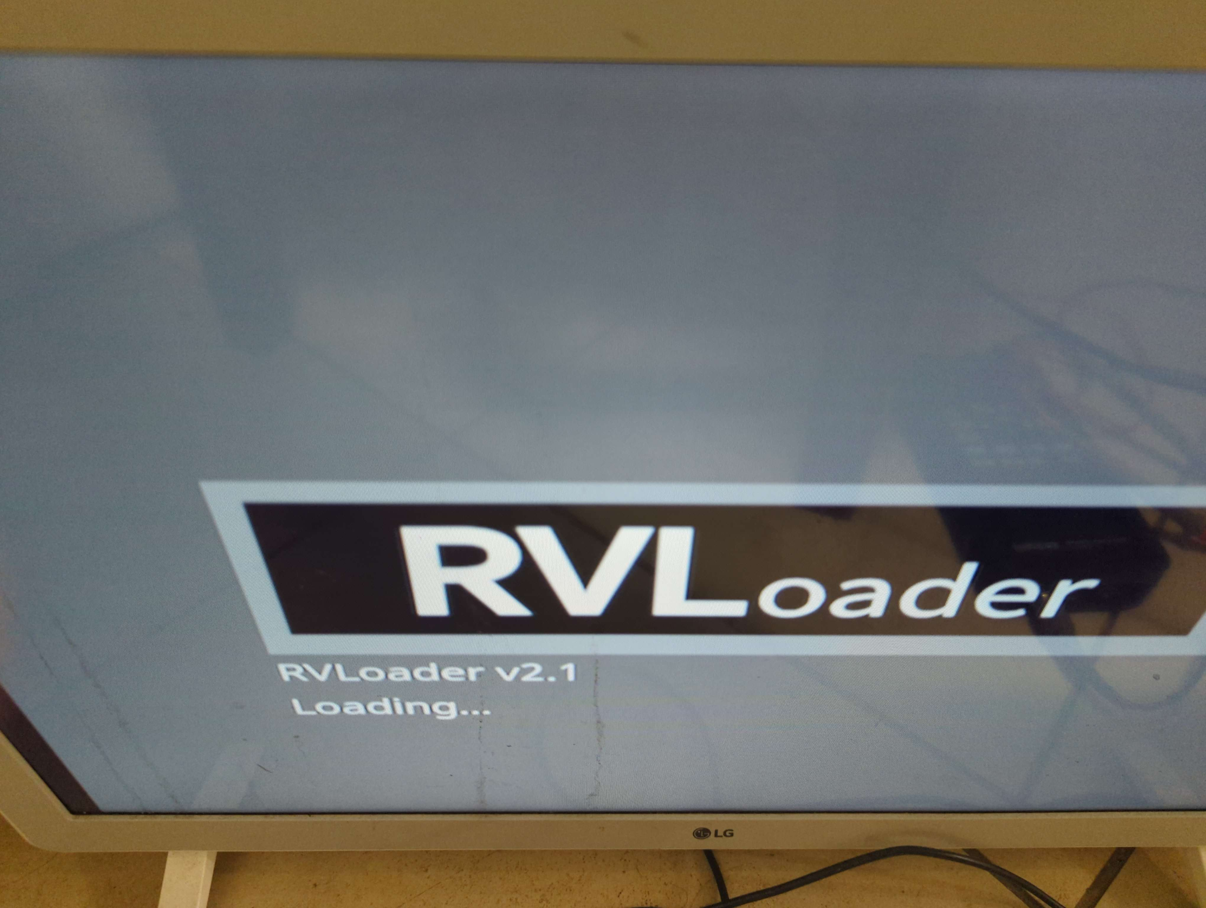

It generates all the necessary voltages for it to boot (1v/1v15/3v3) but instead of 1v8, it generates 1v5 (because this is what the Wii U DRAM is ran at).
This undervolt seemed fine when I initially tested it, but it wasn't really a thorough test. Just saw rvloader bootloader and called it a day.

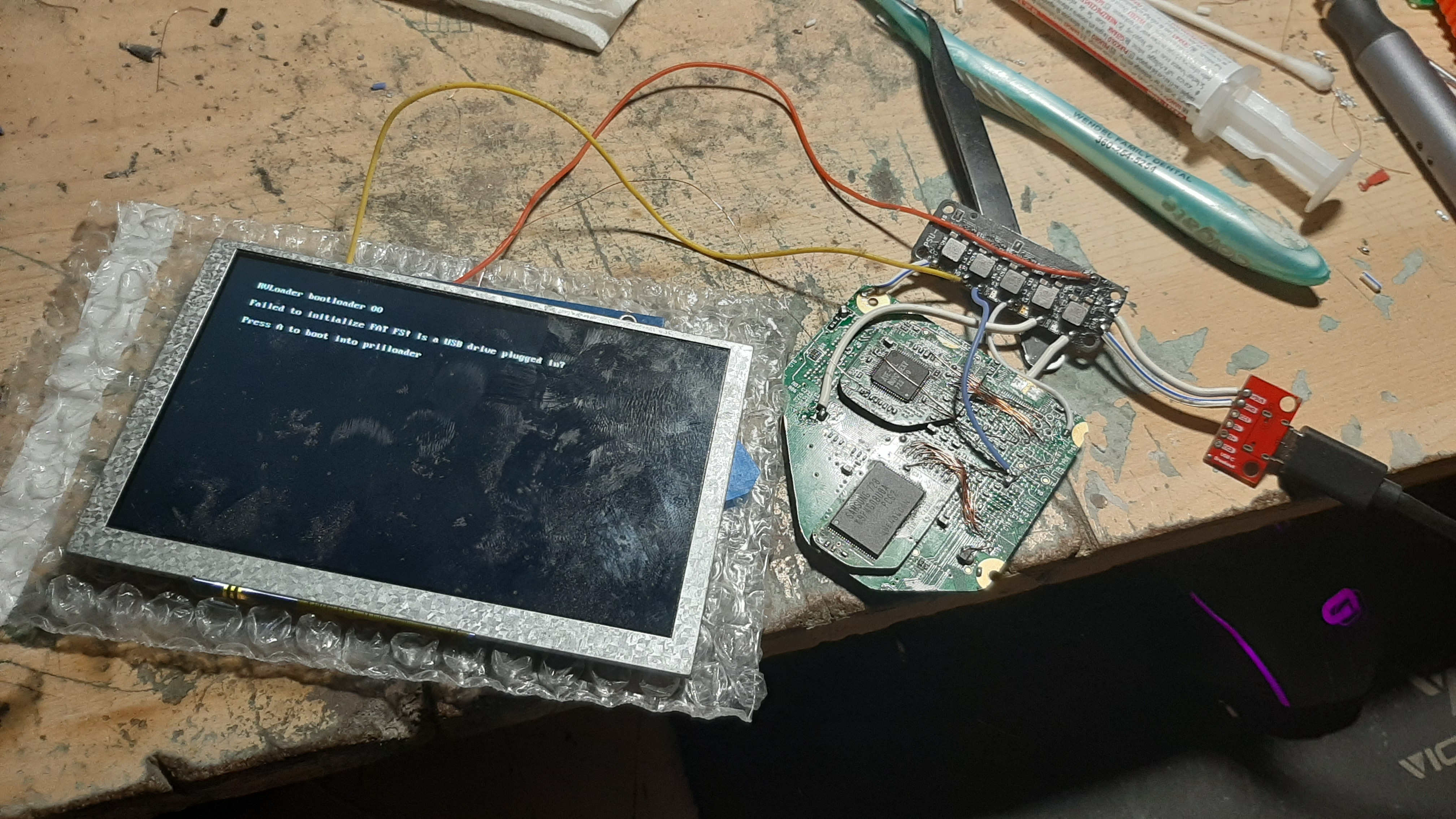

Come to actually testing it and..
At first I thought the GPU was kicking the bucket (wouldn't anyone?), especially since there was no heatsink for most tests and it was being left on for a few minutes at a time.
What really almost nailed the coffin was that it happened on both screens I was using for testing.
At first I thought that maybe it was the batteries because they were really low charge. Put all 4 of them in parallel and the issue persists..
I don't know why, but I remembered that the rail was being undervolted. This was the point where i just grabbed the PSU-Plus and tried it. (not so) crazy thing is that was the issue. So relieving.
Moral of the story is uh, don't undervolt like a maniac I guess.
