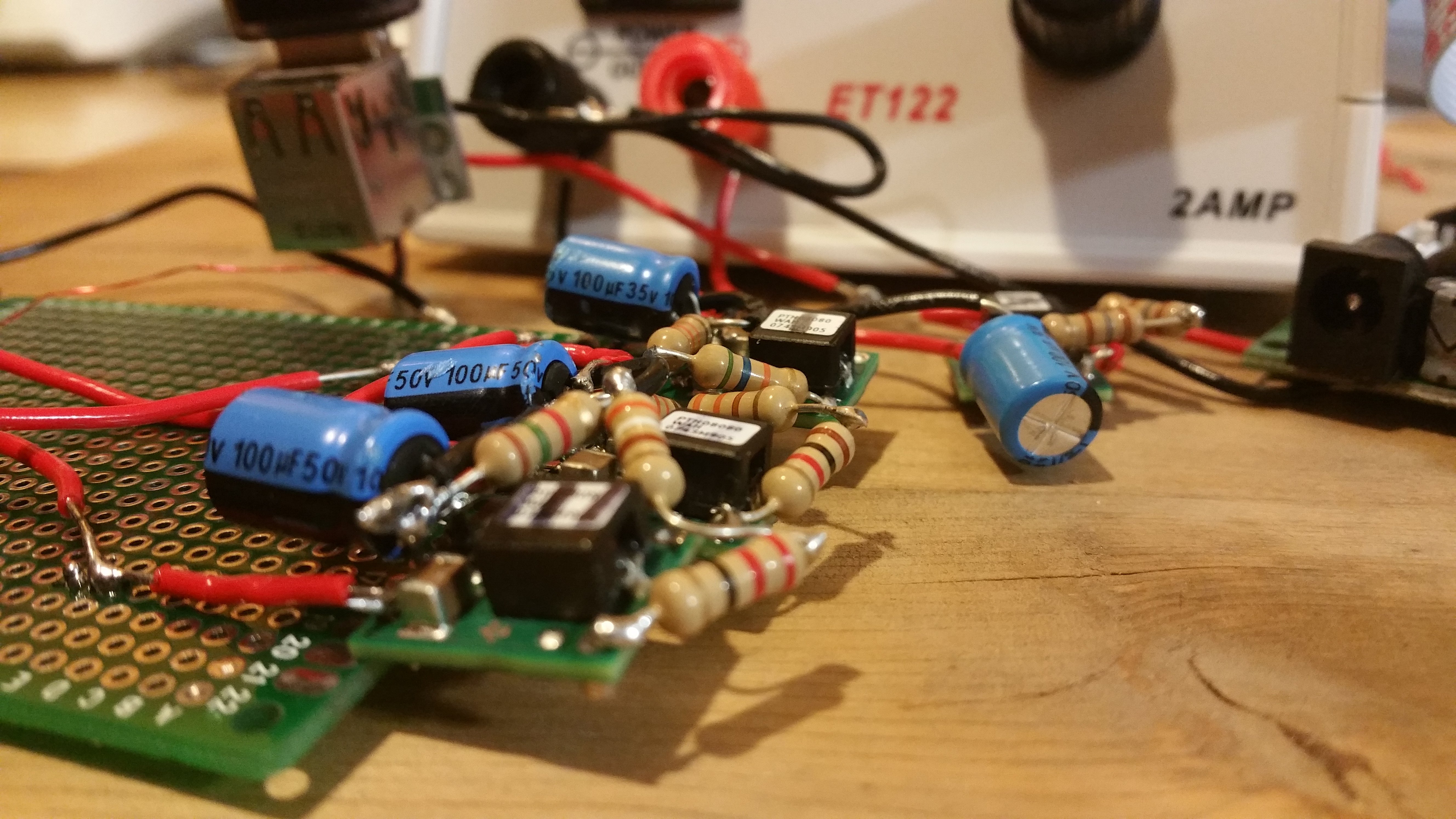

So quick update, my screen came in today. It works, so that's good. My regulators are all set and ready to go, so with the U10 and my perfboard coming in today I should be able to make some good progress with no school tommorow.

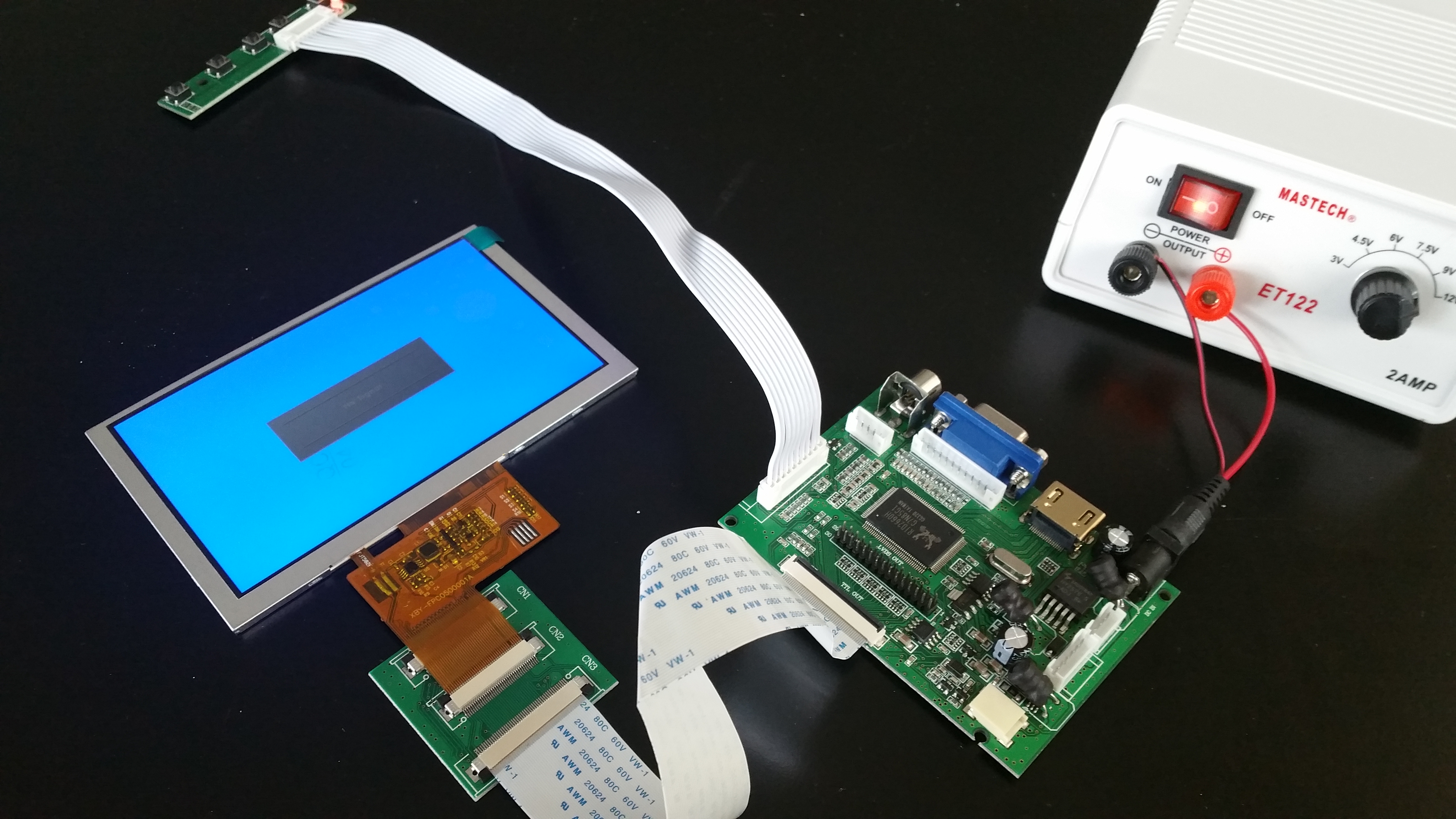

I also just wanted to ask a few general questions about the screen. I'm using this screen from the BOM, and wanted to know if there is a way to power it off of just 5v. I also won't cause any problems by removing the VGA/ HDMI ports, right? If there is other useful information about this screen that I've overlooked, please let me know!
Removing the ports themselves almost never causes problems (unless you short or bridge something by accident while removing them) And you can test it yourself by lowering the power supply to 5v. If it doesn't turn on then you may need to remove an on-board regulator or some other shennanigans to get it to work.
Just verify that it works with the wii before you take off the ports (meaning make sure the video comes up and that it's on the correct settings.) This will save you a headache later on.

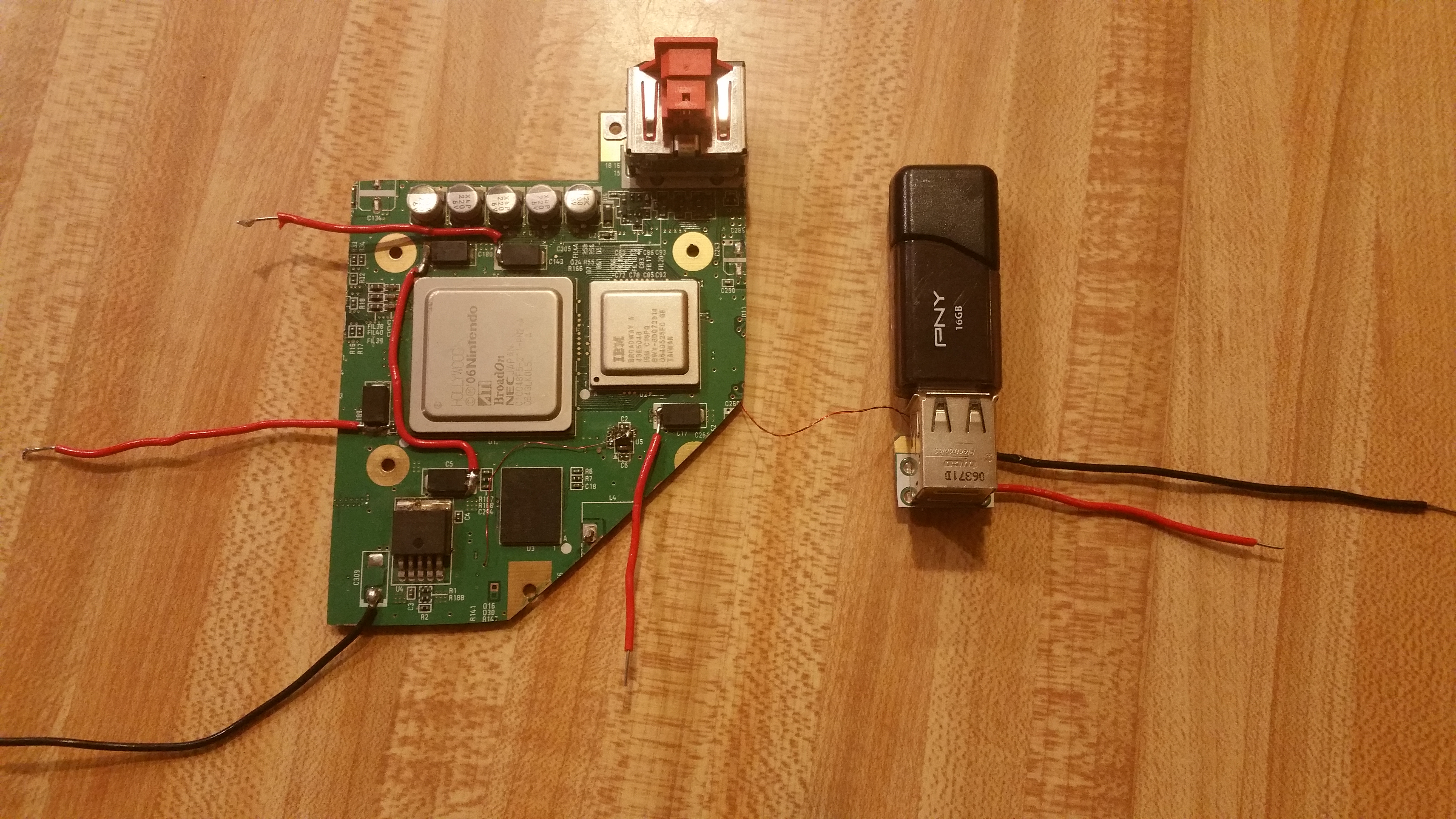

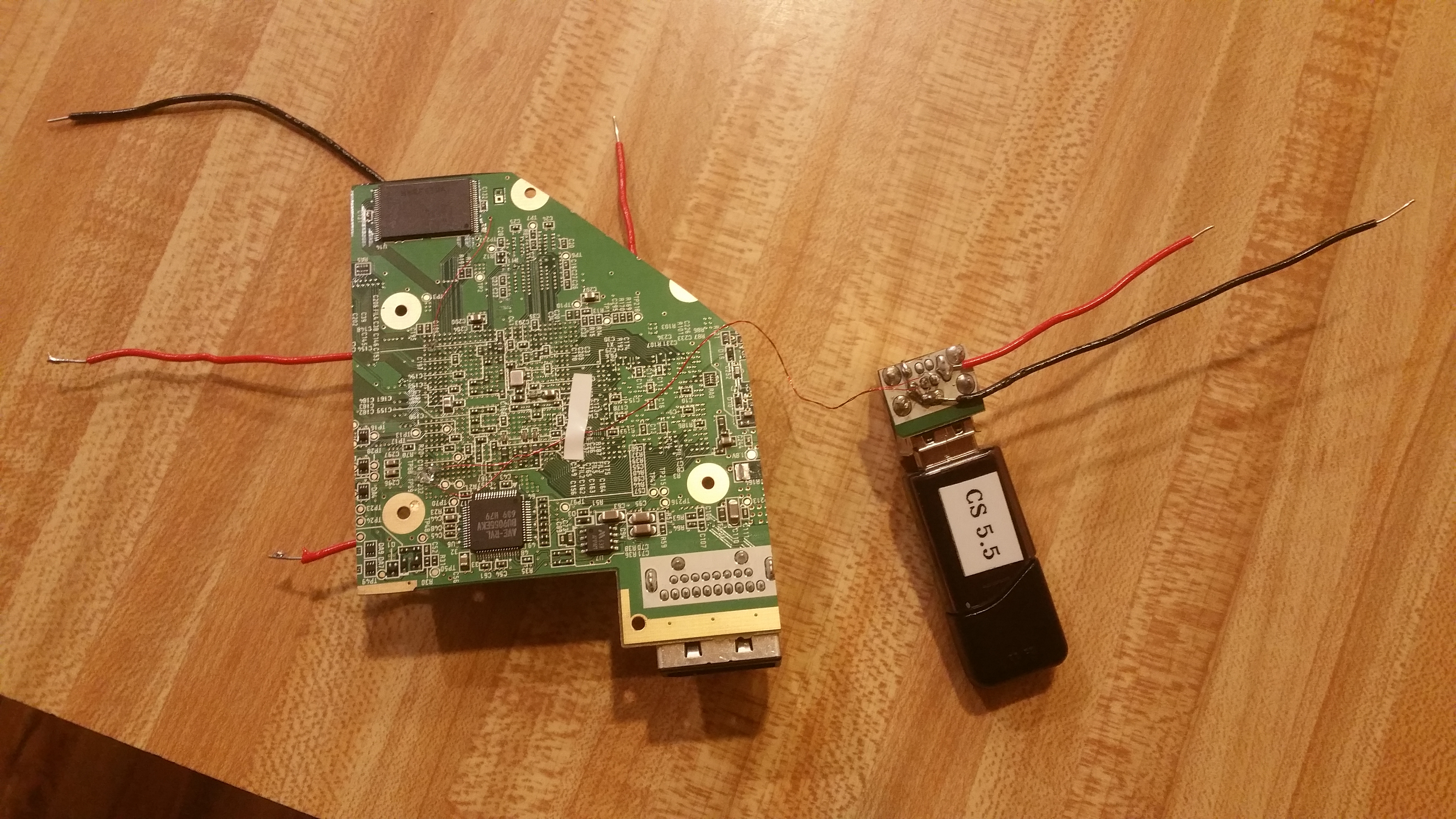

Got the board trimmed, sanded, and relocated! Sanding took forever but was definitely worth it. There was almost no swooshing, so I'm hoping we can get this Wii to boot. U10 went smoothly and was easier than expected, thanks to @Shank for shipping me new ones, and the rest of you for the help with it!
I also went ahead and wired up USB, since I can't get anywhere withhout it. Had to wire to the vias twice because I accidentally pulled them out of their solder job when twisting the wires. 38 gauge wire is a pain. Hot glue is handy.

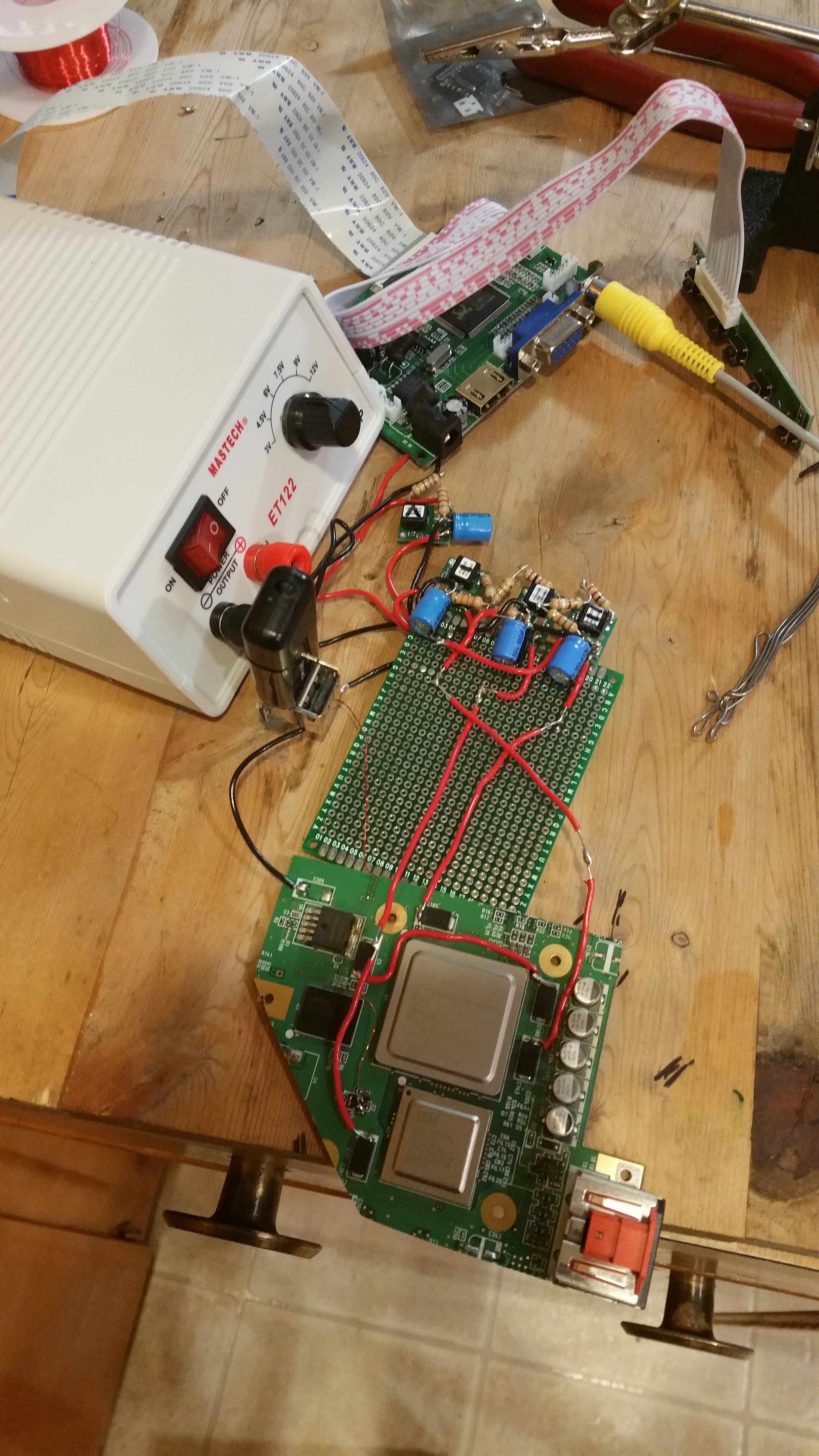

Regulators are ready to roll and working well, so we're ready for a test run! Except... My perf board got lost in the mail and hasn't arrived yet. It's supposed to arrive tommorow, but I don't really want to solder everything together tonight only to have to desolder it tommorow. Really wish I had access to some alligator clips, but oh well..

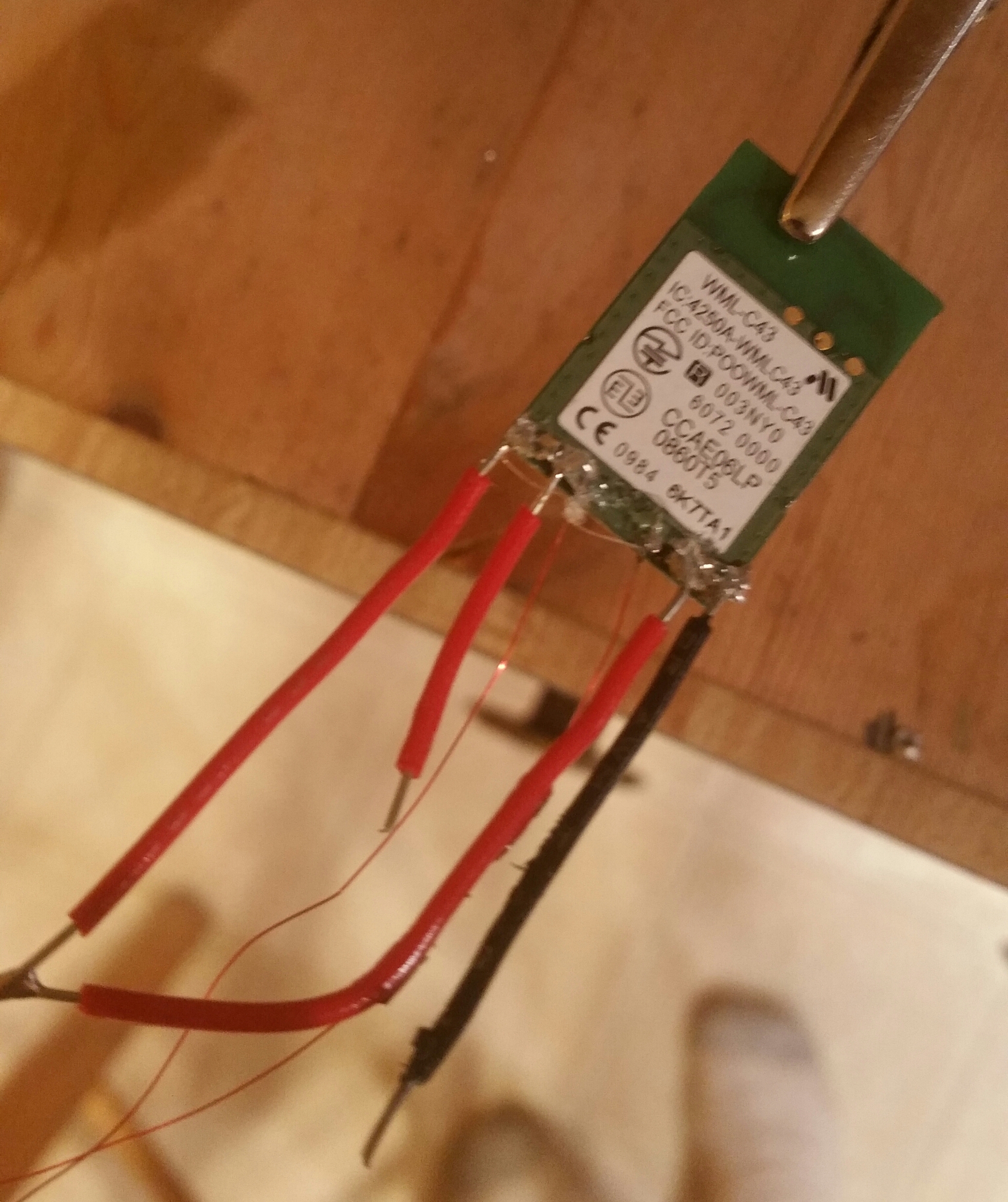

EDIT: Went ahead and prepped the Bluetooth module so that it's ready to go as soon as we get the board to boot!

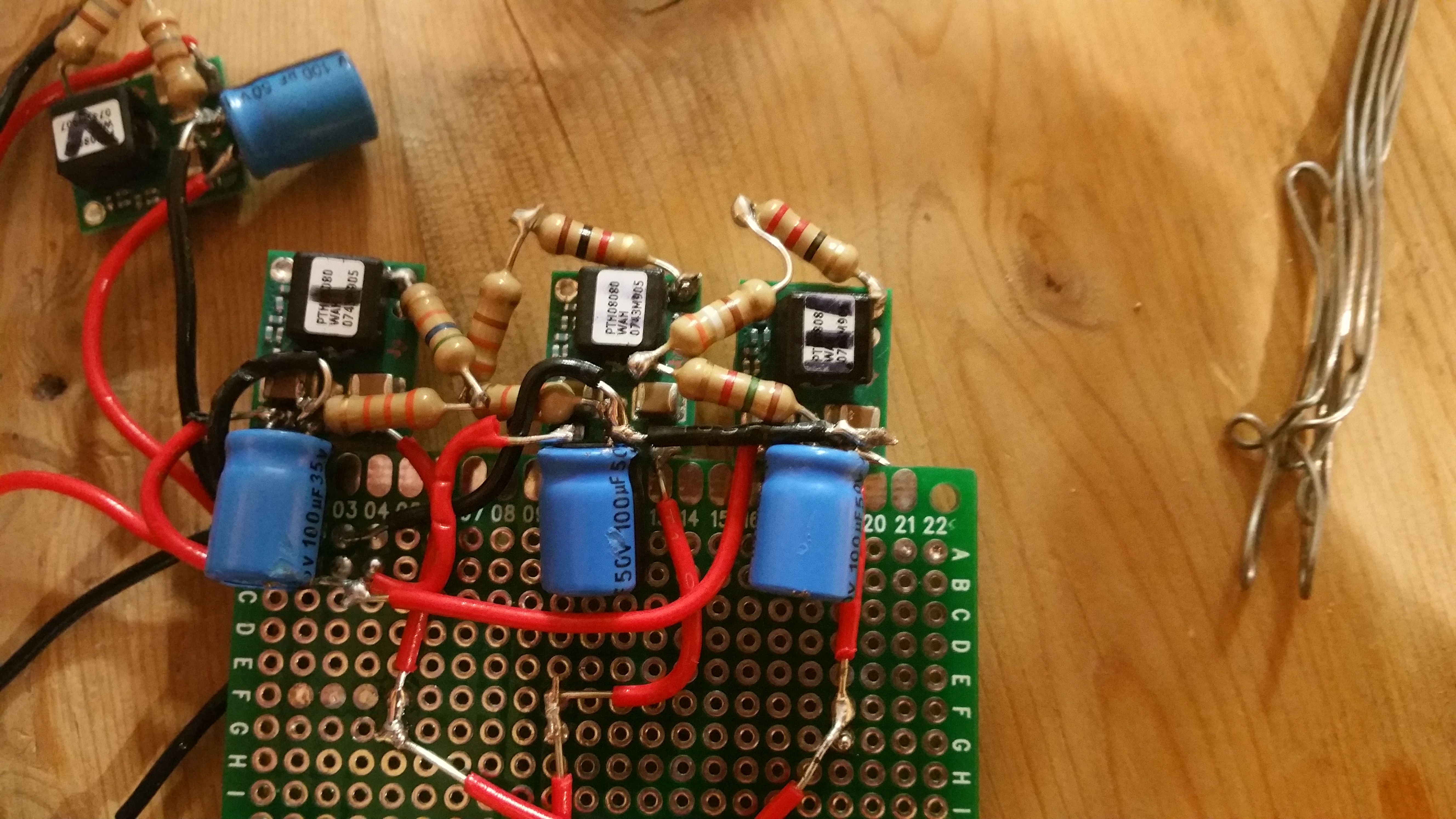

Well, a less exciting update, by I got everything wired to the regulators and it doesn't boot. I've found the reason though, and it seems that the 3.3v regulator isn't doing its job. I get a reading of 0v out of it with my multimeter, but I get a just fine reading out of the power and ground going into it. Pictures are included, and if you have any tips or catch something stupid I did, please tell me.
My voltages going to the board are also somewhat lower than they were before. 1.15 is okay, but my board is only recieving .97v on the 1v line. Will this also be an issue?
Lastly, my 1.8v line was only recieving .24v, but I'm assuming that's because 3.3v isn't working.

Have you tested the regulators when they are not connected to the Wii?
