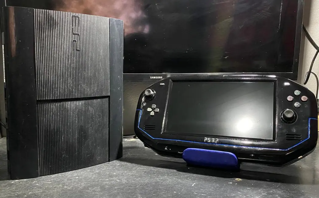

Thank you very much friend, I will bring information soon and finish this topicAwesome build! It's nice to see ps3 made portable!

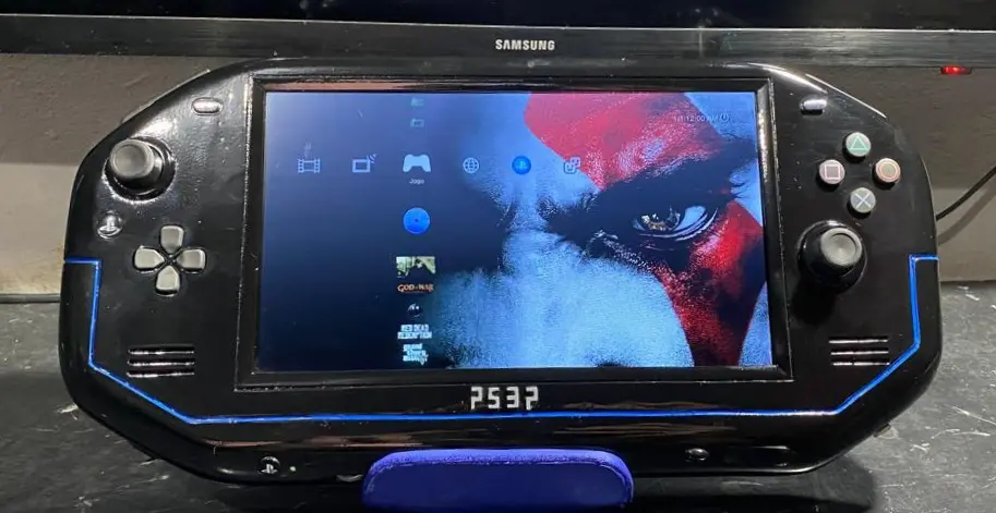

That's right, when I turn on the main switch, the voltage regulator emits the 5V needed to power the standby mode and the screen, then the DC DC regulator module starts sending a subsequent 12V to the PS3 motherboard.I have a question about the 12V main power to the console. I see when the on/off switch turns on the 5V tto ps3 standby and the LCD.
At this point is the PS3 motherboard also receiving 12V? I know the PS3 PSU doesn't supply 12V until the power button on PS3 is pressed.
I did hundreds of tests on both the first boards and the one that was cut, and there were no problems at all. The only difference is that the fan is activated before the board is turned on because its 12v comes directly from the power supply, but it turns very slowly because it is modified. After I enter the menu and activate Hen, I use WebMan to increase the fan speed.Ah i see. So the 12V is supplied to motherboard before the ps3 power button is pressed? There is no damage to motherboard?

Thank you very much, I'm happy to have reached the final stretchSeriously impressive! Congrats on the finished project. Has some old school portablizing energy to it
Yes, the hardest part is for someone to do the first one, I thinkNever thought I'd see the day.

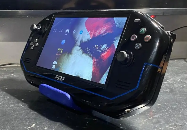

Sorry I didn't answer before, I had a small problem with my cell phone, but I'll answer you now. About the power supply, it uses 9 21700 5000mAh batteries. It's a bit heavy. I don't recommend playing lying down with it, otherwise it will be the end of you. LOL. Jokes aside, it's not heavy, you can play with it easily, but your hand will get tired, so I play with it on my lap or on the table. Because the PS3 is not an ideal console for portability, it consumes a lot and gets very hot. I did it for the adventure, but I don't recommend anyone to do it. Despite everything, it lasts 2 hours on batteries. It was lasting 2 hours and 30 minutes, but that was just the console. It didn't have a screen, amplifier, etc. Another thing is that it has a YPbPr to HDMI converter. It was the best way I could find, and it's working perfectly. I hope I helped.Impressive build! How did you decide in the end about the power to the console?
Another question is on the video output.. are you able to use component to your controller? I am trying to to find a LCD + controller with component (YPbPr) support but had no luck.
Just wondering on the details of the batteries configuration, playing time, and conversion to 12V. Congrats on being the first to portabilize a PS3 super slim![]()
