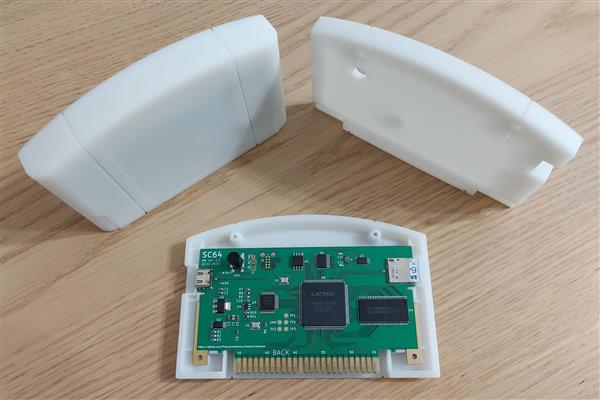

Enter, the SummerCart 64 - a fully open source & feature-rich N64 flashcart:
The SummerCart 64 is an absolutely fantastic piece of hardware, and has a ton of features, including a great loader menu, rock solid game compatibility, and 64DD emulation. However it's got some extras that we probably don't need for a N64 portable, specifically it's debugging/USB capabilities, and we can probably go without the RTC for the one game that uses it. I thought about a trim, but why don't we go even further beyond:

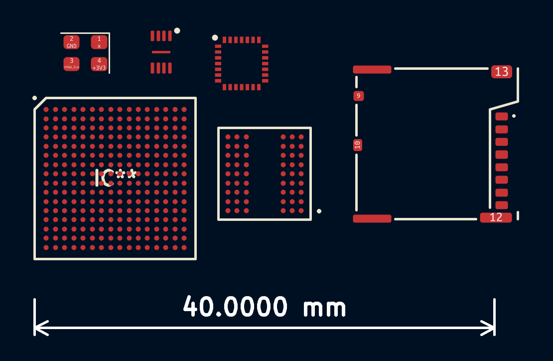

My plan is as follows:
1. Strip out unnecessary features from the SC64 HDL.
2. Redesign the motherboard to use a BGA version of the Lattice MachXO2 FPGA and 512Mbit SDRAM.
3. Reduce the size of the board to be as small as possible.
4. Eliminate the cart edge connector, and replace it with a flat-flex connector.
5. Create an example flex cable that solders directly to a trimmed N64 motherboard, and can be easily modified to suit your needs in your designs.
I can't wait to get stuck into this project. This will be my first experience designing around BGA parts, and I cannot wait to learn all about the intricacies in BGA circuit design so that I can deliver you all a high quality end product that's worthy of this great community. And yes, as always, it will be fully open source! Stay tuned for more updates as this progresses!

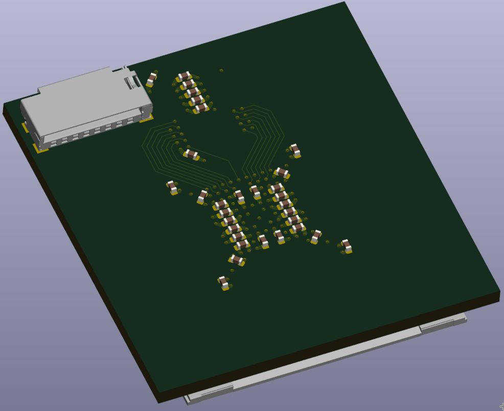

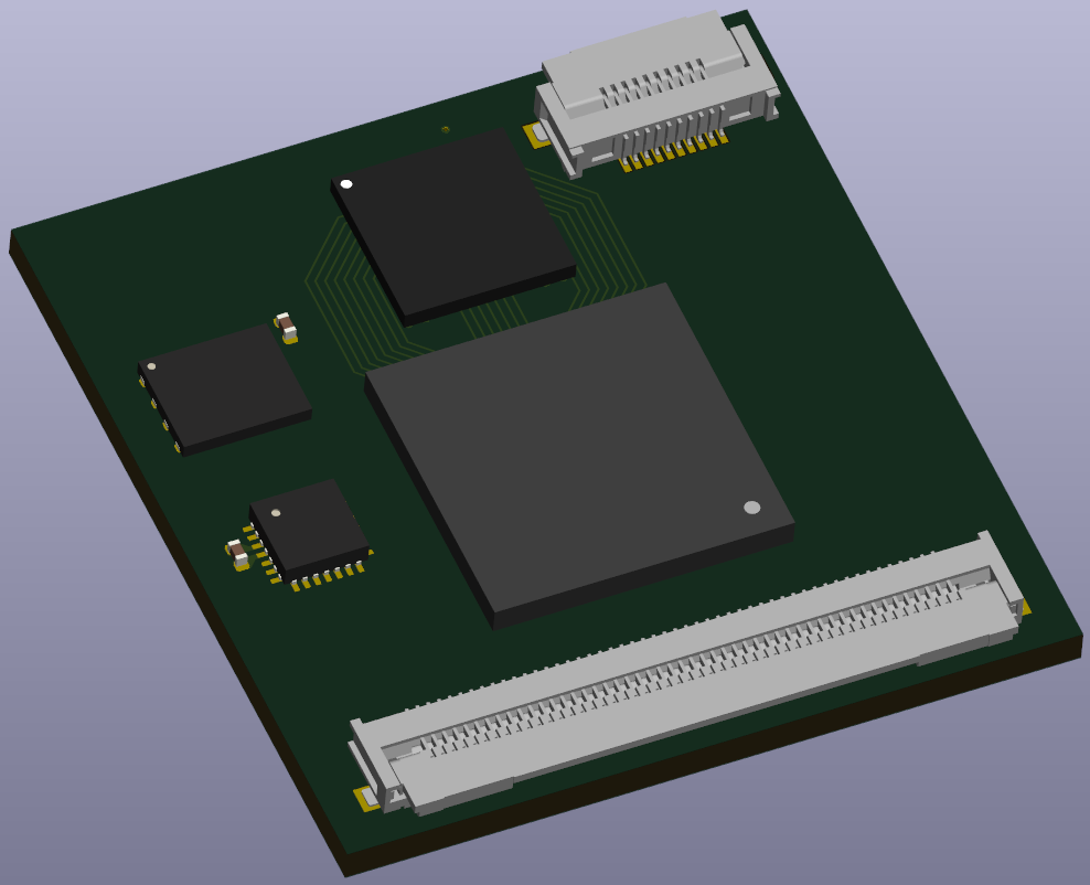

Figured I'd update y'all with the progress made so far. Still a lot of work to be done, the current component layout is far from finalized, and not everything has been placed on the board & routed yet, but this should give you a rough idea what I'm going for!
As it stands right now, the overall footprint for the "cartridge" stands at ~35mm², which is even smaller than my initial 40mm² plan!
I have found fully compatible BGA versions of both the Lattice MachXO2 FPGA & the 512Mbit SDRAM, and have pretty much finished the routing & decoupling capacitor placement for both of those. I've also sourced a compatible QFN version of the STM32G0, which is essentially identical to the original used, just with more I/O.

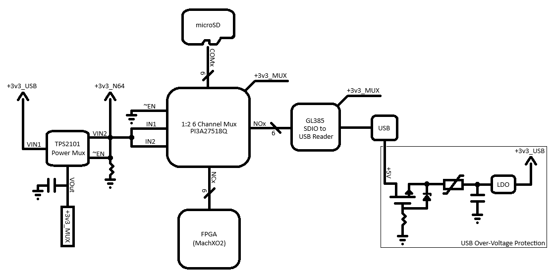

Additionally, I've decided to offer many different ways to interface with the storage of the flashcart. The SummerCart64 is designed to work with SD cards, however I realized that there was a ton of different ways we employ for a user interact with an SD card in a portable. Whether having the card removable and accessible from the outside of the build, or having it be non-removable & accessed through a USB port like the 4LayerTech PMS-PD 3 for Wii portables, I didn't want to force anyone into one option, so I'm adding them both!
The cartridge will feature an on-board half sized microSD slot, as well as a FFC connector for a microSD extender board that I also plan on making. Said extender board will be designed to-spec with proper impedance & length matching, and can be modified to be the exact length you need for your build. You can also always use an off the shelf microSD extender cable if you so desire. Also, there will be a USB interface on-board based on a GL835 SDIO reader chip, which will be properly muxed with the FPGA to prevent any accidental interference or corruption, similar to the 4Layer PMS-PD!
Now, a concern I had with this approach is how you'd only want the internal SD card to be accessible while the unit is off, and with potentially backfeeding power into the cartridge or the rest of the build through the USB port when connected to a computer. With some gentle guidance from @YveltalGriffin, I was able to come up with this concept on how to pull all this off.
This idea is still quite preliminary, but the gist is to employ a TPS2101 power mux IC to handle the switchoff between VBUS and VSYS (the portable's 3v3 rail) for this part of the cartridge, prioritizing VSYS for when the portable is on. The PI3A27518Q is a 6 channel, high-speed, bidirectional mux designed to handle SDIO/QSPI, and is what is handling the switchoff between the FPGA and the GL835. The SDIO mux's input selection lines are pulled low by a resistor until VSYS is present, so the GL835 will be considered the active device until the portable is on, which then the FPGA will stay selected until the portable is turned back off.
The only downside with this circuit is that the USB port *has* to be presenting 5V, as its being stepped down to 3v3 through a LDO. I implemented an over-voltage protection circuit so that you can still use USB-C PD without destroying something, however if you happen to use a PD power supply or a computer with a USB C to C cable that outputs PD voltages, the zener diode will clamp the voltage to 5V and burn the rest off as heat, which may be a concern especially at higher PD voltages. Perhaps I will consider an SMPS setup instead so that PD voltages aren't at all an issue, but I believe that will increase the BOM cost of the whole thing, so I'm not sure which route I will go.

Hello, original project author here. Cool to see people interested in it. However, I have some suggestions about your adaptation.
First, I would highly advise against straying too far from the original hardware design. Source project is far from being finished and if you make your version firmware incompatible with my official release, then it is guaranteed you will stay behind latest improvements. This may come as a surprise but my project is full of bugs in the FPGA code that I'm actively working towards fixing them.
Second, I'd rather stay away from any muxing chips between FPGA and SD card. SD clock speed is 50 MHz and the FPGA design is written in a way to compensate for the specific clock skew and bus turnaround. Introducing more delay might make SD card just not work. Also I don't really understand why you removed FDTI chip and introduced this weird contraption just to access SD card via USB. I think it would be easier to add some USB commands to handle SD card read/write from the PC. This is actually a highly requested feature for the SC64 but I haven't gotten to implement it yet.
Third, the RTC chip is used for more than just keeping the time. I use battery backed SRAM inside the RTC chip to store persistent settings and, most important, console region.

3. In regards to SD access, I suppose you make a fair point here for keeping the FTDI chip. I'll have to look more into it and see if it's at all possible to find them in a smaller package & if it'll make sense to include here. I'm still pretty early on into the design conceptualizing phase of this project, so suggestions like this are more than welcome!

Most importantly, I may consider looking at rethinking the approach for handling SD card access, as it's quite convoluted and is gonna probably end up taking a decent bit of real-estate space on the board. Perhaps I can release a separate module down the line, something akin to PMS-PD 3 from 4Layer, where it connects to AutumnCart but handles the SD and USB muxing itself. I think this could be a valid approach instead of baking it onto the cart, but I'll consider my options here. If I can come up with a solution that even the original SummerCart can benefit from, I will try to go down that route.
