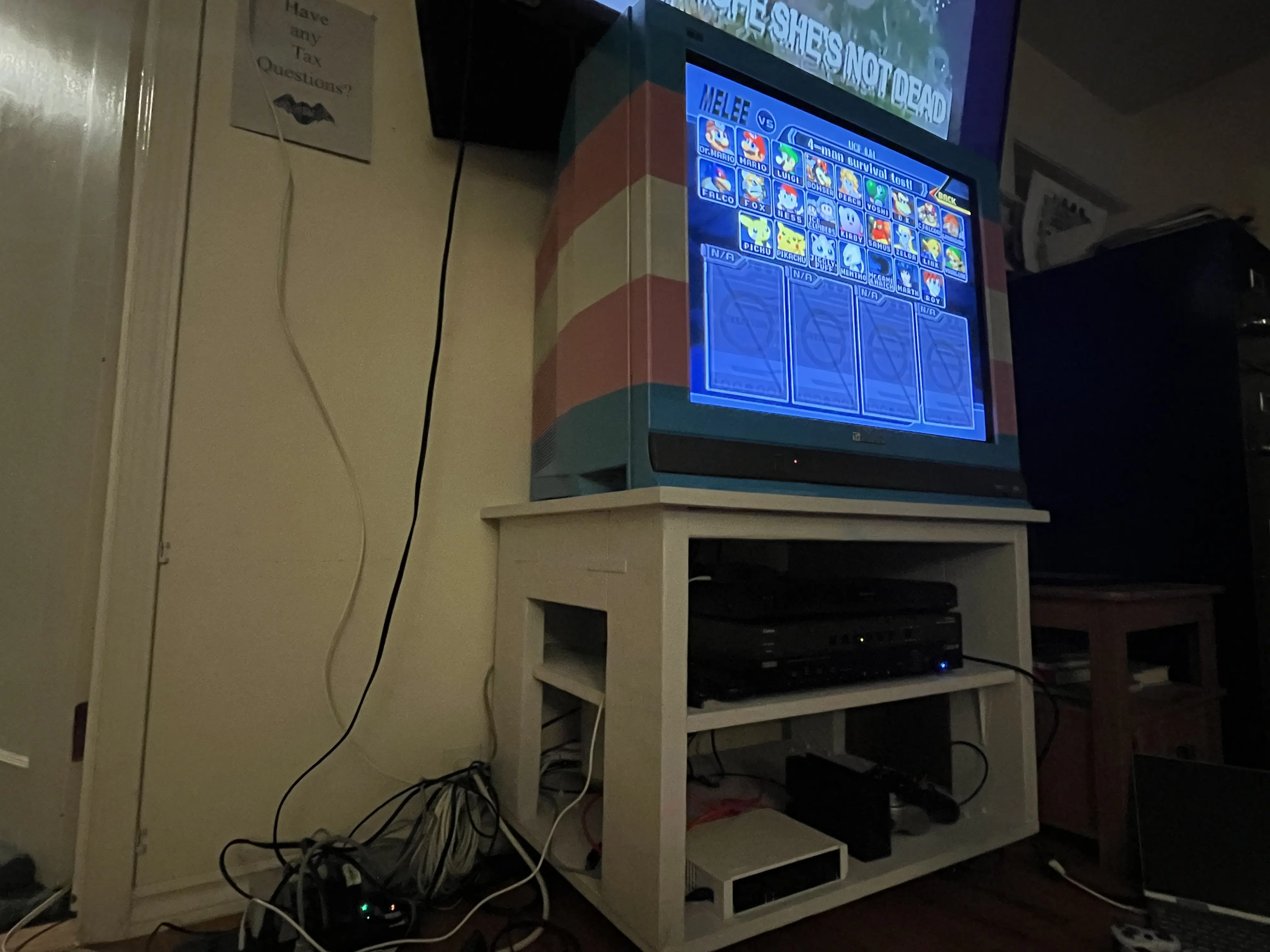

As far as 480p goes, im eating good with a 32" 4:3 HD Tau, as pictured hehe. i also have a 14L5 that, works but needs more work to be tourney ready. What ill likely end up doing is a couple fujiflexes for those displays, and for the Tau i think i'll go from HDMI->VGA->YPbPr with a cheap hdmi dongle and a bitfunx VGA->YPbPr. As for my 14L5 i might actually try HDMI->HD-SDI given it's digital to digital an the option card is just there, idk much about SDI but ive been meaning to pickup one of those for a bit. If thats not a good option i'll go for HDMI->VGA->Sync combiner.
