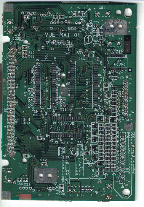

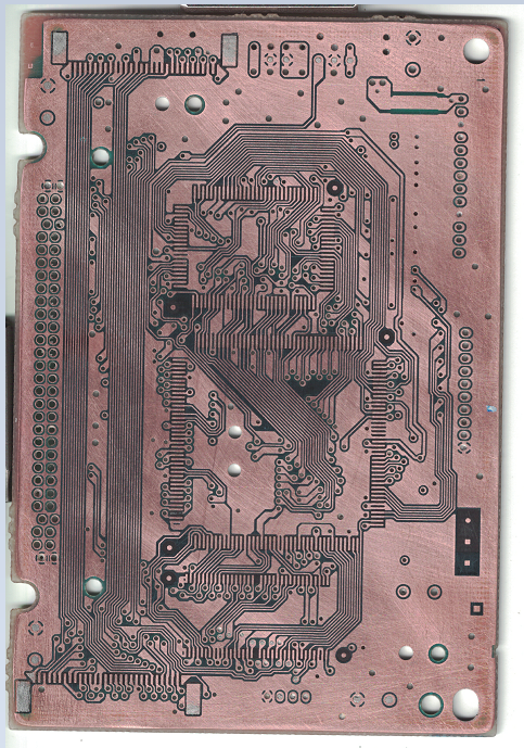

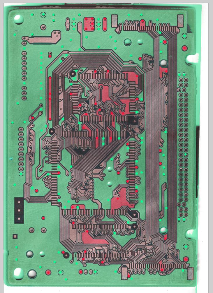

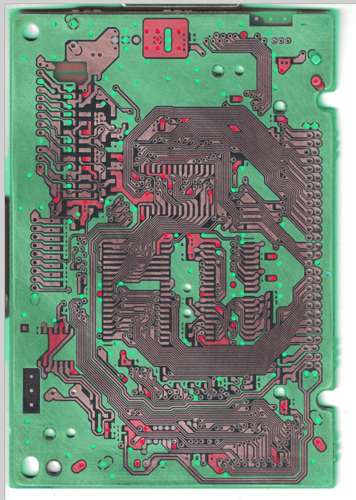

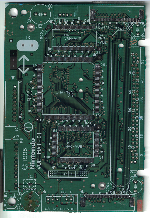

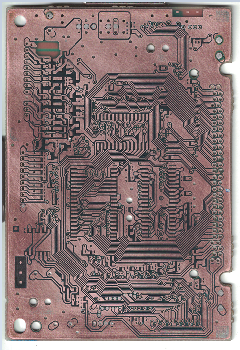

A while back, I acquired a completely toasted Virtual Boy motherboard. I finally got around to blasting the components off of it, sanding, and scanning. I have scanned the surface layers, but not the internals. I may get to that one day...
-I'm like 90% sure there is only one revision of the board
-I suspect the board is 4 layers.
-A single pad was lifted, but the trace connected to the pad is clearly visible

Needed a break from video editing and started the skeleton of a compendium using an incomplete inner voltage layer. One of the inner layers is 100% just a solid 5v plane. The other inner layer... I haven't gotten to yet, but my presumption is that its going to be just a solid GND plane.
I have no intention of completing this compendium, as I simply have too much on my plate right now. If anyone is interested in taking it on, shoot me a message here or on discord. Its not particularly difficult, just tedious and time consuming
