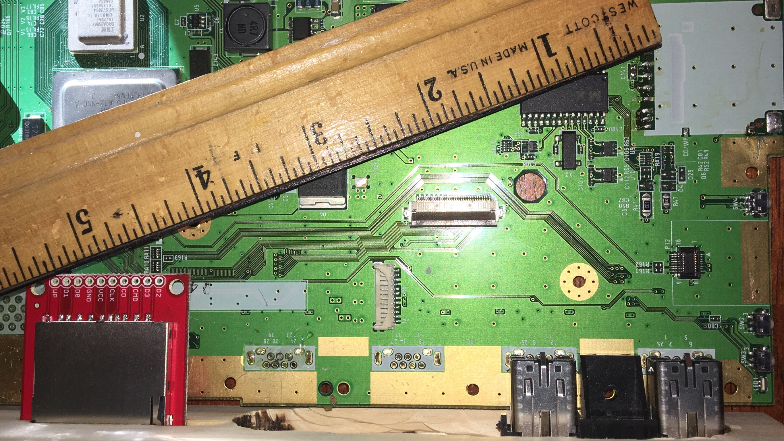

Anything I can do to make that maximum length longer? I already lazer cut an SD card slot in my case...
I recommend trying to keep your wires parallel so they don't cross over one another. Try to make sure all the data wires are the same length as well.
Ok. I will try that. This is the gap:

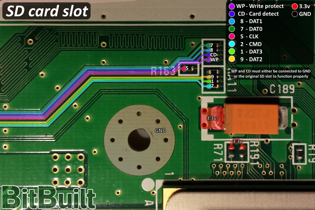

Actually... That might be the perfect spot for an SD card slot, if you're willing to try a bit more challenging wiring. If you look at the Wii trimming guide, you'll see this image with spots to relocate the slot to:
These components are directly underneath where you have your slot, so it be worth the more challenging soldering job to endure that interference won't mess stuff up.
Also, why are you keeping an SD slot? I don't mean this in a "don't do it, it's stupid" sort of way, but everything you want to do with SD might be possible with just USB. I can only think of a couple of somewhat obscure Homebrew things that require an SD card, but if you want an SD card for that stuff then go for it :D
Wow those traces are thin... I don’t have the right tools to do that kind of stuff, so I think I’m going to stick with usb. Thanks for the info though!
