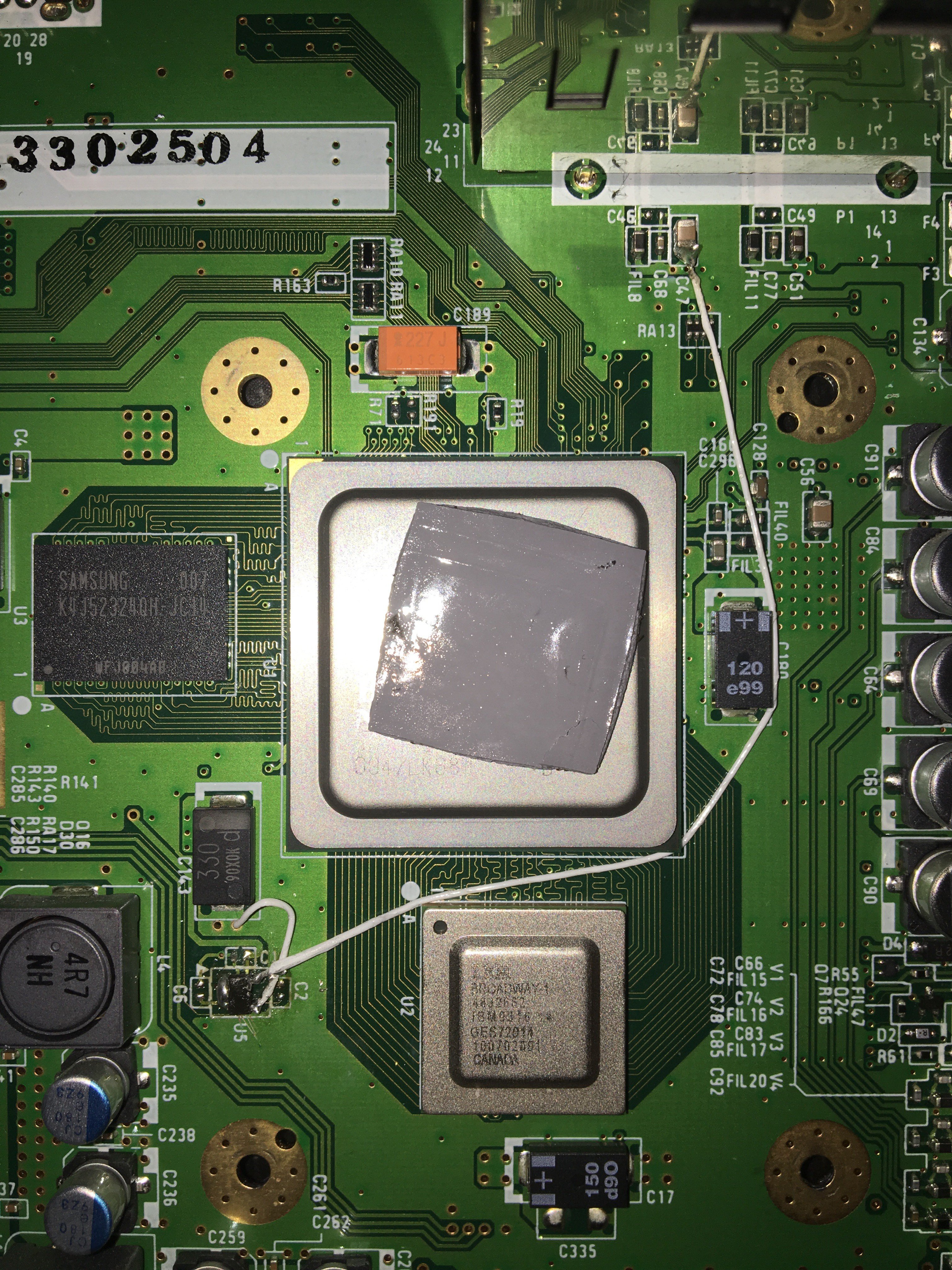

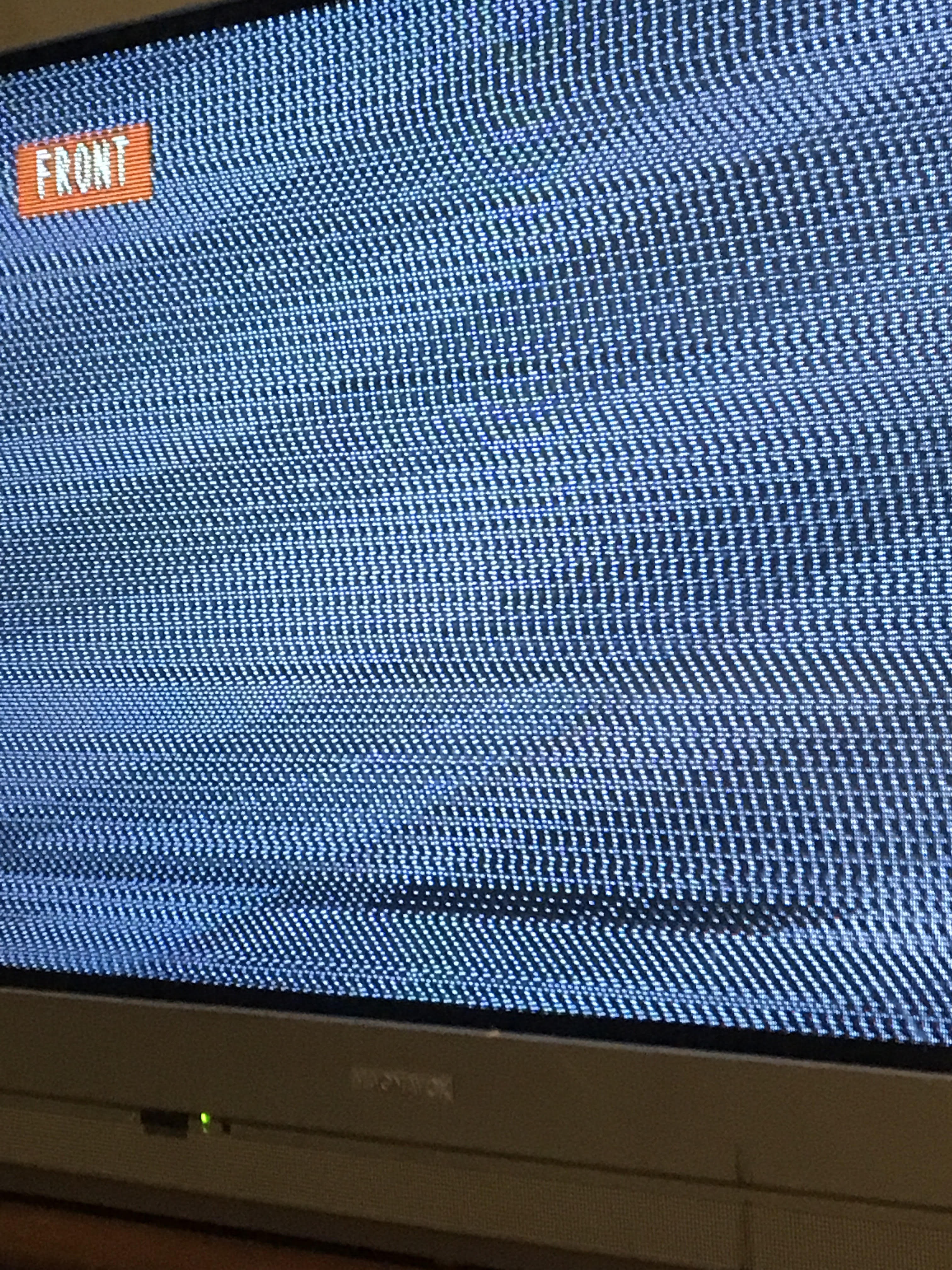

So I just relocated the u10 on an un trimmed board. I followed the instructions on the trim guide, and now when I turn on the Wii I see this:
I have the USB drive plugged in, which worked perfectly before.

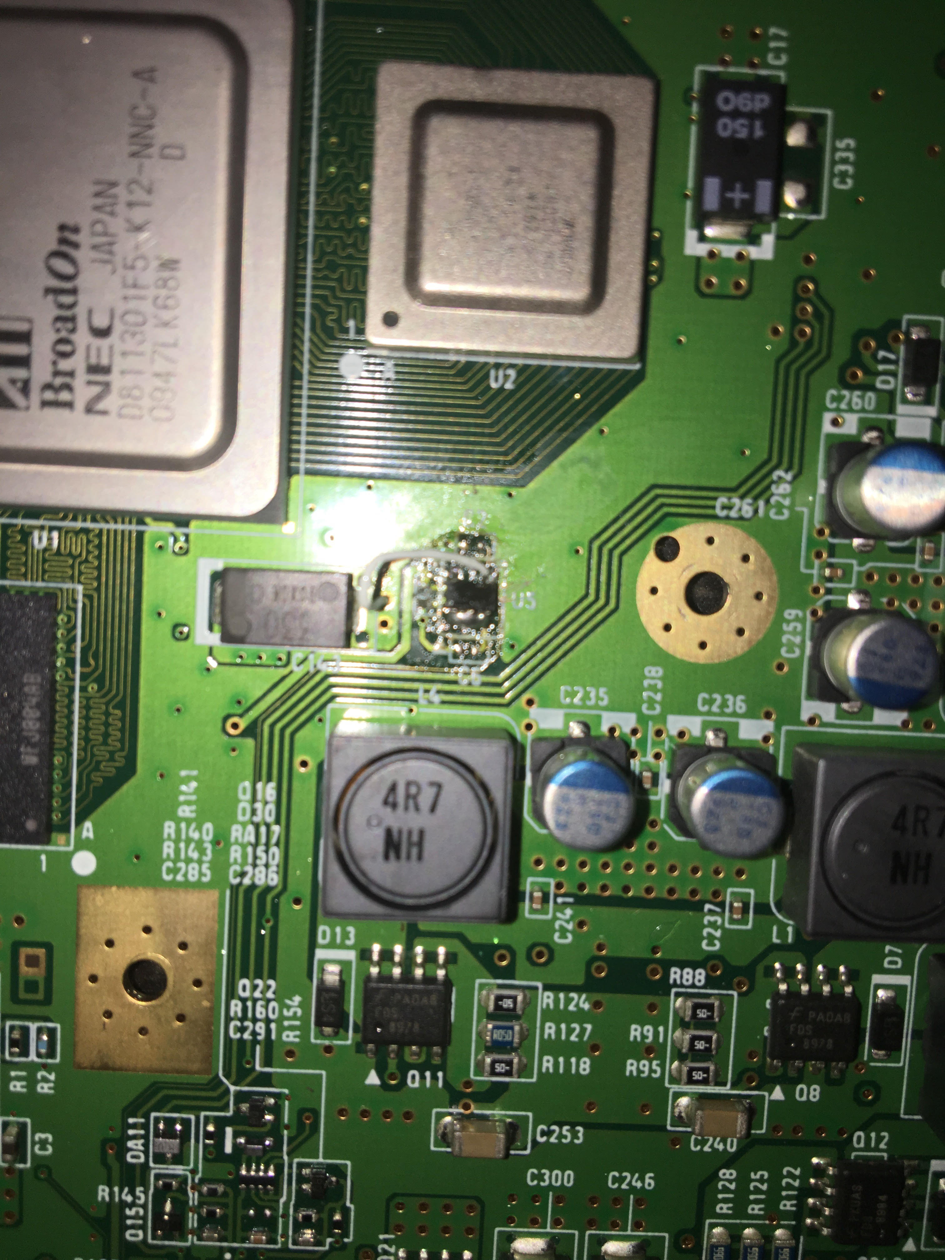

It appears that I lifted this pad:

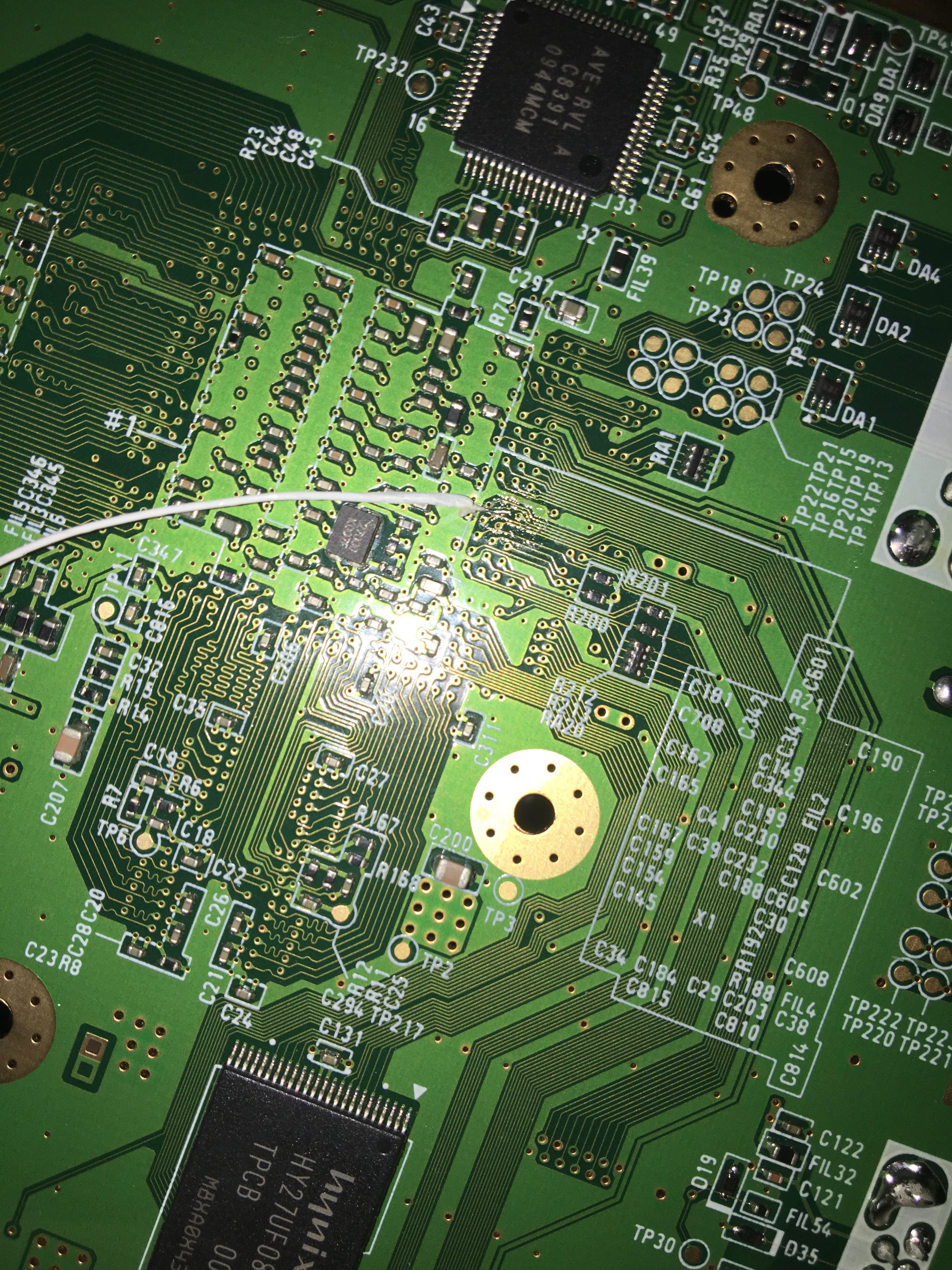

Additionally, I didn't lift the pads that were shown to be lifted in the guide, and I have bridged them with a glob of solder as shown in the guide. I also made sure with a magnifying glass that the wire on the back of the board was no shorted with anything.
In case it matters, I did not remove the U9, or any of the capacitors surrounding it and the U10.
Is the pad I lifted the problem, and if so, is it possible to tap that line anywhere else? It appears that I can get it from the upper pad of C1, but I wanted to ask to be sure.
Here are some pictures of my board for reference:
