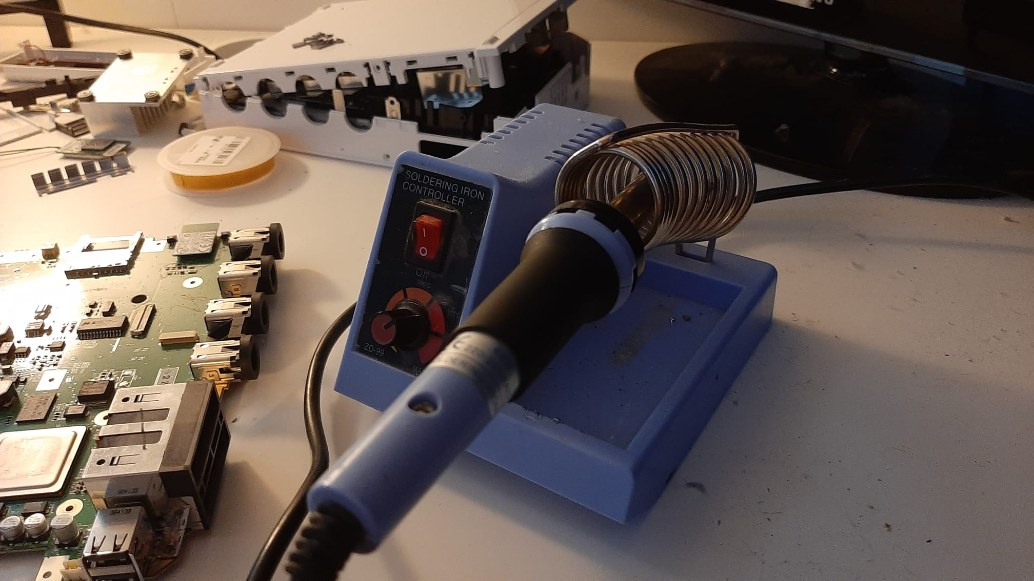

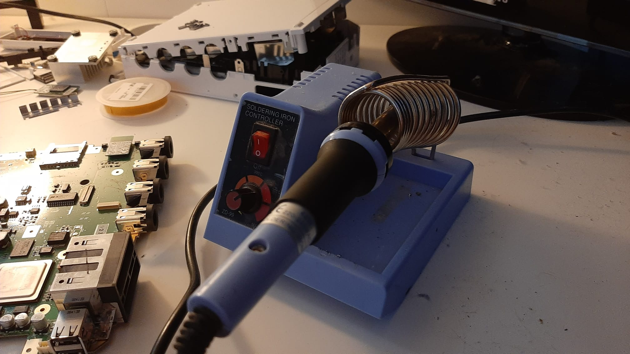

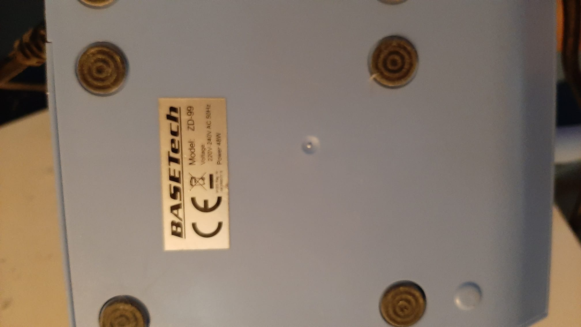

Here is a picture of my uncle's soldering iron if you still wanted to know:
