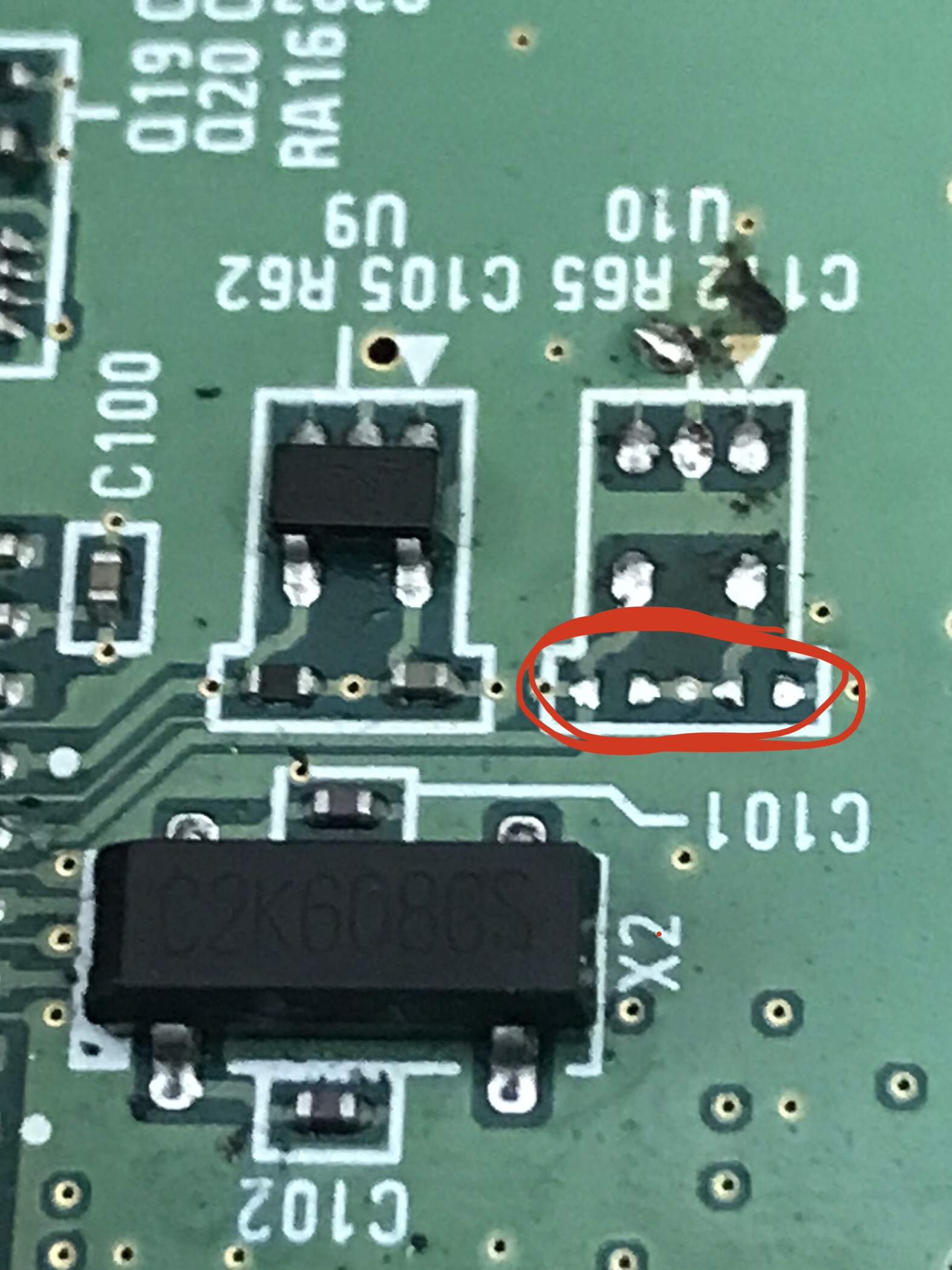

So, I’m currently prepping for a Noldendo trim on my motherboard, and while doing the u10 relocation ahead of time, I accidentally removed a capacitor and a resistor right above the original u10’s location.
I’m fairly certain I know how to relocate those same components from an older board I have, but is that necessary at all and will this thing boot without them anyway?
Those passives don't do anything when the U10 is removed. It'll boot just fine without them
